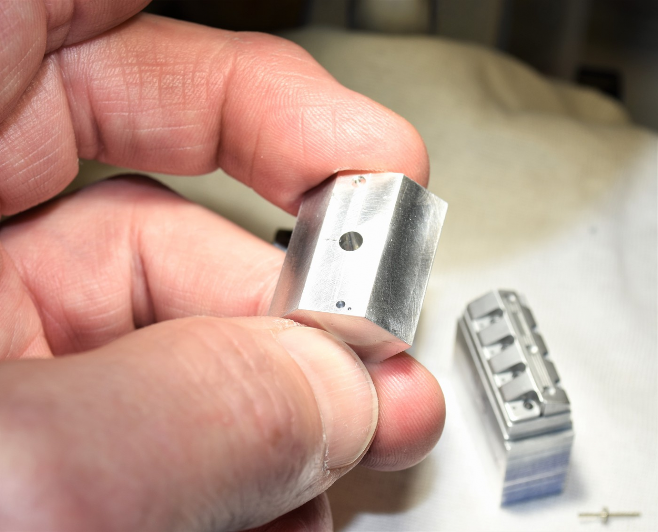

Hello everyone,  I got the block and water pump/cam cover drawn up and started machining the block.  I know that back in the day the blocks were cast aluminum but I wanted the look of alum so I'm machining it and will buff/polish and or media blast it for a proper look when done.  The block is about 2/3 done.  I have to add motor mount, freeze plug and oil housing detail among other odds and ends.  The lower portion of the block on the passenger side needs done next but the two sides are a bit different so getting this look right has been more challenging than the Donovan engine in the Bantam.   Took me the better part of a day just to machine the lower portion of the block you see below.  Hope everyone had a Happy Thanksgiving.  Cheers, Tim

Tim, love the "soft" look on the aluminum heads.  Is that sandblasted or steel wooled?  Looking great!

Hey Pete, the finish was just dremel soft polishing wheel for metal & 0000 steel wool.  I agree, it does look pretty cool in person .   Thanks for checkin' in.

Thank you Niko & Hakan for posting both your comments and insights.  Sorry for the mixed order of pics I'm sharing.  The 1st pic is of the rear motor plate and block "flanges" as I call them along with the machined oil filter housing.  I'll mill a bit off the front of the drivers side to mimic the actual block and you'll  see some further detail later.  More pics below.
The next 2 pics show an actual alum. 494 block with the screw in freeze plugs.  I'll be doing all 6 in the style of the one circled.
This pic is the crank/flywheel flange.
This pic shows the drawing for the crank damper that I machined in 2 pieces.  I couldn't post the pic (file is still to big) of the completed unit but the smaller piece fits inside the larger one as an fyi.  The diameter of the finished damper is 6.6mm.
