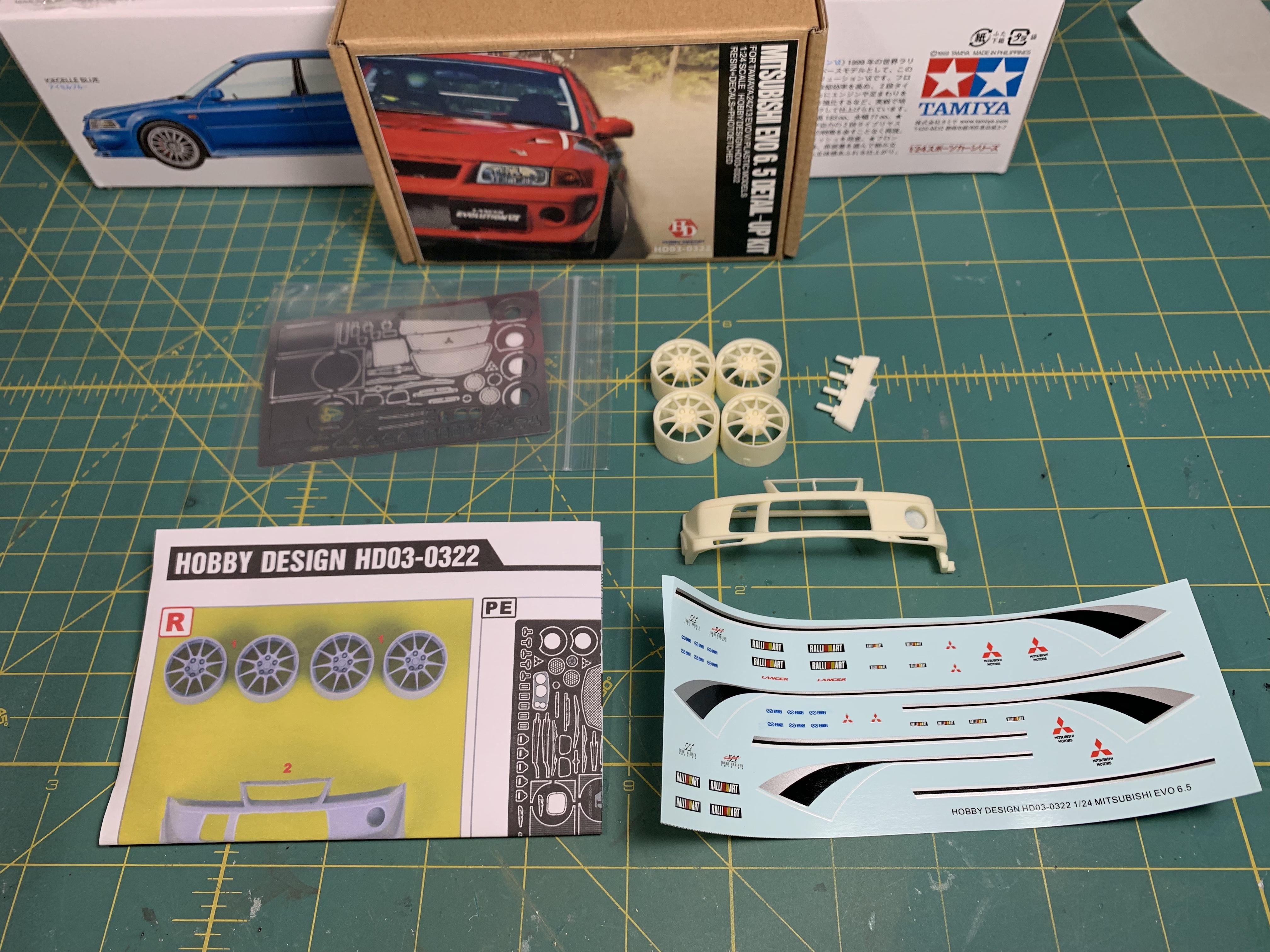

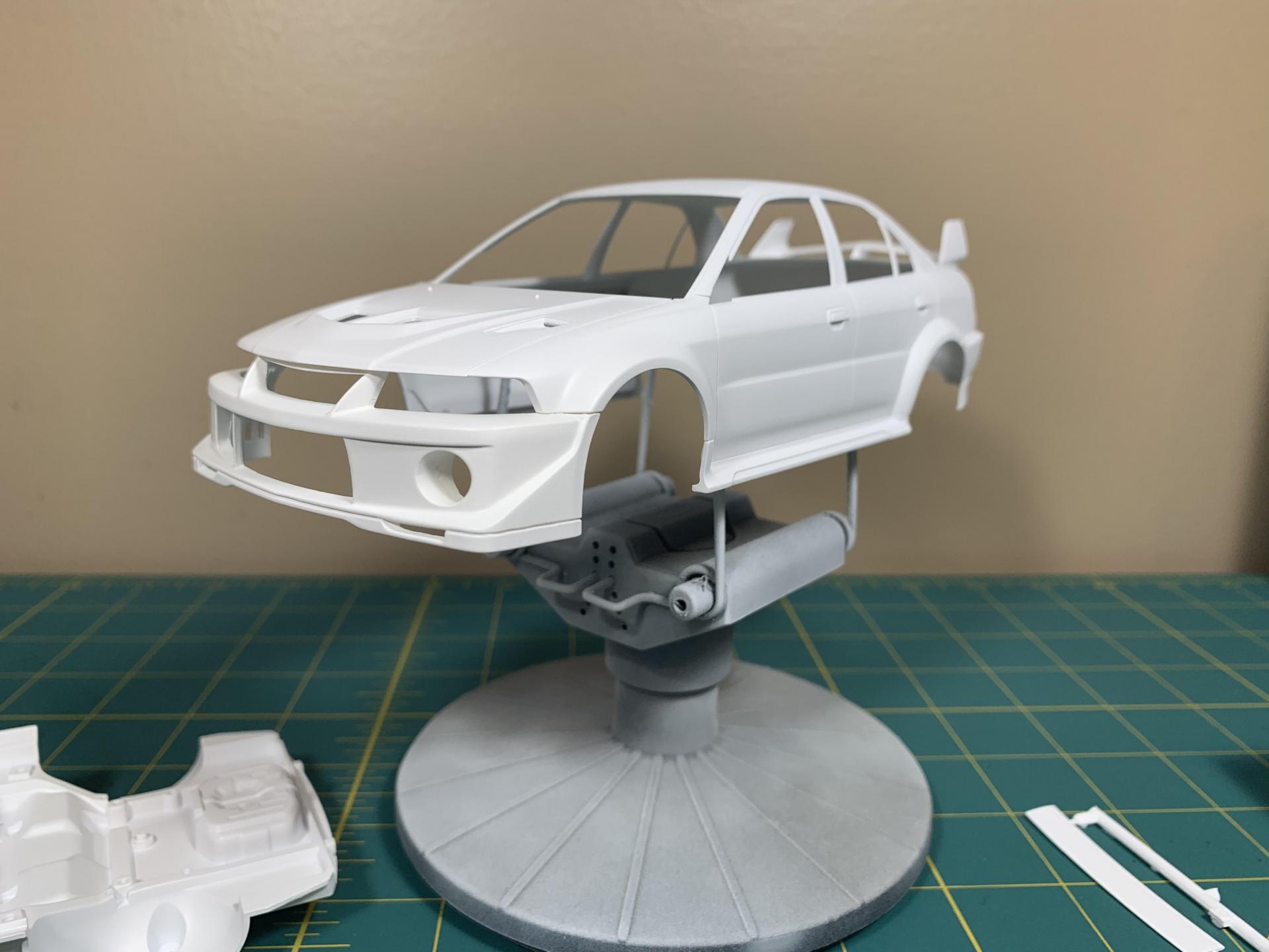

Super excited to get this one on the bench. I saw a pic of one completed online with the detail-up kit from Hobby Design and knew I had to build one.
The kit is a Tamiya Evo 6, And the detail-up set is from Hobby Design. I will also be adding a Hobby Design Muffler. The color is going to be Mitsubishi WRC Passion Red from Zero Paints topped with Zero Paints 2k Clear.
The detail-up set includes the TME front bumper, TME wheels, TME decals, and photo etch parts as well.

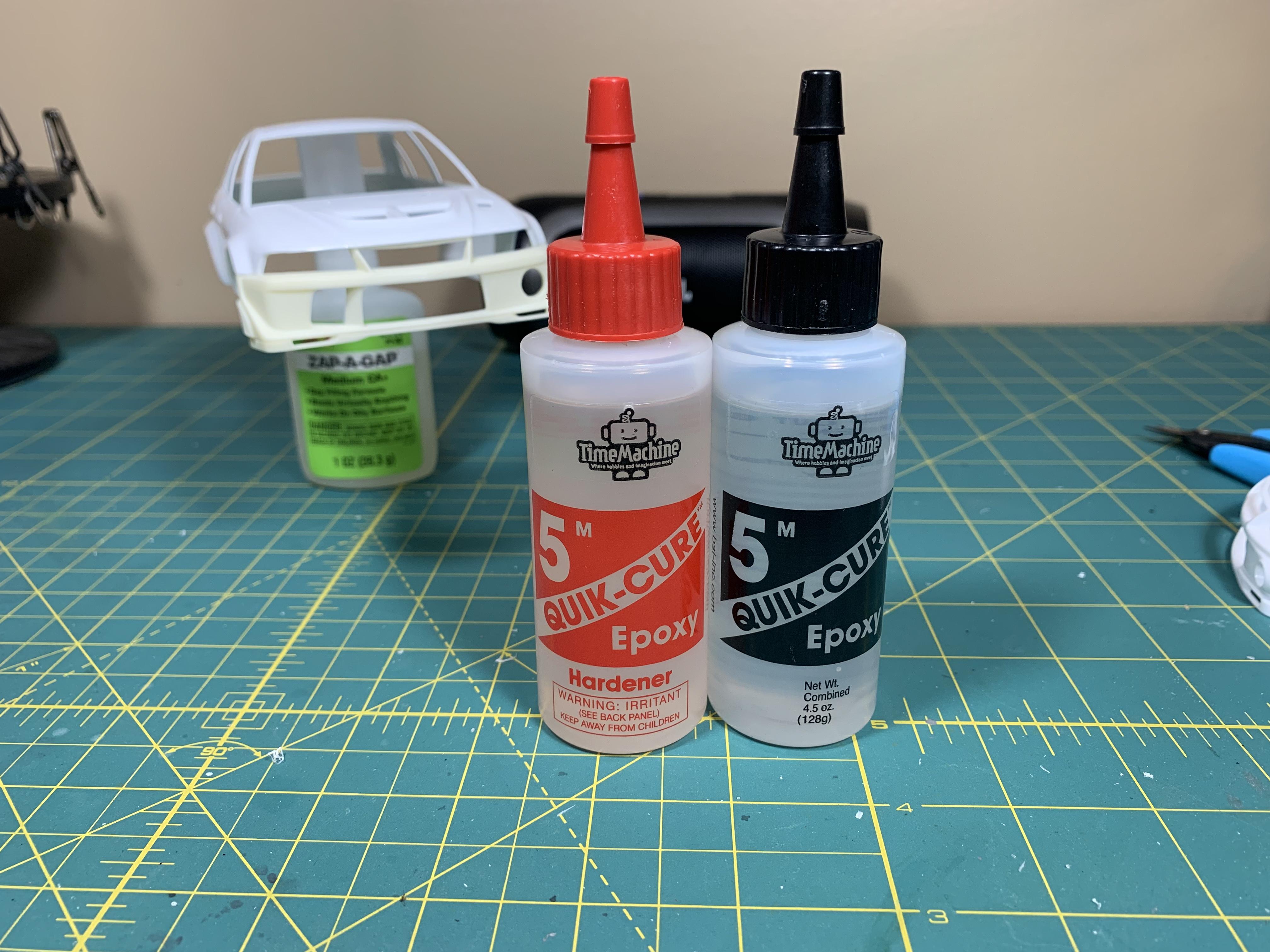

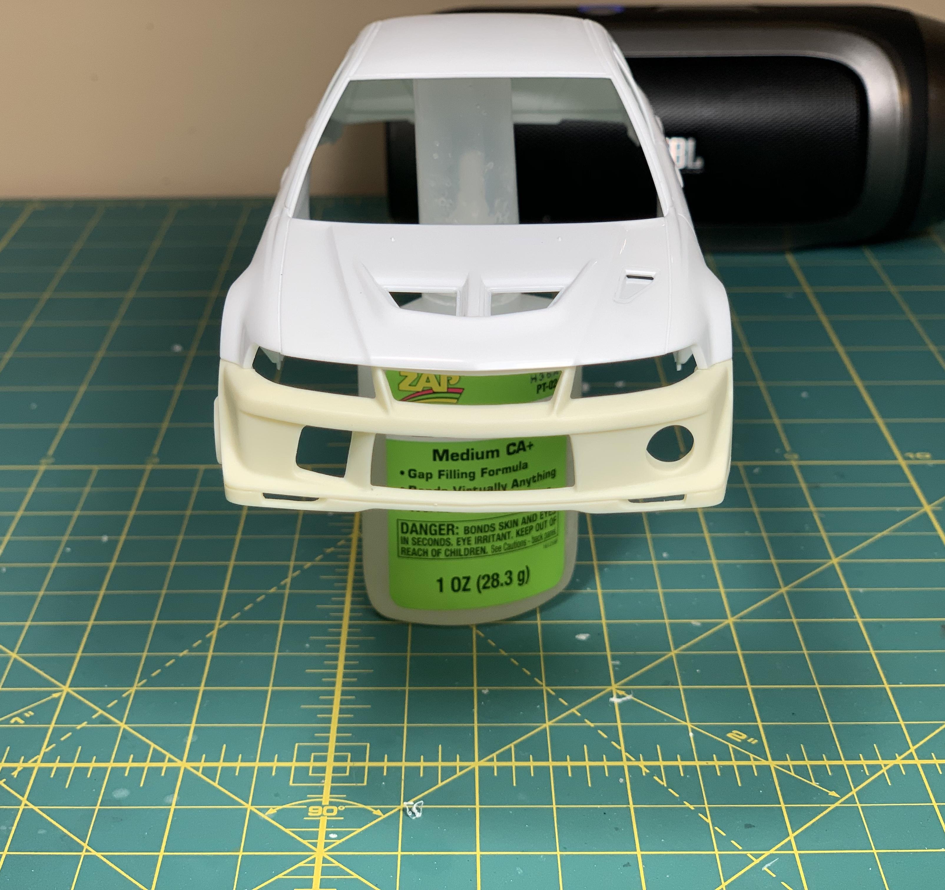

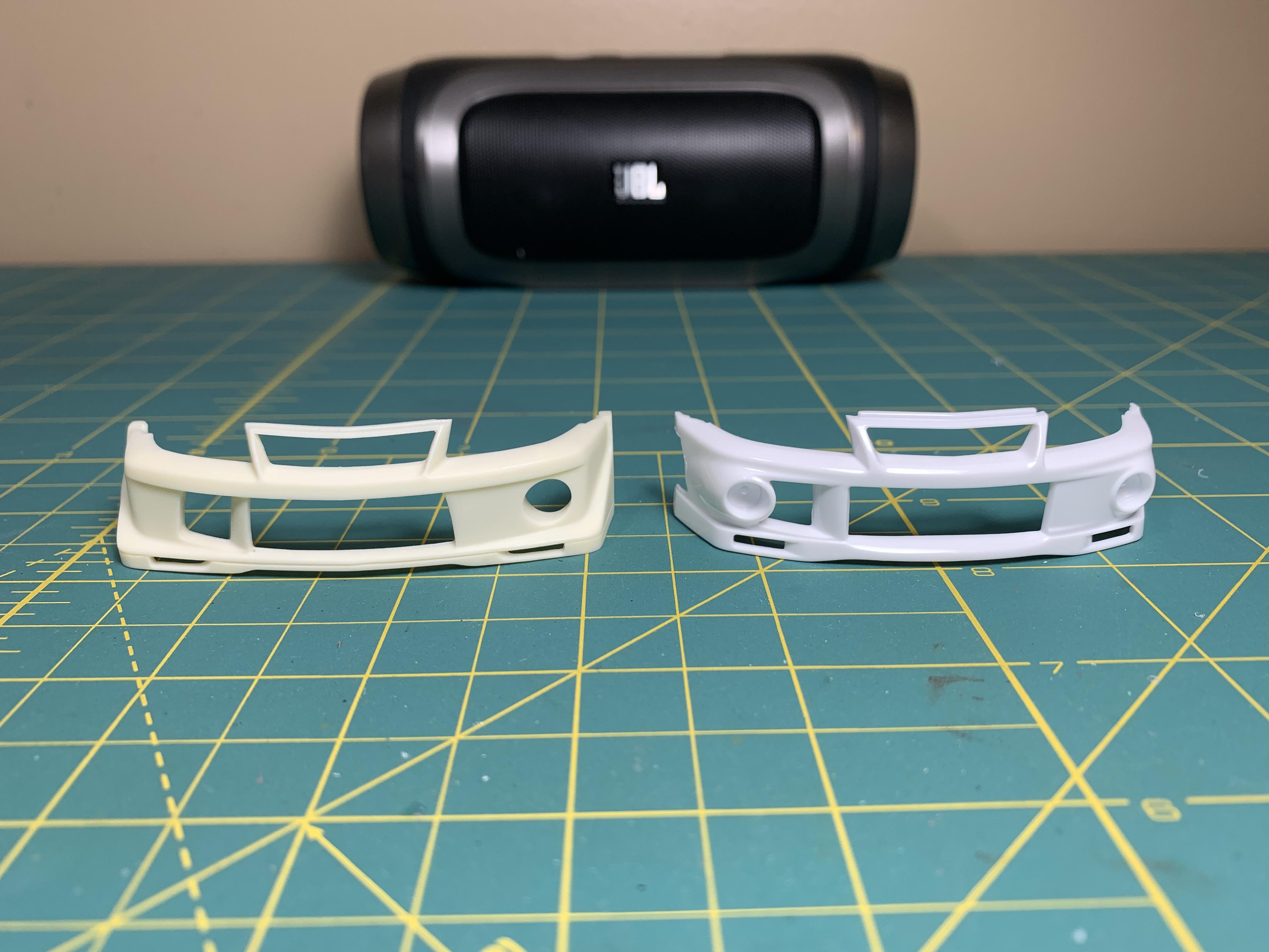

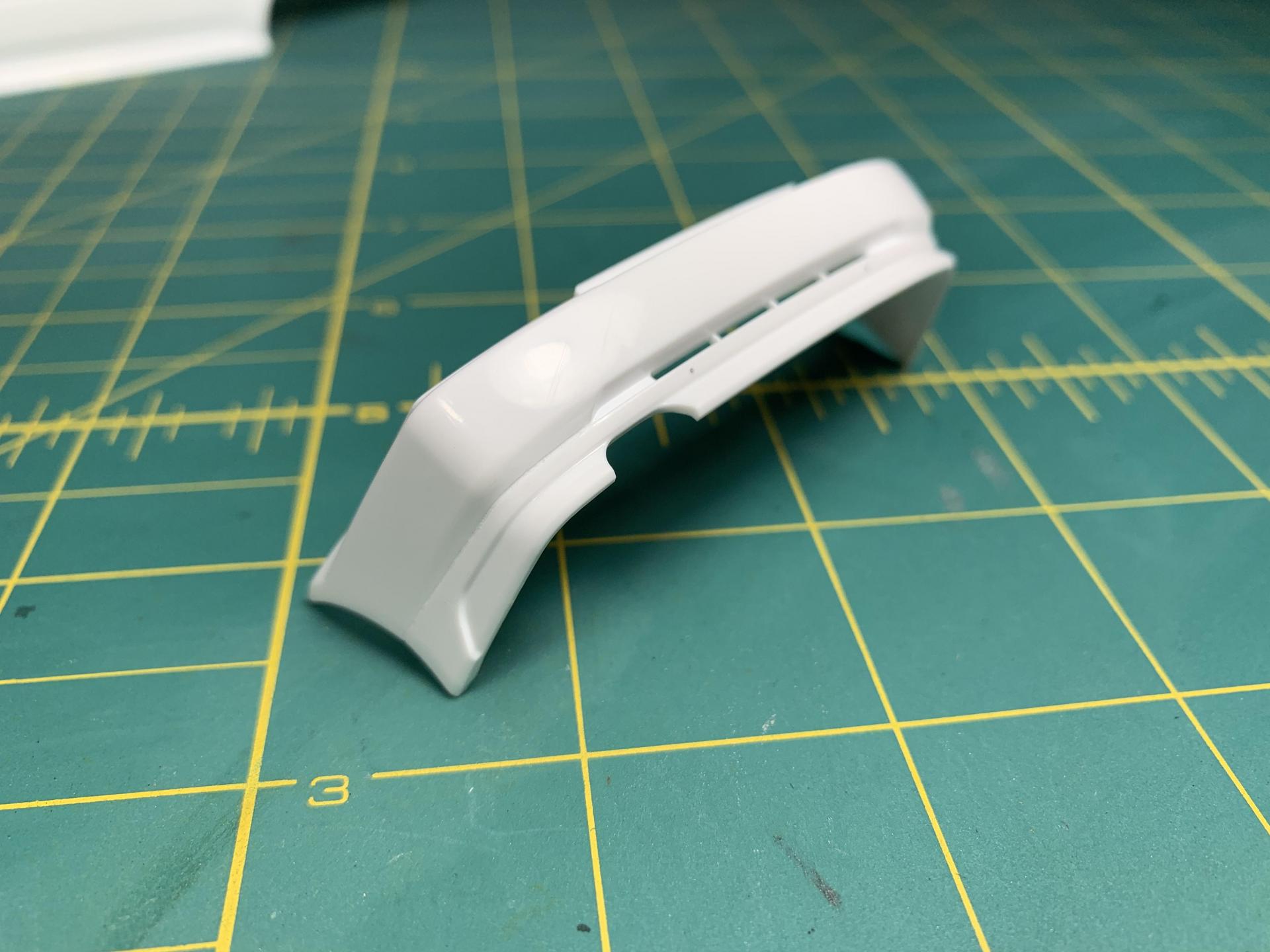

I am very impressed with the quality of the resin front bumper and wheels. Not very much work had to go into the front bumper to get it ready to be mounted on the car. I did so using some 5 min epoxy after completing all necessary body work.

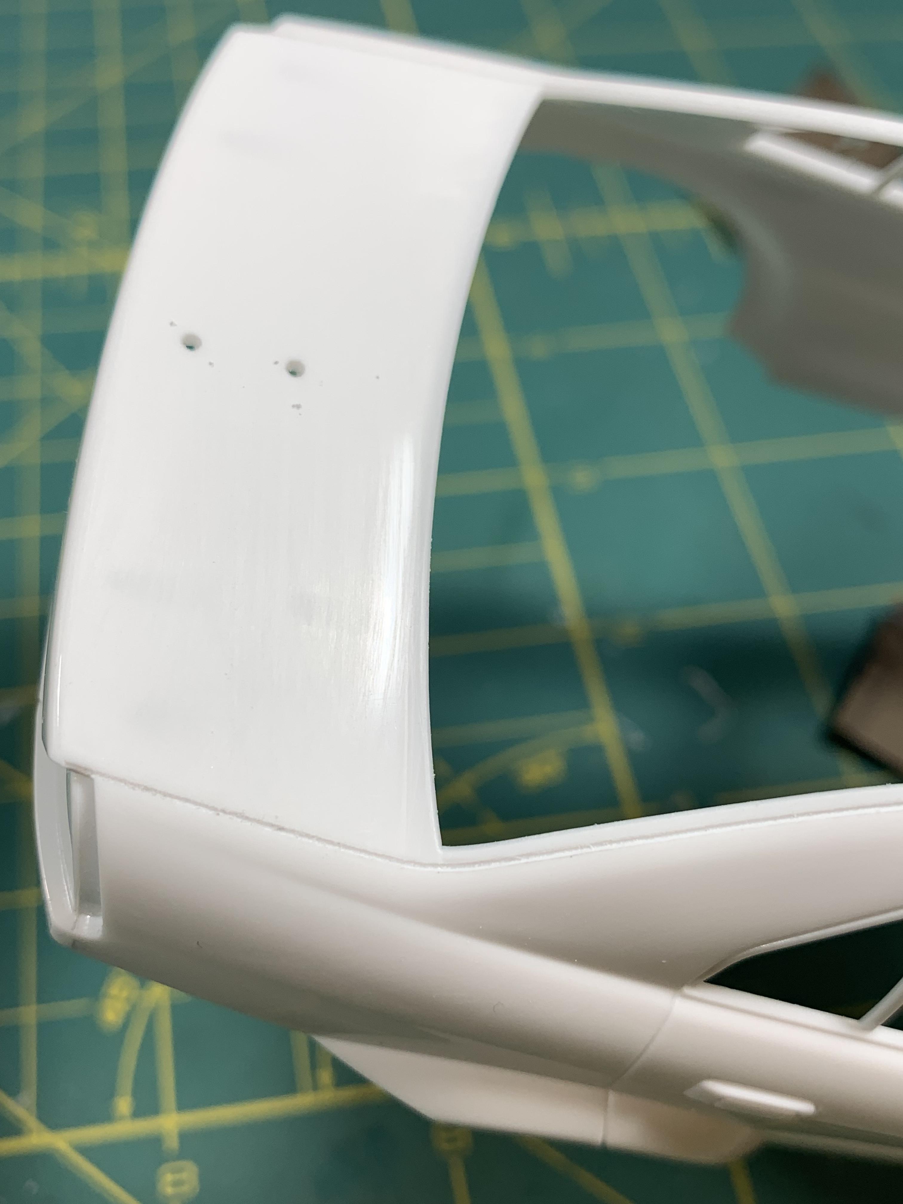

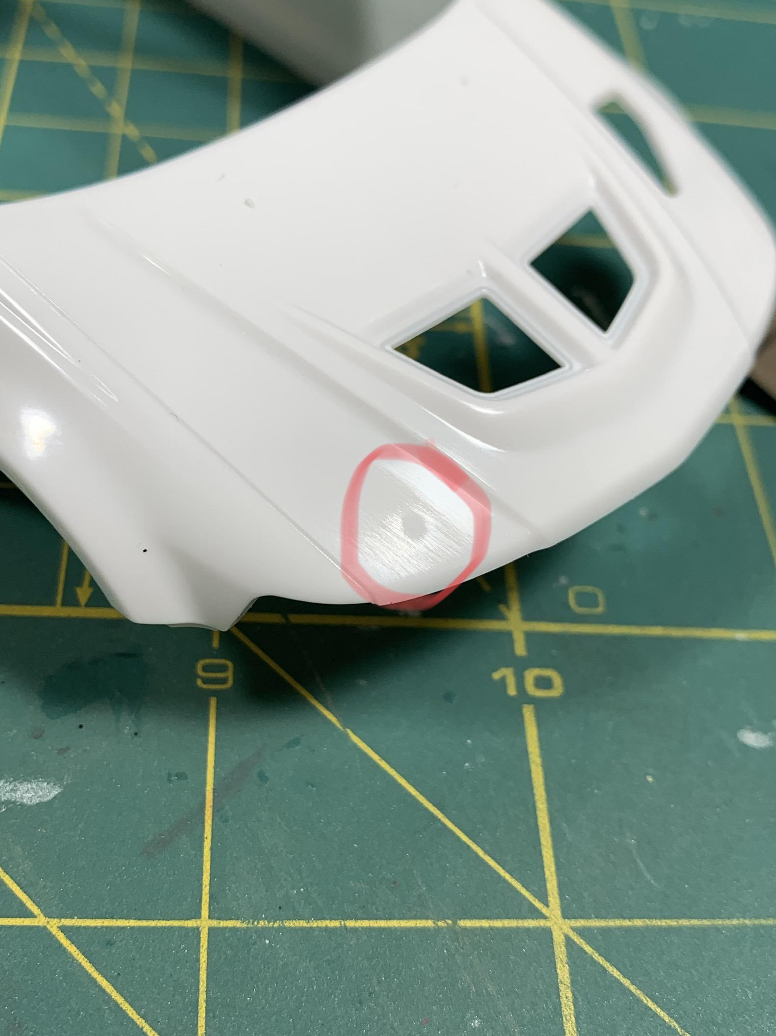

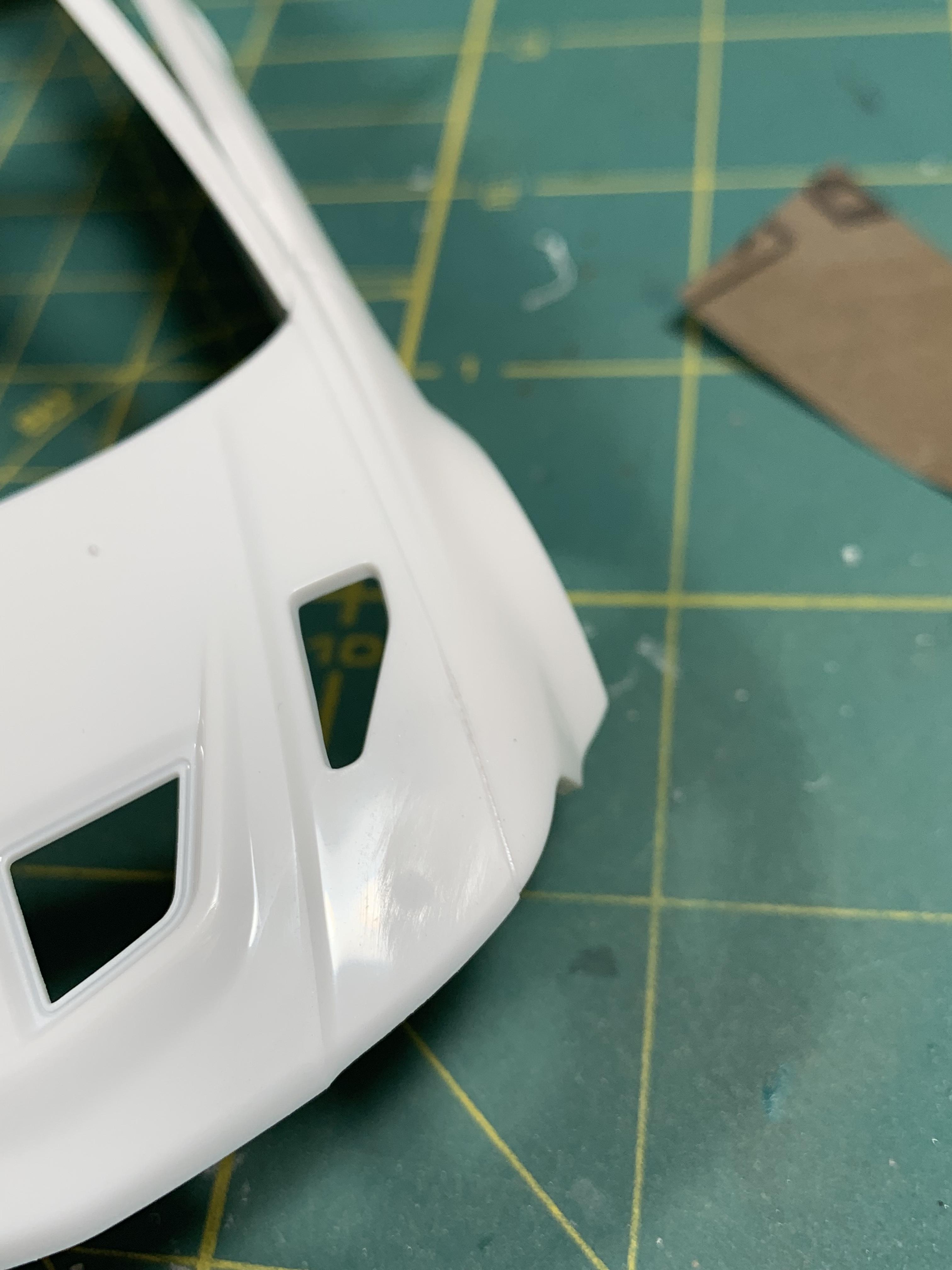

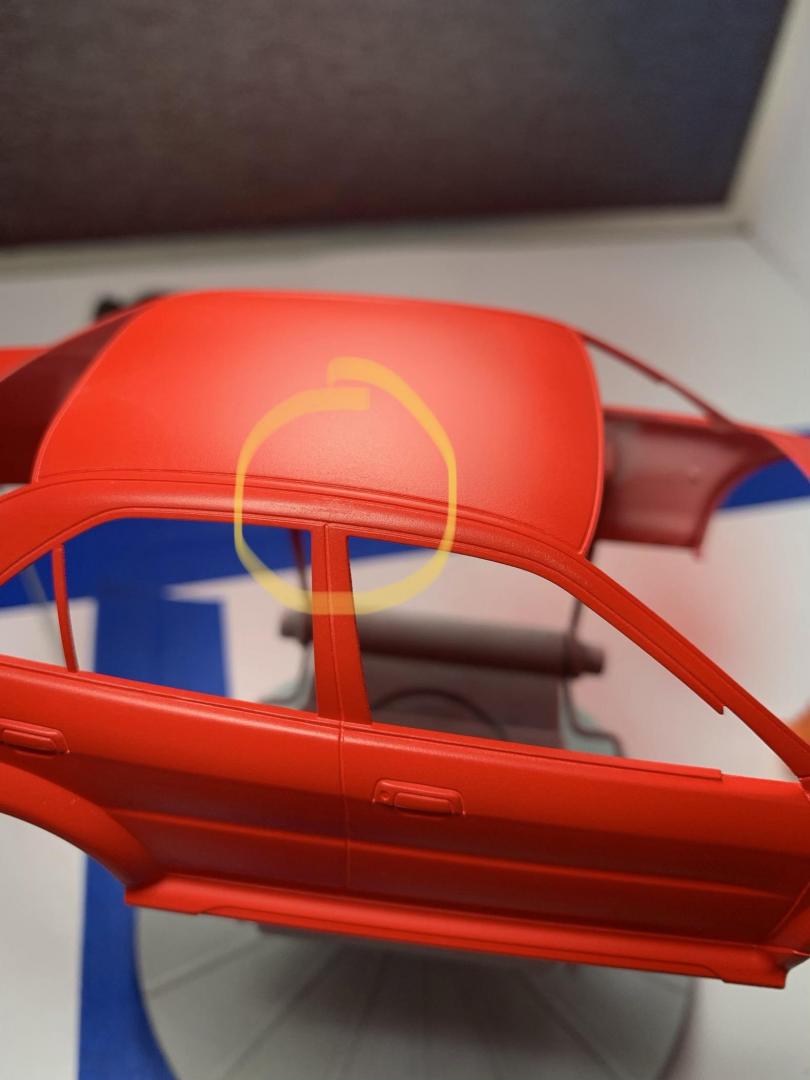

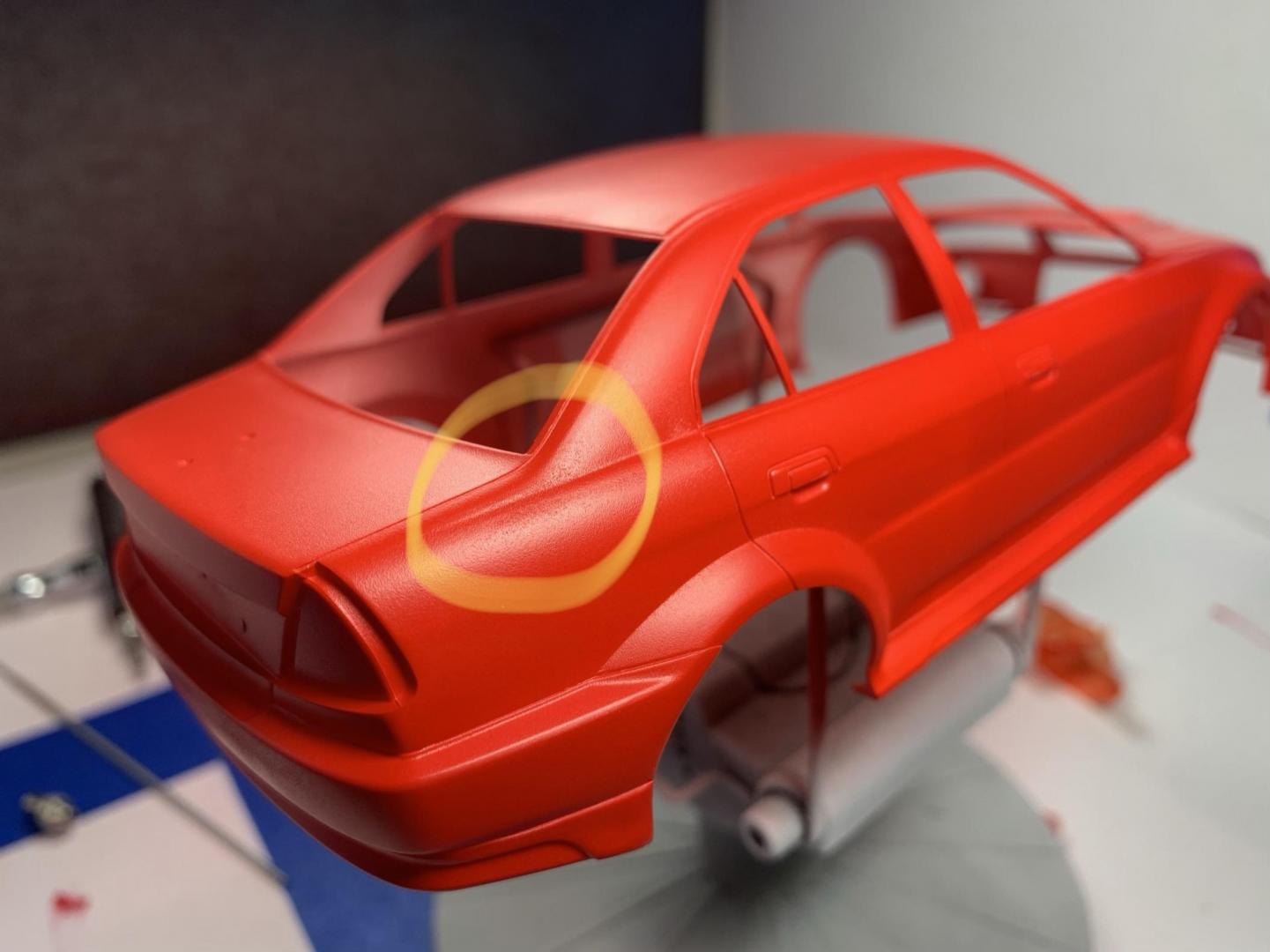

I also sanded out all of the high spots cause from molded dimples on the inside of the kit on the trunk, roof, and hood (as seen circled in red) and went over all of the panel lines with my scribing tool.
I Hope for this to be a nice easy build as with all Tamiya kits.

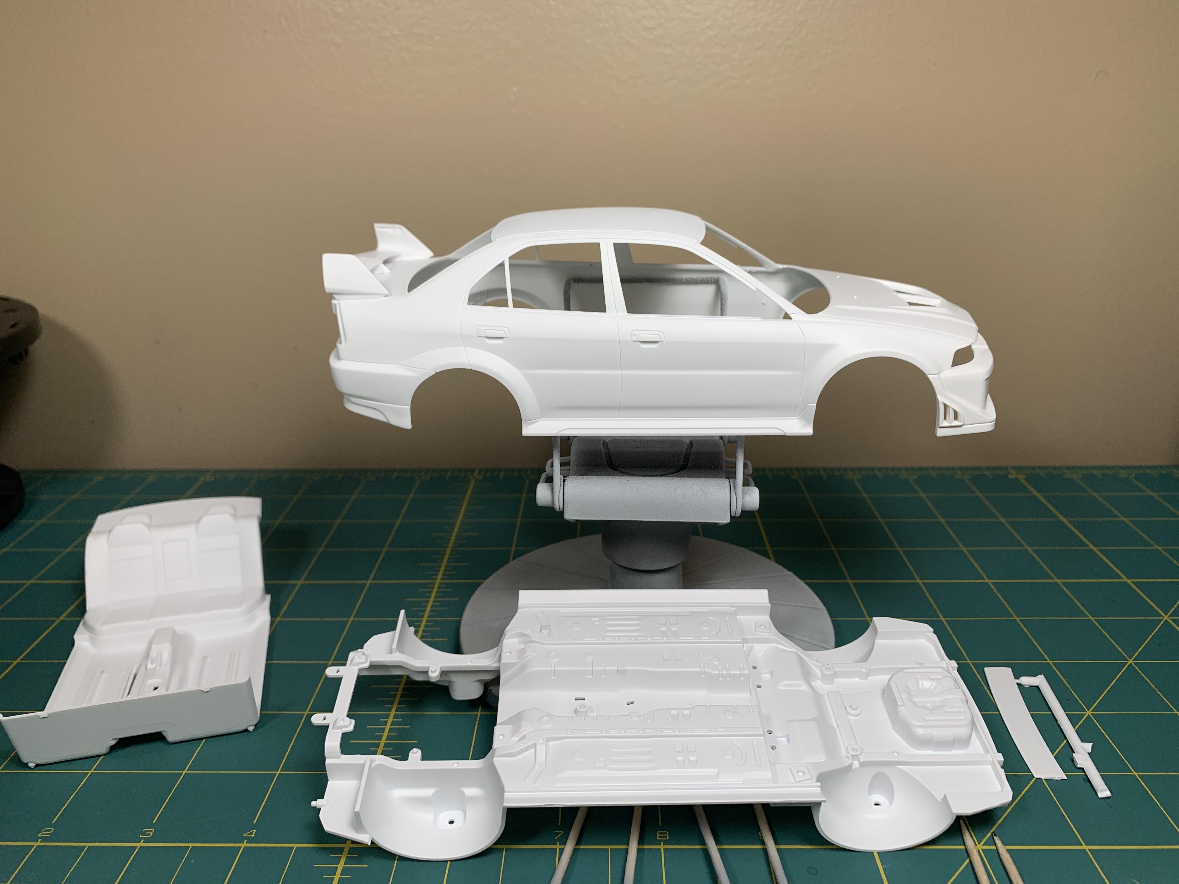

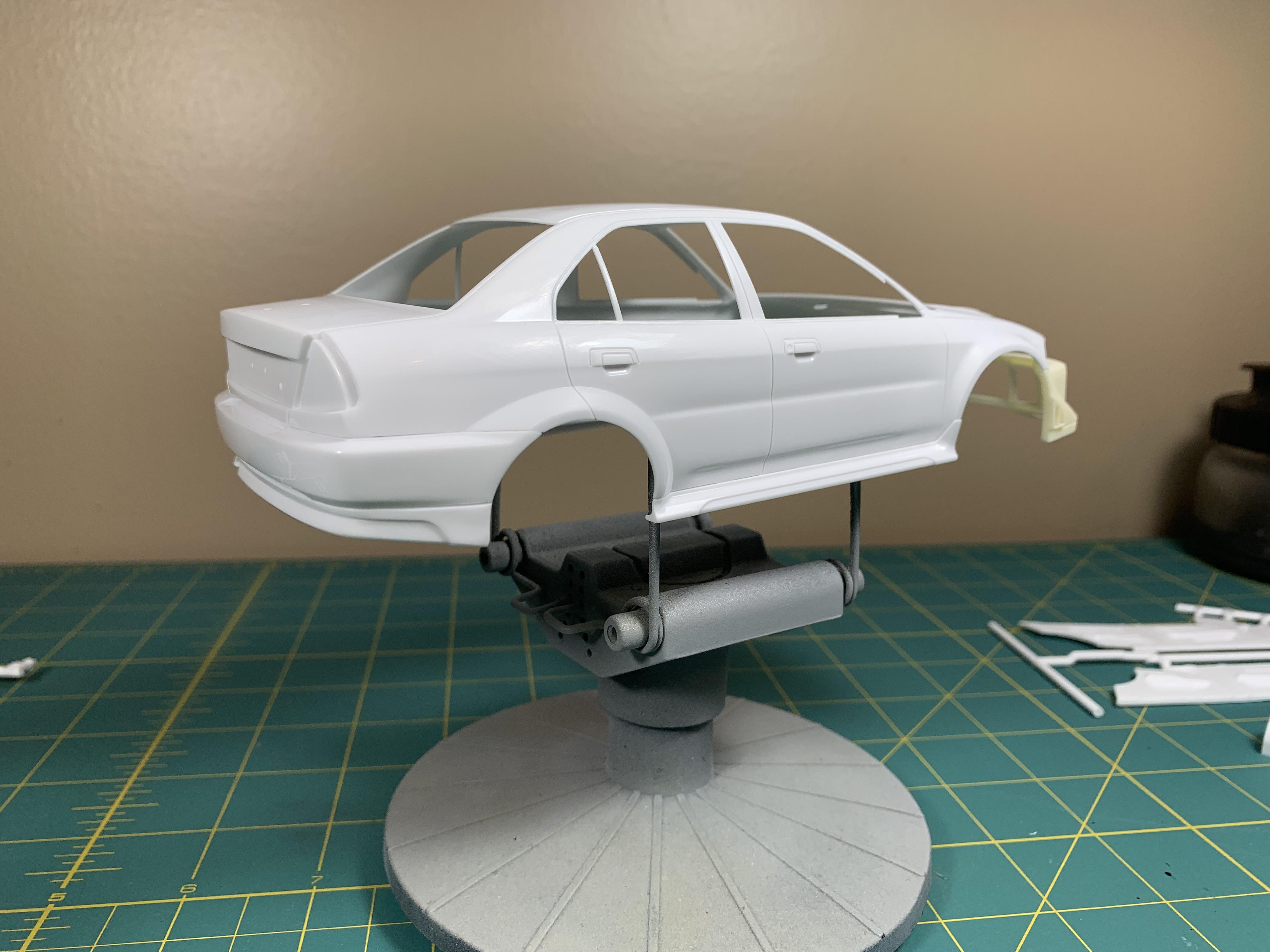

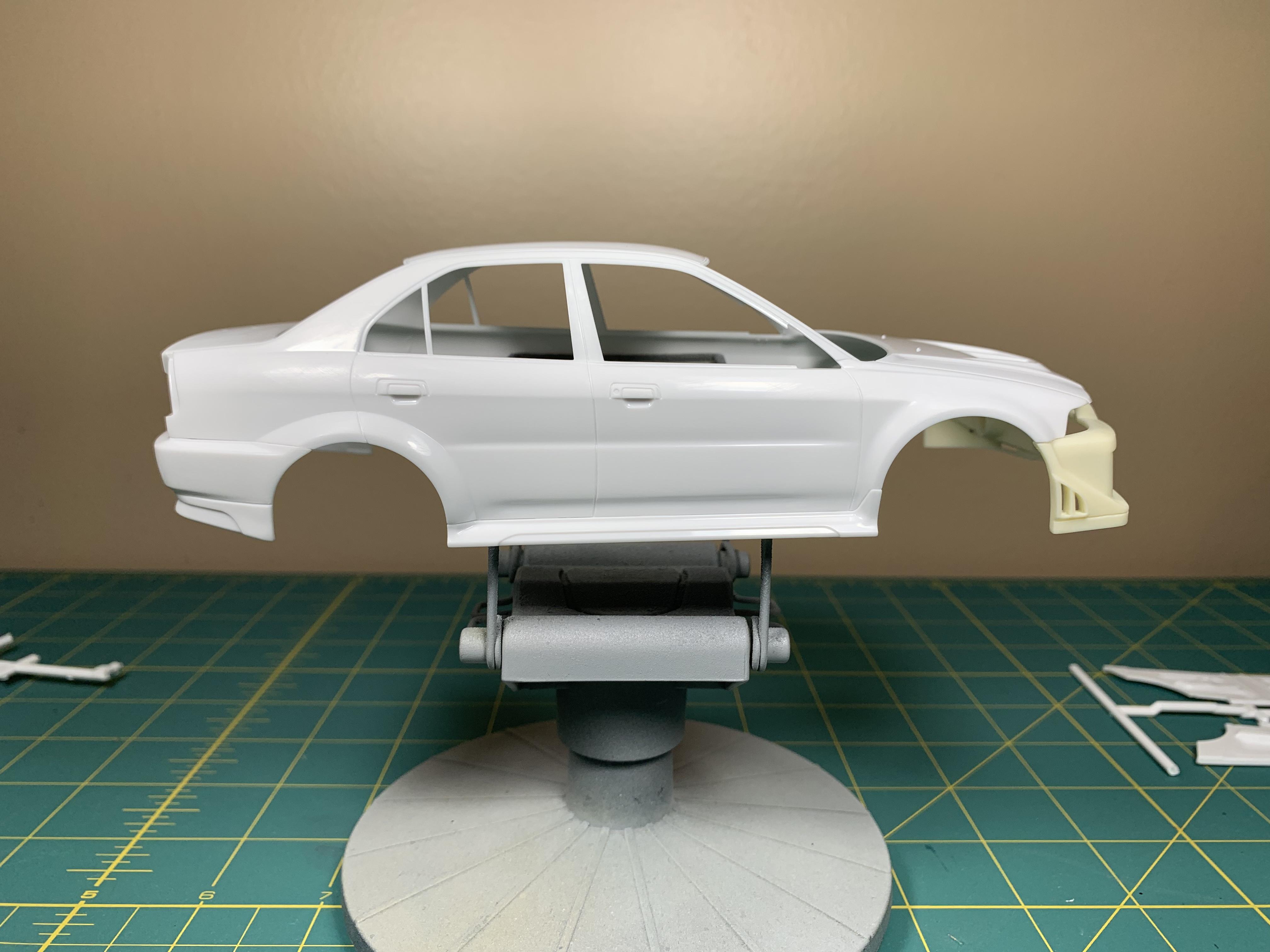

I managed to get a good bit more completed this afternoon/evening.

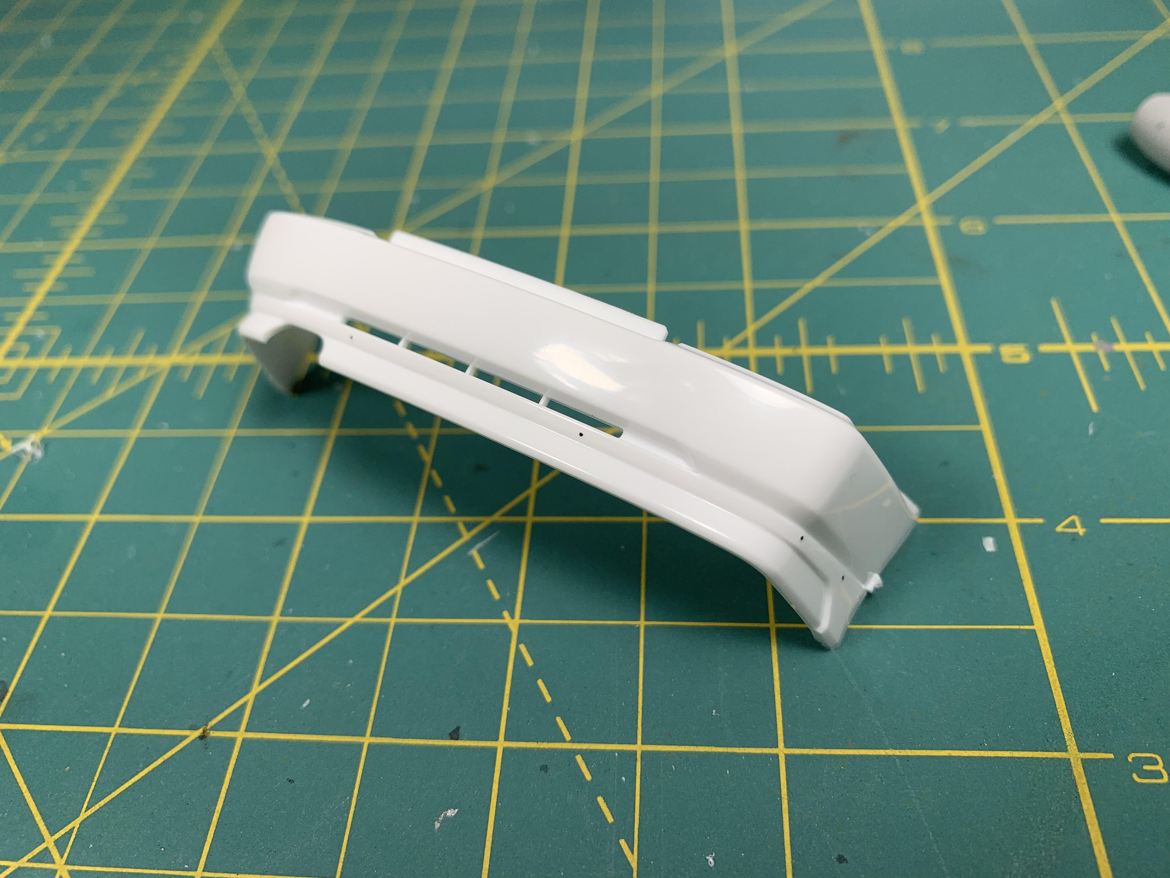

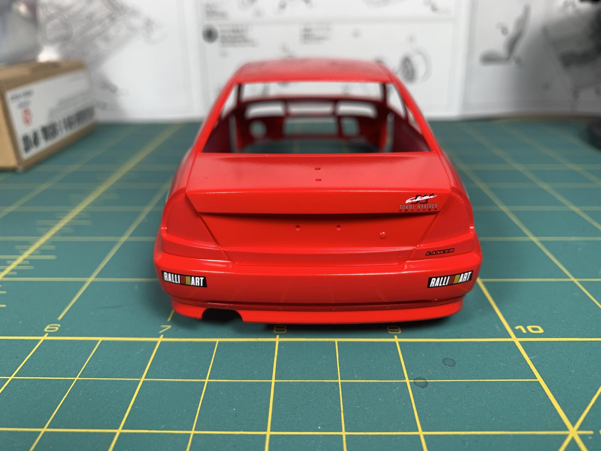

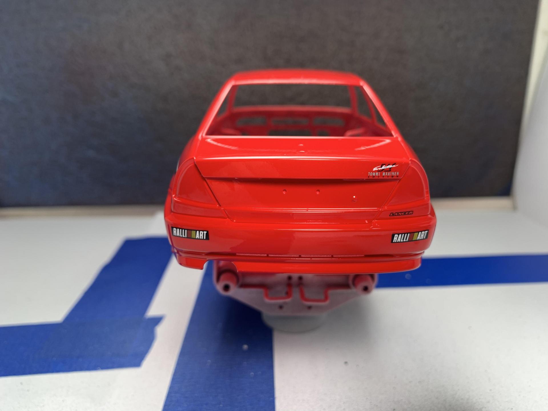

The rear bumper has molded bolts that I have marked with a Sharpie. These must be sanded off as the TME car doesn’t have these.

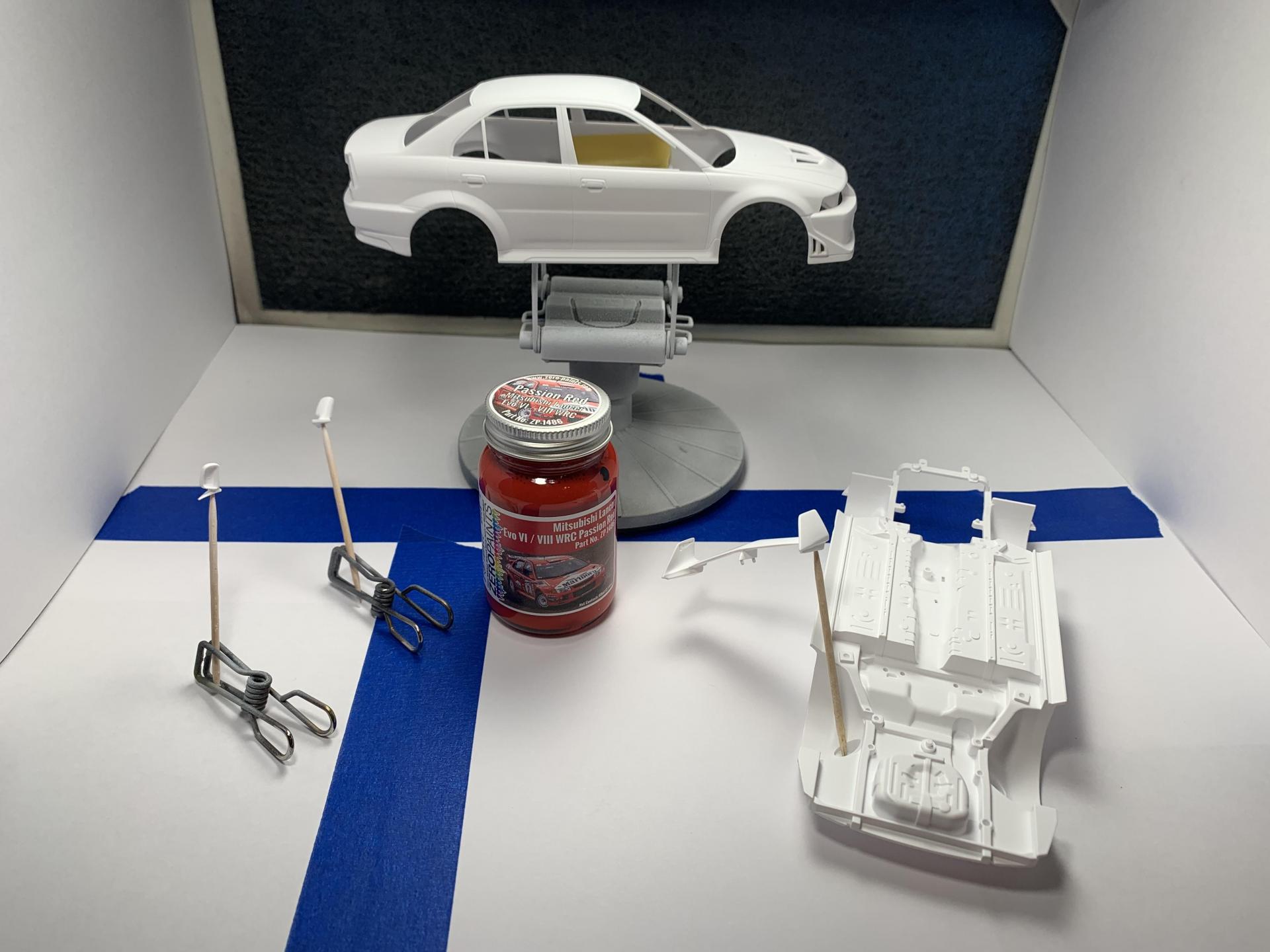

I also got the body/chassis/wing primed in white since the color will need a light base coat.   I primed everything else as well in grey primer.
I have a little work/sanding to do on the resin bumper that didn’t show up without primer. So, I’ll have to do that and prime it once more before I can lay down some color.

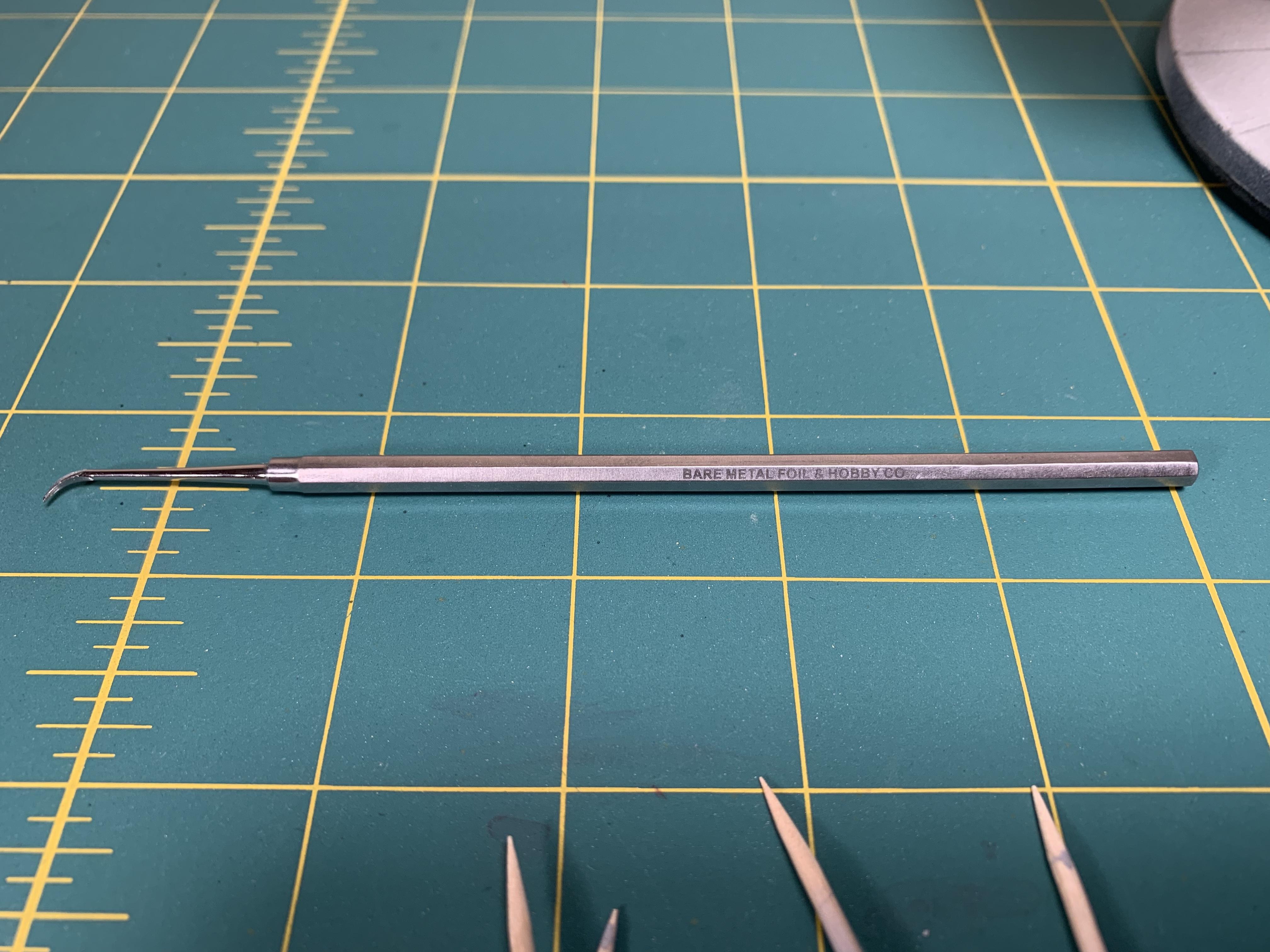

Just because I built this very kit last century, look forward to seeing how this turns out.  Typical Tamiya quality is excellent, other than lacking the engine.  What tool are you using to scribe with?

I use a bare metal foil tool as pictured below.

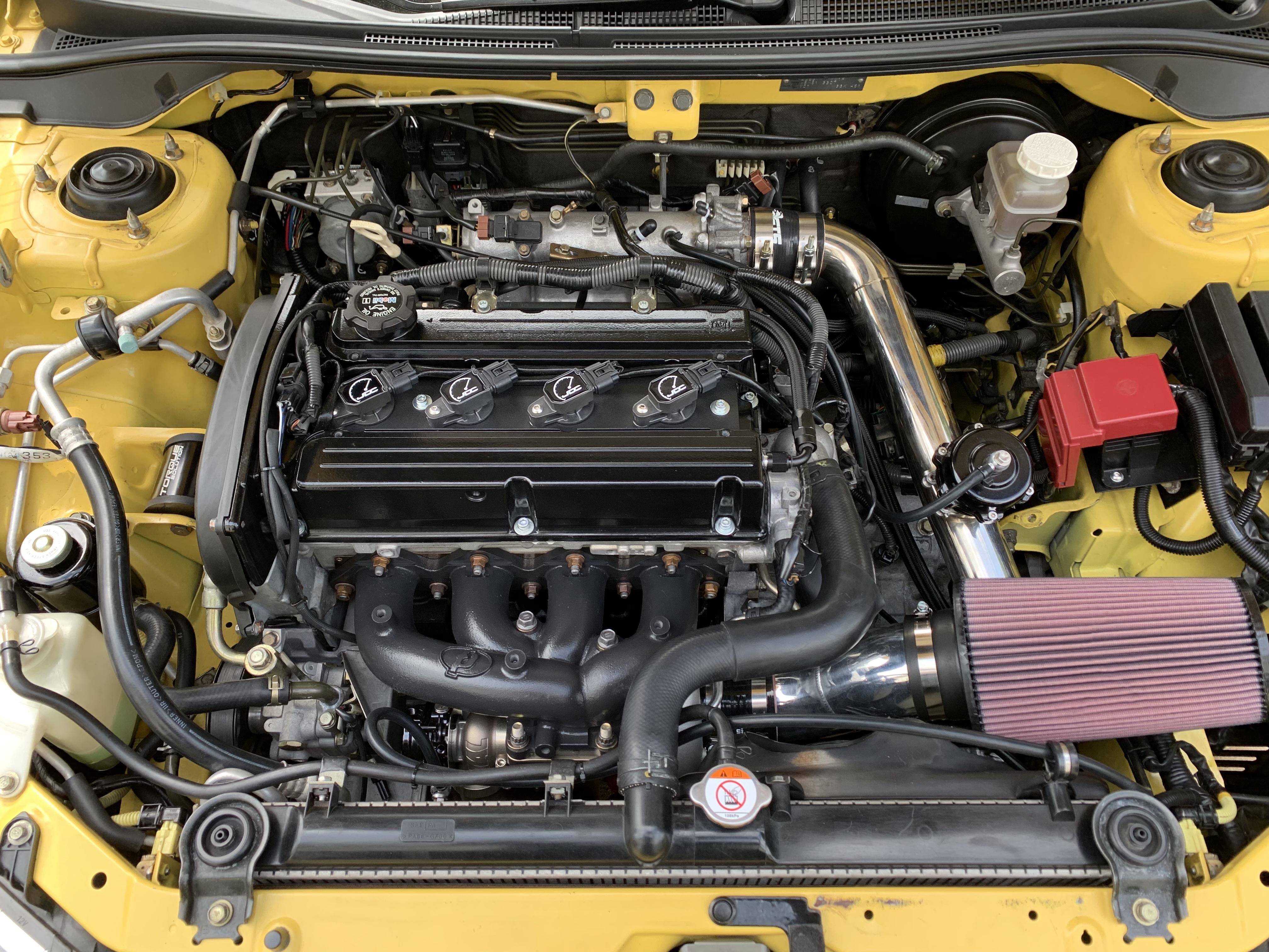

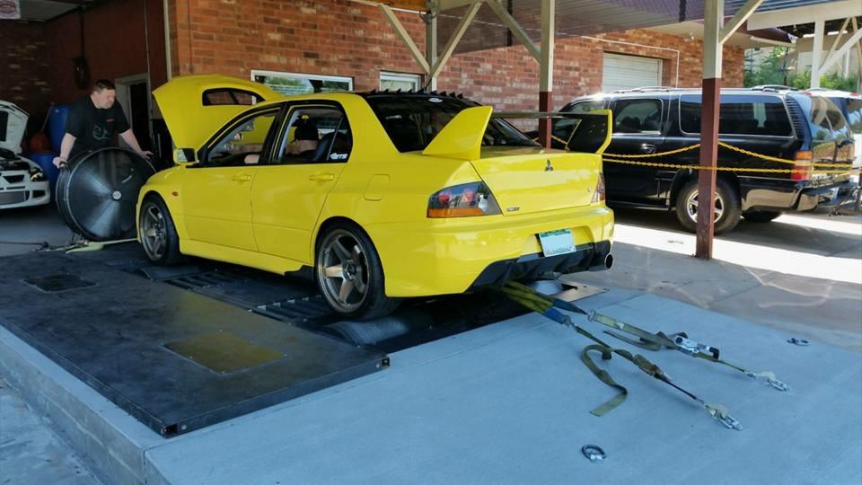

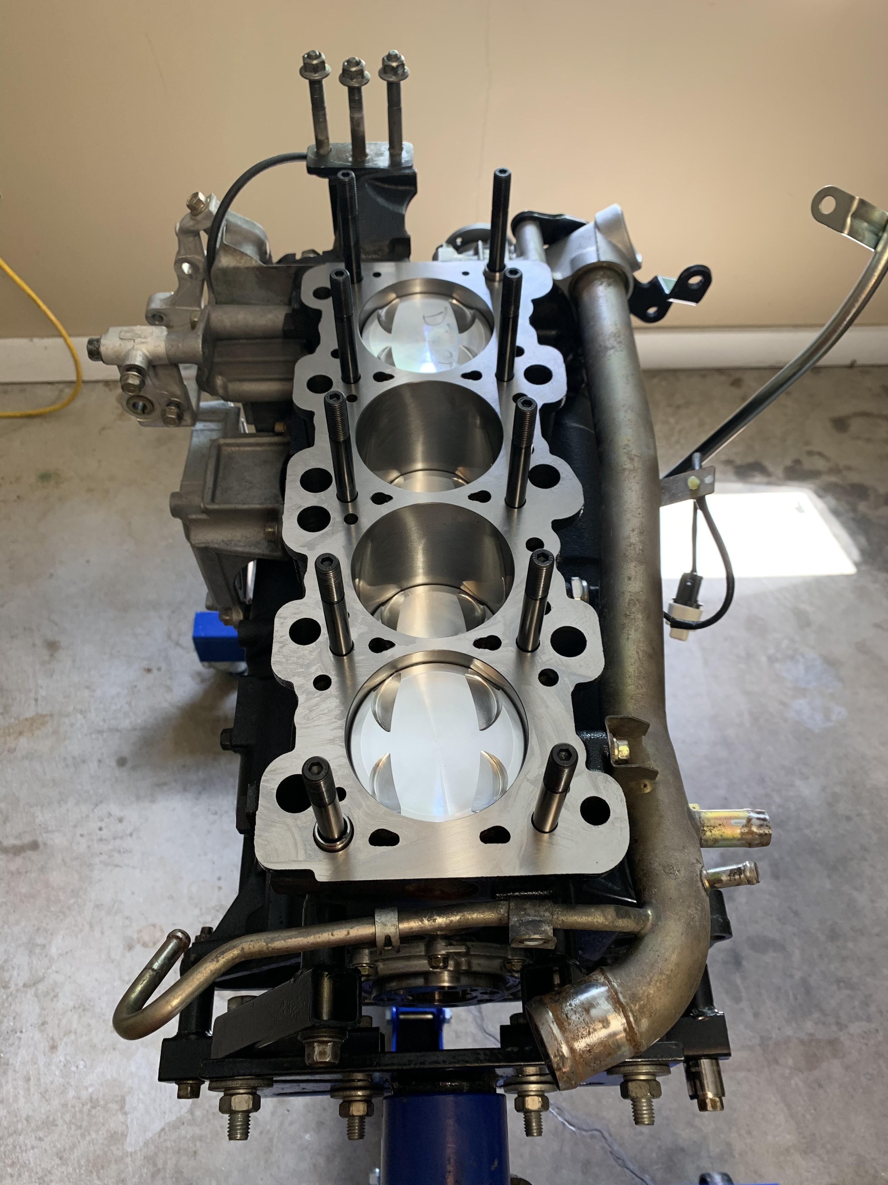

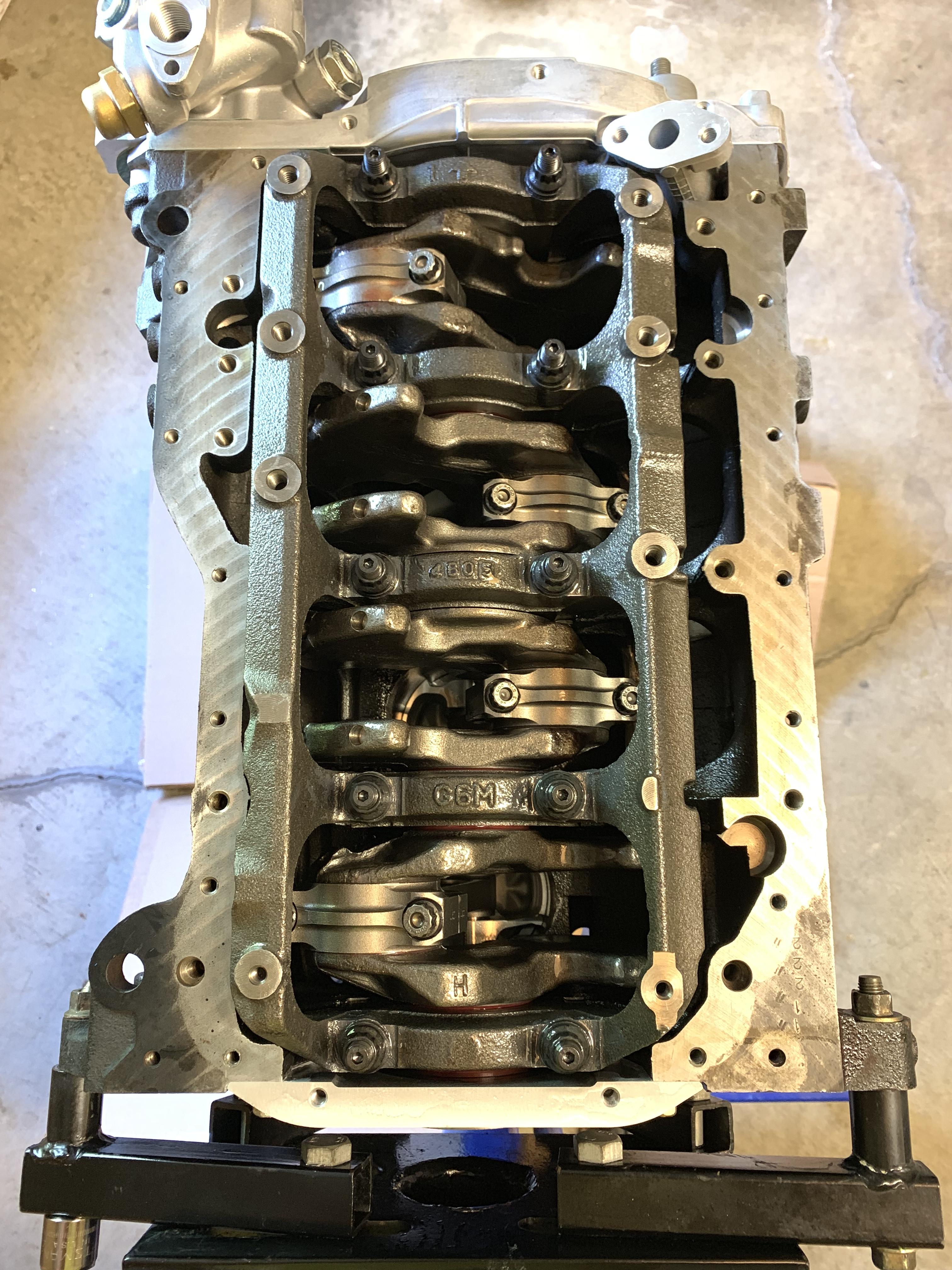

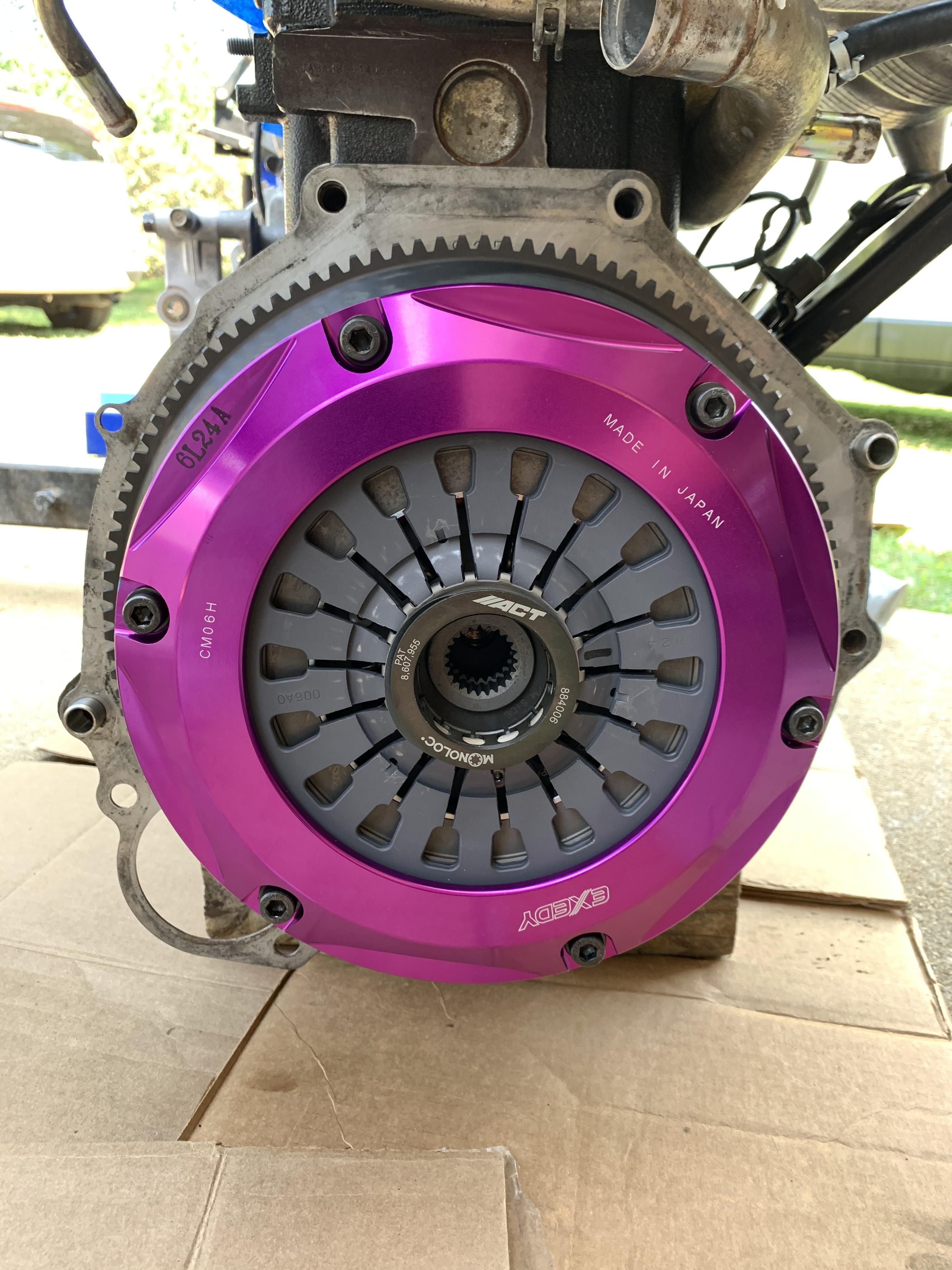

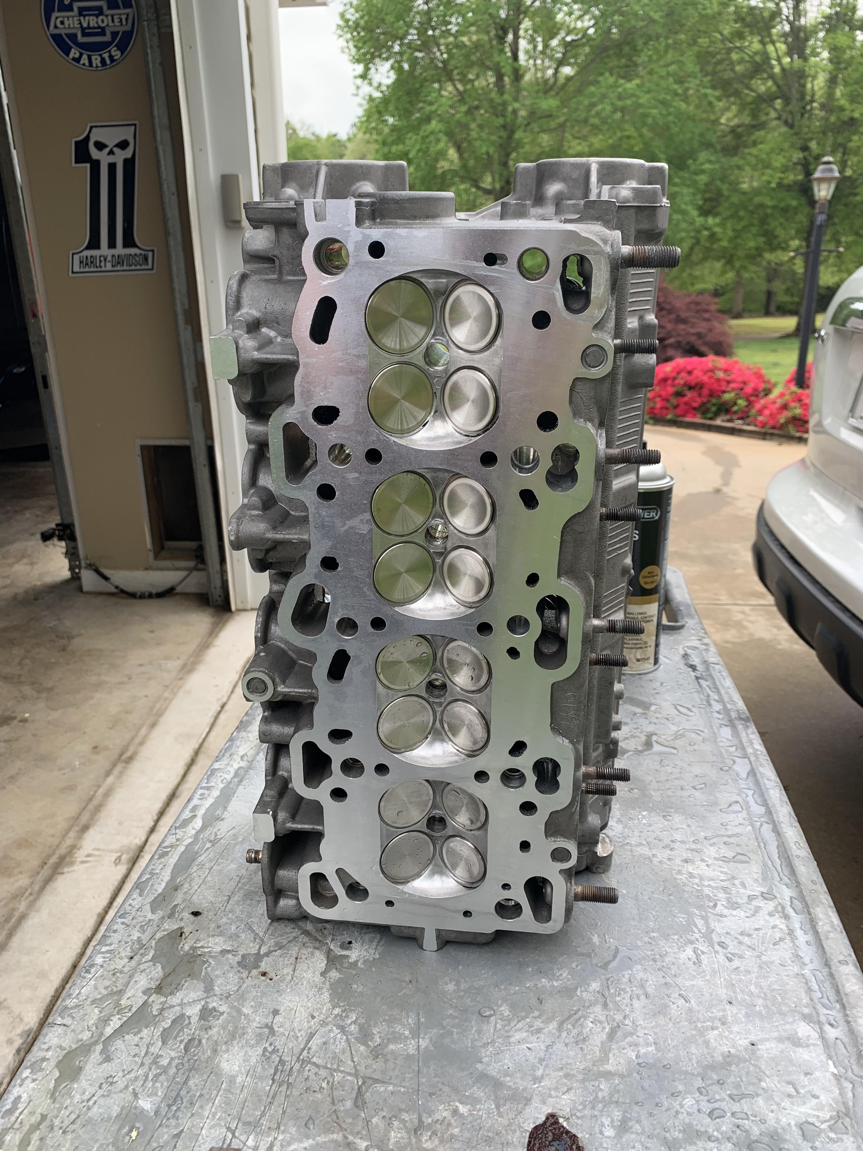

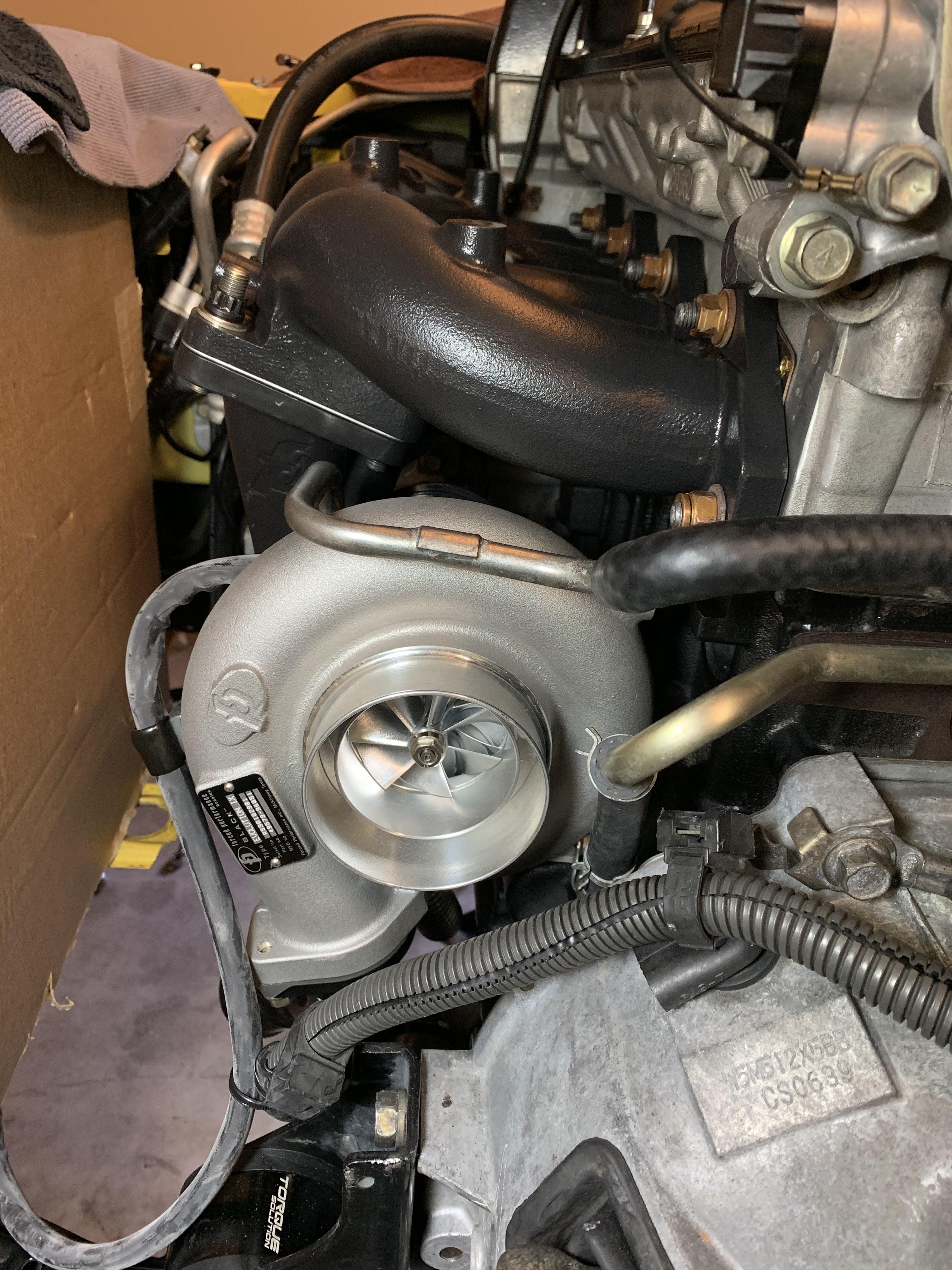

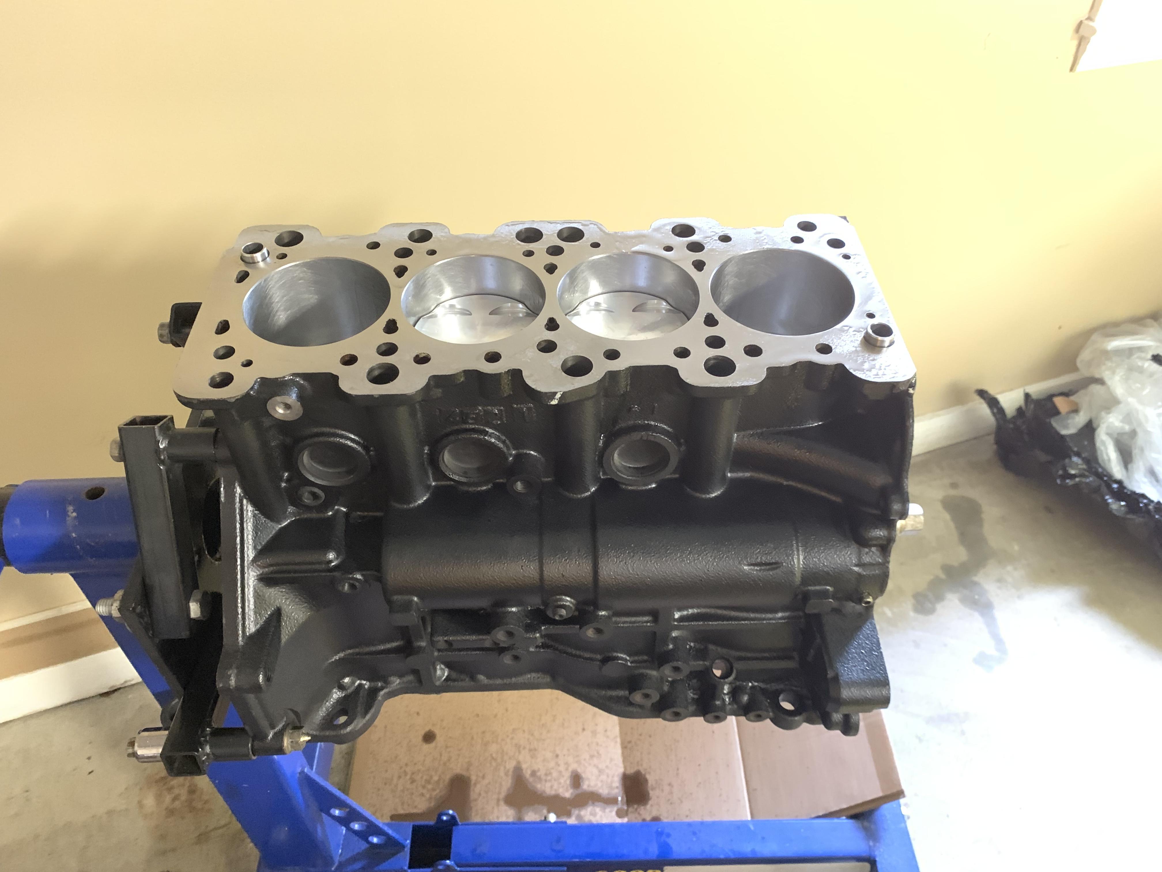

Thanks, I have a soft spot for them as I have an Evo 8 that has been fully built.  That is why I disappeared for a year, lol.  I spent the last year building the engine and getting it sorted out after a rod decided to vent the block. I can't say much, after 10 years of 500hp and 31psi of boost it was time the stock rod gave up, lol.
Now I'm ready to hit the chassis dyno whenever I can get the chance, and get tuned after my new setup. I'm hoping to crack 700hp on some E85.

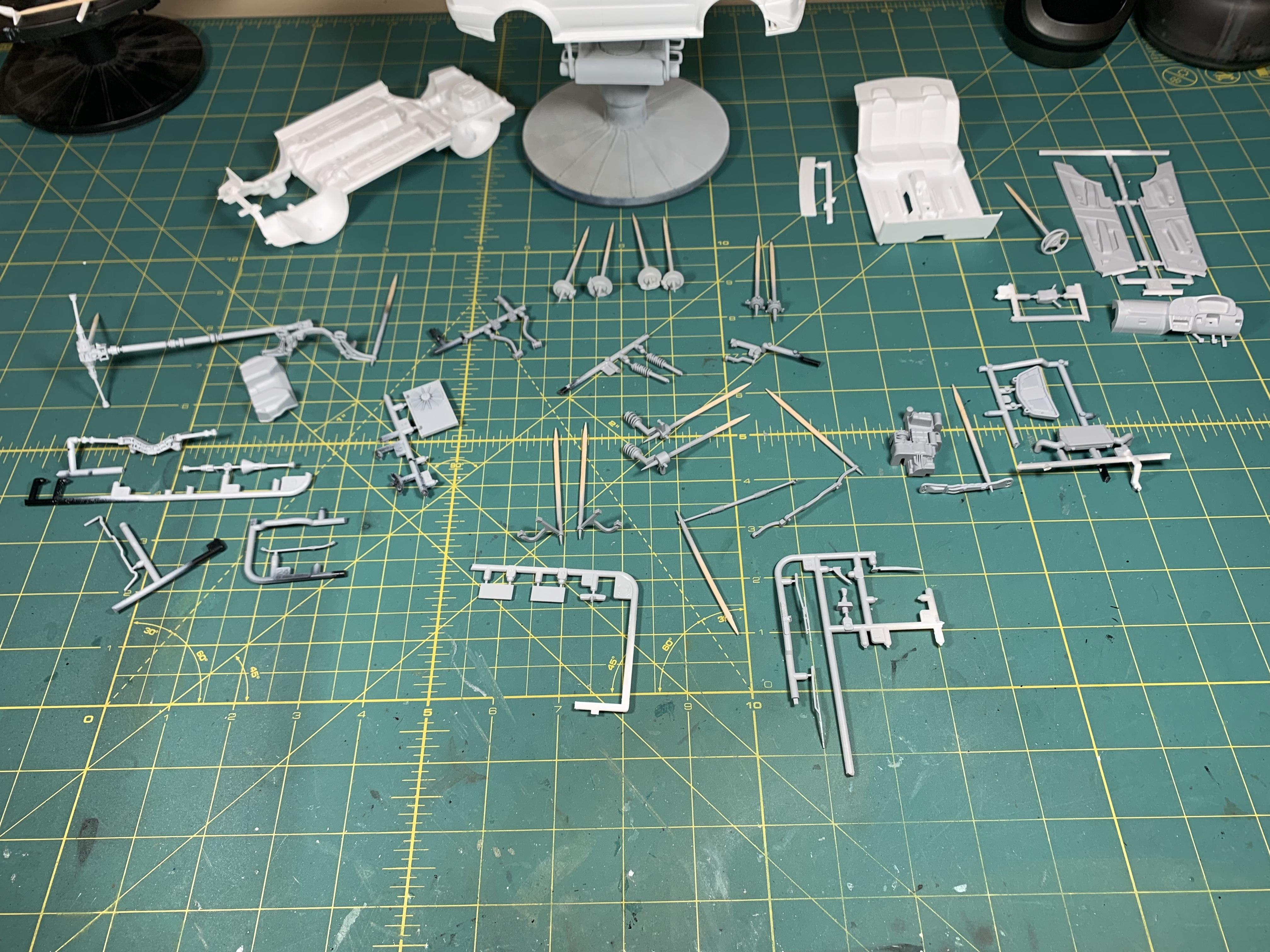

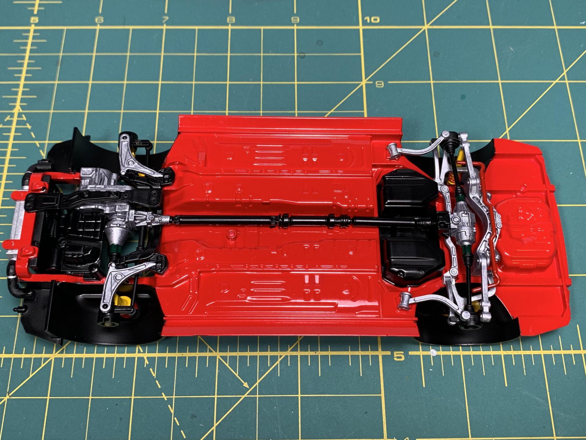

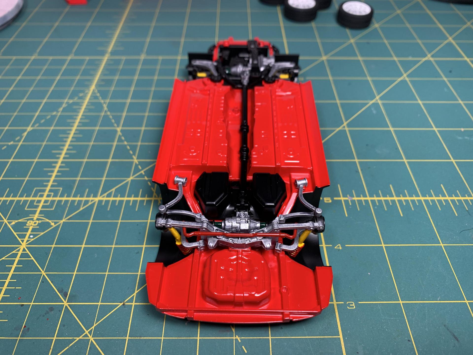

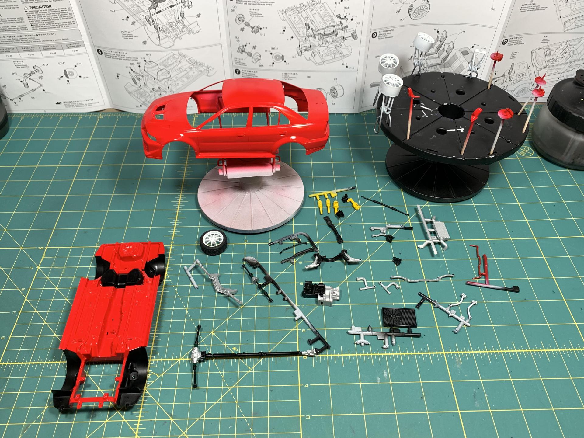

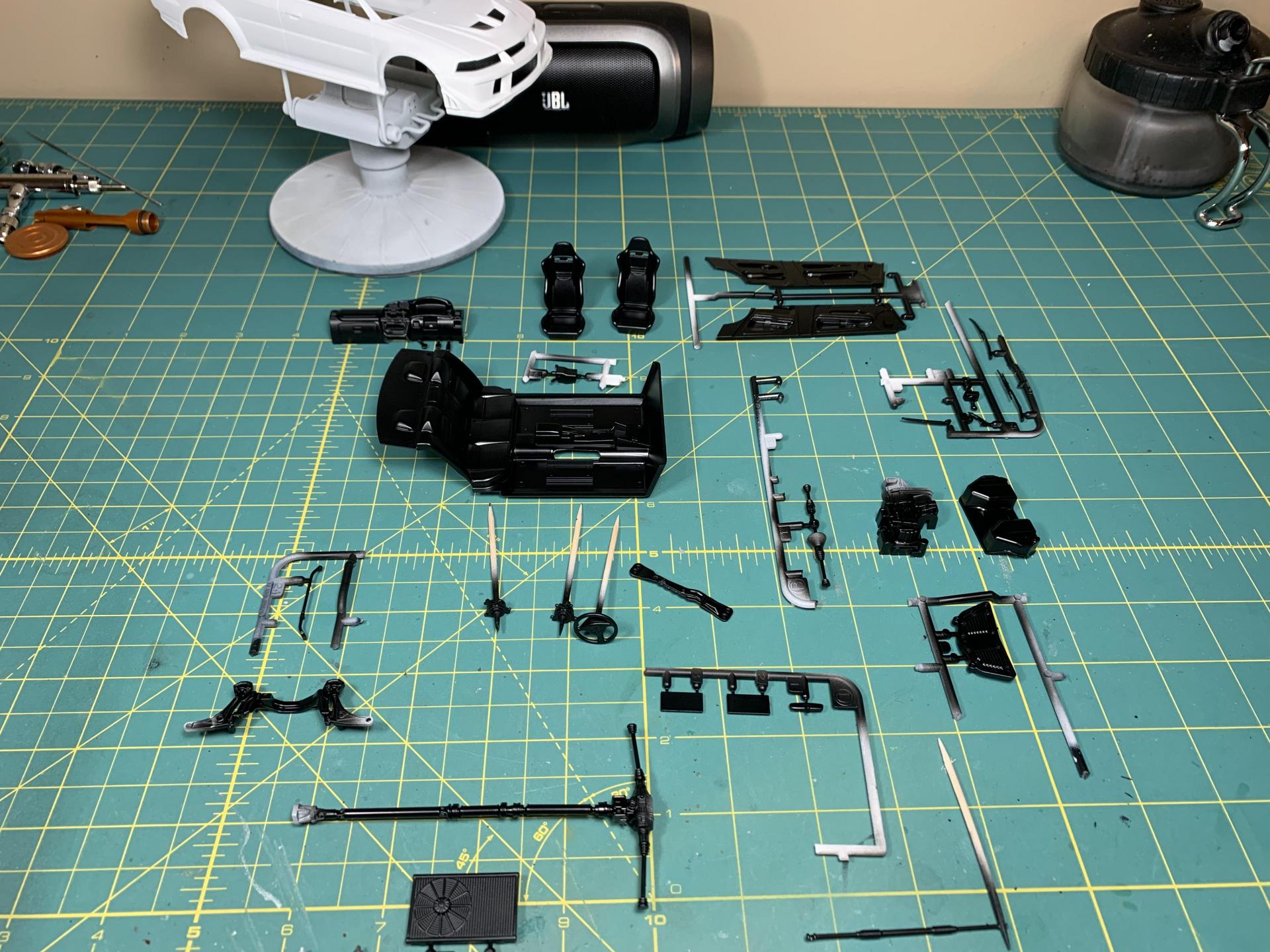

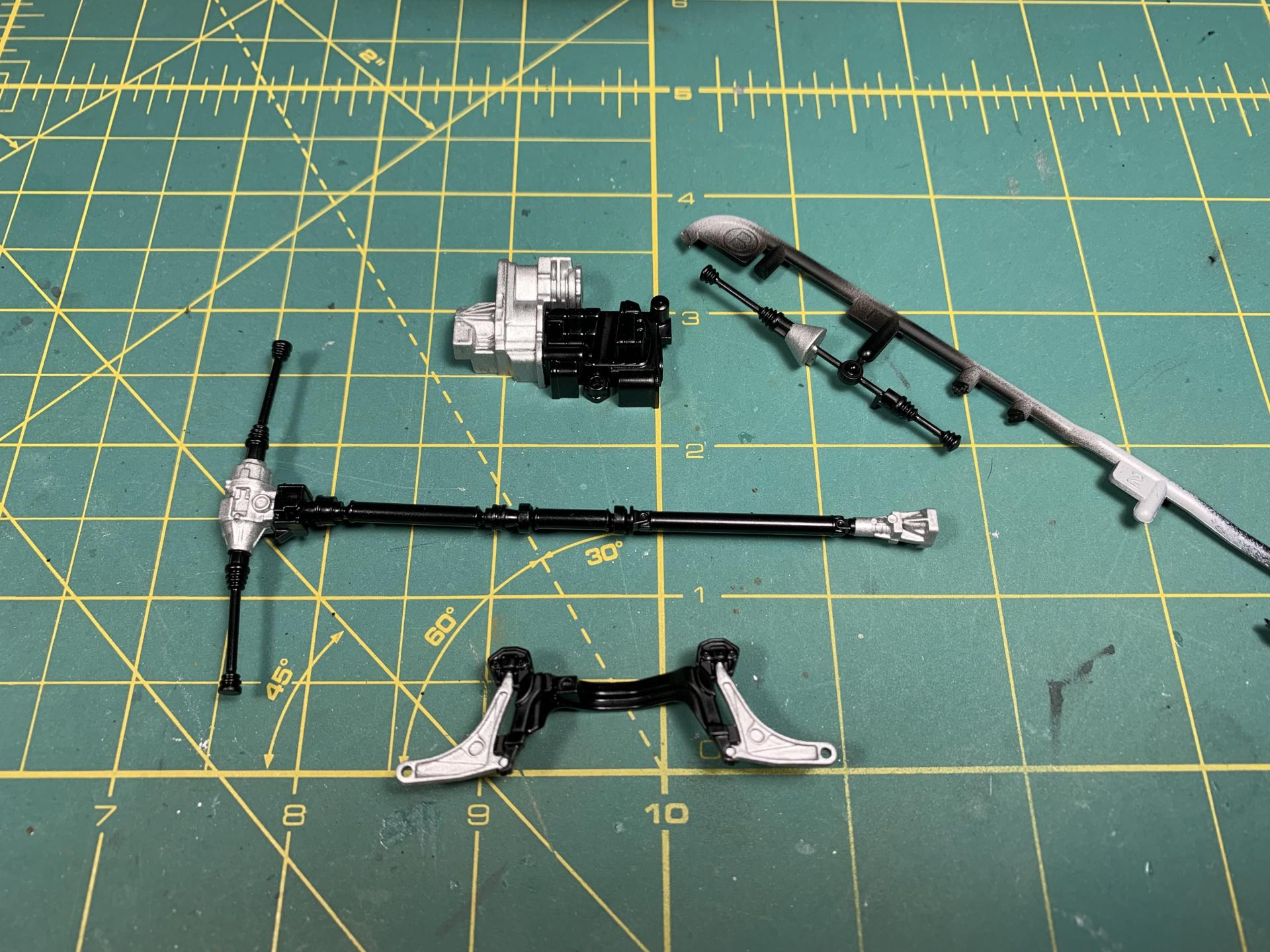

Didn’t get too much exciting stuff done today.  But I did get all the parts that need to be sprayed semi gloss black sprayed today. I also got the rear diff, transfer case, a-arms, and the transmission painted aluminum.
Hoping to get all parts that need to be sprayed aluminum completed tomorrow as well as the suspension sprayed in yellow to replicate some upgraded Bilstein Struts.
