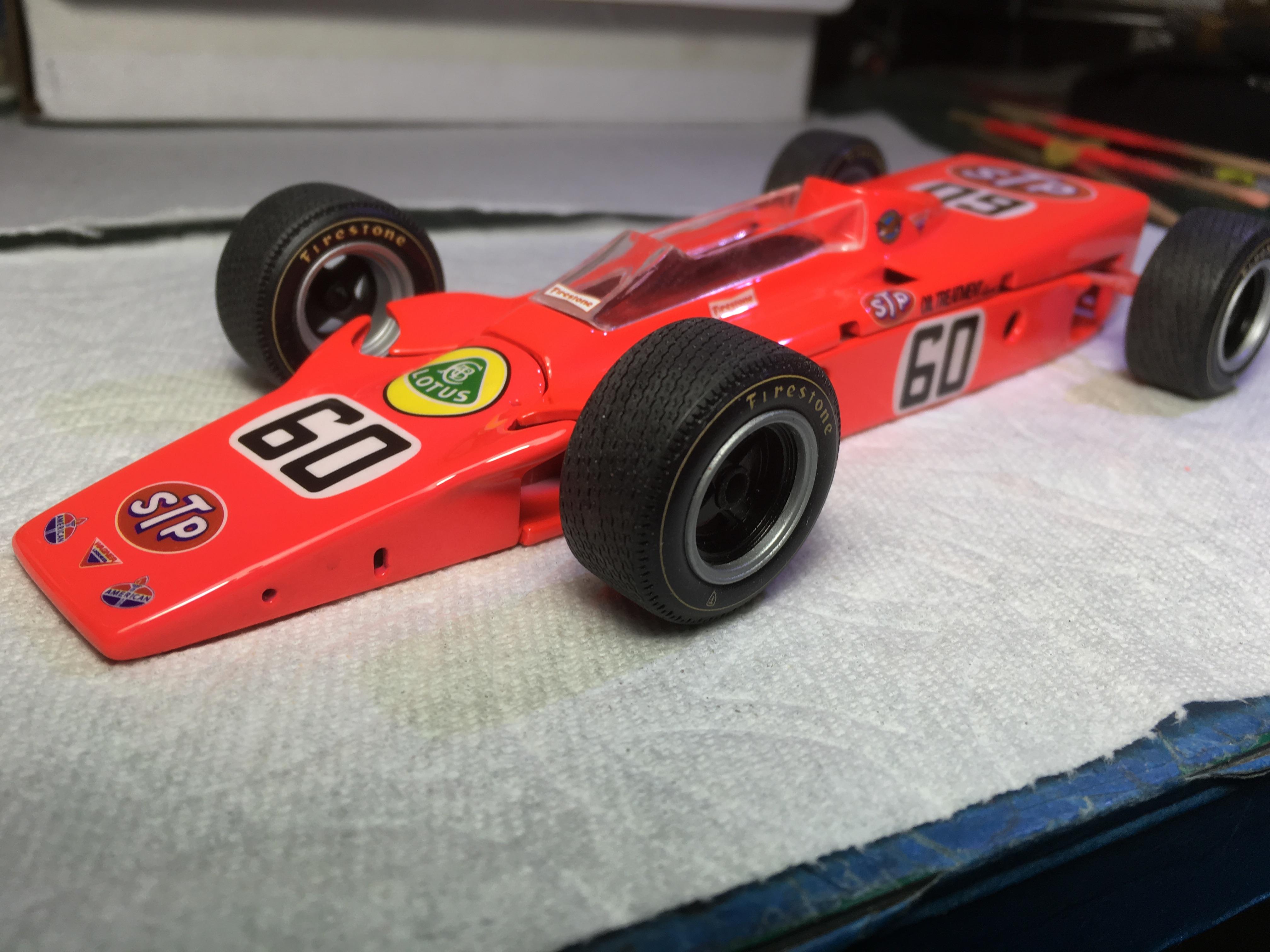

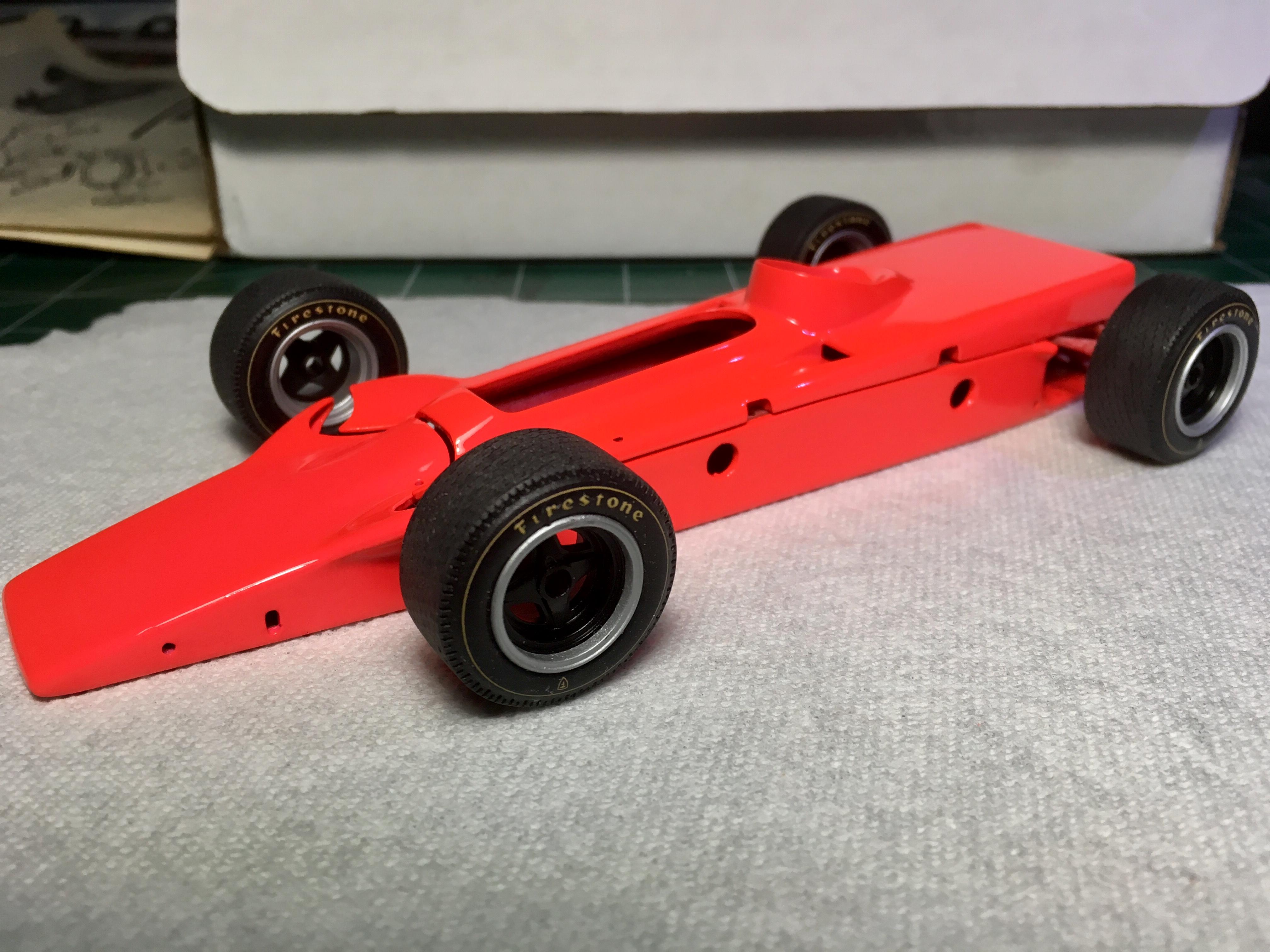

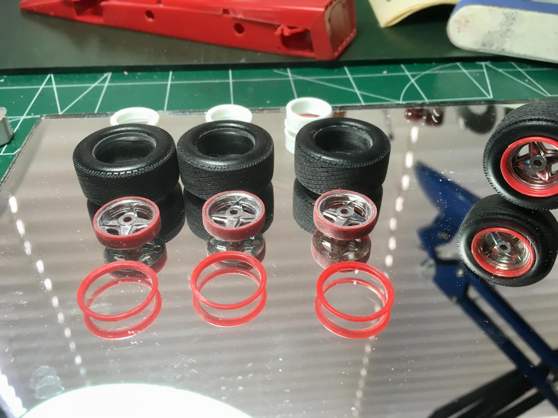

Started other projects but put them aside for this. Mpc kit so it’s a handful for fit. But it’s comming out. Here is what I have so far, hope you like. Indycal tires

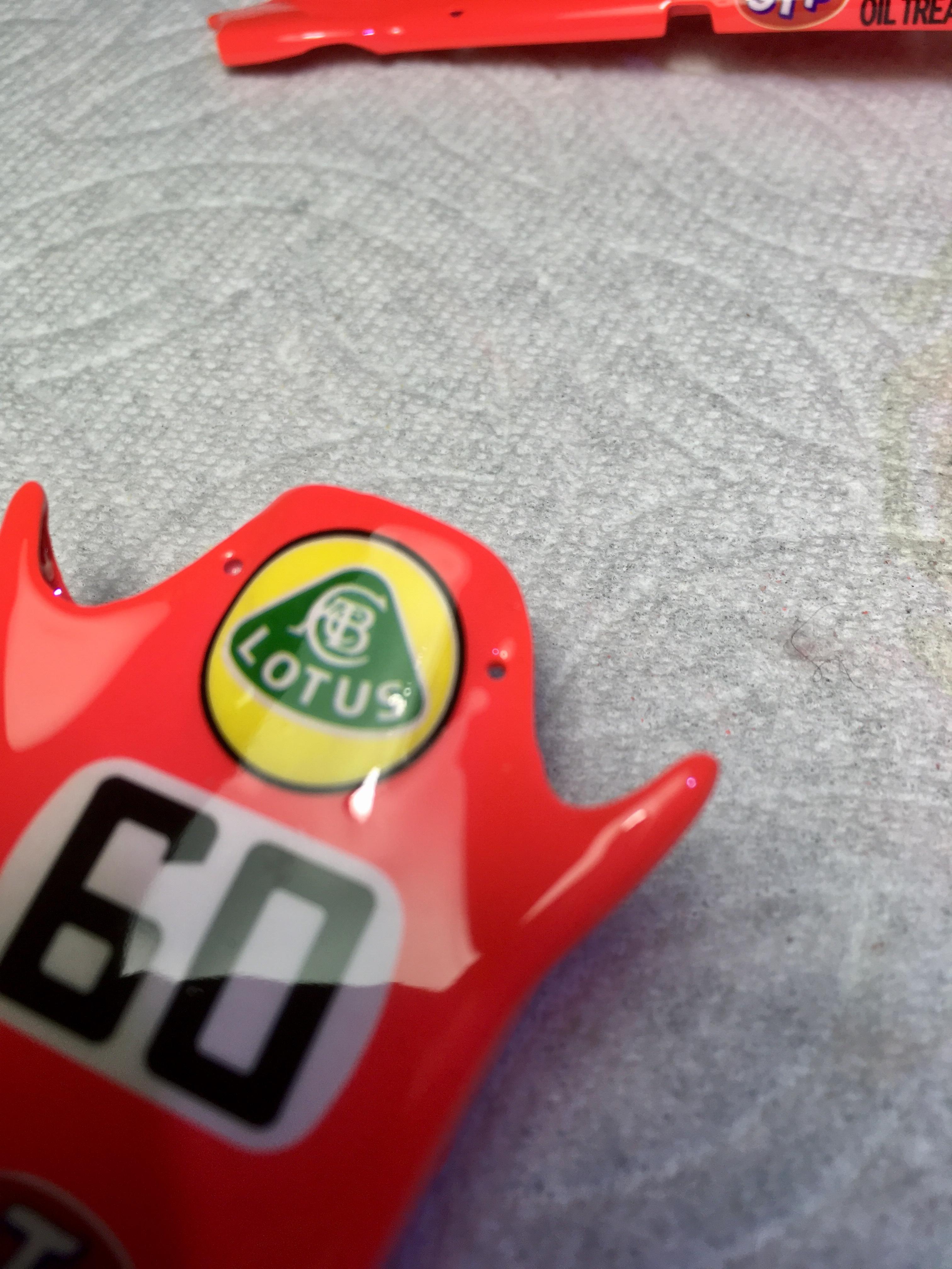

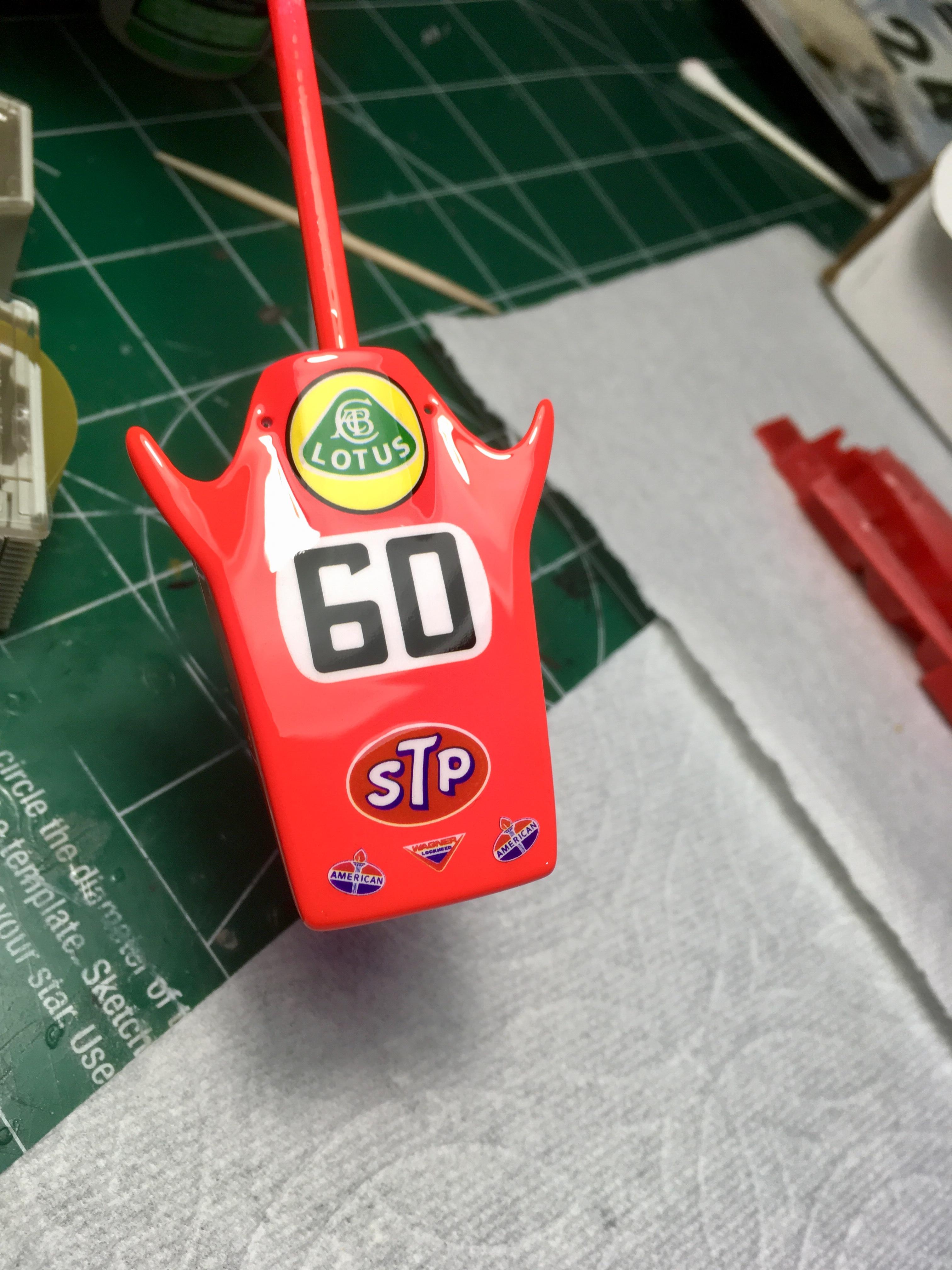

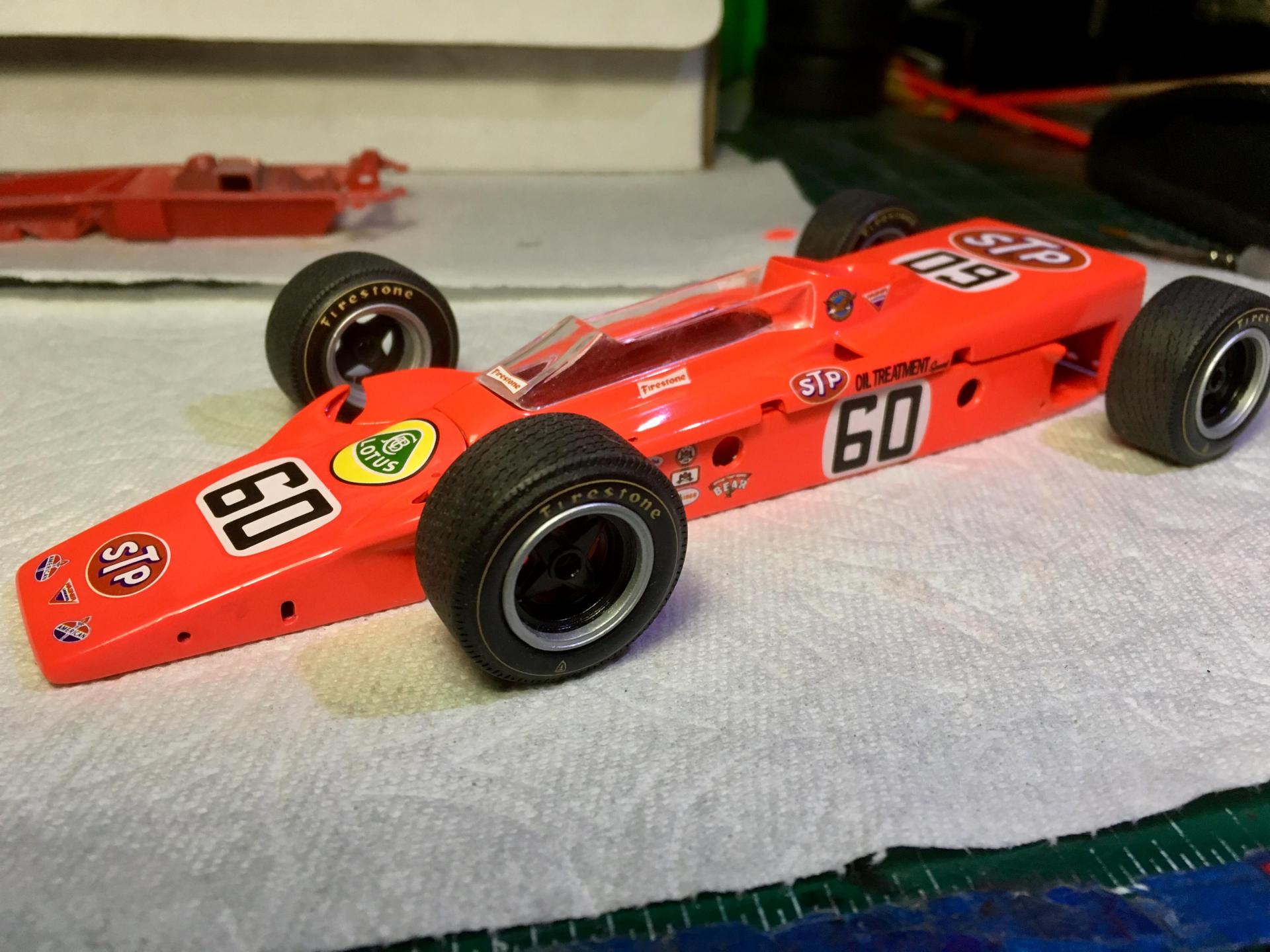

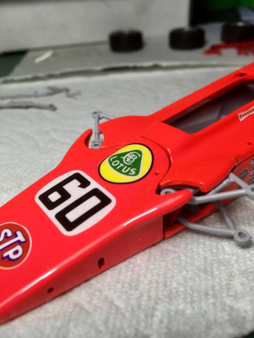

Cleared. The brightest race car I built,  I recommend this kit if you are into Indy cars. The indycal tires and decal set are available and I suggest that you buy them. The kit tires are really bad and the kit decals are really old. Building the Joe Leonard car. A little problem , I’ve changed it , the decals come as the race version. I am building the car pre time trials. The numbers pre time trials are black with white numbers. The race version are white with black numbers. And had a bright green on the rear and left front tire and nose. Sooo I have no choice , since the Indycal decals are race only. Did not want to put green on the car. To me it really looks bad. My version is not decal correct or green paint correct. But nevertheless it is a fun build. B7DCBFB8-142A-41B1-BECF-13C5092CAAD6.thumb.jpeg.a1e8eecffa63dd5747e873d82df1de74.jpeg

I had considered getting that kit because it's such an interesting car, but decided not to.  Will cheer you on!

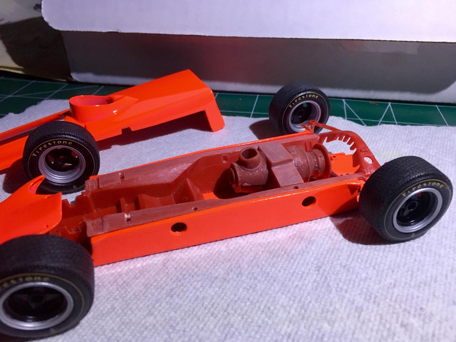

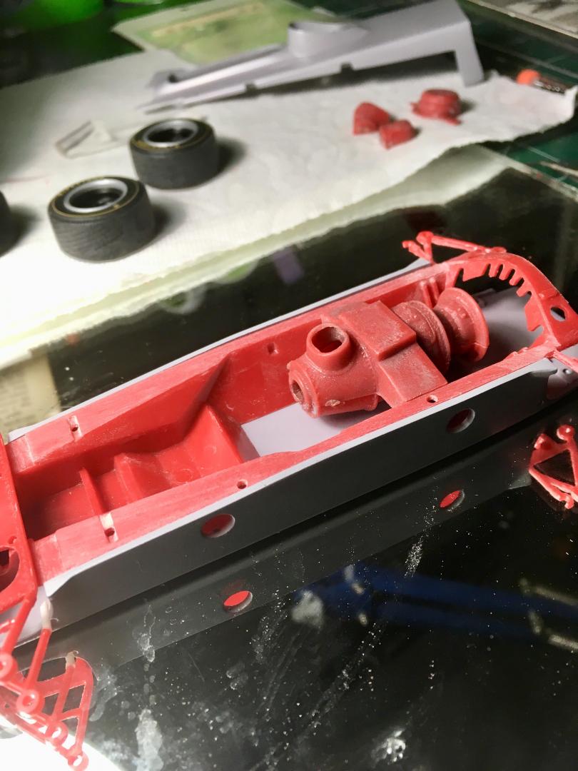

Fitting the turbine . Casting is a little rough, but overall things fit without major problems.

Great looking project Bruce.

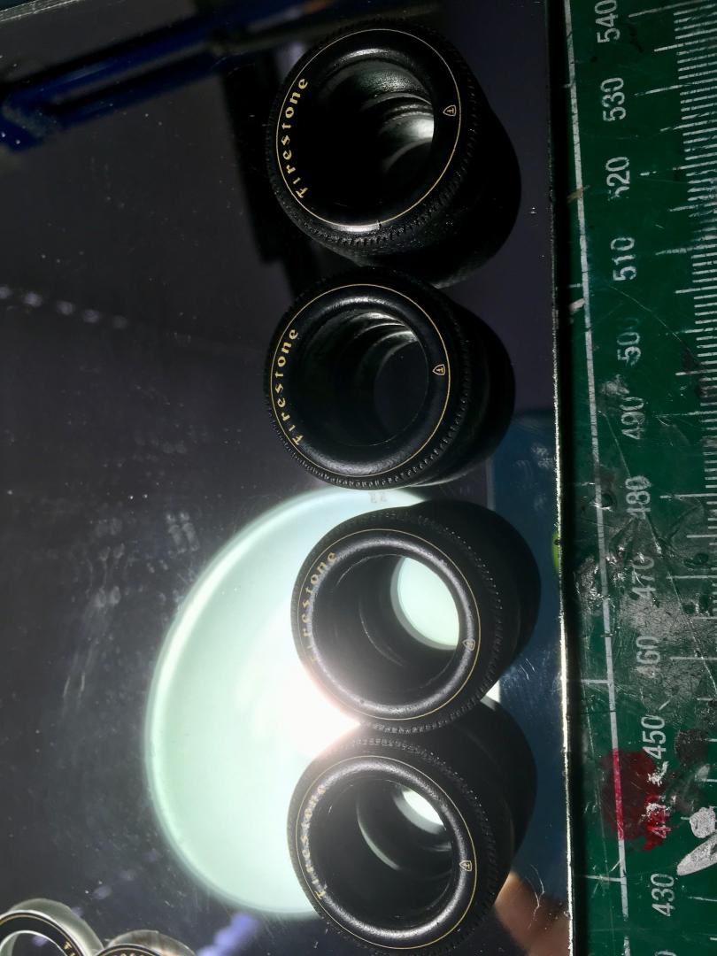

The tires are a big improvement over the old kit tires.  Well done.

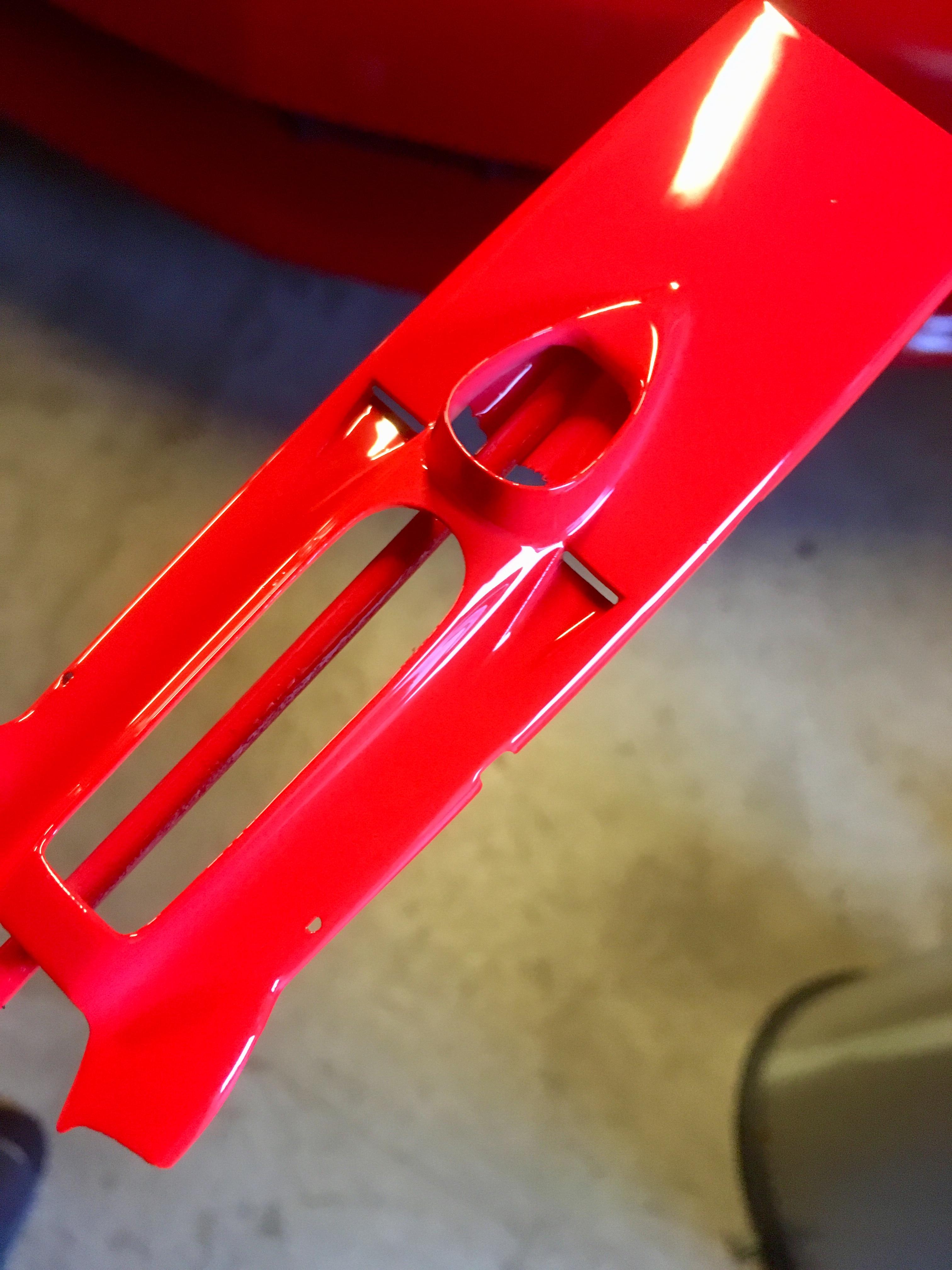

Bruce...what did you use for the red ? . Sure is bright.  I have this kit in an original and the re-issue. I was going to use Tamiya TS36 but it only gets that bright over red  and not  over  primer.  The clear looks awesome too.
Try using the Tamiya pink primer.

Thank you guys very much!  I like this build because it is different. Ok this is what I did for the paint. My first round was a disaster. Model master paint and it cracked real bad. Probably my fault , too much to soon and the temp was 95. I stripped the body.  Soo I did a experiment. I used one shot striping enamel. I primed it. Sanded the primer with grey sanding pad. Mixed one shot with enamel reducer. 1 to 1. Let it dry for a week. Then shot the body with hpc15 urethane clear from sherwin Williams. It is very thin. This clear is is becoming very hard to get in small amounts. For some reason they now,4D8226C0-D9D6-4775-9759-8A9C3EF34F63.thumb.jpeg.0a790dee4623399c6499eb3d12ead650.jpeg only sell in large amounts only. Going to have to change clear as I cannot afford large orders.  Use safety equipment!!! I also use a sata minijet spray gun. .8 tip. After clear I put the decals on. Indycal has great decals and resin tires ! Really improves the build. I then recleared the body. The decals stayed down. Hope this helps.

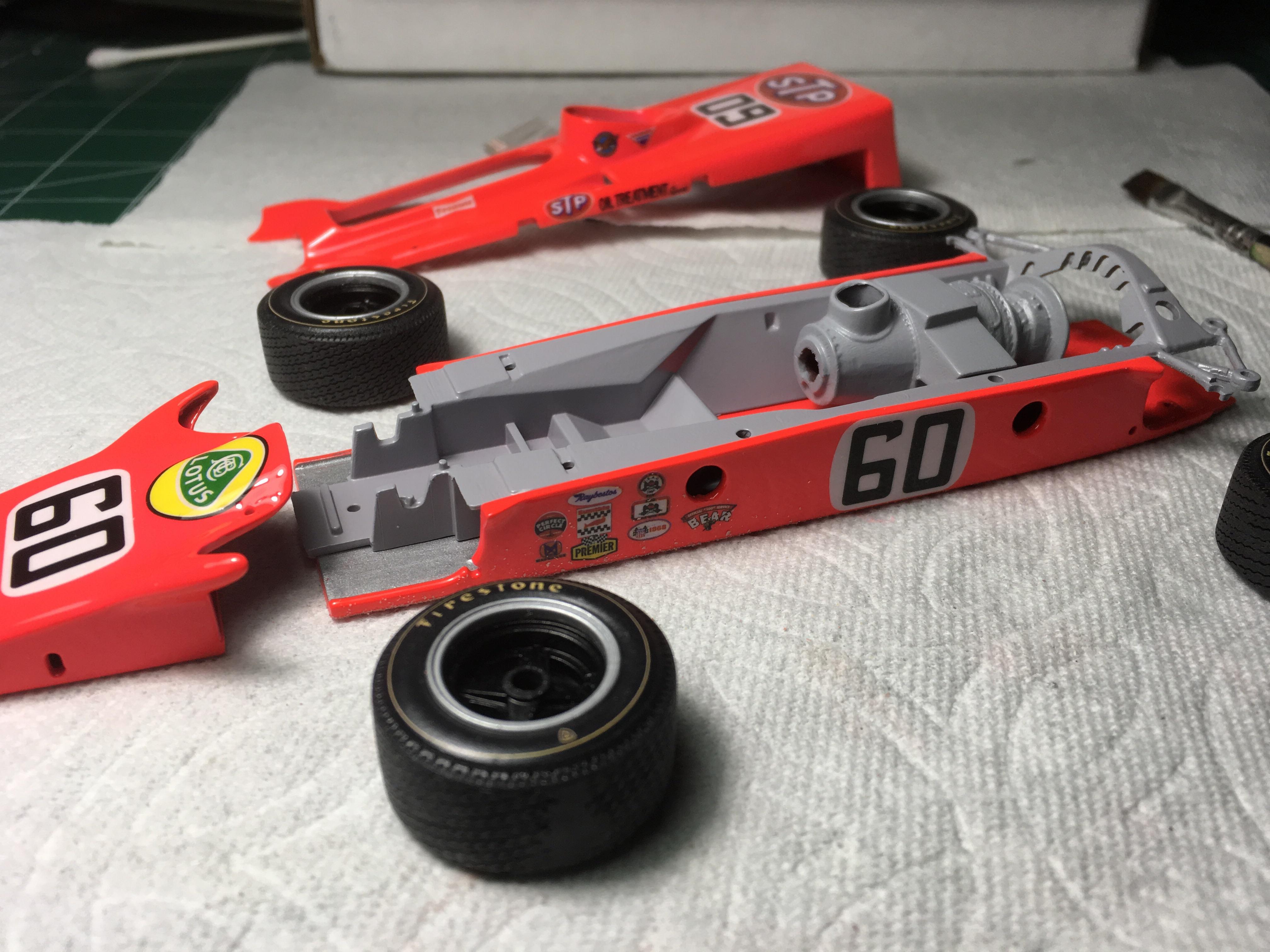

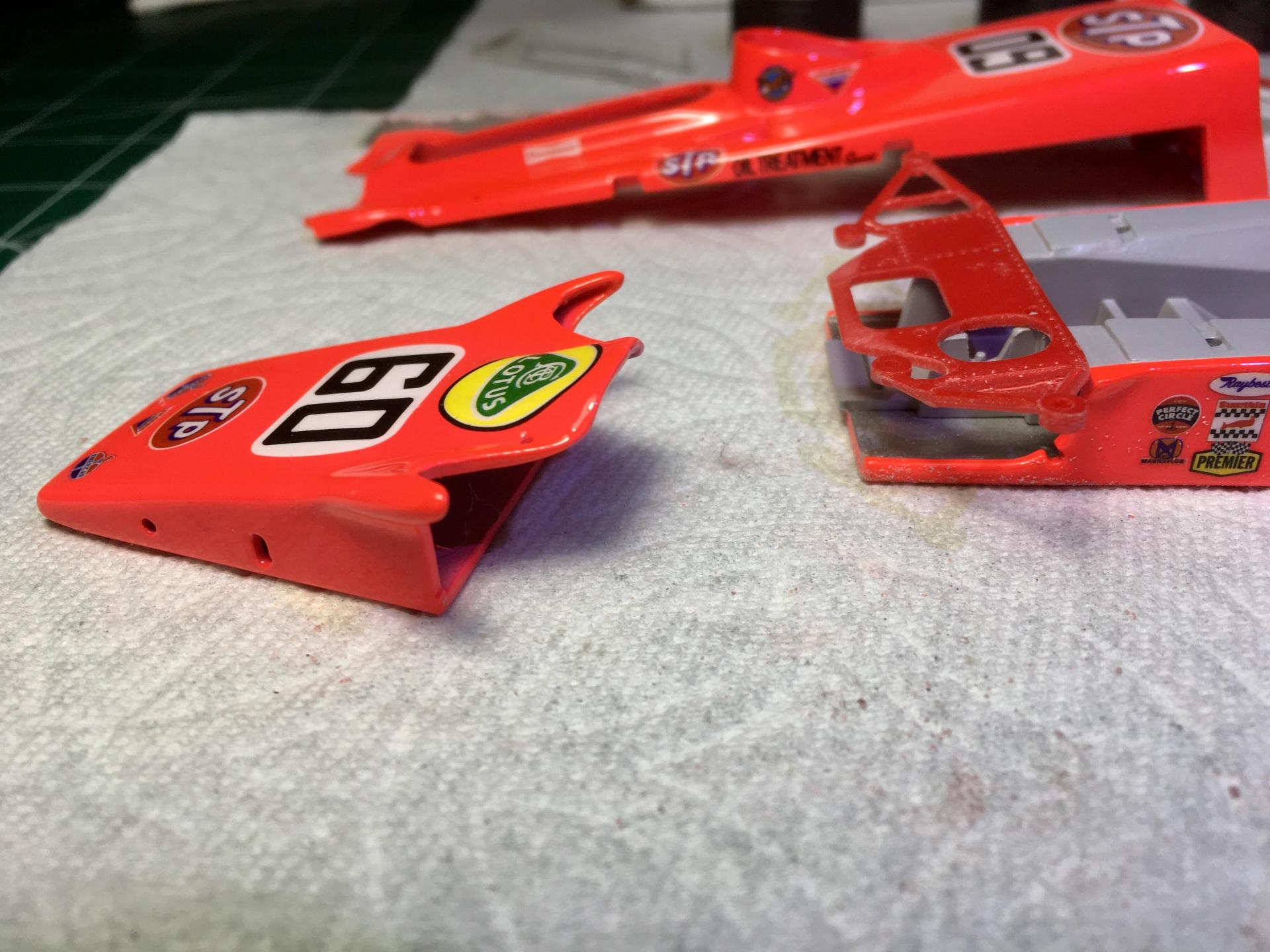

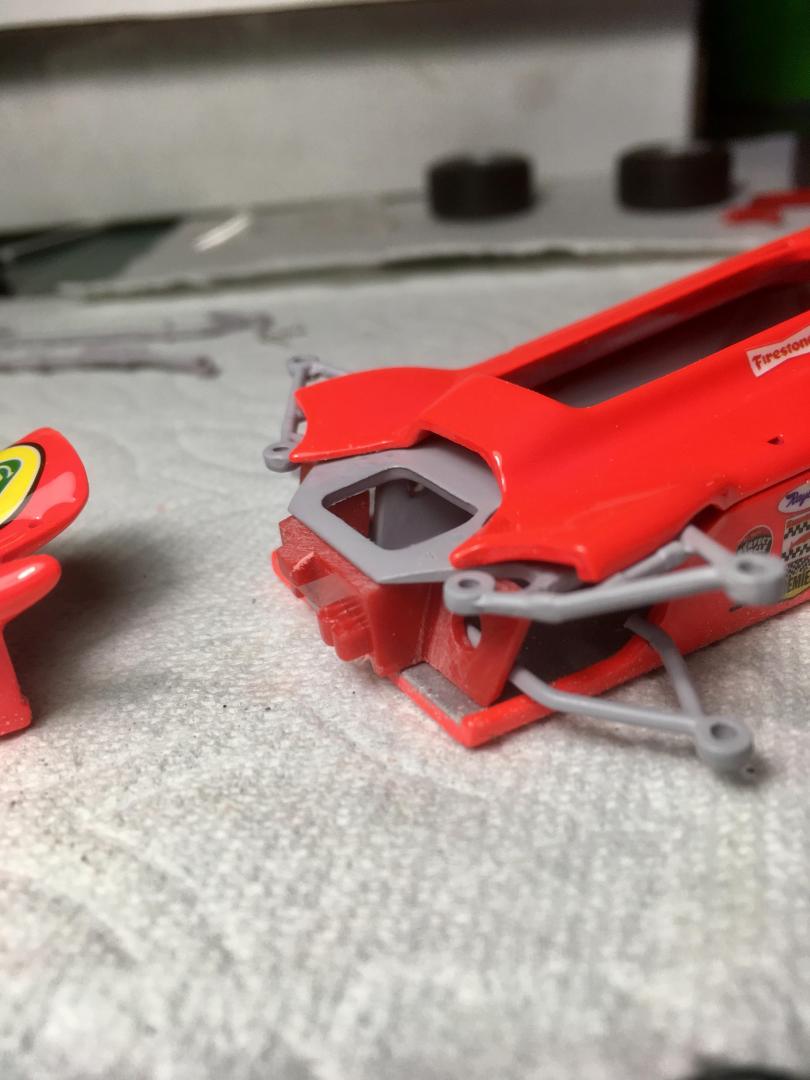

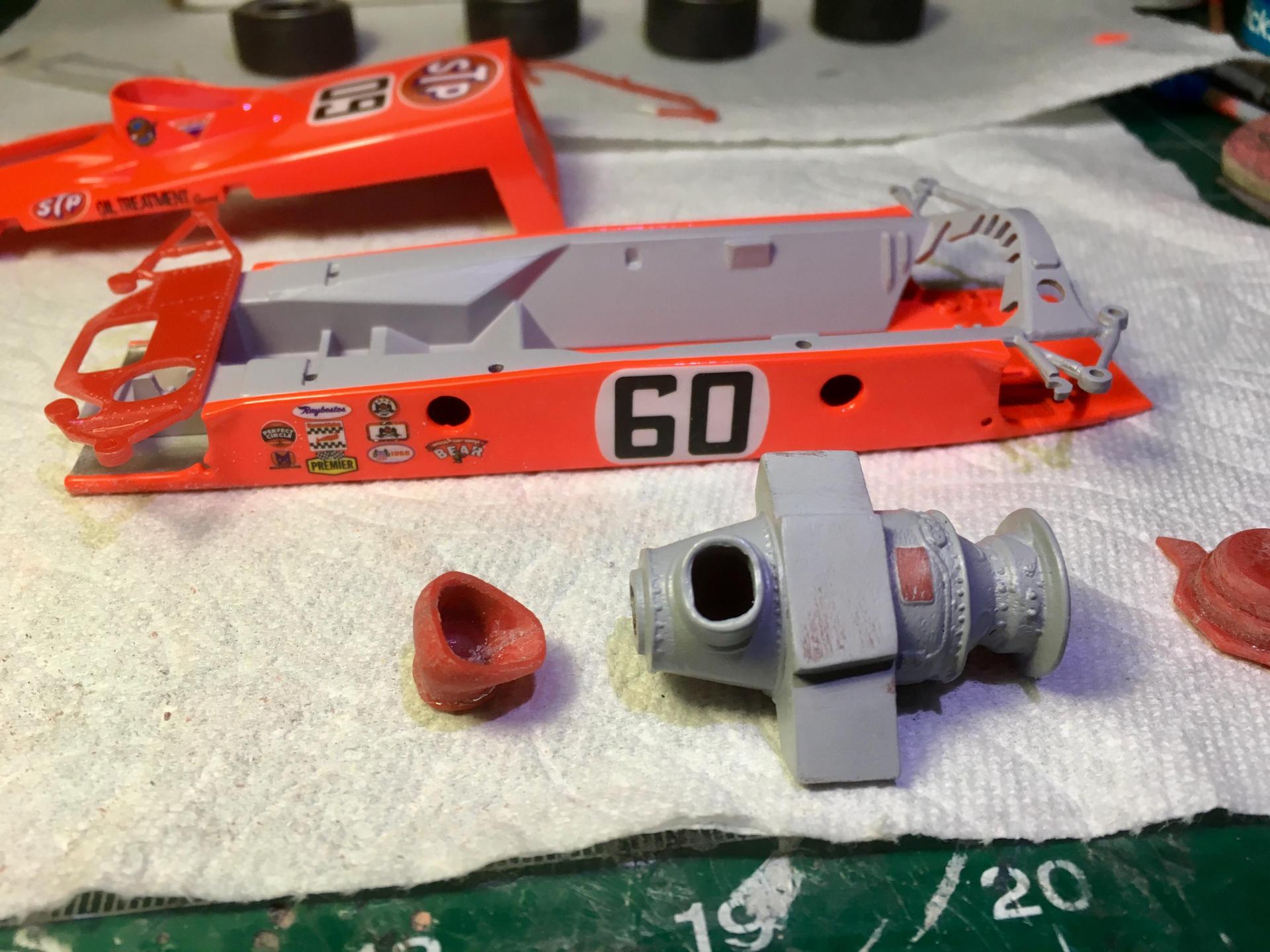

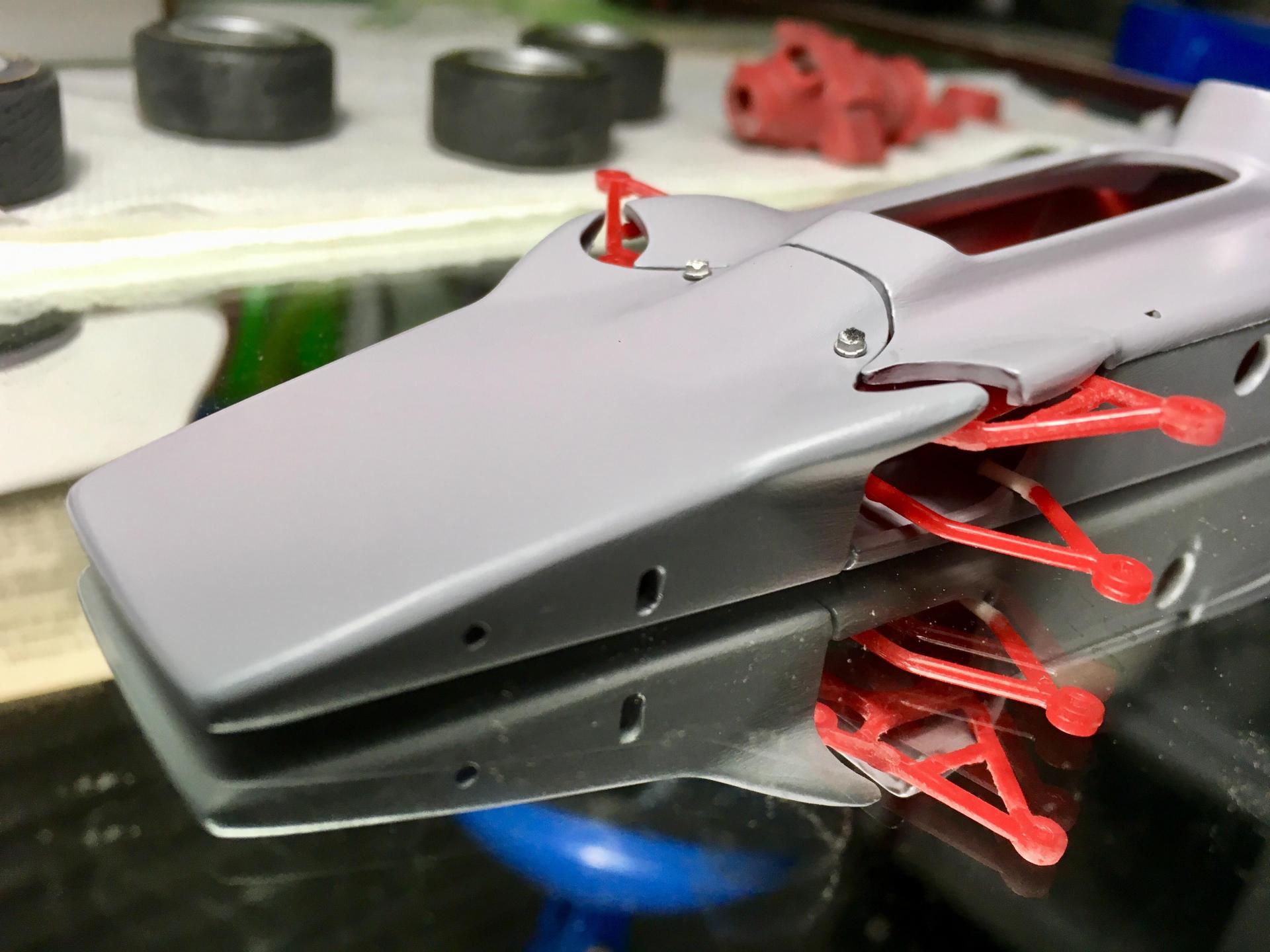

Fitting the suspension. Getting the turbine ready for paint and detail. No plug wires here. As you notice I made the front nose section like the real car. I finally figured out how I am going to mount it. Will show later how that works. Batteries hang out front in the nose section. Think about it, if you had a front crash battery acid would be everywhere. Here is what I have so far.

Wow looks good.  Did this kit have the Wheelhorse tractor with it?  I know the Bobby Unser kit did but thought maybe this one did also.  Anyhow looks great.

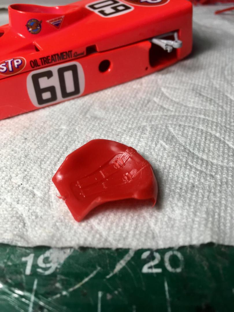

Getting the foot well and front suspension plate to fit is work. Have to sand to get the nose section to fit. Batteries have to fit in the nose section.  Going to be fun to fit the steering arms and front differential. A lot goes on there.  The seat is a piece of work. Really needs improvement. You really have to work on the fit.
