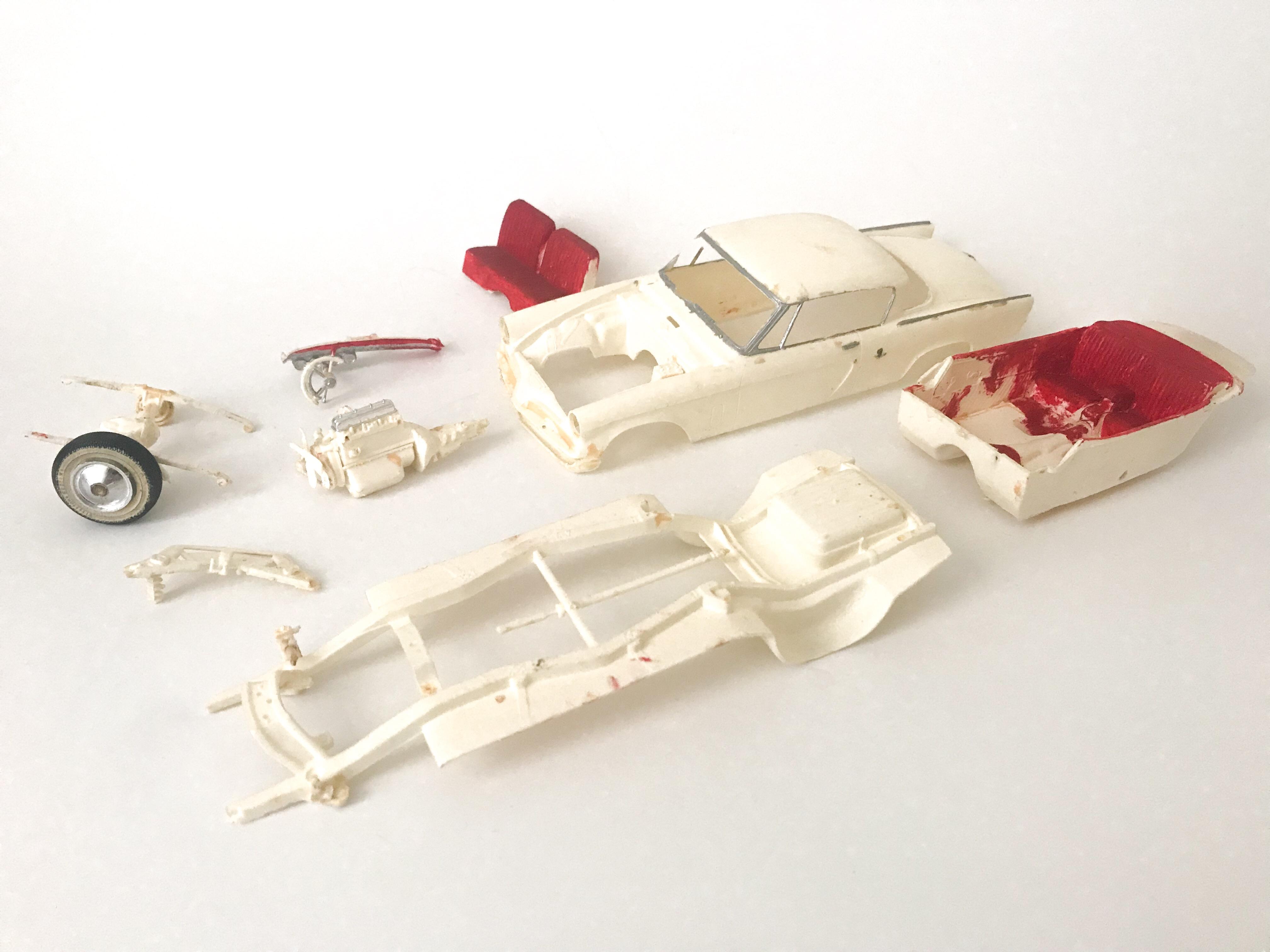

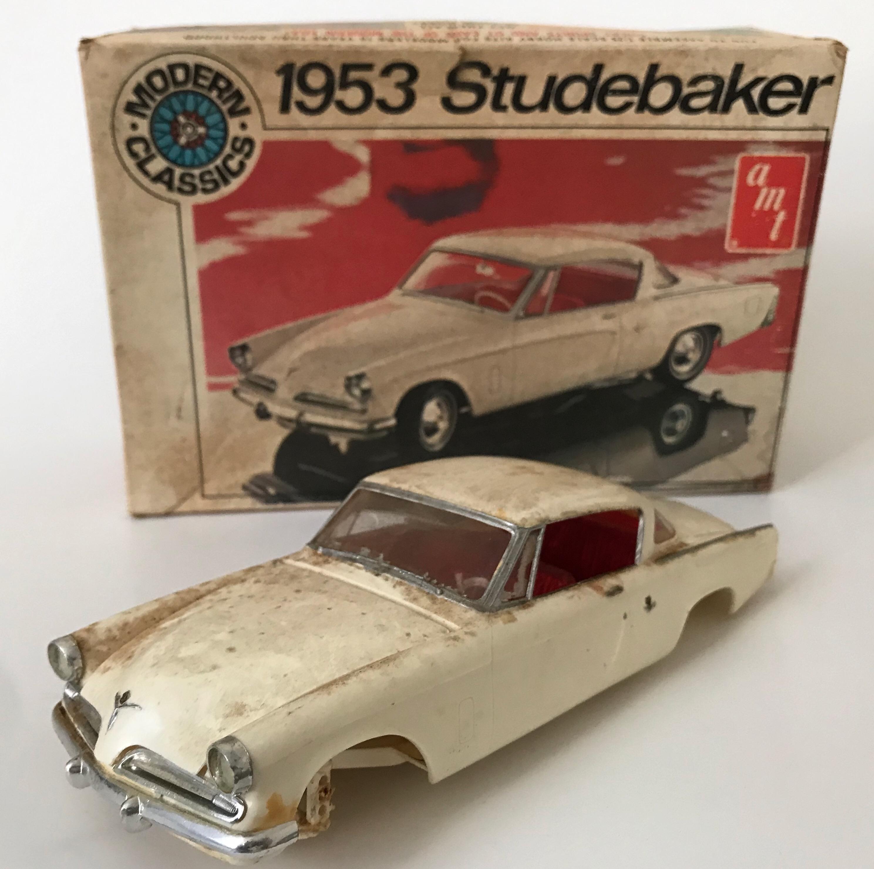

I got a text a couple of weeks ago from my wife’s aunt saying that she found a few Studebaker kits that had belonged to my wife’s Grandpa, who was a real Studebaker nut, and would I like them.  They arrived late last week, and included with them is this built-up that we think he built as replica of a car he had owned in the fifties or sixties maybe:
I said to my wife that it might be nice to rebuild this one so she’d have a nice build to remember her Grandpa by, so I broke it down as far as I could (including giving it a 24 hour trip into the freezer) so I could start fixing it up.
I’m going to keep the color scheme as he built it originally - red interior but with an Ivory body (which is how we think he had his 1:1 car).
I can’t quite bear to build something completely stock but it’s going to be pretty close - as though you maybe had a shop blow it apart today and rebuild it pretty close to original but maybe even nicer than the factory did.

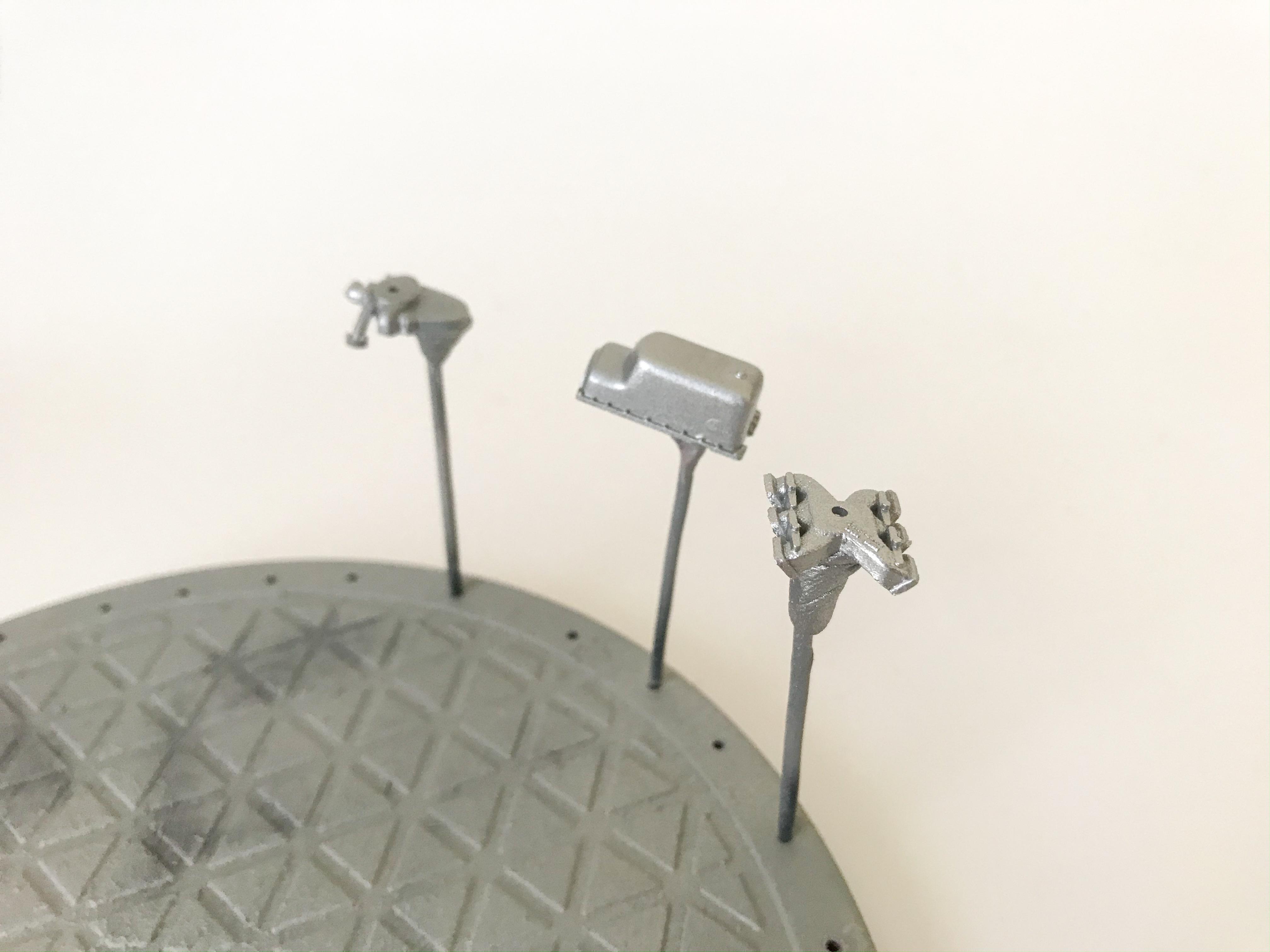

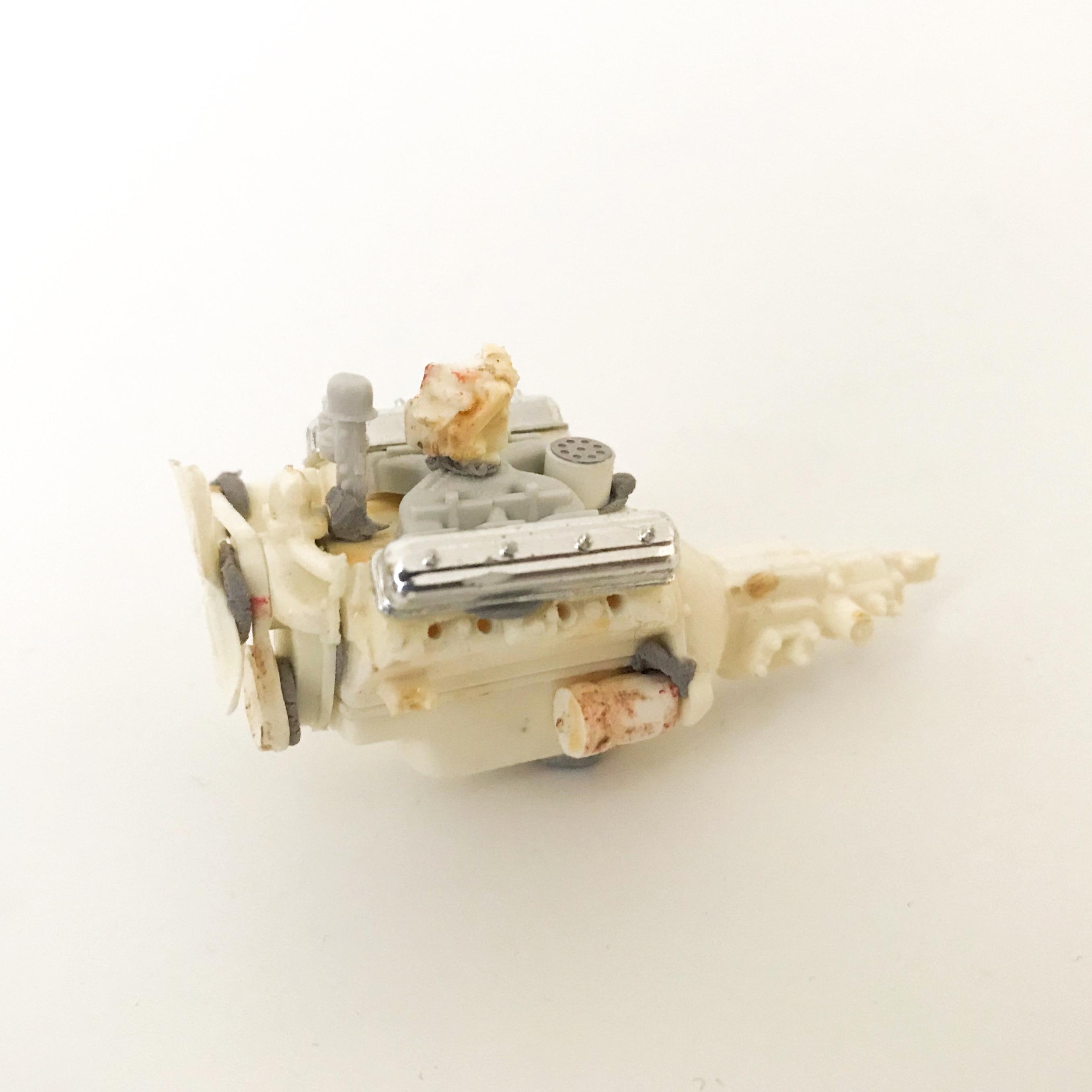

I did a little work on the engine over the weekend and (with the addition of a couple of parts from a second later-issue kit that I have here too) and got that ready for primer:

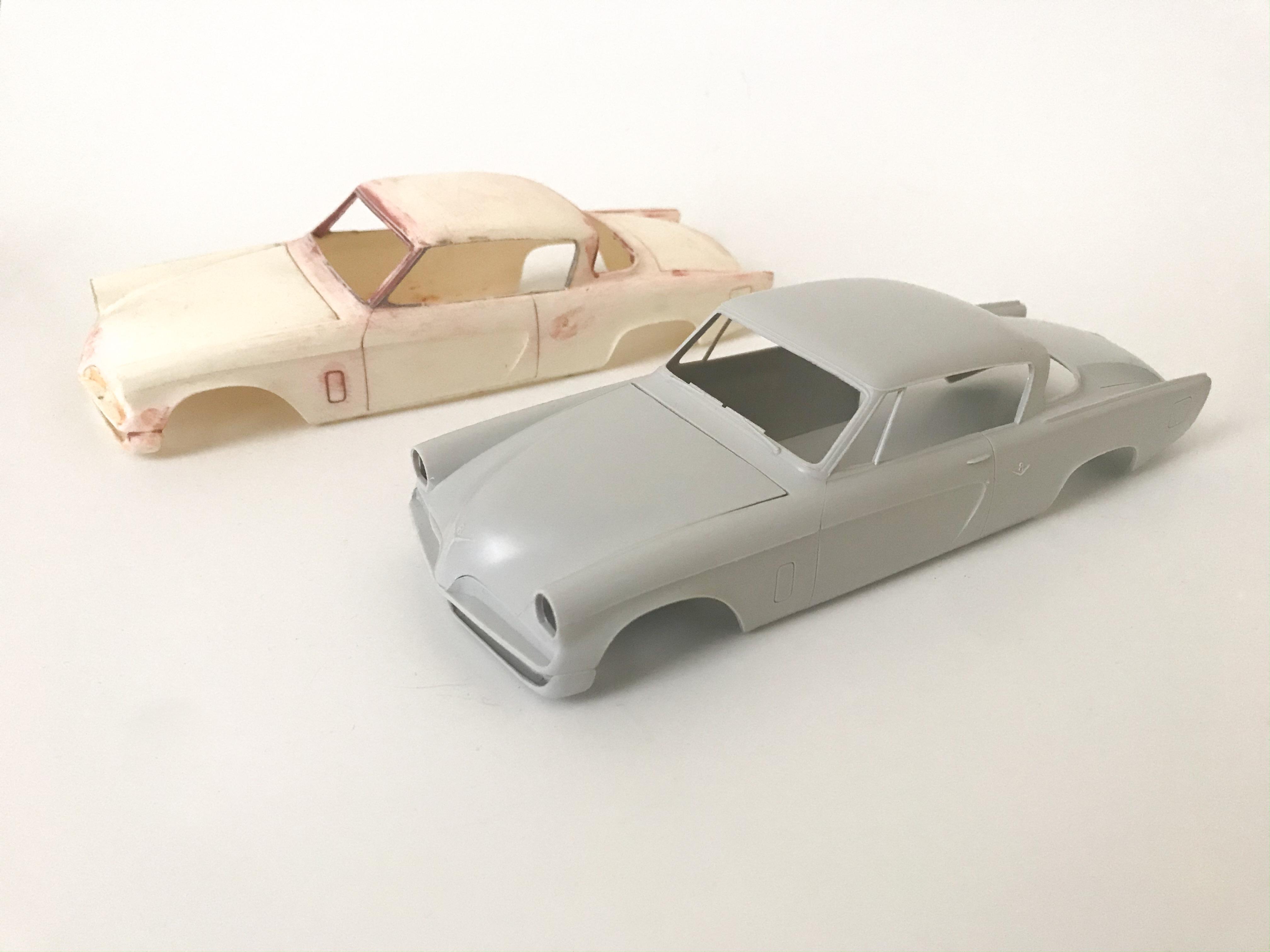

I spent a couple of hours on trying to fix up the old body - it was complete but REALLY rough once I cleaned it up and got the glass out of it...so seeing as this is meant to be a nice factory-stock-ish build I’m thinking of saving the old one and swapping a brand new replacement body that I’ve got here...don’t worry, I’ve got a plan I’m excited about for that old body...

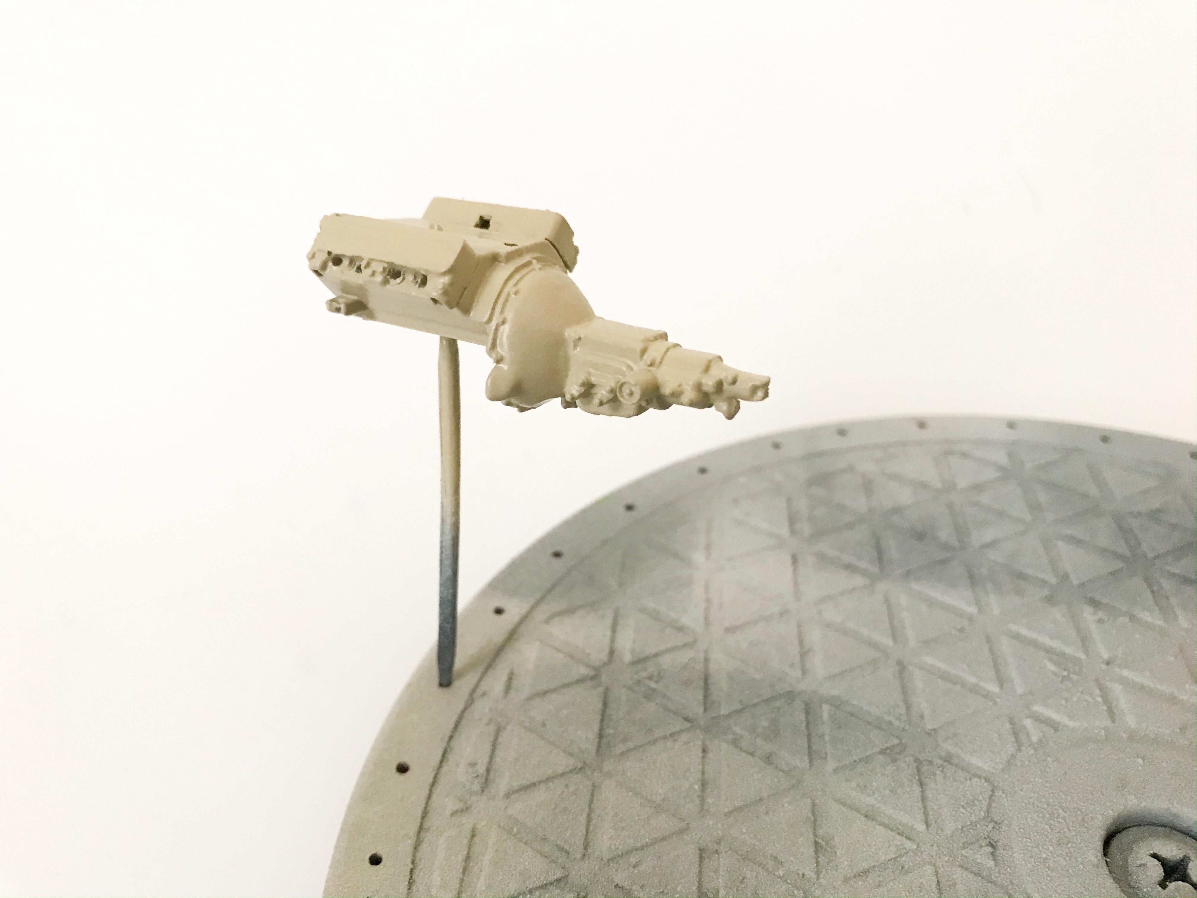

I shot the engine with white Duplicolor primer (which I really like, it lays down like Tamiya primer but it’s a quarter of the price) and then hit the block with some of the hearing aid beige (sorry, Studebaker Ivory Mist ?)
Now, all the 1:1s I found seem to have either a dark green or a black block but I’m building this more as a nice almost-stock restoration rather than straight-off-the-production-line so I decided I’d like to see a nice immaculately-clean engine bay so I’m going with a matching block, body and frame here.  Something that you’d see at a car show and say “wow, that’s CLEAN” rather than “wow, that’s just like original”.
I don’t want to go full-streetrod with the color-coding though, so I’ll be painting the various accessories and components that attach to the block in a variety of metal tones...I picked up this paint at Target a couple of weeks back and thought that’d be a nice shade for a bare-metal oil pan-color and mixed in some Tamiya chrome to get some slightly different tones for a couple of the other parts:

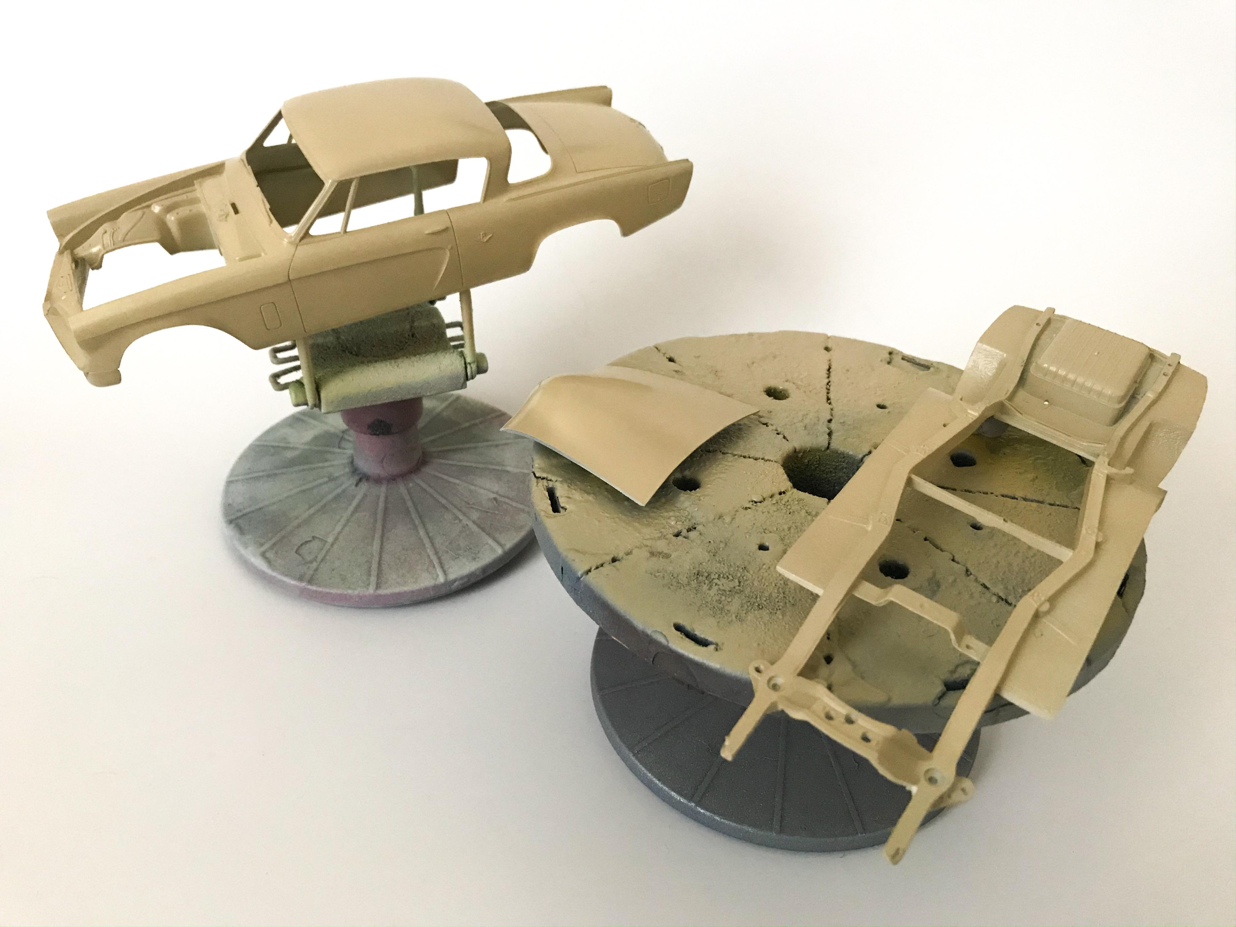

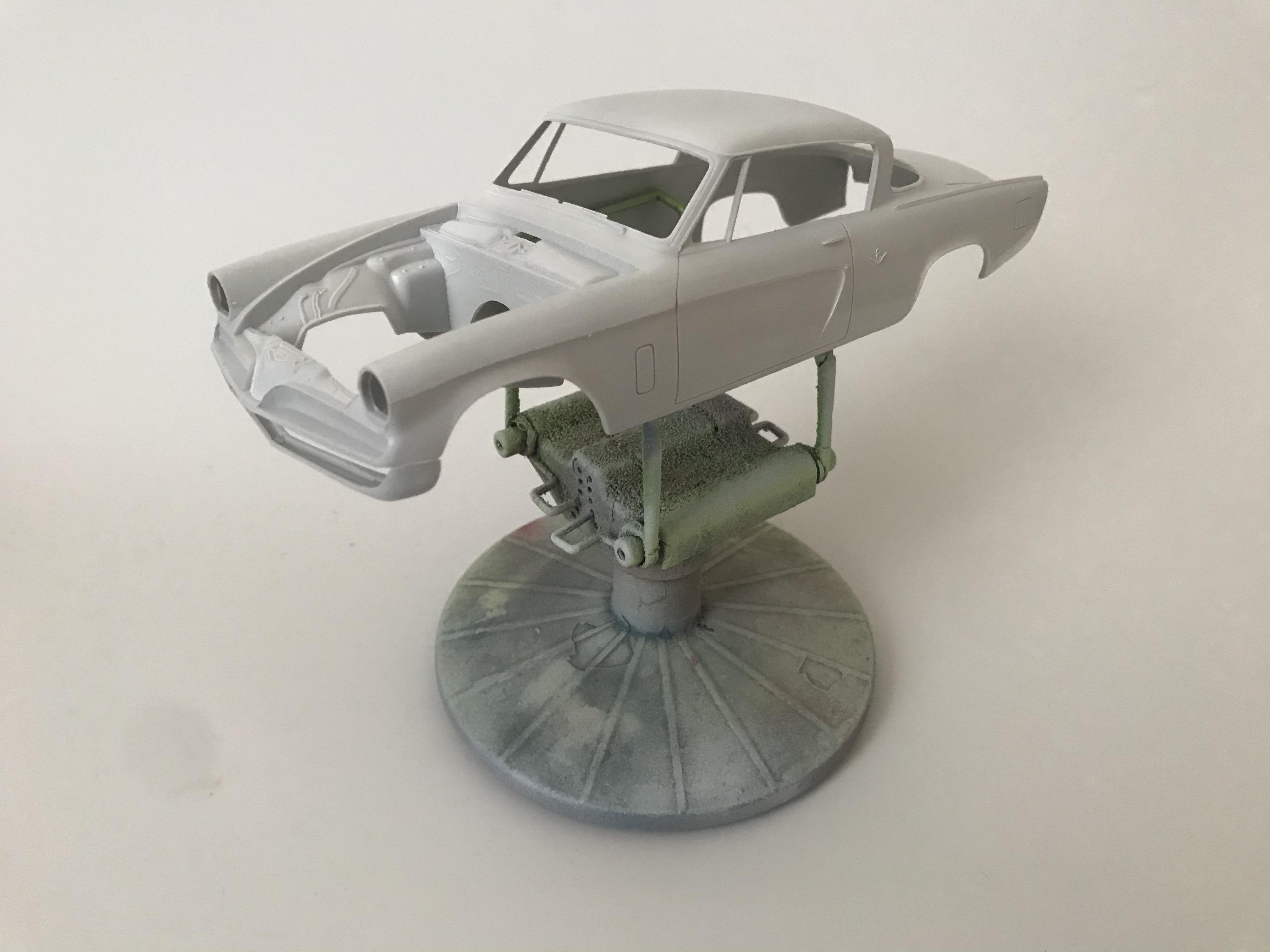

I got some white primer on the body too this afternoon - I’ll let it shrink and set-up overnight and give the body a check for any cleanup that it needs and then give it another flag to make sure the final color is as nice as it can be.  I’m thinking I’ll need to use the foil-under-the-paint trick for the various emblems and details on this body and then use some more BMF once it’s done for the spears and window frames

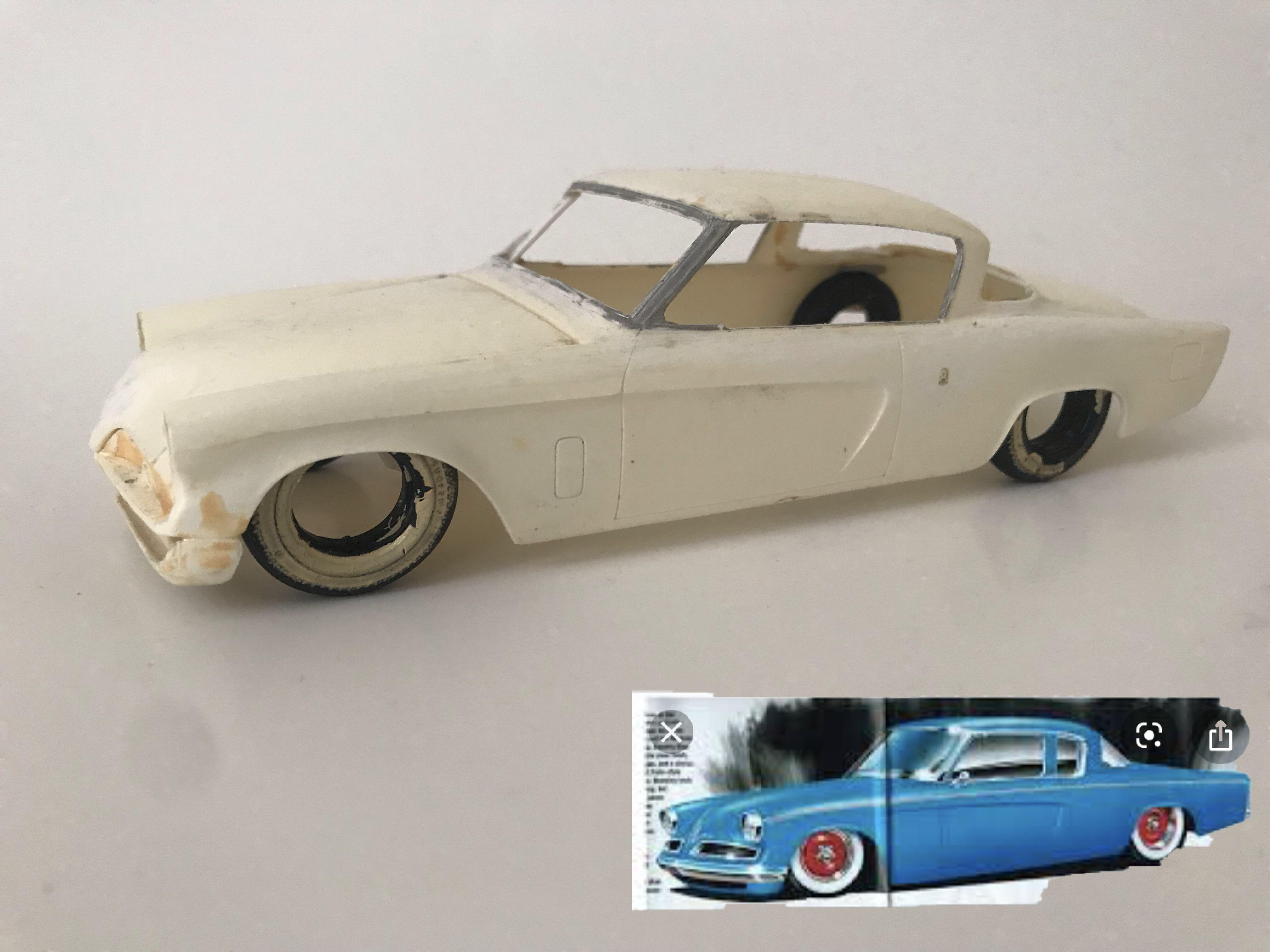

Thanks, I started this project but ended up selling it off in part of my collection to one of my fellow local club members. He finished the car. It's not exactly how I envisioned it finished but it's all good... I have a plan to build another which is why I sold this one.

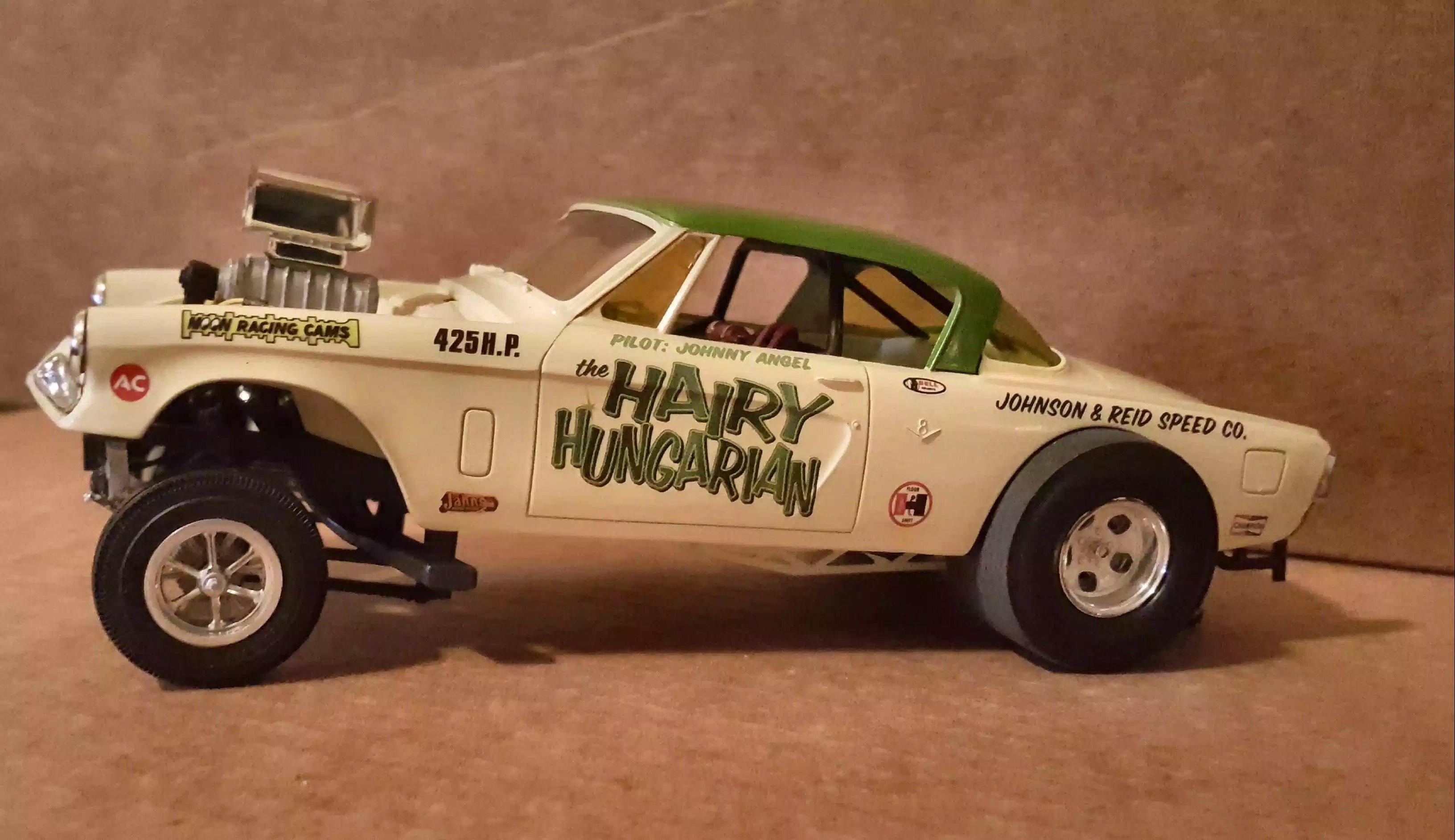

GOOD job on this so far as I'll be following along! I grew up around Studies particularly the finned Hawks so this has my attention! Studebaker gets no credit for this, but those Loewy designed coupes were arguable the first of what would be called a "personal car". The early two seat T-Birds took the credit for that as they were not "sports cars" in the strictest sense, but Studebaker had them beat by a couple years.
It sure would be nice to see some newly tooled later Hawks such as the finned '57-'61 cars as well as the '62-'64's.
Link to comment
Thanks for all the comments everyone - cool gasser Disco!

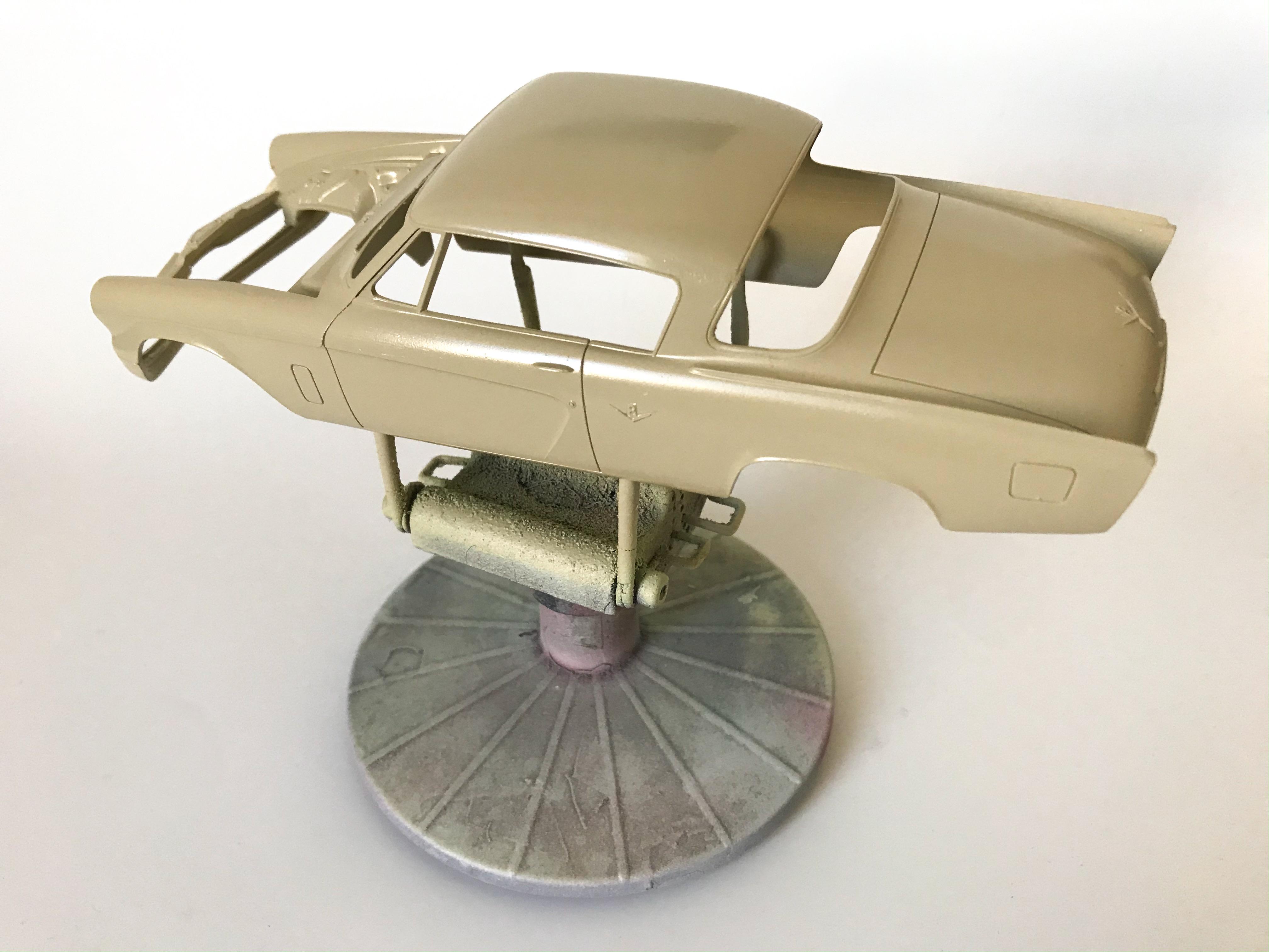

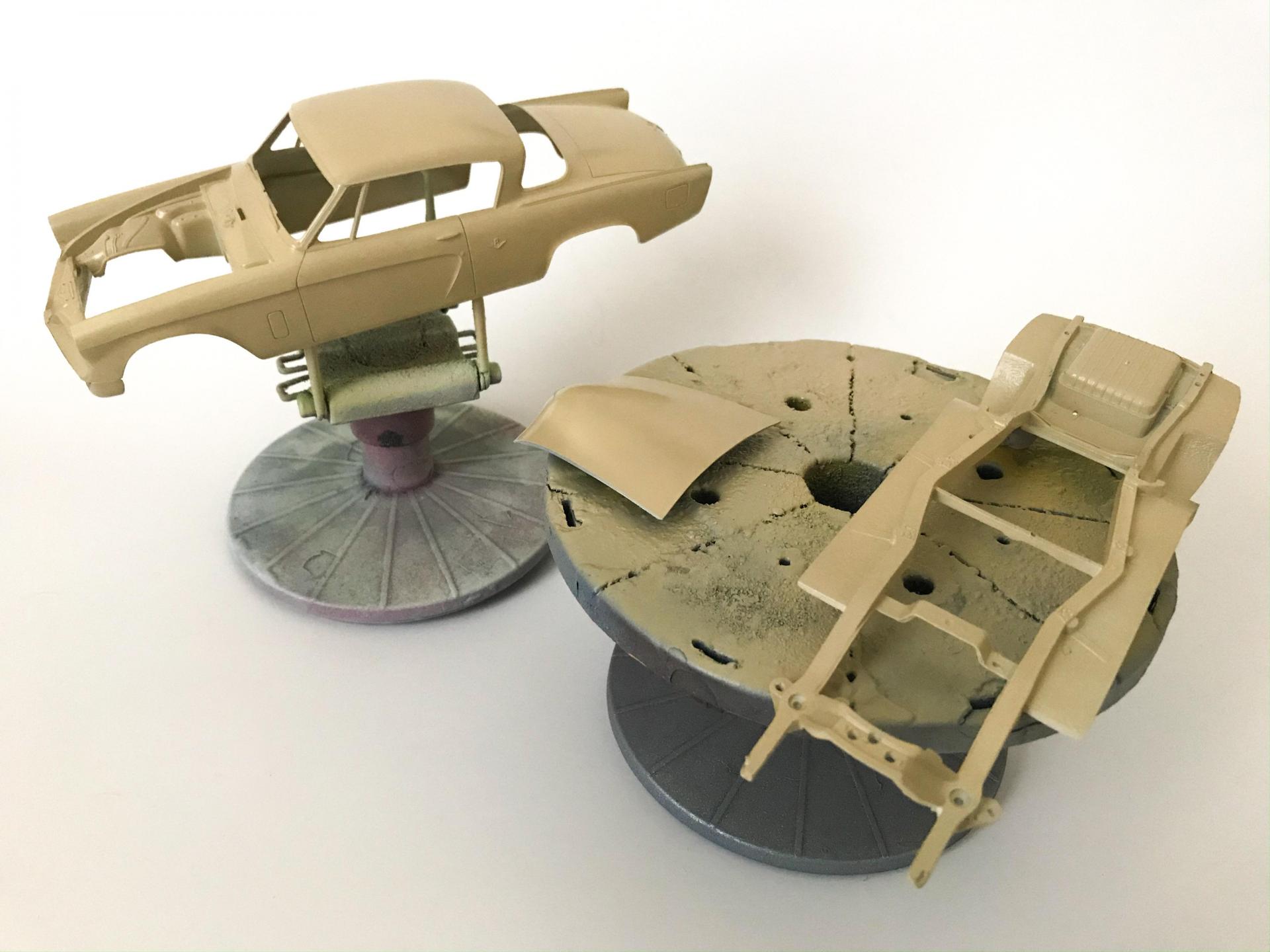

The humidity was really high this week which slowed me down a little in getting the body color laid down...but it dropped to 55% today from 85% and I managed to get some spraying done:

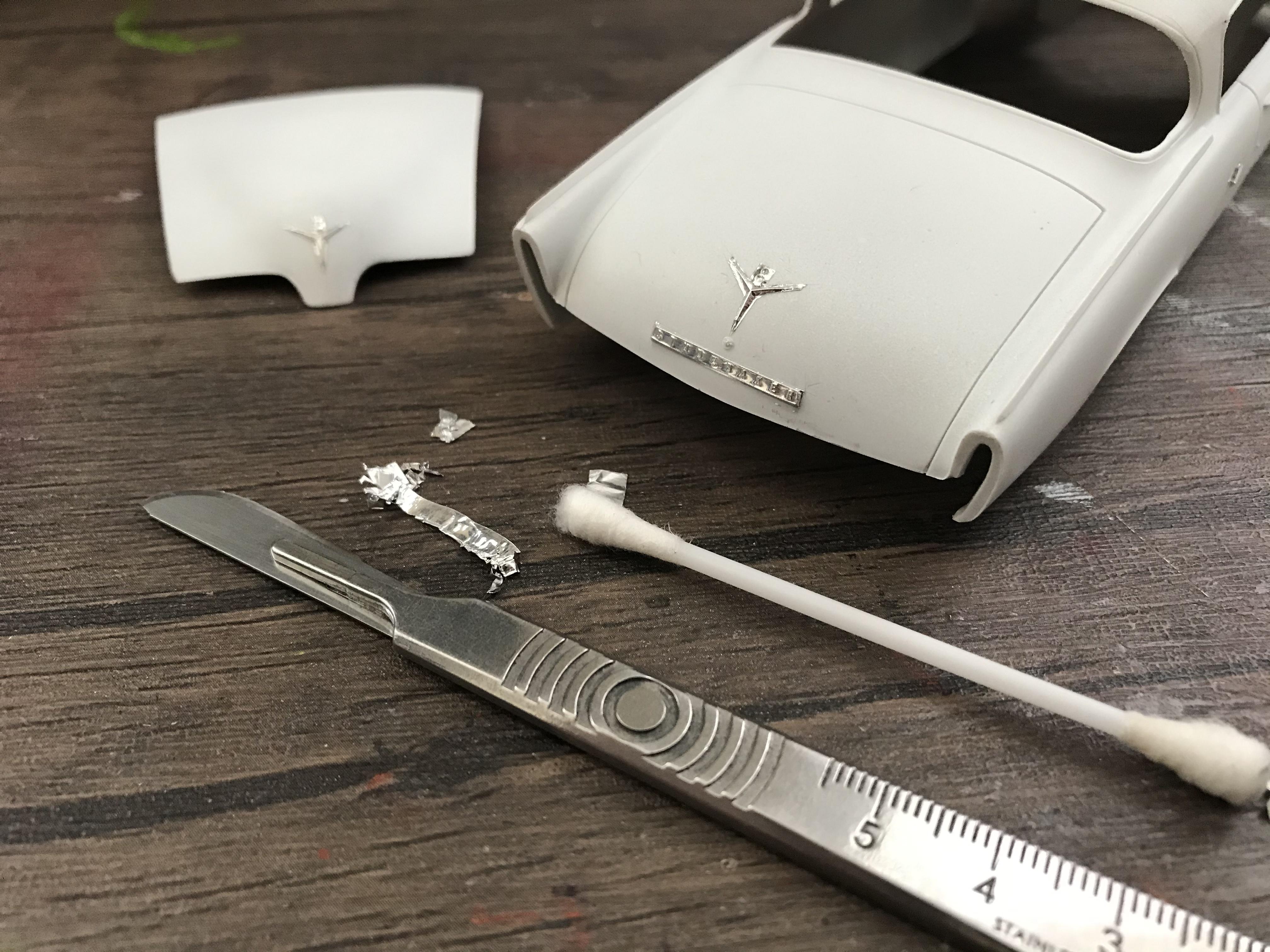

I bare metal foiled the decals on the body before I shot the paint, after I saw a technique Steven Guthmiller recommended in a thread here - hoping I can pull it off!
I prepped a bunch of pieces and got them in primer ready for paint - the interior tub’s primed, most of the engine parts are done and this thing should go together pretty smoothly all being well seeing as I’m building it pretty much out of the box.  I’m adding a little detail here and there though, like replacing the levers on the steering column with a little scratchbuilt assembly:

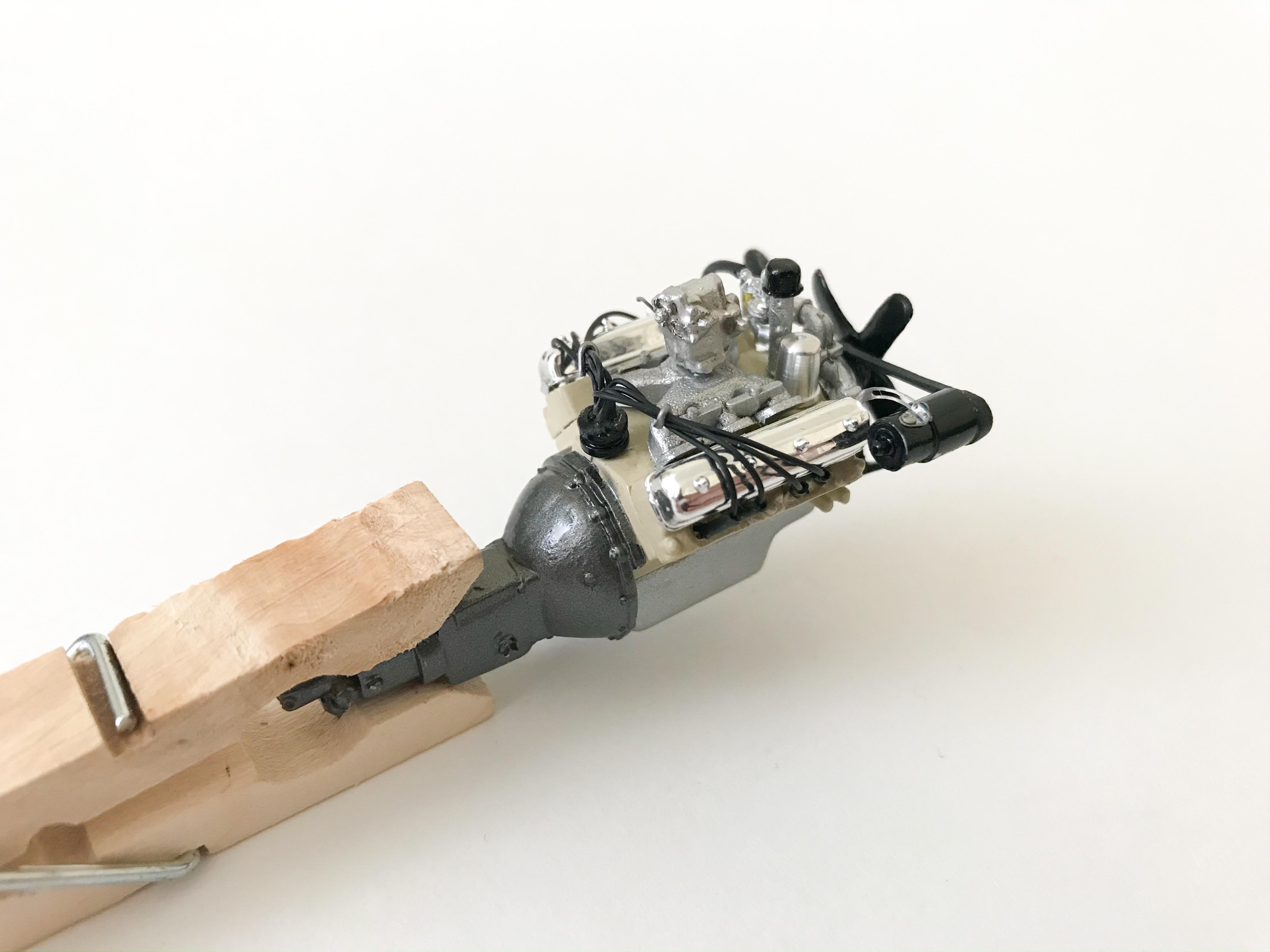

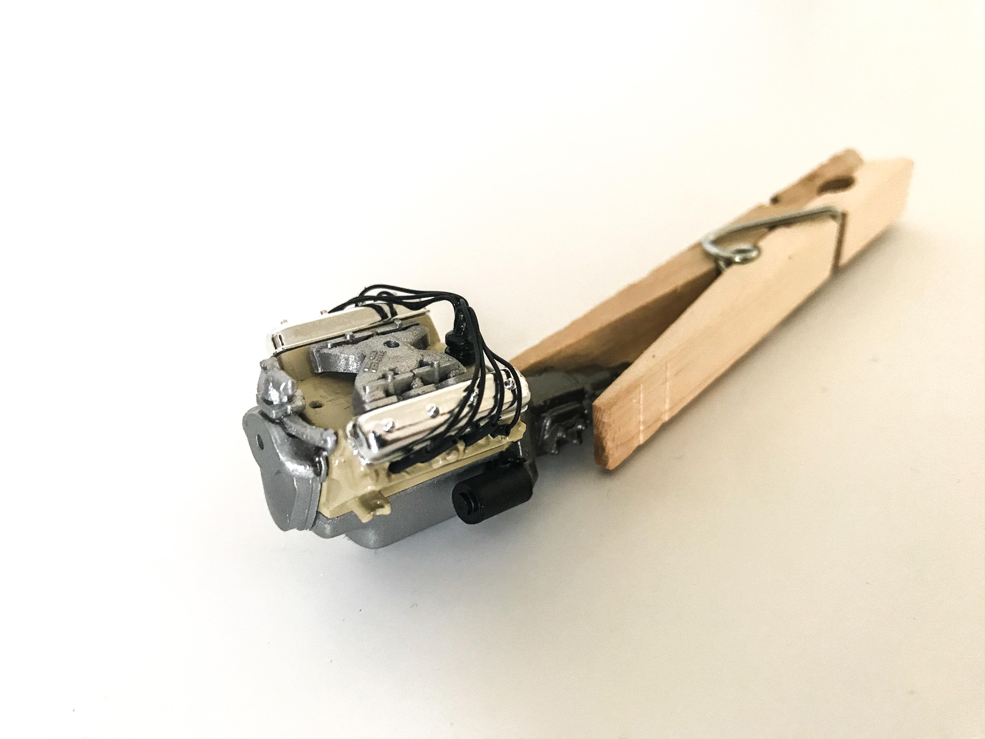

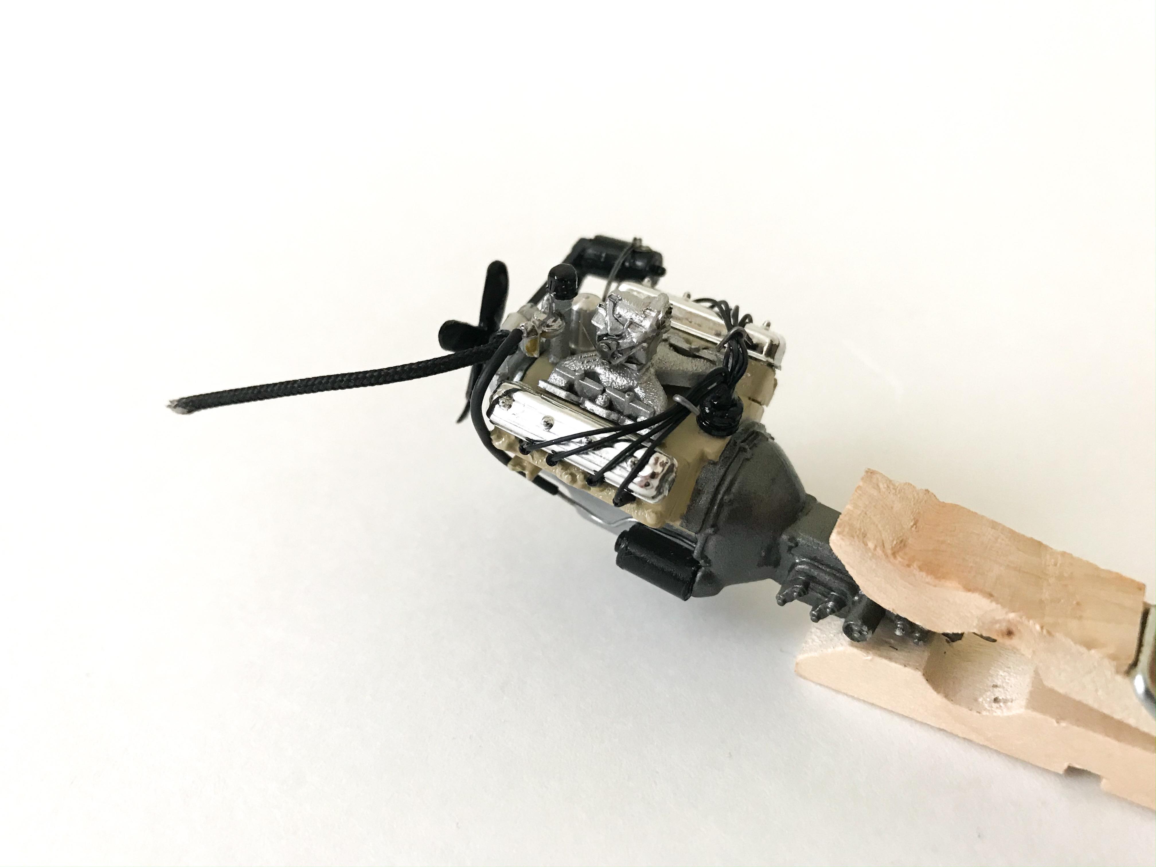

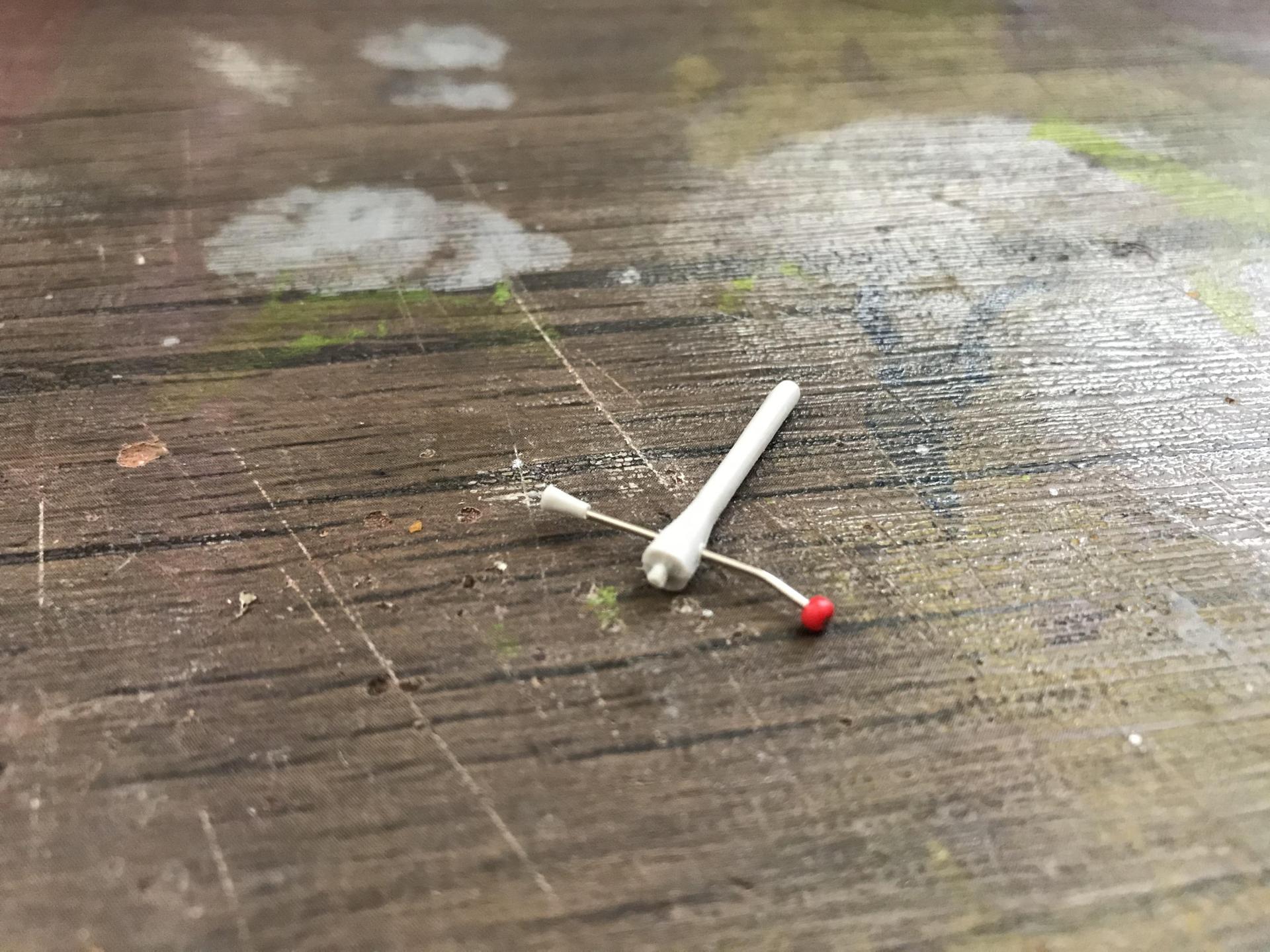

Mini update - got plug wires in there and a few bits attached to the block.  I used some Detail Master wire (with a thicker wire from an old phone charger for the plug boots) and scratchbuilt a distributor...And a quick inspection of the paint on the body that I shot yesterday shows nothing much in the way of dust or other nonsense in my nice finish - a tricky thing to achieve shooting in a New York apartment with nowhere good to paint!

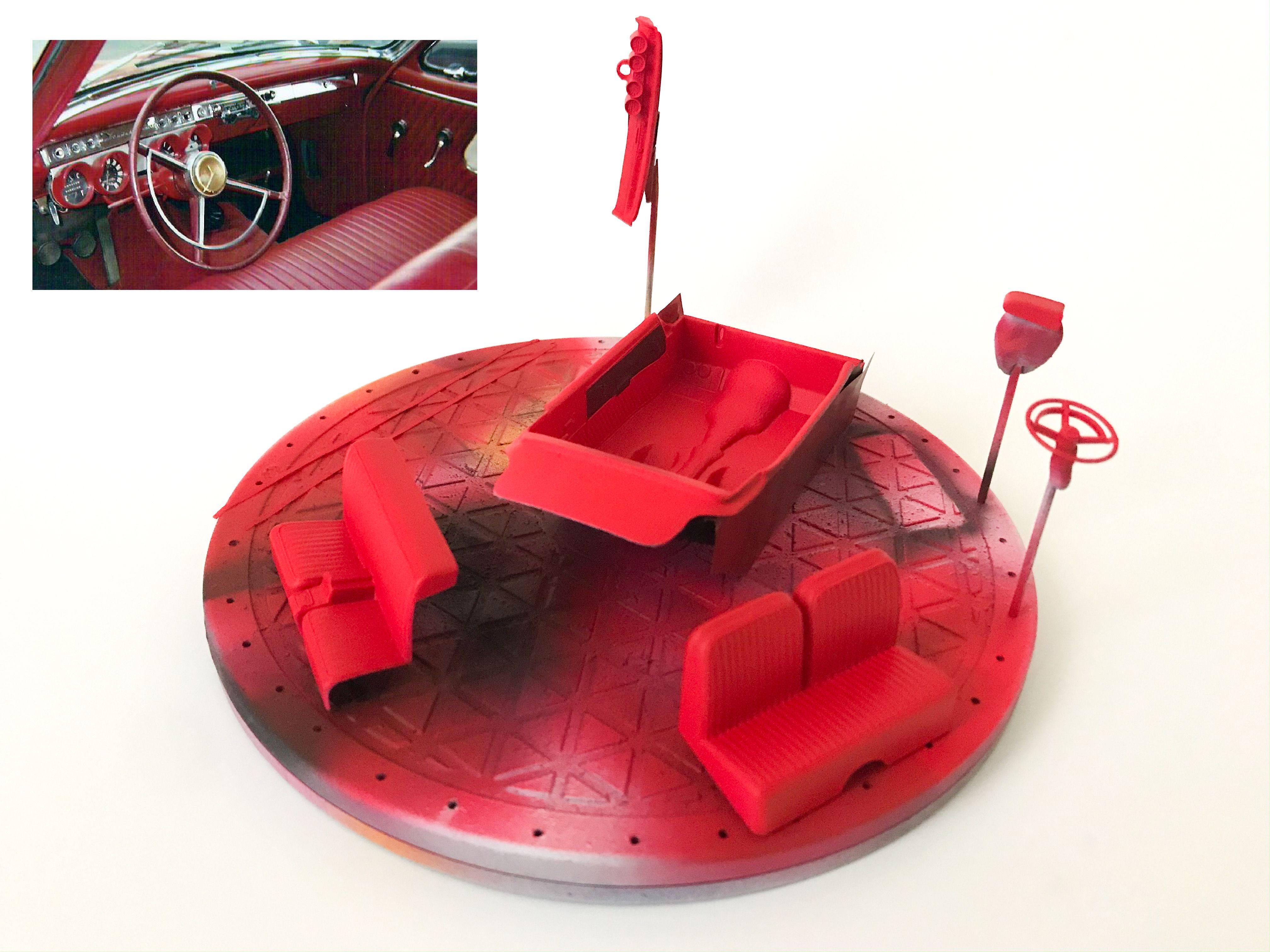

A little more progress on this one - did some work on the engine this week - added a few little details, did some detail painting and got it pretty much wrapped up except for the air filter;
And got all the interior pieces prepped and into their red paint - plenty of detail painting and stuff to go on these but it’s cool to see them in color!
This red is a little bright compared to the factory color I think...but it’ll dull down some once I brush some pastels into the nooks and crannies and start breaking all that red up with the chrome and so on.
More soon, soon as I’ve done more!

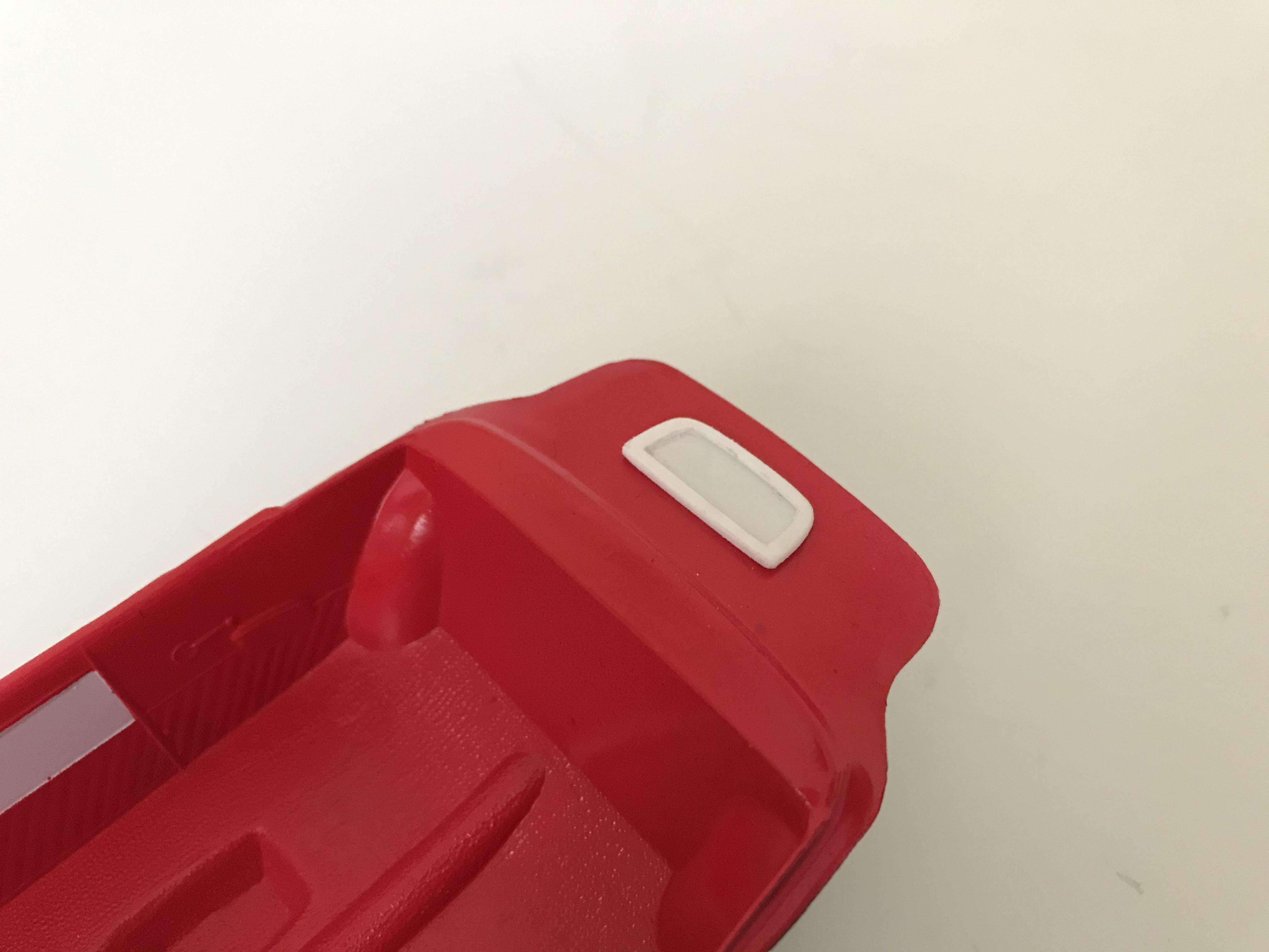

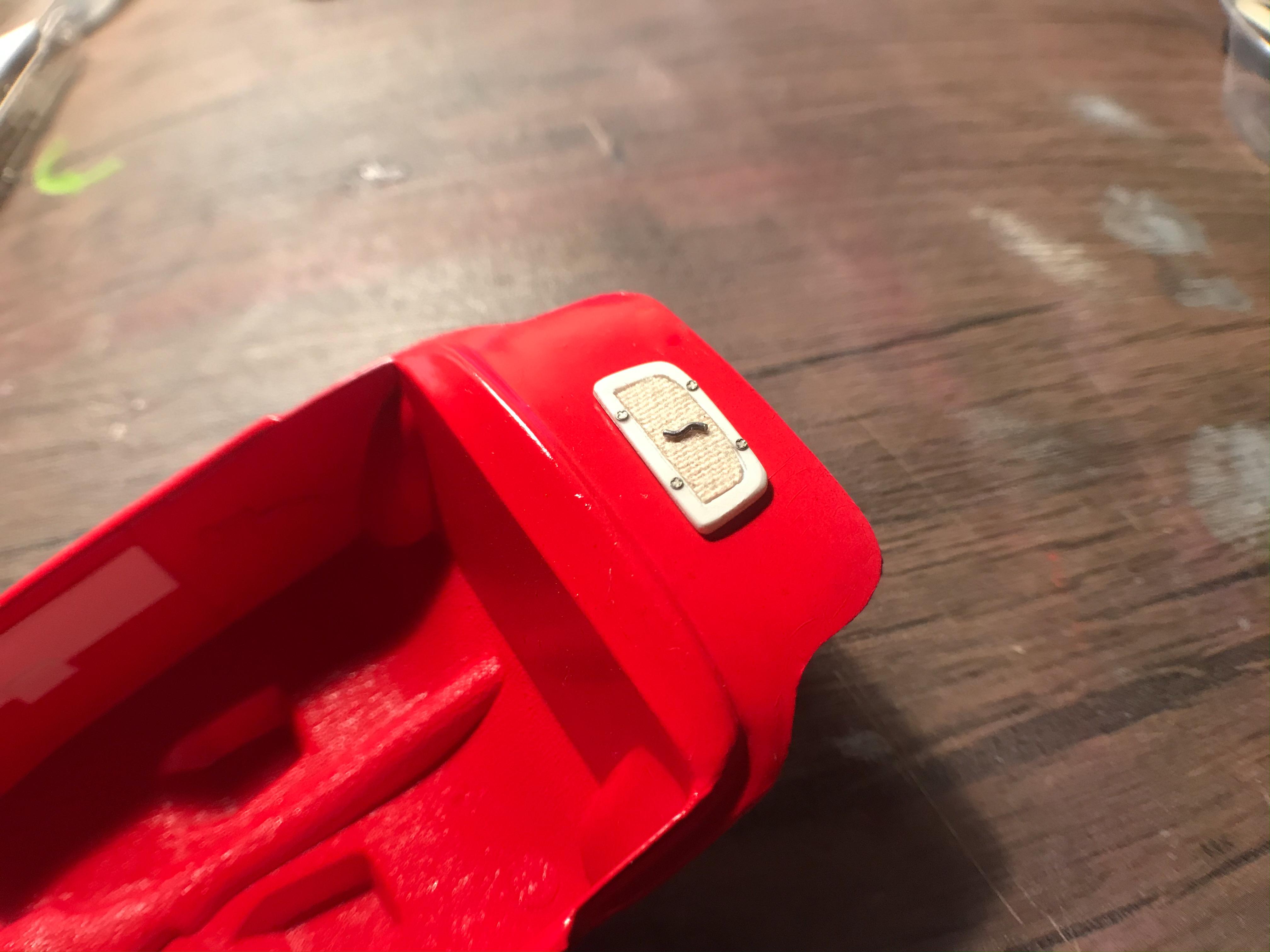

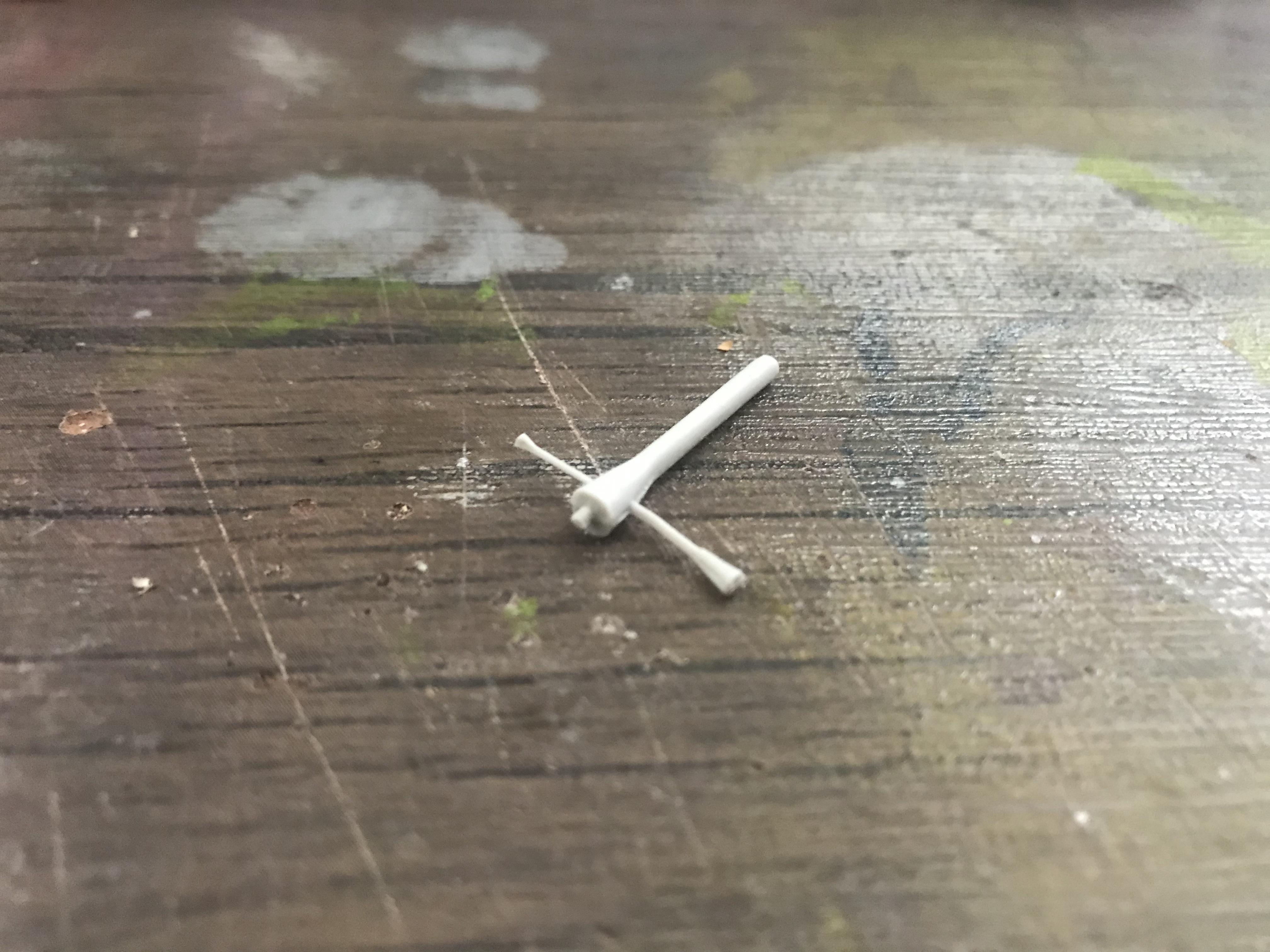

About half-way through they talk about the rear speaker on the back shelf, which I thought was a really cool feature...I’m not sure if that was standard or an option or just on certain models, but the AMT kit doesn’t model that so I figured that’d be a fun Saturday project.  Using the video as reference I make the approximate shape in my vinyl cutter software:
8EC43E59-2E8B-46D4-AE5C-F5EB987BD4F5.png.fc4dc1c12607c7562e4e7ff0175ce0cf.png7366FABD-29CF-4BA5-BC14-F217392BA079.thumb.jpeg.00edf9665caf712d91105f381d07045b.jpeg
And then ran to the dollar store to pick up a sheet of their $1 styrene sheet ?
A quick cut later...
...and we’ve got this!

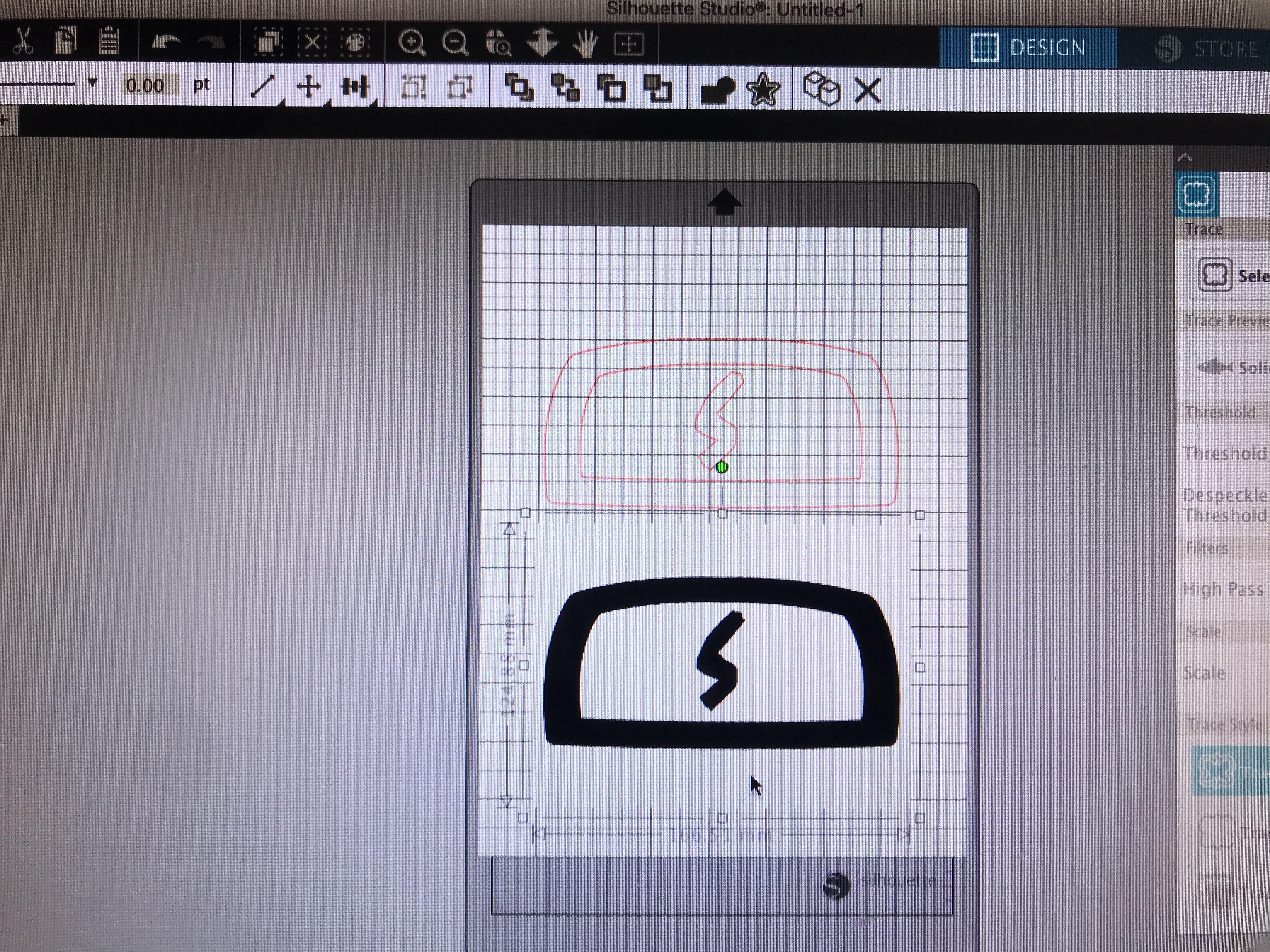

I made the Studebaker ‘S’ a seperate piece and whilst I had the cutter fired up I had it cut a fabric insert to replicate a cloth cover for the speaker:
I’ve just shot the parts with some primer and paint and once it’s good and dry I can insert the cloth piece, add the letter and add some photoetch screw heads to match the 1:1 part.  I had to take some liberties with the thickness of the letter to make it possible to cut it and the dimensions are approximate because I couldn’t find any other pics for reference - but it’s a fun little detail to add to the interior that you’ll be able to see through the rear window pretty easily when the car’s assembled.
