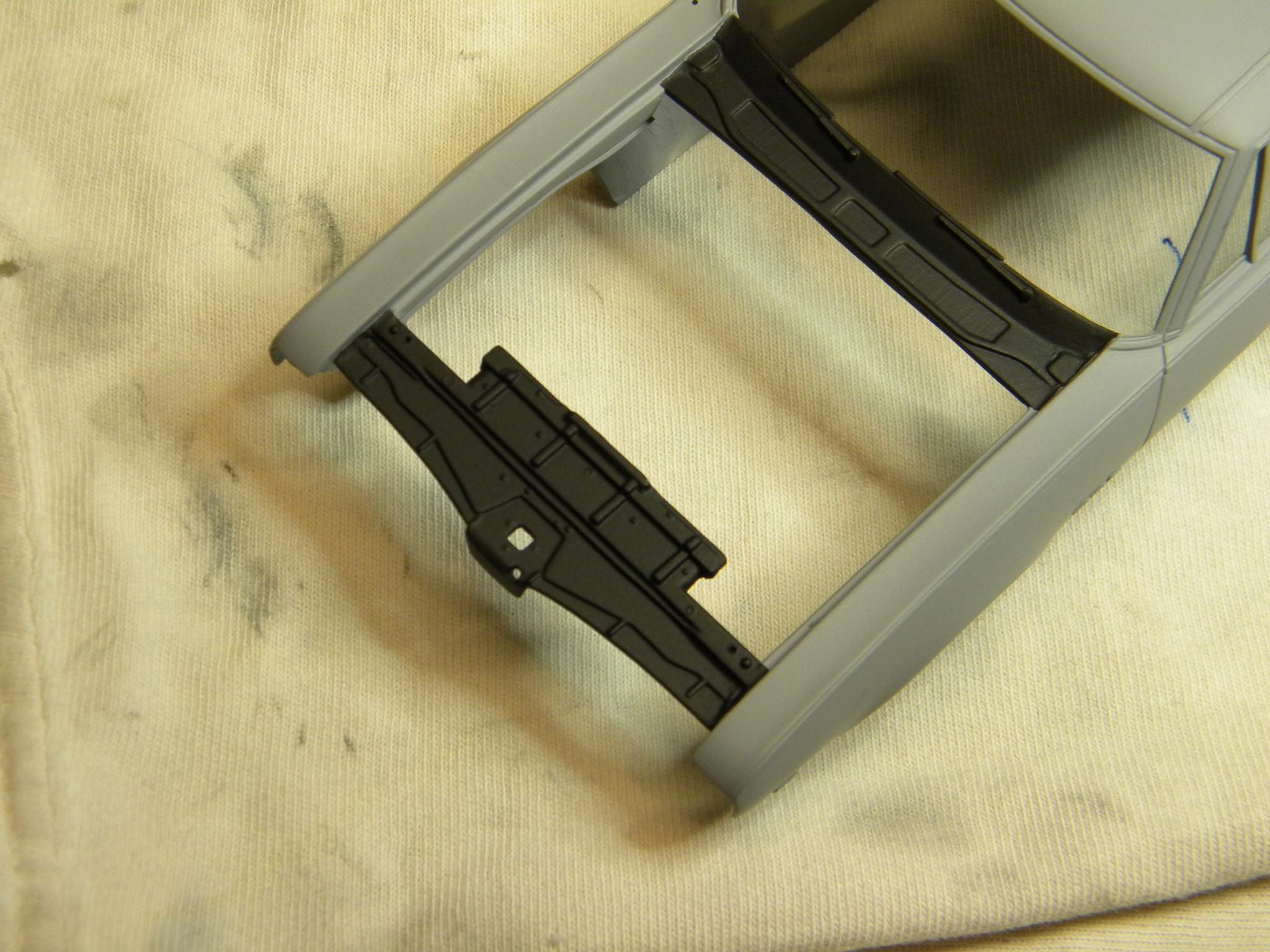

mustang1989 Posted November 18, 2019 Share Posted November 18, 2019 I wished I would've boxed in my frame rails on my Charger build. Pure oversight and it's too late to do it now but I'll be keeping my open on future builds for that. Good added touch. Quote Link to comment Share on other sites More sharing options...
StevenGuthmiller Posted November 19, 2019 Author Share Posted November 19, 2019 10 hours ago, Tommy124 said: ...which is the same kit like the AMT kit I'm currently building, if I remember that correctly from Tim Boyd's book... I'm looking forward to see you start painting, Steve! Exactly the same kit. It has been re-badged as an AMT kit in recent years by Round 2, but it was originally produced by MPC. The kit I'm pilfering is of the MPC variety. Steve Quote Link to comment Share on other sites More sharing options...
StevenGuthmiller Posted November 19, 2019 Author Share Posted November 19, 2019 9 hours ago, mustang1989 said: I wished I would've boxed in my frame rails on my Charger build. Pure oversight and it's too late to do it now but I'll be keeping my open on future builds for that. Good added touch. I rarely catch everything that I would like to do in time, but this detail just happened to jump out at me this time around. Steve Quote Link to comment Share on other sites More sharing options...

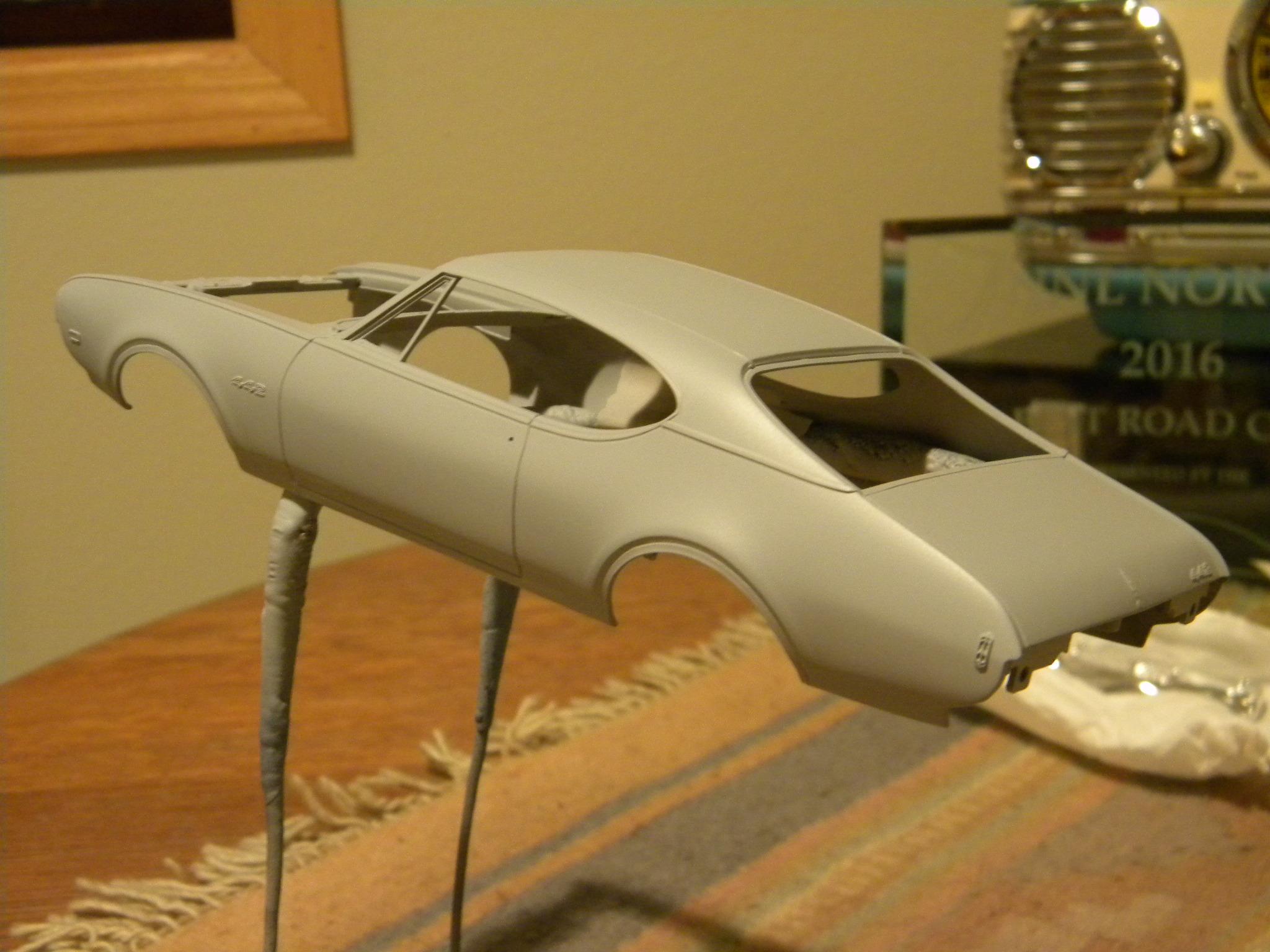

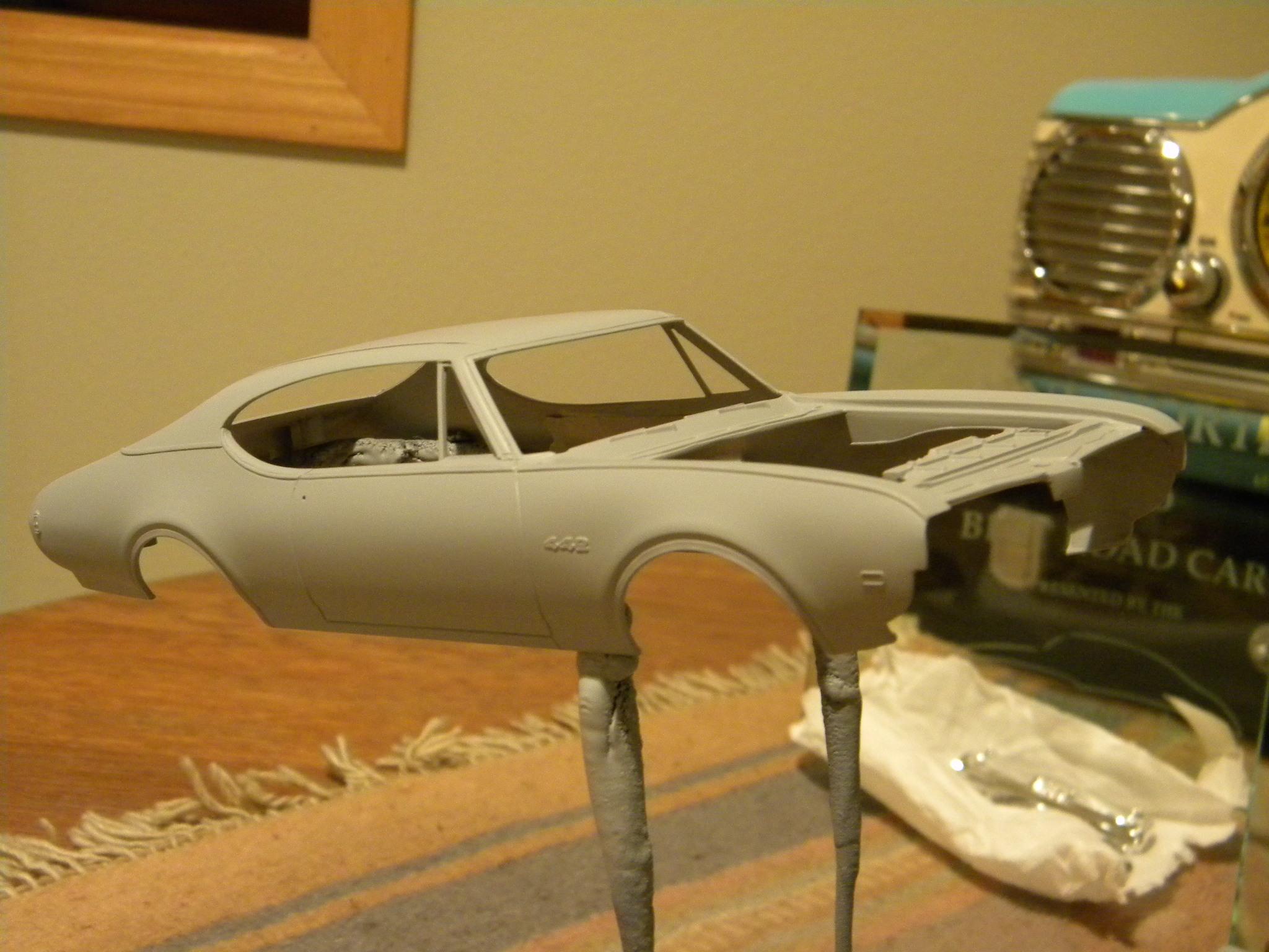

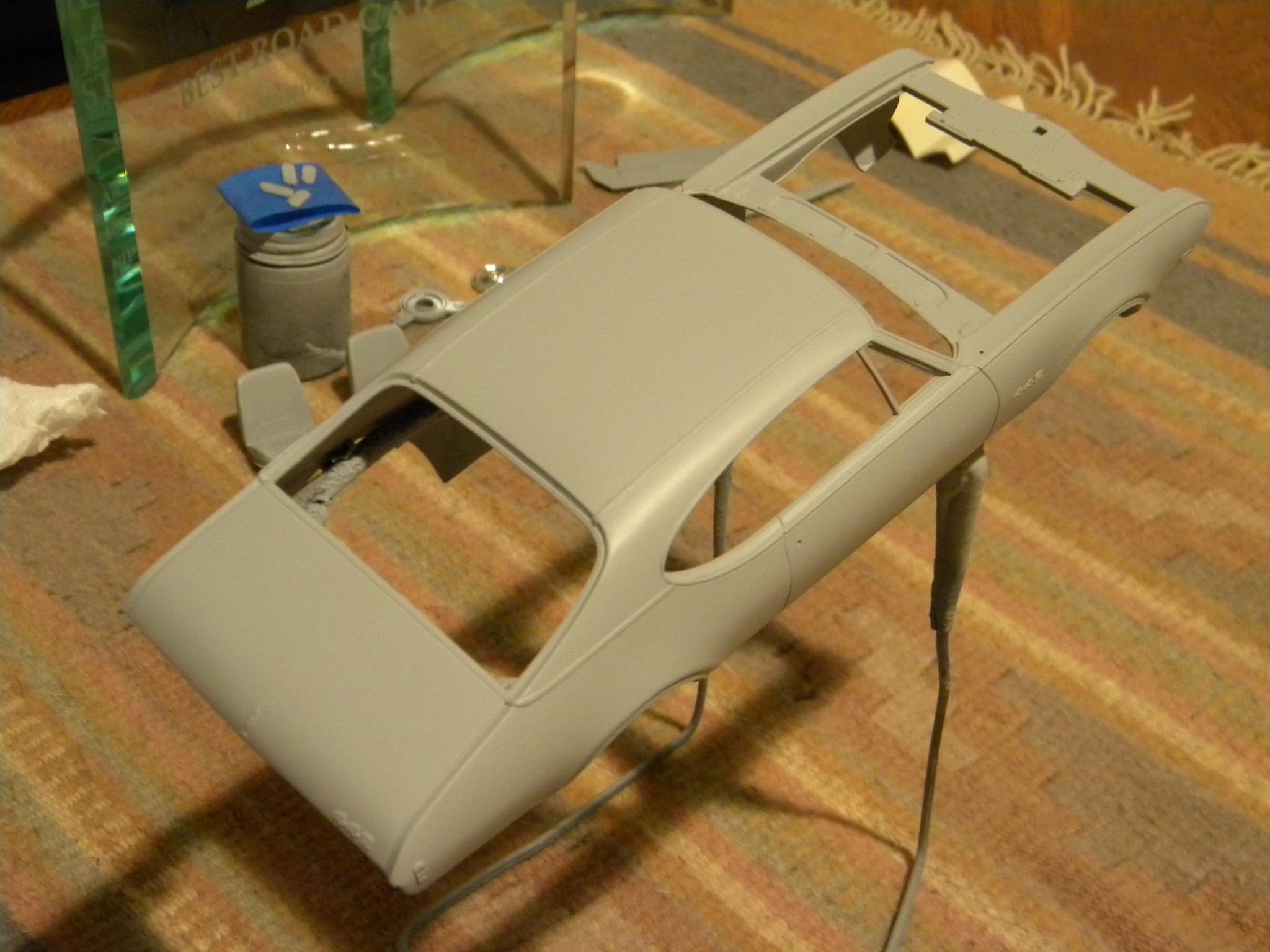

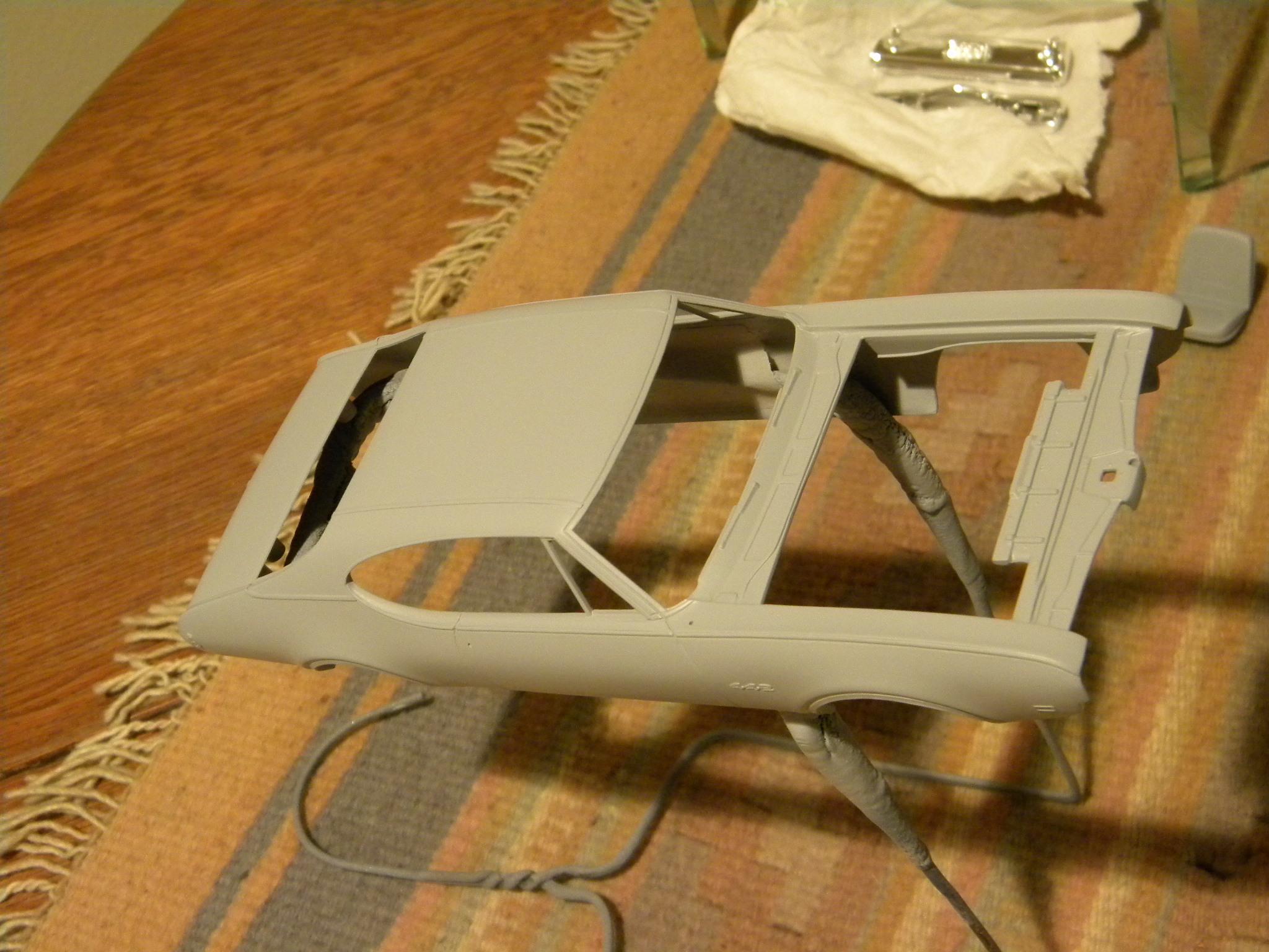

StevenGuthmiller Posted November 22, 2019 Author Share Posted November 22, 2019 Looking a bit better now that it's in primer! Steve Quote Link to comment Share on other sites More sharing options...
Bucky Posted November 22, 2019 Share Posted November 22, 2019 Looking good in its undercoat! Quote Link to comment Share on other sites More sharing options...
TooOld Posted November 22, 2019 Share Posted November 22, 2019 Love all of the extra details that you're adding to this ! It's giving me some ideas for a new project I just started . Quote Link to comment Share on other sites More sharing options...
Tommy124 Posted November 22, 2019 Share Posted November 22, 2019 (edited) 6 hours ago, Bucky said: Looking good in its undercoat! I agree! At the beginning of the build (in your post on Oct. 6th) it looked to me as if you would go for drilling the molded-in door handles open. Now they are gone. Have you changed your mind and use separate ones instead? Edited November 22, 2019 by Tommy124 Quote Link to comment Share on other sites More sharing options...
StevenGuthmiller Posted November 22, 2019 Author Share Posted November 22, 2019 10 hours ago, Tommy124 said: I agree! At the beginning of the build (in your post on Oct. 6th) it looked to me as if you would go for drilling the molded-in door handles open. Now they are gone. Have you changed your mind and use separate ones instead? Yes. Drilling one of them out was just an experiment. I have several sets of the very nice Fireball Modelworks GM Door handles that I really planned on using from the onset. I just wanted to try drilling them out. Seems it might be a viable option for some project down the road. Steve Quote Link to comment Share on other sites More sharing options...

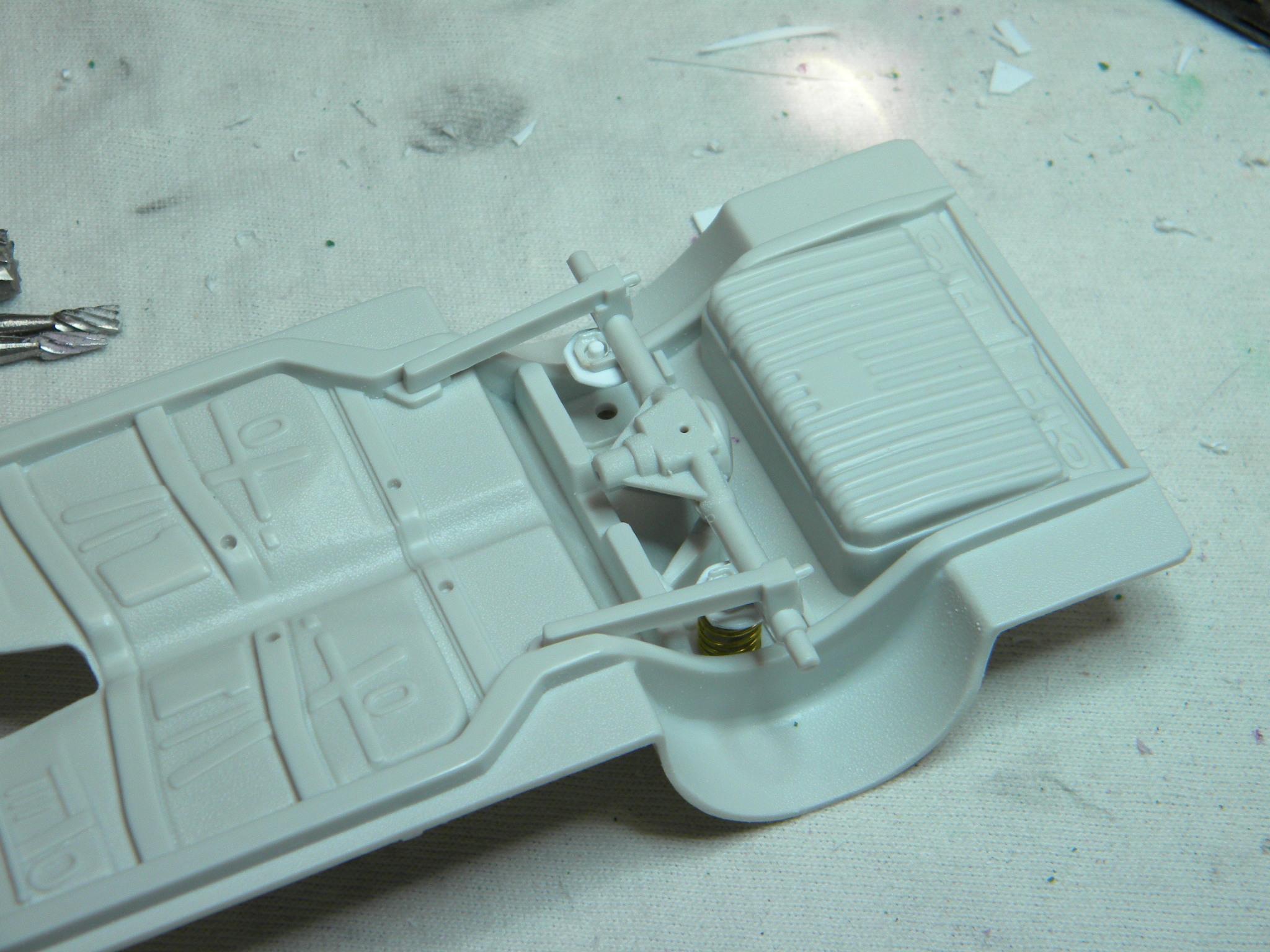

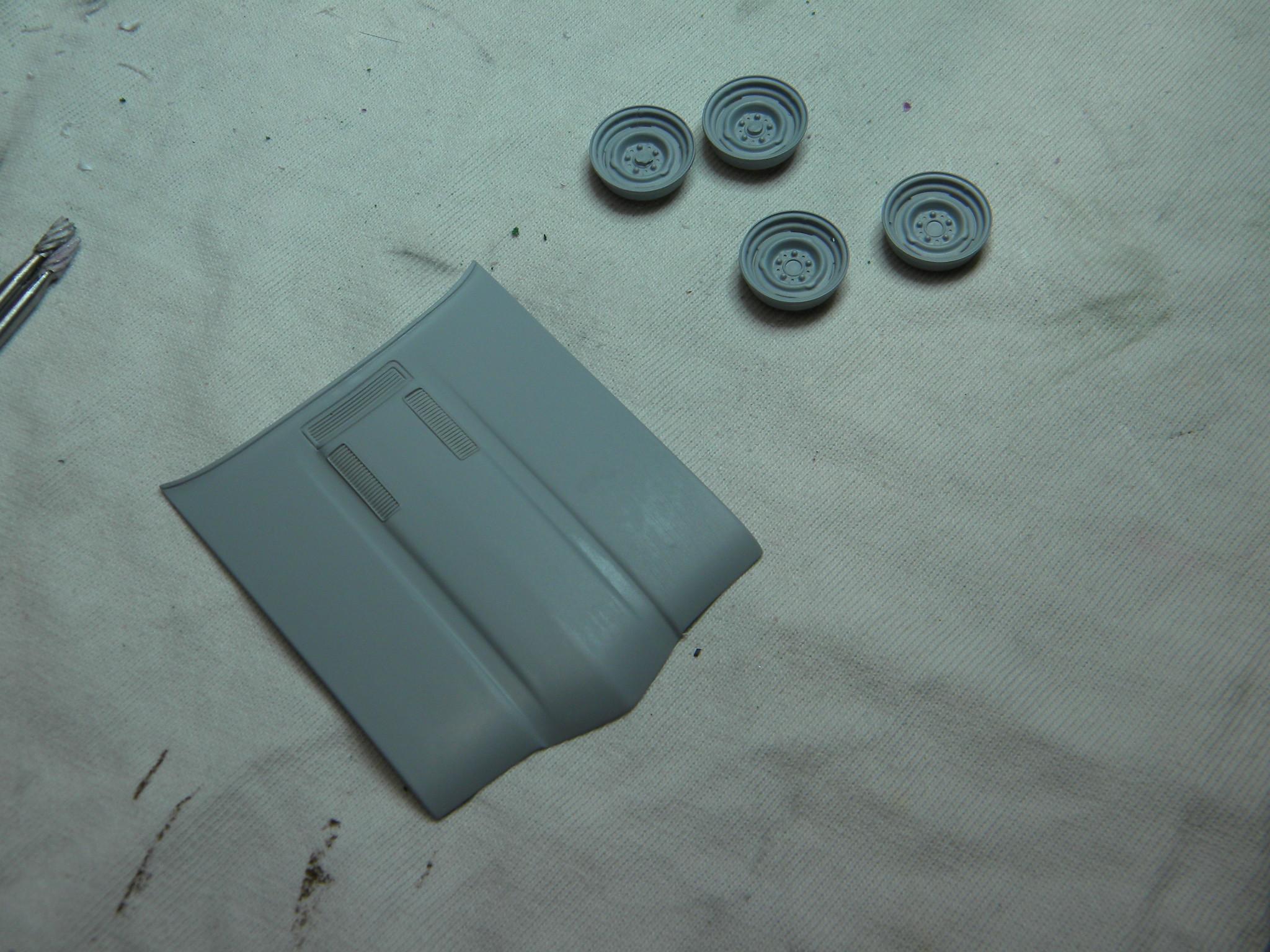

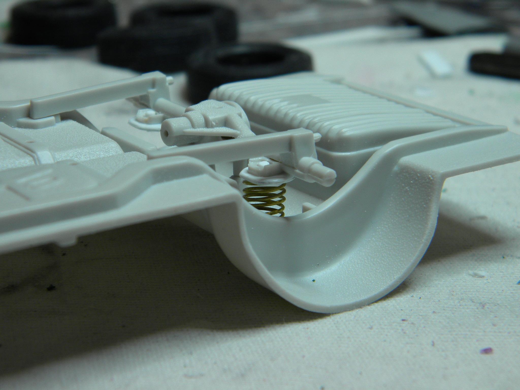

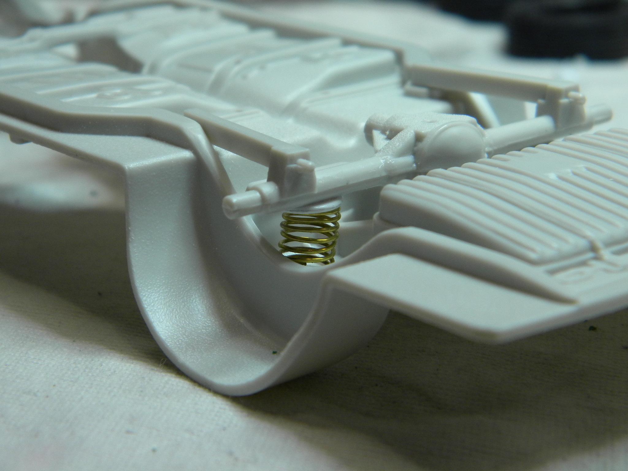

StevenGuthmiller Posted November 24, 2019 Author Share Posted November 24, 2019 (edited) Been spending the day finding some acceptable wheels and tires and working on a little refining here and there. The wheels were taken from an old Johan annual and the tires are Good Years. Same tires that were offered in the AMT '70 Monte Carlo kit. The wheels have been primed, along with the hood. A second coat will be forth coming after some sanding on the hood. I have also decided that the kit suspension springs will be discarded and replaced with wire springs. I added some "attachment points" for the springs to the rear axle as well. Steve Edited November 25, 2019 by StevenGuthmiller Quote Link to comment Share on other sites More sharing options...
charlie8575 Posted November 26, 2019 Share Posted November 26, 2019 What gauge wire are those springs? So far, really nice work. Charlie Larkin Quote Link to comment Share on other sites More sharing options...
johnwitzke Posted November 26, 2019 Share Posted November 26, 2019 You are doing a lot of great detailing work! I will be following your progress Quote Link to comment Share on other sites More sharing options...
StevenGuthmiller Posted November 27, 2019 Author Share Posted November 27, 2019 15 hours ago, charlie8575 said: What gauge wire are those springs? It's some 24 gauge brass wire that I just happened to have on hand. Seems like it should work okay for this application. Steve Quote Link to comment Share on other sites More sharing options...

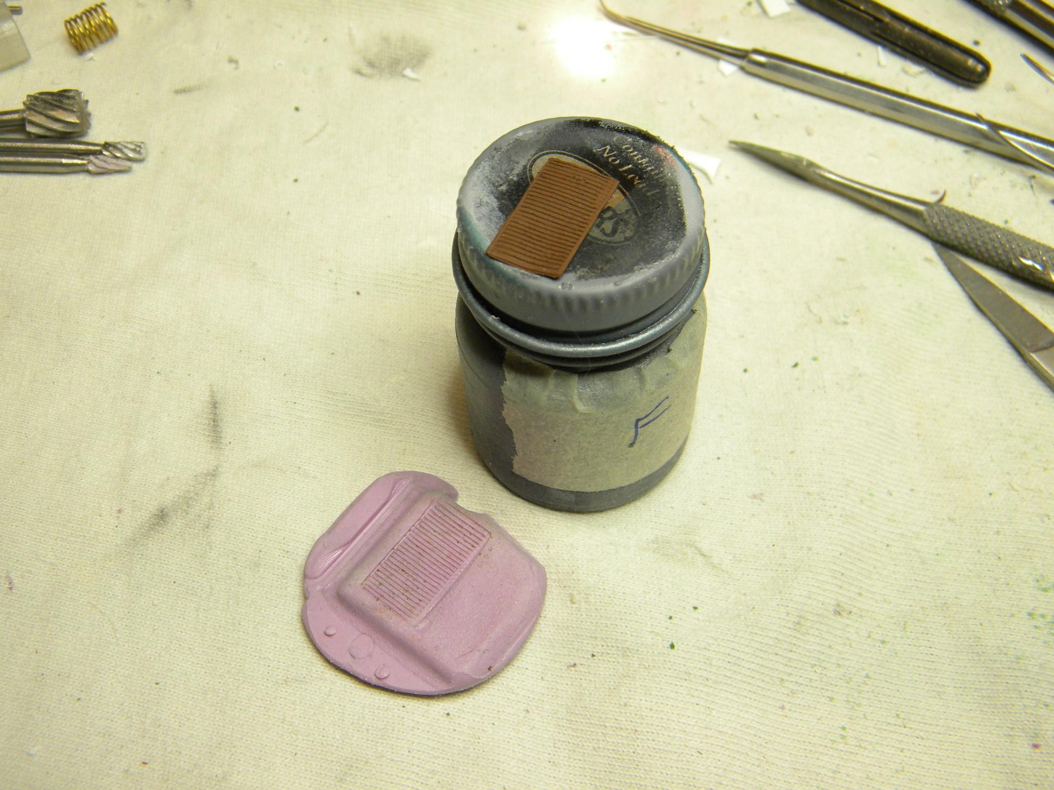

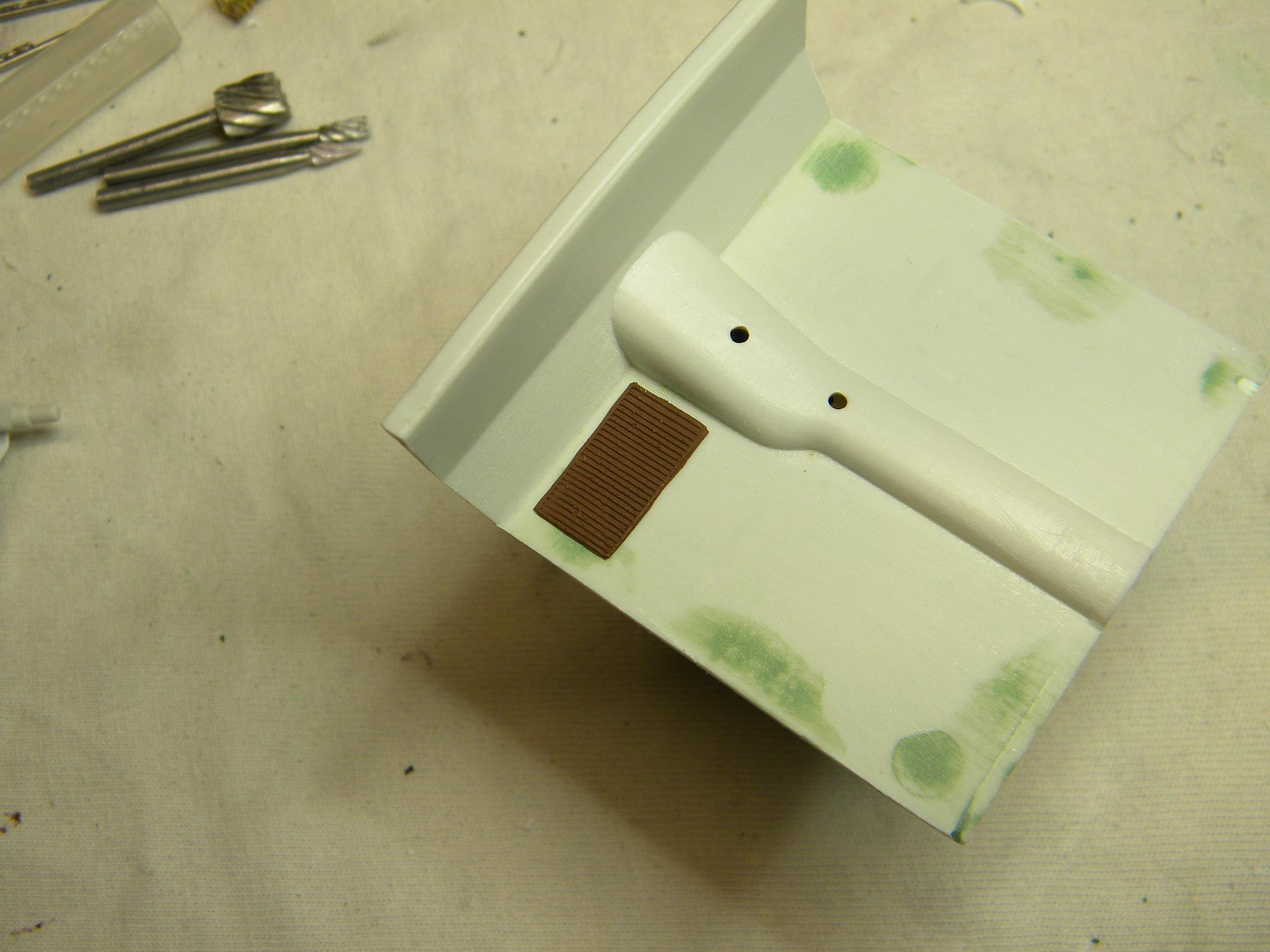

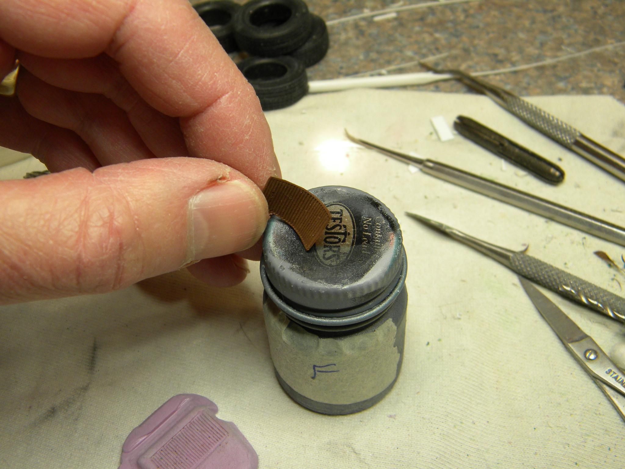

StevenGuthmiller Posted November 27, 2019 Author Share Posted November 27, 2019 Replicated the "carpet protector" mat. I will post the "how to" in the "tips and tricks" section. Steve Quote Link to comment Share on other sites More sharing options...
Bucky Posted November 27, 2019 Share Posted November 27, 2019 Very nice detail! Quote Link to comment Share on other sites More sharing options...

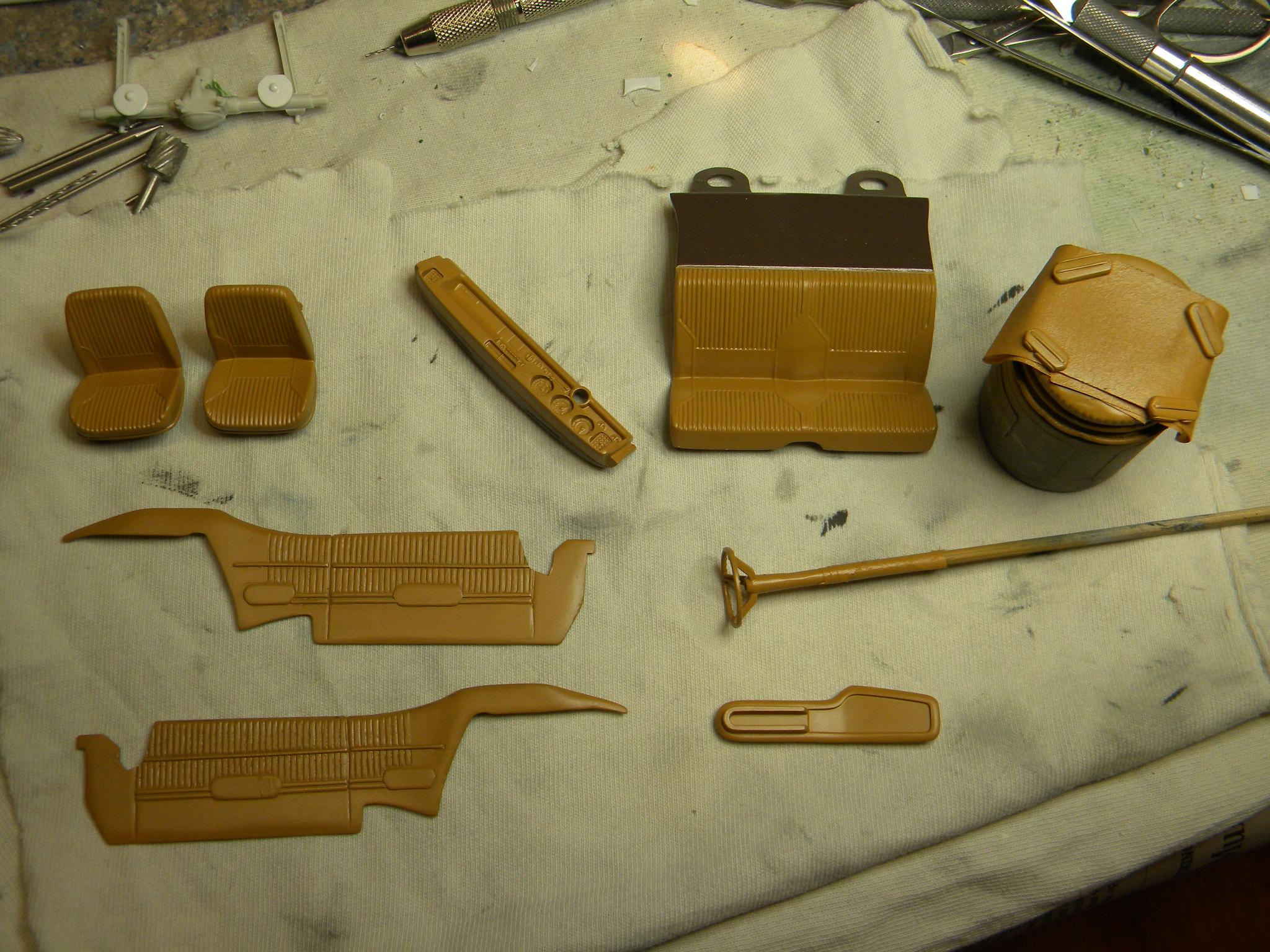

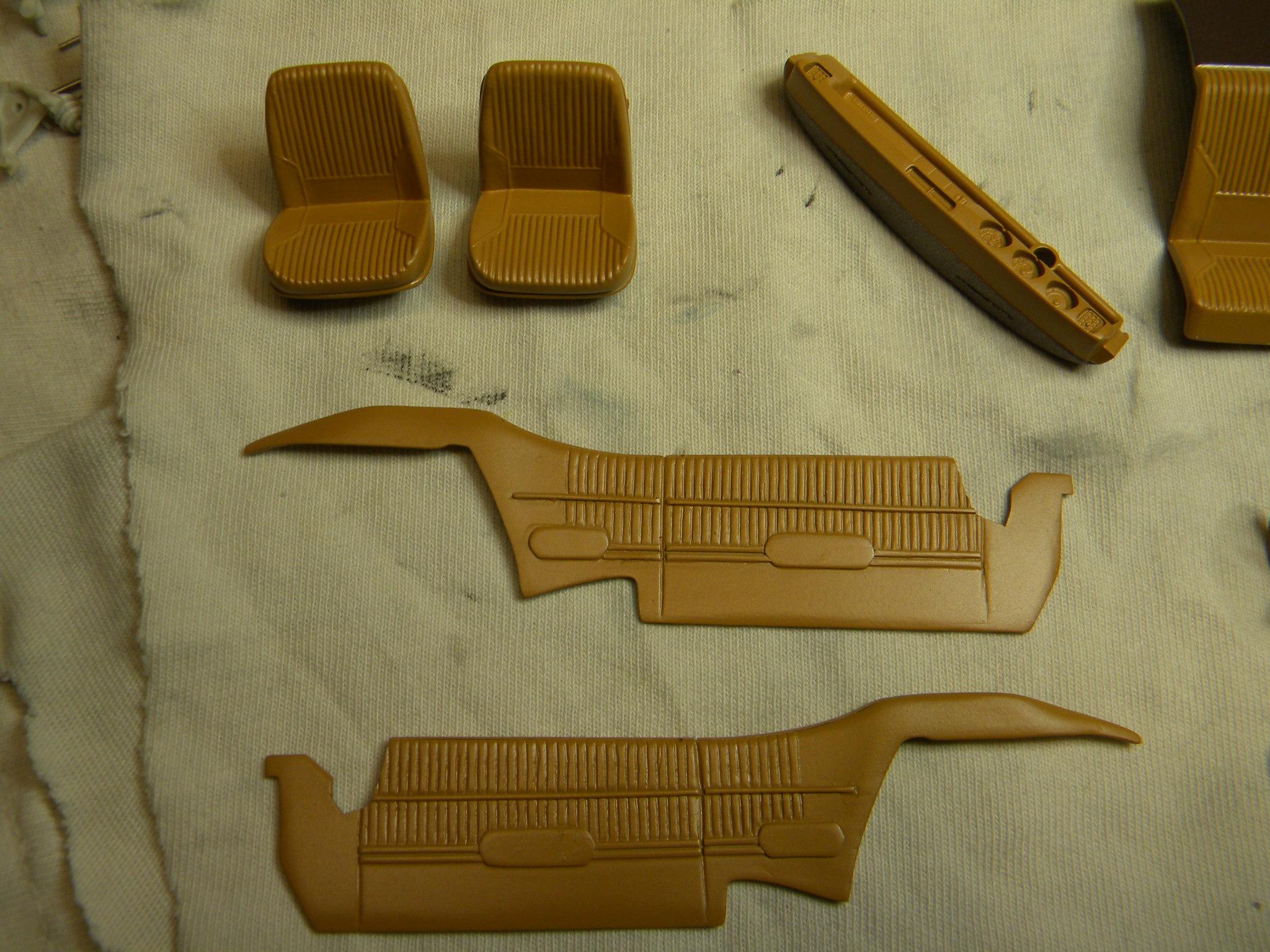

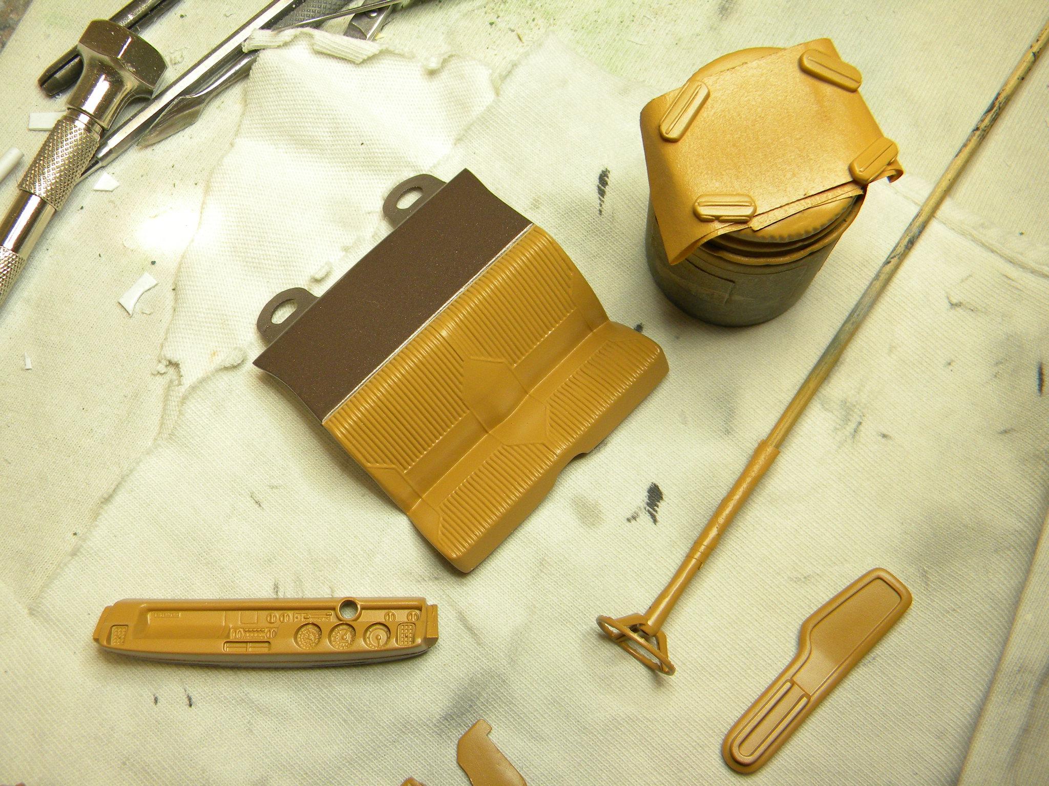

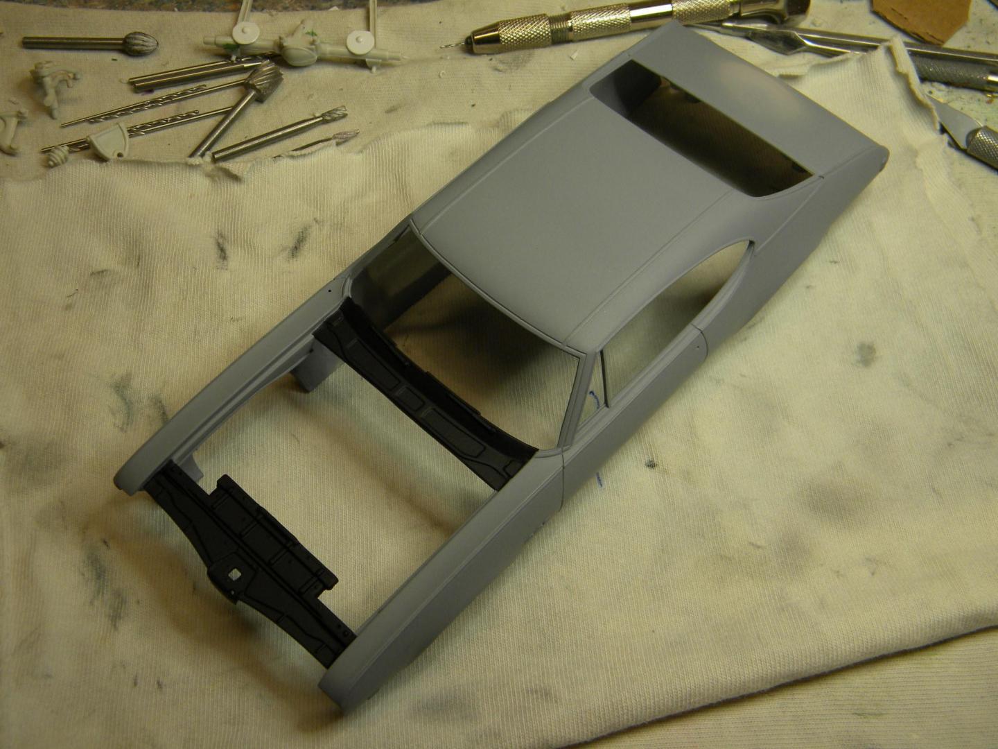

StevenGuthmiller Posted November 30, 2019 Author Share Posted November 30, 2019 I finally am at the point where I can begin throwing some color around, and being as we are smack dab in the middle of a major snow storm here in west central Minnesota, it's a perfect opportunity to spend some time at the bench! I got the saddle color and a coat of clear on the interior parts, as well as some medium brown on the front half of the dash and rear package shelf. I also got some black shot on the engine bay area. That will get one coat of clear during the course of clear coating the body to give it more of a matte finish. The top will get masked off and painted later when all of the painting is done on the body. I still have not made a hard determination as to what color the top and fender stripe will be. White was a consideration, but being as I decided to go with a saddle interior, I think black would be more appropriate. Steve Quote Link to comment Share on other sites More sharing options...
Bucky Posted December 1, 2019 Share Posted December 1, 2019 Great progress, Steve! Would a dark brown color be suitable for the vinyl top? It may not have been a color choice in '68, tho. Quote Link to comment Share on other sites More sharing options...
