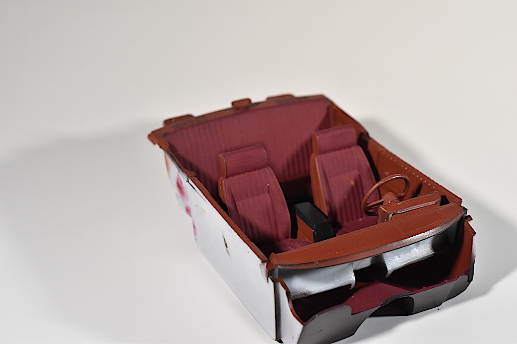

Hey Guys,
I took your feedback, and did my best to apply it to this model, here is the underside of the chassis.
I tried to get a few different shades of black and dark gray on the different components. It required some very intense masking.
And as a bonus, here is the interior, I looked at a lot of pictures and tried to simulate the different textures and colors of the seats and other parts of the interior
Your help is greatly appreciated. All the pictures I found of the underside of G bodies were very good for used and weathered reference, but my goal is a new car for this one.
I am still polishing the body, and I will post pictures of the finished model when the time comes.
Thanks again!

Some people will argue what's correct on which day, but ultimately, your model is cleanly built, neatly painted, and looks great, so you did very well.
The only thing which I'd change would be the fabric(?) areas on the seats. I want to say the fabric was velour-like, but maybe not. Tough to replicate in scale no matter what, but I would add a bit more gloss and a hint of texture.

2 hours ago, kurth said:
Hey Guys,
Thanks again!
Glad to see you got back on this one. The chassis looks showroom fresh. The interior looks very nice. As Casey mentioned the fabric on the seats is or was a very fine texture almost like the old mohair interiors of old but not itchy to sit on. Your picture looks like you got the vinyl portion done correctly as the seating surface was the only cloth area on the seats and all the other parts were done in vinyl. The color you used also looks good. Years ago I built a model of ours and I used Model Master Enamel #2904 called Kiln Red. I think that they dropped that color several years ago since I have been unable to find any. I still have 1 can laid back for the future. What ever color you used looks great to my eye for what that's worth.  Please post your body pictures when you get to that stage.

Speaking of accuracy, most likely that center console top would have been red , not black
Share this post
Link to post
The pad on the top of the console was the interior color. The remainder of the console was what they used to call Piano Black and had a Red stripe along either edge. The panel on the passenger side dash board was done the same way also.as well as the face of the gauge pod.

You are right, it looks like I goofed on the top of the console. I consulted reference pictures again and sure enough it is interior color. not sure why I painted it black.  I know I got the steering wheel color wrong too.  🤷‍♂️

Chassis looks great. Close to what an under coated car would of looked like or what a restored car would look like with new floor boards.  I had a 79 Malibu and when the undercoating peeled off the floorboard, the color was a mix of overspray body color and a dark gray.
The interiors of these cars used the standard GM fabric at the time. It wasn’t velour but it wasn’t a smooth cloth either.  I had the same fabric in my two 80’s Trans Ams. It’s hard to describe and replicate as the color would shift depending on which way you rubbed the cloth. I did see you painted the door panels the same as you did the dash which was a hard vinyl. The upper part of the door panels, front and back, were fabric colored if I recall.

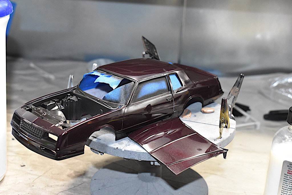

The next step is to paint the black trim on the body. This required a lot of masking

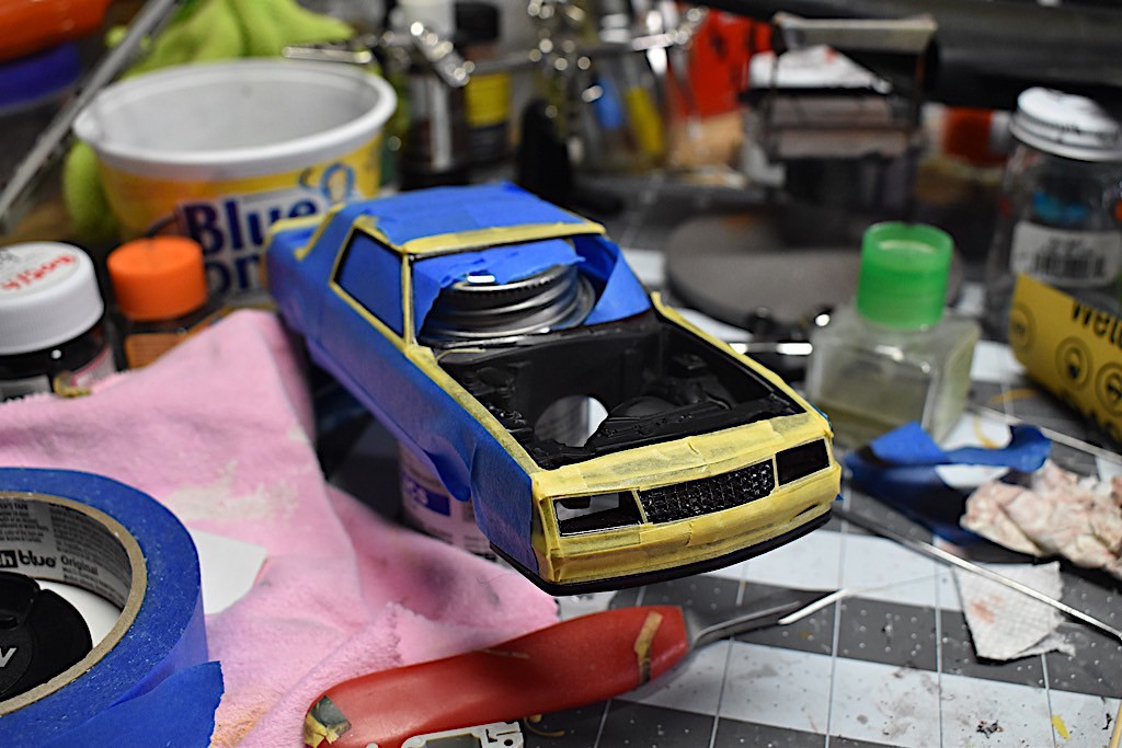

Here is where I did the "fine masking"
and then I filled in the rest of the body with tape
almost looks like a blue and yellow NASCAR stock car
And with the semigloss black applied tape removed, you can hardly see the difference!
I still need to apply decals, and detail paint under the hood, things like the overflow bottle, wiper fluid bottle, and so forth and so on.
See ya next time
