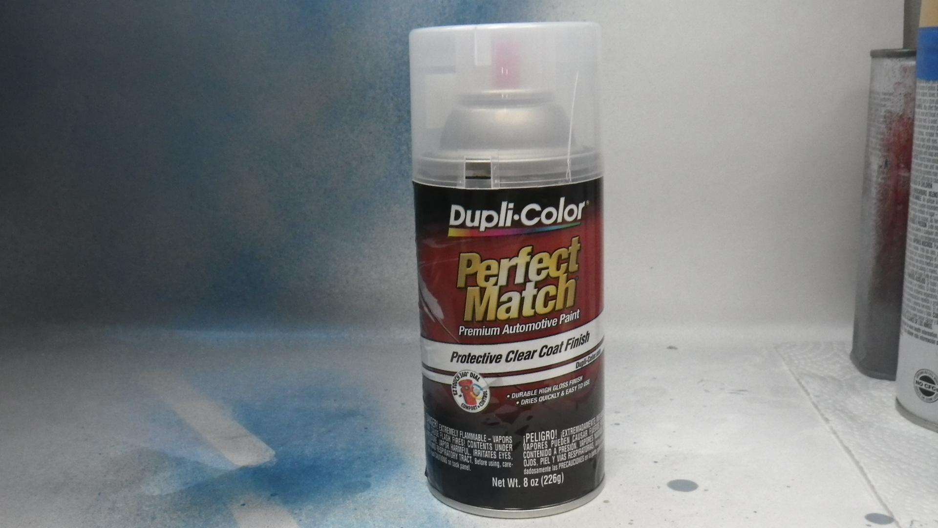

mr moto Posted October 12, 2019 Share Posted October 12, 2019 Two coats of this... ...worked on decals made in 1959. Quote Link to comment Share on other sites More sharing options...

Greg Myers Posted October 17, 2019 Share Posted October 17, 2019 On 10/11/2019 at 6:17 PM, mr moto said: Two coats of this... ...worked on decals made in 1959. Looks good Mr Moto, where might one get some of this ? Quote Link to comment Share on other sites More sharing options...
mr moto Posted October 17, 2019 Share Posted October 17, 2019 2 hours ago, Greg Myers said: Looks good Mr Moto, where might one get some of this ? Wherever Duplicolor is sold. I usually get mine at Pep Boys but Auto Zone, O'Reilly and other car parts stores carry it in this area, also. Quote Link to comment Share on other sites More sharing options...
