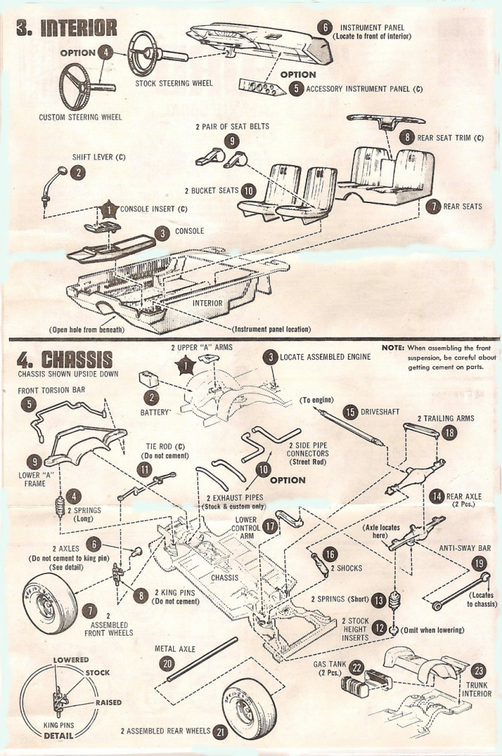

Can you post a pic of the instructions that involves the suspension? You may be able to just flip the front spindles and block up the rear......

These instructions show that there is already provision for lowering the car provided by the kit.
If this is the model you have, you simply omit the parts #12 in the rear, and select the "lowered" position hole in the front spindles.

Take a close look at that detail inset - don't they have the raised and lowered positions backwards? Remember this is an upside down view.

Use the highest position on the front king pin parts to check how low the front end goes with the kit parts- test fit. If it isn't low enough, it shouldn't be too hard to scratch build some king pin replacements that allow the front to sit lower than it does out of the box.
For the rear axle, it comes with inserts to raise the rear springs (part #12) for stock height, and omitting these will lower the rear end- a pair of scratch built styrene lowering blocks mounted between the trailing arms (part #18) and the differential should get things down some in combination with trimming down the springs...you'll want to shorten the shocks too. If the control arms and driveshaft hit the floor pan with your chosen amount of lowering in the rear, notching the floor pan around the control arms and deepening the tunnel the driveshaft goes through with a round file will help.
