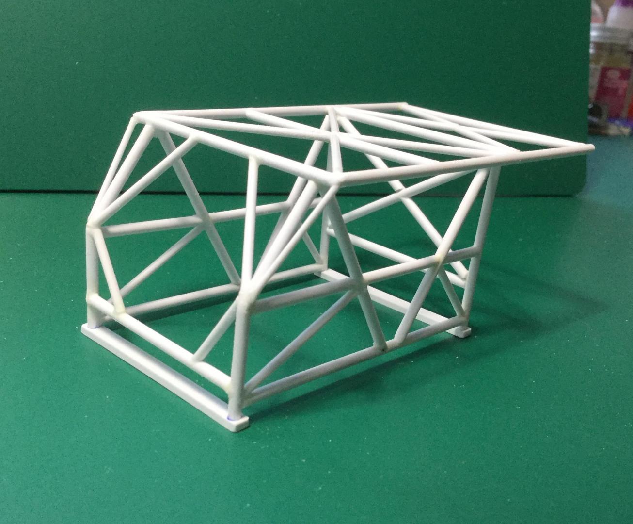

Been following this same technique with angle cut and round file. Never thought to use a triangular file to set the position for the round one, perfect hint!  That will save a lot of aggravation and plastic rod. I usually use a set of dividers to measure the length on the rods and to match them up. The most adventurous construction I've undertaken was the cage for my K5 Aussieball entry.
Cheers Misha
