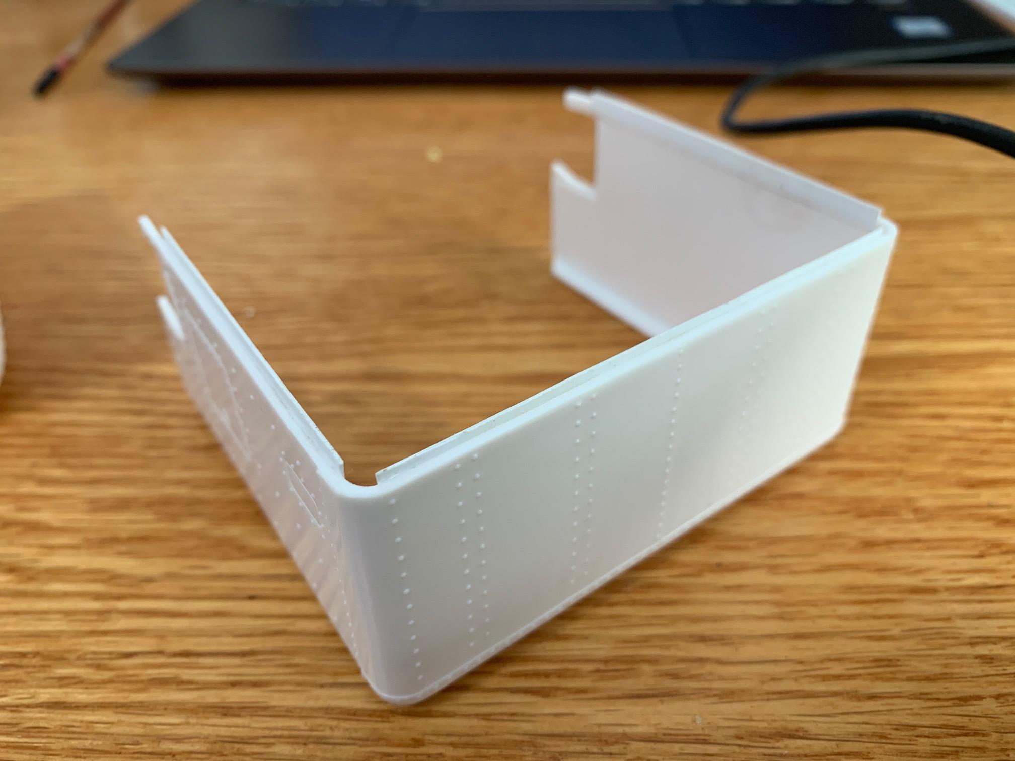

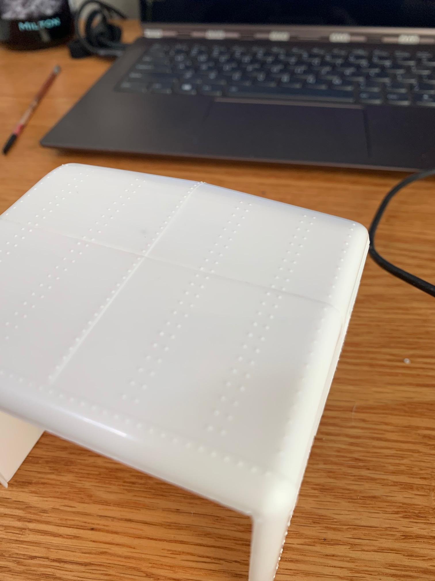

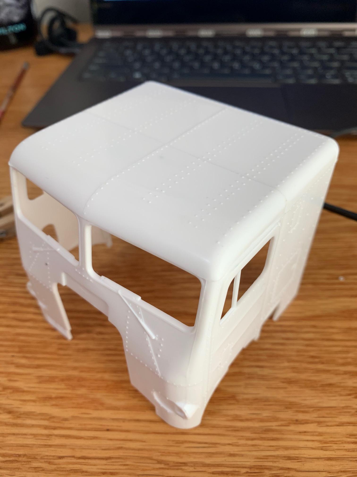

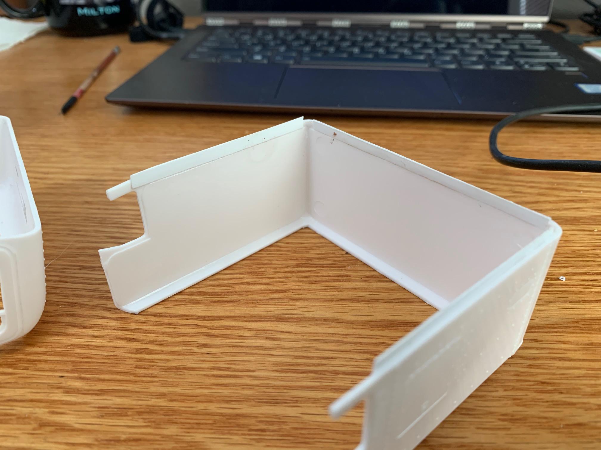

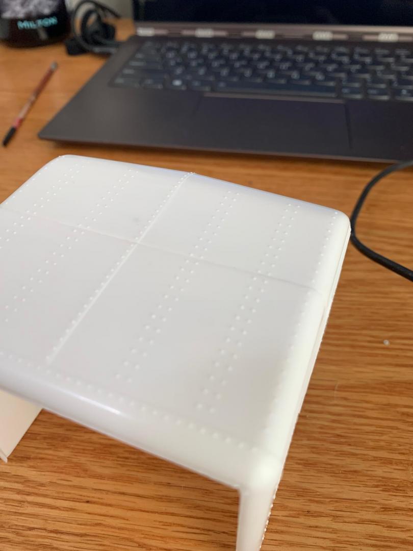

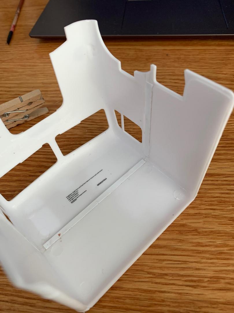

Oldmopars Posted October 29, 2019 Share Posted October 29, 2019 I cut some small thin .020 sheet and glued it to the inside of the cab. This acted like a guide to align the two cab halves. I also sanded the cab halves flat on a flat surface before gluing anything. I hope the pictures with help. In the end the cab went together really easy and the fit is great. Quote Link to comment Share on other sites More sharing options...

JerseeJerry55 Posted October 30, 2019 Author Share Posted October 30, 2019 15 hours ago, Oldmopars said: I cut some small thin .020 sheet and glued it to the inside of the cab. This acted like a guide to align the two cab halves. I also sanded the cab halves flat on a flat surface before gluing anything. I hope the pictures with help. In the end the cab went together really easy and the fit is great. Thanks again for showing me your cab assembly. I assume that the strip cannot be seen at all. Am I correct? Quote Link to comment Share on other sites More sharing options...

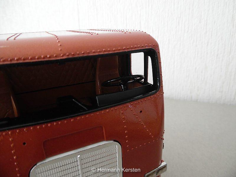

Hermann Kersten Posted October 30, 2019 Share Posted October 30, 2019 (edited) Hello Jerry, I did this in the exact same way as Scott did, i used 0,4mm x 4mm styrene strips. If you glue the curtain in, you will not see these strips. Make sure, that you grind and sand the cabin surfaces well and straight. And with the curtain... Good luck with your cabin. Hermann. Edited October 30, 2019 by Hermann Kersten Quote Link to comment Share on other sites More sharing options...
