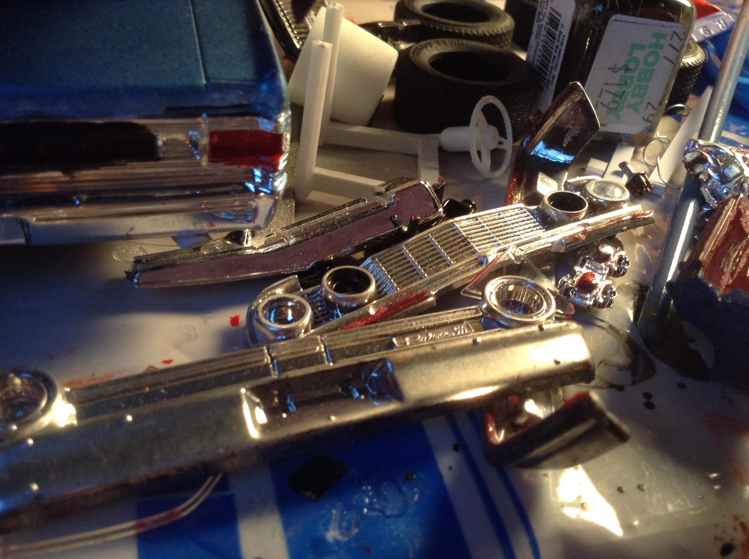

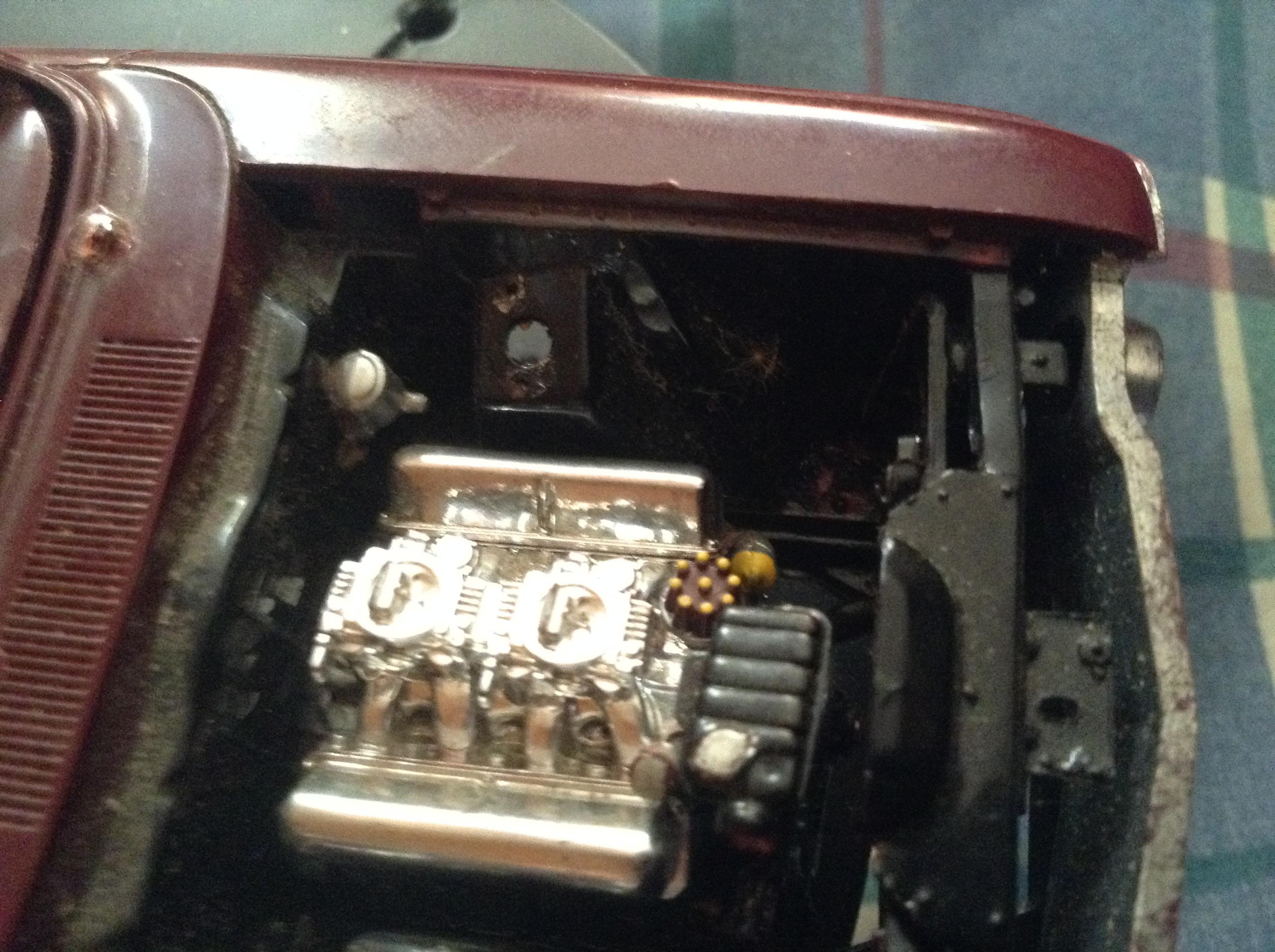

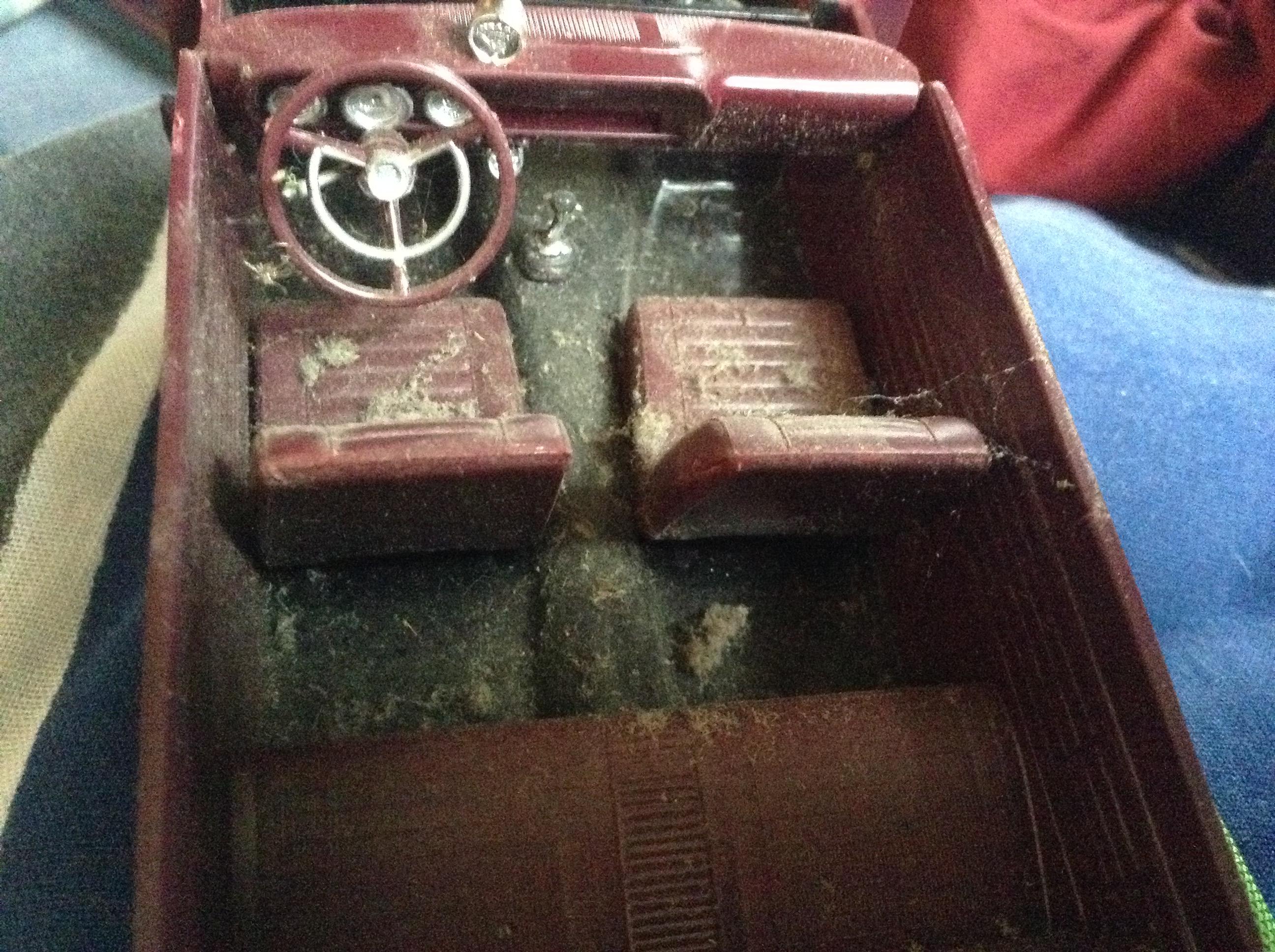

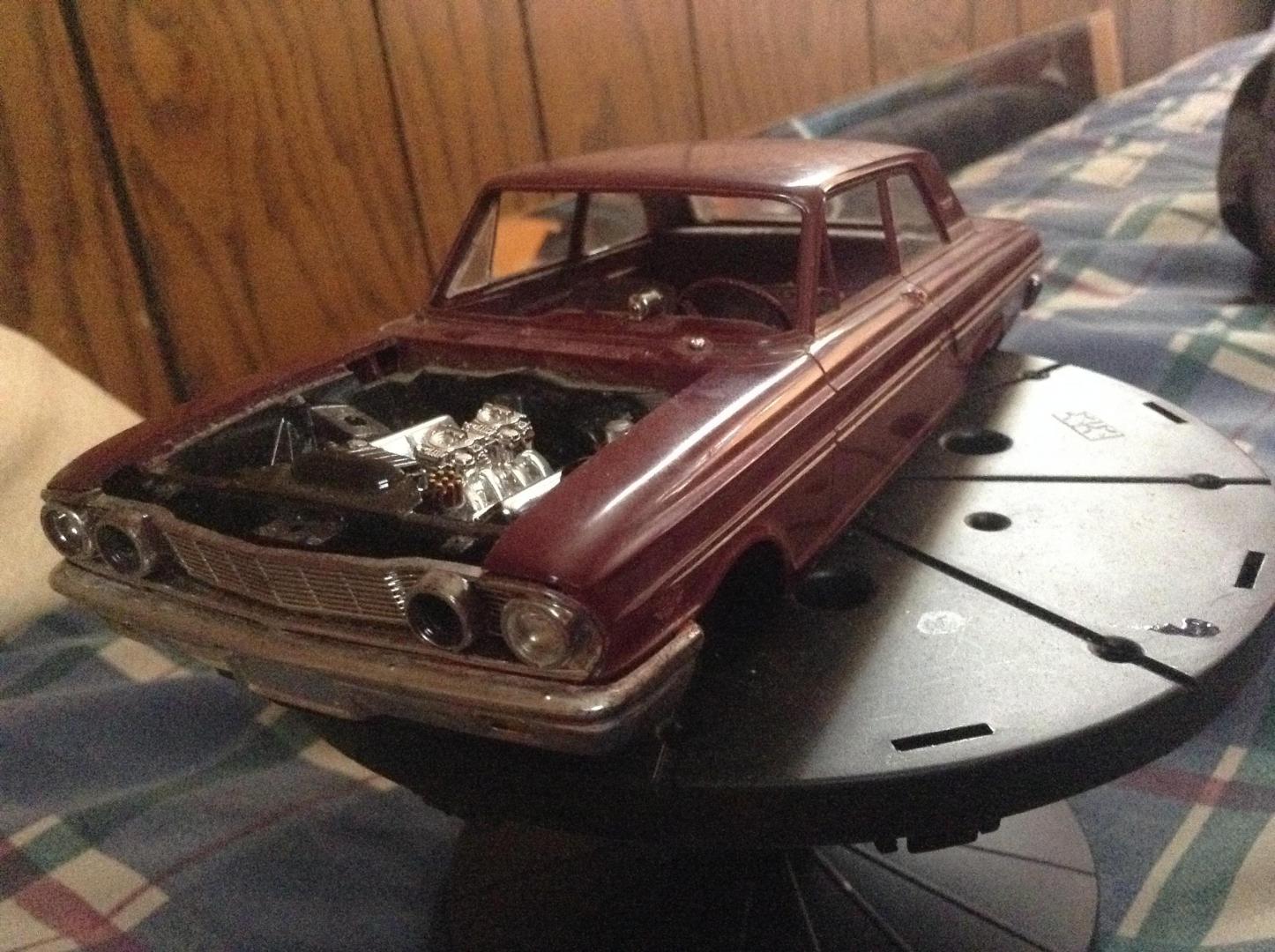

Well Christmas is next month and i was thinking what would be nice to get my dad I thought to restore his 64 fairlane he built around my age im 14 i hope he likes it when its done  p.s im not telling him im doing it
i got the car apart now time for cleaning
Edited by MININORTHFORDMAN
I added two of the same image

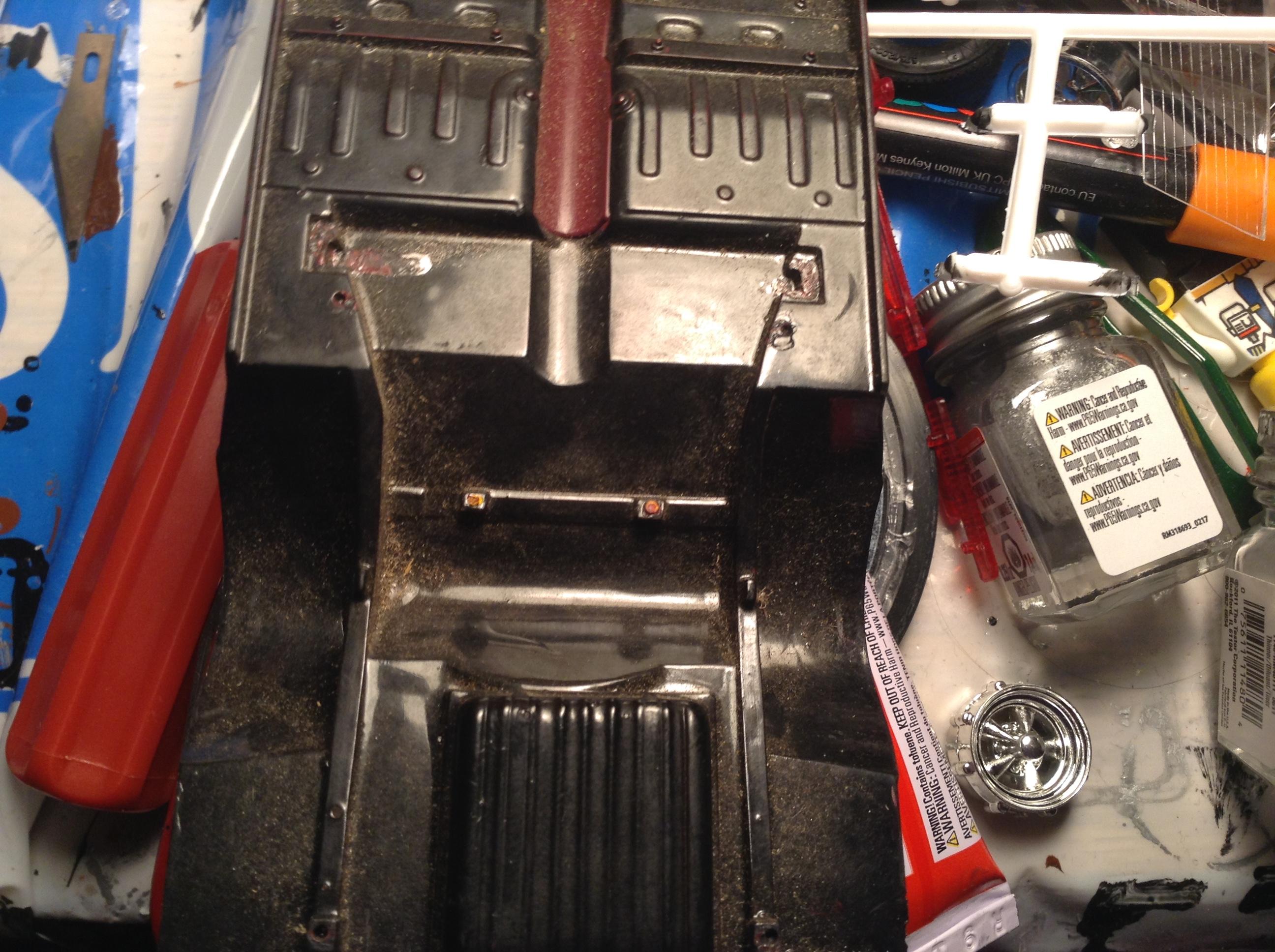

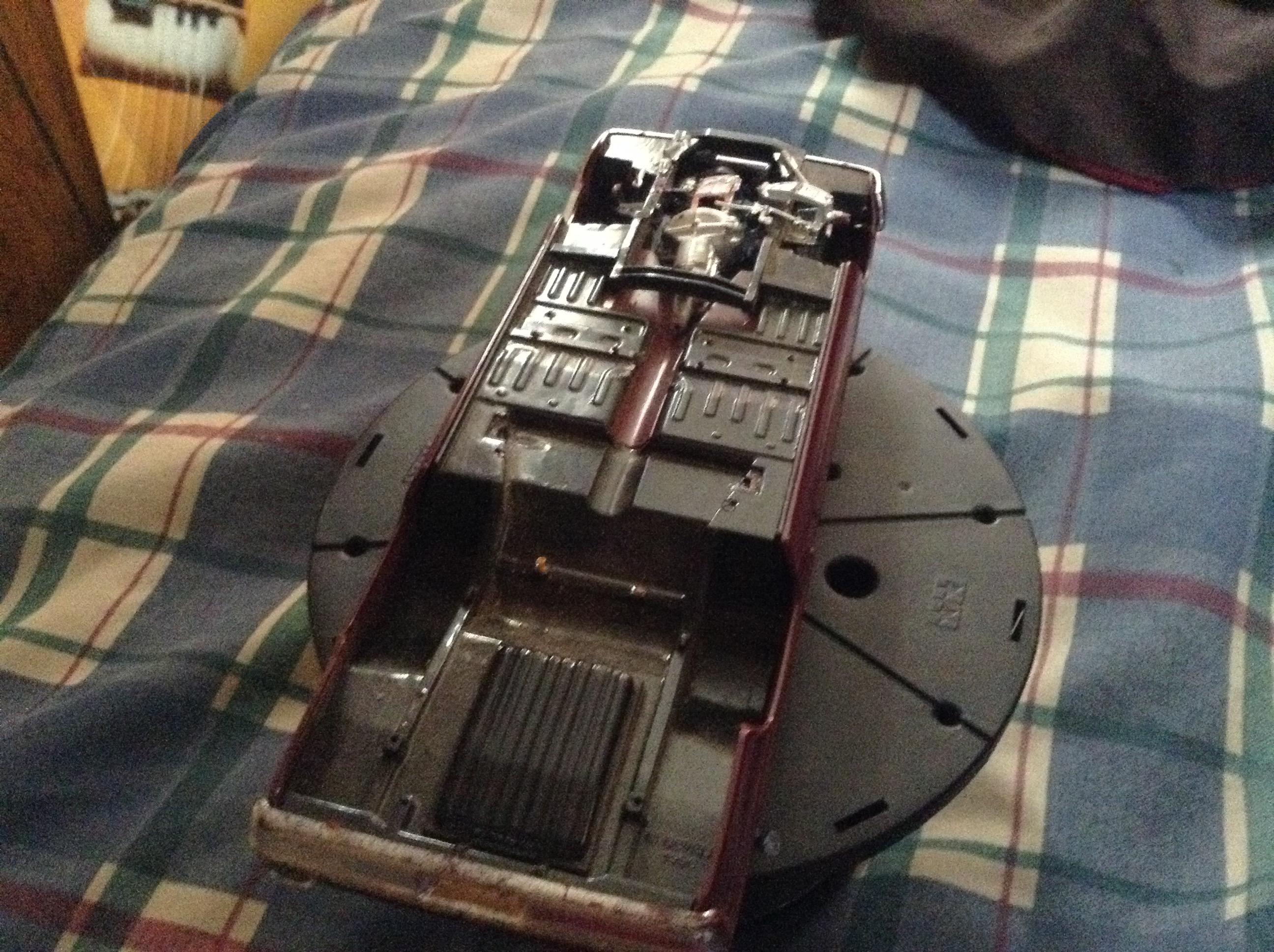

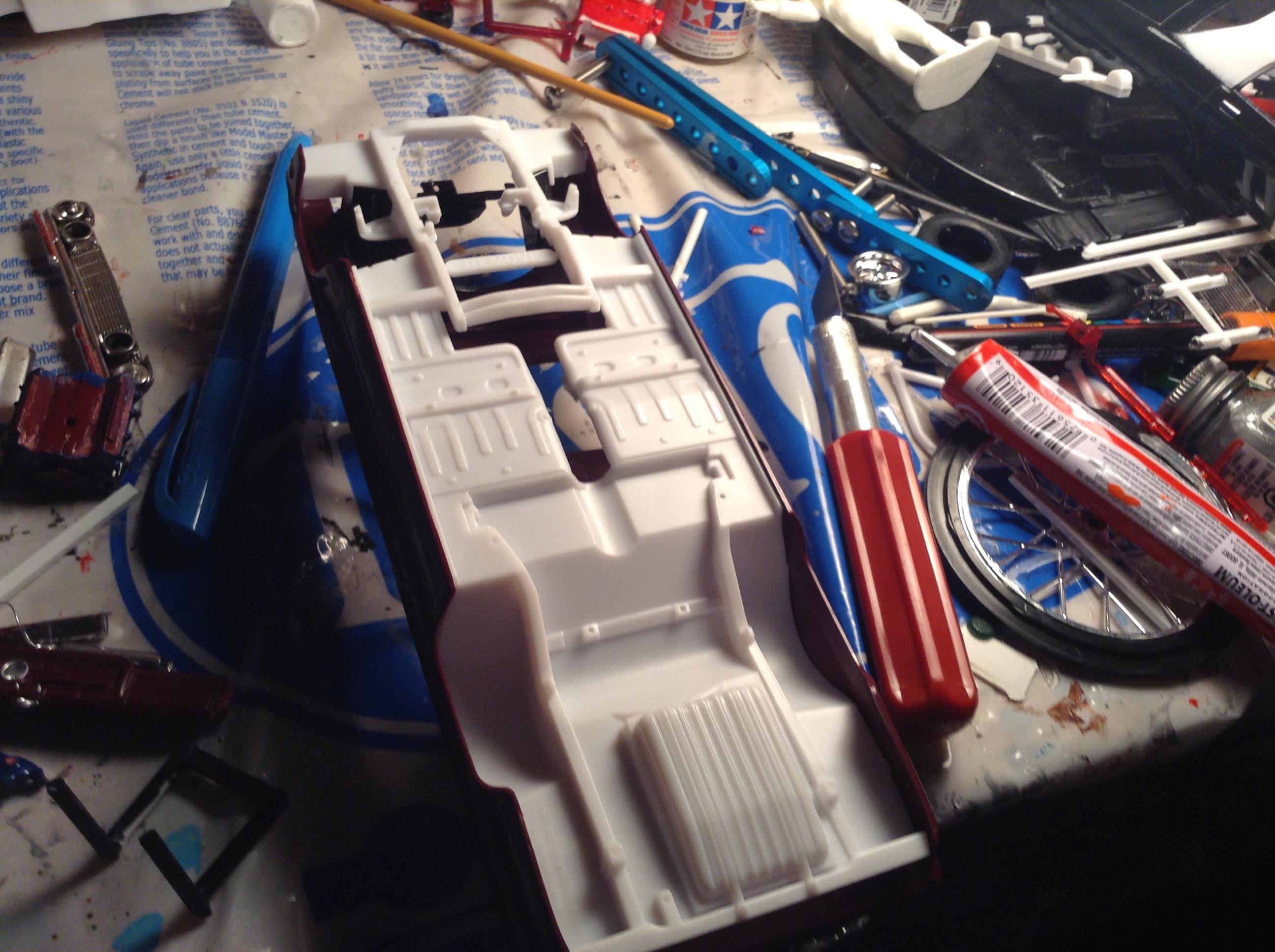

56 minutes ago, MININORTHFORDMAN said:
i need some  advice should i use the original chassis or use the new one from the new kit? I don't know how to get the pieces of shocks out
Drill the remainder of the shocks out from behind or top side of the floor. Just how bad a shape is the original chassis ?
thats really the only spot the rest has glue spots
If the frame has glue damage, depending on how bad it is, try sanding the surface as smooth as possible then use a small amount of filler to the areas that are below the surrounding level frame. This will all take some time and effort but give you satisfaction if you are able to save it. The alternative is to of course replace the frame if you have one. Seems like a waste to buy another kit just to get a frame unless there are other parts that you can use on this build.
This is such a cool thing to do and it looks like a great project so far. Honestly, what espo said is I would do in drilling out the area where the shocks mounted up and if needed insert a piece of styrene on the back side of the hole so you can insert new shocks.

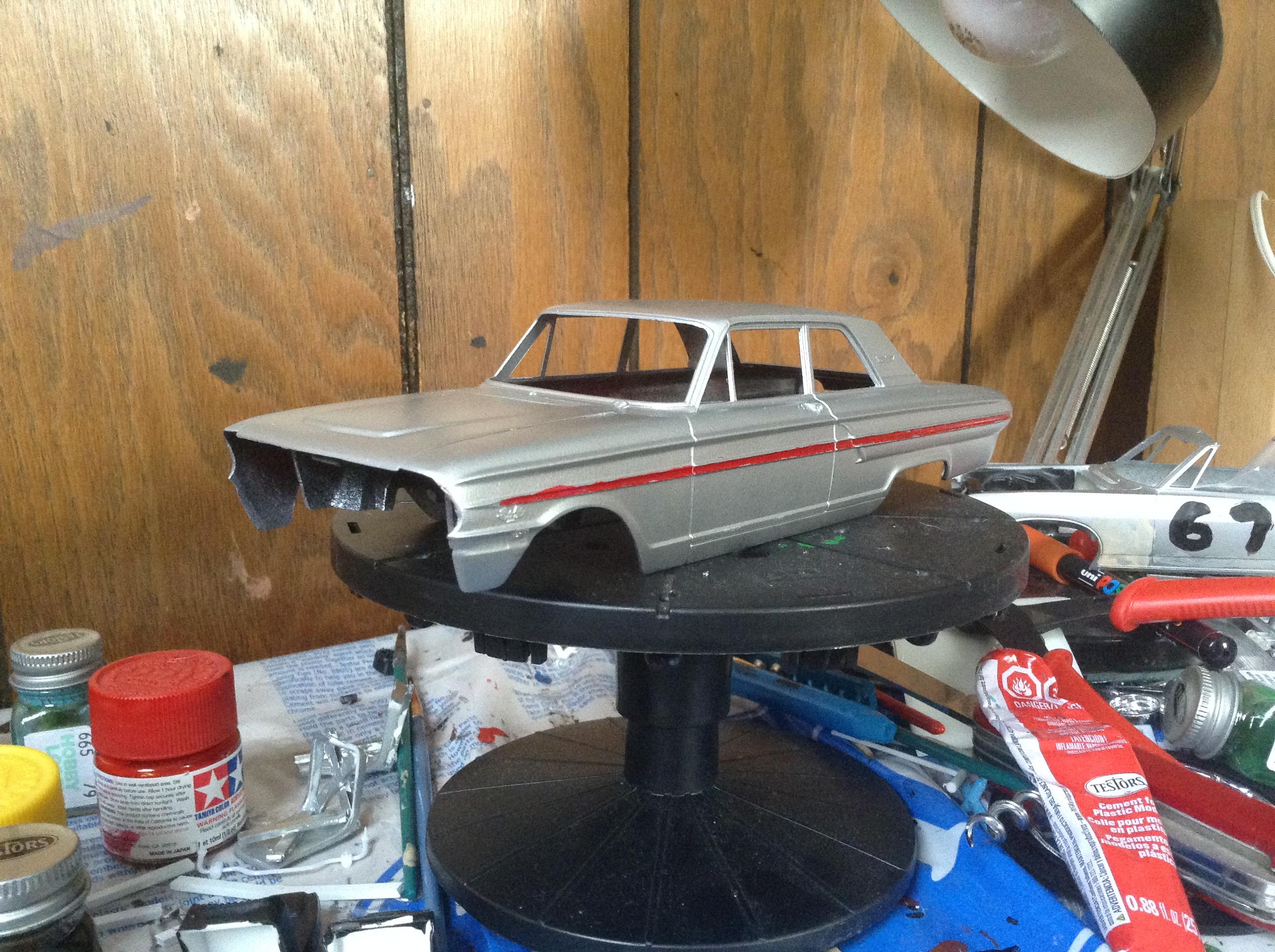

Now i have the chassis done and in paint the hardest part for me was making the red stripes which i was hoping too do, im glad its over now that was the scarest part of the build so far. The chassis phot will come soon
