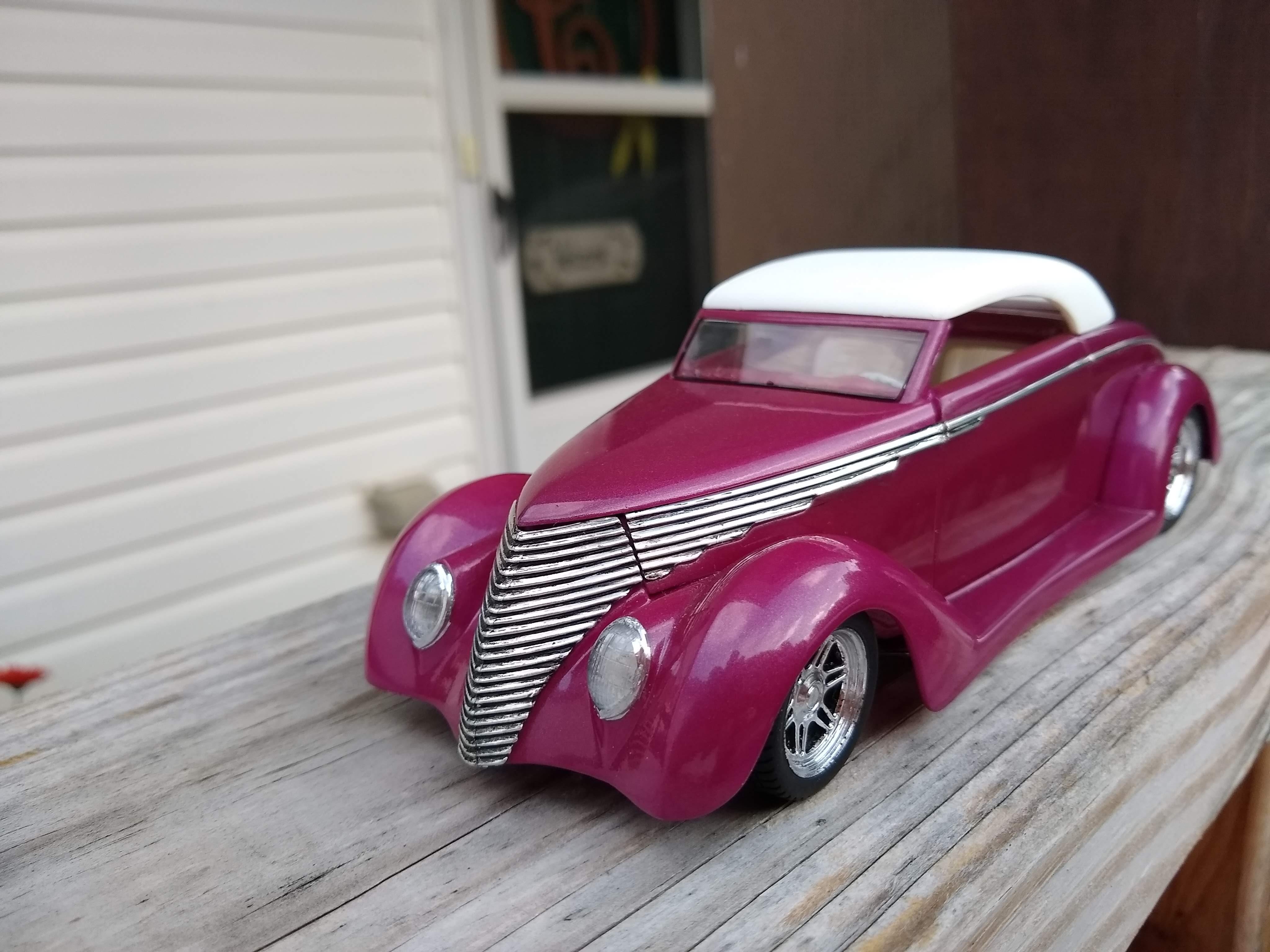

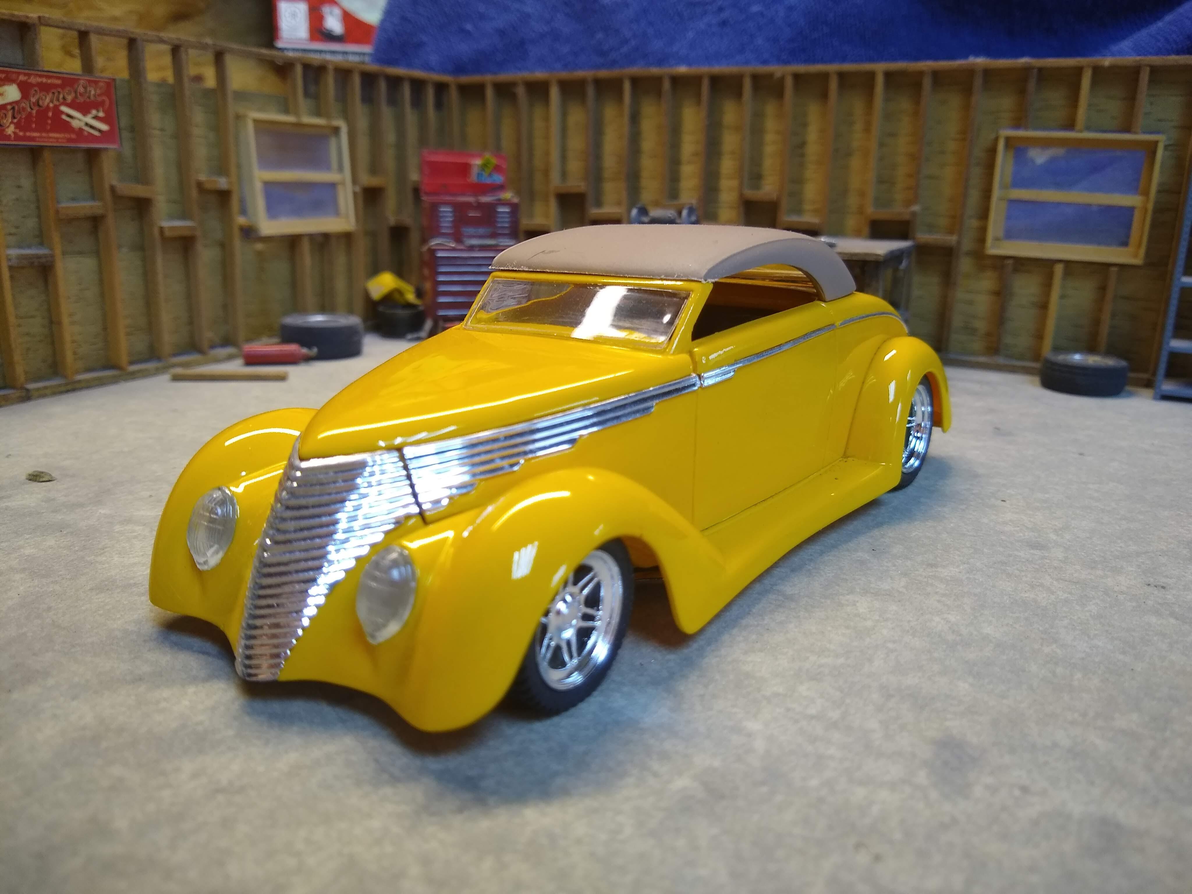

I know it's tough to believe, but it turns out okay.   I have built TWO of them.  First by choice and second by request for a friend.   I have my yellow one on ebay right now.   The purple one will go to it's recipient soon.   And it is not the sharpest tooling out there for sure.   The yellow one is the first issue of the kit when it was new.  Purple is the boxing that you posted.  Not much difference.  Nothing better or worse in the 20 years? or so between then and now.  Good luck - you'll get there.
Oh yeah, the chrome in my newer version was quite spotty.  I used a molotow pen to dot in the spots on the chrome and the chrome on the grille and side sweeps on mine is foiled.  It was quite bad.   And the kit was still shrinkwrapped so I know the previous owner didn't sell it knowing that.

Thank you for posting these Randy, two very nice examples for sure.
I seem to have wide gaps around the chassis, and floorpan, the only part that lines up well is the bonnet, ( or hood )
No idea where the dash or firewall fits too, it's very vague !
But yours looks a lot better, so I'll go for it and see now....
Thanks again, I'm certainly more determined now to build it as is !

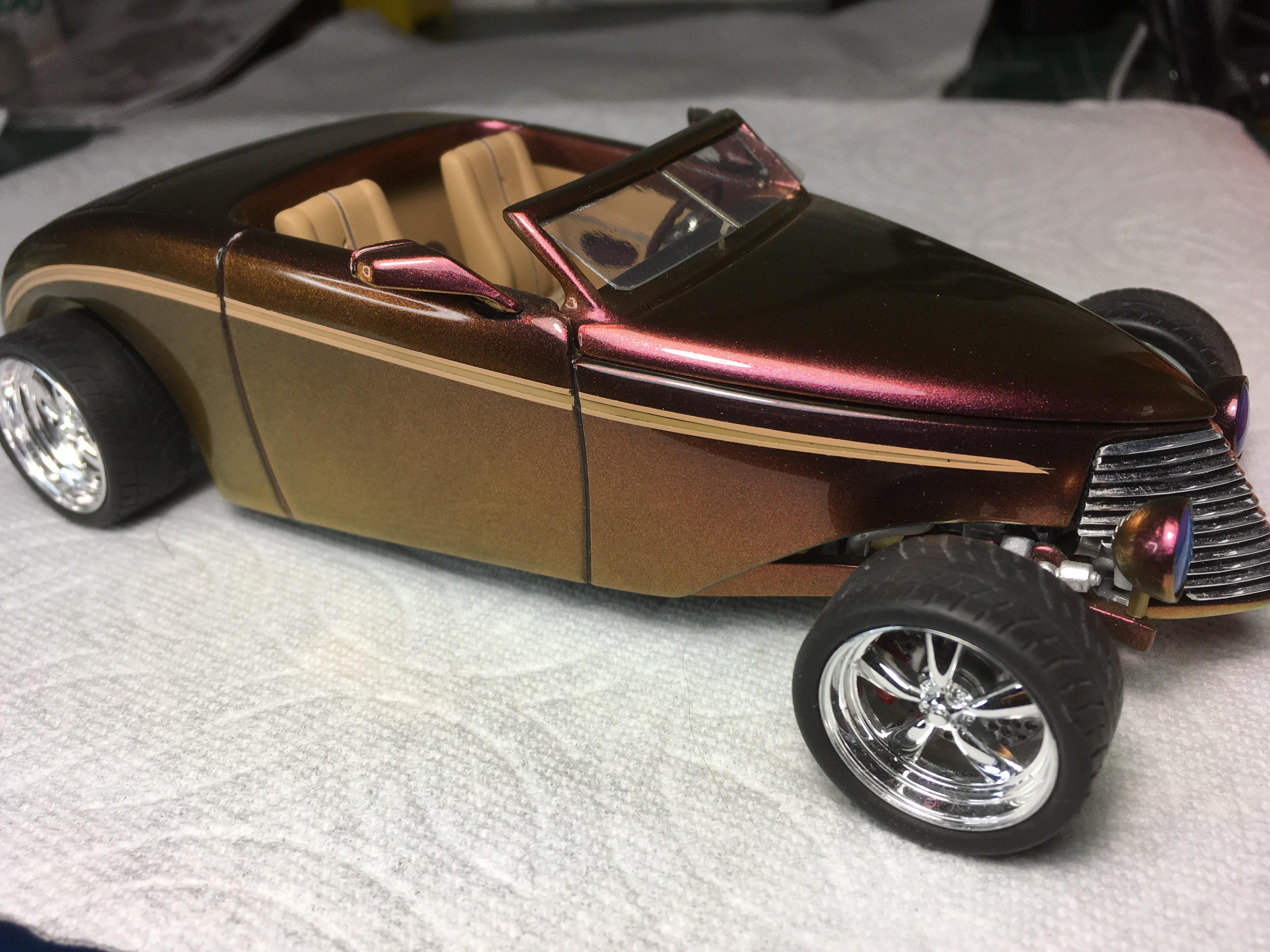

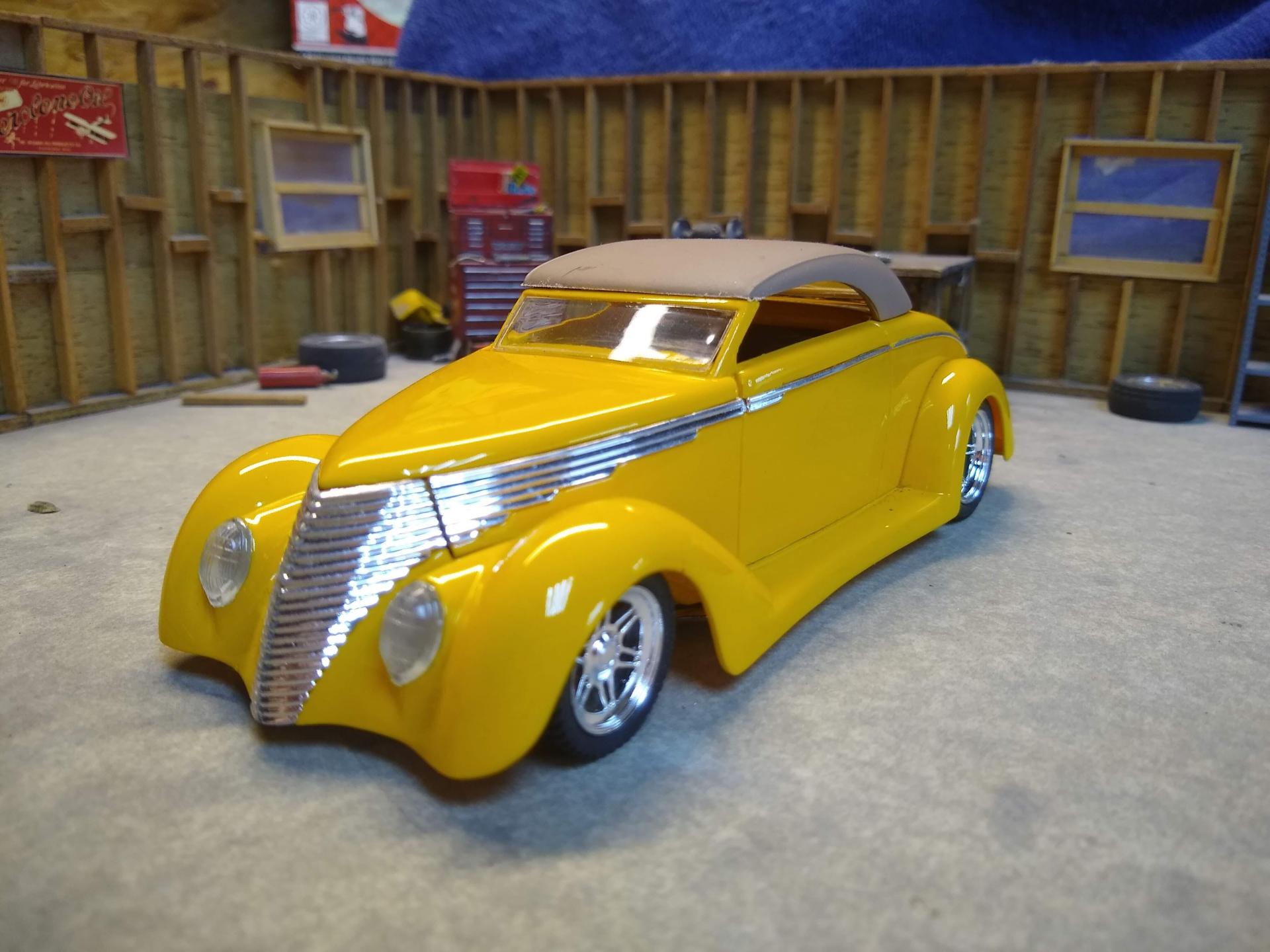

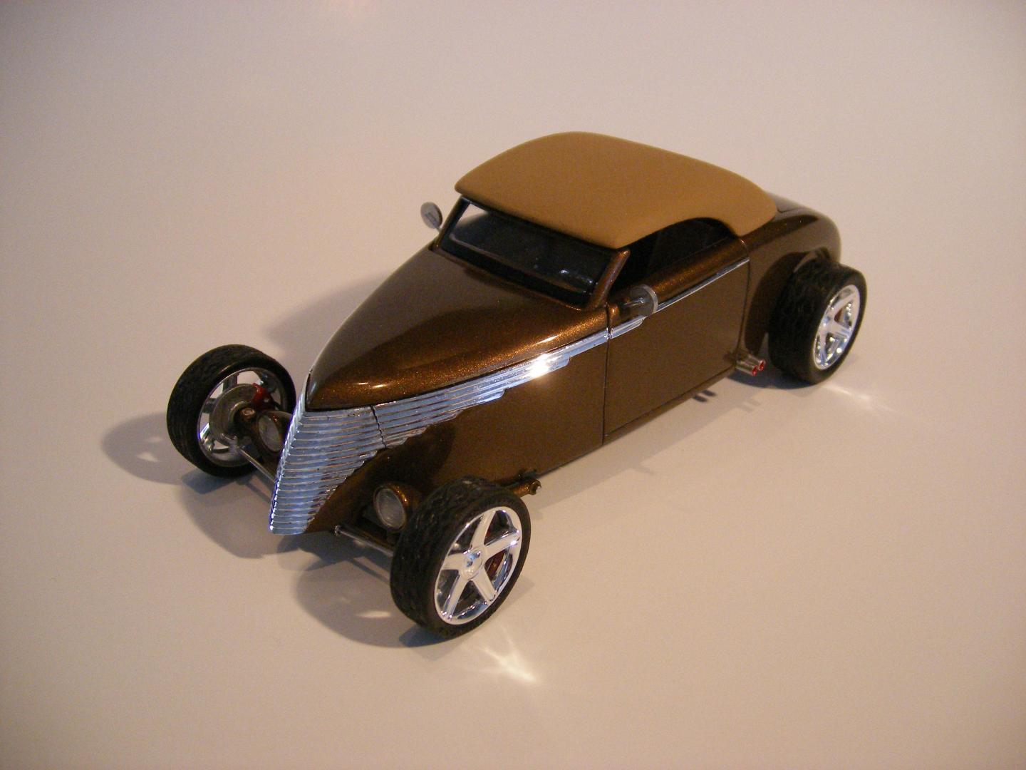

Some issues with the fit of hood, grille & windshield glass are to be expected. Nothing you couldn't deal with, I guess. Here's a Highboy variation. Have fun!

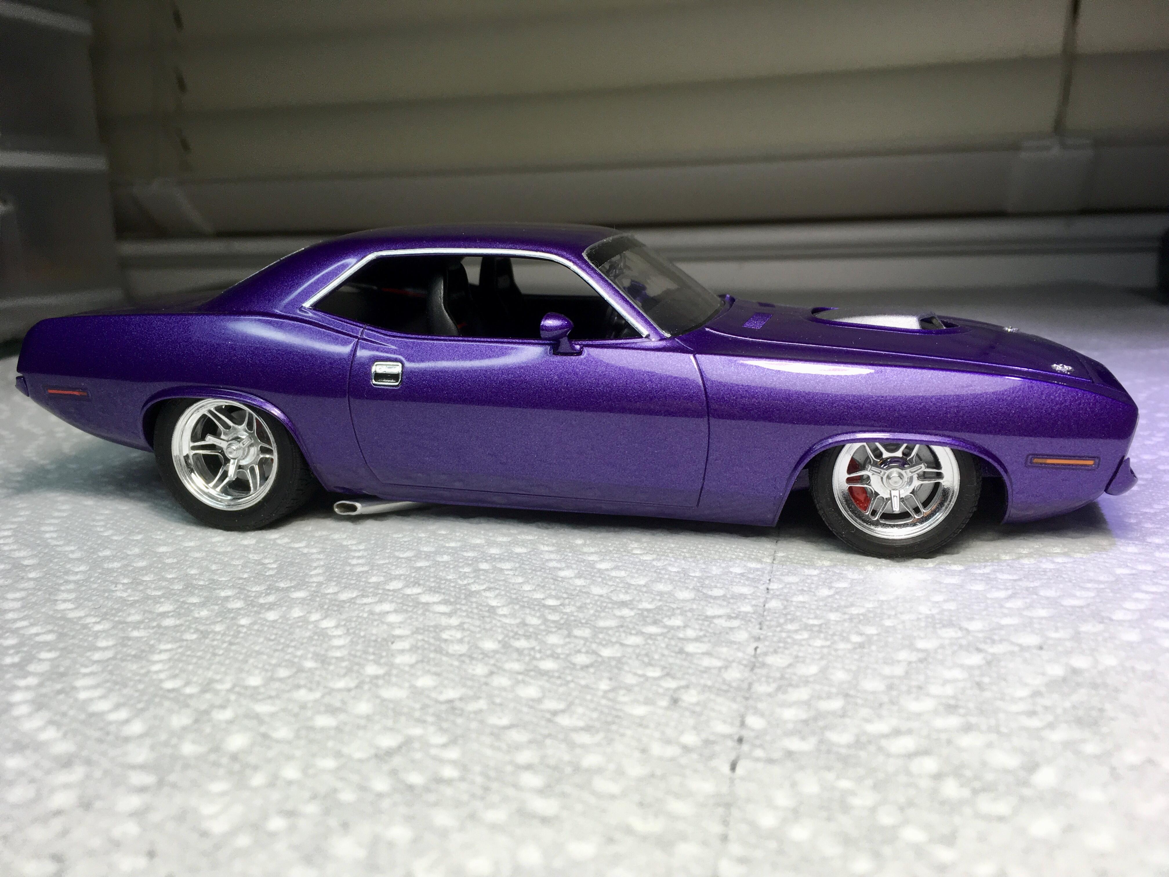

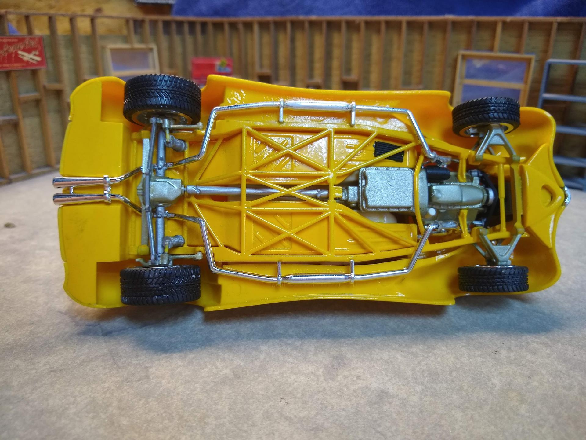

I really like this kit. Has some issues but works ok. I love the wheels and have used them on other builds. Here is another version of the high boy. The cuda has the smoothster wheels

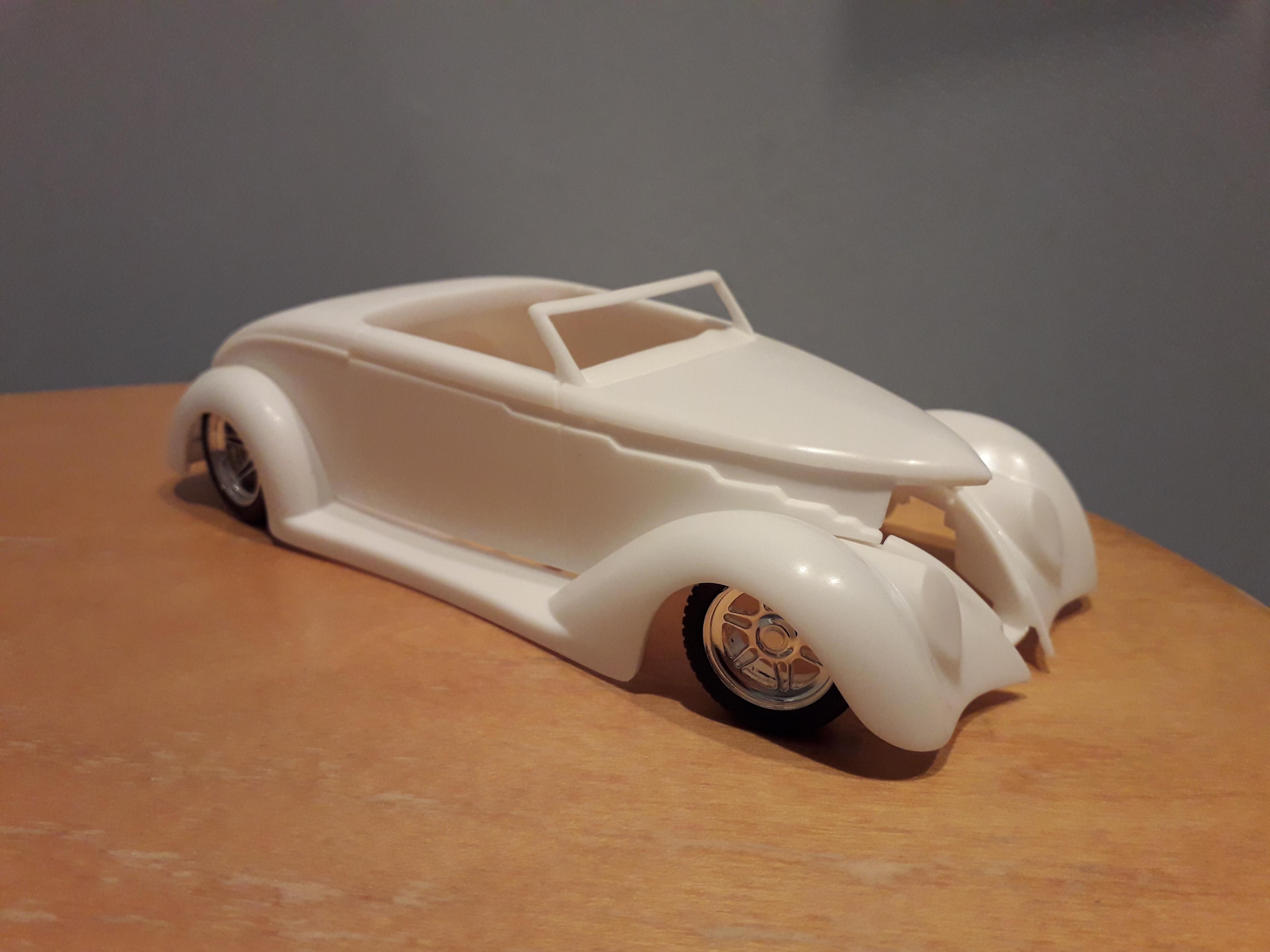

Made a start on the bodywork , rubbing out mold lines etc.
The rear panel with the exhaust cut-outs fitted badly so ive blended this in . Also under the running boards had sink marks etc so i made smooth panels from 0.5mm plastic card and blended thses in too.
As the hood fitted well i taped this in place and glued the dash/windscreen surround in so it lines up. Will be adding a front hinged hood so i might fill a couple of gaps where the hinges go too !
I like the look of it laying on the floor so it may get lowered with airbags, but first a smooth firewall is on the way, more sanding then its primer time !

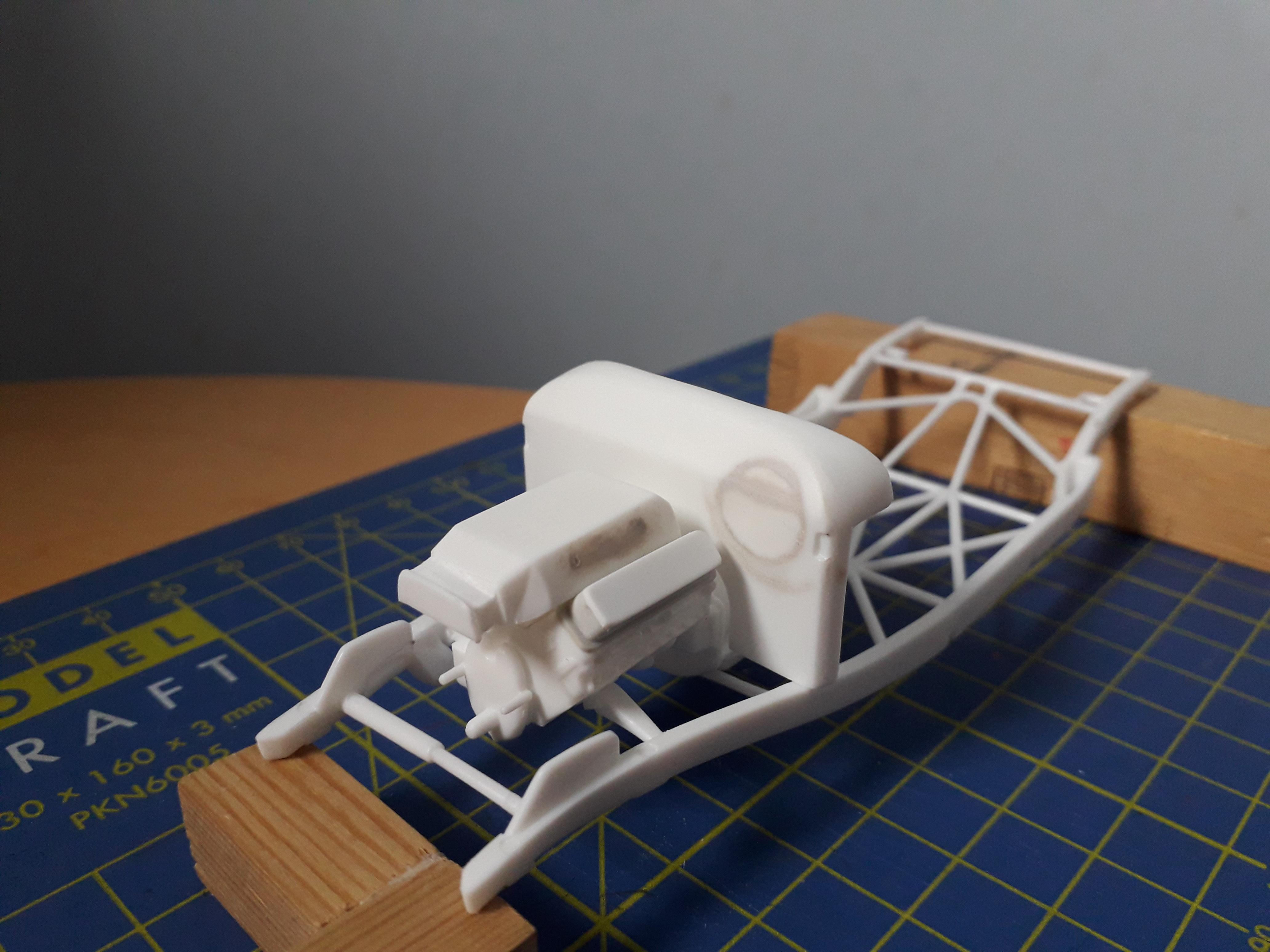

Engine basics together, there was a hole where you could see past the starter motor and into the gearbox, so ive plated this with sheet. The sump and gearbox pan have had the nuts and bolts smoothed out and im currently smoothing out the firewall !
Not sure about engine design yet, i`ll add the heads and intake when ive decided on the look im after !

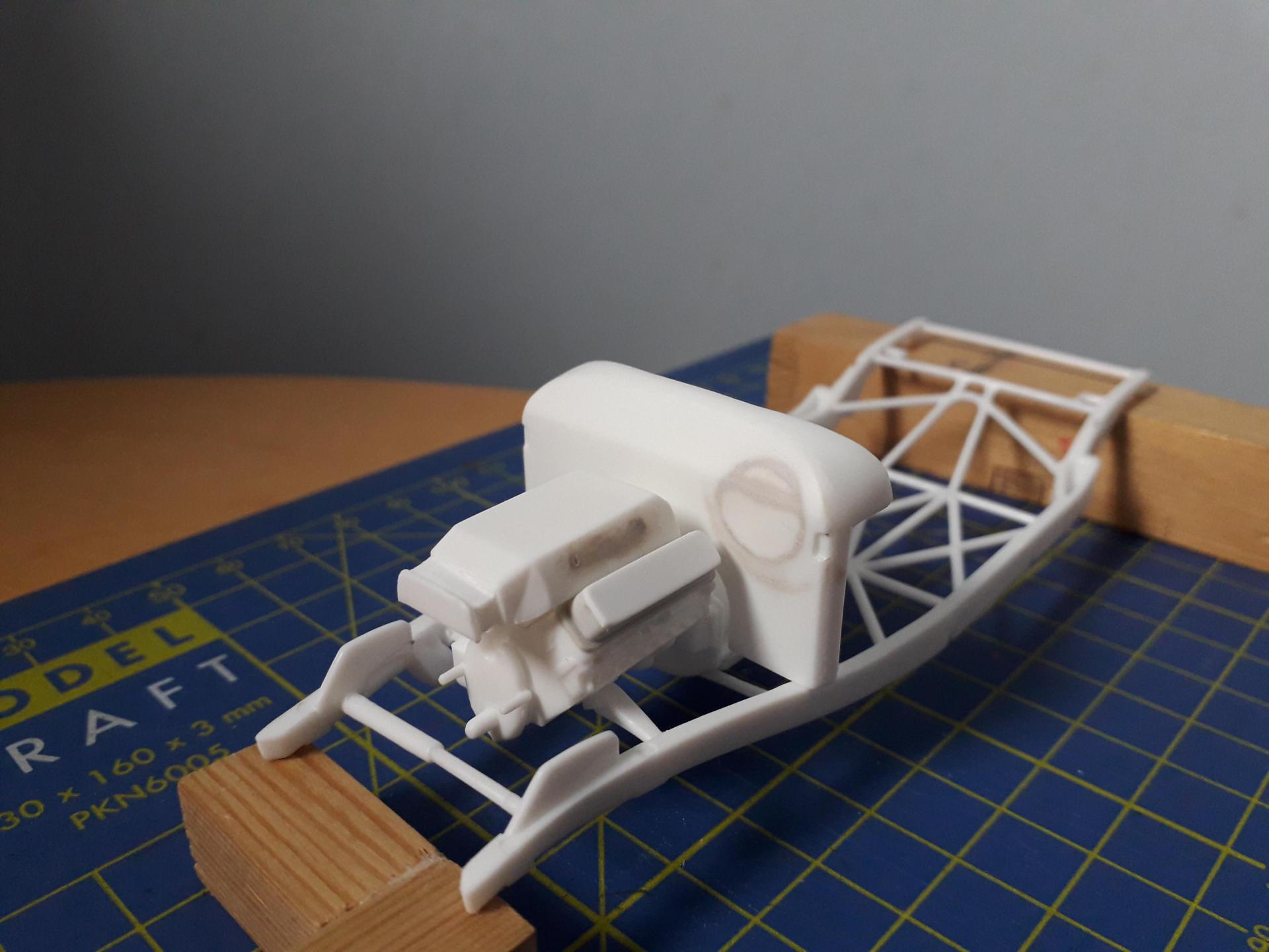

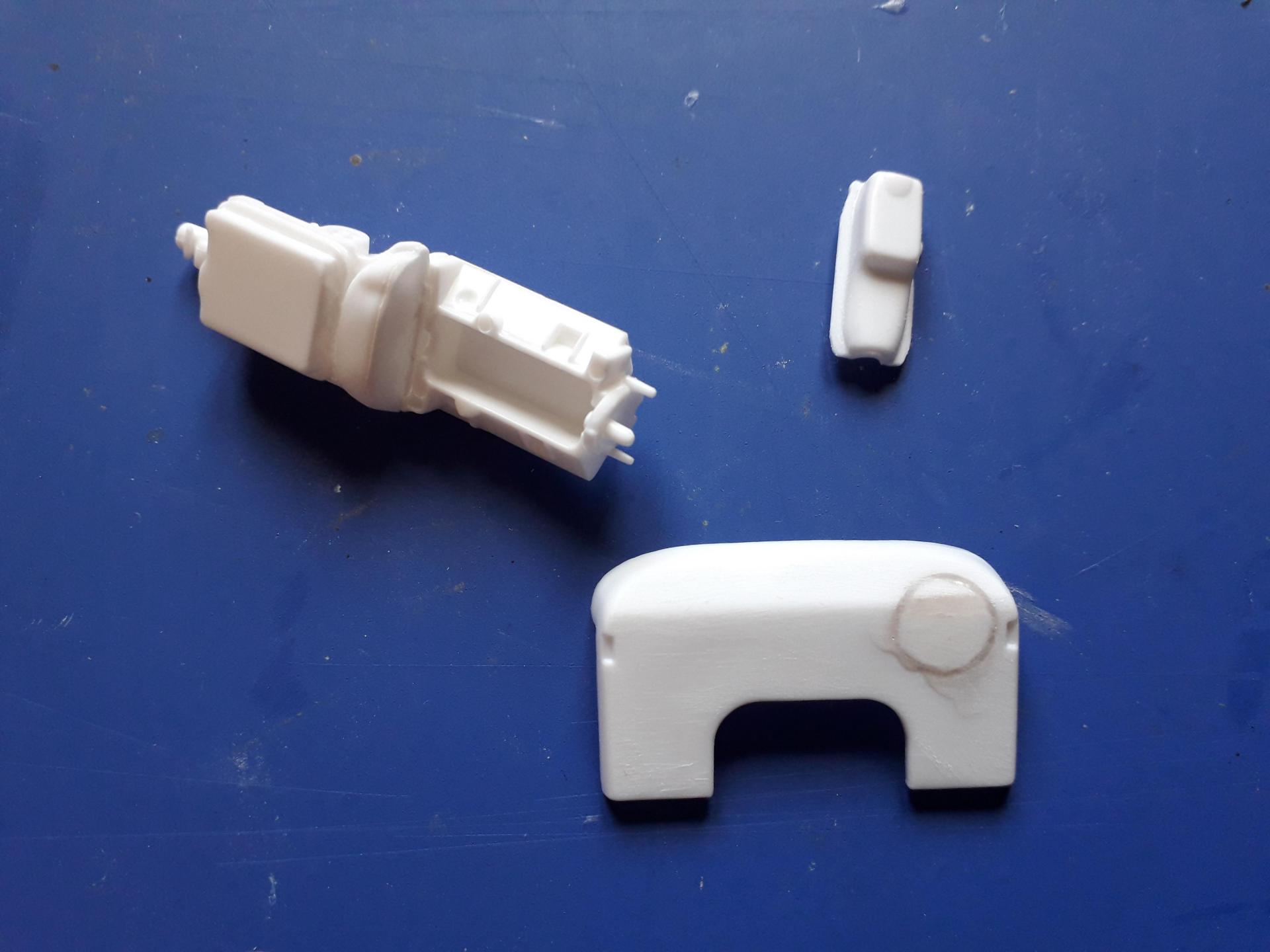

So not much else to show at the moment, its too cold to paint outside (cant do any indoors!)  so im still smoothing things out, for a change !
Wasnt going to use the air cleaner but im trying it out, i cut a groove in the end which i`ll fill with mesh for an air cleaner, and smoothed all the detail off of it.
The rocker covers are corvette, and, er, smoothed !
If i carry on smoothing like this, im going to produce an egg on wheels !

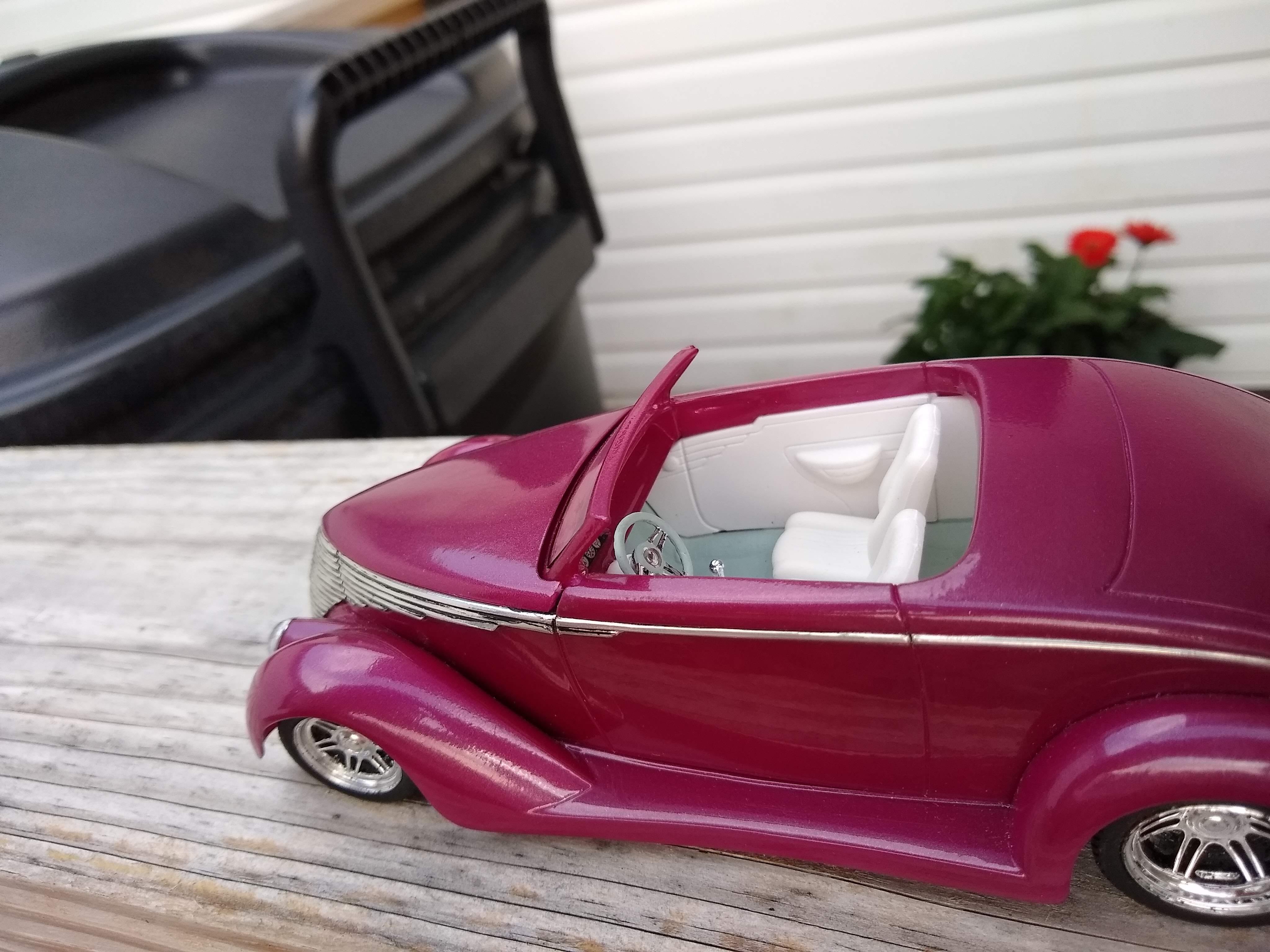

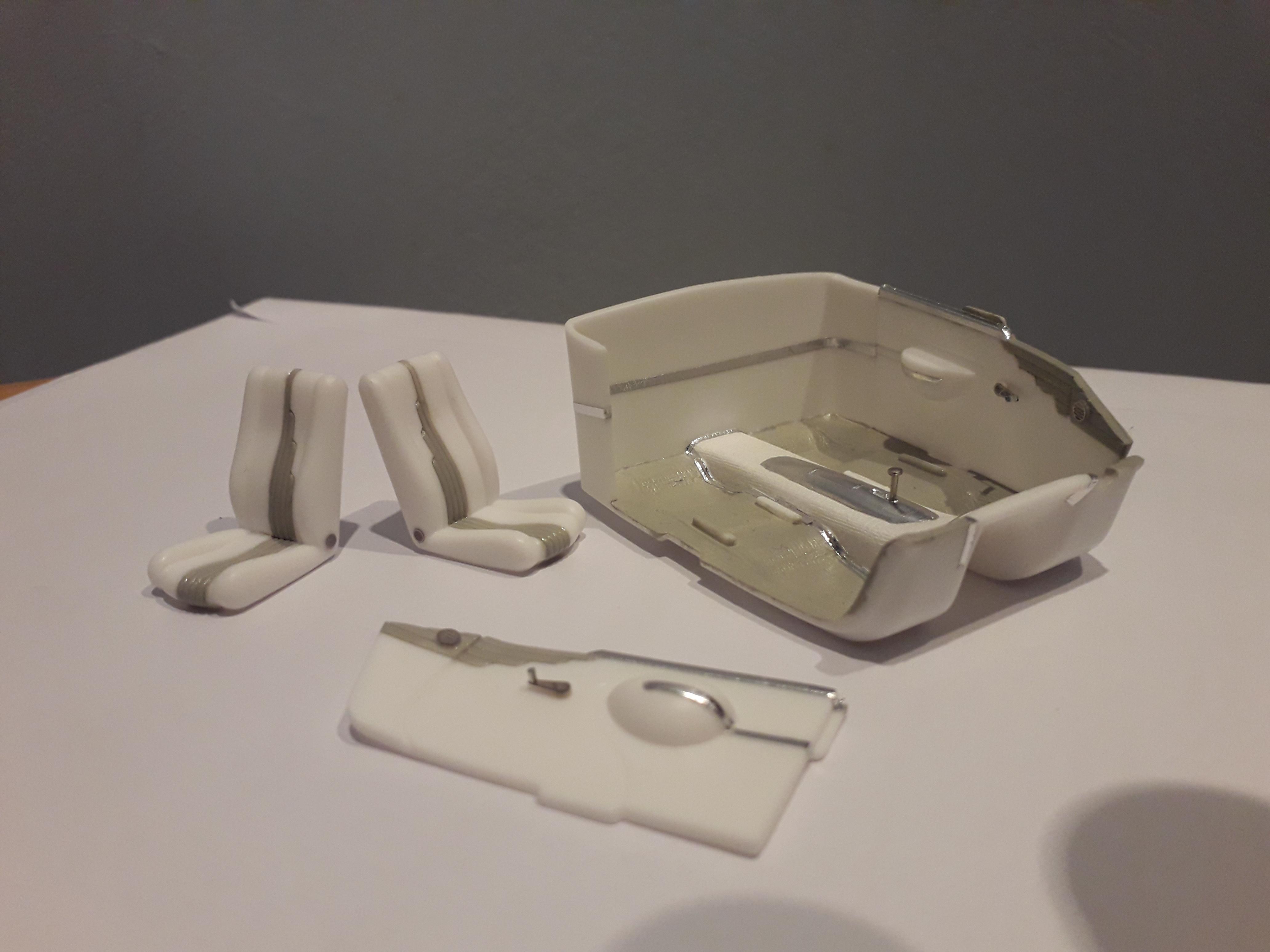

Too cold here in the UK for painting ( i cant spray indoors! )  so thought id start on the interior !
I did paint it all matt white, and was going all white, but it was too bland, so i added a light grey, ( looks a bit green in the pics? ) then out came the foil..
The centre console and door panels were foiled , ( with a pin shifter ! )  Then i added a chrome strip to the carpet edges to seperate them !
Back of the seats was just a hole, so i filled it with fur !  Seems i cant do an interior without adding fur and chrome !
Then came p/e speaker grills for the doors, and a chrome strip round the back of the interior to tie in with the door chrome !
Spent ages making door handles, a p/e piece with slices of plastic tube behind and thinner solid pieces for the actual handle !
Oh and p/e seat adjusters on each seat !
More soon !

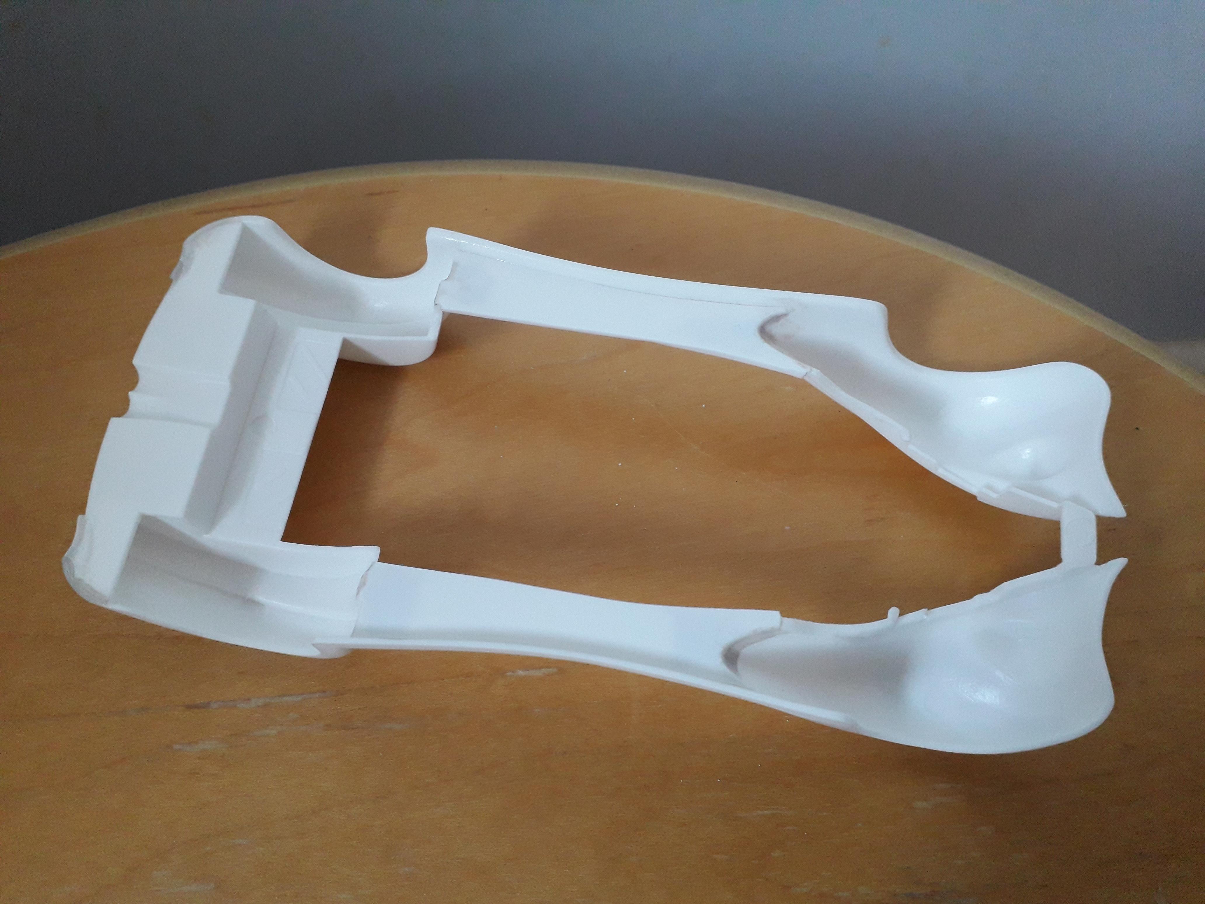

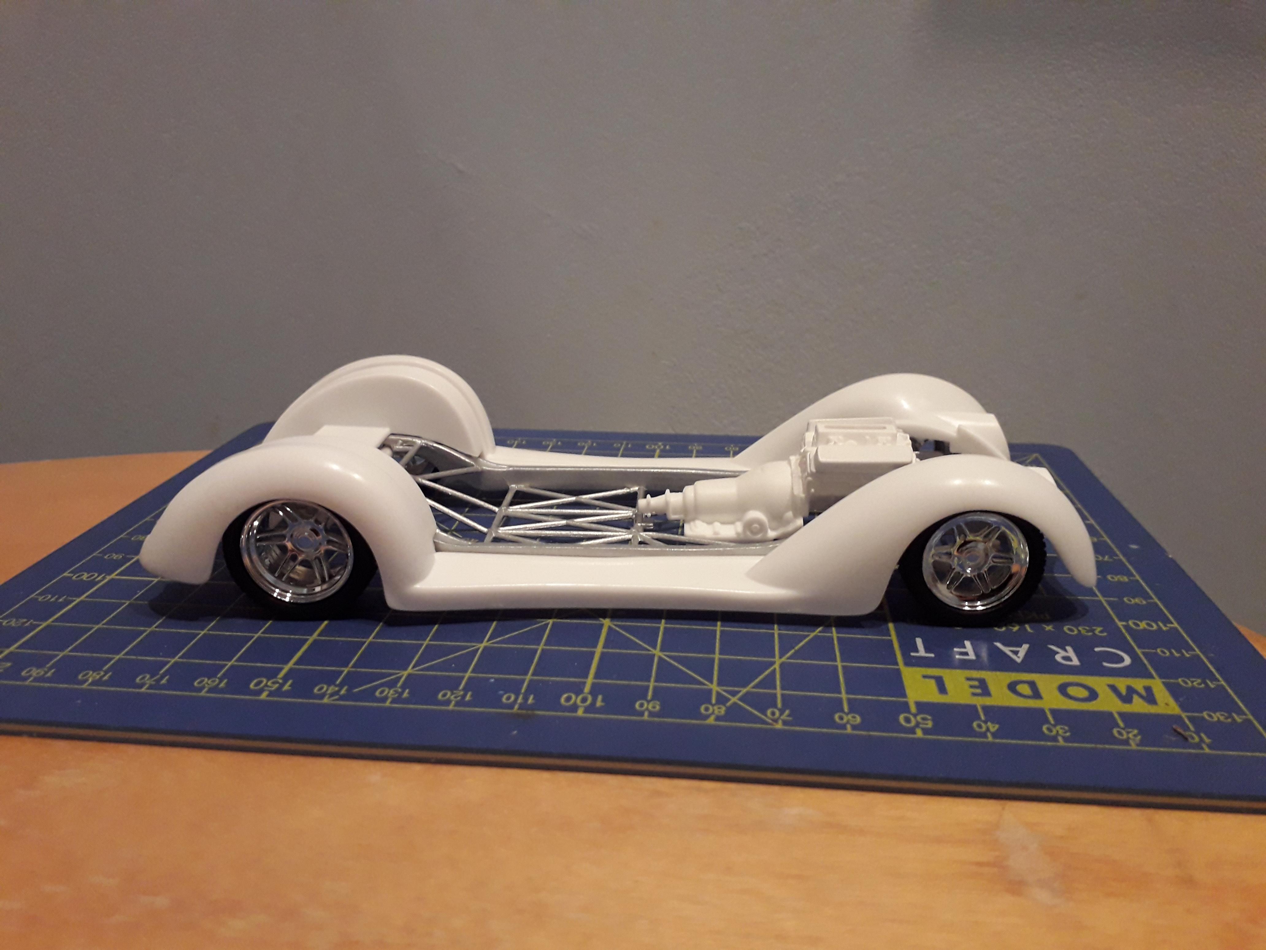

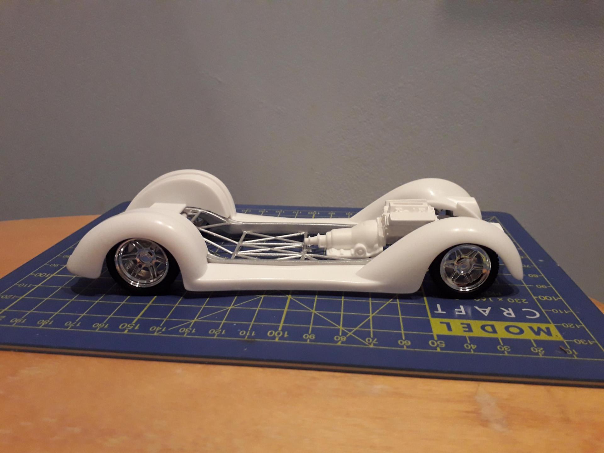

Im still playing with this, thought id start on the chassis next. Only a slight adjustment to the ride height, its subtle, so nothing too low this time ...
I wanted the top of the tyres to sit just inside the arches, back was easy but the front a bit more complicated.

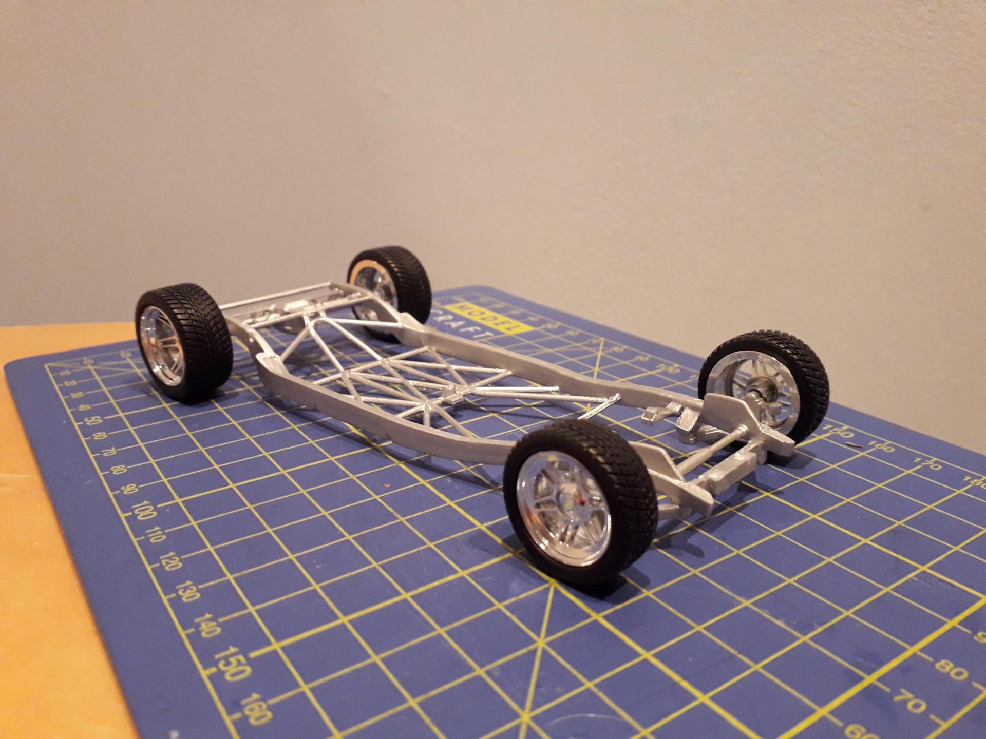

Ive always liked the look of just plain metal, like the rods you see with just a clear coat. So im trying it on the chassis, lots of details to add yet but its a start !
Im happy with this stance now too....
Share this post
Link to post
Nothing too low?!?! It couldn’t be any lower! 😂
and just to give you heads up. Those “plates” sticking out on top of the frame by the front suspension need to be body color. So, if you are painting the body in different color than the chassis, you may want to address this now, before you go any further on the chassis. 😉
