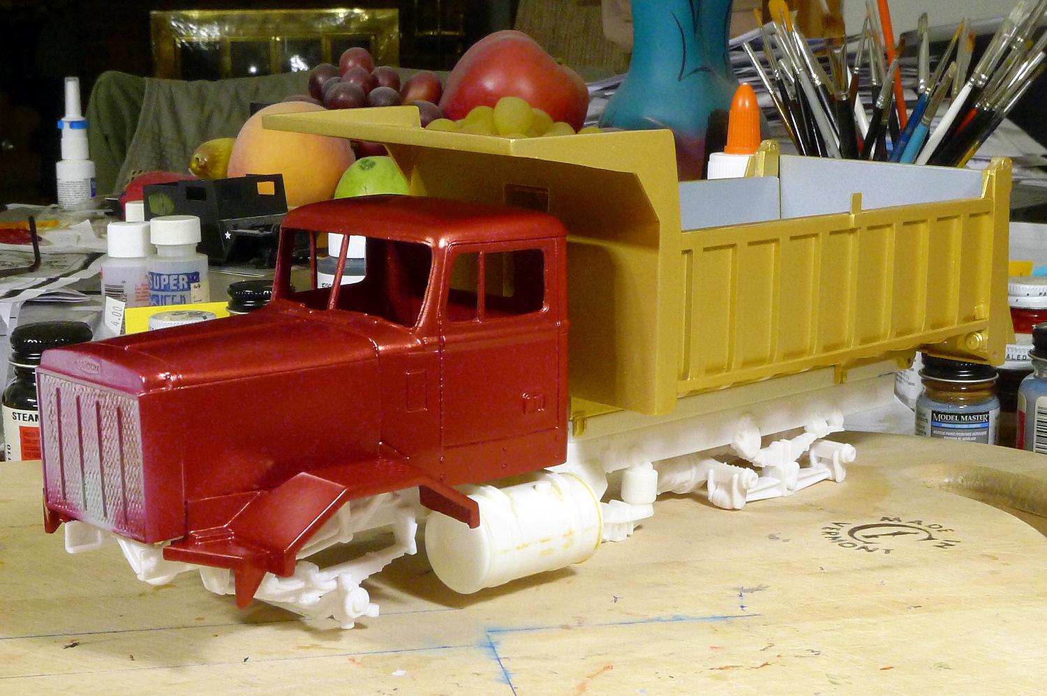

Been making decent progress while trying to recover from a strep throat.  I fit the cab and found it doesn't need any more than a few minor tweaks to get it where it should be.  I'm able to use the A64B kit glass and interior and the cab and fender mounts seem pretty close in  their stock location.  I recycled the fuel tank from the Pete wrecker as well as the battery box.  Both fit the chassis well, the kit parts won't work with the tag axle.  I got the tag axle from George Wallace, I need to finish the main wheels and rims and get the tires mounted to determine the final tag axle height.  I decided to use the trailer wheels I had leftover from the Lindberg Dodge/tanker kit.  Used the tank body on the Brockway water wagon project.
Dump body is painted, cab has it's first color coat (will see how it dries, might be the final color coat as well!)  There was a local contractor a bunch of years ago that ran a fleet of Pete dumps with green cabs and gold dump bodies, so yes, the gold dump body has been done.  I think there will be just enough room behind the cab for the hydraulic oil tank for the hoist.  Still a long way to go and I haven't even started the dump trailer yet..... BTW, you can see the inside of the tailgate, got skinned.

Those colors really pop.  What color are you going to use for the chassis?

Thanks, the photo doesn't do the red justice.  It's a custom blend based on Aztek Red Pearl Metallic.  The chassis will be body color, red.
