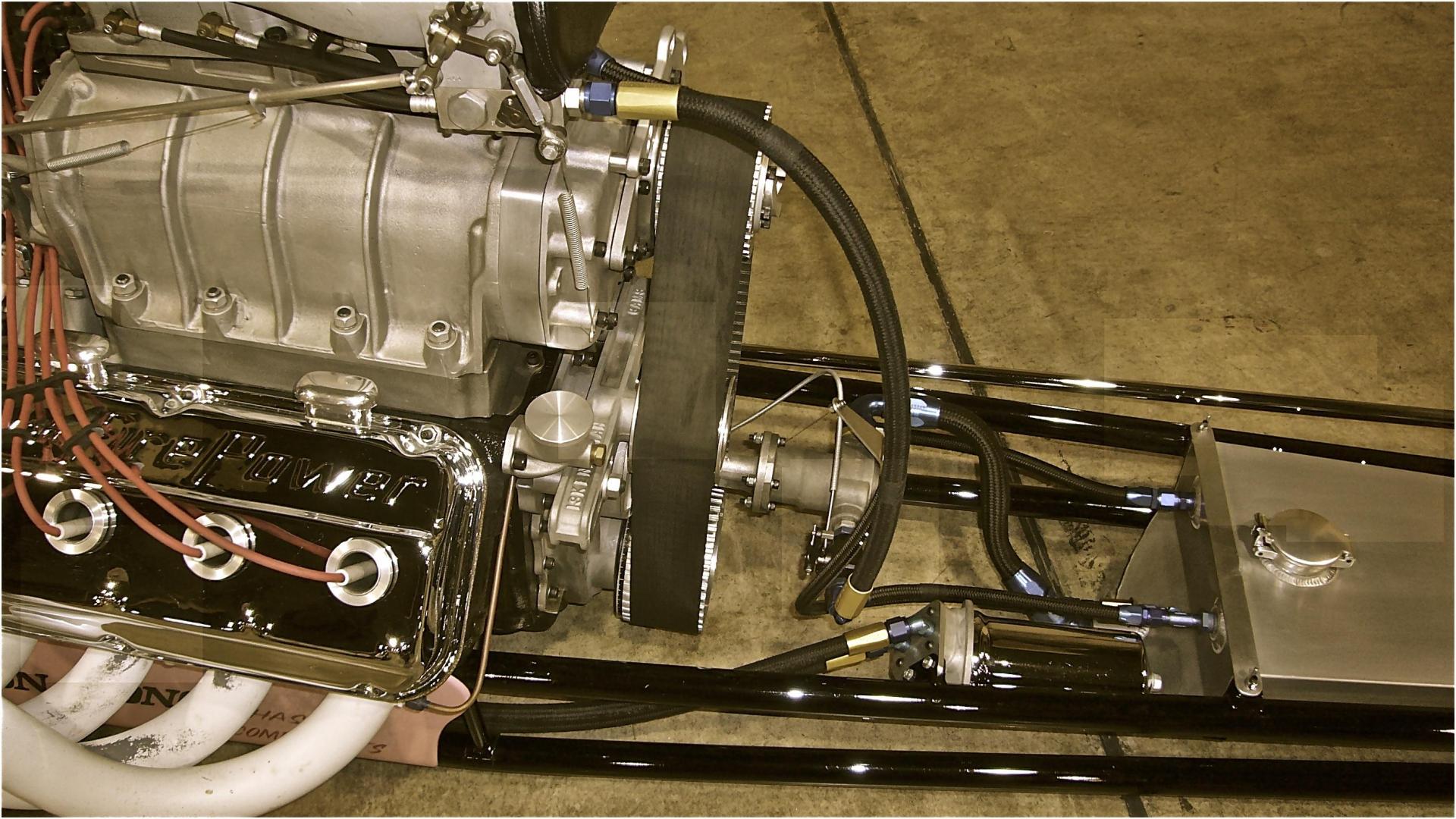

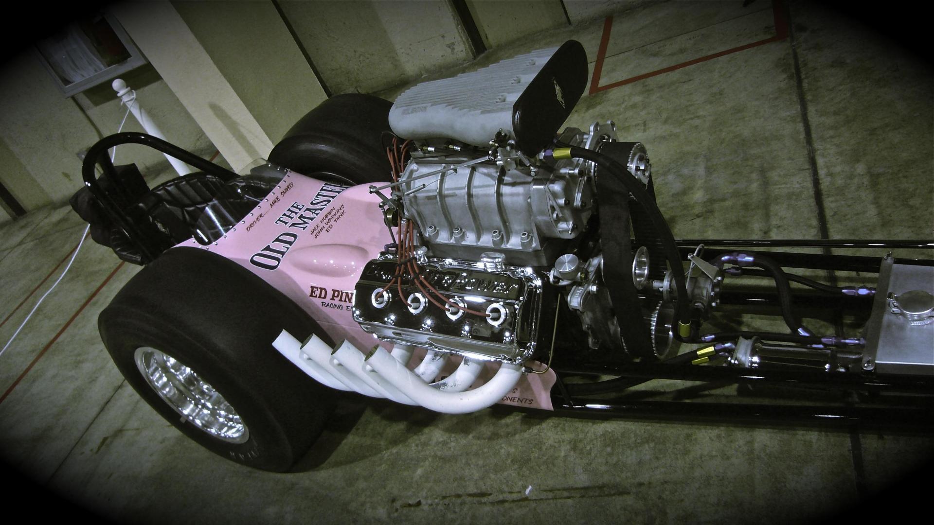

9 hours ago, MAGIC MUFFLER said:
From the Pomona 2013 show.  My friend Derek restored the car.
Great reference pics!  Thank you for sharing!
