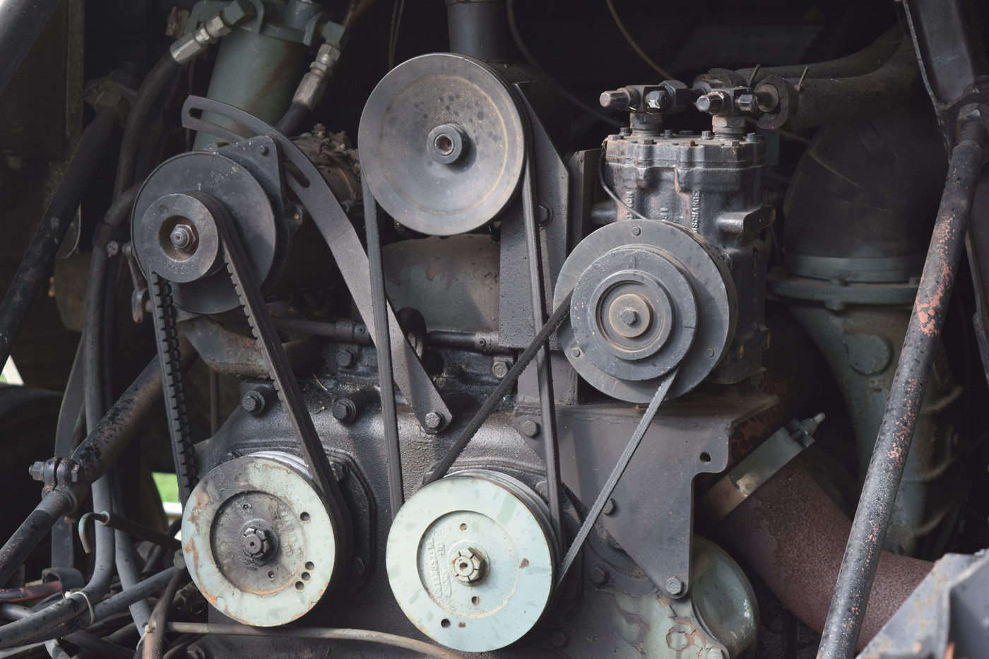

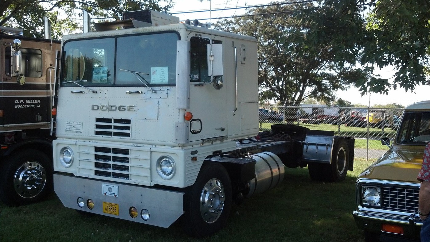

Richard Petty had 2 of those trucks, I actually saw one at an ATHS show last year. I talked to the current owner and he told me that he bought it not knowing that it was a former Petty truck (it had been repainted white). Once he noticed that there was Petty blue paint behind the upholstery on the interior and that there was Petty blue showing where the white paint was flaking off, he started digging and found out who originally bought it. The trucks had 6-71 inline-6 Detroits  in them. I may have taken some pictures, I will have to look.

Here is the truck today:
Here is a picture that I took of the 6-71 engine.

Thanks for the pictures! Nothing like seeing the real thing. I wish that I would have had those 6-71 pictures when I built mine.
That would make it an LN1000 instead of an LV1000. GW Trucks makes a very nice 6-71 and moluminum makes a very nice one as well.
