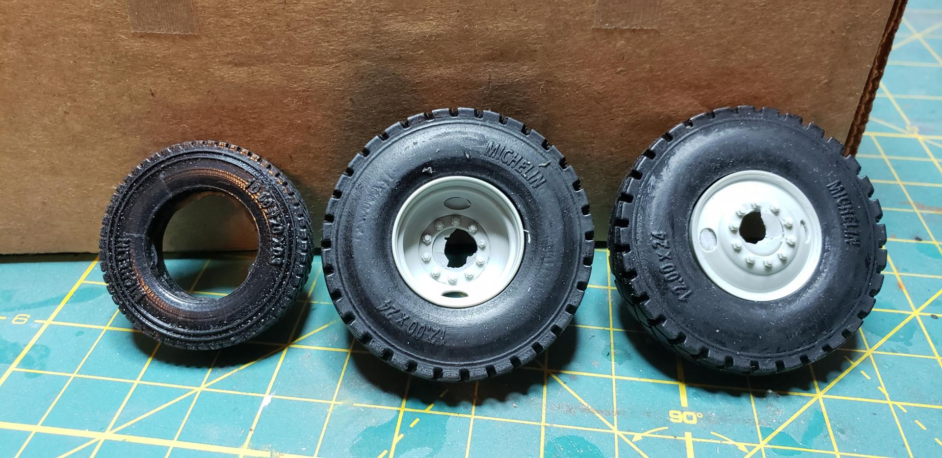

I just picked up these tires and wheels from Jamie ! The rims slide right in with just a slight looseness. Should be fine after assembly,  or may need some adhesive.
The little fella sitting beside them is a 20 " drive from gary for comparison.  The tires are 12 x 24s  w his 22s 2 inch budd perfect for the big snow mover there going on
Share this post
Link to post
Those are some beefy tires!  It could be the fit would be better after the rims are painted.  I tend to use paints with very small pigments so they don't build like the old Testors rattle cans.
