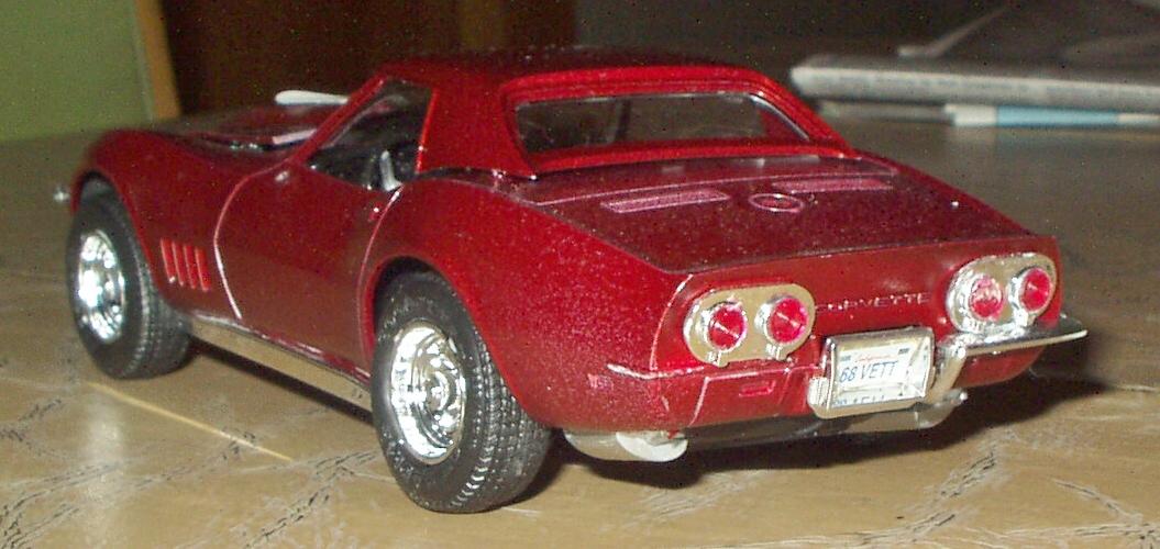

On 12/14/2019 at 4:59 PM, StevenGuthmiller said:
I was just about to ask this question, but knowing snake, there's a perfectly "reasonable" explanation! :D
Lay it on us Snake! ;)
Steve
It's a rescue glue bomb I repainted and upgraded. (Rare for me--I never repaint "rescues," saving that for full rebuilds.) When I got it, the license plate frame was installed upside down. And the taillights were glued on the OUTSIDE of the body! I repositioned both correctly, and thought it would be fun to leave the license plate as-installed as a reminder of its humble glue bomb origins. So there. B)
Link to comment
See!
I knew that there would be a completely plausible explanation!
Snake doesn't just "goof up" things like this! ;)
Steve
