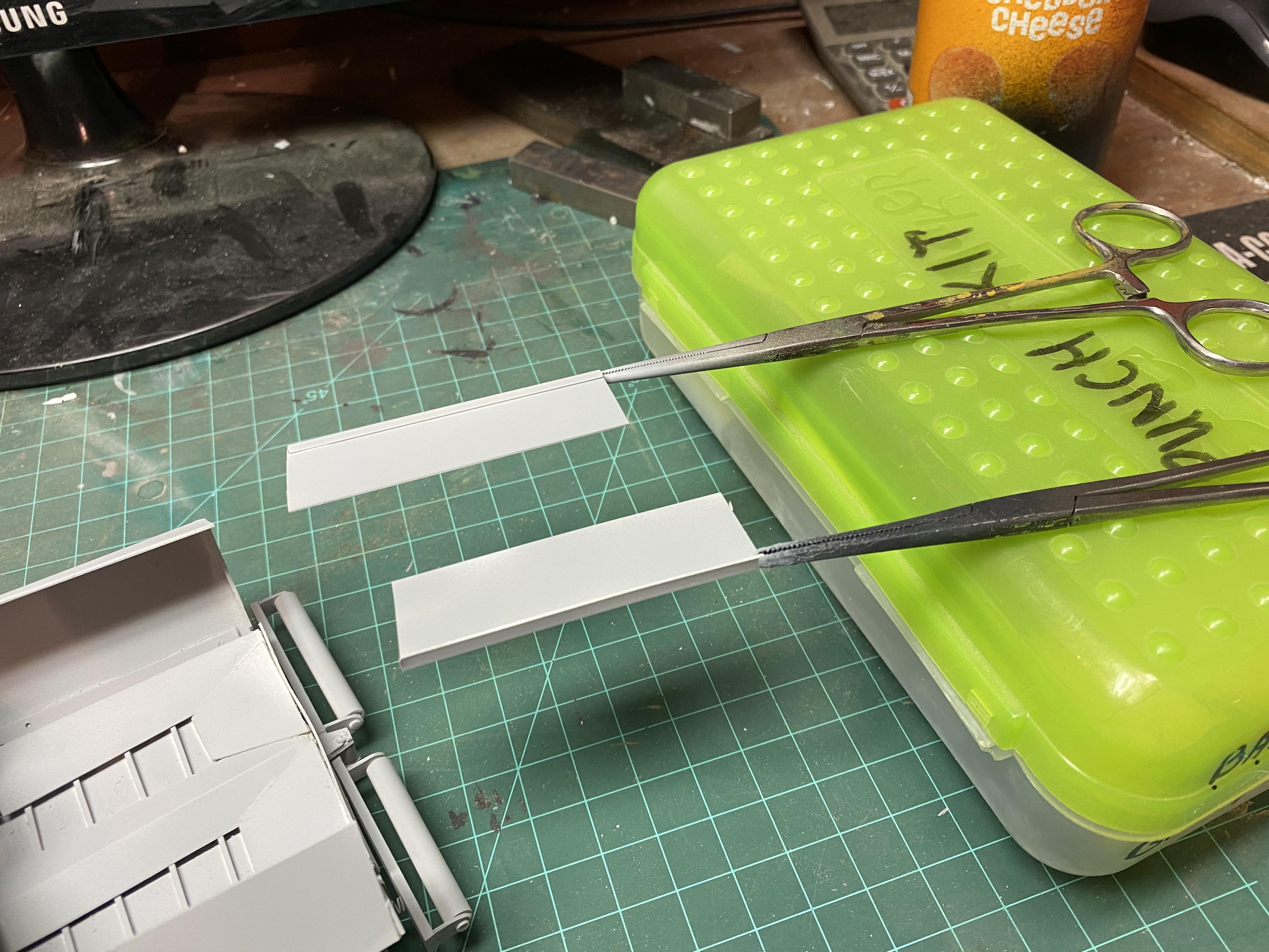

redneckrigger Posted March 21, 2020 Author Share Posted March 21, 2020 On 3/18/2020 at 1:51 AM, peteski said: For soft floppy rubber flaps I would take some electrical tape, remove its adhesive (Naphtha should take it off), and use the leftover black vinyl. It is very thin and flexible, yet it still has some stiffness to it. Good idea................will try it. Thank you! Quote Link to comment Share on other sites More sharing options...

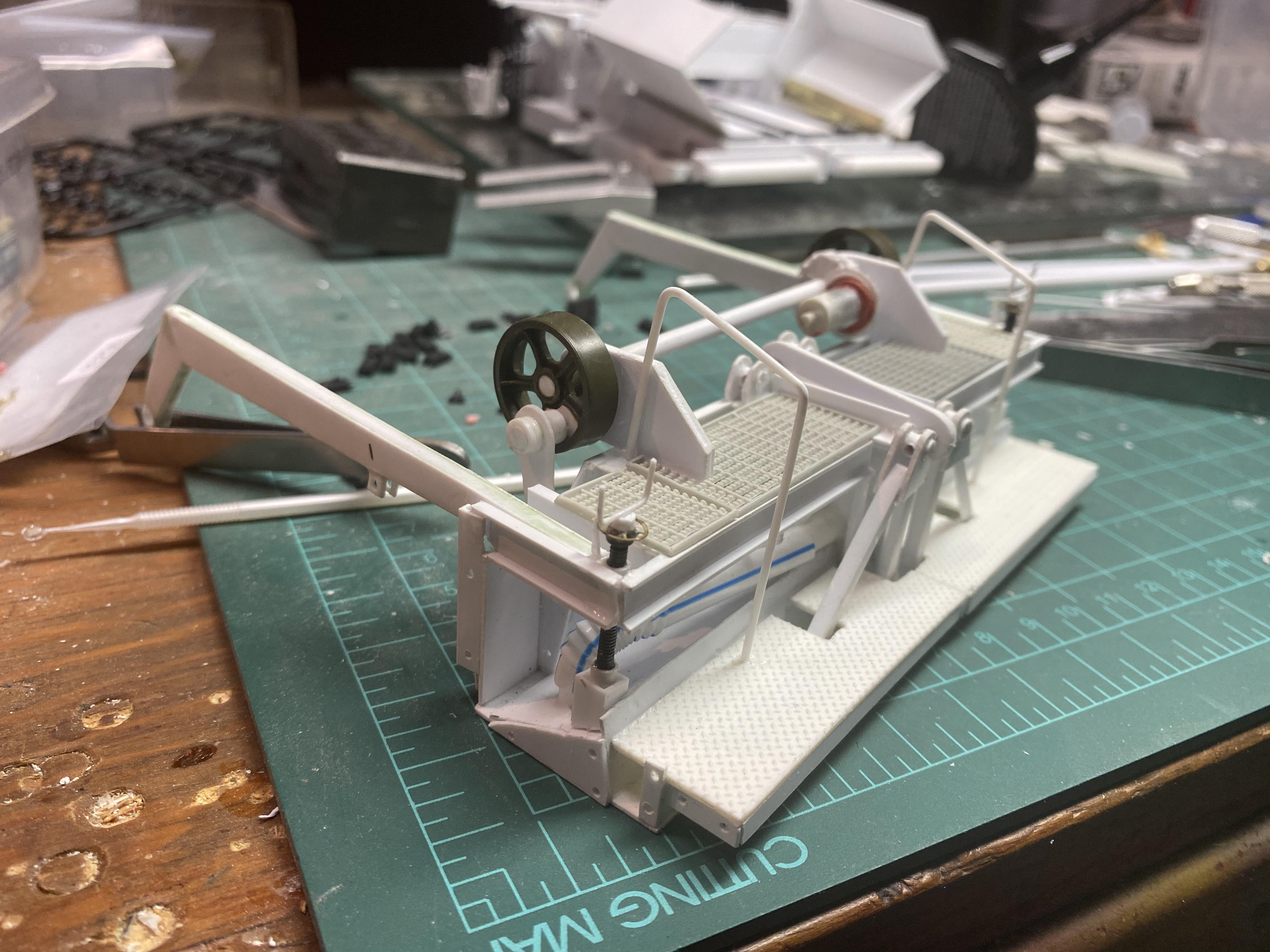

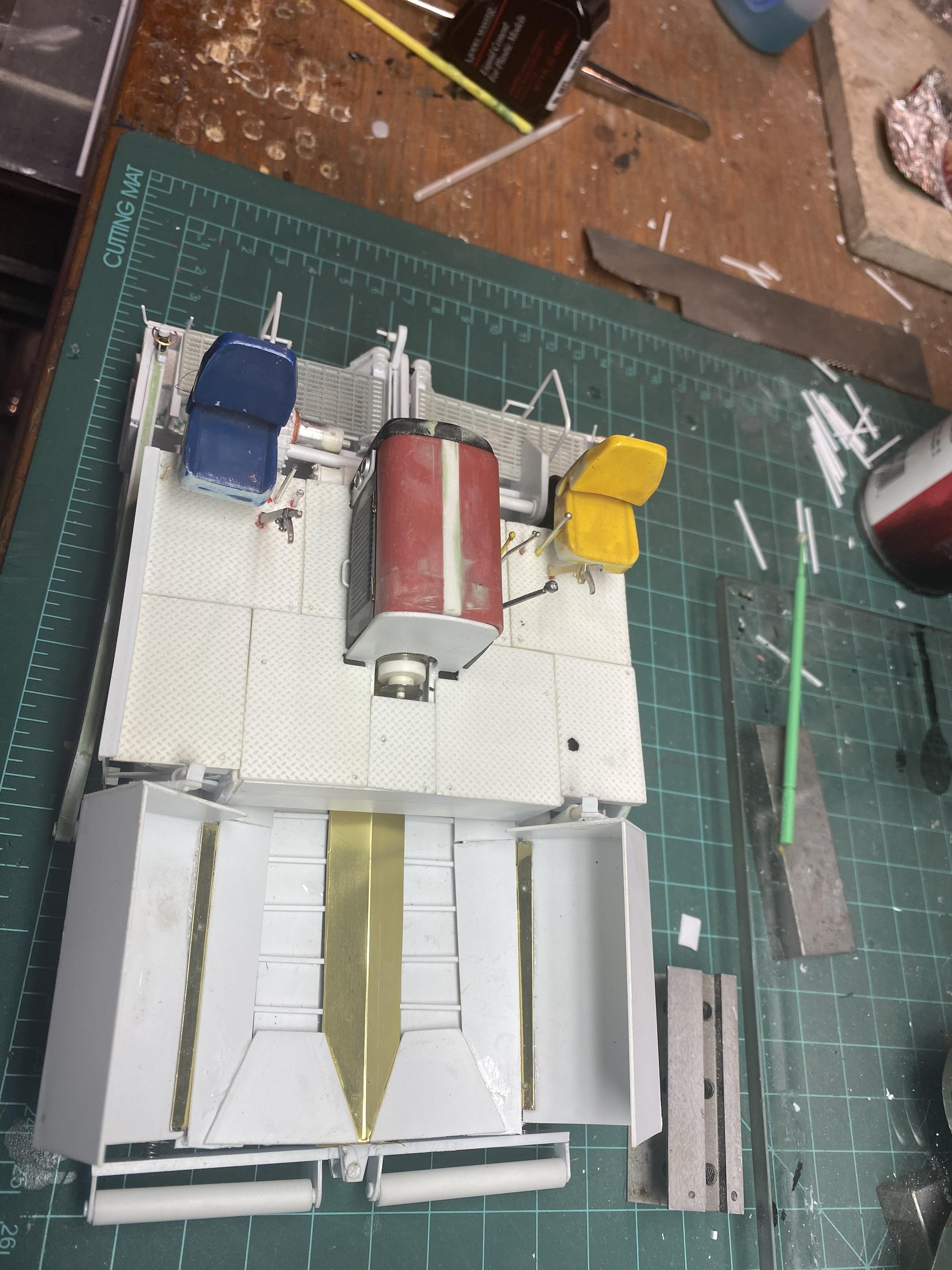

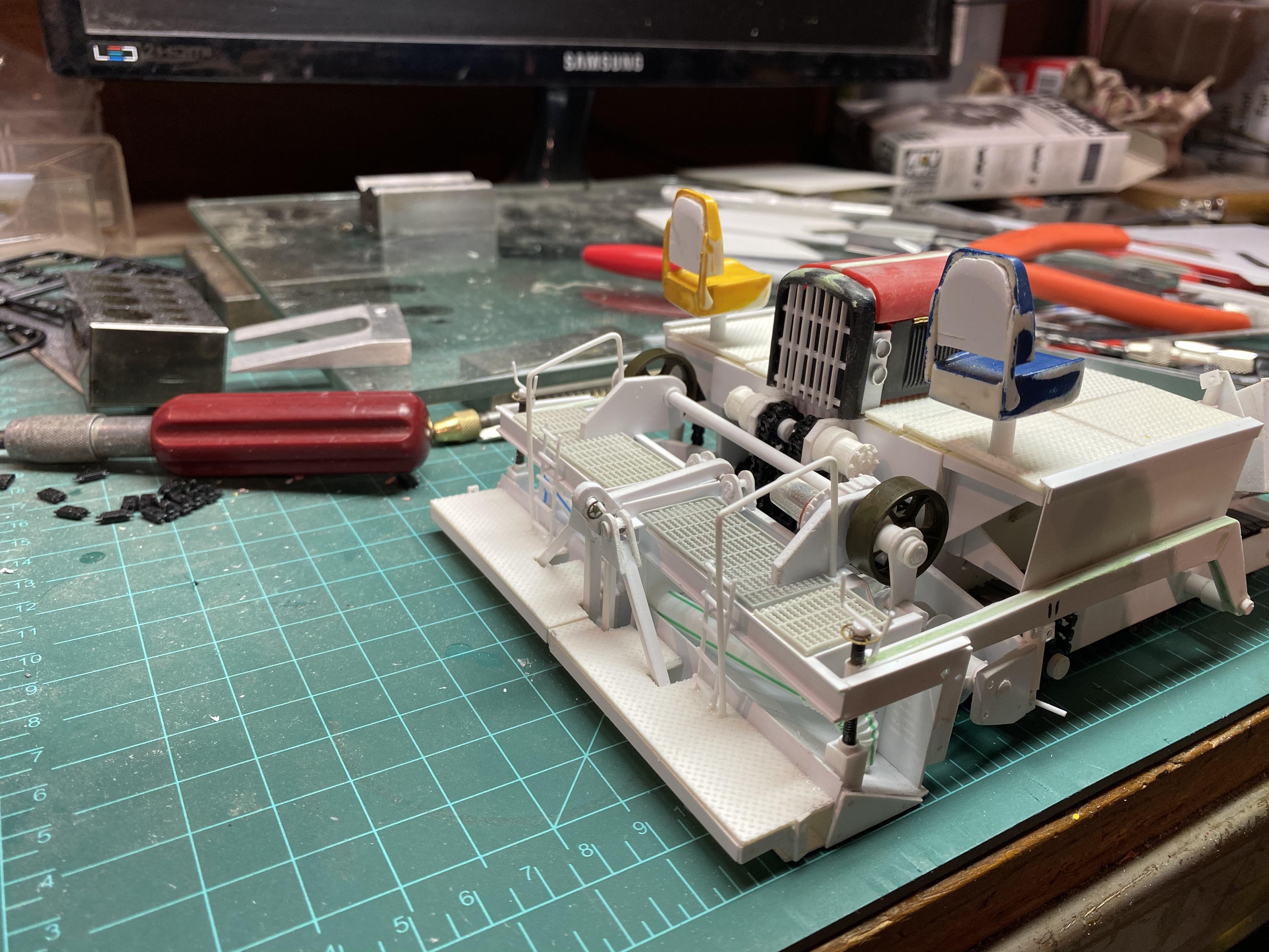

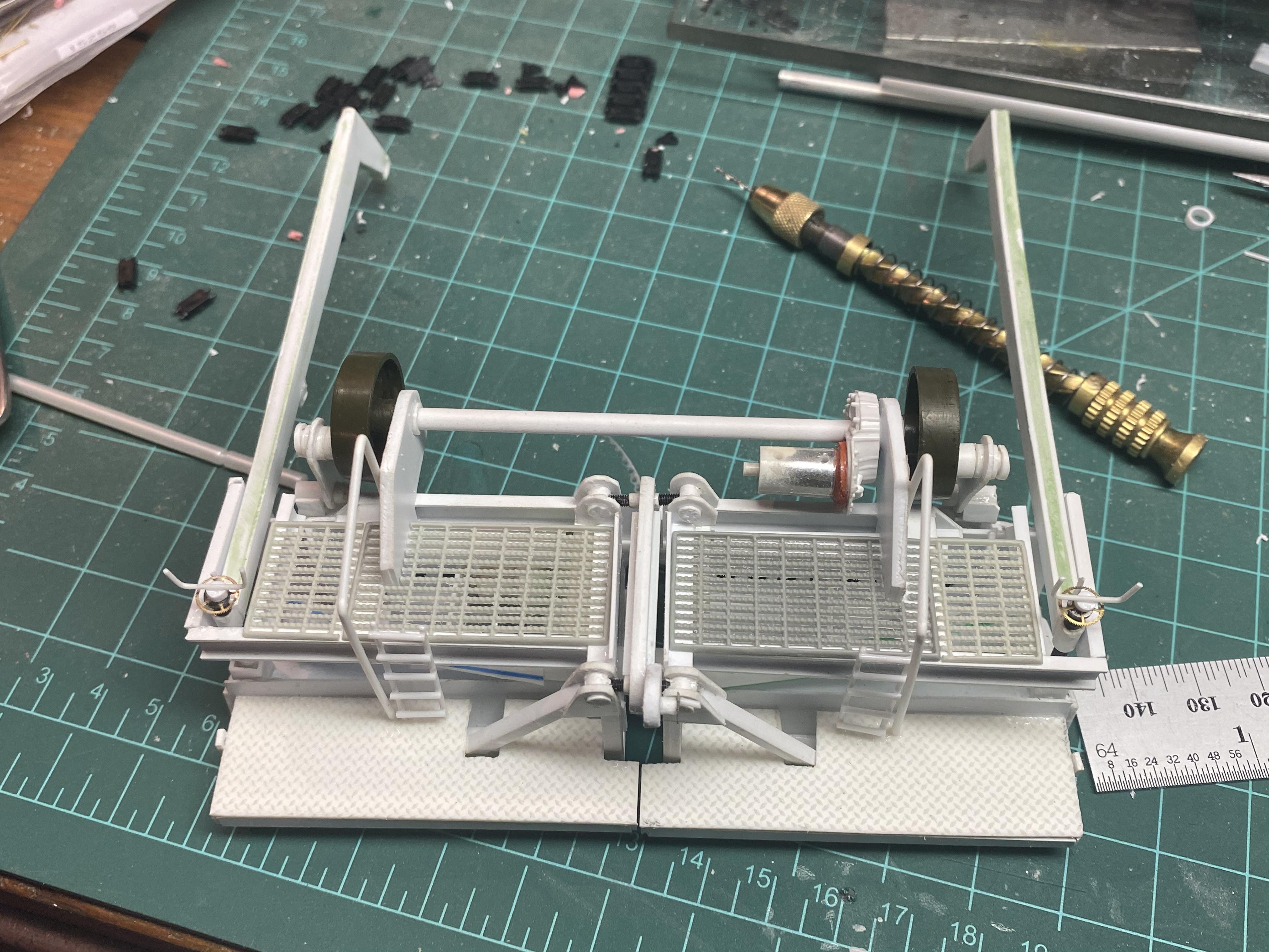

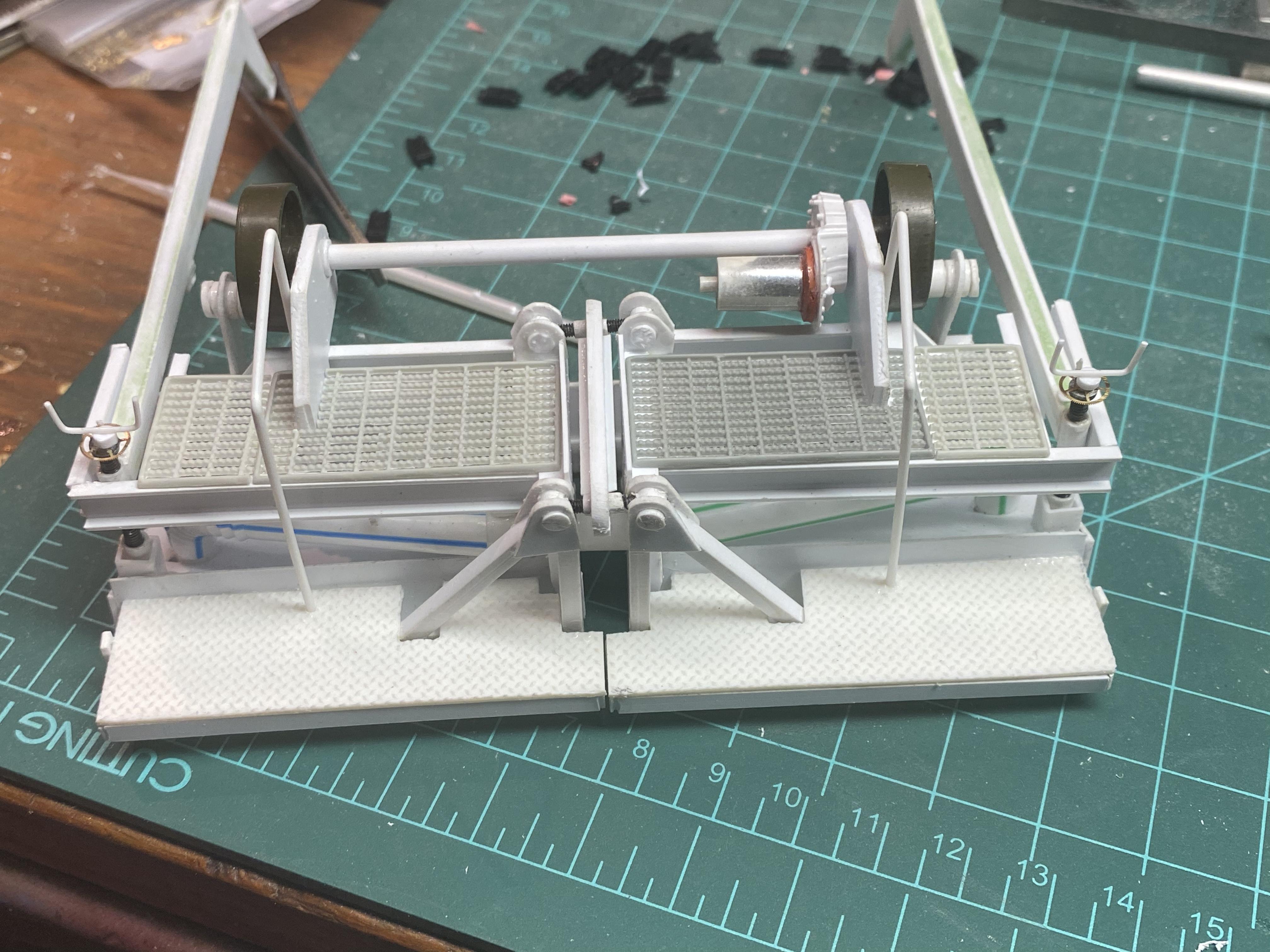

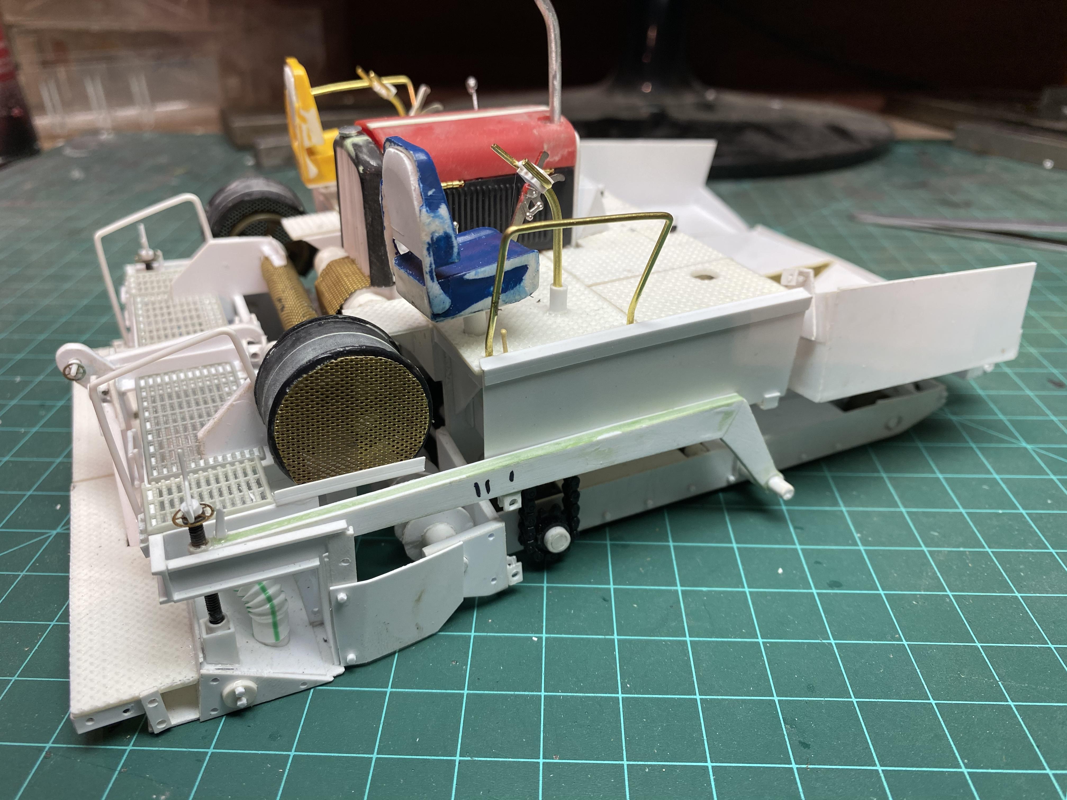

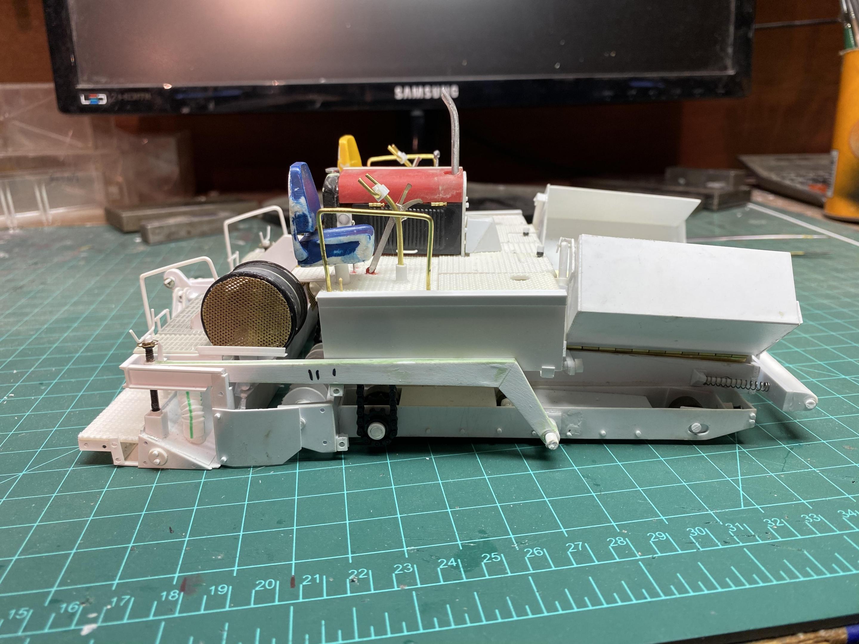

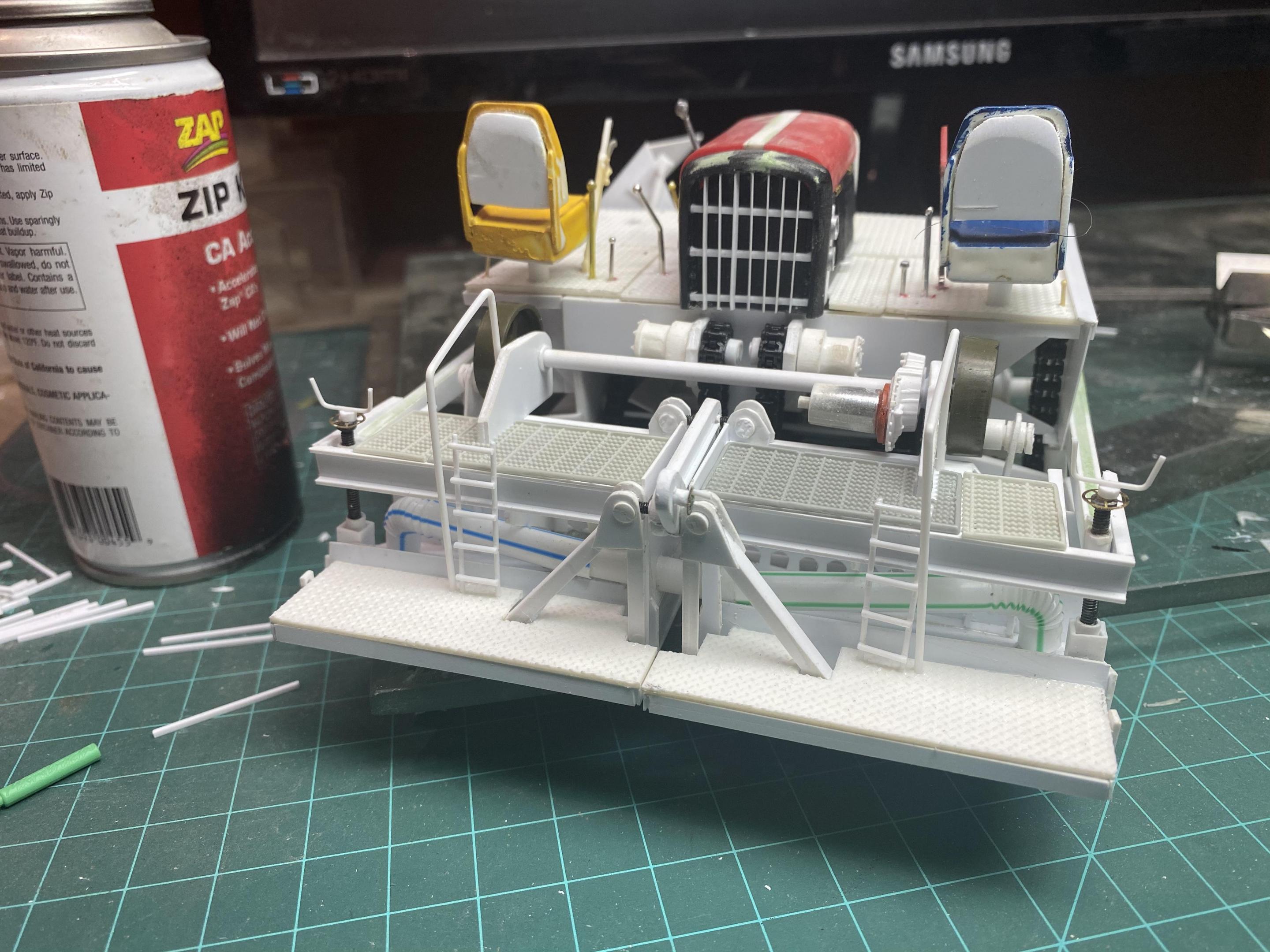

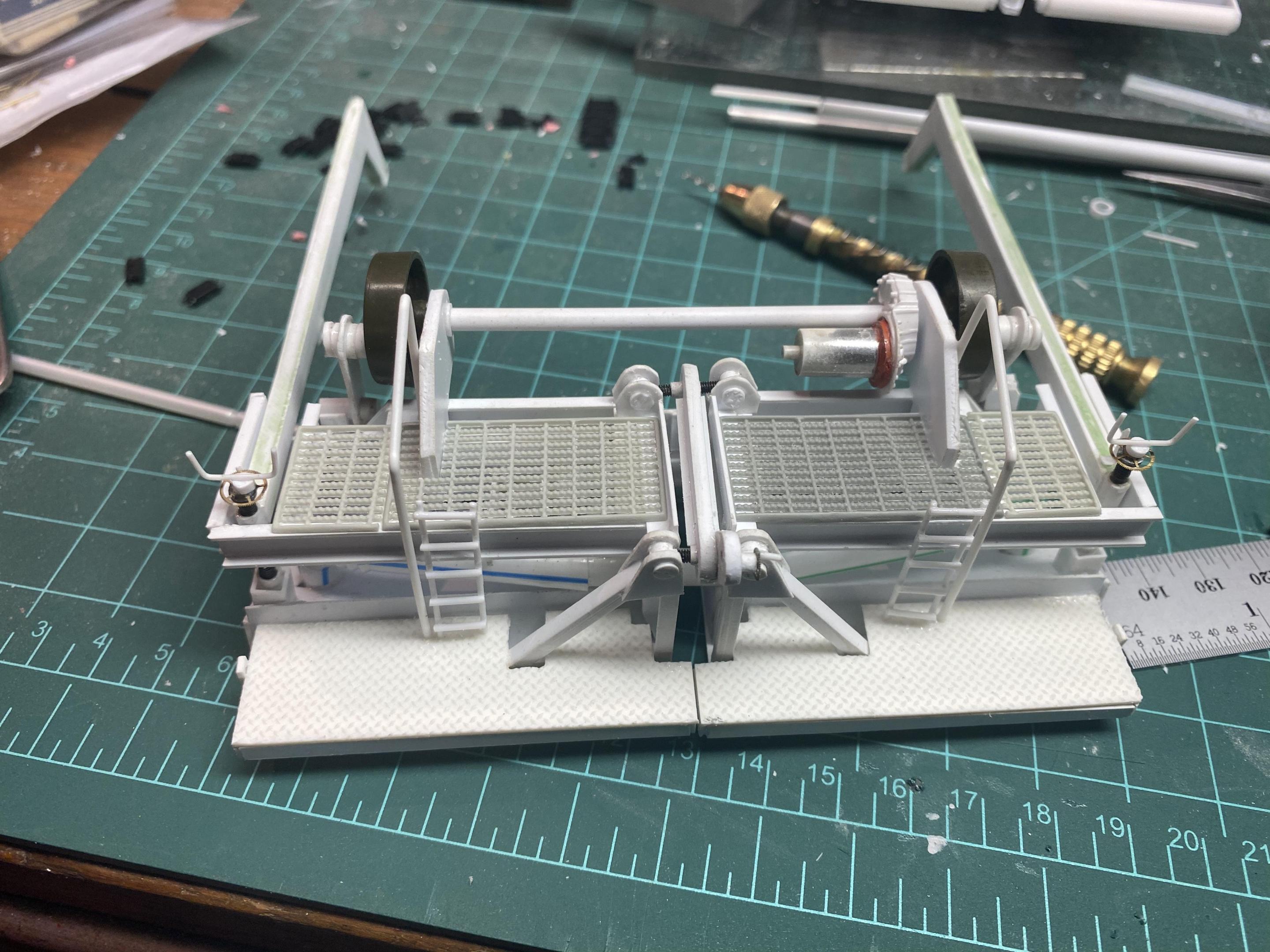

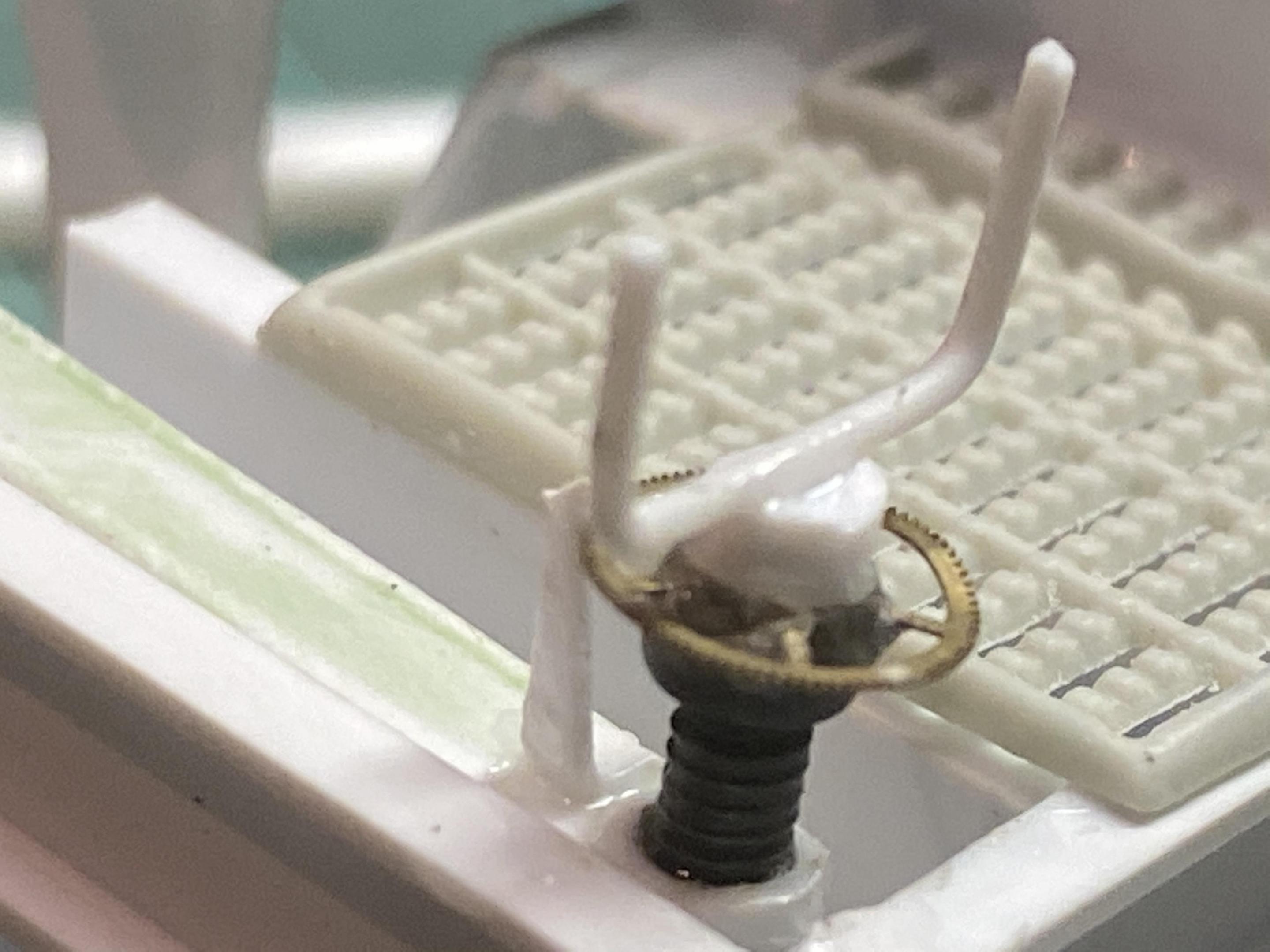

redneckrigger Posted March 23, 2020 Author Share Posted March 23, 2020 Added a few details to the screed tonight. Put the hand spinners and ratchet stops on the thickness controls, handrails and ladder steps, as well as the crown control drive and handwheel. Quote Link to comment Share on other sites More sharing options...
bobthehobbyguy Posted March 23, 2020 Share Posted March 23, 2020 Wow. Just came across. A tour de force in scratchbuilding. Goes to show if you want something bad enough you can find a way to make it happen. Quote Link to comment Share on other sites More sharing options...

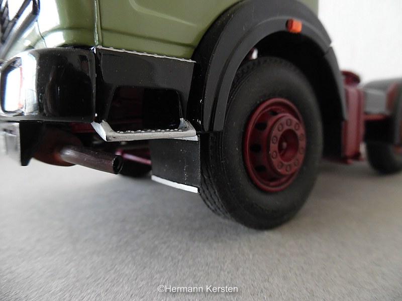

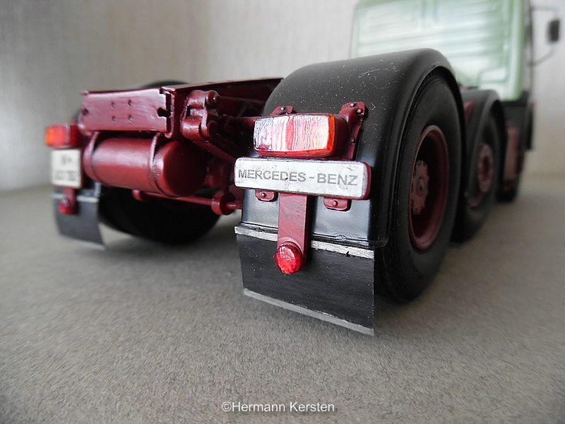

Hermann Kersten Posted March 23, 2020 Share Posted March 23, 2020 (edited) On 3/16/2020 at 9:56 PM, redneckrigger said: Still figuring what to use for rubber flaps. Need something very thin and flexible but it can wait until the very end. There is also another idea, just ordinary paper, I used it often on my trucks as mudflaps. Just paint both sides and when its dry, you can bend them in any position you want, even you want them curved. I glued them with ordinary hobby glue. Keep up the awesome detailing work.? Hermann. Edited March 23, 2020 by Hermann Kersten Quote Link to comment Share on other sites More sharing options...
redneckrigger Posted March 24, 2020 Author Share Posted March 24, 2020 18 hours ago, Hermann Kersten said: There is also another idea, just ordinary paper, I used it often on my trucks as mudflaps. Just paint both sides and when its dry, you can bend them in any position you want, even you want them curved. I glued them with ordinary hobby glue. Keep up the awesome detailing work.? Hermann. Thank you.........that is a great idea. I will give it a try! Quote Link to comment Share on other sites More sharing options...

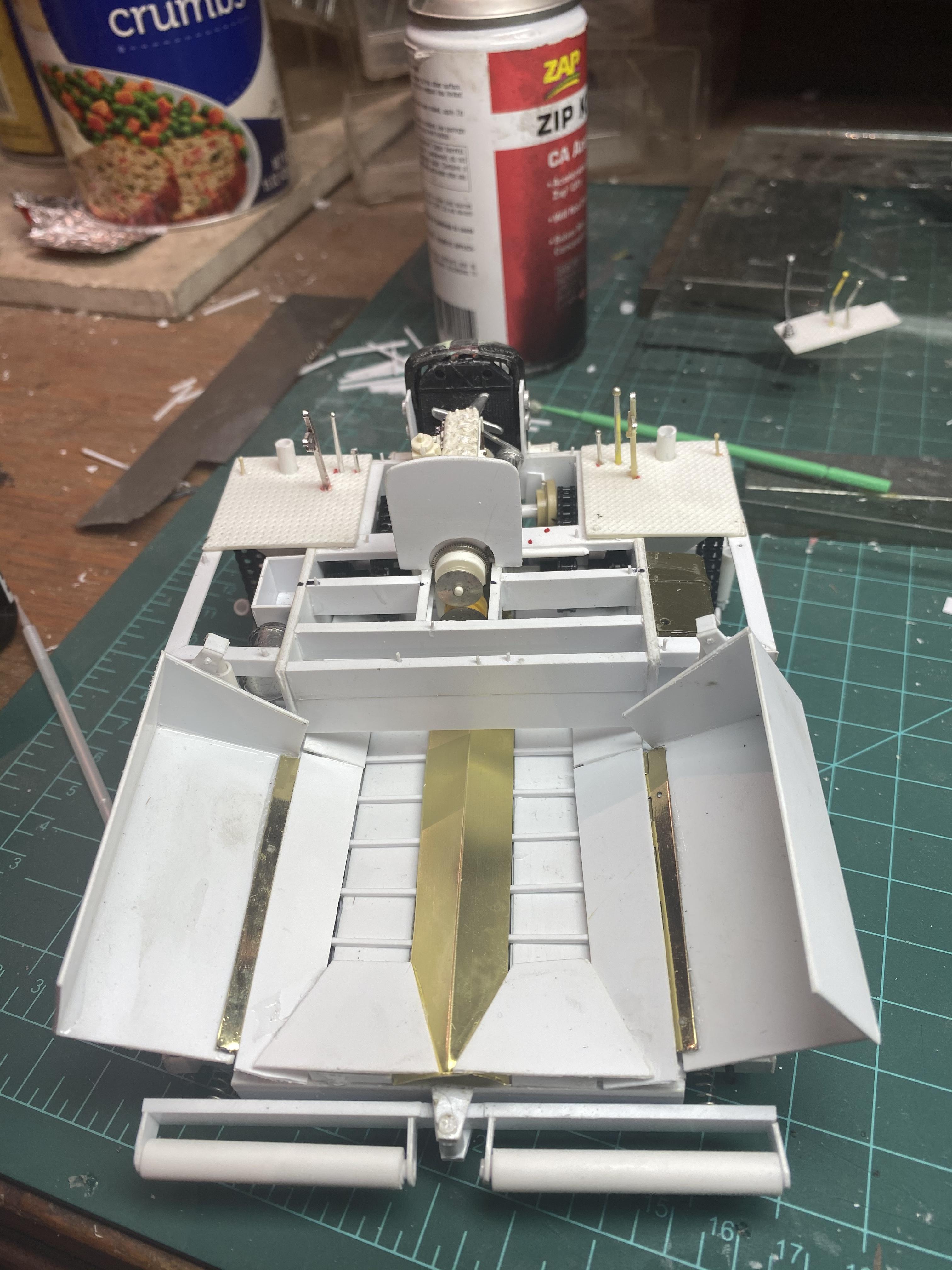

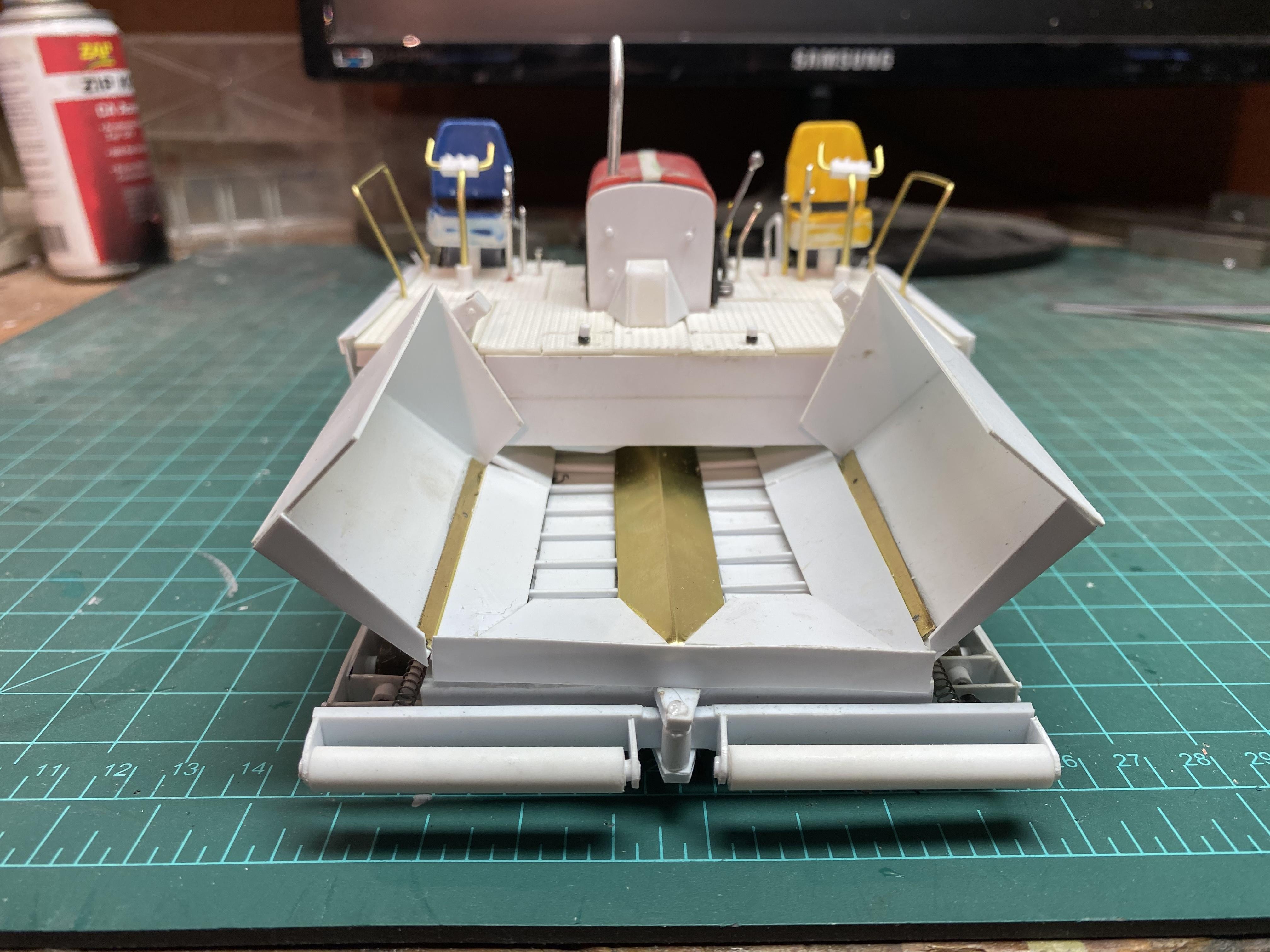

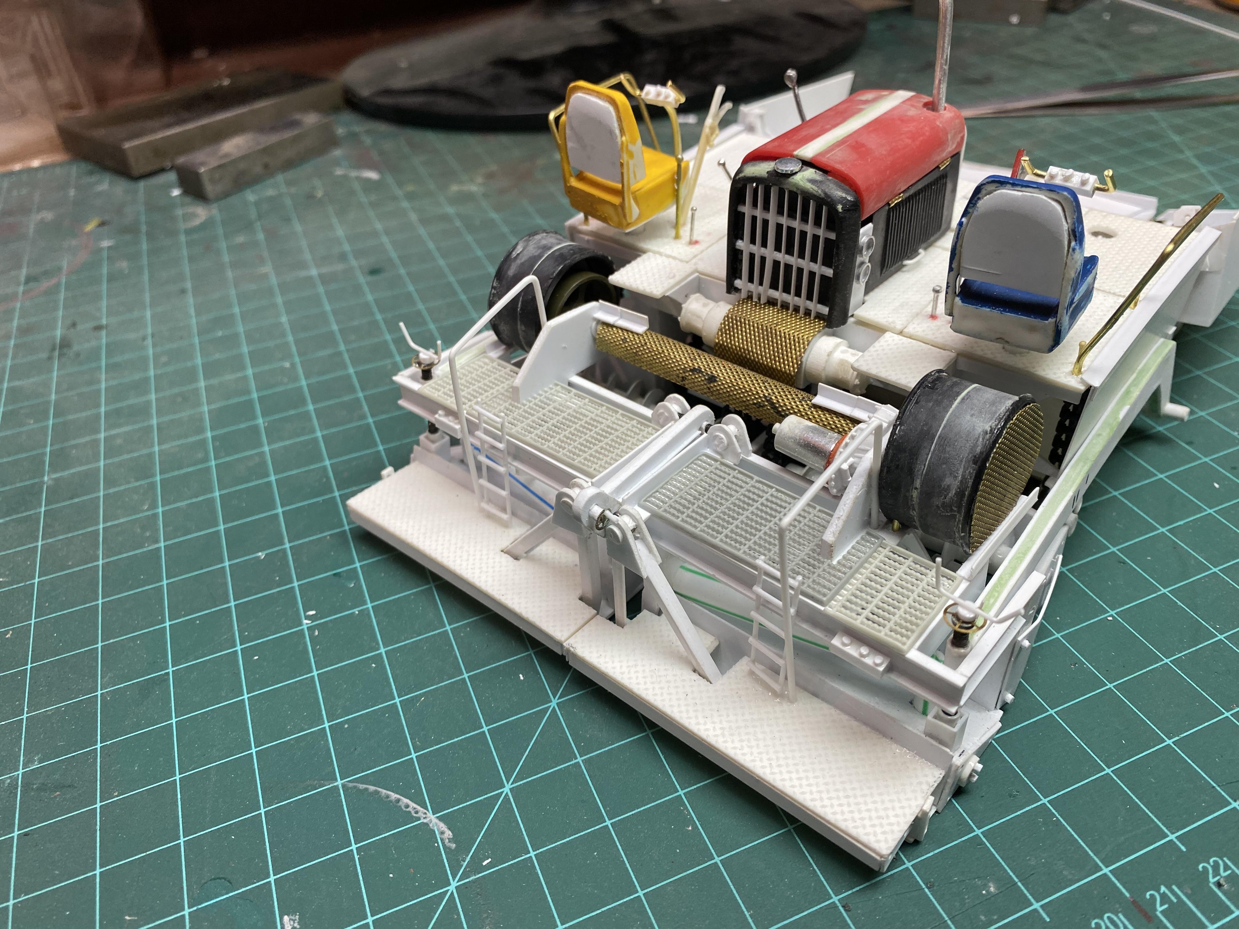

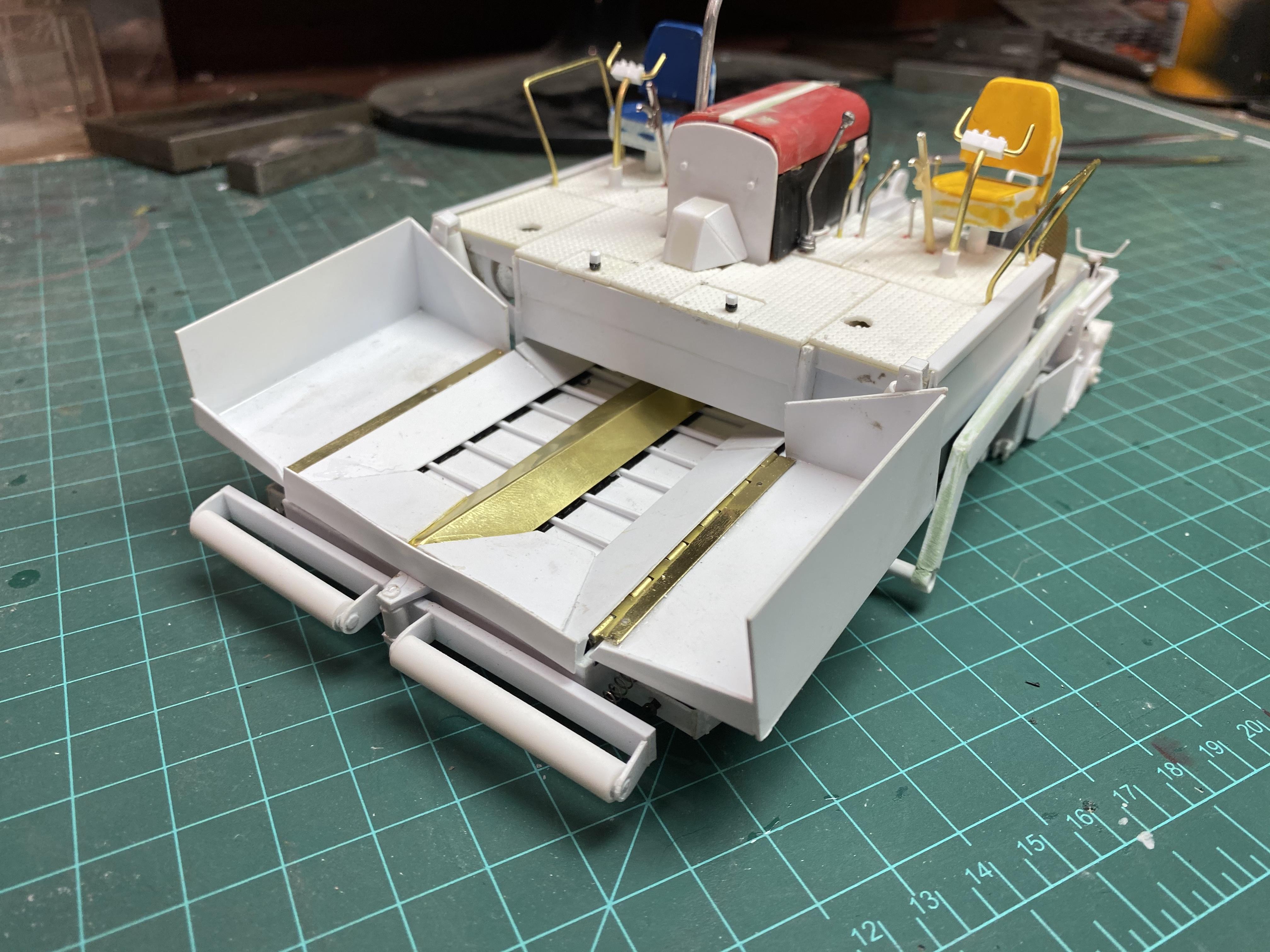

redneckrigger Posted March 25, 2020 Author Share Posted March 25, 2020 (edited) Now you guys are trying to get me REAL confused! I actually have thought of something like that but it goes against my routine of doing paintshop fresh builds! I may do some staining and very mild weathering but adding blacktop???? Hmmmmmmmm! Lots of detailing to do yet, but a rough mockup is shown. Have controls, and literally days worth of details to add. This is absolutely the most difficult and complex build I have done yet, out of the Galion crane, roller, RGN lowboy etc. This is over the top. Not only does it have a zillion parts, it is something I am mot intimately familiar with, unlike the others. But, oh boy, has it been a fun ride so far! And lots more to go! And so much more to learn about this machine and new building techniques! This build HAS taken on a life of it's own. Edited March 26, 2020 by redneckrigger Quote Link to comment Share on other sites More sharing options...

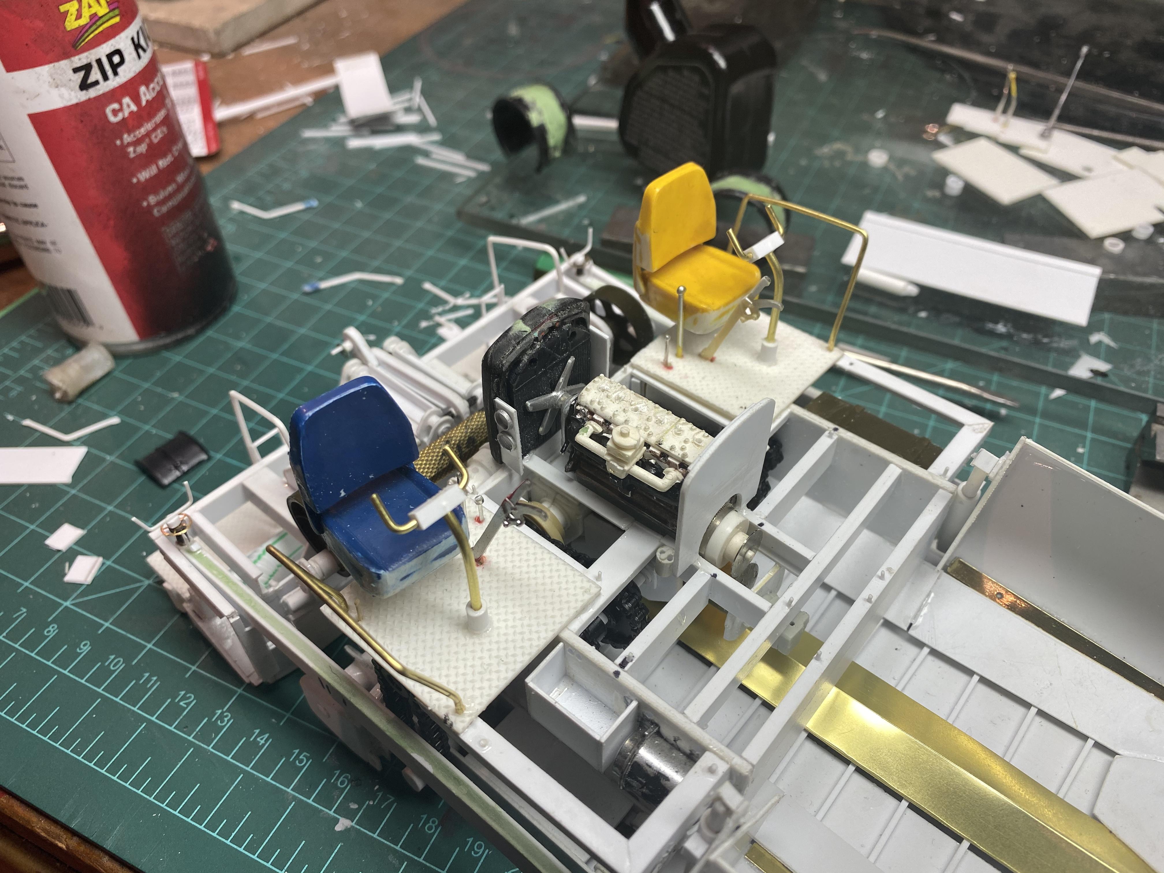

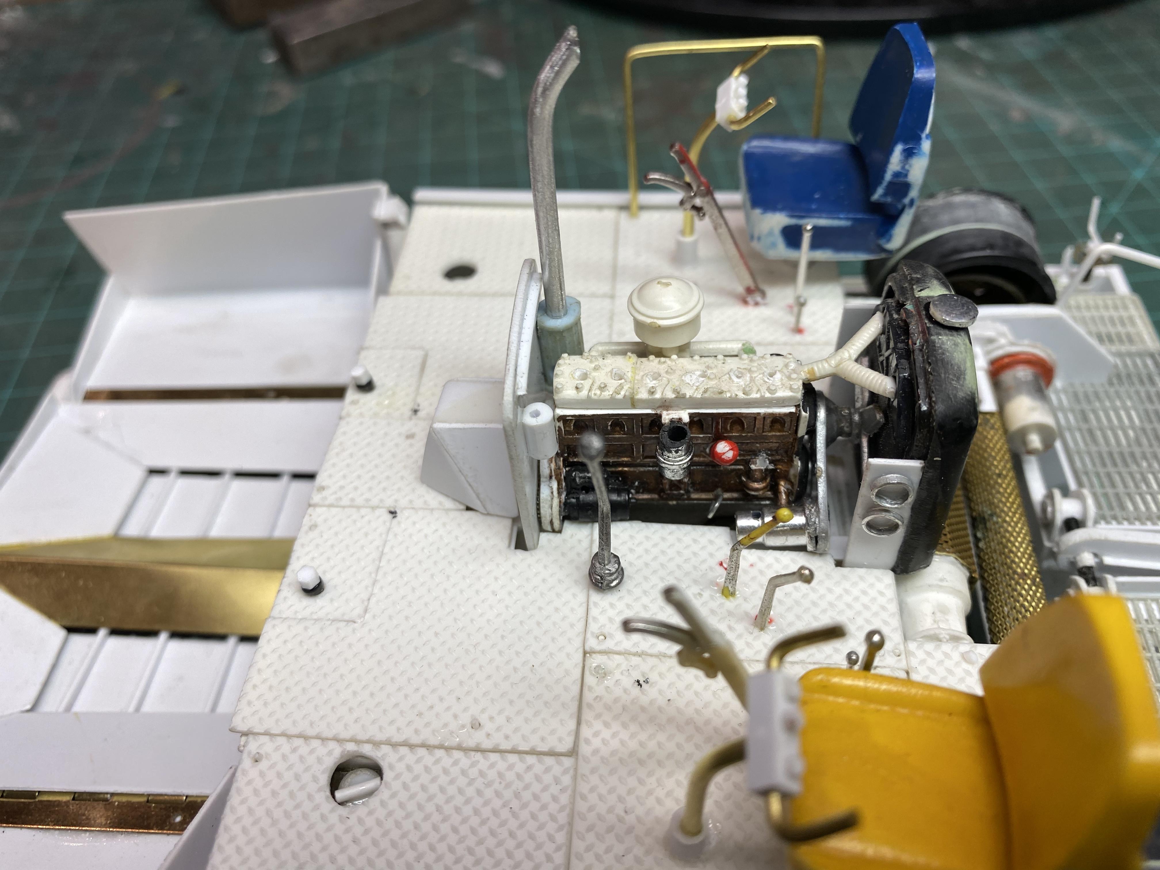

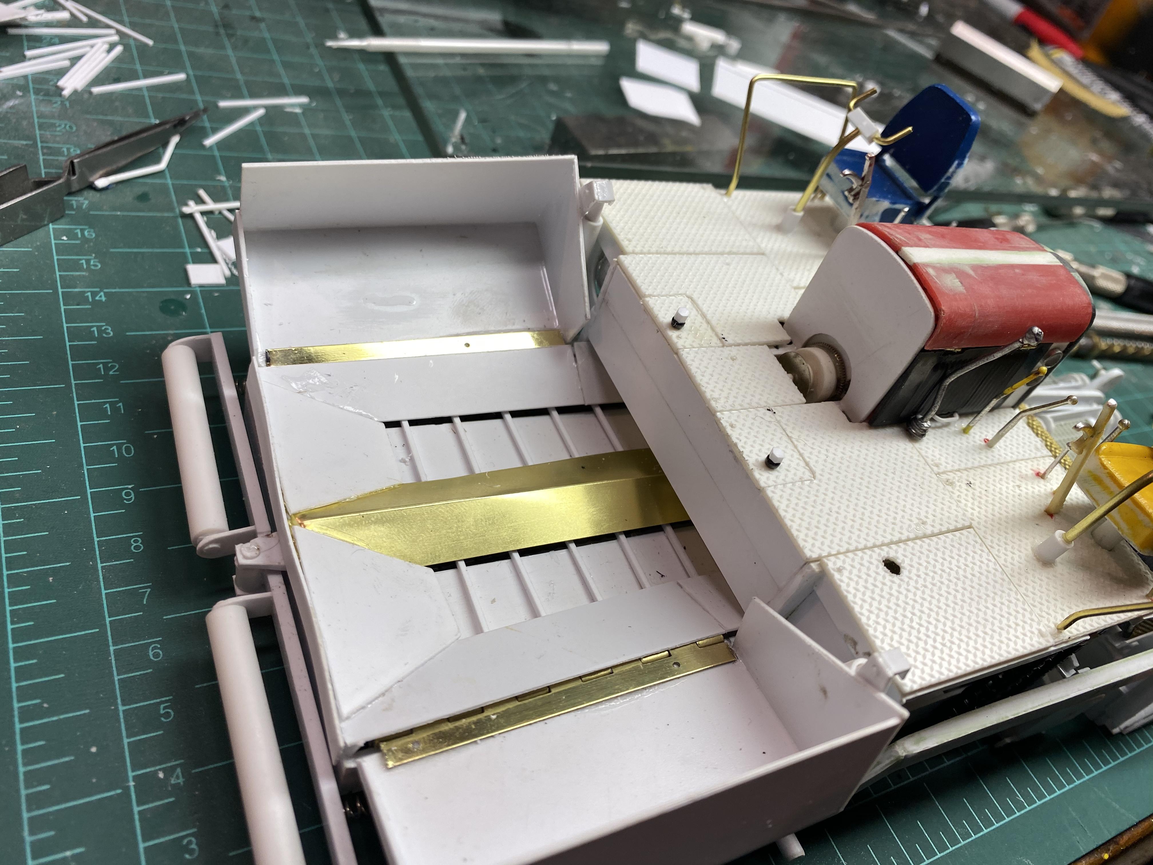

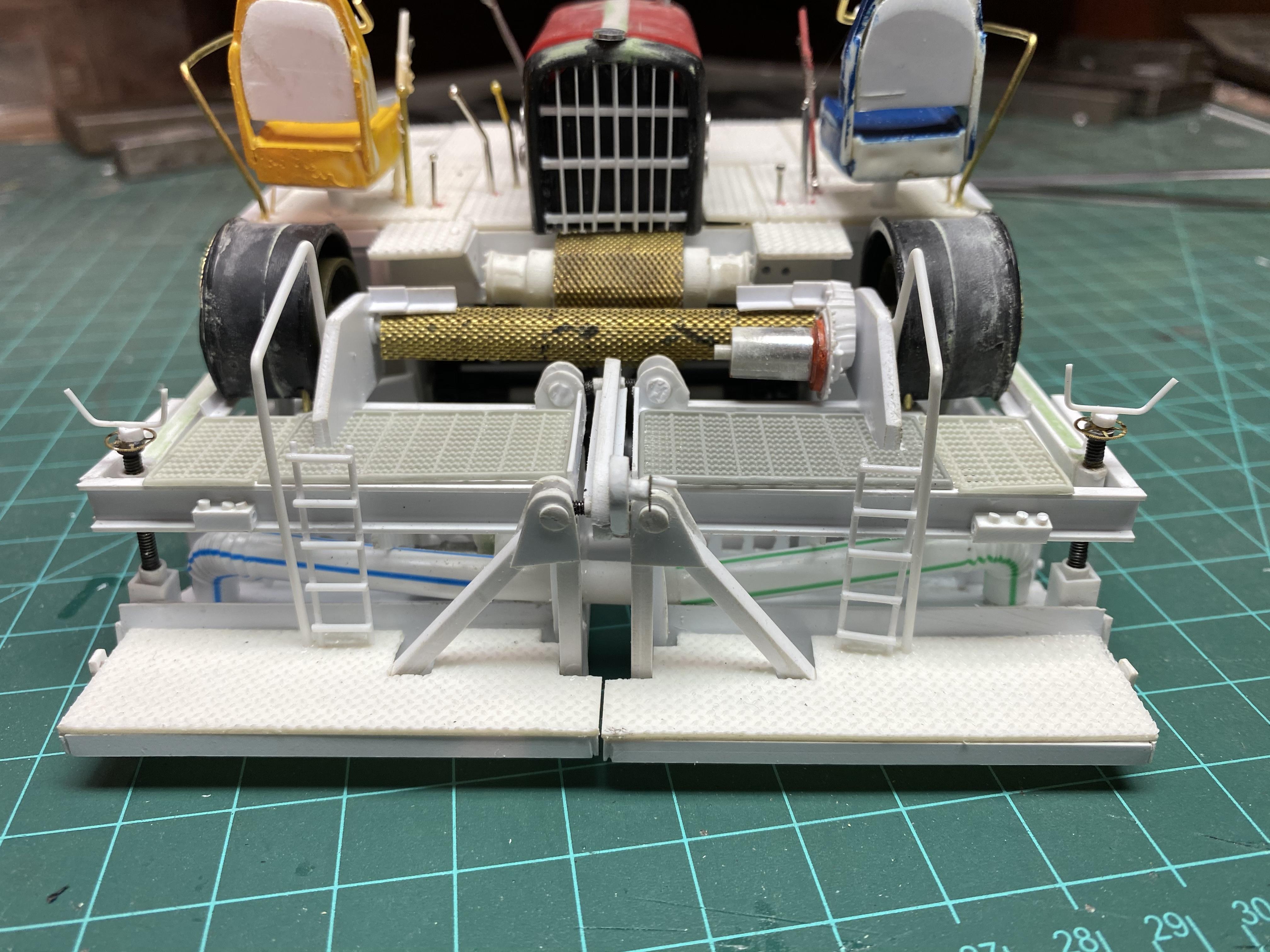

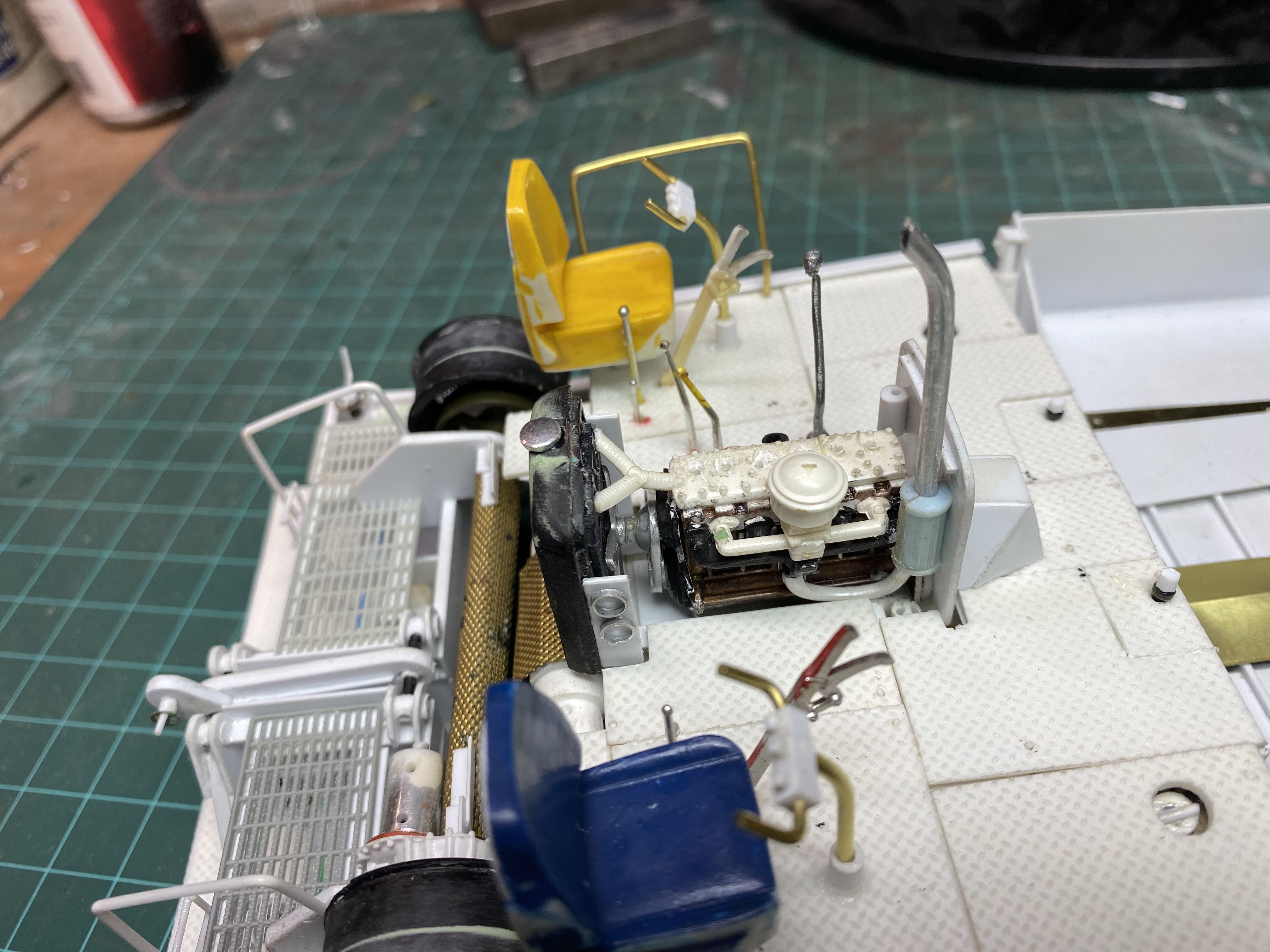

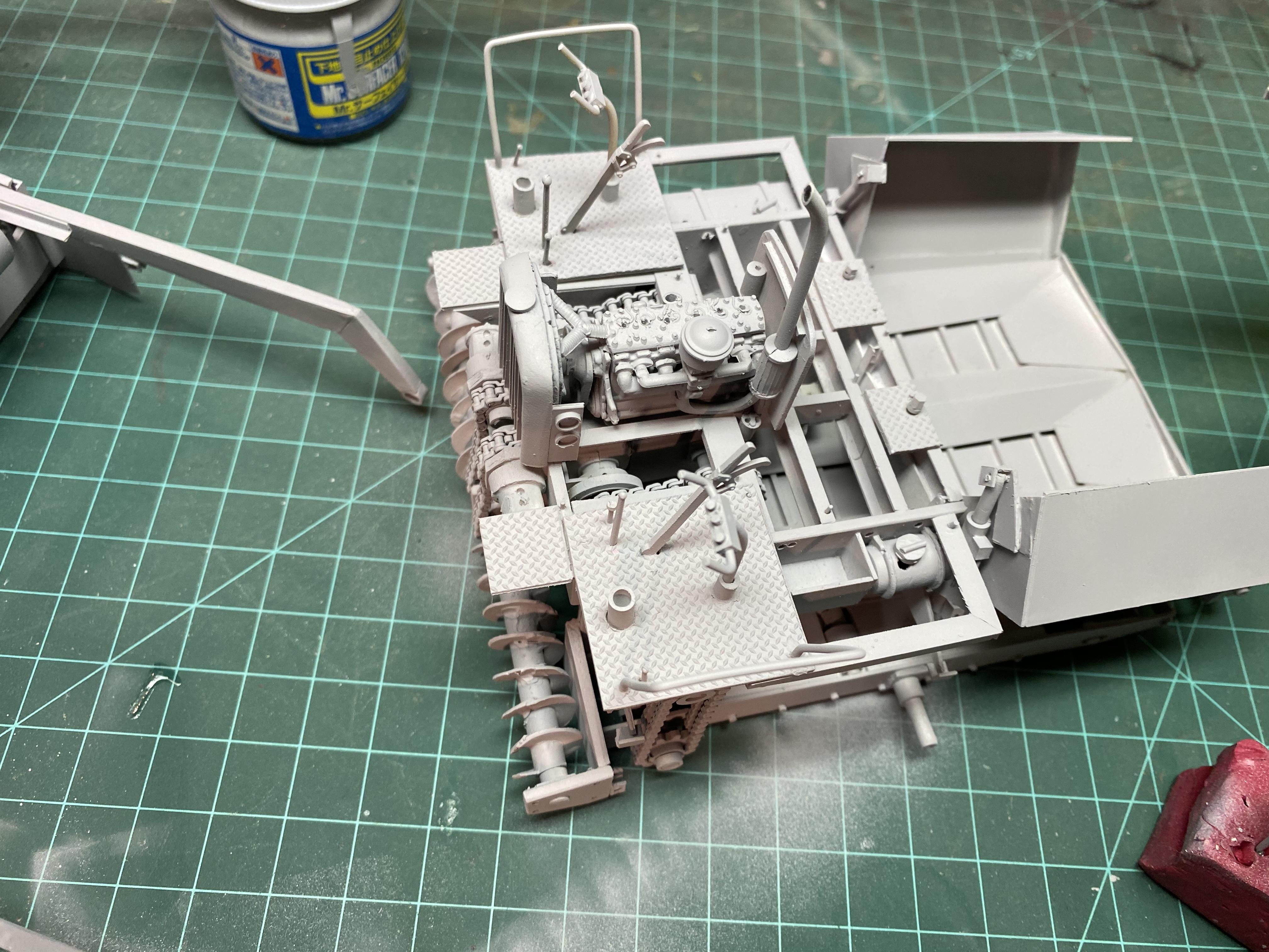

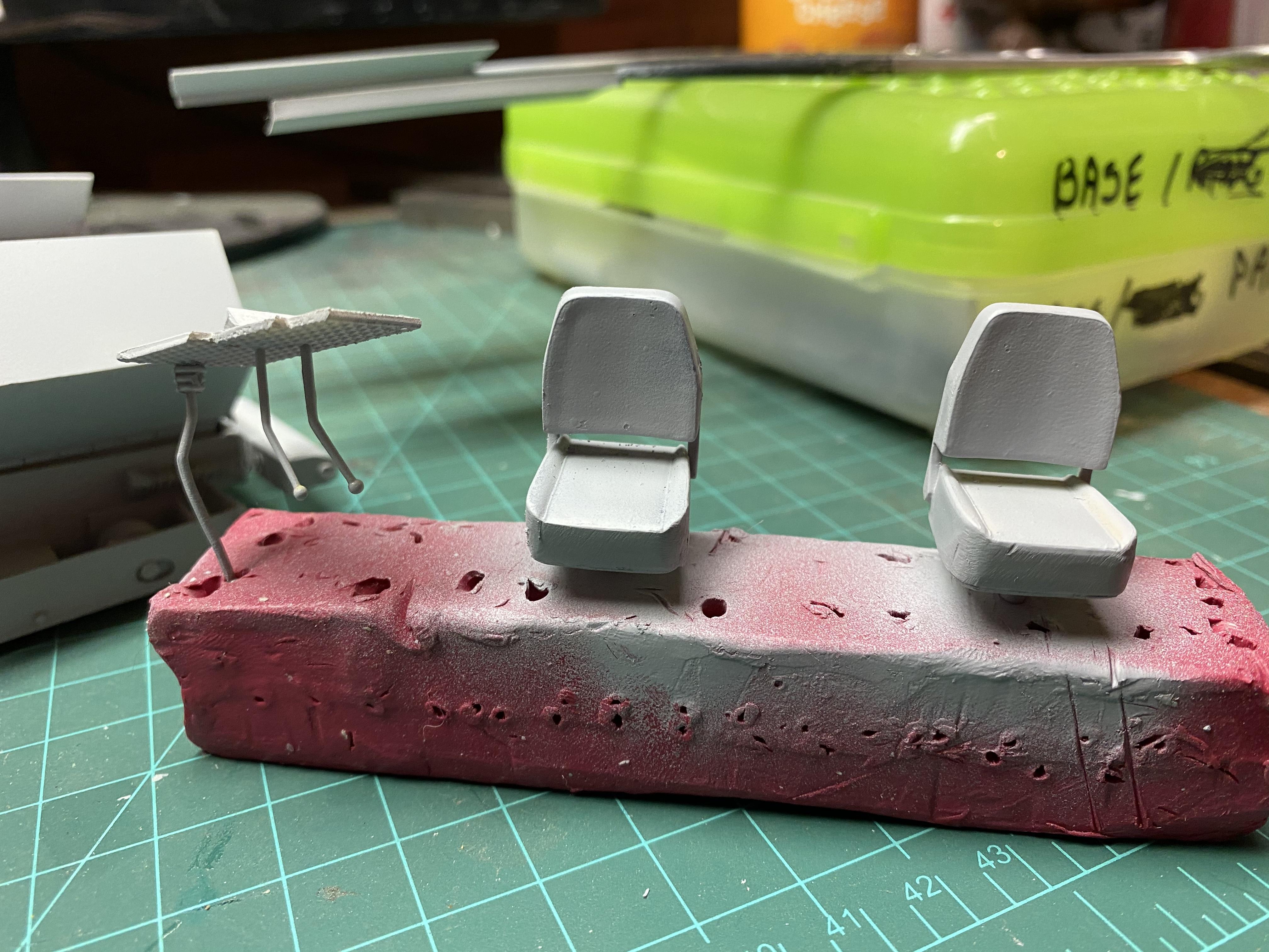

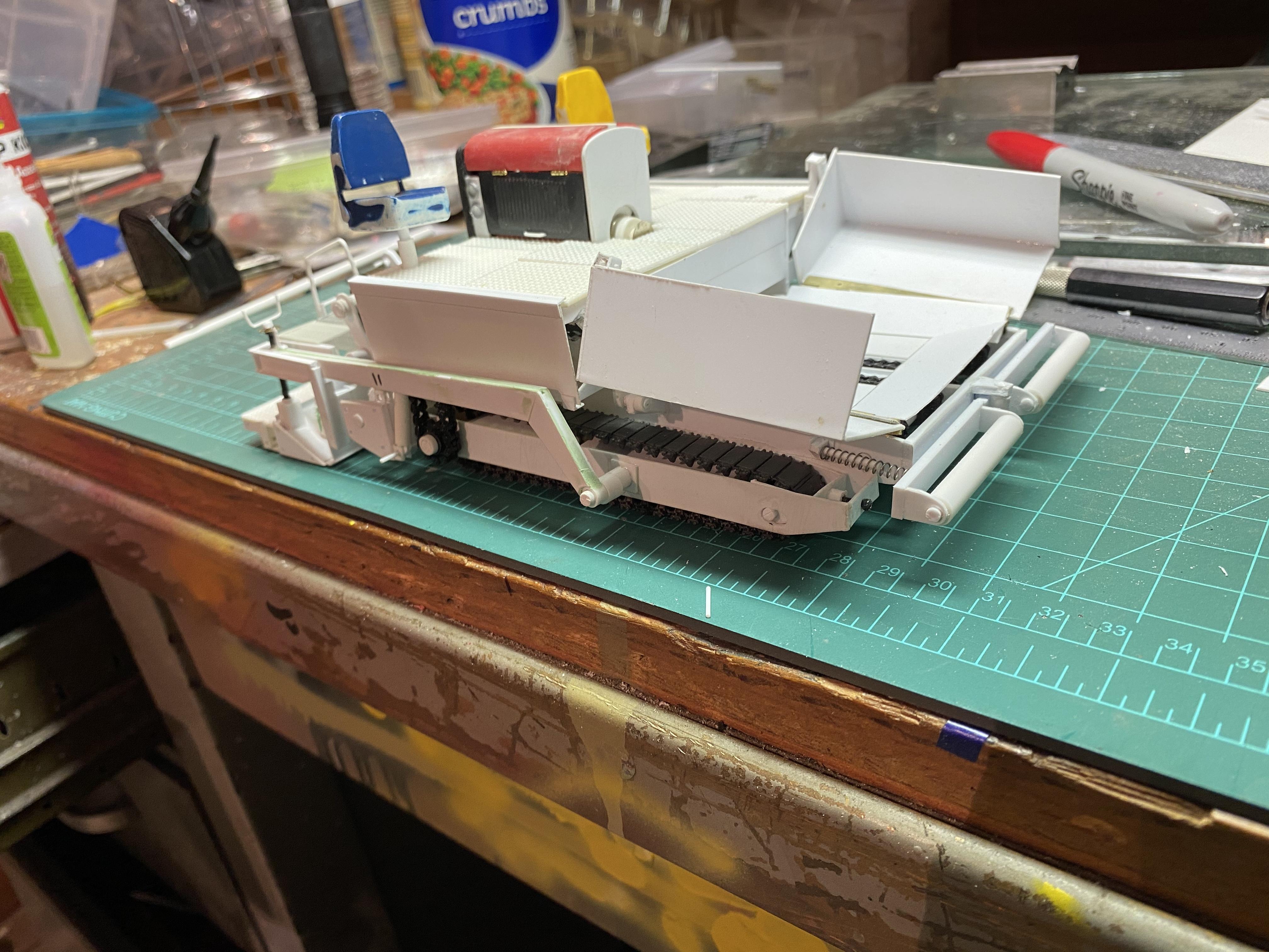

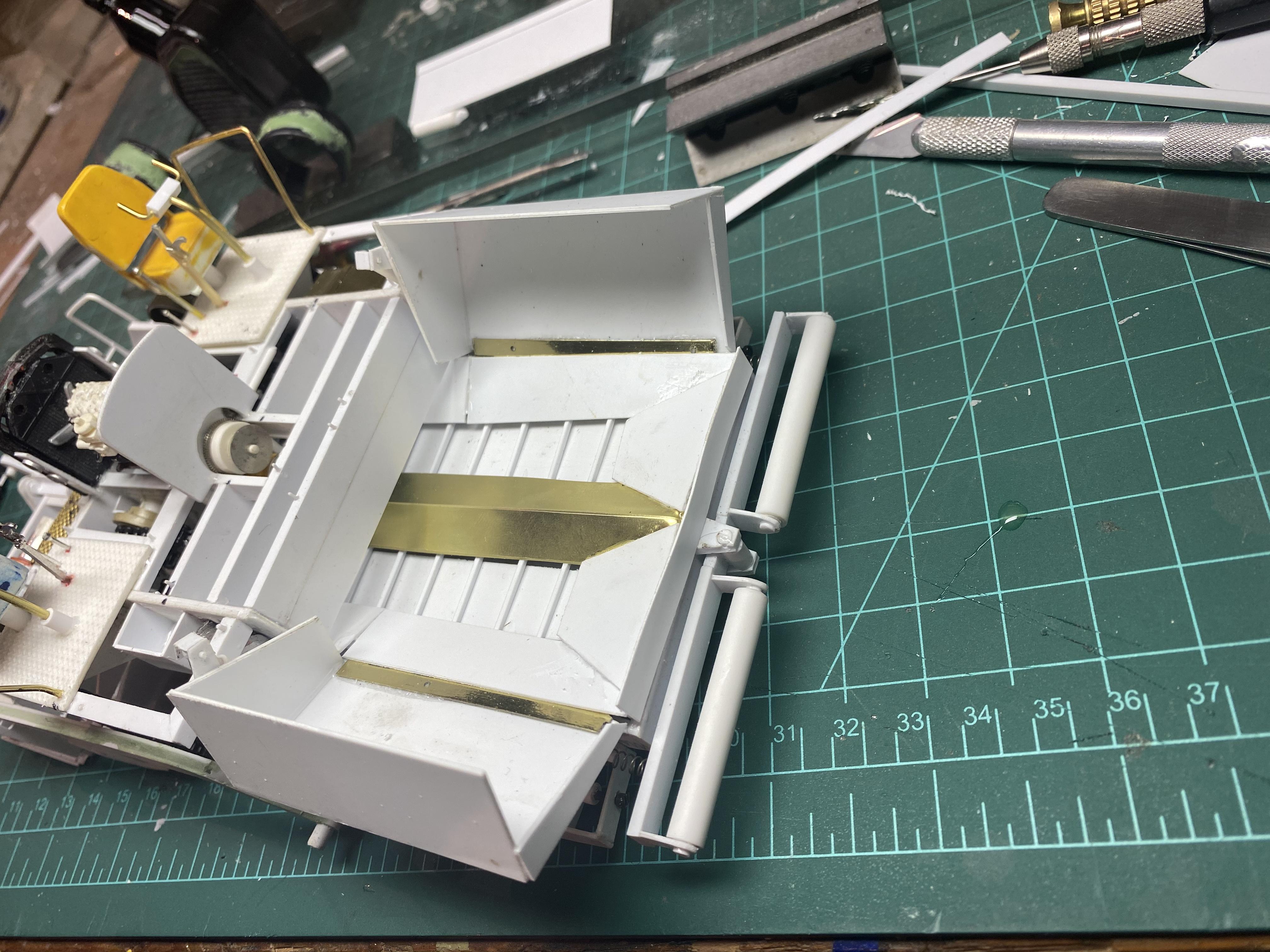

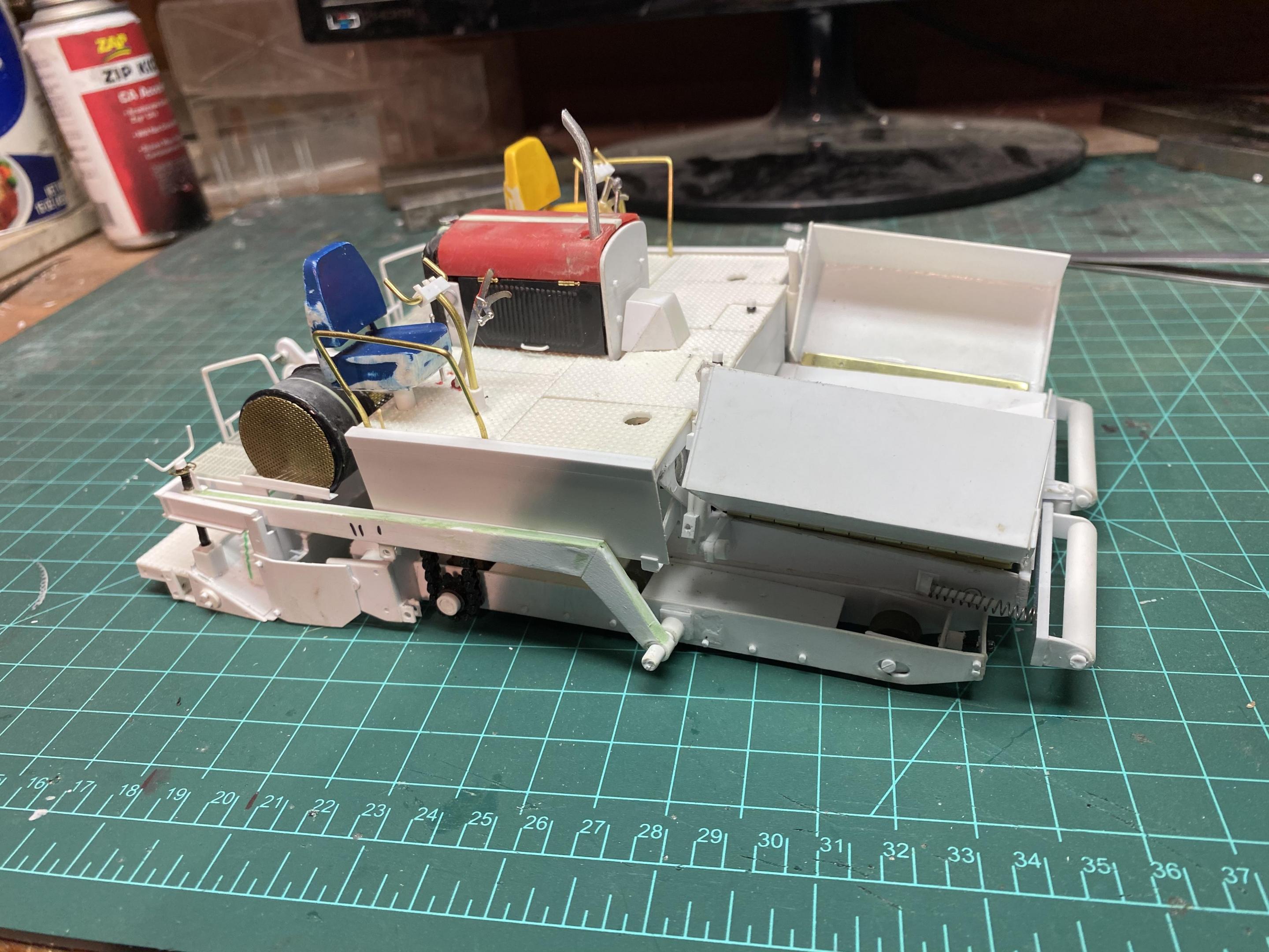

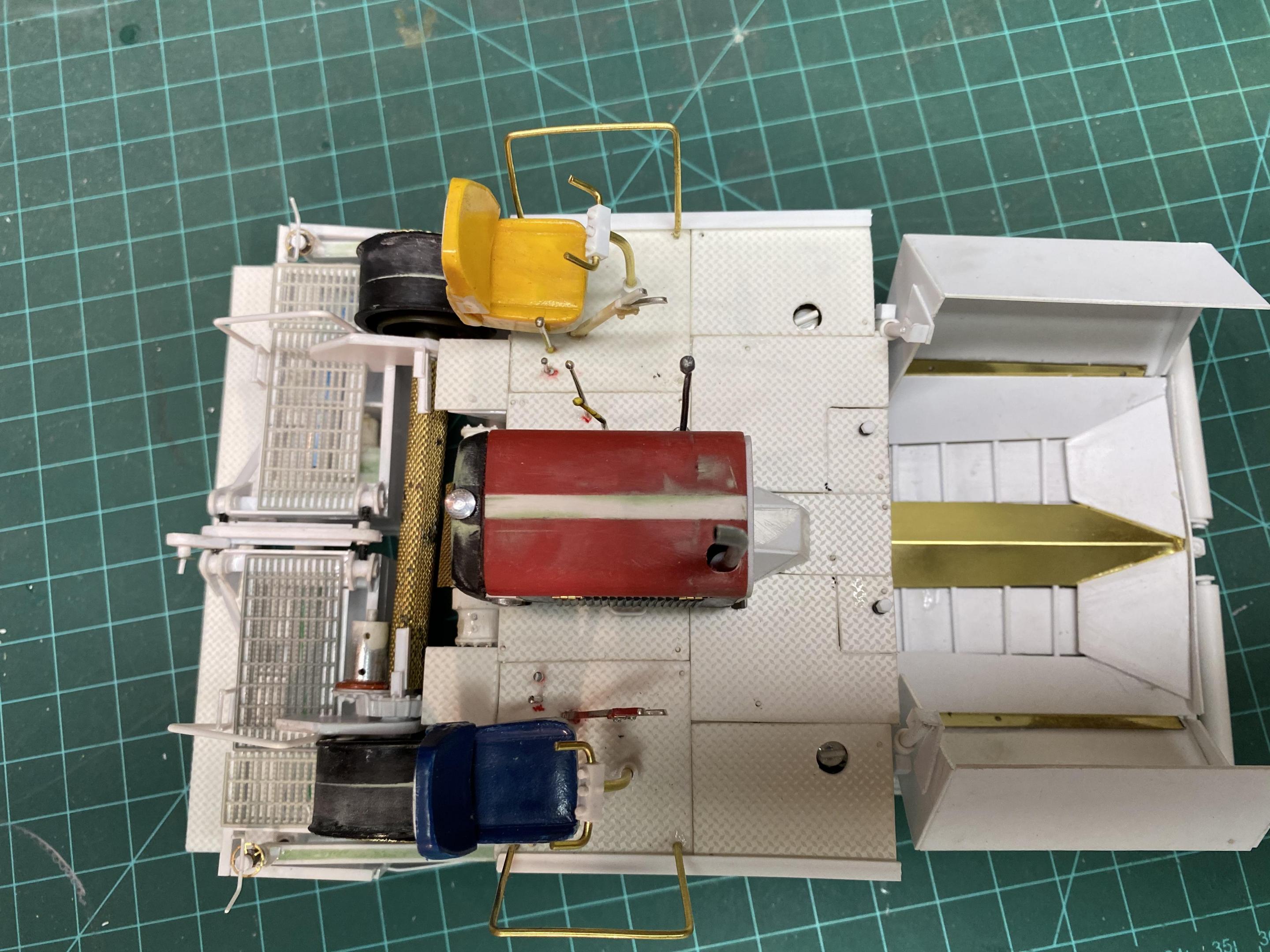

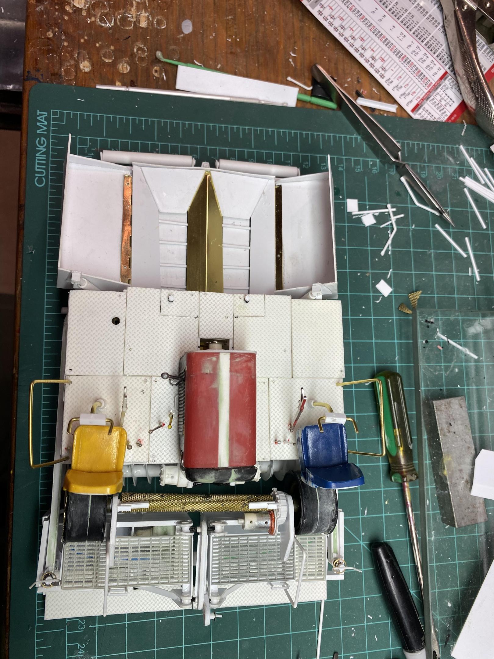

redneckrigger Posted March 29, 2020 Author Share Posted March 29, 2020 (edited) Added the operators seats, all control linkages and control levers. Installed the feeder drag bars and built the feed hopper shields. Still have to install the rubber flaps. Have to get to adding the hydraulic lines, engine details, tamper drive guards, and then see what else is screaming to be added! Edited March 29, 2020 by redneckrigger Quote Link to comment Share on other sites More sharing options...

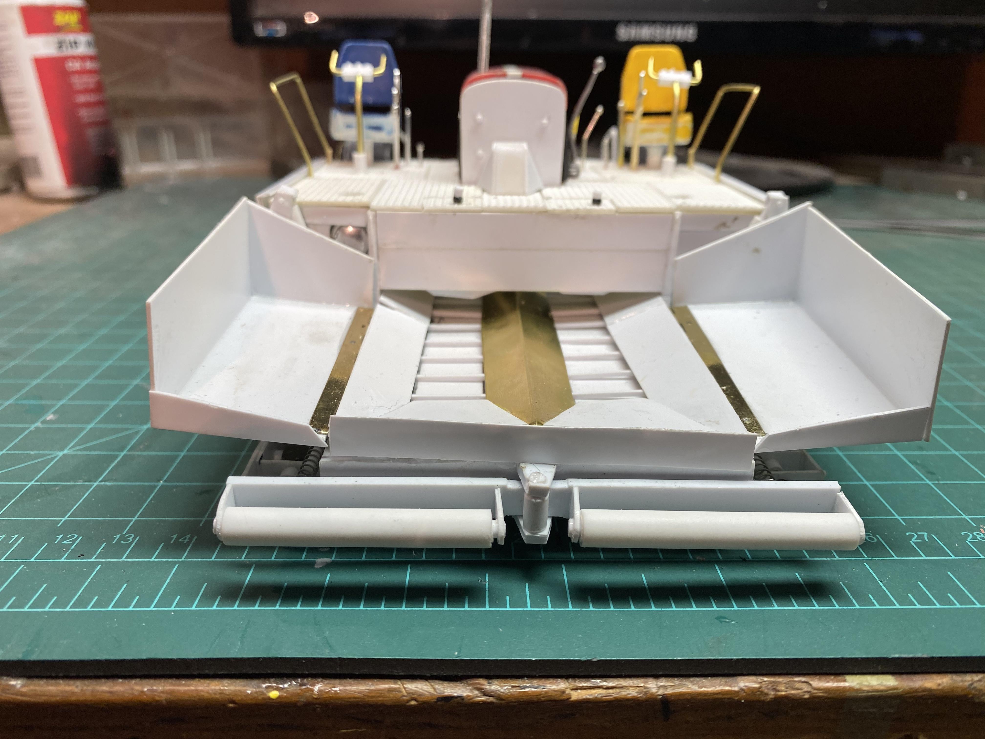

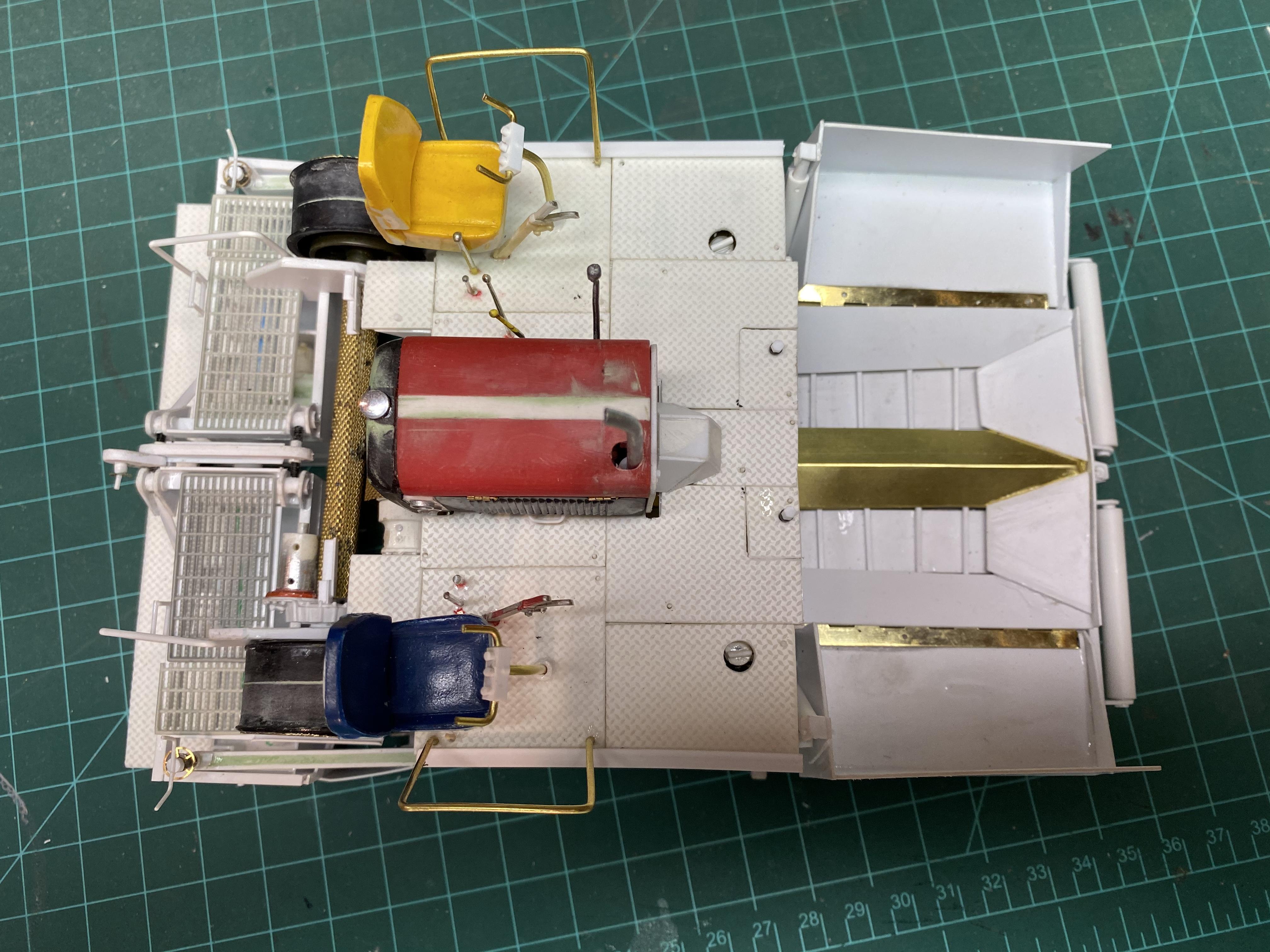

redneckrigger Posted March 29, 2020 Author Share Posted March 29, 2020 Finished adding the steering controls, seats and handrails, tamper driveshaft guard, and finished the hopper. Lots more yet! Quote Link to comment Share on other sites More sharing options...

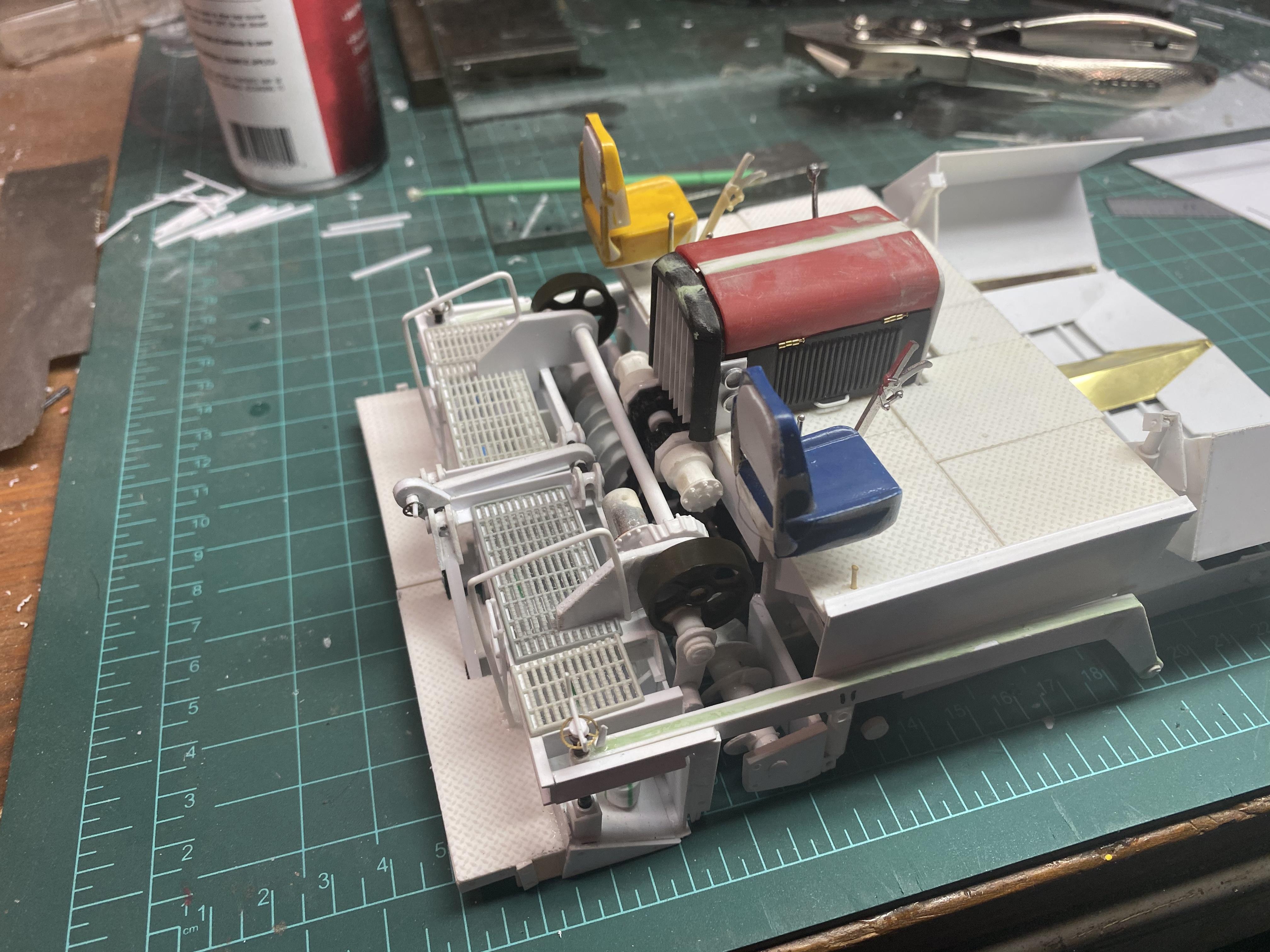

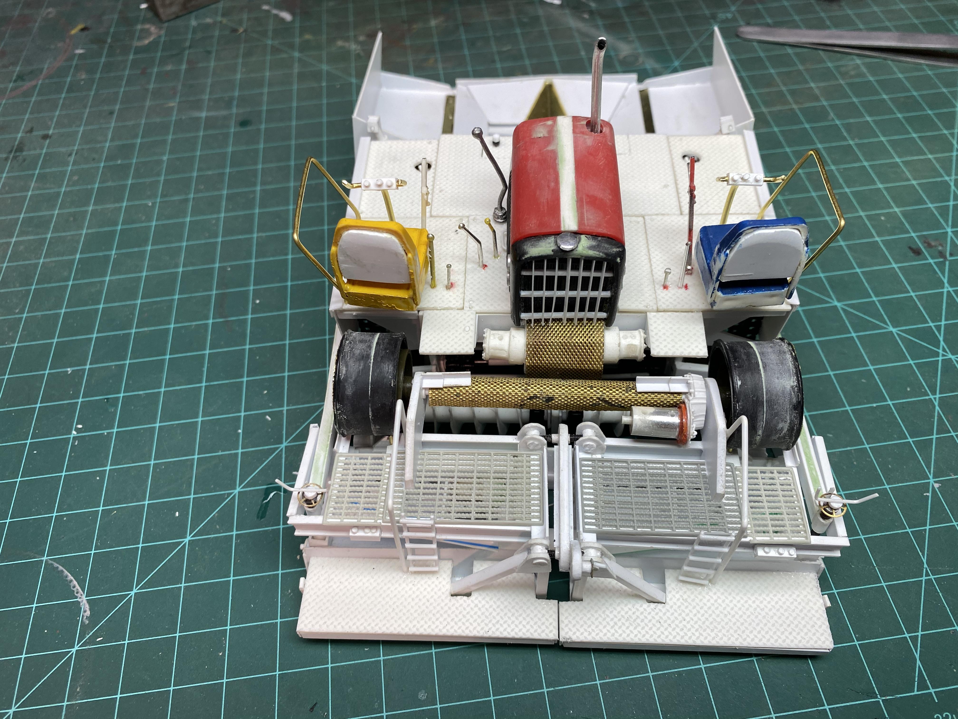

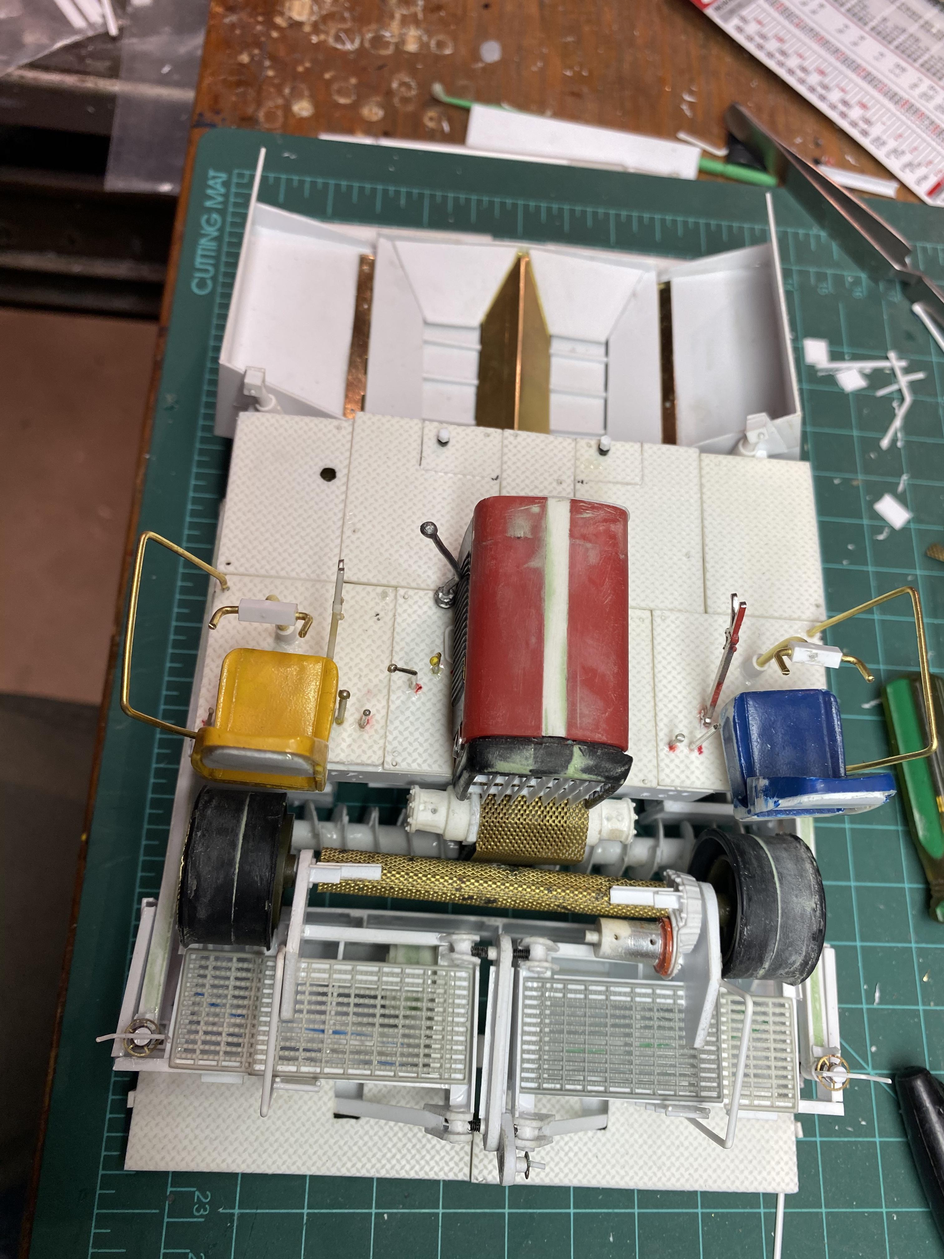

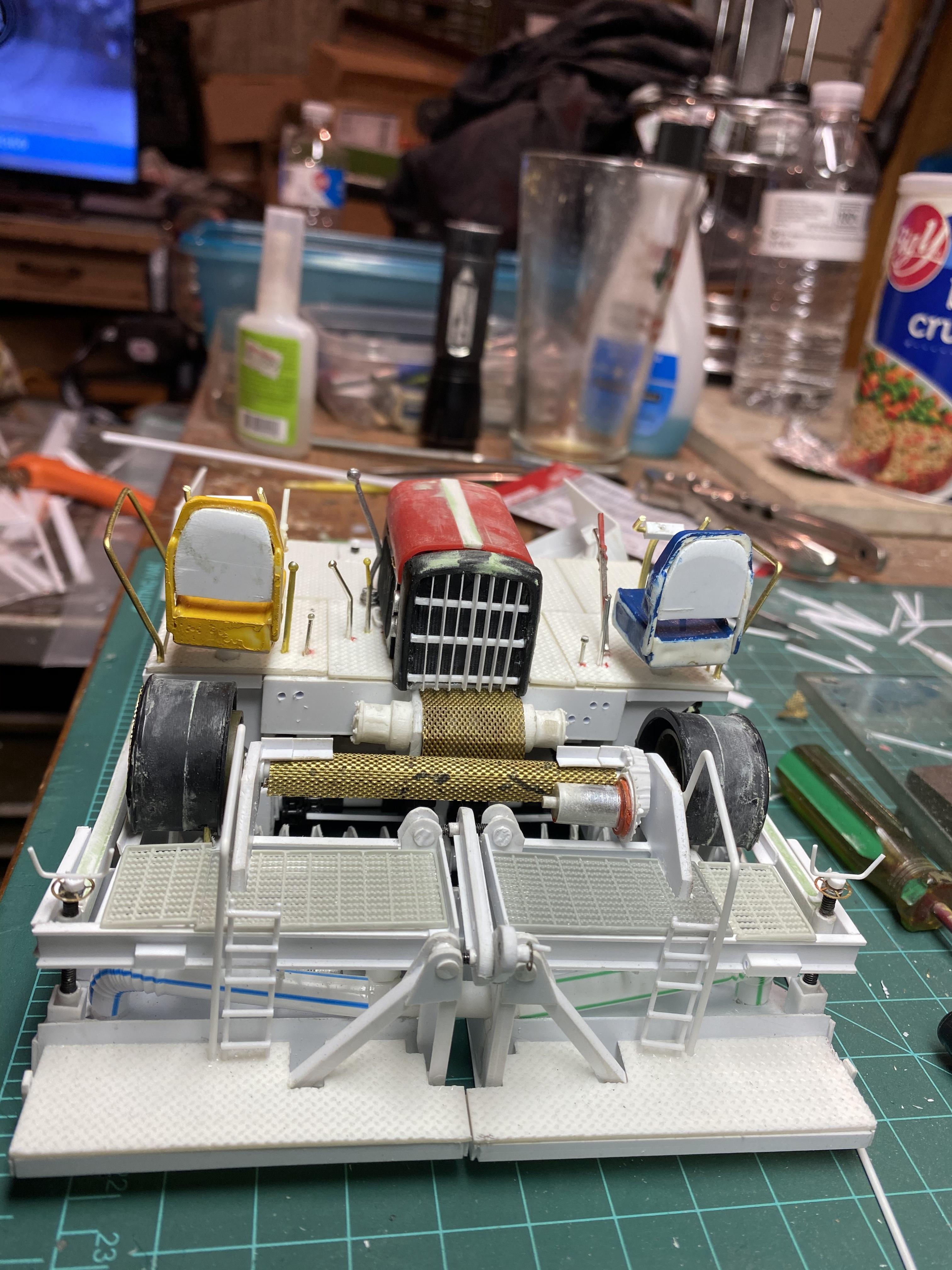

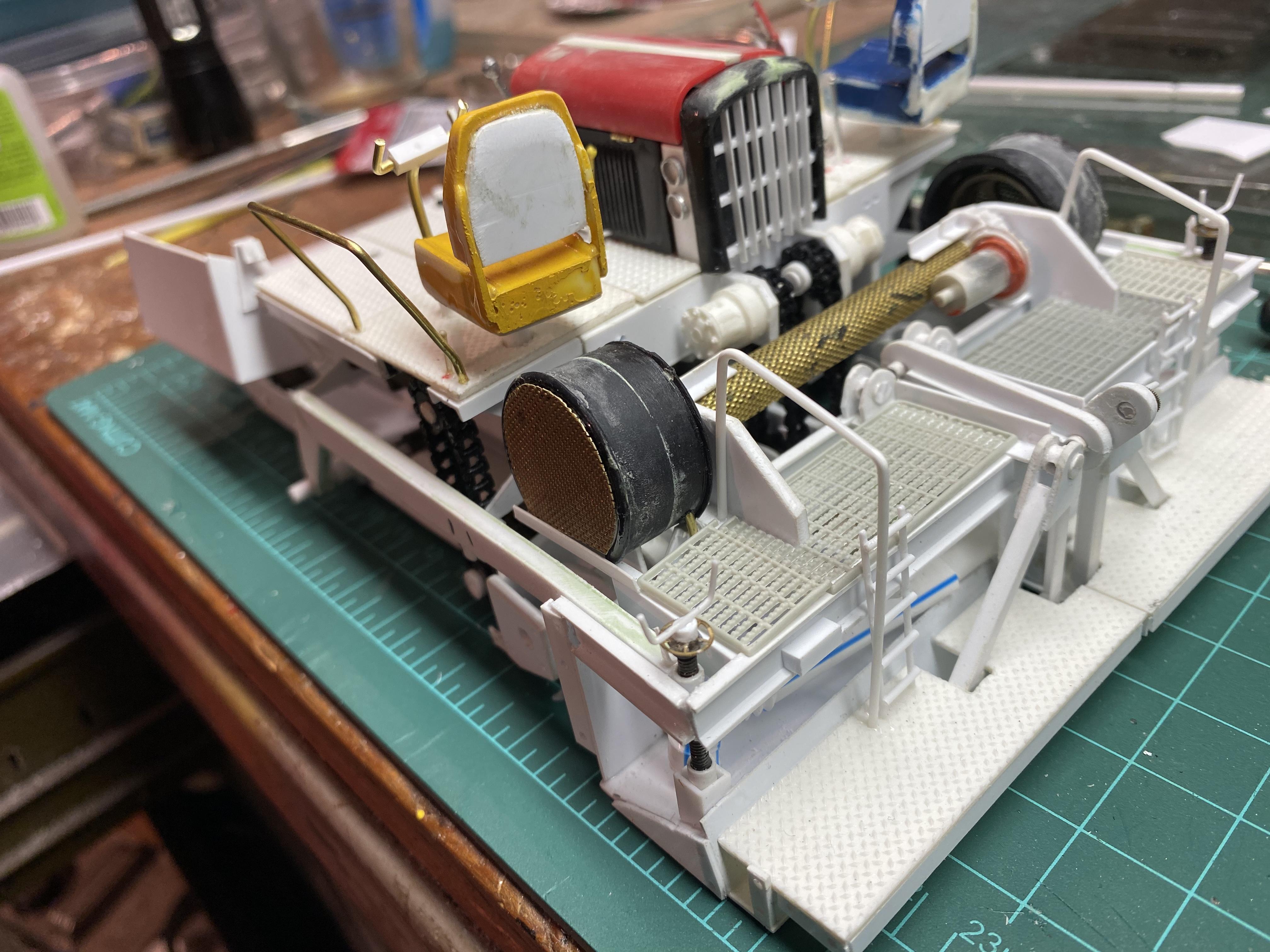

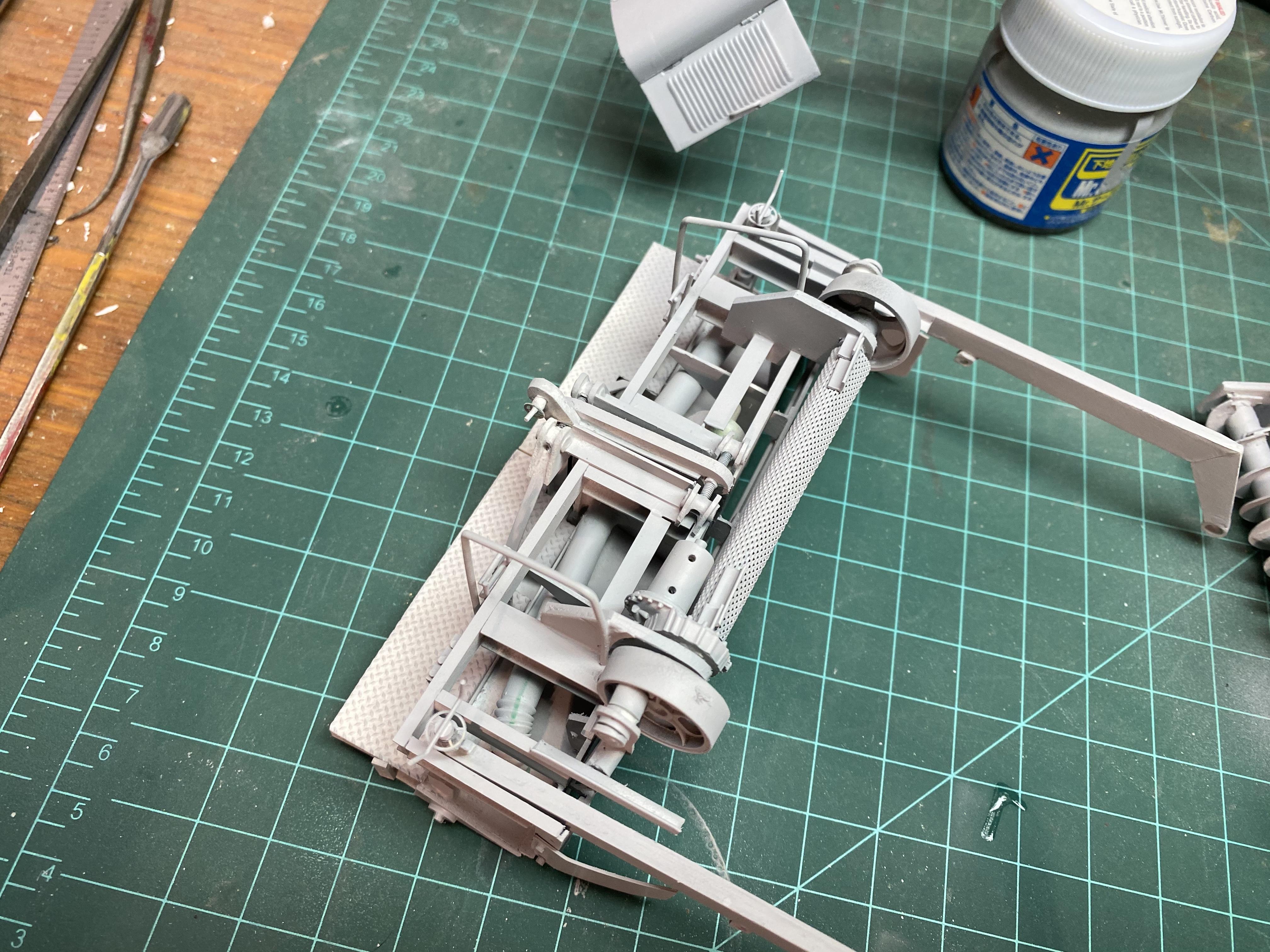

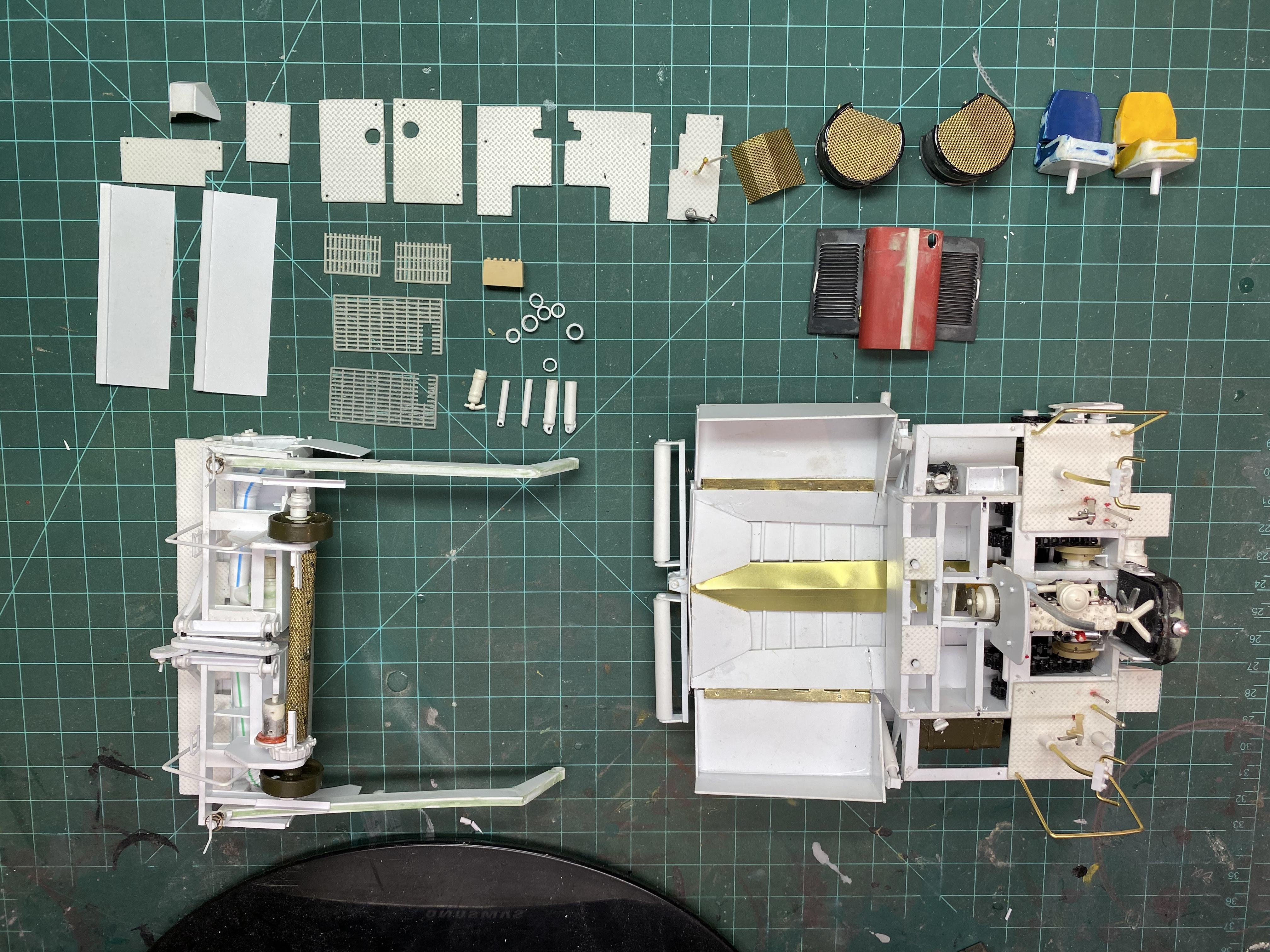

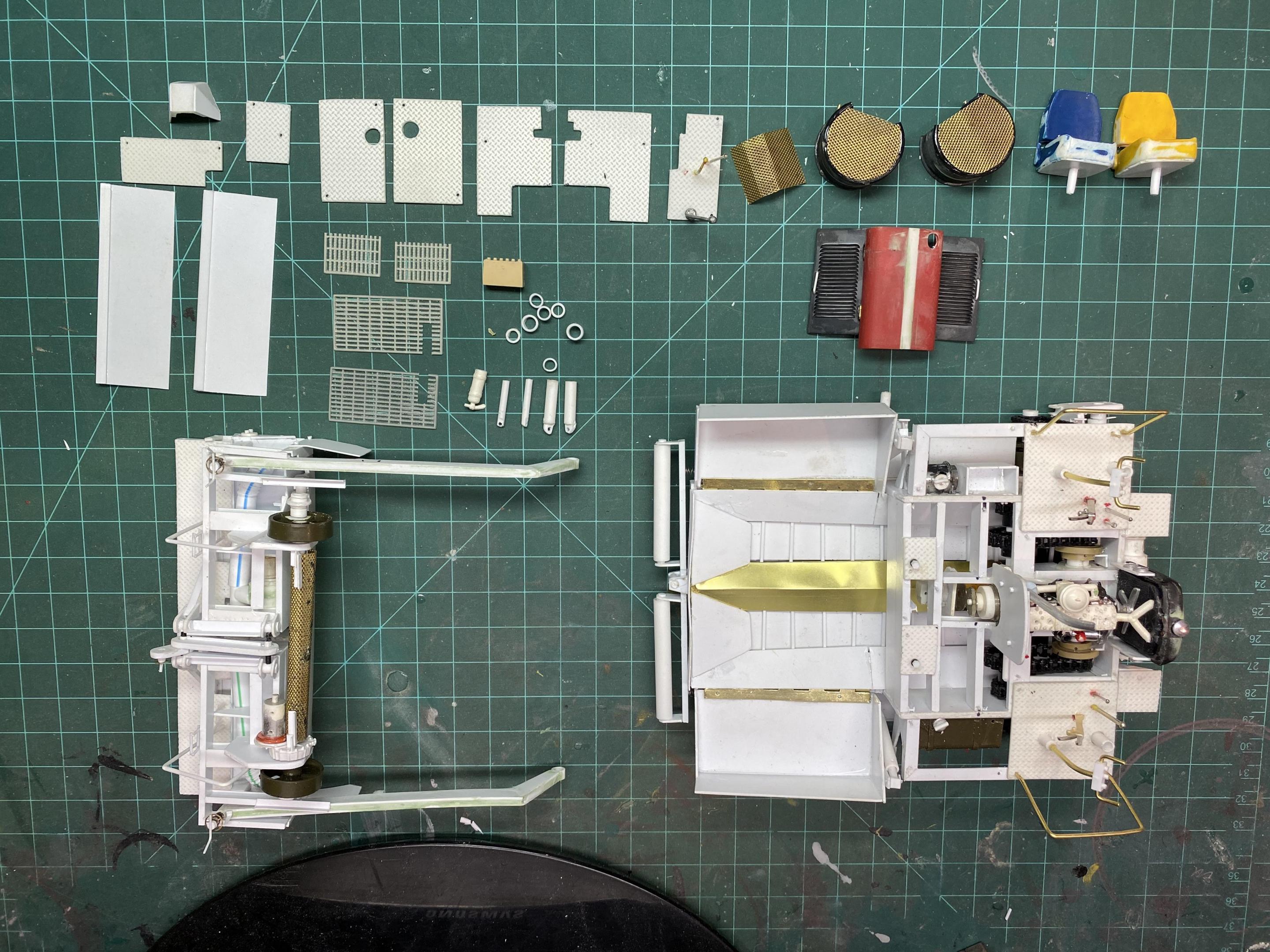

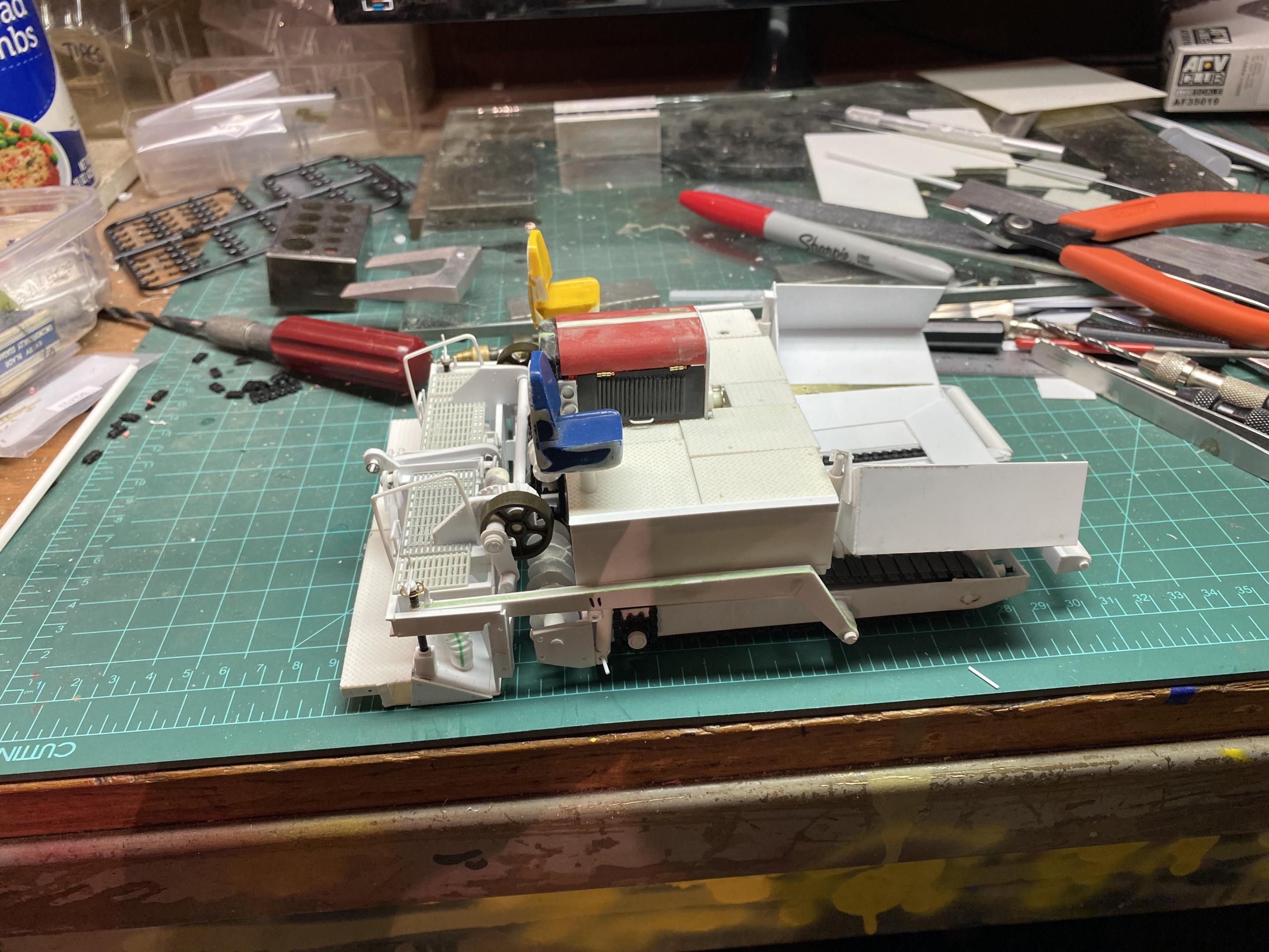

redneckrigger Posted March 30, 2020 Author Share Posted March 30, 2020 More work today.......installed the feed gates, and the tamper drive flywheel guards. Still have to install screed side shields, engine exhaust, and the rest of the sheet metal along with about a hundred bolt heads. Then, unless my OCD kicks in again, primer and paint!!! Will install all hydraulics and wiring after paint. Tomorrow is yet another day! Quote Link to comment Share on other sites More sharing options...
redneckrigger Posted March 30, 2020 Author Share Posted March 30, 2020 Just now, Chariots of Fire said: Yer joshin' right? You don't know much about this machine????????????????????????????Looks to me that you know a lot about it! Fantastic work my friend!!? Actually Charlie, the only thing I ever did with a paver was to repaint a couple of them years ago. I never paid much attention to how they worked. So, as usual, I did hours of research into them, and acquired lots of reference material, and then I looked at how other people, yourself at the top of the list, did various techniques. Truth be told, if I was doing it over again, I would button the whole thing up and skip all the inner workings as they are going to be near invisible anyways. But it sure was fun! Getting the green paint ready! Quote Link to comment Share on other sites More sharing options...
Warren D Posted March 30, 2020 Share Posted March 30, 2020 For the rubber flaps, what about a heavy weight plastic garbage bag? Quote Link to comment Share on other sites More sharing options...

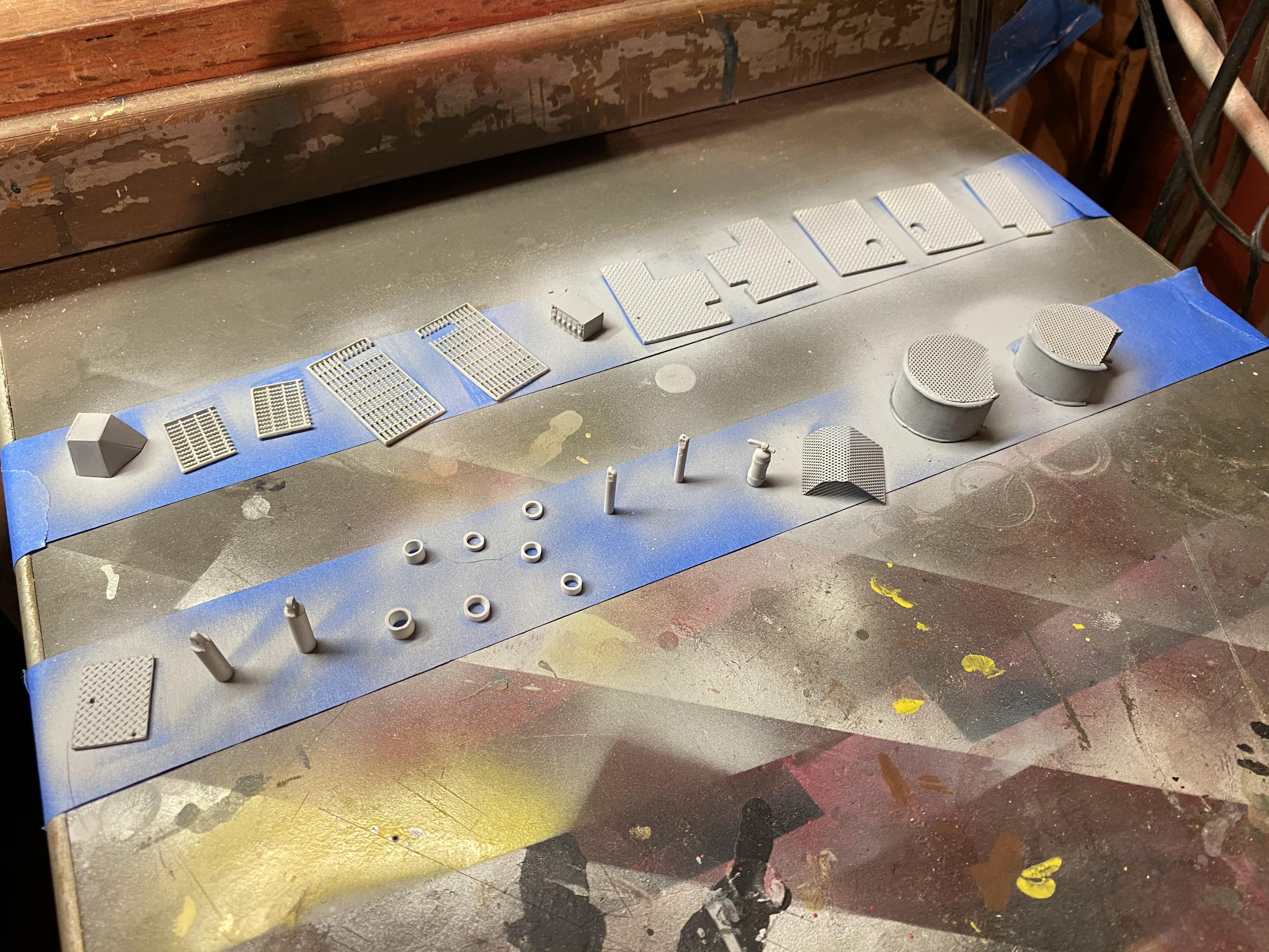

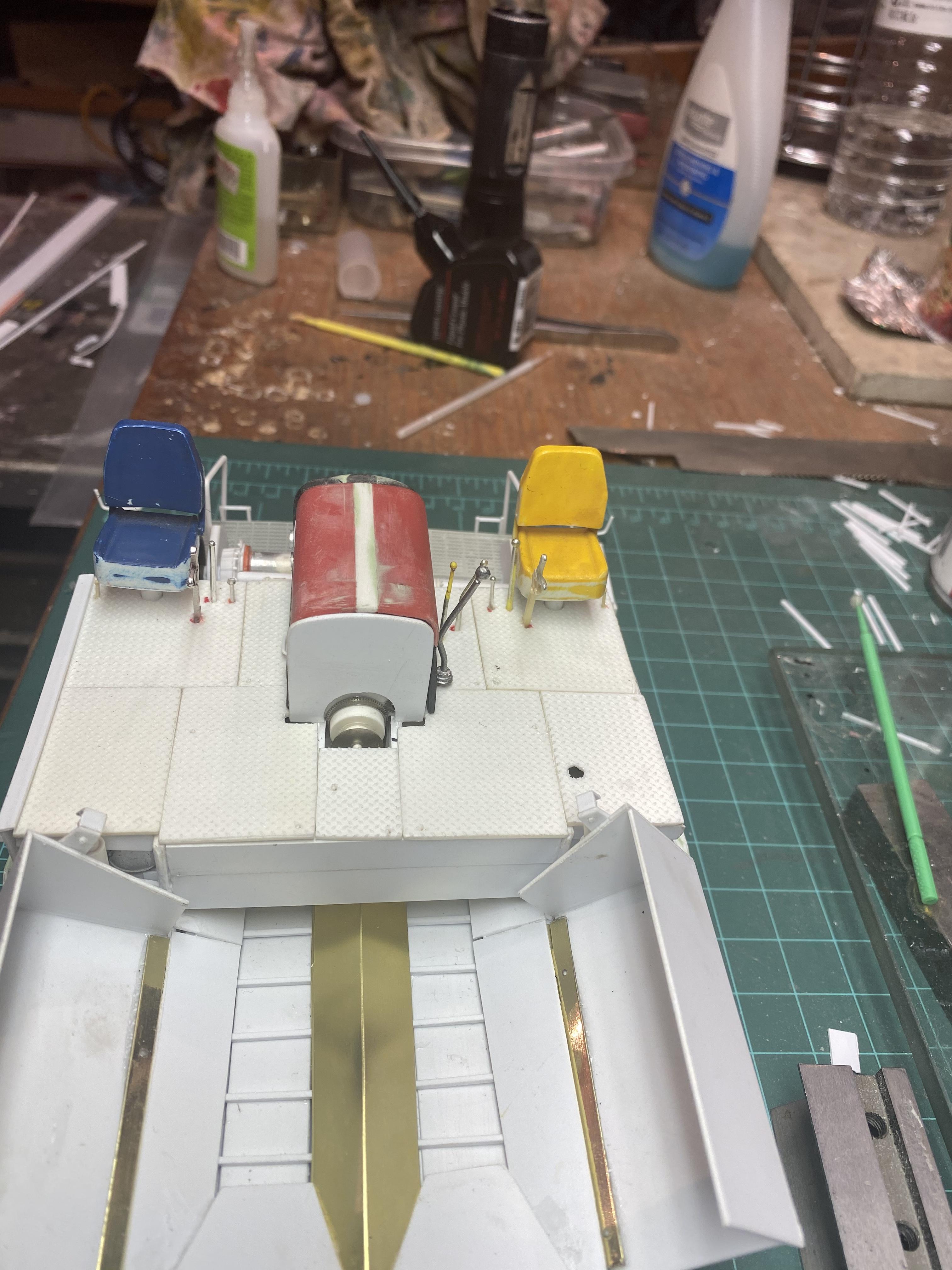

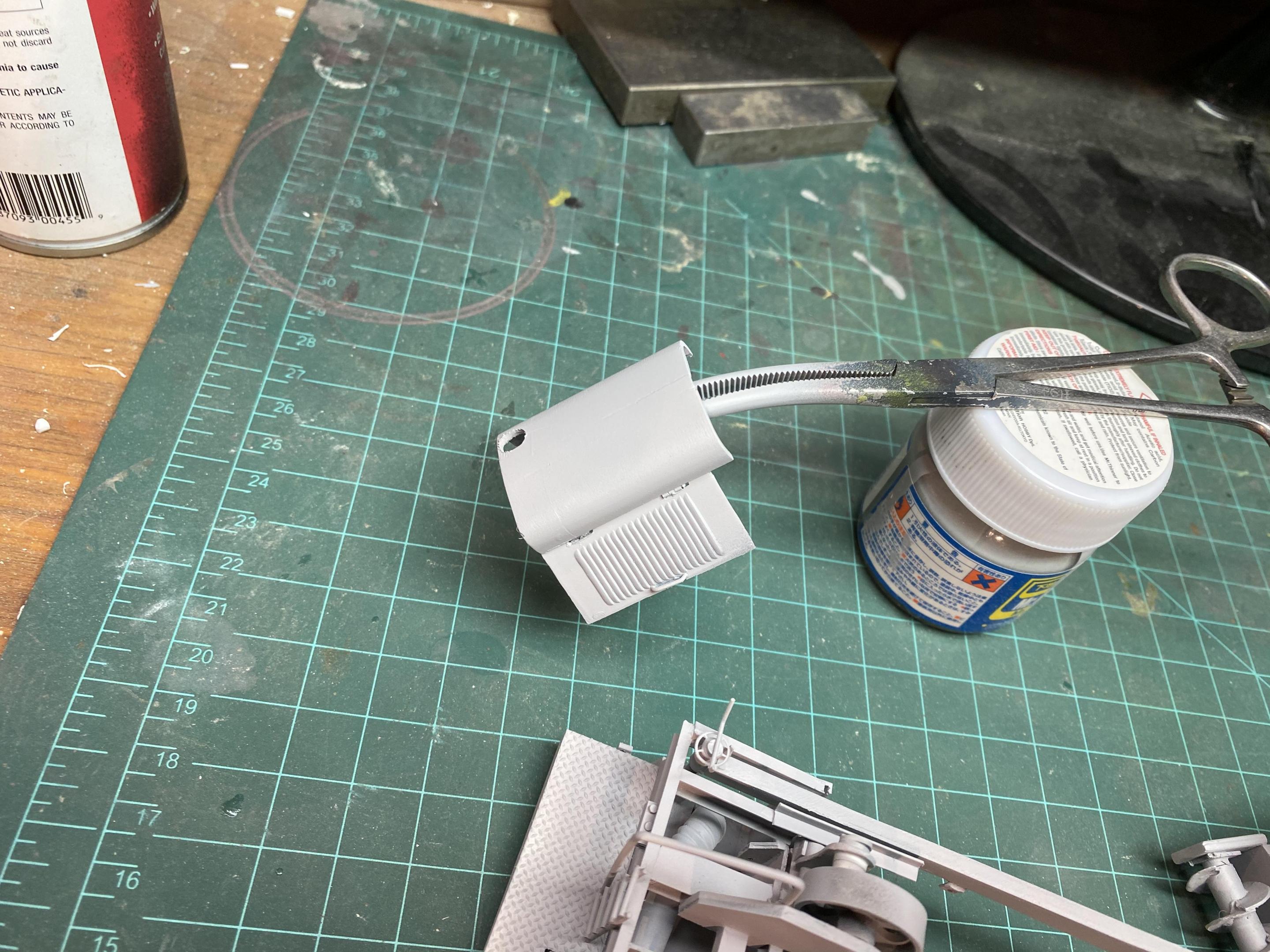

redneckrigger Posted March 30, 2020 Author Share Posted March 30, 2020 (edited) Finally reached paint day! Everything is done except the wiring and piping that will be done after paint along with the hopper rubber flaps. Will be priming with Mr. Surfacer and then painting with PPG enamel with a flattener added to kill the high gloss. It’s gonna look paint shop fresh with some VERY minor grease and grime added. I thin the primer to get into all the nooks and crannies and then give it thin coats of color. I do exactly what you suggest, Charlie, with a brush in hard to reach areas. Have lots of bits to paint. It should look pretty good when done! Primer done, paint tomorrow night! Edited March 30, 2020 by redneckrigger Quote Link to comment Share on other sites More sharing options...
