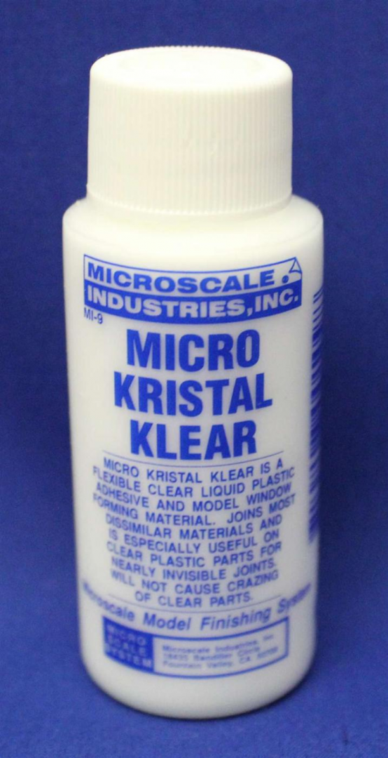

If you are using glue today that damages windshields, don't!  There are better glues on the market specifically for this task that won't cause any damage!
Microscale's Micro Kristal Klear is available in hobby shops and on-line

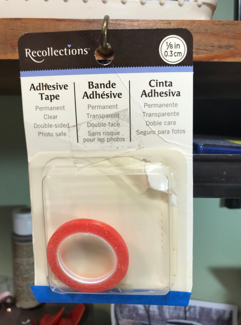

I also use this tape to put in glass. It's clear and very strong, it was made for the scrap booking hobby.  I bought this at Michaels.  Hobby Lobby probably has it too.
I will use a combo of the tape and glue together.  Sometimes I will use the tape across the top and glue the remaining three edges.
