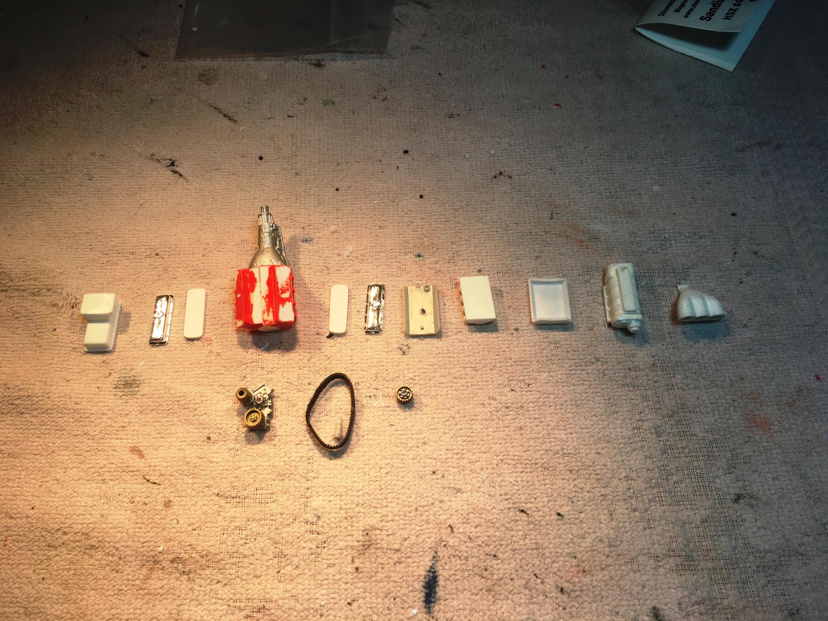

Got my parts from B-N-L Resins. Started tackling the engine for this project. It is basically a Dagwood sandwich.
Resin 3-butterfly Pro Mod scoop.
Resin adapter to the top of the blower.
Resin 10-71 blower with end caps.
Styrene parts box blower base #1.
Resin 8-port intake.
Styrene parts box blower base #2.
Styrene parts box Big-block Chevy.
Resin deep-sump Milodon oil pan.

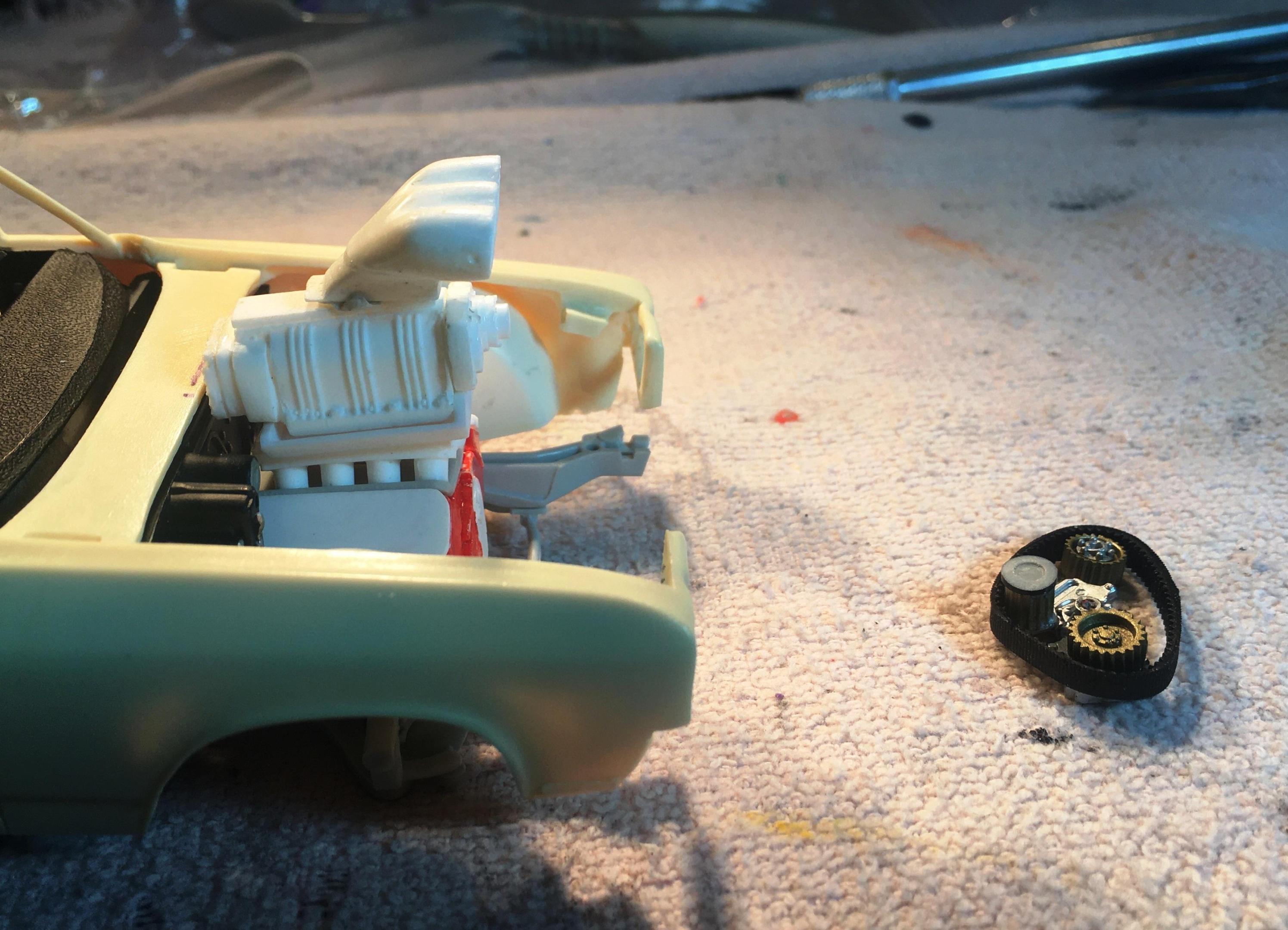

The blower drive is from an ebay purchase of some larger scale blower motor.
It comes with a rubber/vinyl Gilmore drive belt.
I also had to fab some valve cover spacers to help the blower base #2 not protrude higher than the heads.
I will have to notch the cowl a little bit for the blower (no big deal).
The top of the scoop is slightly higher than the roof (which was what I was hoping for).
