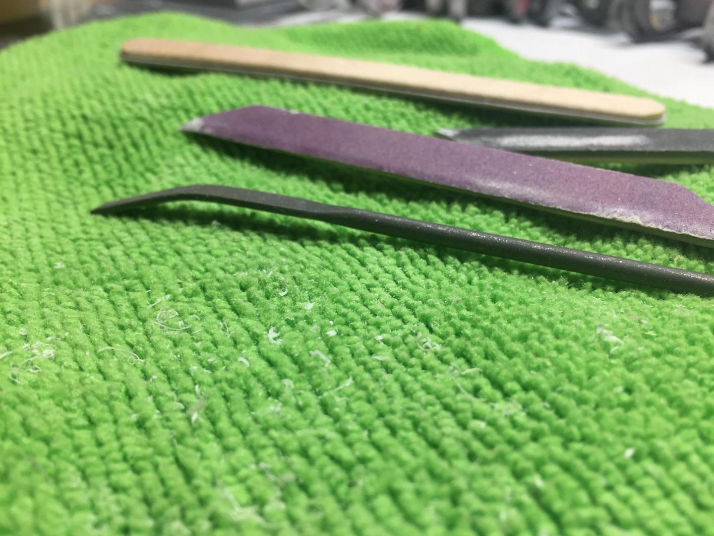

When I am shaping parts, the plastic bits that clog up the mini files need to be removed frequently. I've found that the easiest way is to wipe it on a micro-fiber cloth. The fibers seem to grab the particles nicely! I make my own sanding sticks with popsicle sticks and 3M double face tape, and this works especially well for them. Then toss it in the wash when the wife ain't lookin...:unsure:.

Wire brushes don't work very well on sanding sticks, or my diamond files. Try the cloth, you'll like it! The odd bit that is impacted I scrape out with the tip of a hobby knife. I don't think I want WD40 anywhere near my models?

Hey, No worries! This is a good "while you work" cleaning... sand-wipe-sand-wipe. It keeps stuff from getting embedded on the files or sanding sticks.  If things get really crusty I'll break out the brass brush or hobby knife too. The diamond files are a cheapo 10 piece 150 grit set from Princess Auto. They are less aggressive and less "directional" than my other files.
