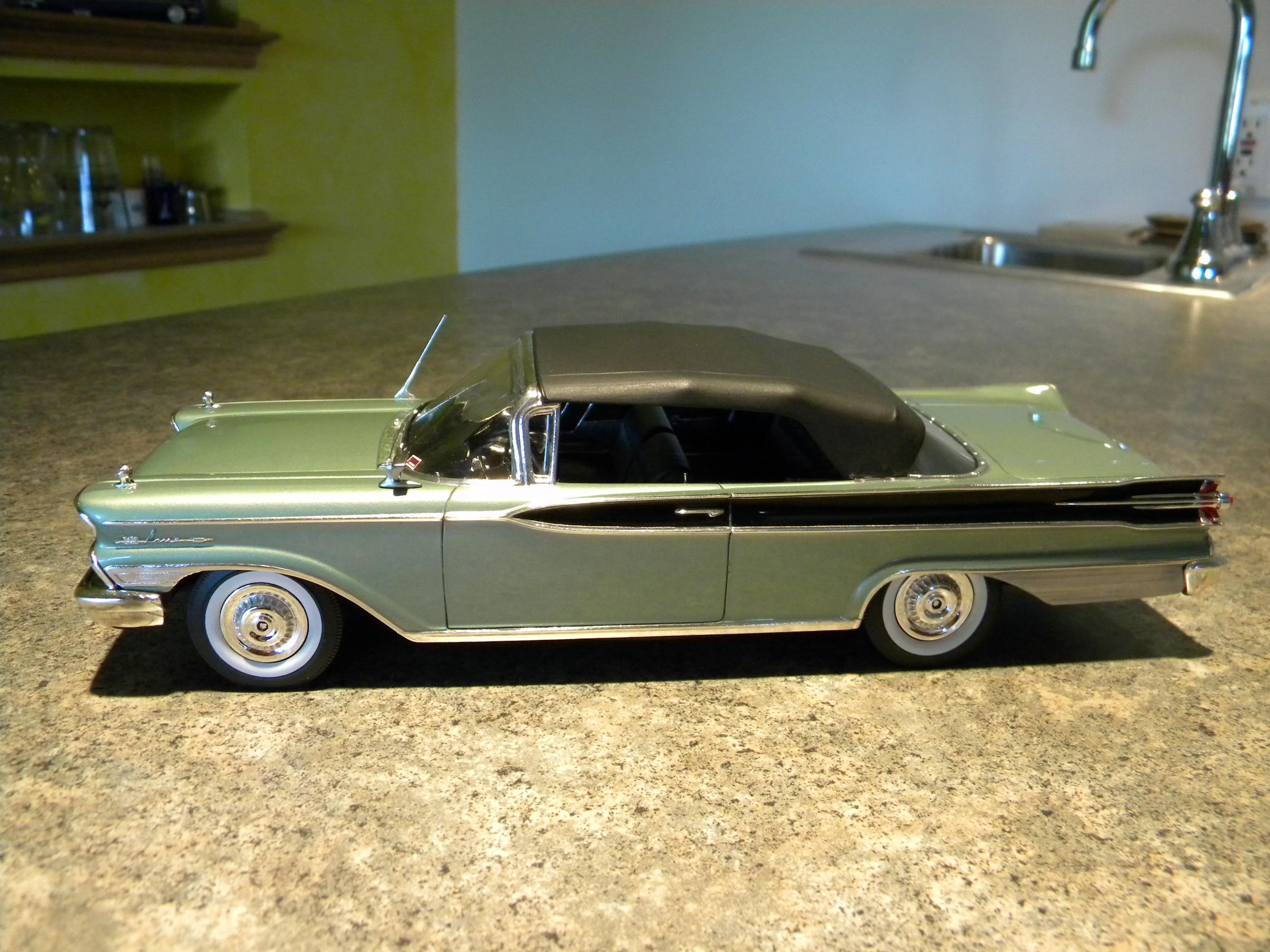

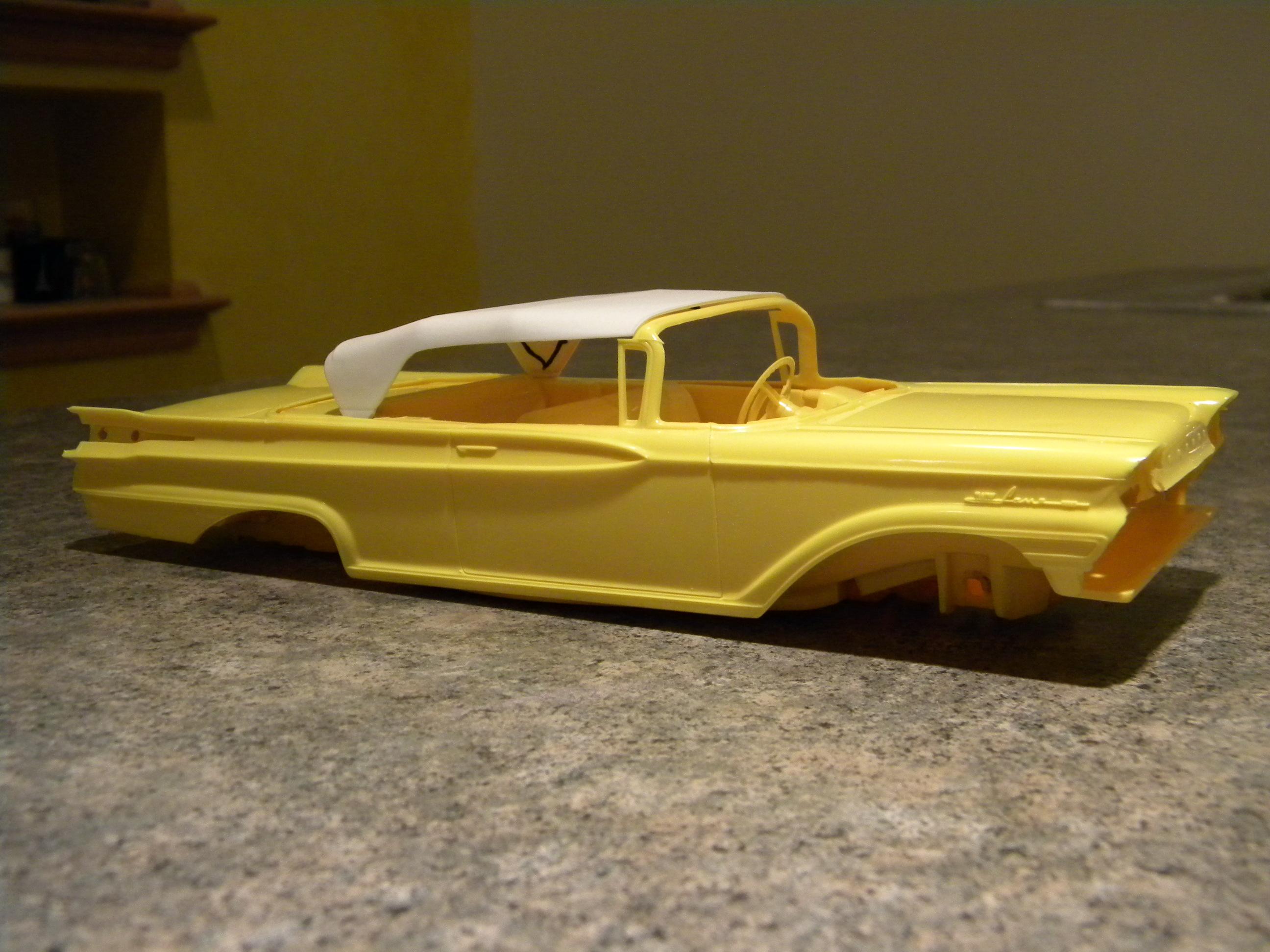

A coat of Testors lacquer primer, followed by a few light coats of Duplicolor primer/sealer has always worked for me.
People frequently bring up the issue of "bleed through" but I personally have never seen it using my current paint regimen.

2 hours ago, StevenGuthmiller said:
That is a very pale yellow, old plastic Steve..I was speaking more on the newer, deep yellow, orange, and red kits, but I will try your clear over primer under topcoat idea
Share this post
Must be someone else's technique.
I just use straight primer,  No clear. ;)
Steve
Steve
Love your Parklane convertible. The real cars were rocket inspired works of art IMO.
