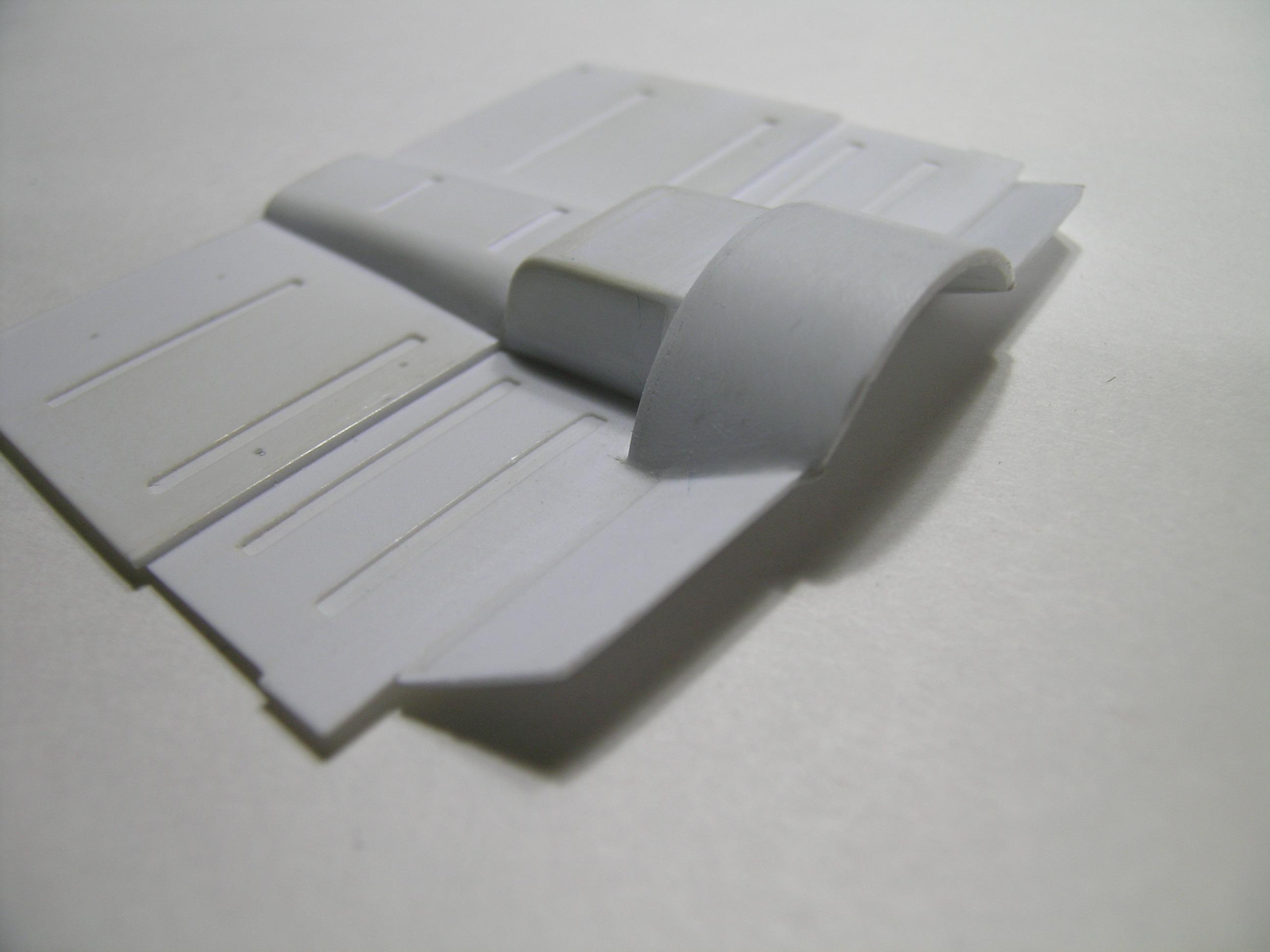

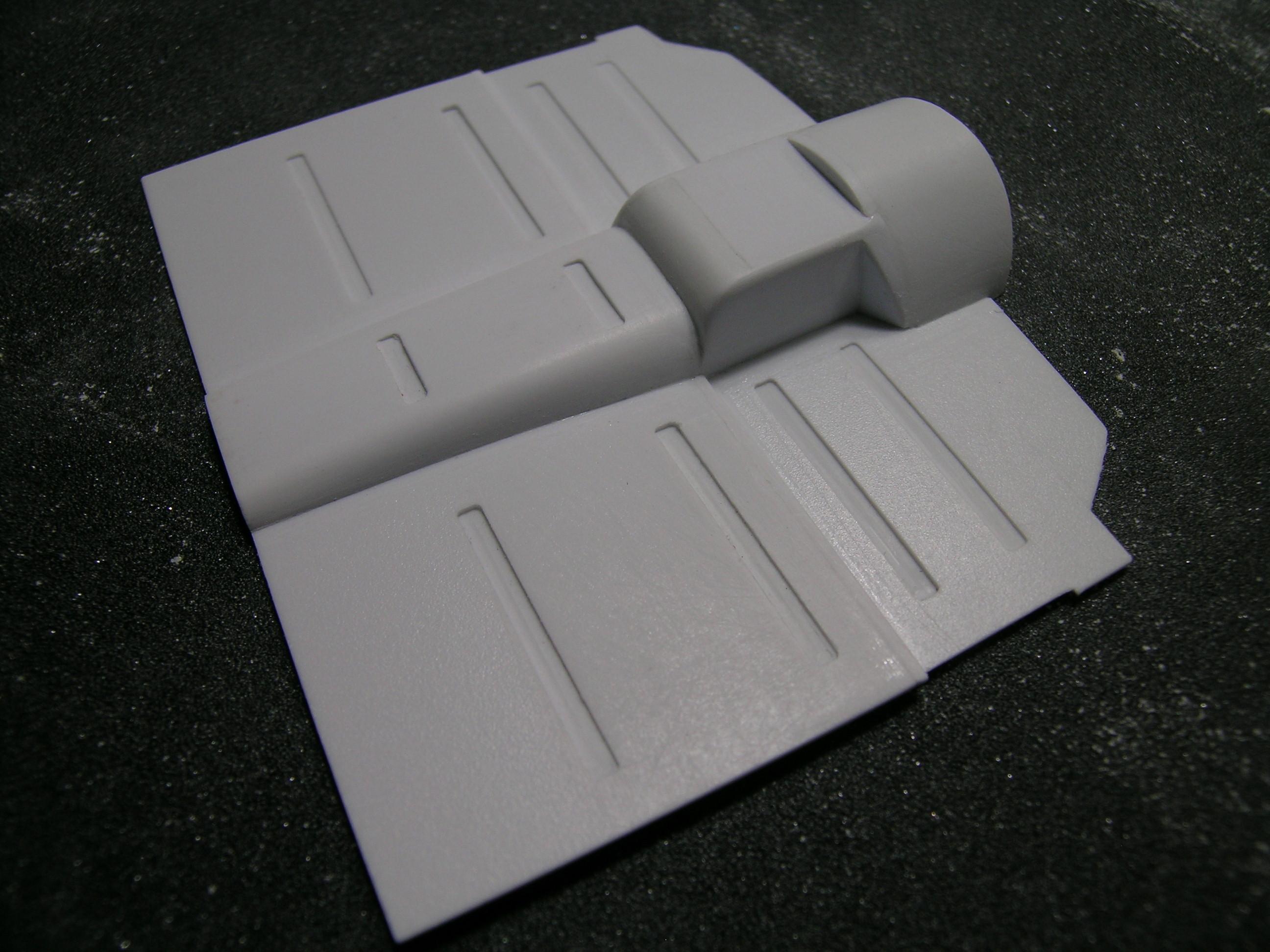

Pic of the floor pan from 2019/01 for comparison.28_Floor_Tunnel_Trans.JPG.e607ef0730a7181847b3d9e3f7fdfa42.JPG

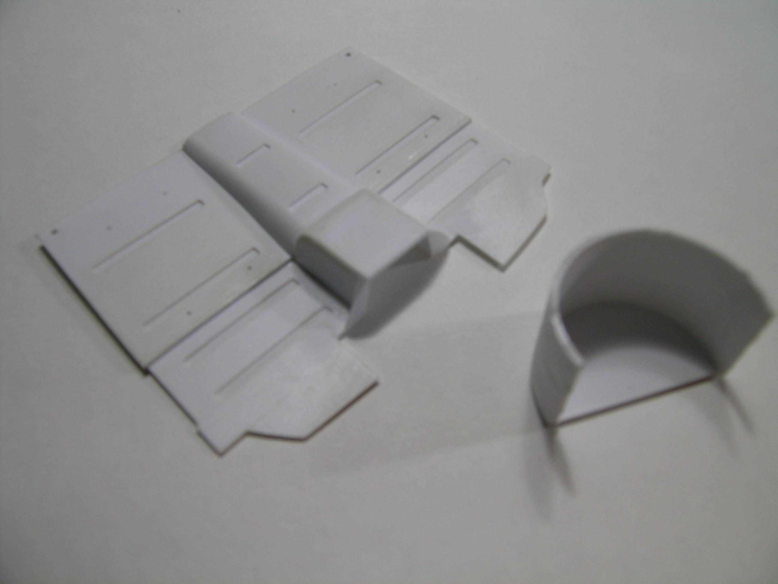

I made a larger opening for the bellhousing, this one is roughly 0.200" larger than the previous one.370_Floor_Pan_Mod_1.JPG.18ba5d90303c27ca6caa7dcc8cce32d1.JPG
I had to make an angle on the floor plate (like the 1: 1 truck), it was a mistake at first and you need room for the clutch levers.371_Floor_Pan_Mod_2.JPG.5e2b12e1471fc56567e97e2df07396af.JPG

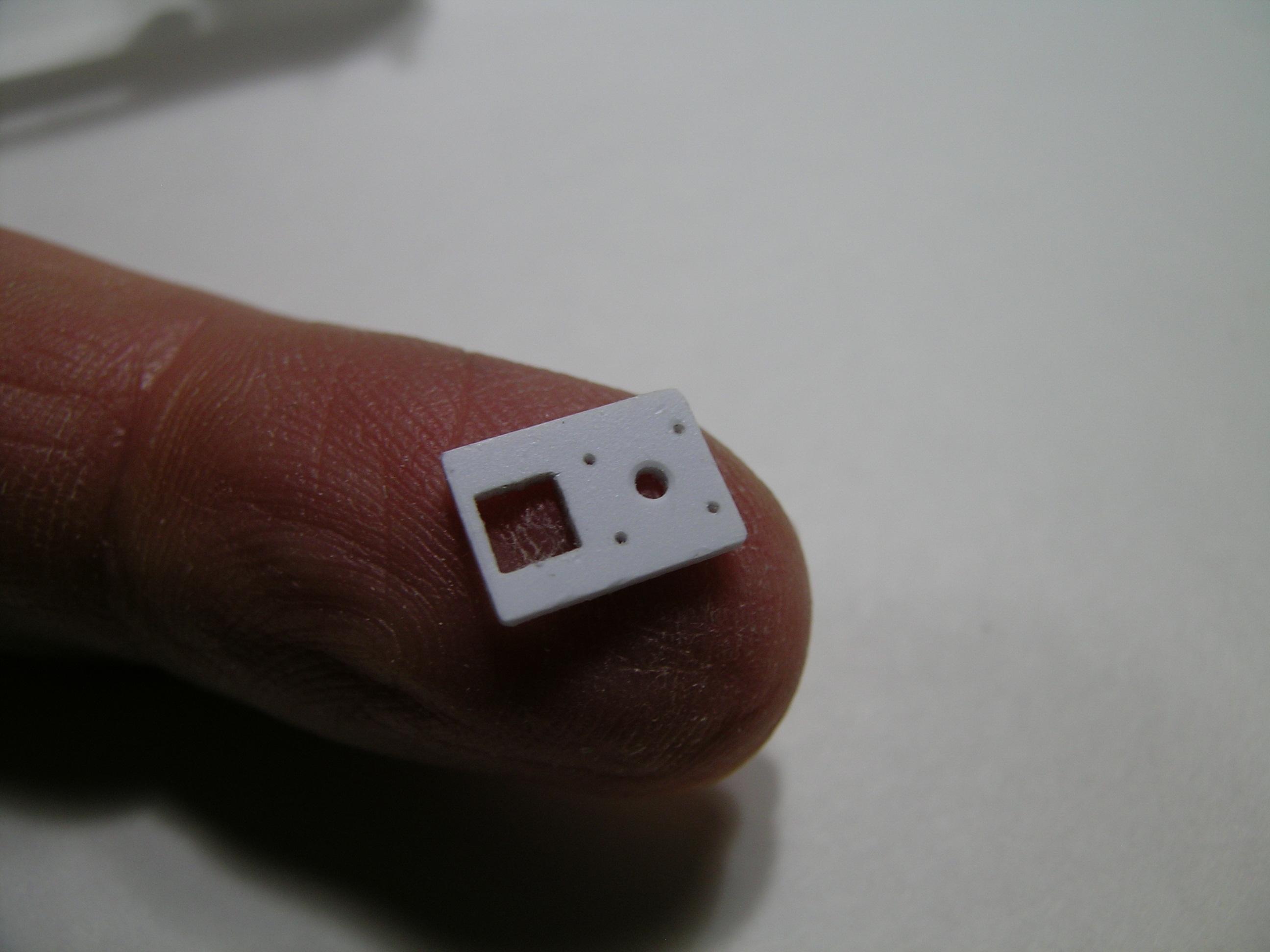

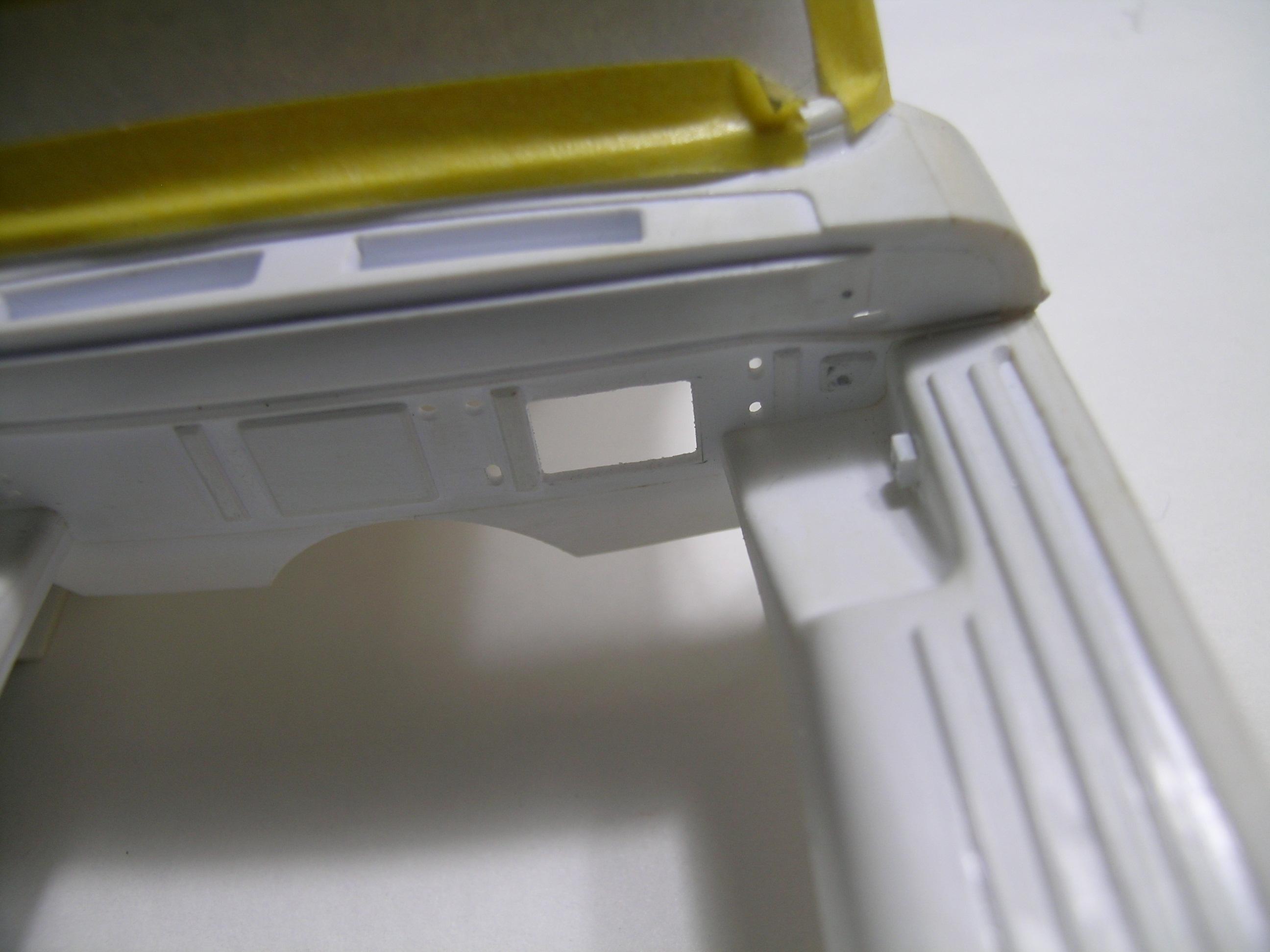

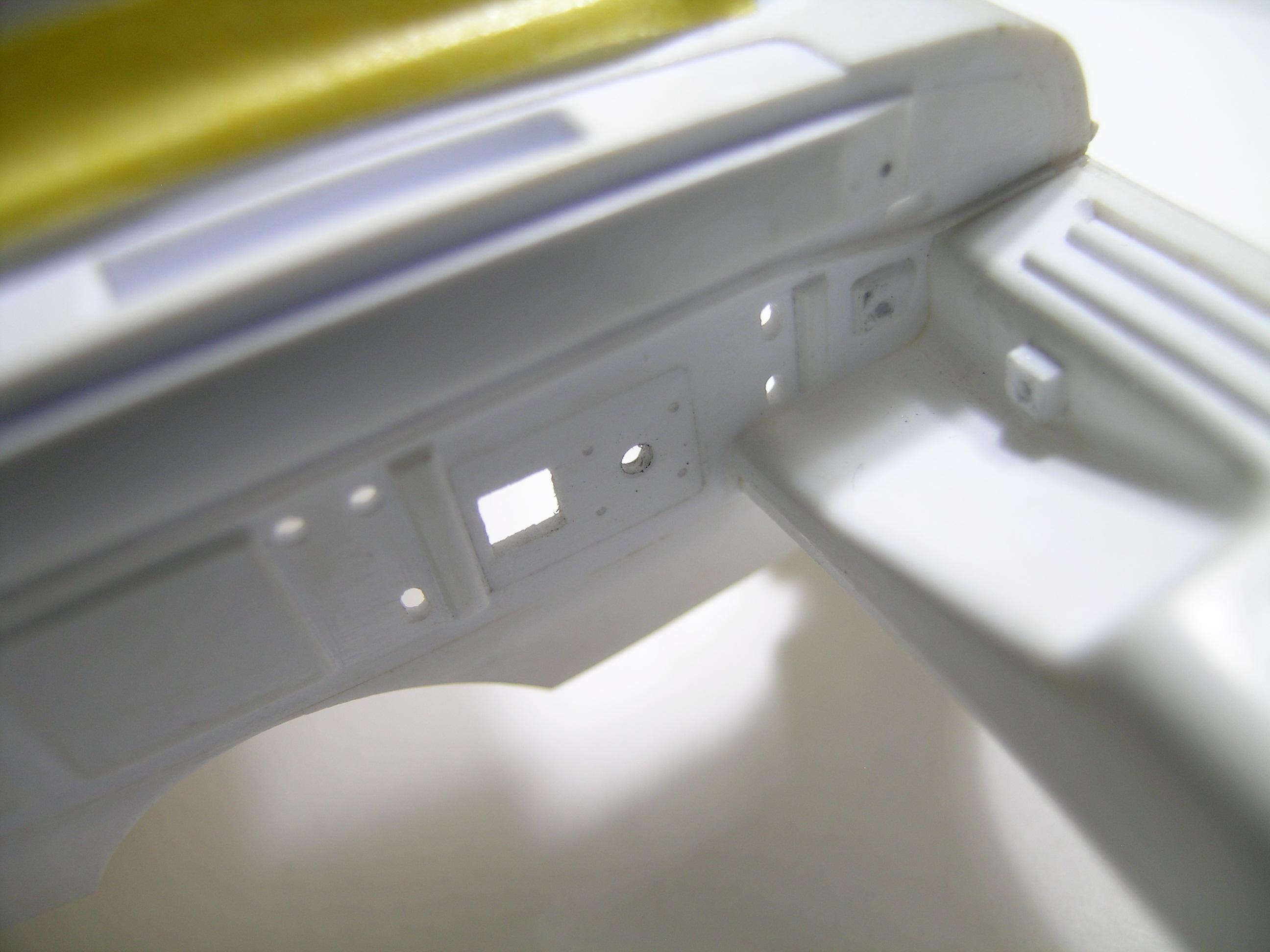

The brake master cylinder should be moved to the driver's fender in order to have enough space for the accelerator pedal inside the cab.372_Cowl_Dash_Mod_1.JPG.f0e4700b6ff3f7f88eb655a81fc503d4.JPG
I can't save the part so I cut an opening and made a new one exactly the same size as the hole, I turned the part 180 degrees so now the fuse box will be at the other side.373_Cowl_Dash_Mod_2.JPG.7fde69560e612c4b9e05616933bddda2.JPG
The new plastic part is glued in place.374_Cowl_Dash_Mod_3.JPG.9367e6d267891b3abf53a0a0350077ad.JPG

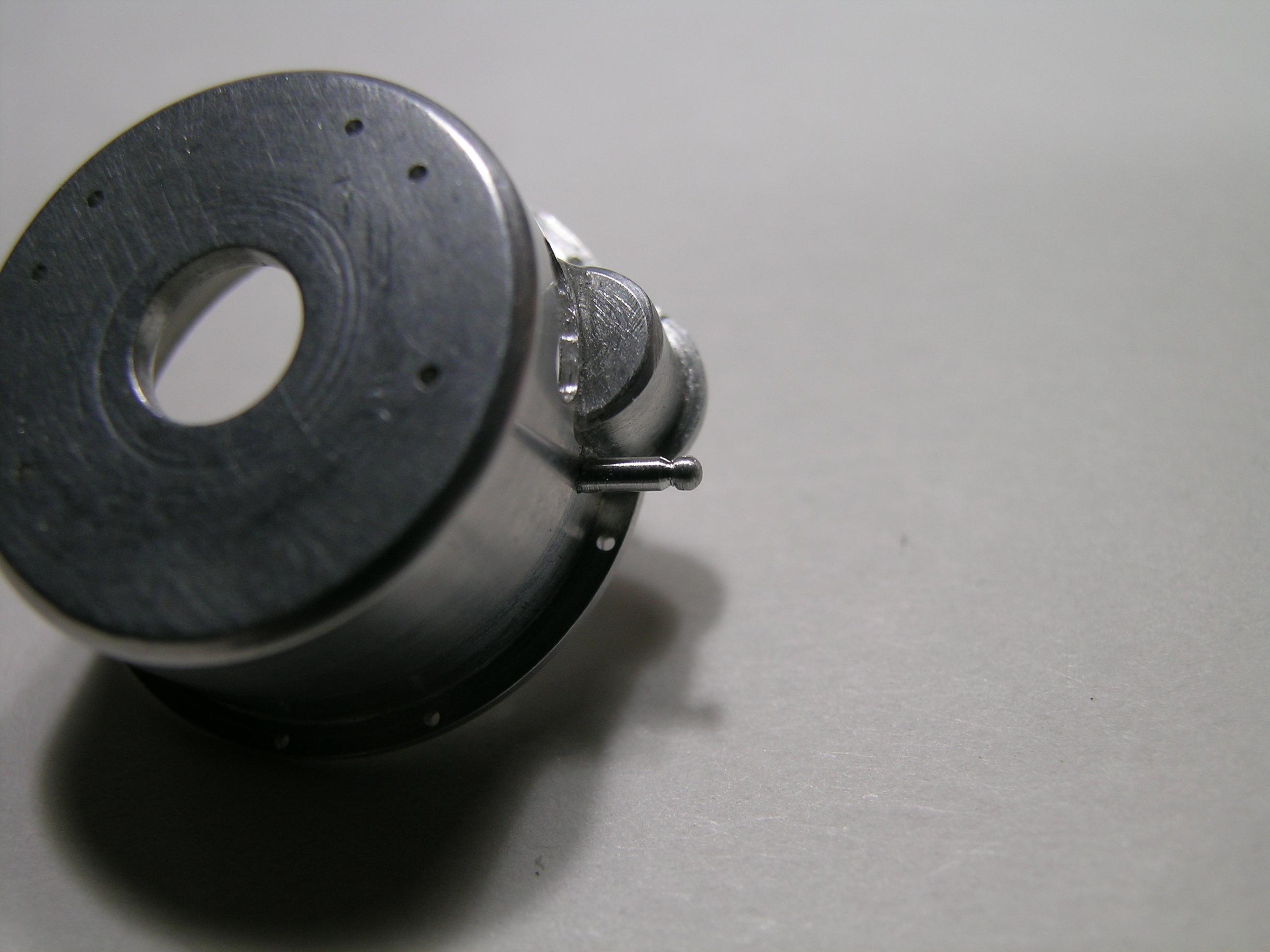

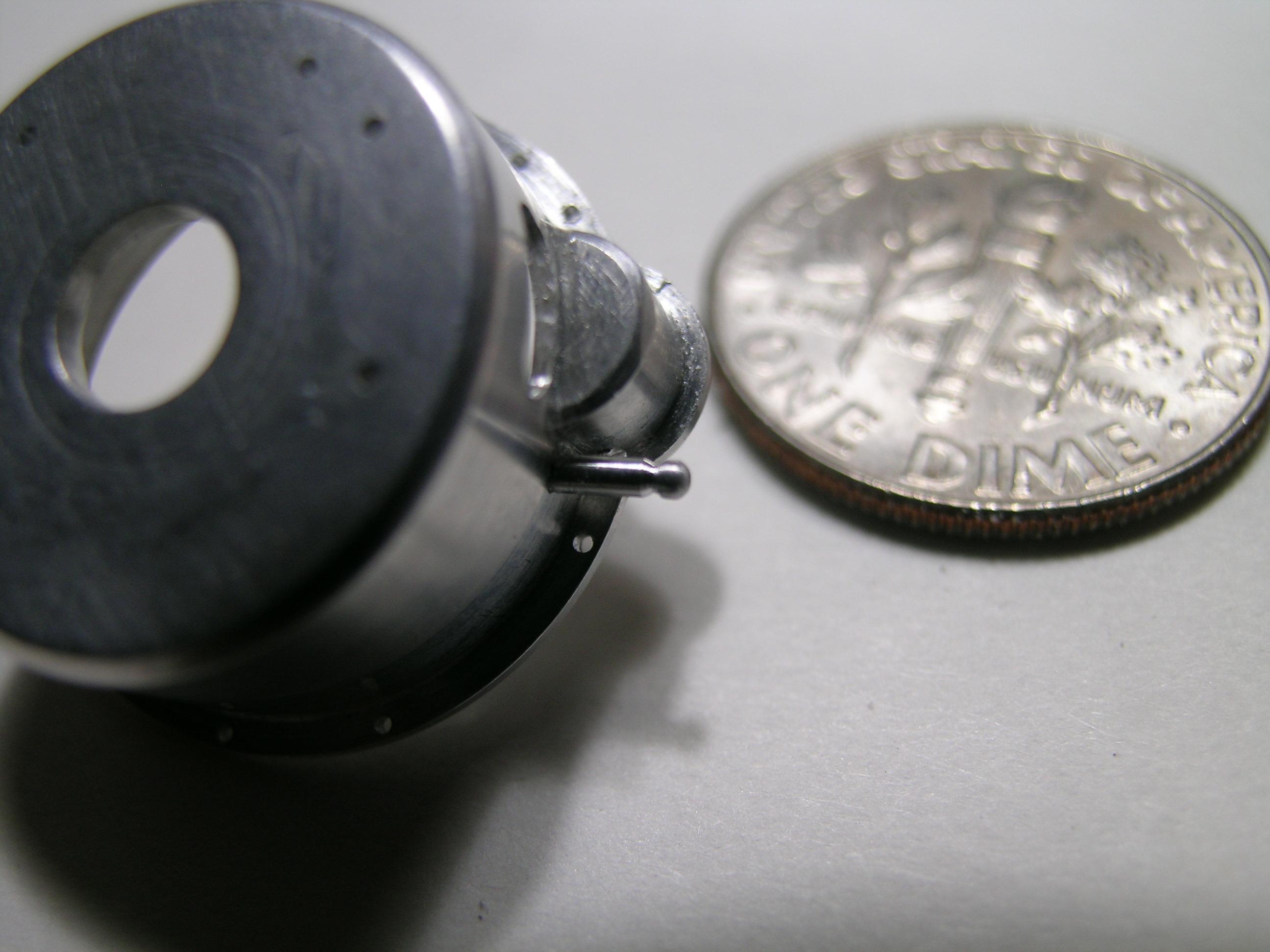

I machined the clutch lever pivot point on the bellhousing.375_Bell_Clutch_Link_1.JPG.e910decf0bd1ba28d62398e5f014bbcc.JPG
Same part different view with the big dime...376_Bell_Clutch_Link_2.JPG.8ac1b9cb0a86064334ec2d2d55a5dd97.JPG

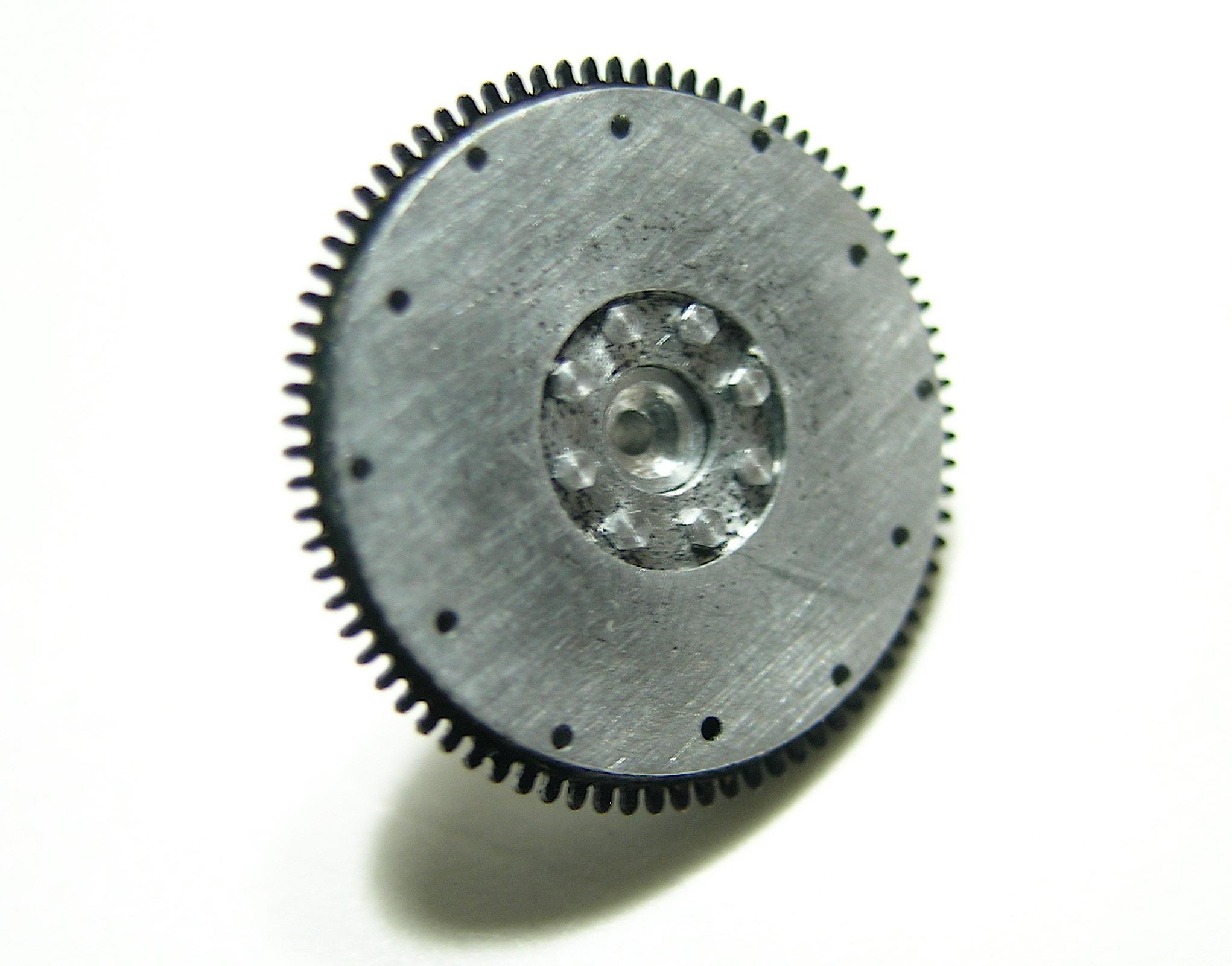

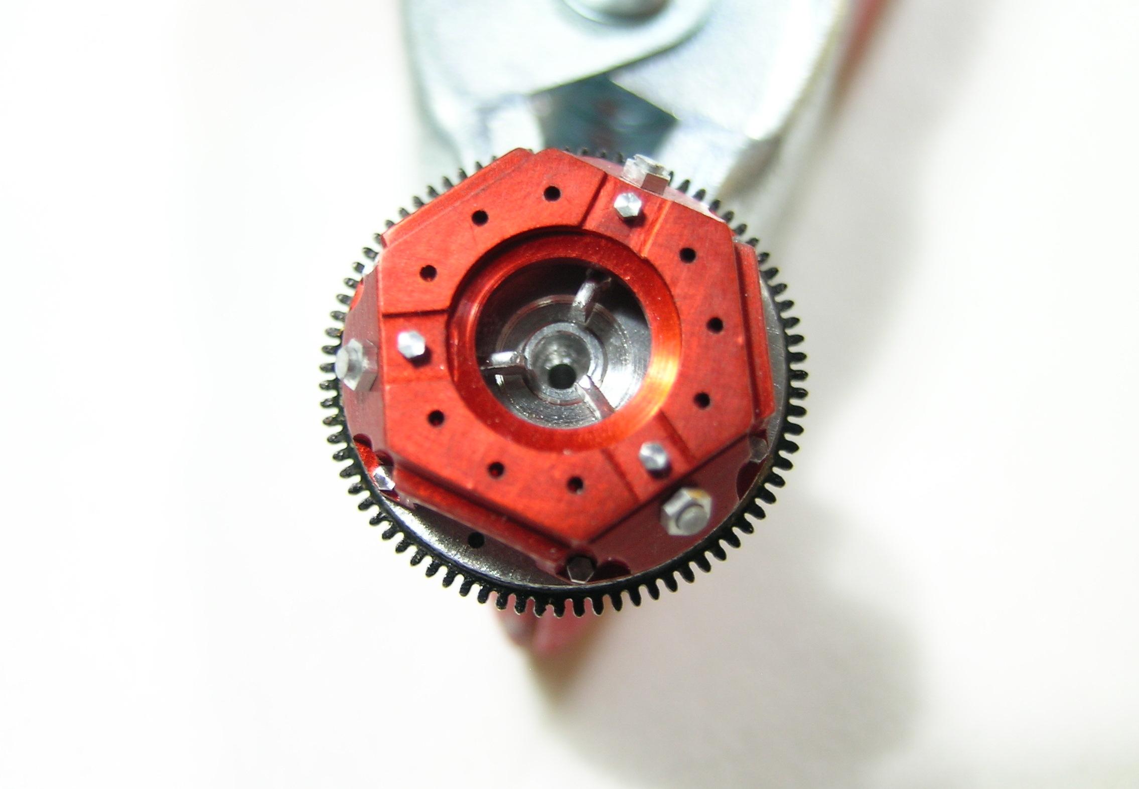

The flywheel is now permanently assembled on the crank end with RB Motion aluminum bolts.  The flywheel teeth have been blackened with "Brass Black" to simulate the hardening treatment.377_Clutch_Assemblage_1.JPG.20ddcf0c6189c06b7690e49c97bd1c72.JPG

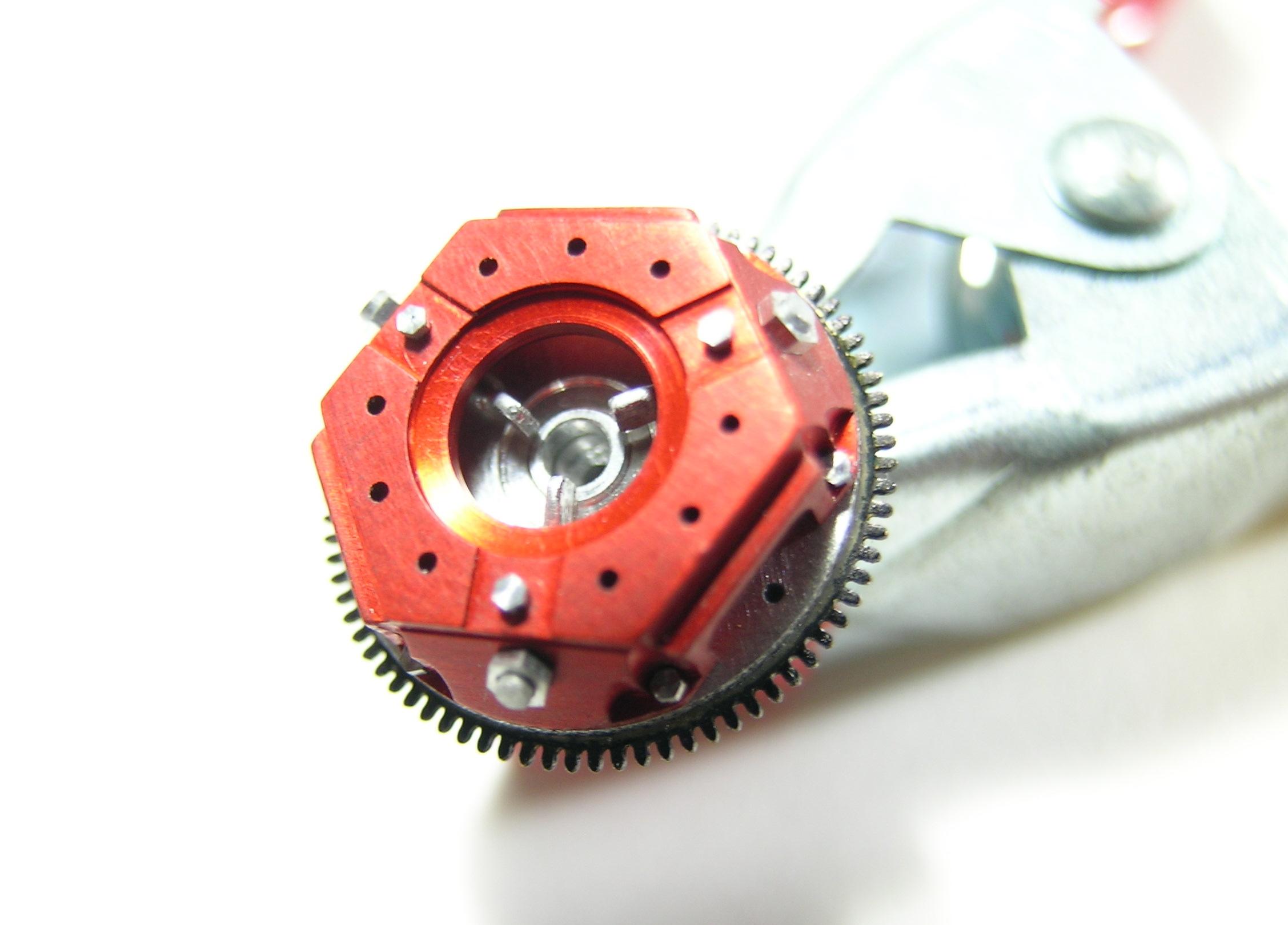

Pressure plate is now finally installed on the flywheel with aluminum bolts.378_Clutch_Assemblage_2.JPG.940ddccc2f142e2c8450c2d229b6cf16.JPG
Pressure plate different view, you can also see the clutch disk in between.379_Clutch_Assemblage_3.JPG.ebb331a08d855538bcfd633fed621aa1.JPG

20 hours ago, Alan said:
Sweet!!!!! Where is the clutch disc
Thanks Alan!  Well, I must admit that it is rather well hidden and barely visible between the flywheel and the pressure plate...   The pressure plate is just the shell and it is not complete with all the components because I was running out of space ...  You can see the simple designed clutch disk in this image at an earlier stage of build if you missed it...  I must admit that there are starting to be quite a few pictures on this thread... lol
