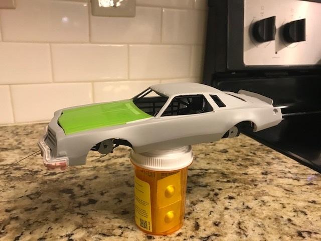

DoctorLarry Posted December 29, 2019 Since I am almost done with my 76 Indy Pace Car Buick, it is time (while I have some to spare) to start on another vintage NASCAR project. I found this picture on the Petersen Archives web site and thought it was a beautiful car. It was raced on the West coast by Jim Thirkettle and this shot was in the 1978 NAPA 400 at Riverside. It will have a stock rear frame and a T Bird clip like many cars of the era. I built the chassis for my 73 Grand Am project till I found the Petersen archives and found it was all wrong for the car so I had it left over. Pictures are few, but I can fake it. Starting point is a random resin Cutlass body I bought on EBAY. It was warped so I put it in a pan of hot water and gently straightened it out. I will make a mold off the front of my Century Pace car for the nose and since I have done this mod once, I know how to do the rest. One side is not done, the other is about 75%. Fender flares came from an MPC Volare kit. I'm no fan of the new cars, I was in my teens in the 70's when these cars raced. YellowSportwagon is a big encouragement-he builds gorgeous vintage builds. (rather quickly, I might add). Quote Share this post Link to post Share on other sites

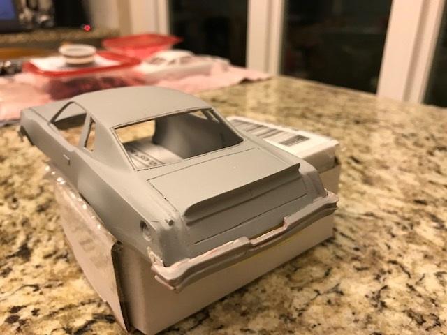

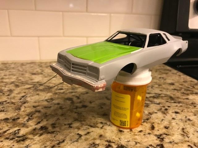

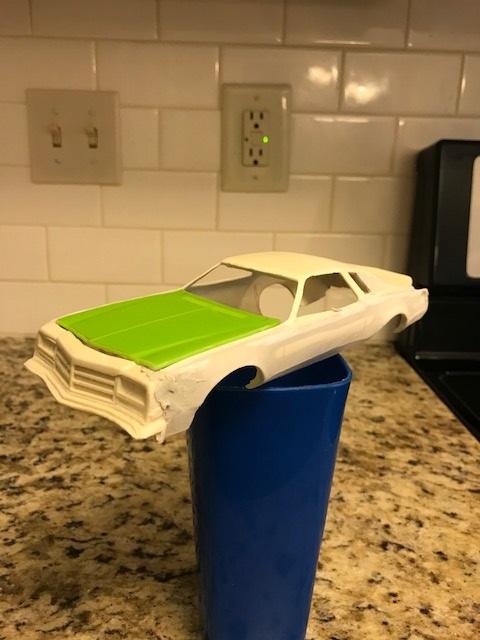

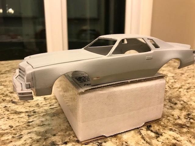

DoctorLarry Posted January 3, 2020 I made a quick mold off the front end of my Century Pace Car and pulled out a casting. I cut the front end off the Cutlass and glued the Century one on. The hood is left over from a Revell 77 Monte Carlo I cut up for my Hurst Grand Prix project. I got rid of the Cutlass tail lights and modified the area to replicate the Buick. I will make molds of the Pace Car bumpers and cast them then this one is ready for primer. Quote Share this post Link to post Share on other sites
DoctorLarry Posted January 10, 2020 Body is almost ready. I have to modify the hood slightly to get the right body lines. It is sitting roughly on the chassis but I have to adjust the mounting points. Quote Share this post Link to post Share on other sites

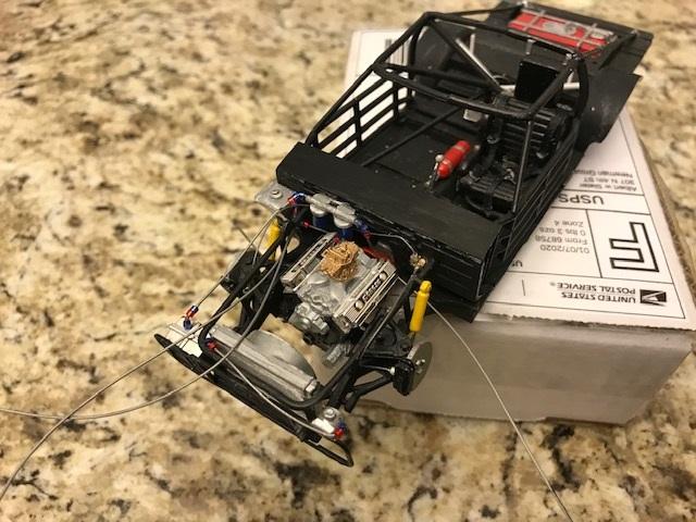

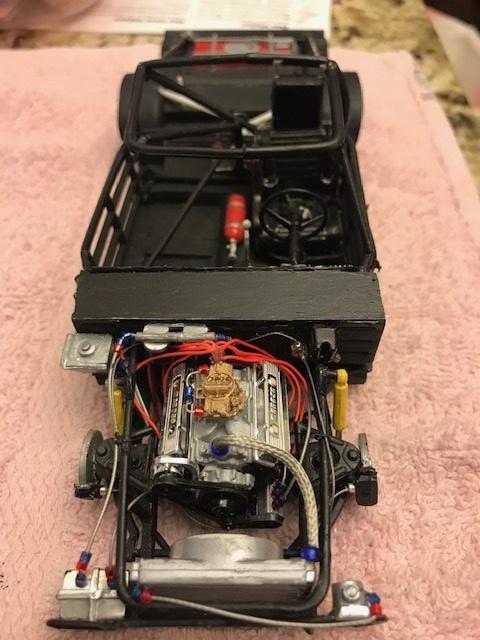

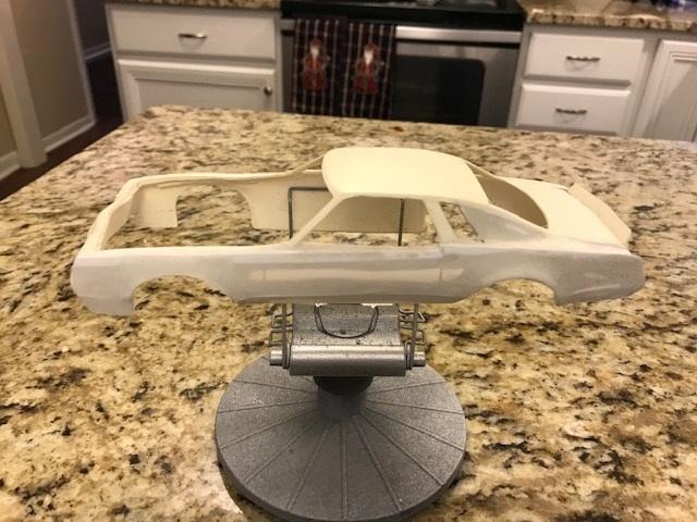

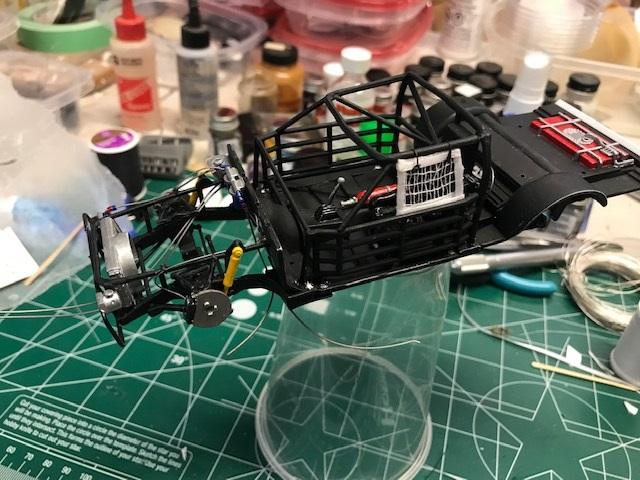

DoctorLarry Posted January 21, 2020 Made some progress. Body is 95% done. I need to do some fill work on the body by the bumpers and finish the bumpers off (the ends were too long) and final blocking. Also need to thin the hood edges so it sits flush. After that, wet sand and one more sealer coat then on to paint. After I paint the body I will make a mold and cast it in resin. Last shot is my chassis/engine. I ordered a salvage kit engine off EBAY so it needs to be wired and plumbed. I painted it and added a Fireball resin Holley. Detail is astounding on his carbs! Then finish off the chassis plumbing, mount the wheels and adjust stance. Quote Share this post Link to post Share on other sites

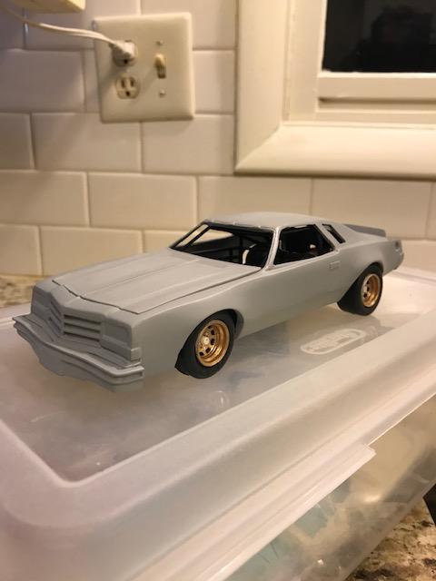

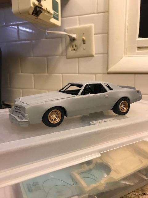

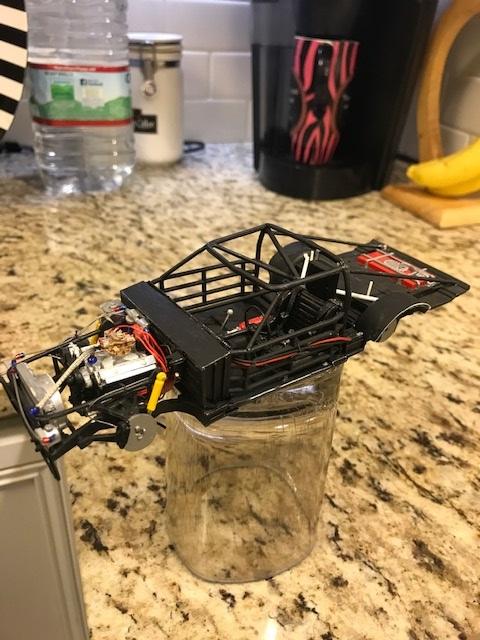

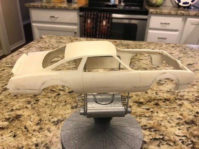

DoctorLarry Posted January 26, 2020 Chassis is about done and body has been final sanded. Still a couple of minor touch ups and it can be painted. I still need to put the exhaust and rear window filler panel on and it will be ready for paint. I also have to paint and mount the wheels and tires. Quote Share this post Link to post Share on other sites
DoctorLarry Posted January 28, 2020 Body is ready for paint. I set the wheels in place and slipped the body over the chassis. I have to finish the chassis details and get the mounting points right but this is close to where the body will set. I think the back needs to be lowered. I also think the rear wheels need to be tucked in a bit. Thoughts? The hood will sit right when I raise the body mounts up a smidge. Quote Share this post Link to post Share on other sites

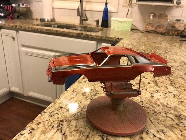

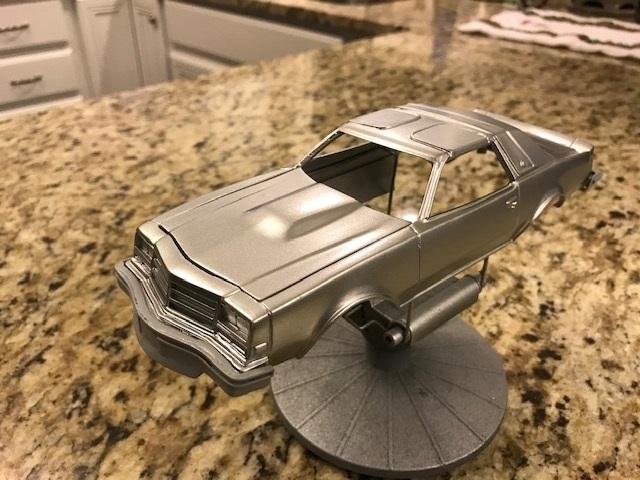

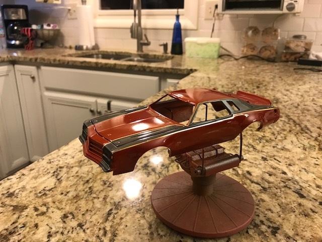

DoctorLarry Posted February 17, 2020 Experimented for awhile with paint and could not get it perfect without a custom mix, so I settled for Testor's Fiery Orange and Graphite Dust with gold striping. Tamiya TS-13 clear. Speedway Decals is working on the artwork for the decals now and they should be ready in a couple of weeks. It was hard to tell what the color was. In some photos it looked more orange and in some redder. I tried using Tamiya Clear Red over the orange and then it was too red so I sanded it down and started over. Tried yellow striping but it was way too bright. The real car is probably somewhere in there in between. Close but not perfect, but it laid out slick. Quote Share this post Link to post Share on other sites
