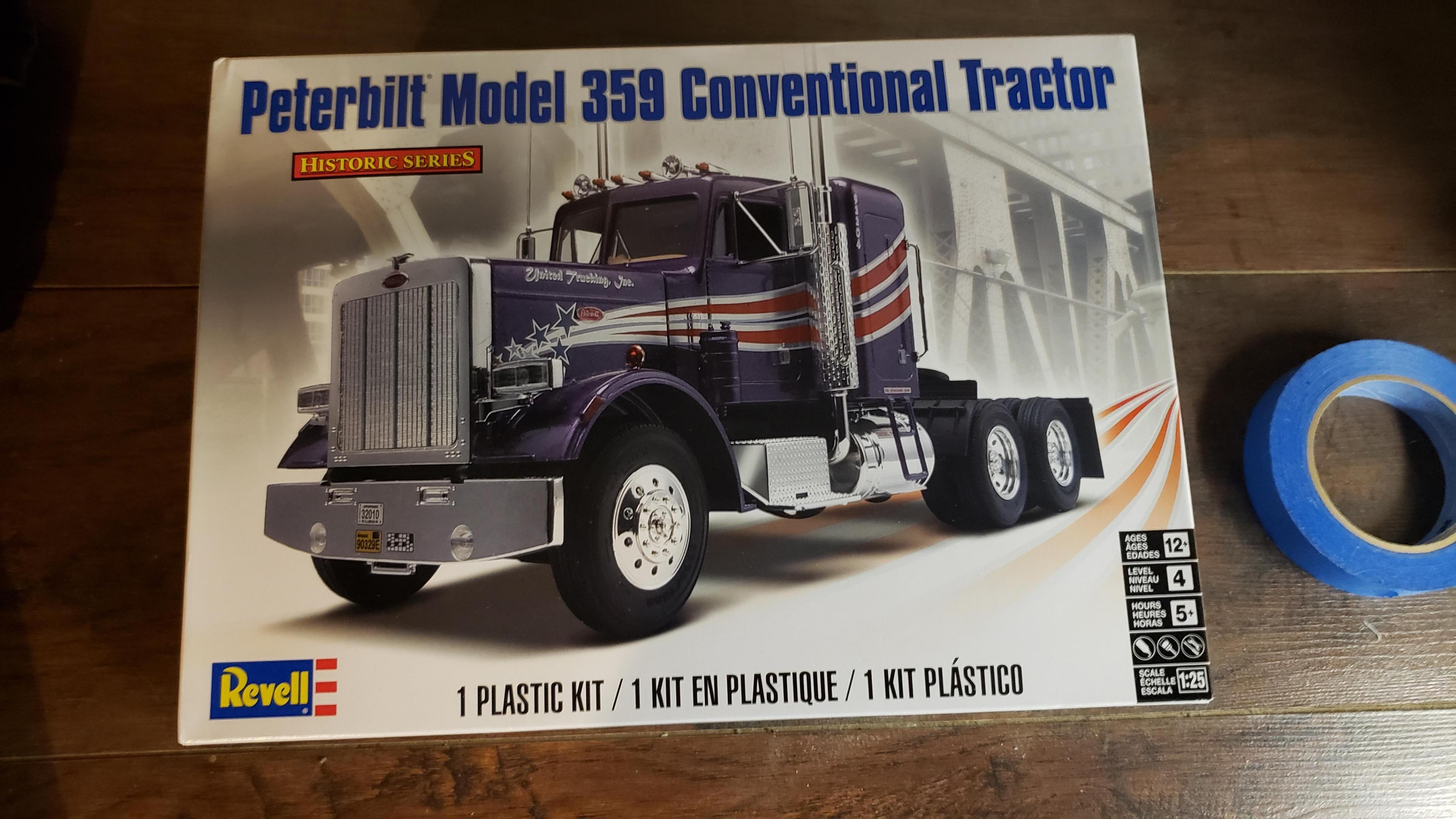

Hi everyone, new guy here. I'm entering in to the build off, and plan to create a heavy haul 4 axle pete, with the snap 359 kit. Actually, I'll use 2 of them, lol. Here is my start
And here is a crude rendering of what I plan to build. I was originally planning to build a daycab, and I may still go that route. I'm undecided at the moment
I can't wait to get started, I'll kick it off this weekend once I'm off call from work! I also can't wait to watch everyone else as they build their creations!
