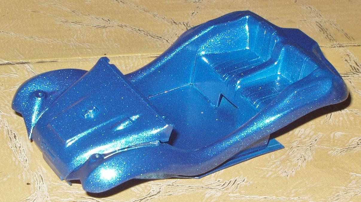

2. Krylon Shimmer: Available in various colors, I just used the Blue for the first time. It's a metalflake, much too flaky for a factory paint job but pretty nice for scale metalflake. I put it on a dune buggy body so it's just about right. Covered well and easily, and dried with a pretty good amount of shine. I've bought several colors of the stuff, and I'll be using it again. I like it!

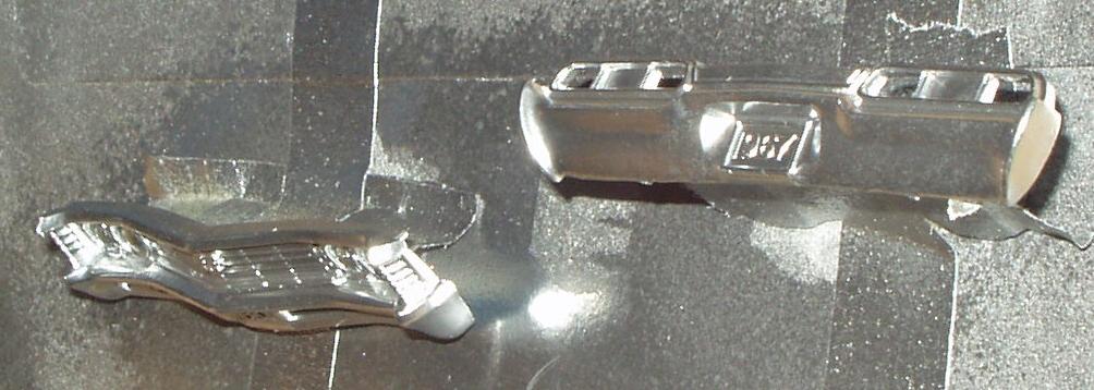

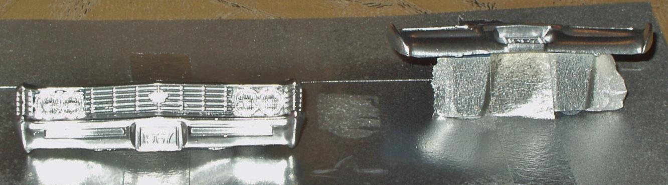

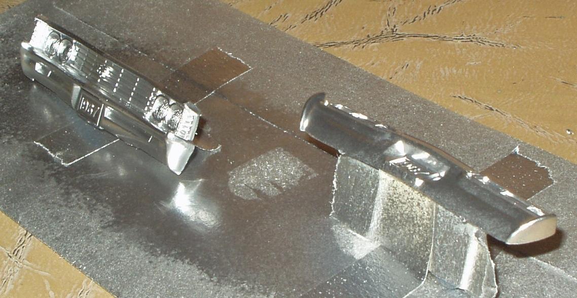

3. Krylon Foil: Just used this for the first time, on a couple of old promo bumpers that had to be stripped (they'd been poorly brush painted). I'm VERY impressed! No, it won't be confused with kit chrome, or even a good Alclad job, but it was amazingly easy to use (no special prep) and produced a surprising degree of chrome-ish shine. For the reasonable price paid ($7 for a big can), I'm VERY happy with the results.

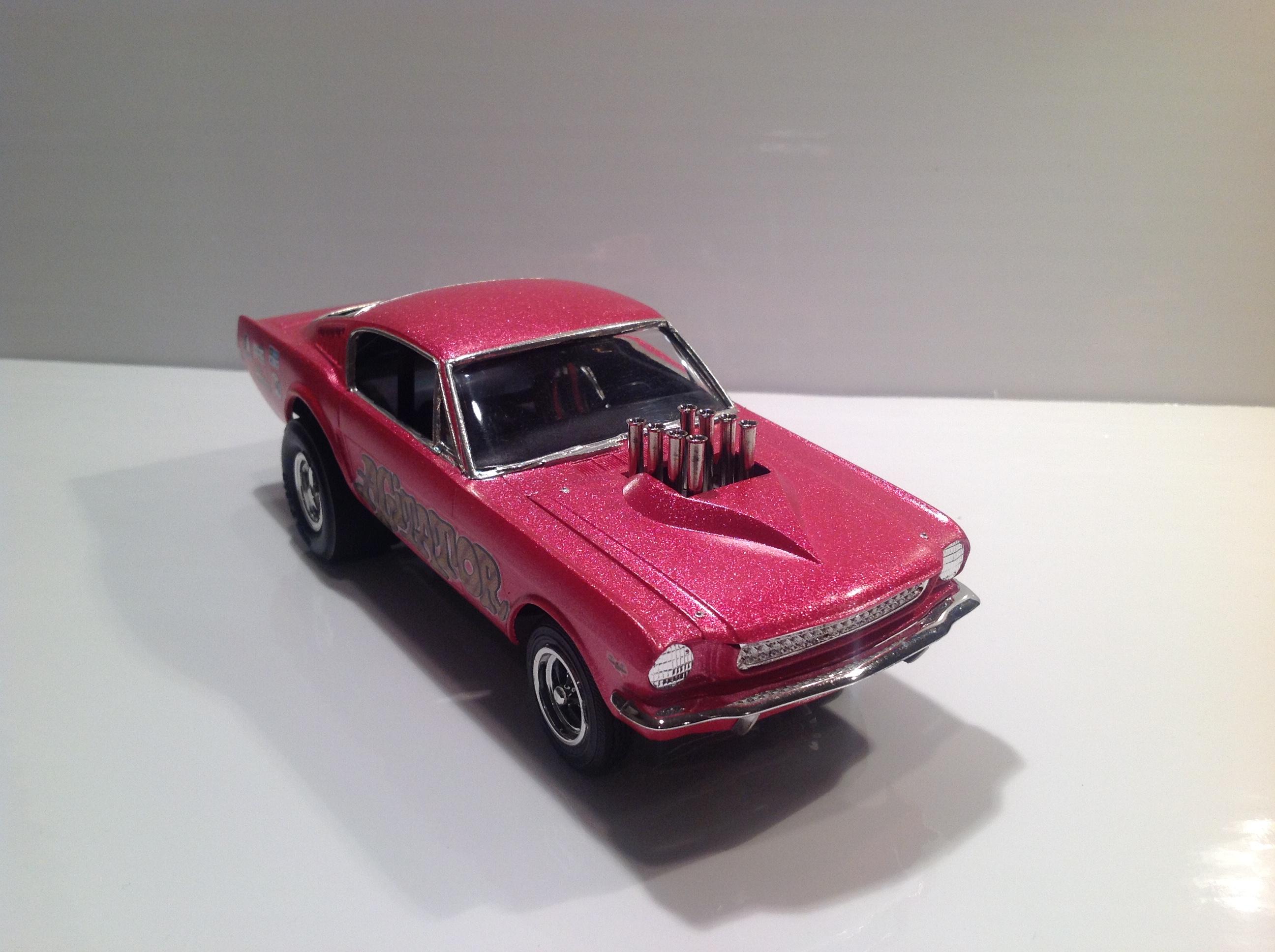

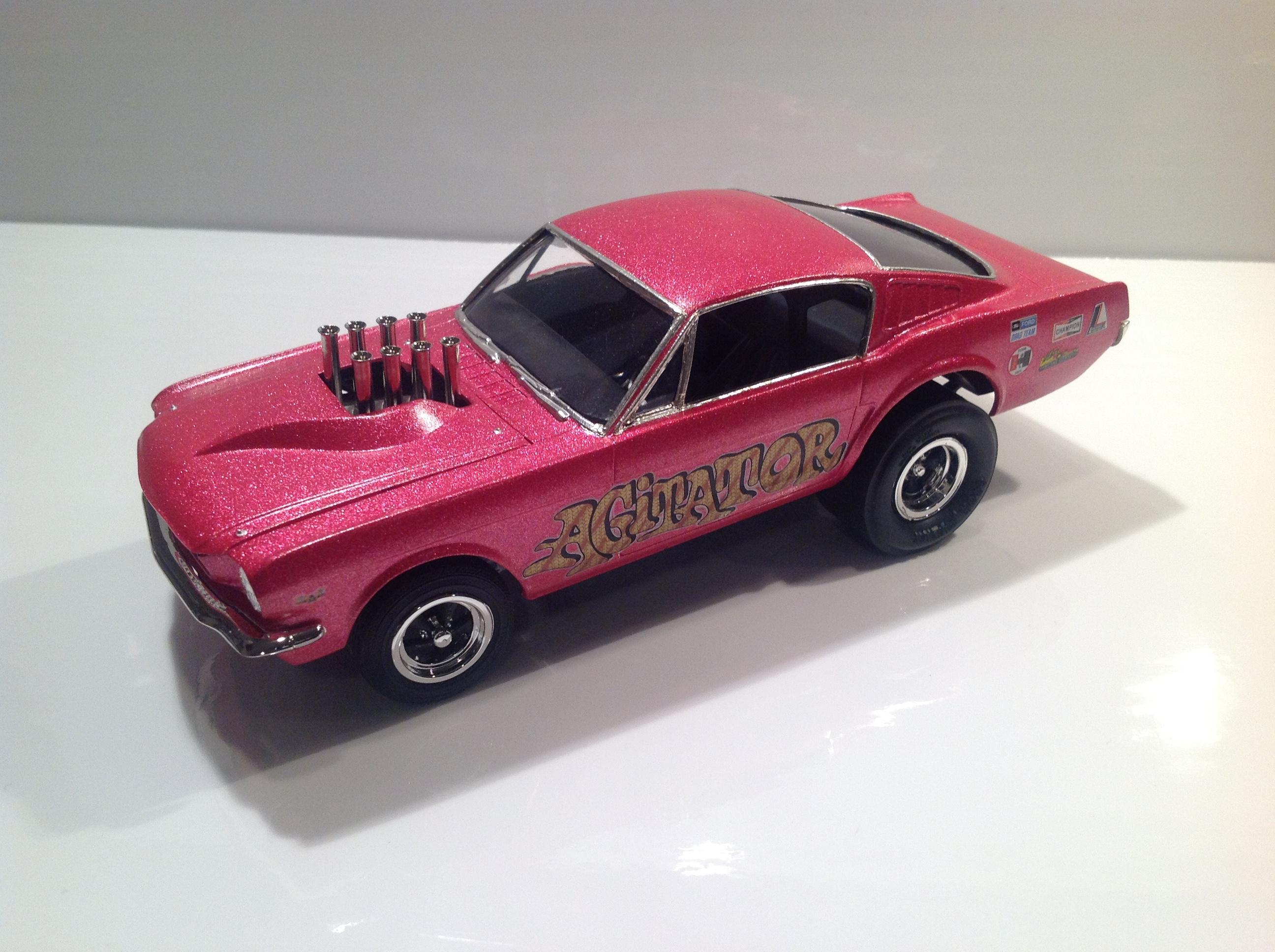

Here's Krylon shimmer pink on a mustang street freak. Just the right flake for this type of car

Yup! Very nice, BTW! B)

That flake paint is right on old-school Metalflake-looking; I dig it!

I buy the stuff at Hobby Lobby. They seem to have changed some of the colors. I bought one--no longer shown on their website--called Pumpkin or something that looked like a nice metalflake orange/tangerine from the can cap but is actually more of a copper/bronze color that I haven't found anything I want to use it on yet. I'm planning to do a Manx in the Shimmer Green and a TeeVee in the Shimmer Red.  The green looks like an excellent match for 1972 Chevrolet/Pontiac Spring/Julep Green, except of course for being way too sparkly. I discovered that covering it with Dullcote tones the flake down to a factory metallic appearance (polishing or glosscoating it again brings all the flake back), so I'm thinking seriously of doing a '72 GTO in it, flattened, as a late-'70s/early-'80s beater or High School Hot Rod.
Each can looks like it could paint at least four or five models, or more.

As promised, here are some pics.

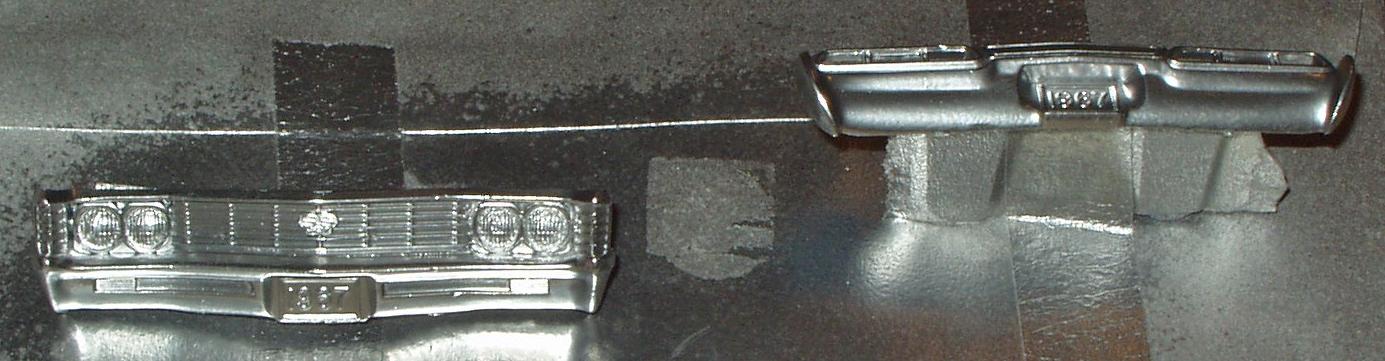

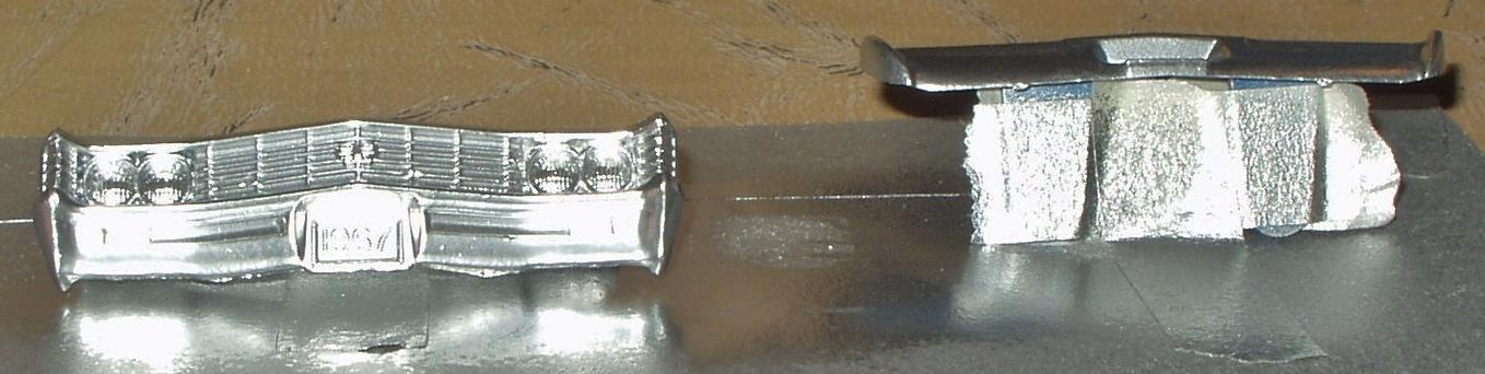

'67 Impala promo chrome with Krylon Foil paint, right out of the can. Notice in some pictures you can actually see a bit of a reflection of the front bumper in the Foil paint on the paper envelope that I had the parts taped to for painting. No, it's not as good as most kit chrome, but I've actually seen some kit chrome that doesn't look this good.

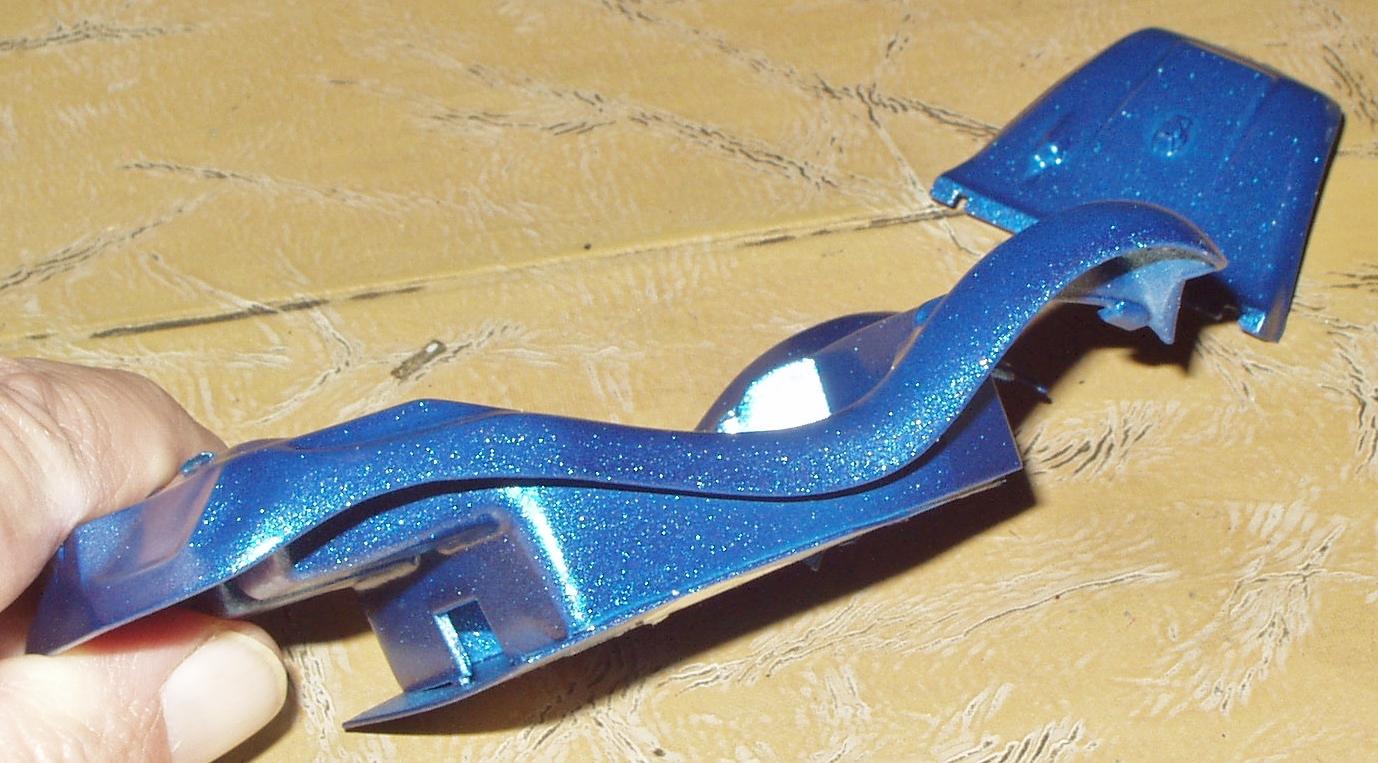

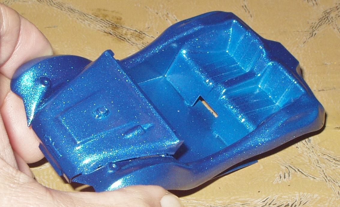

And here's the EMPI Imp body with the Krylon Shimmer, right out of the paint shop. No clearcoat or polishing, though I might try polishing it later to see what happens.  Comments welcome.

The finish on the Buggy looks very much like what I remember seeing on these in the '60's. I'll try that on the next one I build.

Those both look great!  Thanks for posting, Snake!
How is the surface of the flake-y one?  I’m guessing it’s real flat and will need a few coats of clear to bury the flakes?

Hi Snake!
That Krylon Foil seems very convincing. How many coats would you say you put on those bumpers? Light dusting or medium or heavy coats? Just curious...
It's very smooth, with a pretty good gloss. I'm going to try polishing it with Wright's to see if that brings out any more shine, but if it doesn't, in this case, I'm going to use it as-is, I'm not going to bother clear-coating it. At least not at this time.
CT
I sort of dusted on one coat, and then immediately went back and laid on one medium-heavy coat, just enough till I was sure I had 100% coverage. One step, one-shot process, the whole job was done in about 60 seconds. And then I let it dry undisturbed for 4-5 days.
Today I did the black-washing of the grille and I was amazed at how well the stuff held up. It wasn't nearly as "soft" as other silver paints I've tried. I don't think I picked up any smears or dings in the handling.
Oh, and I didn't use any primer, either, just shot it right over the promo's bare plastic.

That chrome finish is a real budget friendly alternative, at least it appears so to me; very impressive finish! You already had me sold on the flake, it is SO 60s-early 70s custom perfect. The flakes appear scale correct for that "bass boat" look!  Thanks for the report, Snake!

Snake,
How does the Krylon foil compare in sheen to Molotow?
As reflective or no?

Hi!
Thanks for the infos.
You stated you used it without any primer. However, many kit manufacturers spray a "clear" coating on their parts about to be vacuum plated. It shows when you remove chrome with, say, Easy Off. It is the yellowish stuff that remains in some corners of the parts after the removal chemical is done with the shine. I read somewhere that they go to the expense of doing that clear coating to provide a "smoother" surface for the vacuum chrome to "flash" on.
Therefore, my question: would your excellent results be even more chrome-like if you first "cleared" the parts with a light coat of a clear compatible with Krylon Foil? Presumably Krylon glossy clear?

Dunno. The promo parts I shot were VERY shiny. They might have had the clear coat on them but in my experience lye (Easy Off/Super Clean) will remove that and both these parts spent a week in Super Clean. I didn't notice any clear buildup or yellowing on them, but as I said, the plastic was VERY shiny.
I should also point out that these 1967 promos MIGHT not have been styrene. I think some promos were made of something stronger, like Cycloac, and these MIGHT have been that. I'd urge everyone to experiment on the exact plastic  you want to "plate."
I didn't prime these parts because I suspected that surface smoothness might be an issue. If I'd used a (flat) primer, I might have had to shoot two or more coats, which might have obscured detail. I DID test the stuff on the underside of the promo's interior to make sure it wouldn't eat the plastic. It looked pretty good there, so I just drove on.
You might want to do your own tests with glossy primers and so forth. All I can tell you is what I did and show you how it worked. I'm sure there are other ways to use this product. What I did produced good results for what I wanted to do--better than I expected, if the truth were known.
I've only used Molotow on small areas such as window trim and bumper corner touchup, so can't compare perfectly to these bumpers, but I'd say the Molotow is definitely "chromier" in shine and reflectance. Same goes for properly applied Alclad, which I've never used but have seen very nice results of.
The Foil seems to be more durable/handle-able than Molotow. I was surprised at how well it held up to handling when I did the black-wash. I'd have expected Molotow to show some wear or damage from this.
The Krylon Foil's high points are, it's relatively cheap, relatively available (I think I got it at Hobby Lobby), and easy to use. It's not a replacement for replating or well-done Alclad, but for many jobs (such as a quick, inexpensive glue bomb resto/rescue) it seems like a good fit. In my case, it did EXACTLY what I wanted it to do and even exceeded my expectations.
