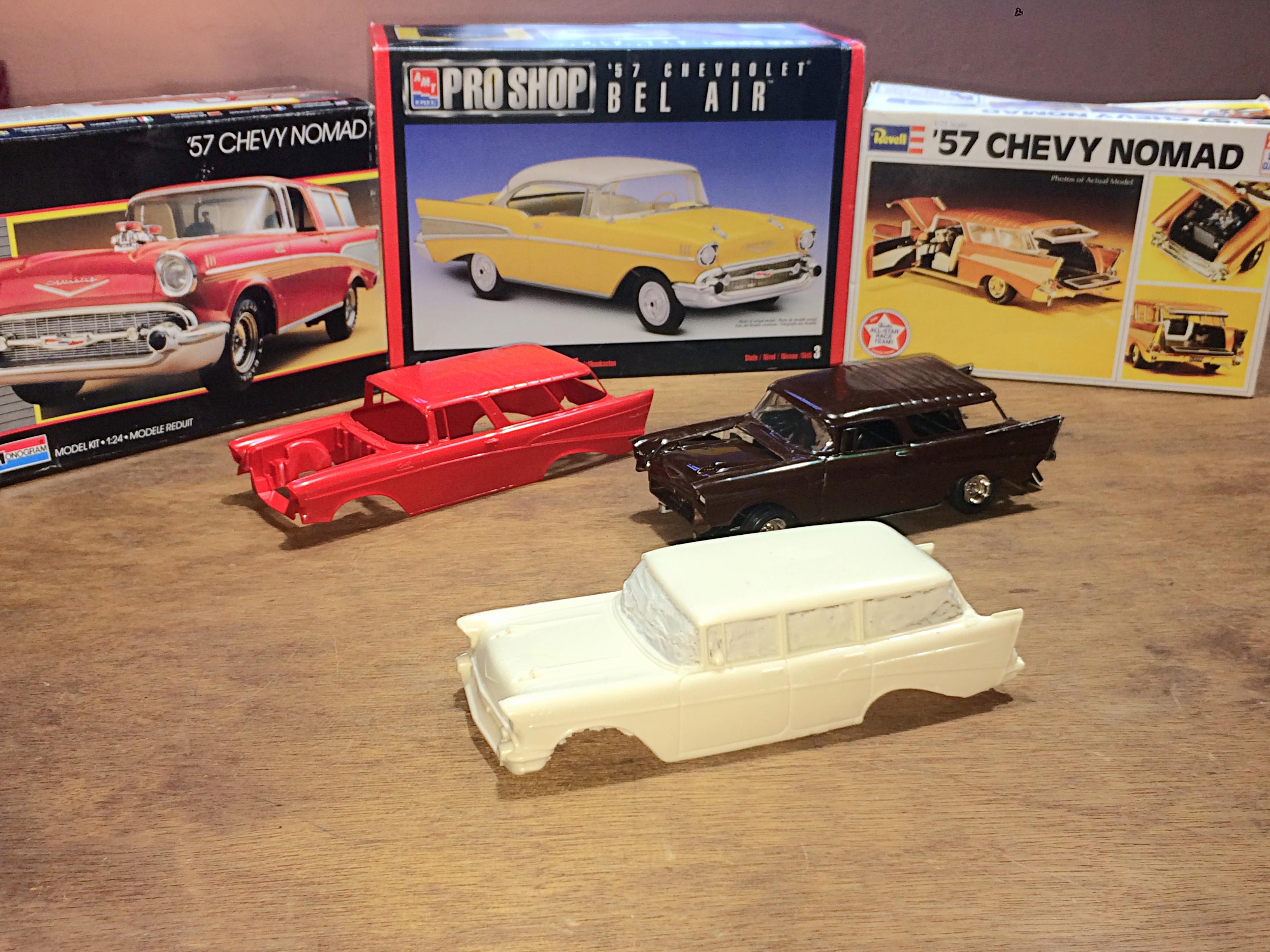

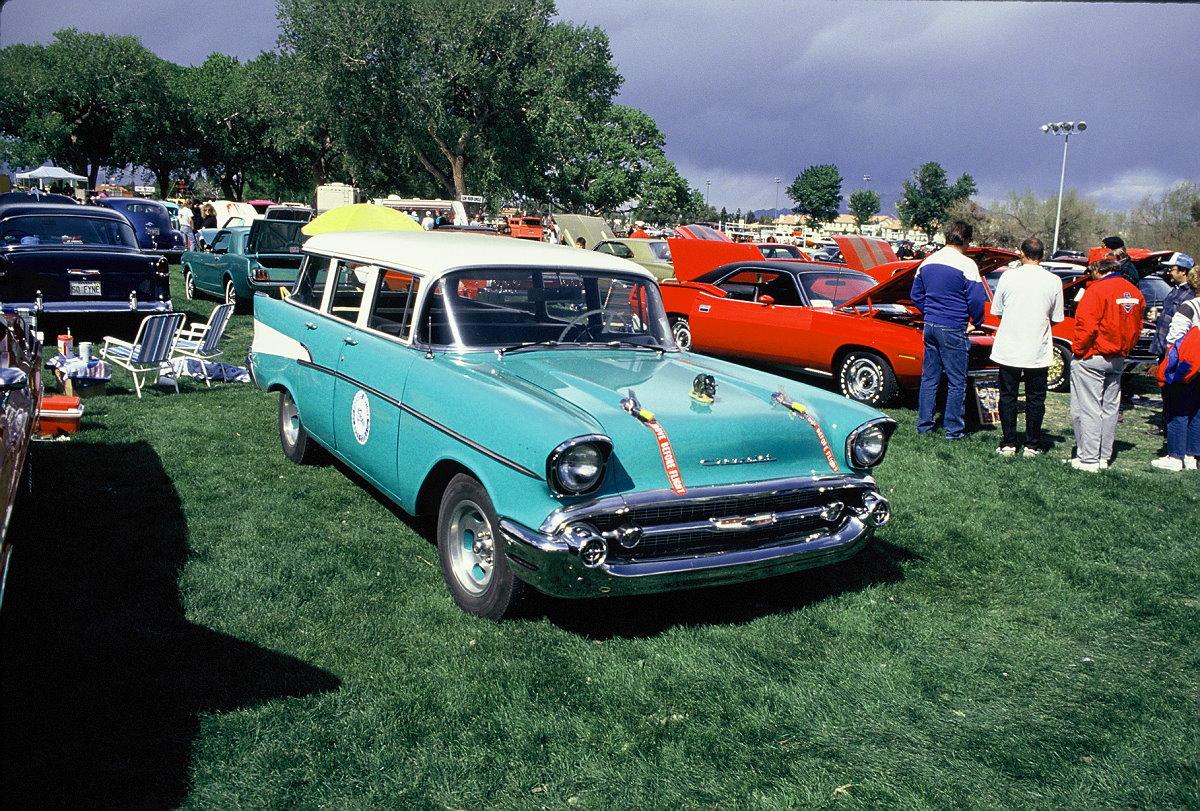

I owned a real '57 4 door wagon last century, and have a few kits in the stash.  Be careful about mixing, most people think the only change was lights and bumpers, but the cowls are different.  Dash is different too.  I'm going off fading memory, for a model it might not be a big deal.  All I really know, not a simple swap of bumpers.  Future project:

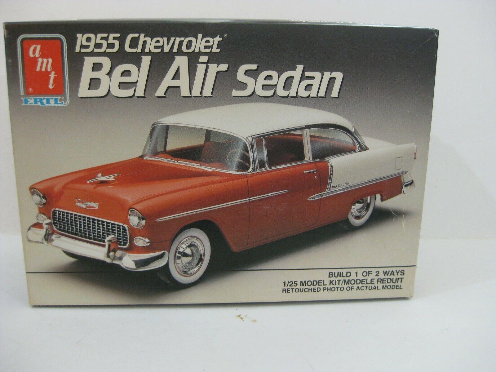

What's wrong with this kit?
The whole grille area and front pan just doesn't look right. It's not too bad if you plan to use the front bumper, but if you want to leave it off gasser- or street freak-style, it's pretty ugly. I've spent a good deal of time trying to fix one and it's hard, delicate work and I'm still just not ever gonna get it looking right. I'm thinking of trying to graft on a Revell front end, too.
The Nomad kit is also bad in this area, but the Sedan is even worse for some reason. It won't bother a lot of people, but it's just unacceptable to me.

Oh!  Thanks for your reply. I'll have to pull it out and look.

The only thing that is truly bad about the AMT '55 is the molded in single exhaust. Easily fixed with the chassis from the Revell '56 Del Ray. I would also use the floorpan from it with the seats and door panels from the AMT '55. The grille, headlights, turn signal and tail lights from the Revell '55 would be an improvement. But, not necessary.
In comparing the Revell '55 and '56, it wouldn't be a very simple top swap. One would also have to use the tops of the doors and quarters as they are shaped different and there's a big difference in length and height. Not to mention the the trim piece that runs from the bottom of the quarter windows down to the side trim would probably no longer be long enough. Along with having to modify the interior door and quarter panels to match the different profile. To me, it just wouldn't be worth the effort. Unless, I really really wanted a '56 hardtop.
Here's a photo of my AMT '55 with the Revell grille.
