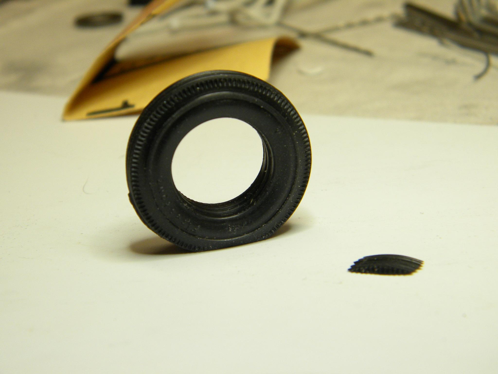

1 hour ago, Snake45 said:
That sounds easy. Isn't. Isn't easy at all to take a slice off a vinyl tire and get it FLAT.
I've thought of maybe trying to make a little clamp/jig of some sort that would hold the tire solidly, and you'd slide a razor blade or utility knife blade along the edge and just sort of plane the slice off in one shot , if you follow what I mean. Wouldn't be that hard with solid vinyl, dunno if it would work with hollow vinyl at all or not.
I've flat-spotted probably hundreds of model airplane tires, using a file and sanding block on solid styrene. THAT is a challenge, to keep everything perfectly flat in two planes, but it can be done. I'm thinking it would be about 20 times harder to pull off with flexible vinyl. :unsure:
It appears to be very easy, depending on the type of tire you're dealing with.
I just ran into my shop, grabbed my X-Acto knife and a little sand paper and completed this experiment in about 30 seconds.
This is an old AMT Firestone tire from a '49 Ford kit.
Harder and much easier to cut than a soft hollow tire.
I can understand how a soft tire would be more difficult.
Steve
