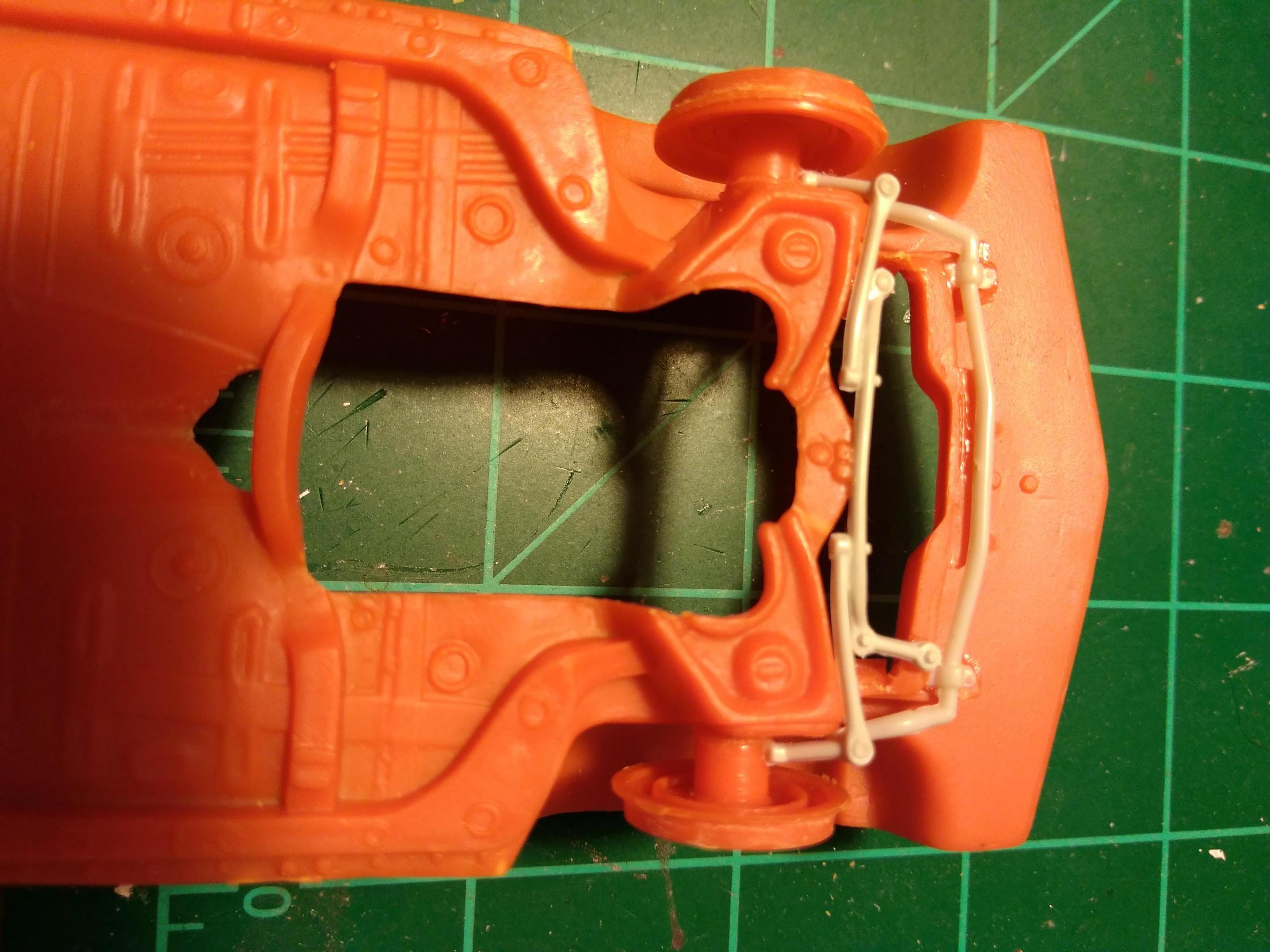

Thanks, its comming along kinda slow at the moment..
Front suspension is lacking. So I added a parts box steering linkage and swaybar.

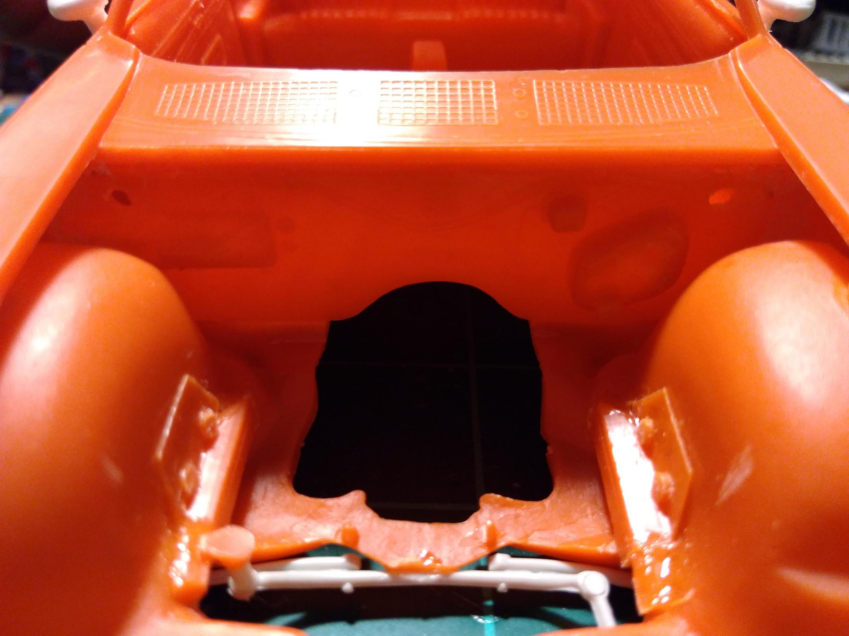

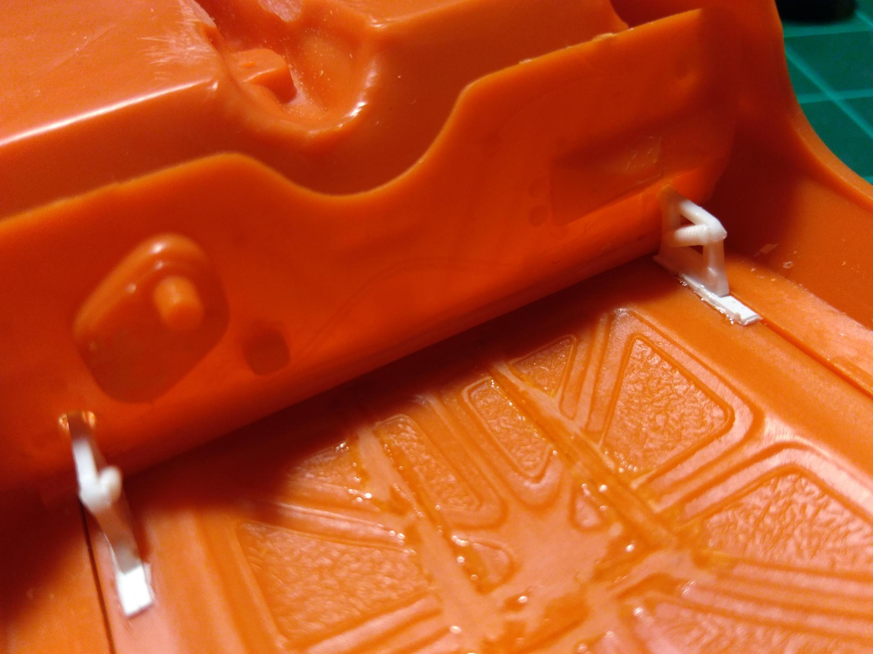

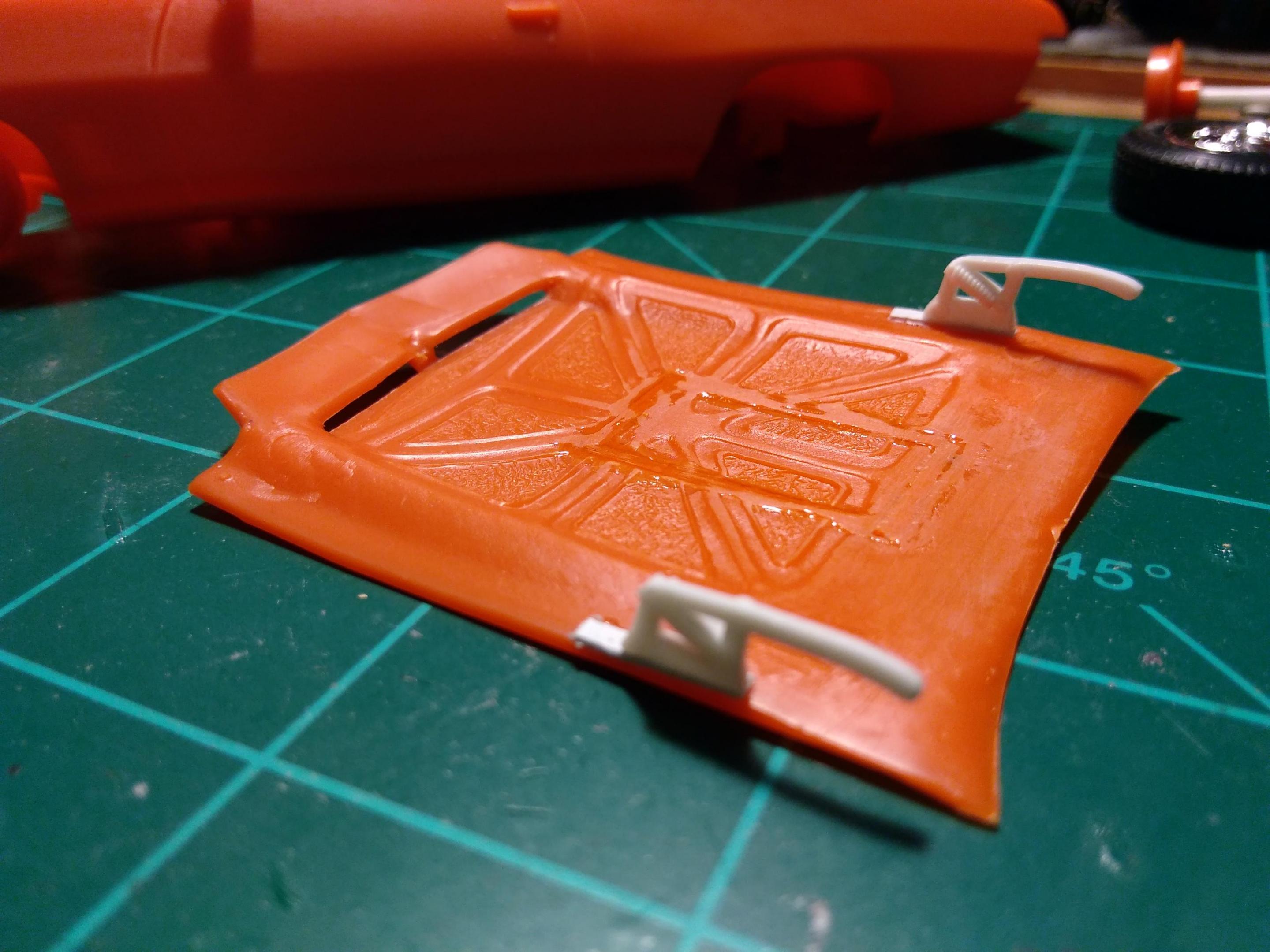

Moving on, I kept noticing how the hood just sits on the body and slides off very easily when picked up or handled . Had to figure a way to hold it down better. Looking back on those hood notches I filled earlier , even though it's a 67 firewall , I figured those were put there for a reason..like hinges.
Digging in my parts again , I found these hinges ( wish I knew what kit these are from) with long posts at the rear. I then drilled two holes in the firewall to match where the hinge posts line up. So that when glued to the hood bottom they would act as a clamp to keep the hood from constantly falling off.the interior bucket had slots on the firewall portion already that lined up so the hinge posts could slide all the way through.  With these in place , the hood stays on. To remove it, Just lift the front and slide forward.

Excellent idea with the hood hinges.
I might have tacked it lightly with a couple tiny dabs of museum wax.

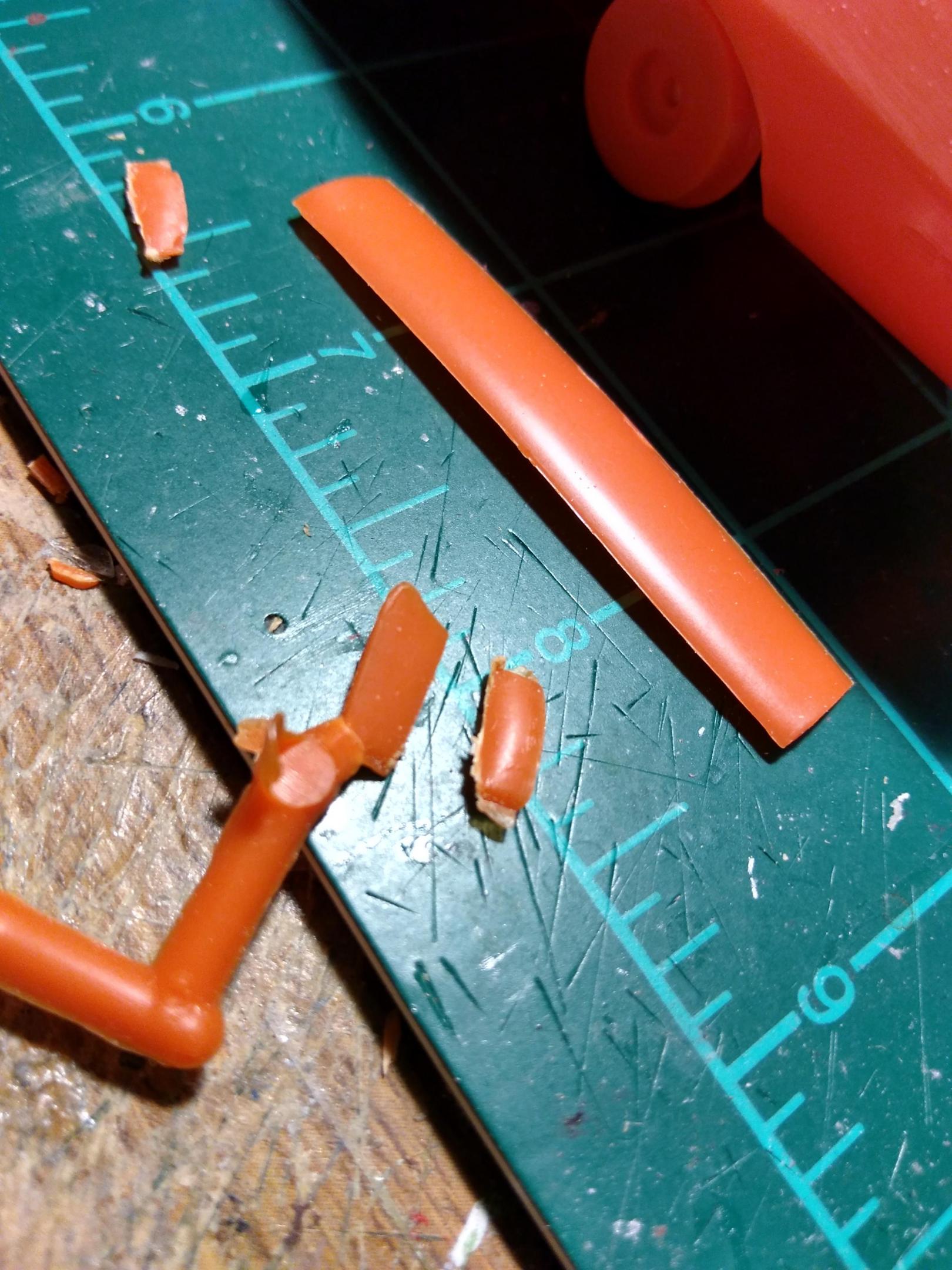

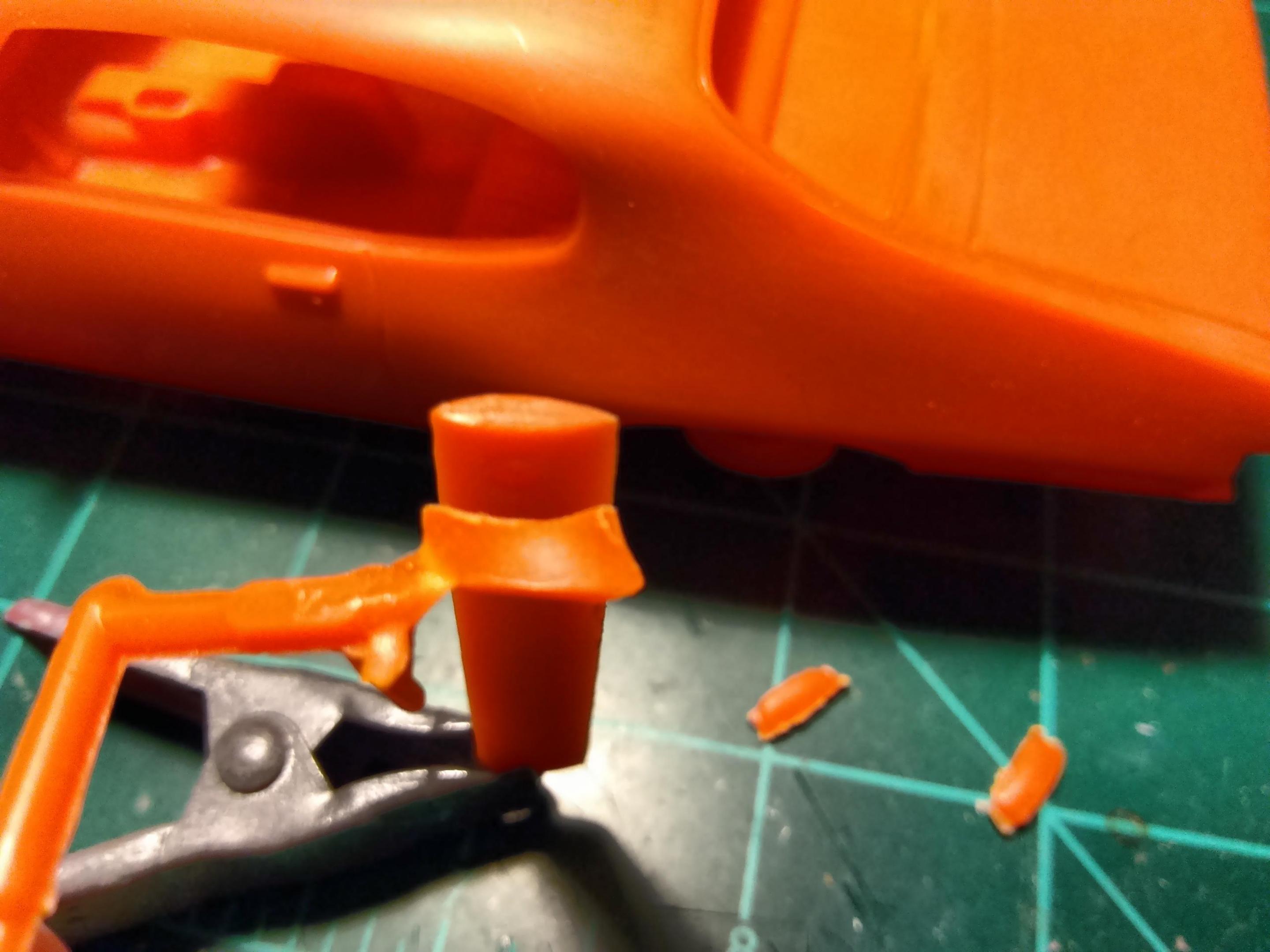

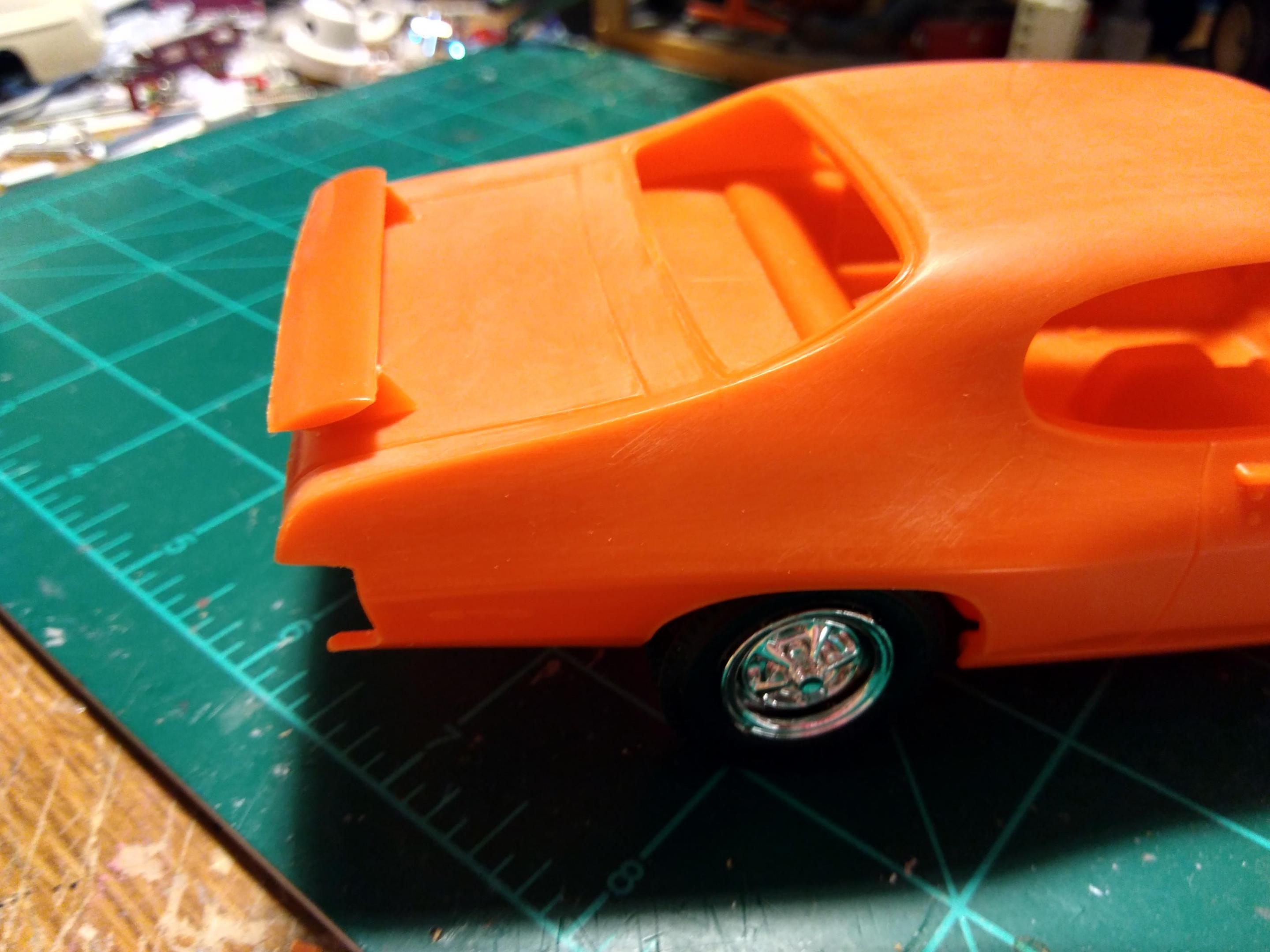

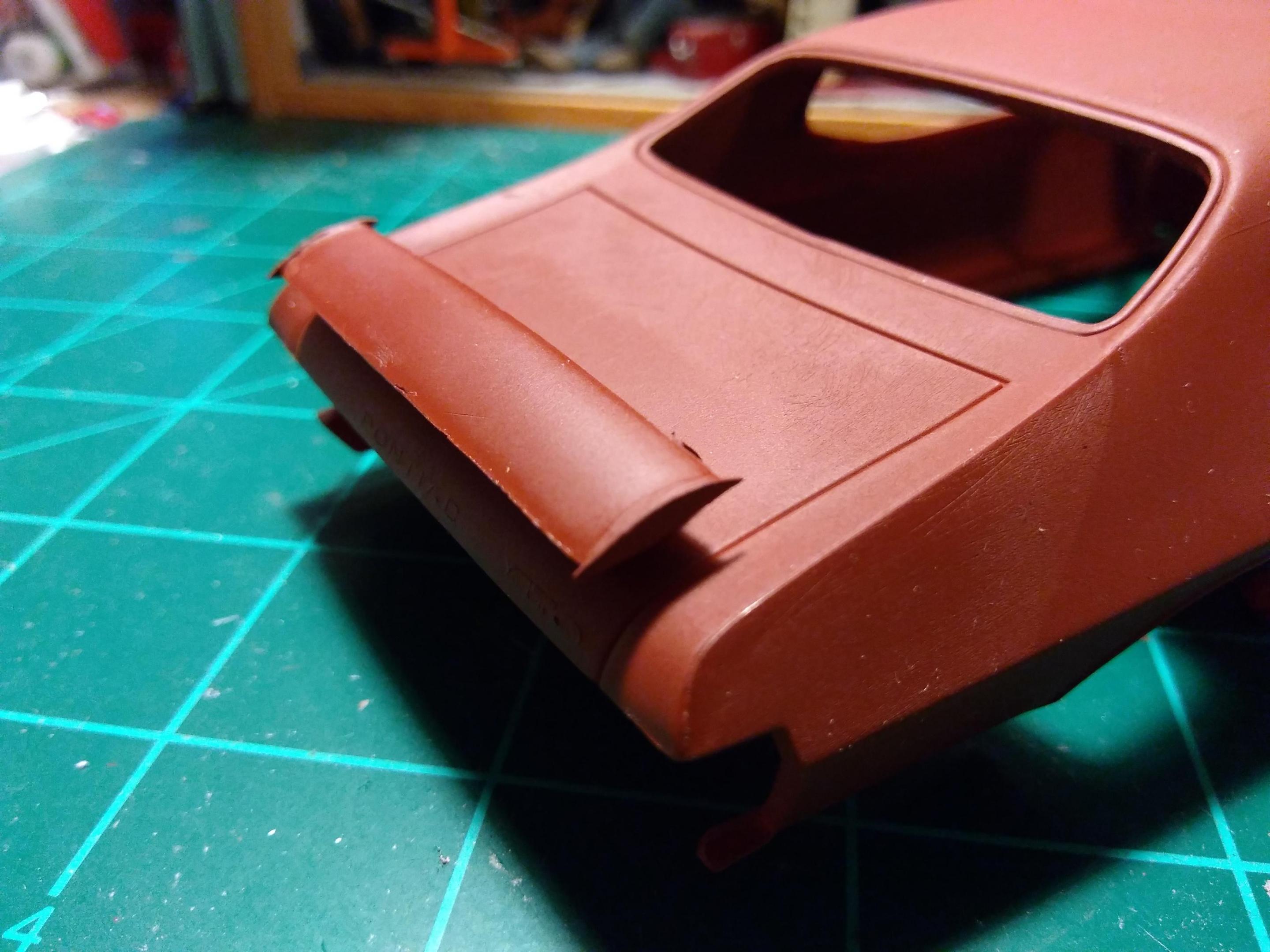

Got some time this morning to build on models. Moving on to the rear trunk wing..which is incorrect for a 72 from the pictures I've seen..so simple fix.
Take the curved end stand pieces and cut the upper curved section off. I'll be using the lower straight section. Used a Dremel tool to carefully shape the cut end to match the curvature of the wing.  Glue into place about a 1/4 inch in. Trim a little off the back edge at an angle to keep the wing stands from overhanging off the rear trunk curve into the bumper . Since the wing is going body color anyway, I went ahead and glued it to the trunk lid.

Be advised there should be thin end plates on the spoiler. (Assuming you wish to put forth the effort)

Yeah. Almost went without doing that..but since you pointed it out and it's an easy add on..here ya go..made it from the parts tree flashing.
Also primed the body and various parts over the weekend.

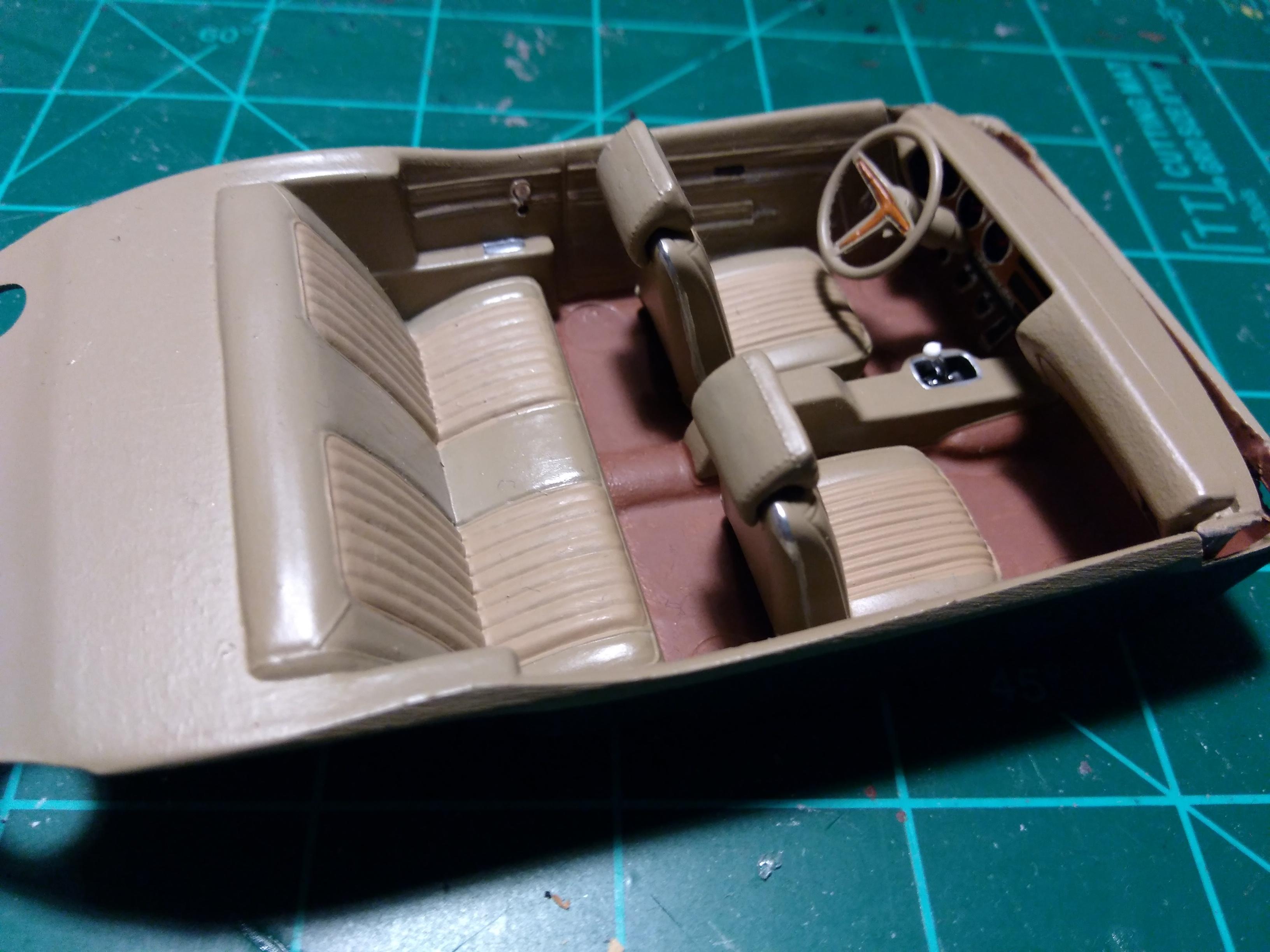

Did some painting on the interior and engine while finishing up updates on another build. Been fighting a cold at the same time so progress is slowed ..but it's moving forward. I decided to do a tan interior like the box art. Used valspar flat 84230 rugged beige for the seats, door panels, dash and steering wheel. The engine block is done in duplicolor light metallic blue.

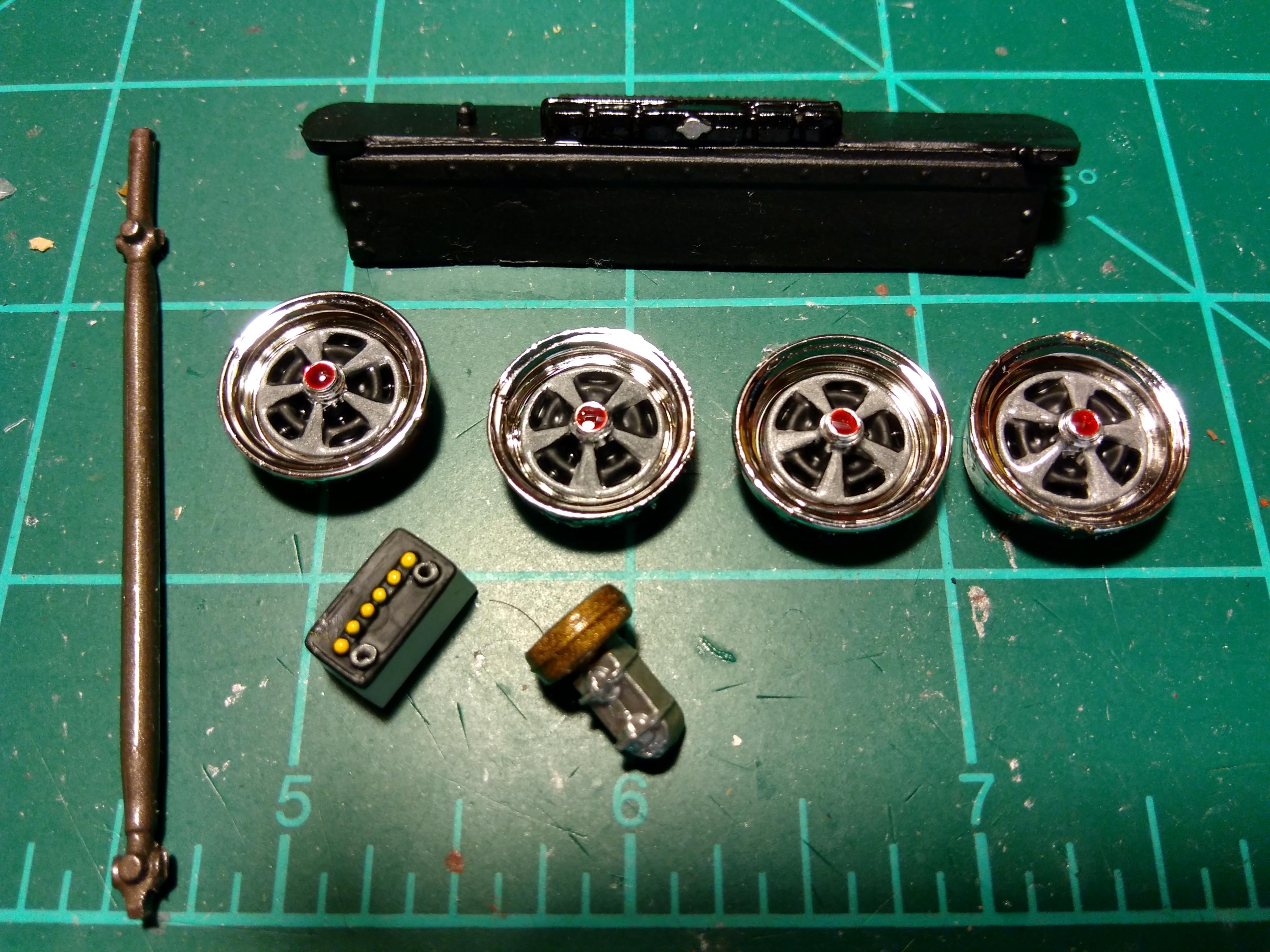

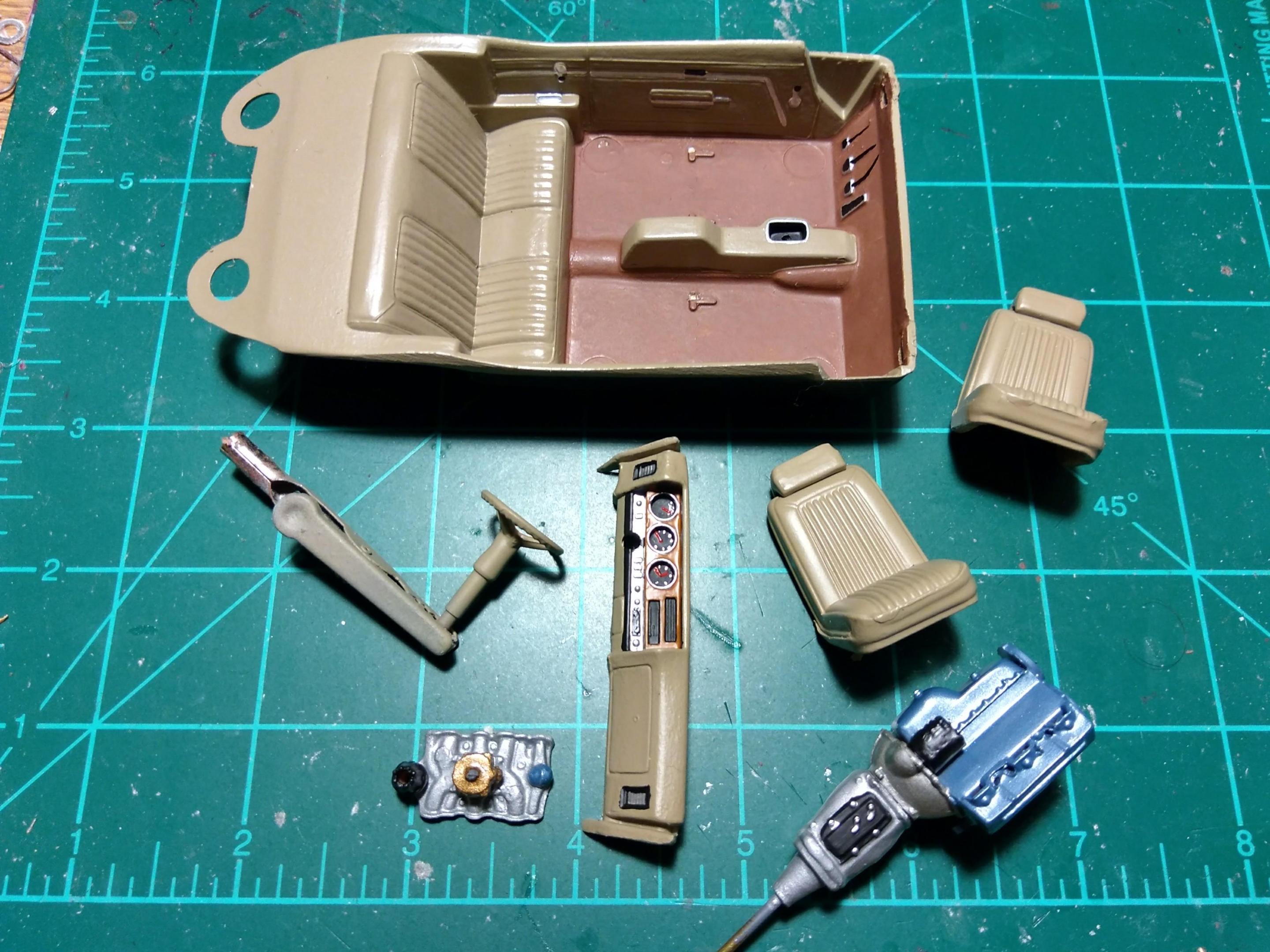

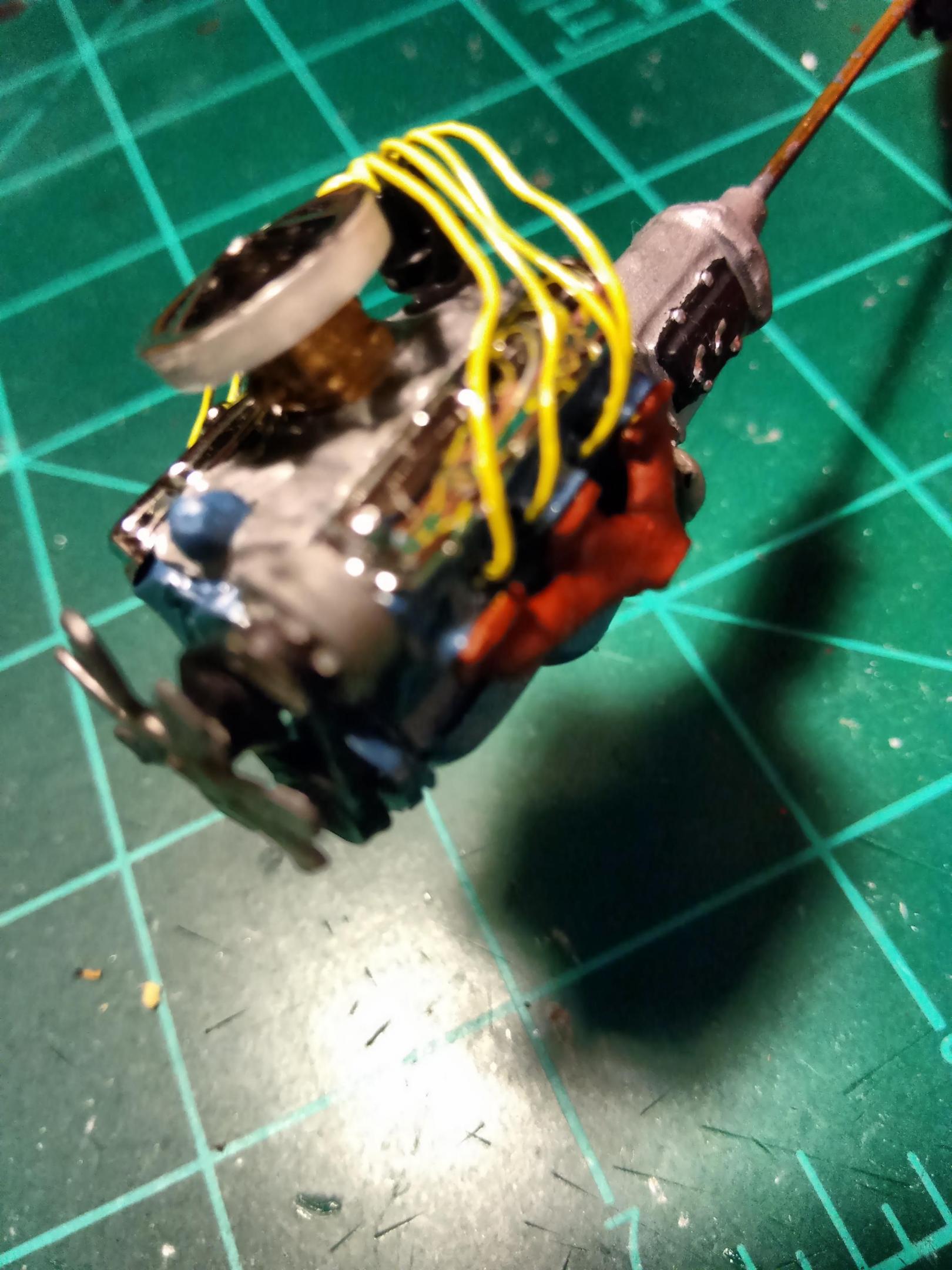

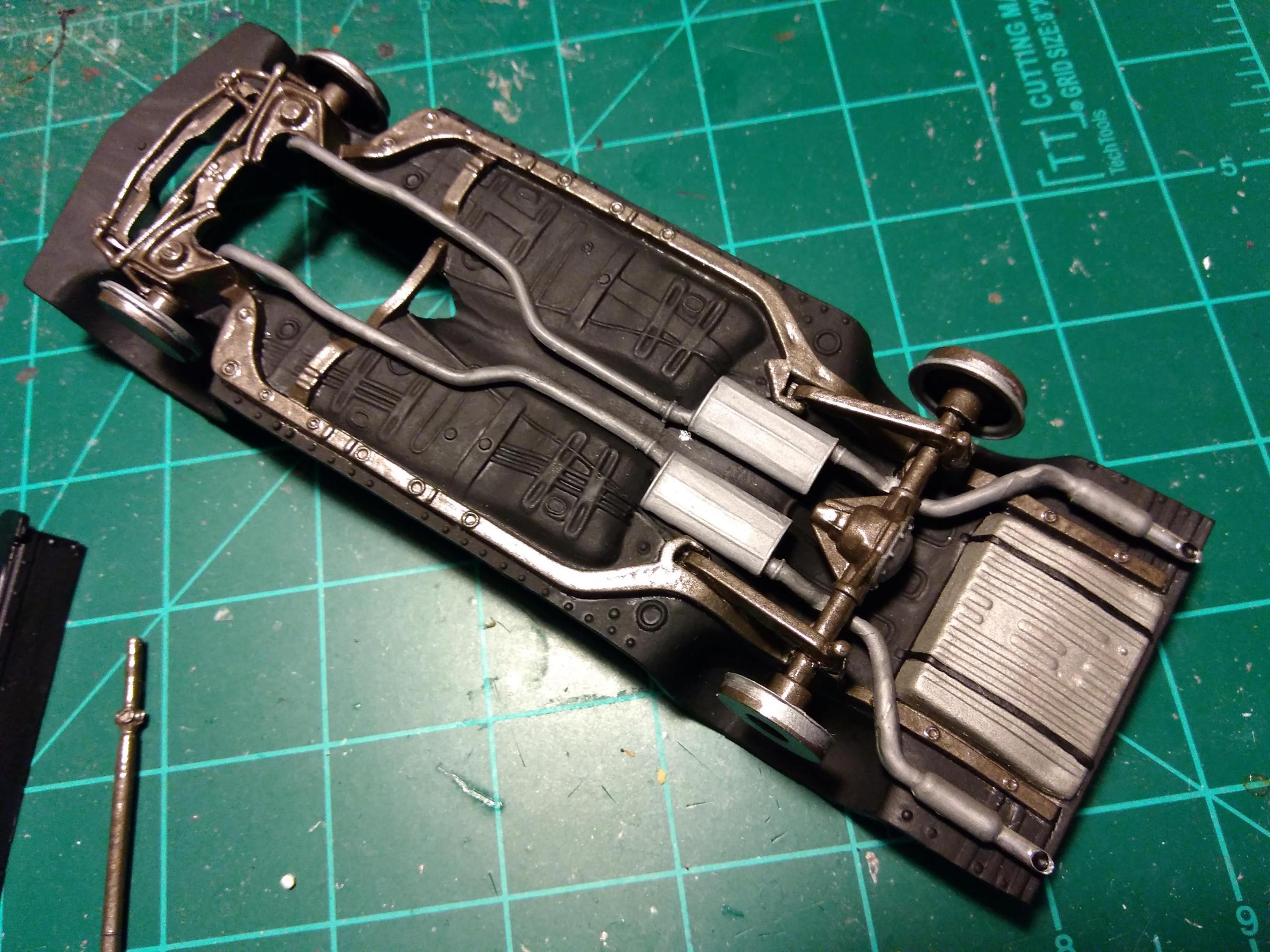

Finished up the interior, engine and chassis .
Frame is painted Rust-Oleum hammered bronze. For the interior ,I had to trim down the bottom seat " tracks" and use a drill bit to angle the steering column hole in the dash. Otherwise ,the steering wheel will touch and sit right up against the seat causing a slight fitment problem..not to mention no leg room for a driver..the engine needed a couple small spacers for the pullys cause the alternator sits against the block. But don't space it out too much or the fan will hit against the radiator and lower chassis plate clearance cove under it..I went ahead and wired up the ignition with 26 guage floral wrapping wire and painted testors light yellow.
