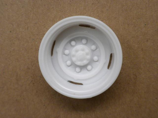

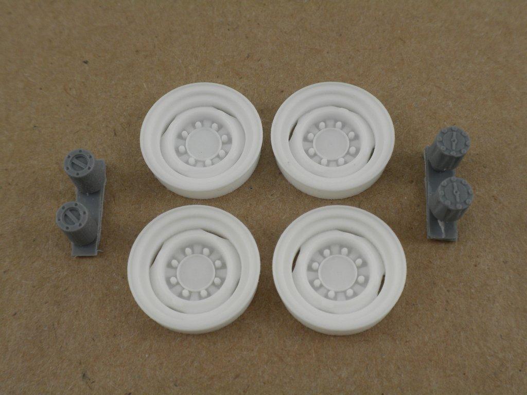

Forgot that Scene’s Unlimited has some really great 8 lug steel wheels with full floating hubs - in 1/25 and 1/24.
One with separate hubs and one with molded in:

On the left are the W28 1:25 scale wheels from Scenes Unlimited, and on the right are the W44 1:24 scale units from the same caster. The separate floating hubs are below the wheels.
IMG_9668.JPG.5f2be2552b5c40d686eb82d93c682b72.JPGHere is the W28 in an AMT M&H slick, with the W44 in a Revell M&H slick. The W44 is just a tad small for the Revell opening, despite the wheel being 1:24 and the tire being 1:25, but it would work if the wheel back pushed it out far enough to look seated on the bead. On the other hand, the W28s fit the AMT slicks like a tailored suit.
IMG_9666.JPG.be7e36991eeccf0c232b16cffe37dafb.JPGThe BNL castings of the old MPC 4x4 wheels were mentioned. Here's a comparison of them with the W28 in the AMT slick. You can see how large and deep they are. Now, Ford did offer a 19.5" wheel as an option on the F-250 in the '50's and early '60's. In a pinch these might be passable for those.  But they were rare and much narrower than depicted in the MPC wheel. Sure, you could say they're widened Ford wheels but I doubt anybody was making a racing slick for a 19.5" wheel in that period, or today. Much less one that had been widened. :P
