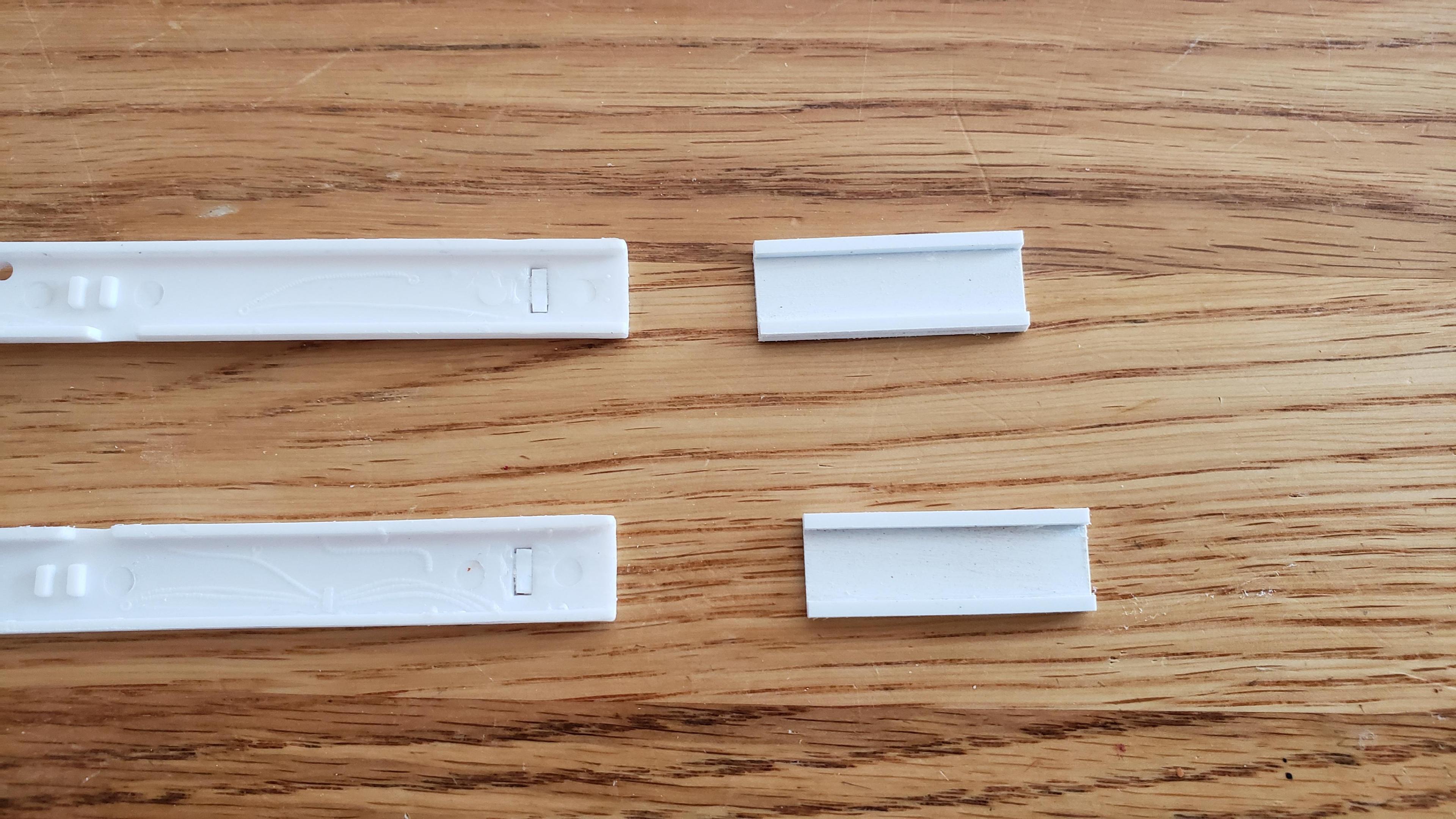

delta99 Posted February 6, 2020 I am building the Autocar dump kit, and I want to lengthen the frame. The frame rails measure 7/16" in height. Neither plastruct nor evergreen offer styrene channel in that size, but plastruct does have ABS. On plastruct's catalog, it shows recommended glues for both, and they recommend the exact same glues for both. But under the description for their glues, it says they will bond like materials, ABS to ABS, styrene to styrene, etc. I normally use testors orange tube cement. Will that bond ABS to styrene, or do I need to use CA? Quote Share this post Link to post Share on other sites

delta99 Posted February 15, 2020 Well, I decided to try to make frame sections from styrene while waiting for the abs channel. They came out pretty good. Should have just done that to begin with lol. I'll experement with the abs in the future Quote Share this post Link to post Share on other sites
