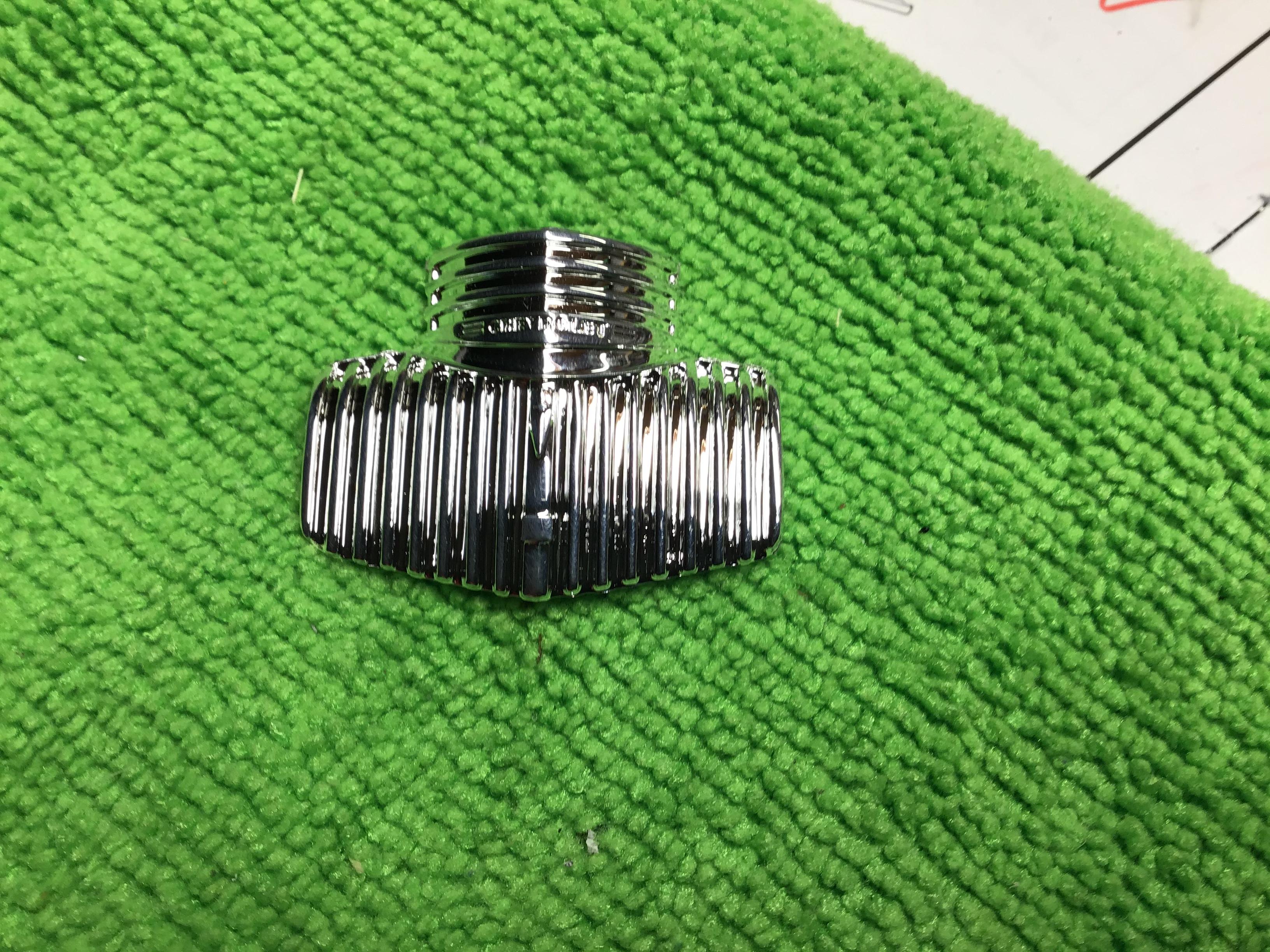

I am working on a ‘41 Chevy pickup. The grill has wide shallow indentations that represent the open slots. What black paint would look better, flat or semi-gloss? Actually opening them up is too difficult and would destroy the chrome. I think the SG might give the illusion of more depth.

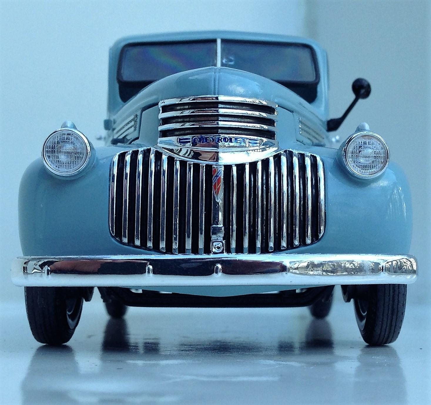

I went all in and stripped it, cut out the "vents", and then used Alclad Chrome followed by Alclad Aqueous Clear
Share this post
Link to post
That looks GREAT Gerry! If I screw up the paint I think I will try that instead of painting the whole thing black and then trying to do the reverse of painting the slots. Did you strip the bumper and headlight bezels also, or is that the kit chrome still?  Do you have a thread on that truck somewhere?

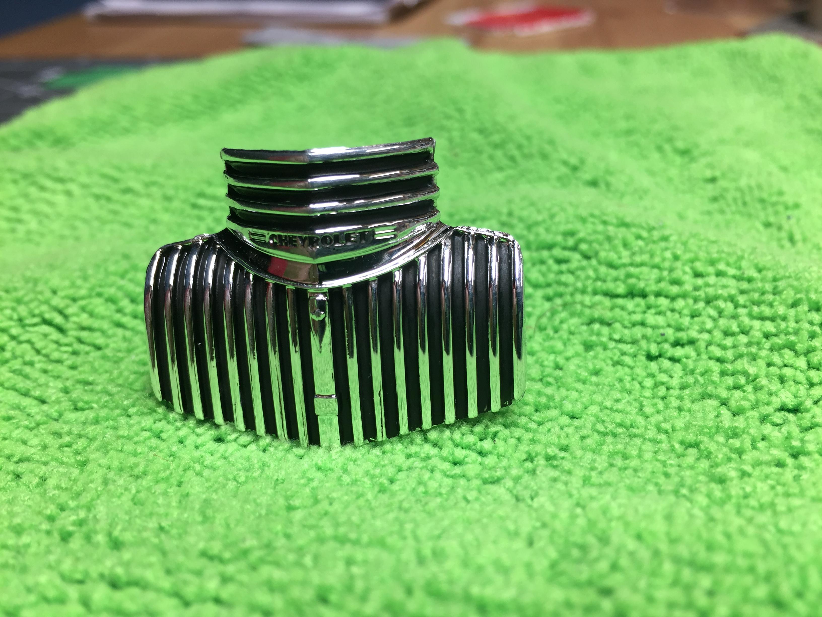

Well I took the easy way out. This is Tamiya acrylic flat black free handed and cleaned up with some nice tapered cotton swabs that I got at a local electronics supplier. It needs at least another coat, and I may try semi gloss?:unsure:
Looks great the way it is.
I wouldn't change a thing.
Steve
Edited by StevenGuthmiller
Share this post
Link to post
I'd leave as is, looks good to me..Don't press your luck..Very nice..Leave it alone..
Share this post
Link to post
Yes looks great. I like the flat black, shadows don't have a shine. When you put it on the body for mock up you will have a better idea of how it looks.
Share this post
Link to post
Agreed. If it aint broke, don't fix it, and your grille looks great to me.
Edited by Roadrunner
Share this post
Link to post

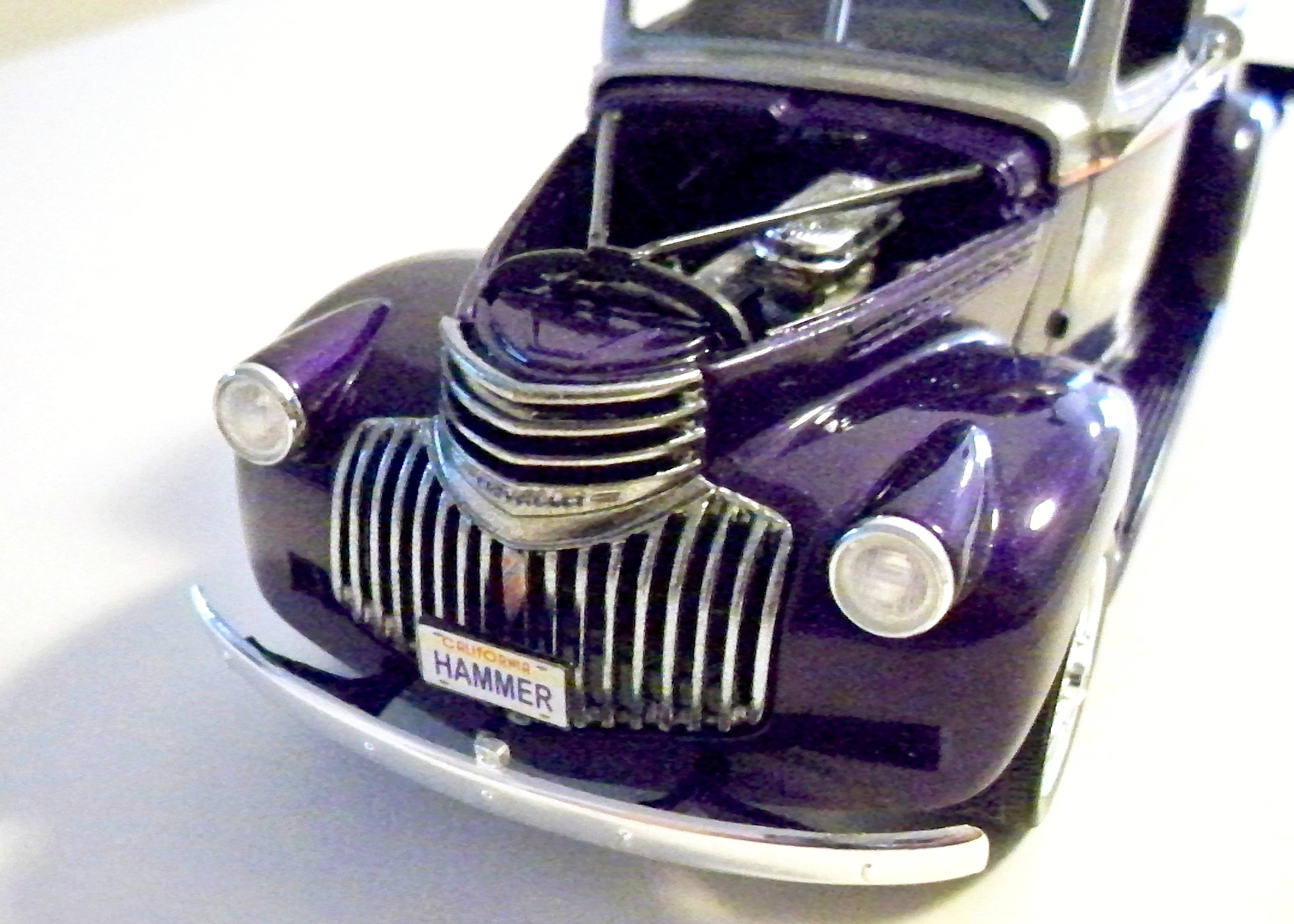

I did this one using Panel Line black, your opened up grille looks FANTASTIC!
Share this post
Link to post
