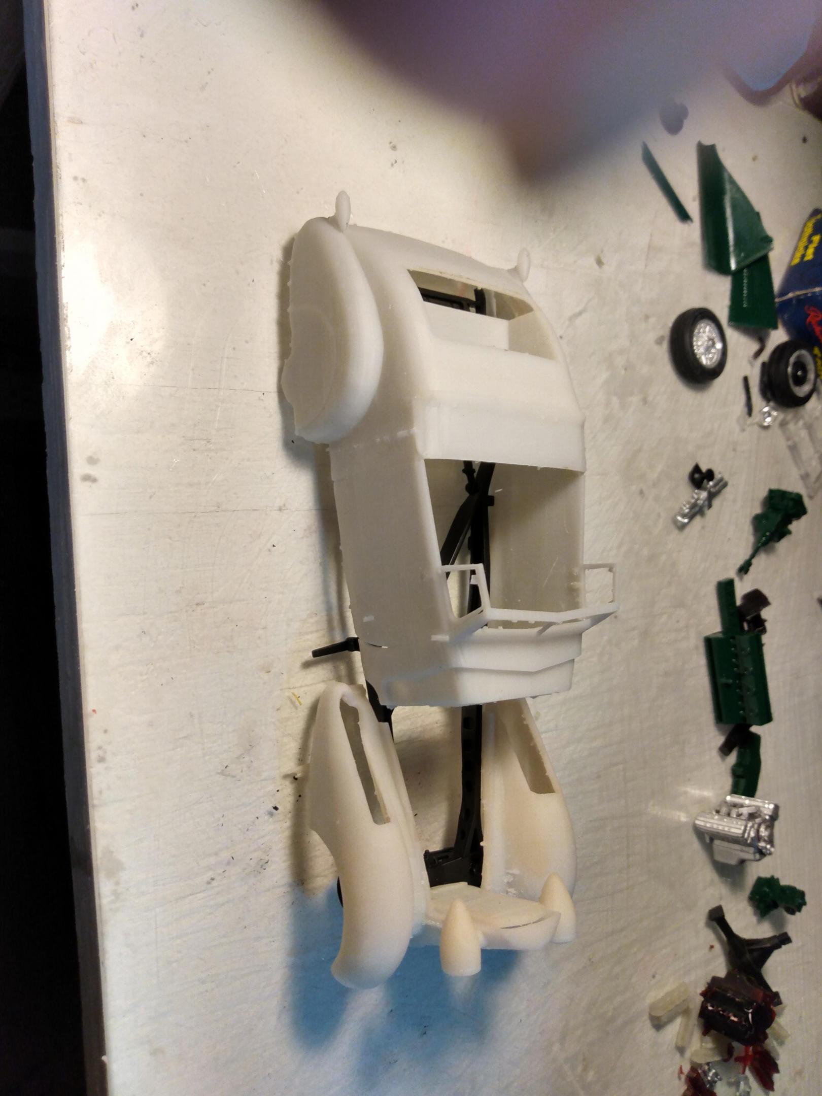

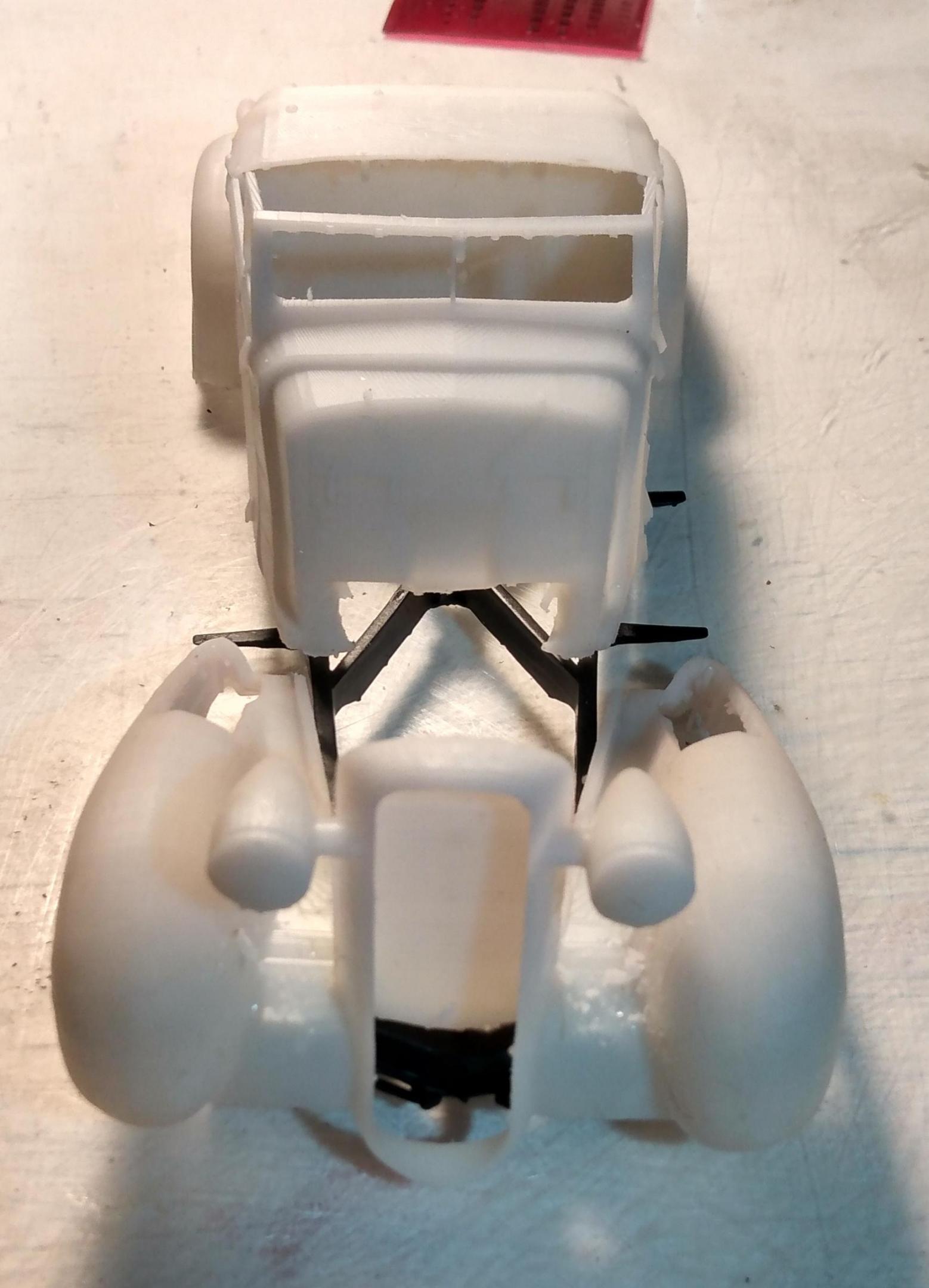

I printed out 2 test print of the front clip and body to check for errors and fit for both pieces. Everything looks good.IMG_20200320_121950884_HDR.thumb.jpg.b68a3b7ee1ad60964184cc8c60ca5042.jpgIMG_20200320_122021365.jpg.f198fd0c36f24efb6ef1b416a268e353.jpgIMG_20200320_122028224_HDR.thumb.jpg.040a59c436a1ee8e99c05705e2b78570.jpg

Ooh man, that's cool. Much respect for what you have accomplished already. I'd be happy with just the test subjects. BTW- what are your plans for them?
Later-
Throw them away.
