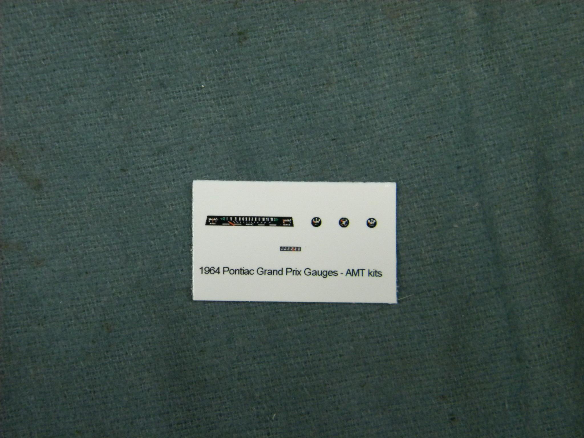

Have you got some gauge decals for this one? I'll bet there's a couple more of us could use some. My '64 GP being one of them! Haha
Actually Keith, believe it or not, they are readily available from "Best Model Car Parts". ^_^
Steve
Share this post
Link to post
Cool info on the gauges! I buy a lot from him, but didn't know he had the GP set.
Share this post
Link to post
Your dash's are a model unto themselves.
Share this post
Link to post
Steve
I really love Michael's gauge faces but I don't use them on my 60's Pontiacs.  The reason is the black gauge background which to my eye is not correct for these cars.  If I could scan them into something like Photoshop and change the background to what looks to me like a gray with a very slight blue tint, I would be happier.
