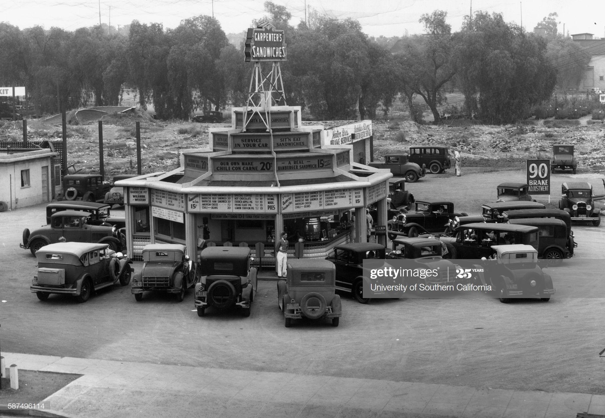

I have a diorama project that I want to build and need the services of someone that can do sign graphics.  Purely text with a few different fonts that mimic the signs in this photo.
I have a thread called Carpenter's Sandwiches in the Diorama section, but think this is a more logical place to ask.  I would rather deal with a forum member if possible.

What scale is the diorama?
You might run into the situation where the text would be so small that font wouldn't be noticeable.
Share this post
Link to post
Thanks Pete. Already did some font searching and found some that are close enough.  Only problem with searching is finding font lists where the whole alphabet is shown.  Problem learning a different program when I'm geared for another.  The good thing is I have a project to learn with.
Hope size reduction doesn't cause pixelation.
Diorama is 1/24 scale matching all the Danbury Mint cars I've collected.  Have about 40 cars and trucks that fit the era.

One thing that I haven't read explicitly in this thread: the signs that you want to duplicate are all handpainted. So you will not find a font that matches them 100%. But by changing the fonts to curves, and the manipulating the control points, you can make them look like the handpainted lettering.

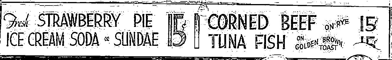

This will be my first sign project in Corel.  The image is what I did in Paint from a photo.  I'm fairly sure Corel can do it better, that is getting from an aliased bitmap to an antialiased bitmap prior to the conversion to vector curves.  Not sure I have the terminology correct. The photo is just to show the subject.
Got it backwards.

If you want to deal with bitmaps (like cleaning them up, flattening perspective, converting to black/white, etc. Corel PhotoPaint is pretty good).  What you show above will take quite few hours of work to vectorize manually. Corel also includes auto-tracing program, but in my years of working with Corel I never got it to work to my satisfaction.  I always end up tracing manually.
Share this post
Link to post
There's only the word "Fresh" that I need work on. Searched through hundreds of fonts and didn't find any that looked as good as the original.  I can see where a bitmap image editor needs to be used to clean up the word prior to sticking it in Draw for conversion to curves. 95% of the word copy on the signs is common looking all upper case.  Hours don't bother me once I get focused on a personal challenge.
I watched a tutorial on the auto trace and it sure has a bunch of things to tweak.
Share this post
Link to post
Auto-tracing foremost needs fairly high resolution bitmap.  Then you usually end up with either rough rounded outlines of the traced objects, or if you change the settings, you end up with very jagged outline with thousands of line segments,  I have never found a happy medium where the outline would tightly follow the traced graphic, and no have too many line segments (control points).  I tried auto tracing, then cleaning up the traced vectors by removing bunch of control points, but now I find it easier to just manually create a rough outline around the item I'm tracing, then mess around with that outline.  It takes me less time to manually trace than to auto trace and clean up the result.
I've been thinking of your project. How large will the printed version of that sign you posted earlier be?  2-3"? You might be able to get away with just cleaning up the bitmaps and just printing them.  Of course redoing it in a vector format will result in a crisper printout and one that can be easily manipulated without losing any quality.
Share this post
Link to post
From past experience I'll always resize the bitmap image to double or triple the pixel count and make all sharp corners down to one pixel.  Now when I convert to curves the auto trace will lock a node to each sharp as manipulate the total node count.  I want the crispness of vector graphics. No different from dealing with splines in CAD.  I'm very familiar with learning curves and the effectiveness of mastering a meaningful step a day no matter the time it takes. Then I practice what I learned at least seven time, with variations, so it sticks. In the end there will pretty much be manual manipulation so I may use manual tracing from the get go as you do.  I'm hoping to find I can edit a bitmap within Draw, but manual tracing negates the need.  Hmmm
