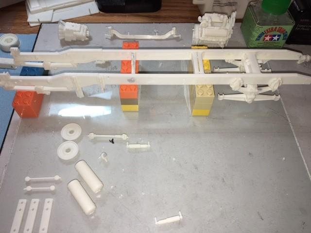

Goodwrench3 Posted April 4, 2020 Author Share Posted April 4, 2020 Got a bit further... rear suspension is on, attached a couple of the frame brackets. "Keep 'er movin' !" Quote Link to comment Share on other sites More sharing options...

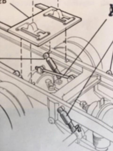

Goodwrench3 Posted April 10, 2020 Author Share Posted April 10, 2020 Hi all: Further to the question above, does anyone have any info (or 1:1 pics) of the rear axles and the torque rods on the 4300 ? The instructions for the 4270 and the 4300 are opposite of each other as far as how the rods are oriented (i.e. which direction the side with the pin is on goes). In the 4270 instructions it shows the pin toward the axle housing. In the 4300 instructions, it shows the pins toward the frame cross member ? Thanks! Quote Link to comment Share on other sites More sharing options...
gotnitro? Posted April 11, 2020 Share Posted April 11, 2020 I usually snip off the tips of the axle posts that snap into wheel backs so I can remove as needed. When I'm ready to permanently install them, a touch of super glue locks em Far as the torque rods go, if the crossmember has a notch in them, stick the end w pin there..have the lollipop end at the axle . Some have a small hole , or notch they sorta fit.. I'll dig out my 4300 parts truck tomo for a look, havent really taken a good look Quote Link to comment Share on other sites More sharing options...
Goodwrench3 Posted April 11, 2020 Author Share Posted April 11, 2020 15 hours ago, gotnitro? said: I usually snip off the tips of the axle posts that snap into wheel backs so I can remove as needed. When I'm ready to permanently install them, a touch of super glue locks em Far as the torque rods go, if the crossmember has a notch in them, stick the end w pin there..have the lollipop end at the axle . Some have a small hole , or notch they sorta fit.. I'll dig out my 4300 parts truck tomo for a look, havent really taken a good look Hey thanks for the reply. You are correct. I really didn't look at the cross member - I just assumed it was the same as in the 4270. In fact, there are locating holes on both sides of the cross member for the pins on the torque rods. Thanks for the advice on the axle posts -- I guess the wheels don't really need to turn - it's not like it's going to be going anywhere ? Quote Link to comment Share on other sites More sharing options...

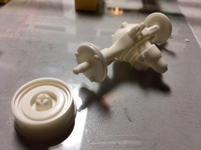

Goodwrench3 Posted April 11, 2020 Author Share Posted April 11, 2020 Hi all: Another couple questions that I need some help on to "keep 'er movin'" ... The assembly of the rear drive wheels -- there is a middle ring that goes between the inner and outer wheels (part #74). The ring itself is "beveled" -- but the instructions really aren't clear as to which side should go toward the inner or outer wheel ? It's hard to see in the pic below, but it slopes down from right to left in the pic. The outer wheel also has a "cone" shape to it. And, what color are you normally painting the inner wheel ? You won't hardly see the middle ring so that's not too important. Thanks! Quote Link to comment Share on other sites More sharing options...
Goodwrench3 Posted April 12, 2020 Author Share Posted April 12, 2020 I found a YouTube video that showed the wheel pieces assembled -- it looks like the cone shaped middle piece is installed with the smaller end towards the outer wheel. What's the best way to check the installation of the axles to make sure all the wheels are going to sit on the ground with the frame level before cementing the axles in place ? I been trying different ways of trying to clamp the axles temporarily and measuring and nothing is really working -- too many pieces at once. If I need to do any shimming anywhere, it would be good to know before the axles are permanently glued in place. Thanks for your help ! Quote Link to comment Share on other sites More sharing options...

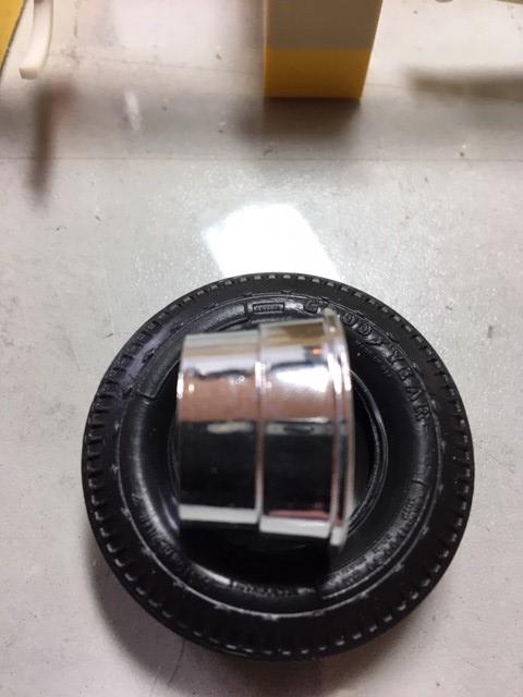

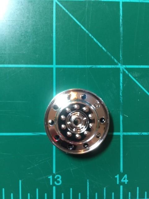

Goodwrench3 Posted April 24, 2020 Author Share Posted April 24, 2020 Well, thanks AMT. ? AMT decided to go "generous" on the chrome -- and some of the holes in the front wheels are filled with chrome. Suggestions on the best way to open these up without making a mess of it ? Quote Link to comment Share on other sites More sharing options...
blackbeard Posted April 24, 2020 Share Posted April 24, 2020 Pinvise drill bits Quote Link to comment Share on other sites More sharing options...
gotnitro? Posted April 25, 2020 Share Posted April 25, 2020 I'd simply take a worn hobby blade and spin in the hole to ream them out , going from the back Quote Link to comment Share on other sites More sharing options...
Goodwrench3 Posted April 25, 2020 Author Share Posted April 25, 2020 23 hours ago, blackbeard said: Pinvise drill bits Thanks -- I found mine and of course I don't have all the bits. LOL. The 0.0470" I have is close -- just a tad small. And a 1/16" is too big. The 0.0540" is probably just the ticket -- and is the one I'm missing from mine. I'll check my local shop Monday. Quote Link to comment Share on other sites More sharing options...

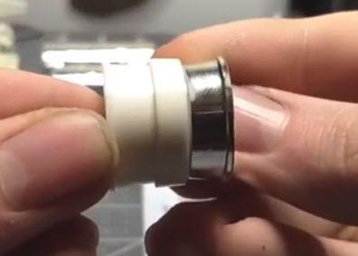

Goodwrench3 Posted April 26, 2020 Author Share Posted April 26, 2020 (edited) That area between the wheel and the hub should be black, I think. What's an easy way to paint that without making a mess? I don't have the steadiest hand. LOL. I was thinking of maybe flowing some wash in that grove -- maybe a couple of times ? Or possibly using a water-based acrylic paint so that if I slipped and got some on the rim, I could easily wipe it off with a Q-tip ? Any help welcome. And thanks in advance. Edited April 26, 2020 by Goodwrench3 add photo Quote Link to comment Share on other sites More sharing options...
tbill Posted April 26, 2020 Share Posted April 26, 2020 Water based acrylic is the ticket for that, cause as you say, a bit of water and a q tip and you’re back in business Quote Link to comment Share on other sites More sharing options...
Goodwrench3 Posted April 26, 2020 Author Share Posted April 26, 2020 Cool -- and, as I previously thought that ALL "acrylics" were water-based (shame on me) - I THINK the Model Master "Acryl" bottle paint is water-based ? Thanks Tom! Quote Link to comment Share on other sites More sharing options...
gotnitro? Posted April 27, 2020 Share Posted April 27, 2020 Yep that's water based Quote Link to comment Share on other sites More sharing options...
