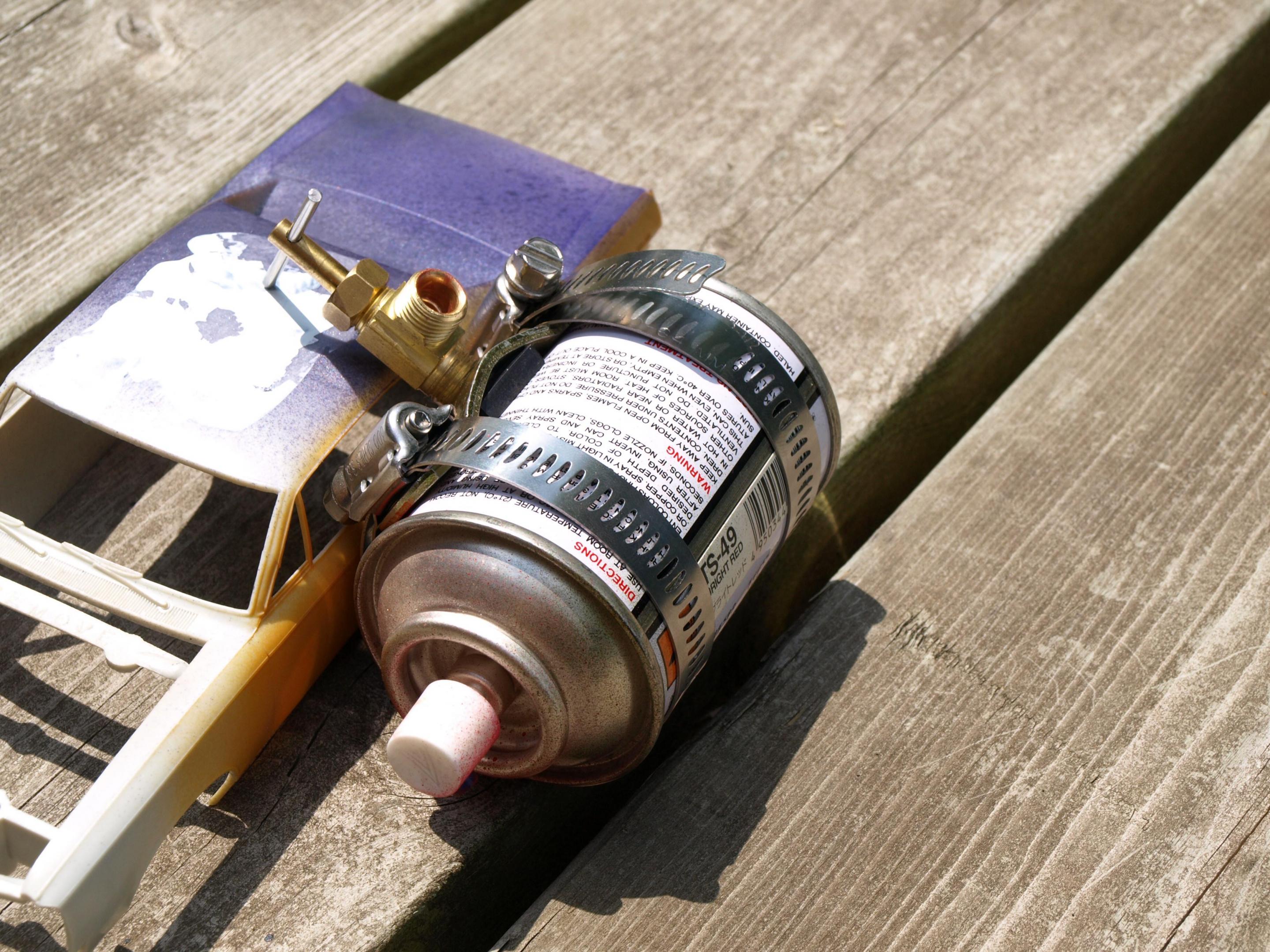

I'm going to do a video sometime with my method. It involves using a valve for tapping into a water line to hook to a refrigerator and short length of copper tubing and two hose clamps. It's been discussed on this forum, I think.

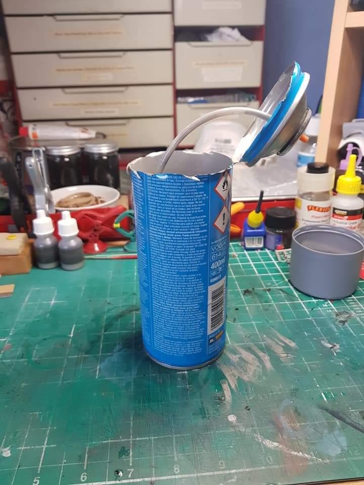

I've been doing this way for years without any problems, put a small pin hole at the top of the can, once the gas has escaped, cut the top off and left to de-gas for about 30 minutes, then pour the contents into a glass bottle.

Cheap and easy.  After flushing with thinner. Flush the nozzle with water
IMG_0731.JPG.f76aa462e16c08d91948d82a5b521f0f.JPGIMG_0734.JPG.2fe5a852979b5afaab379114ad527b28.JPGIMG_0736.JPG.7c17b8f05697a46b30a241a5e674606b.JPGIMG_0739.JPG.317ec52da73b9e3237db27eb36aa8650.JPGIMG_0738.JPG.b1165e457ff4dad7430fac1954346996.JPG
Share this post
Link to post
No explanation needed here. Being a hoarder sometimes pays off.
This is the method I use. Have never had an issue with removing the paint from the can. I don't bother with the tubing, but use the valve to slowly release the pressure, and pour the paint into a container after opening the can.

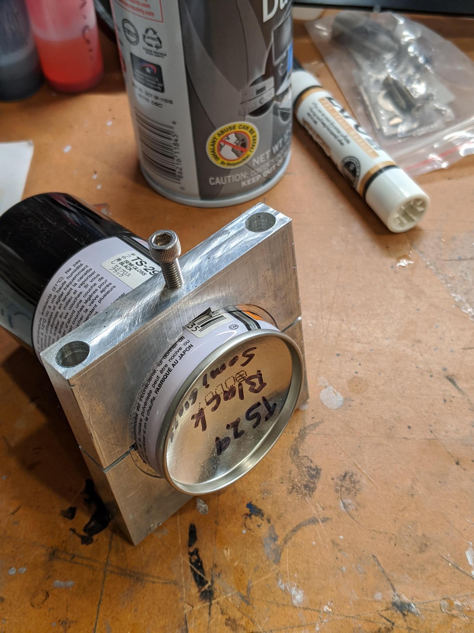

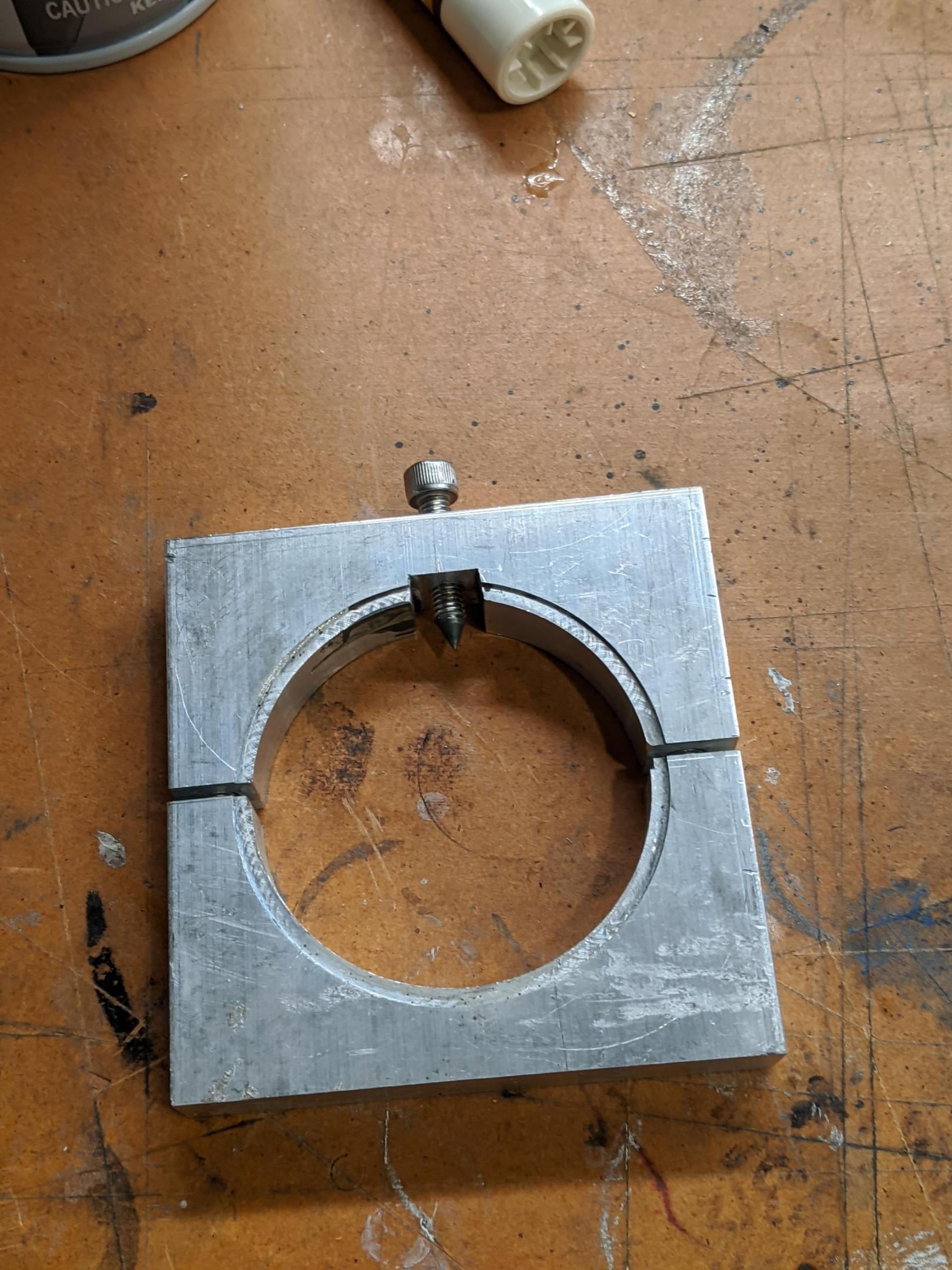

I've used a similar process.  I machined this piece some time ago and it is less hassle than all the clamps and valve.  I can also make the hole large enough to get a pipet of thinner in and flush out all the paint.  I generally punch two holes.  One as close to the bottom as possible to get all the paint out and one near the top to vent it and let the paint flow out smoothly.  I can also cover the top hole with my finger and control the flow.
