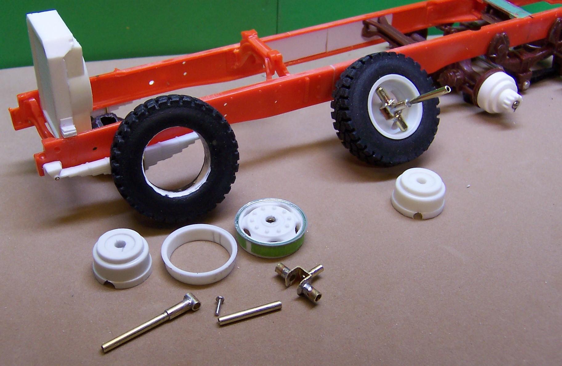

redneckrigger Posted December 23, 2020 On 12/22/2020 at 12:02 AM, Chariots of Fire said: Here's an example of brass steering knuckles. The long end fits into a tube that is within the axle. Makes the whole thing quite strong. Gonna have to give that a serious look! Though I dont solder anything other than copper tubing I may give it a go machining out of aluminum. Quote Share this post Link to post Share on other sites

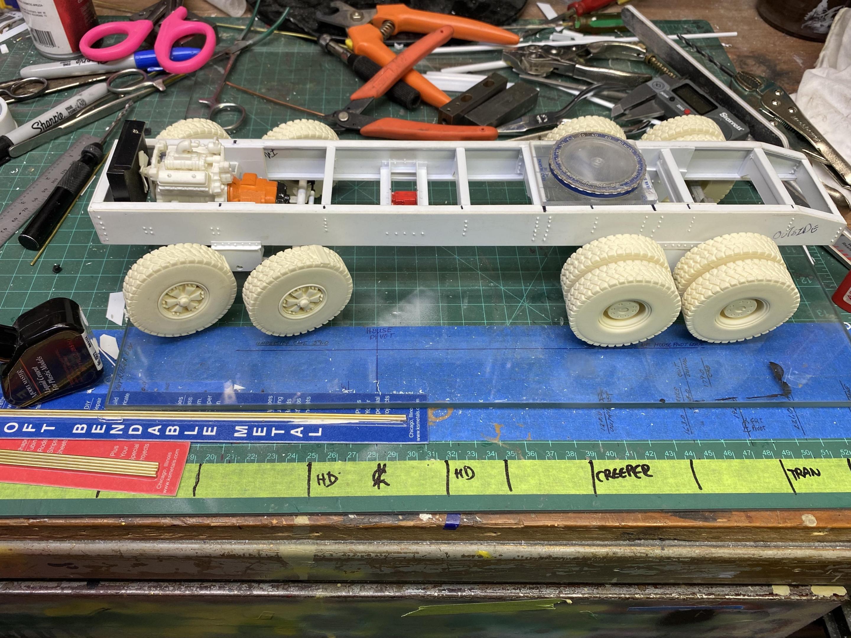

redneckrigger Posted December 28, 2020 Gotta work on the linkages, so built a sort of rotisserie stand for the frame to hold it as I figure out the complicated linkage. The intent is to have it work, though it is so complex that may just be a dream. Quote Share this post Link to post Share on other sites
Straightliner59 Posted December 28, 2020 This is a very cool project. Enjoying watching it come together! Quote Share this post Link to post Share on other sites

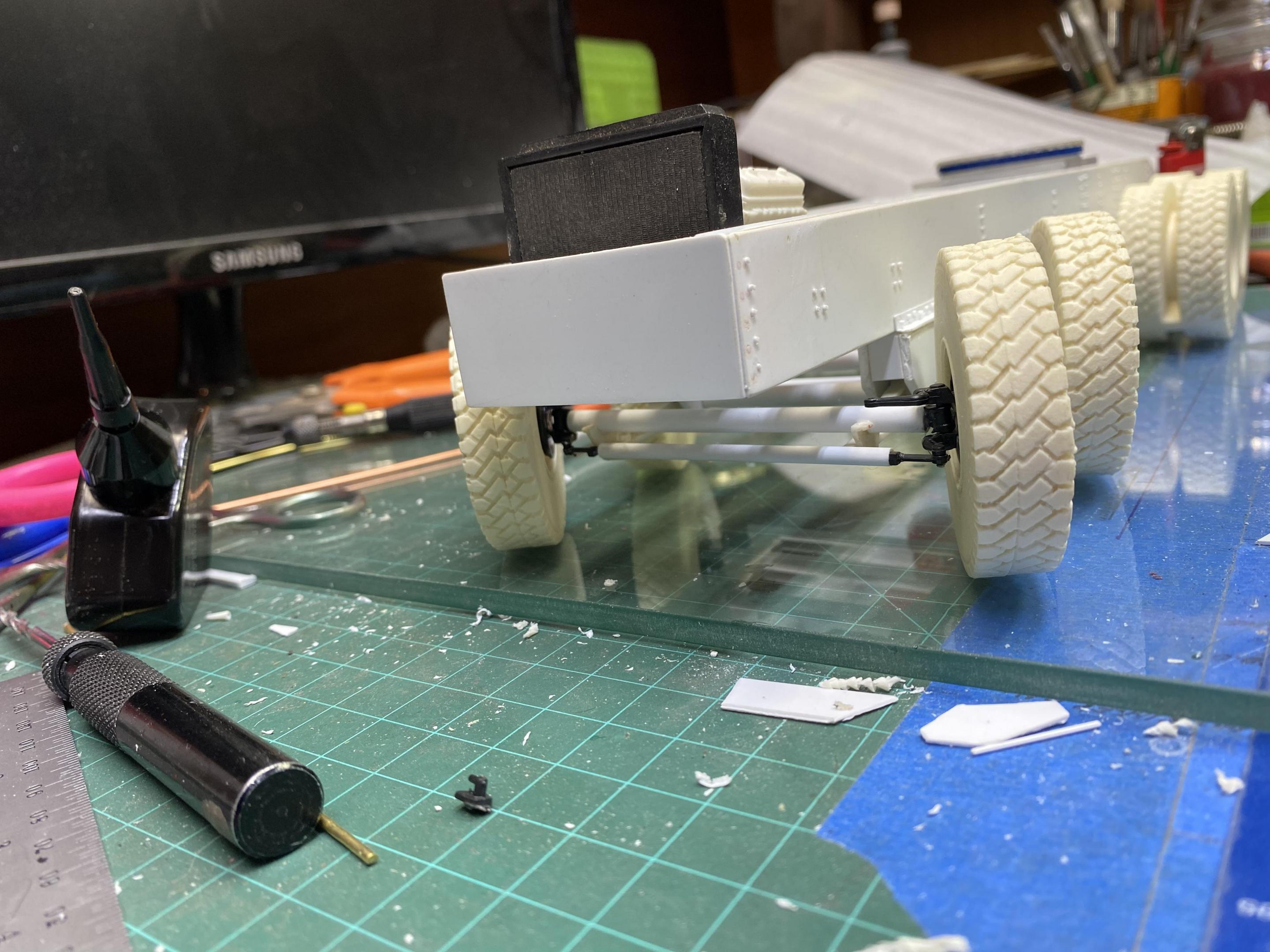

redneckrigger Posted January 2 Mockup of the steering linkages. Still need to make the two hydraulic cylinders. Happy New Year to everyone! Quote Share this post Link to post Share on other sites

redneckrigger Posted January 2 (edited) Steering linkage done with the cylinders. First time I’ve ever made a twin steer let alone one that works. Kinda fiddly snd so forth but makes me happy! IMG_5413.MOV IMG_5415.MOV Edited January 2 by redneckrigger Quote Share this post Link to post Share on other sites

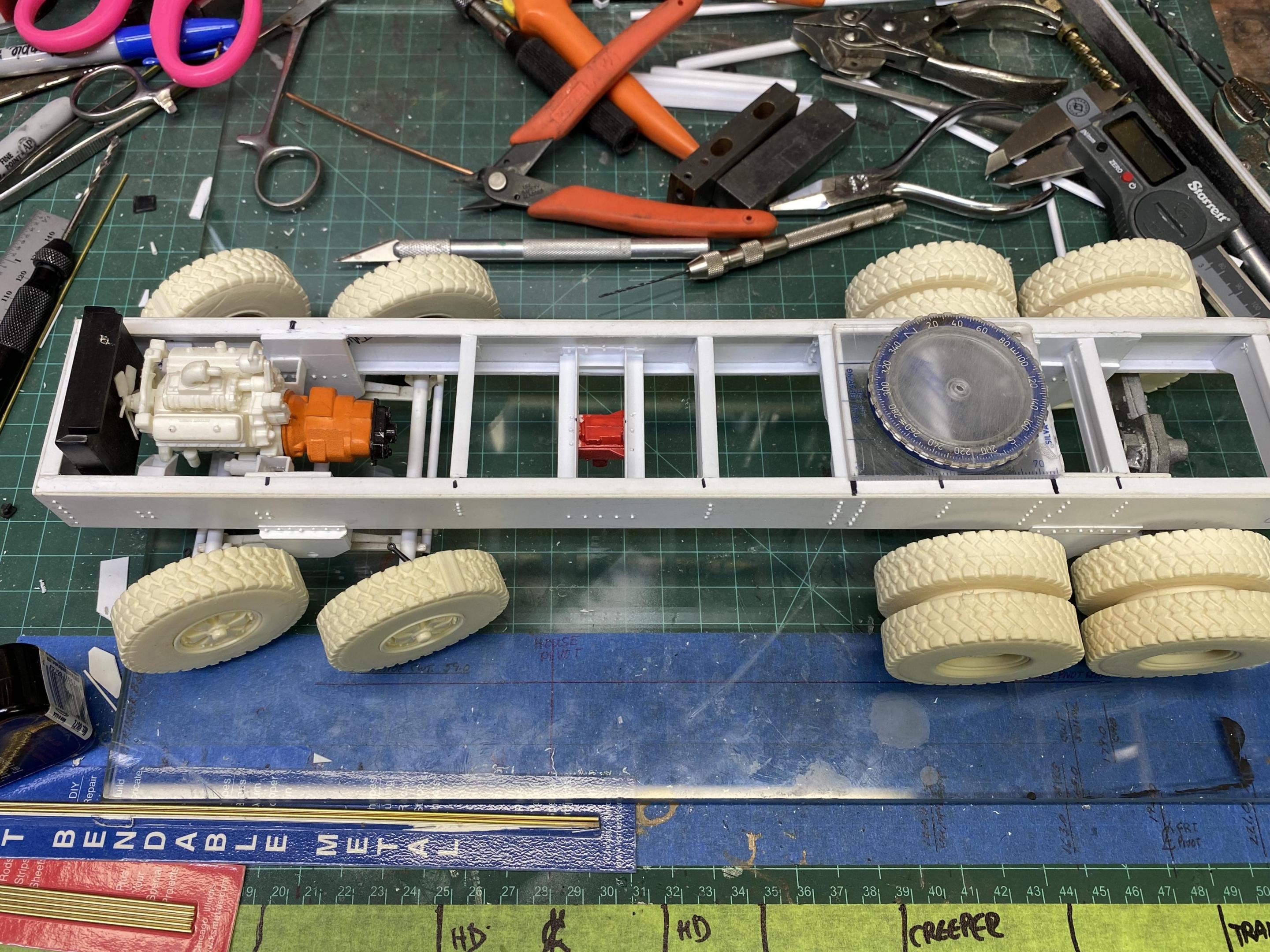

redneckrigger Posted January 3 Front suspension and steering all done. Radius rods added, suspension travel bumper stops added, steering cylinders and steering box in place, front of frame trimmed as per actual prototype. On to the rear....... Quote Share this post Link to post Share on other sites

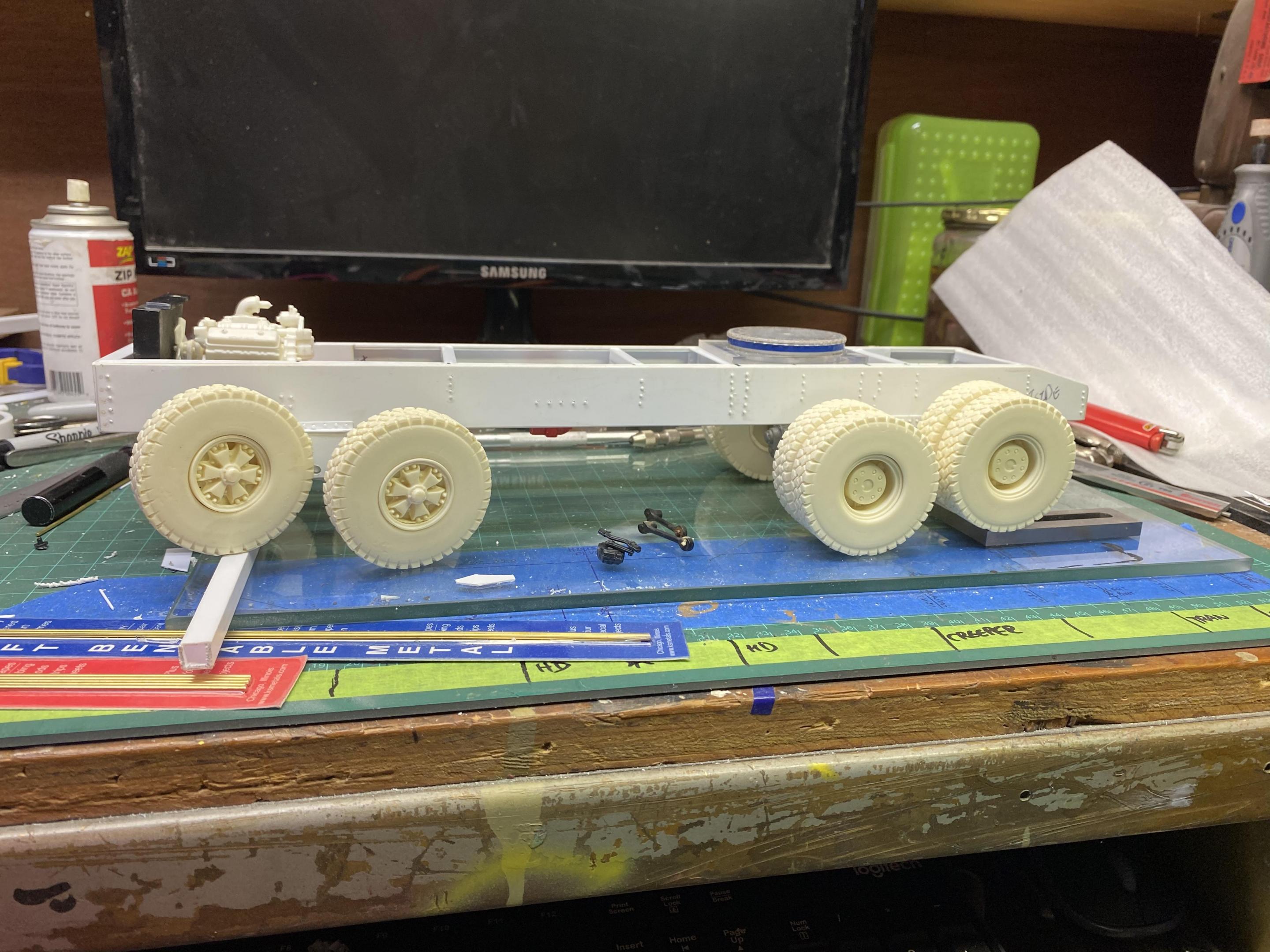

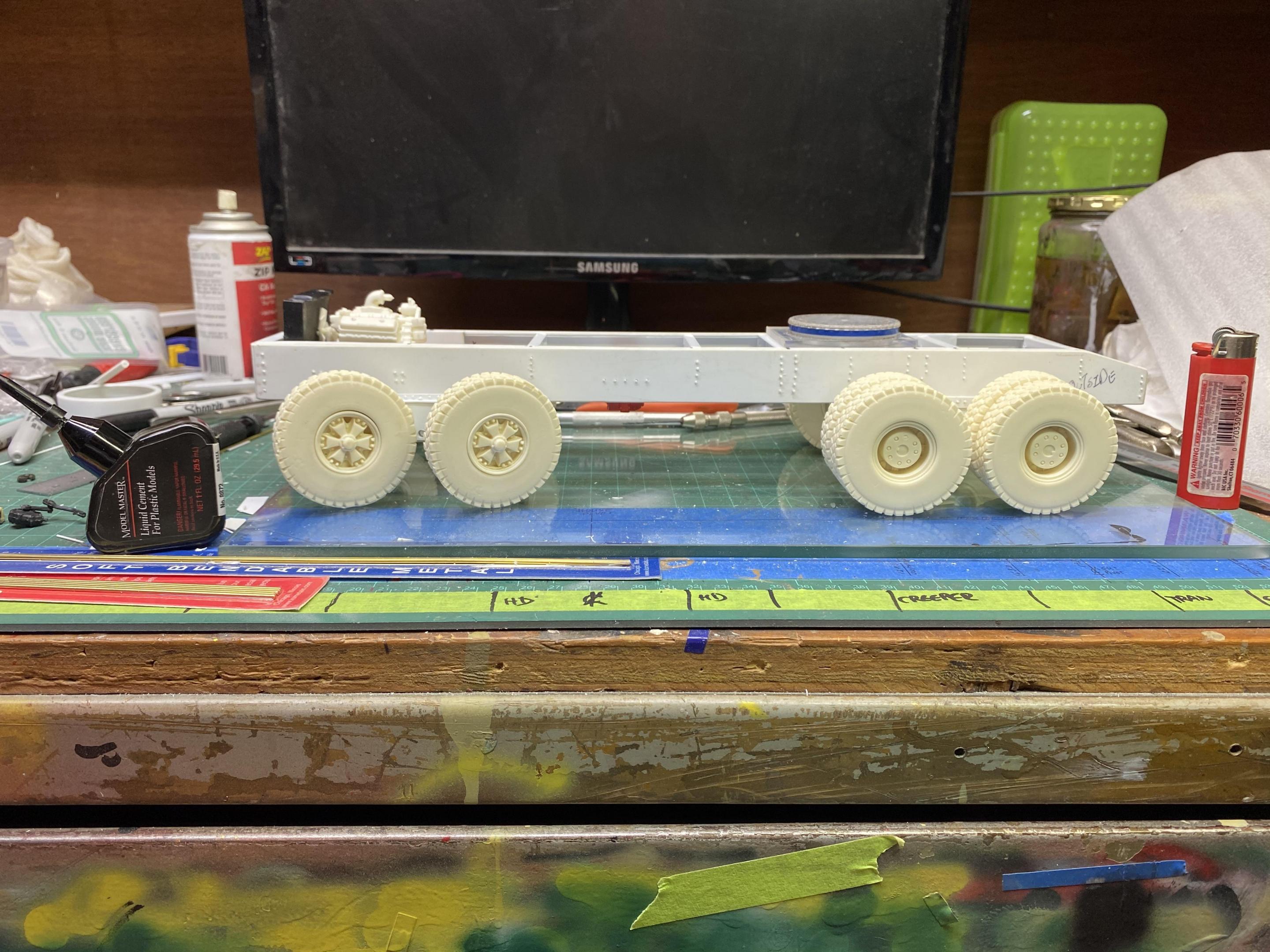

redneckrigger Posted January 3 (edited) Rear suspension done with radius arms installed and driveshaft from the creeper transmission in place. Suspension pivots just like front. Brake cans still need to be installed when piping is being done. On to the cab......... Edited January 3 by redneckrigger Quote Share this post Link to post Share on other sites
