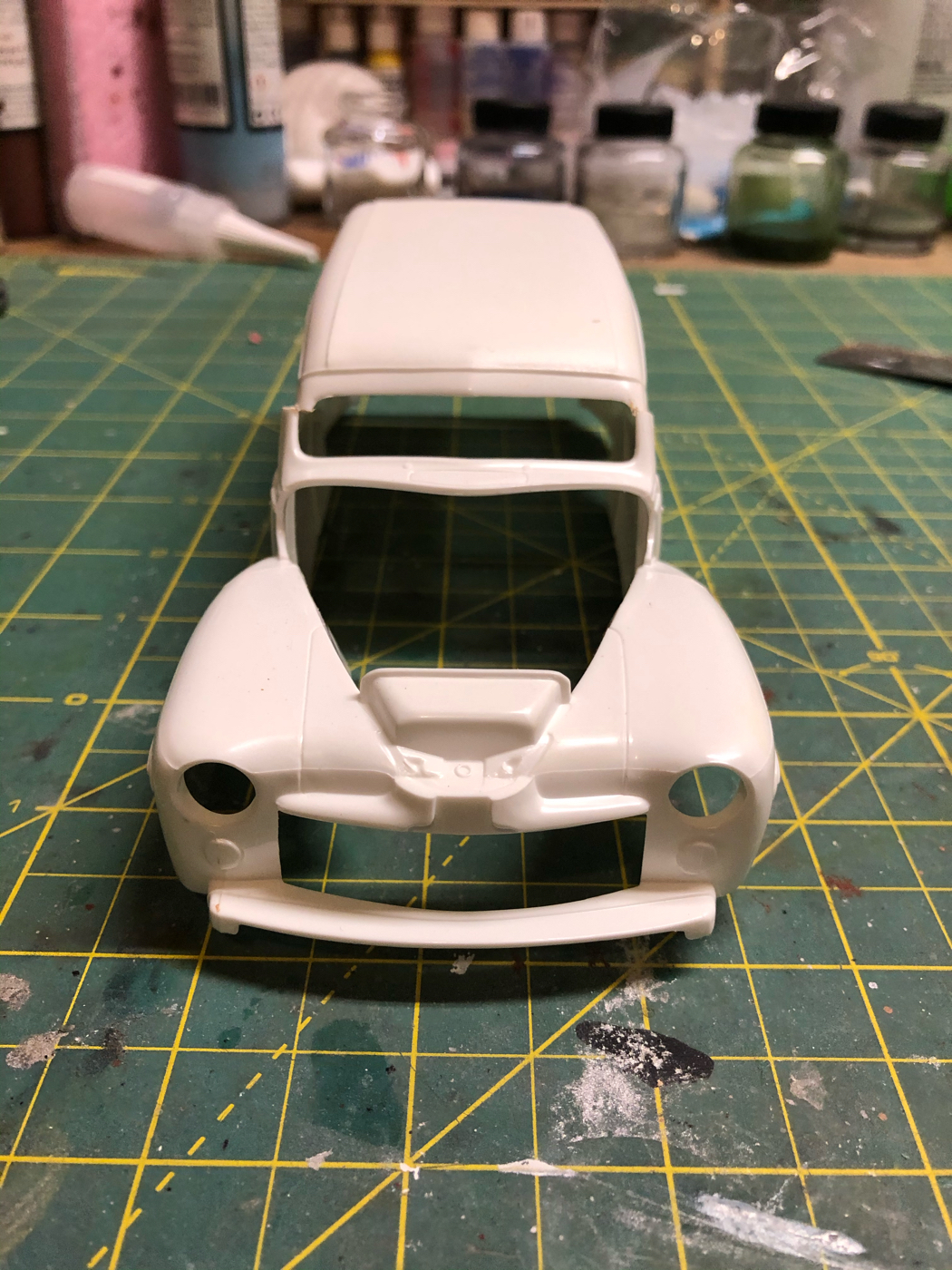

Conversion to a two door, chop top custom begins!
1586228527011
1586228535840
...removing the "C" pillars....
1586228544300158622857727815862285841531586228643433
Edited by Intmd8r
Share this post
Link to post
Now the back hatch is starting to take shape.
15862286270051586228643433
What are your thoughts about he filler panels? in the mock up?
15862288990551586228634568
Lastly, if anyone has suggestions about tackling the "A" pillars, I'm open for suggestions.
1586228680026
Was hoping to keep the vinyl top, but looks like I will need to cut and extend the roof to reconnect the "A" pillars.  If I go that route, I'll just sand off the texture and paint it body color.
Thanks for looking

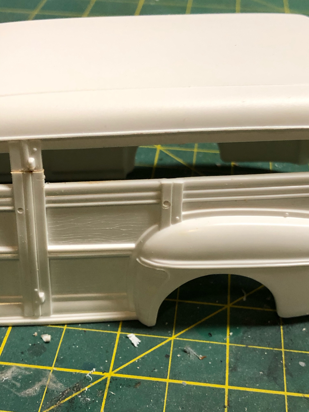

I really like what you're doing on this build. STITCHUP's suggestion on moving the roof forward should save you lengthening the roof section. I would offer just two suggestions. Since you're making it a two door. Move the B Pillar toward the rear of the body to represent the back edge of the door. This would make the proportions look better. This would take some extra slicing and dicing with the wood trim, but I think it would look more like a two door than a four door with the rear door nailed shut. The filler panels from the custom coupe is something I never thought of and depending on the style you're going for that may actually give the body a sleeker appearance. You might want to see how you want to mate that panel with the wood trim. You might remove the upright wood trim on everything except the door and create wood trim of a size like the area over the rear fender, and run that along as the break between the wood and the filler panel. Again that filler panel idea really does give this a Kustom look.

Another thing i just remembered about the side coves, when i did mine i tried to fill the gaps afterwards but in reflection I would have been better adding the plastic before i stuck them on. It was a pain trying to get them right and would have saved a lot of cussing if I had done it first. It still works the way i did it, it would just have worked better doing it first

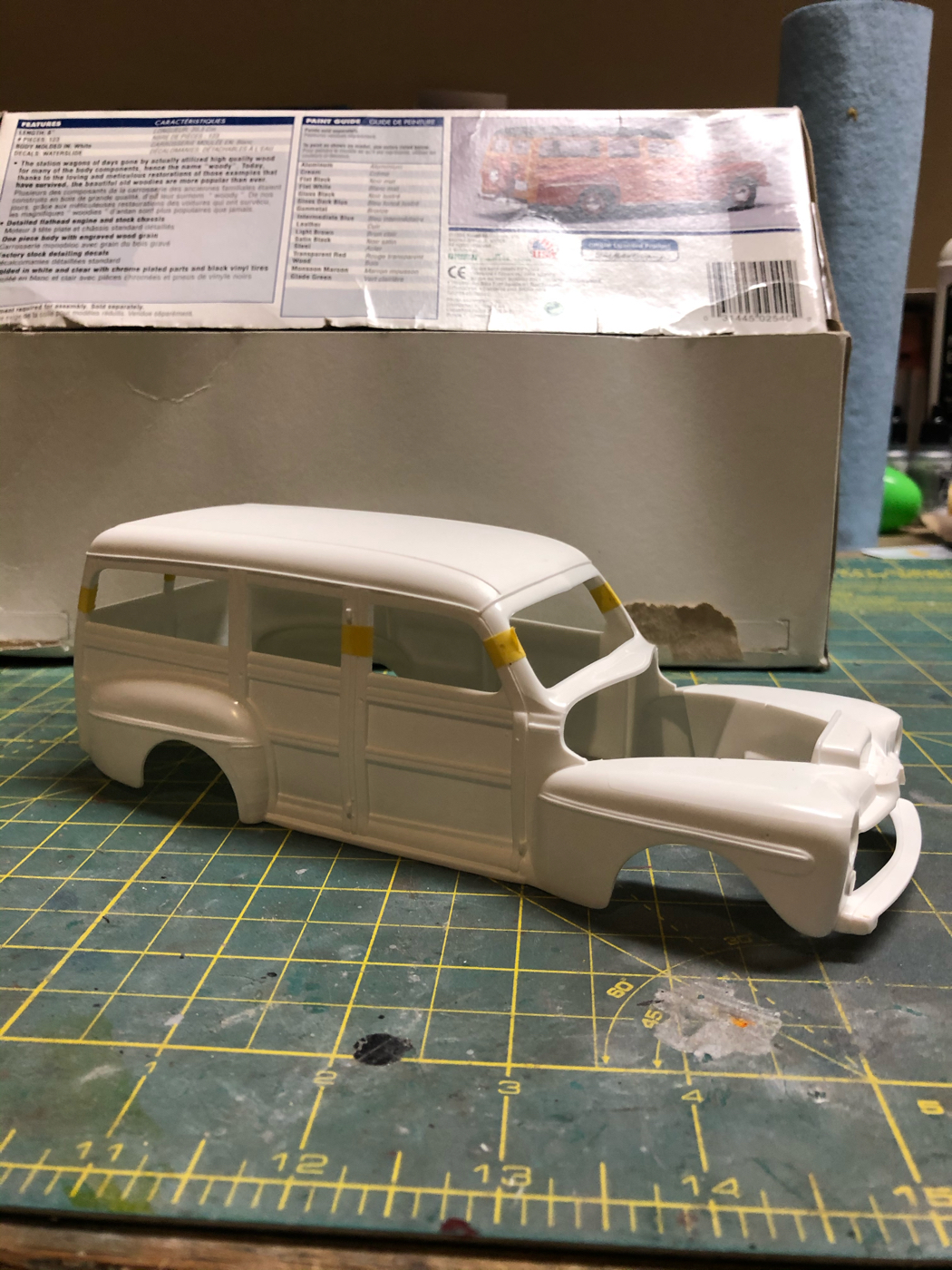

Small update: decided to not use the custom coupe filler panels on this build.  They do however provide a decent template for lengthening the doors to a proper factory 2 door dimensions. So I started cutting...
158643476150215864347784151586434770722
While the filler putty was drying, decided to massage the fenders, cowl, and hood to remove the chrome trim and alter the front fenders slightly.15864348159931586434823700
Lastly, a quick mock up as to where the build is going compared to the stock proportions ...
1586434831770

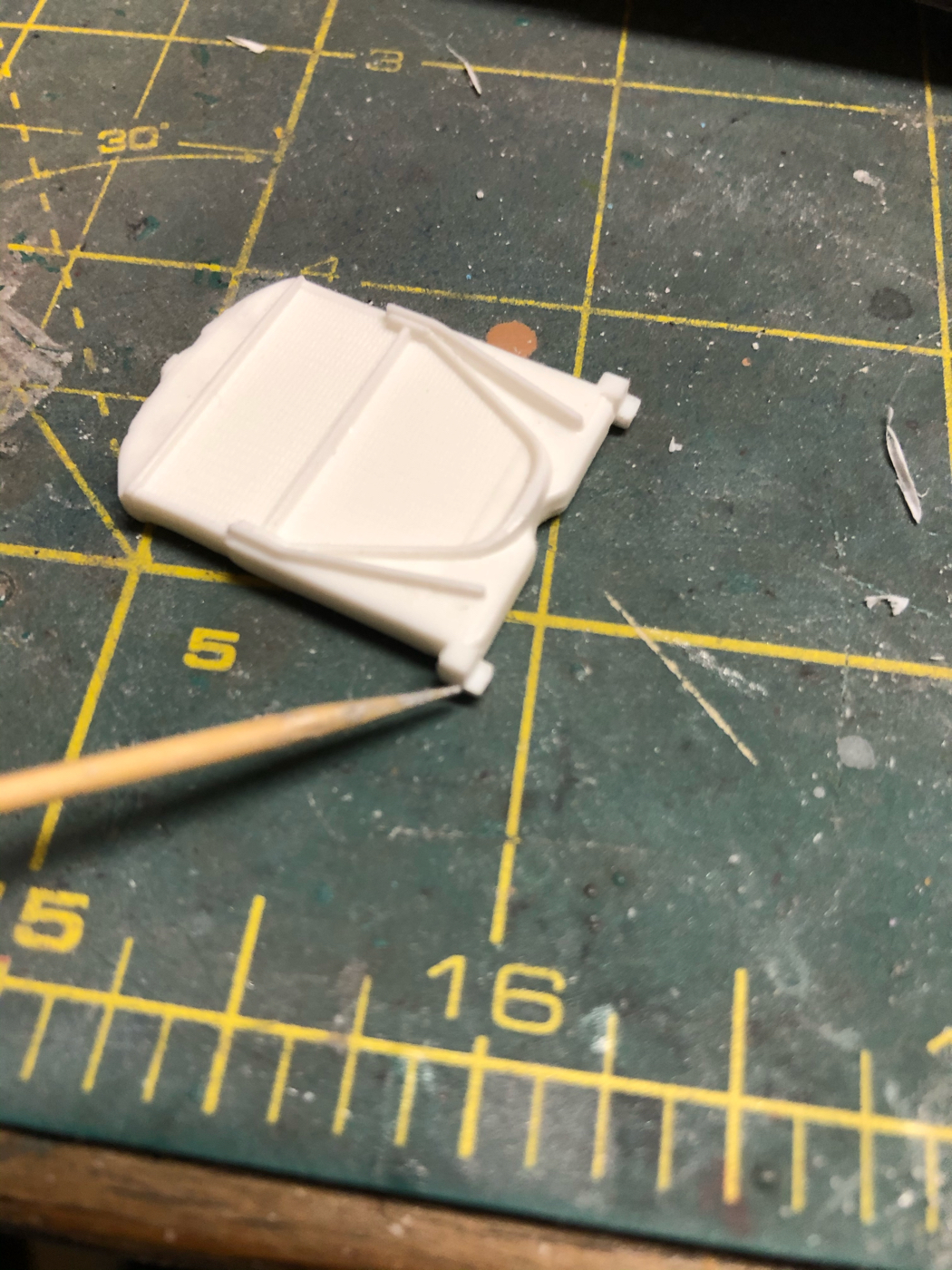

got the passenger side door modified:
1586489575944
Now to work on the driver's side, then work on attaching the roof.

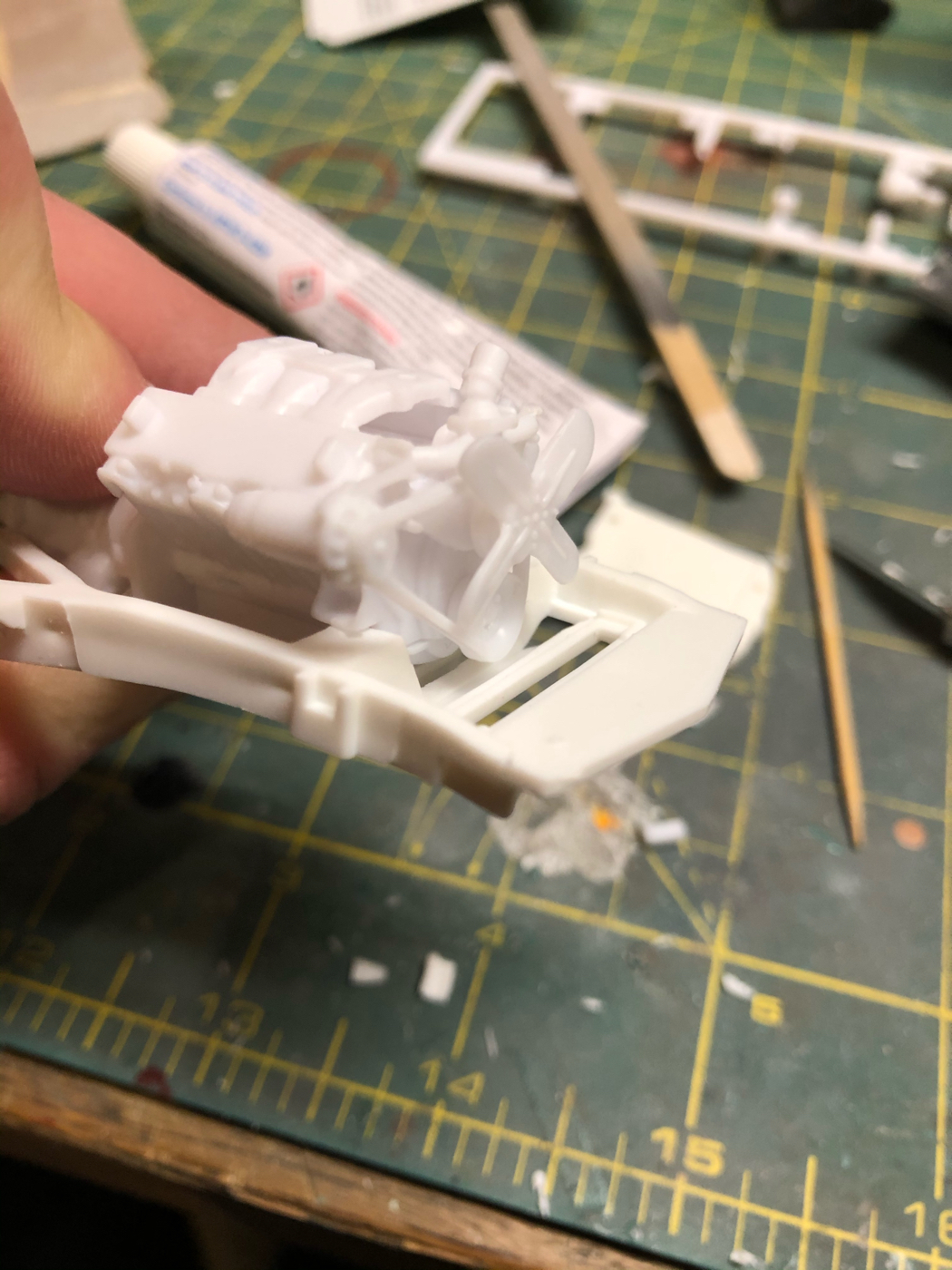

Instead of watching glue and filler dry, I turned my attention to the chassis for my engine swap.
Wanted a period correct, vintage engine swap, so I'm going to trade the stock flathead from the '48 Woody kit with "Y" block V8 from the '49 Mercury wagon kit.  The transmission from that kit creates an interesting challenge in the '48 Ford chassis.
1586634196472
A comparison between the two frames:
1586634215782
Time to notch the frame - otherwise the engine sits too far forward:
1586782762975
15867827424231586782754478
Share this post
Link to post
The front of the ending needs a little massaging.
the  front cross member also needs to be notched and the rad moved forward slightly to clear the engine fan.
15867829511751586782920488
To change the mounting points of the rad, did more notching....
15867829047071586782912489
Looks like I have some more notching to do......
15867829589771586782967074

I just noticed your mention of putting a Ford Y engine from the Merc. Wagon kit. I'm thinking that engine is a Cadillac engine. This may explain way you have to do so much chassis surgery.  You  have already all but got this mounted so I wouldn't change now, but the best Y block right now can be found in the new Revell '57 Ford kits.

Did you try swapping in the Merc chassis?
FYI, the engine is a Caddy, not a Yblock. Still period correct though.

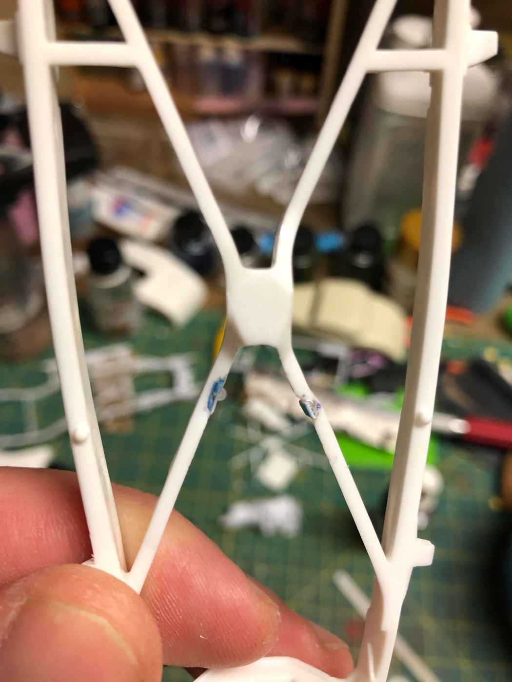

Decided not to half arse the engine mounting - going to rework the x bracing of the frame so that the Caddy engine looks like an OEM fit.
Share this post
Link to post
Modified the "X" bracing today to fit the Caddy engine.
Still have some filling and sanding to do, but things are looking better.
158715670523715871567124221587156719812158722273983315872227484981587222757575
Share this post
Link to post
More Chassis work.
For those keeping score, the Caddy swap is becoming more trouble than its worth, but I'm going to see it through.
Some minor trimming of the floor pans and gentle reshaping of the trans tunnel, now everything fits all snug.
