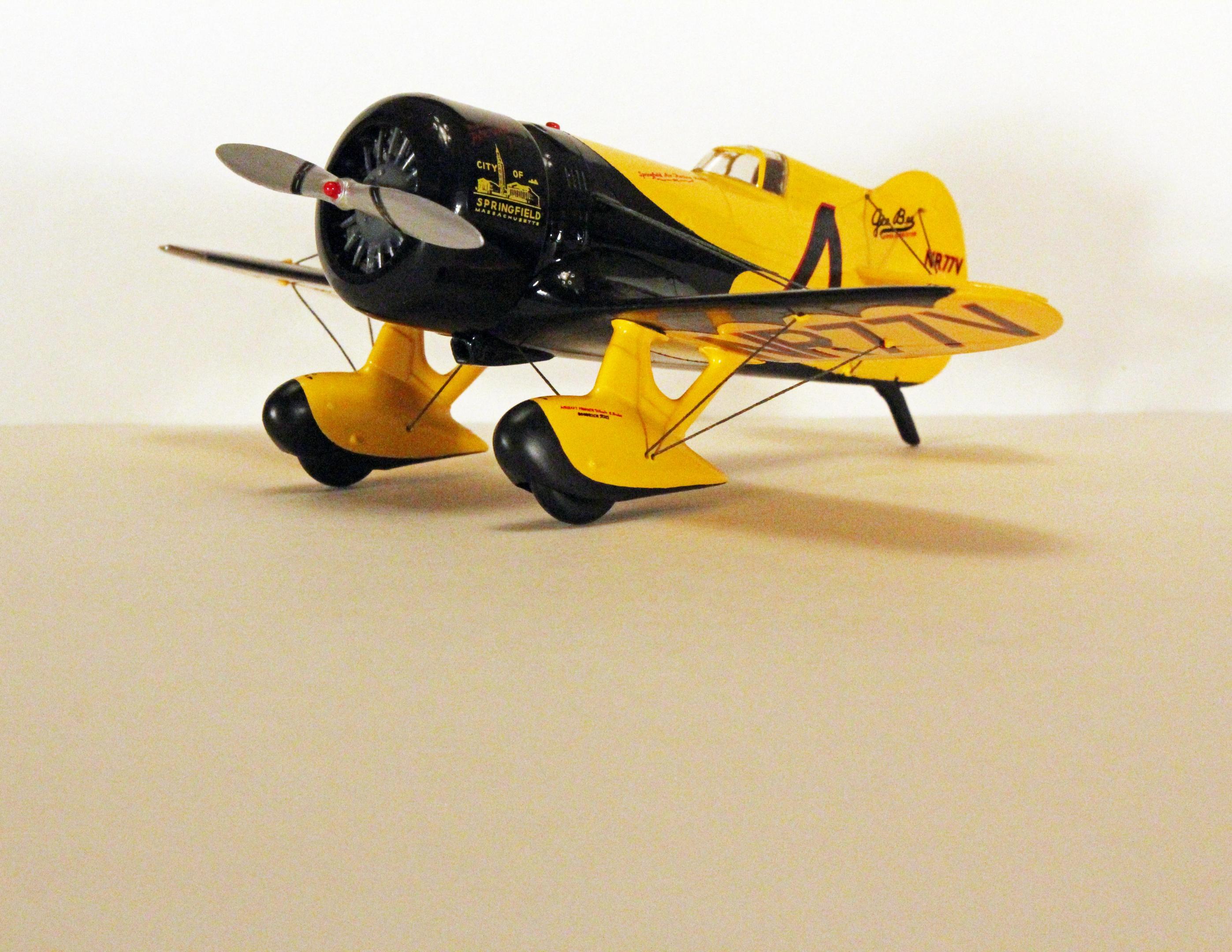

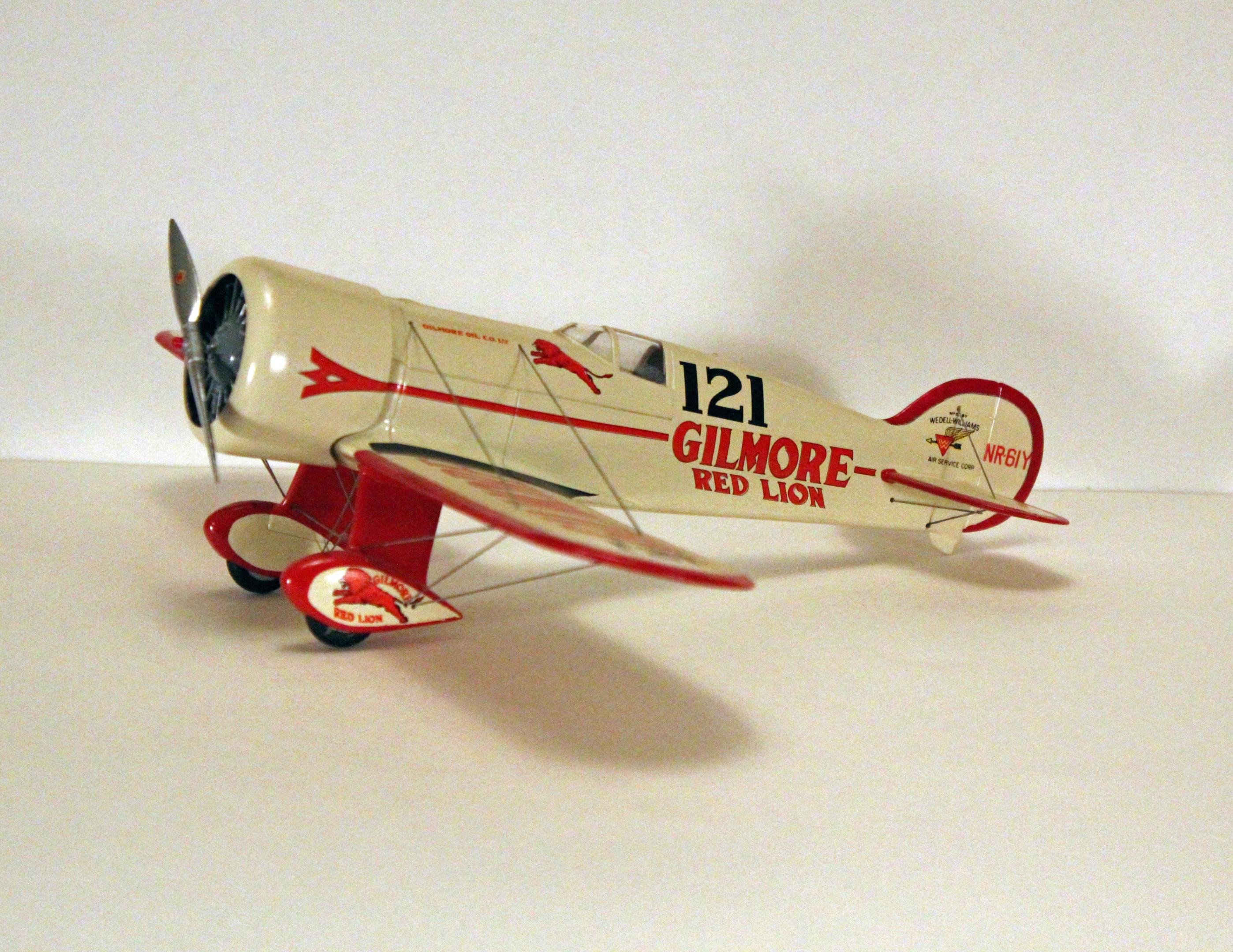

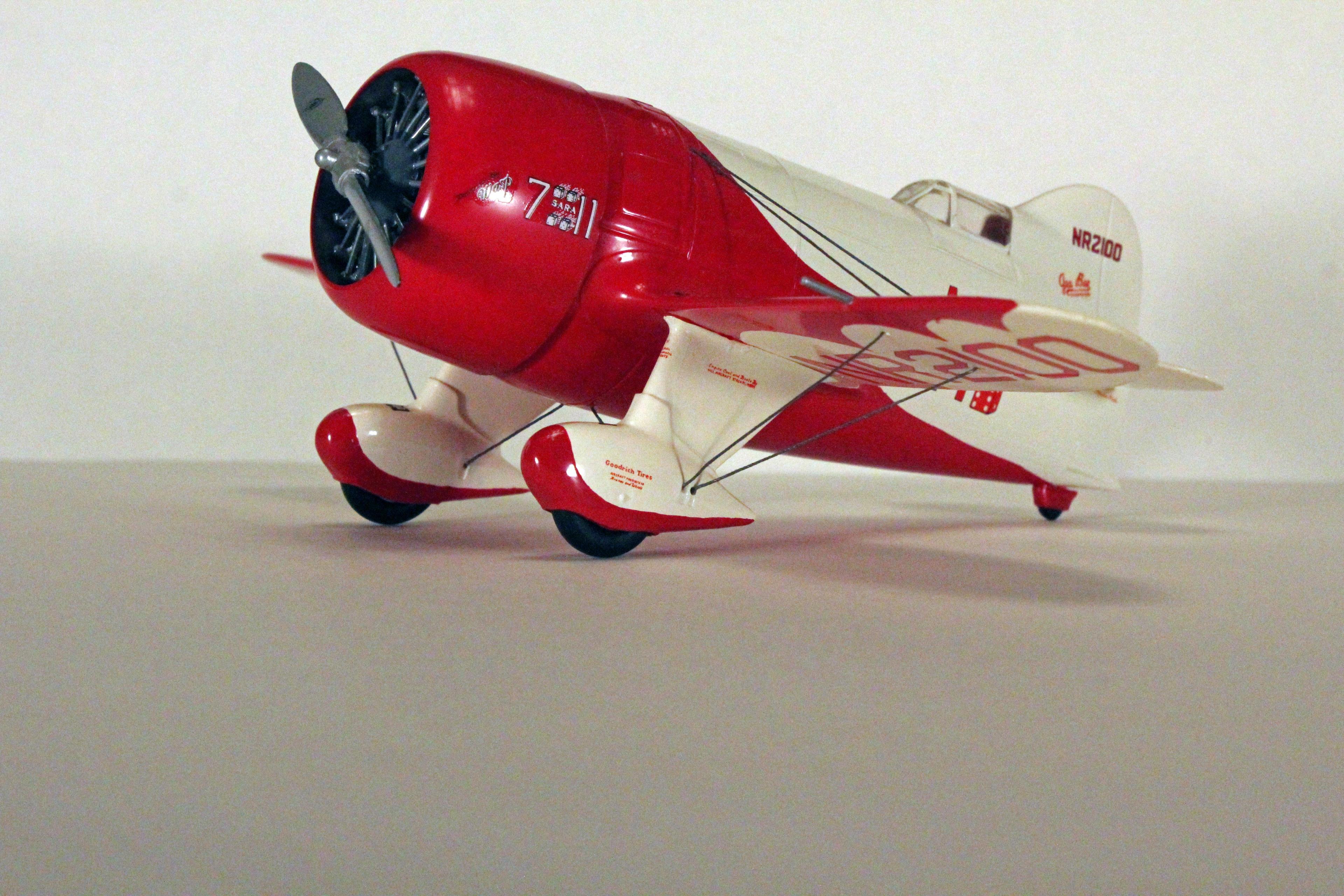

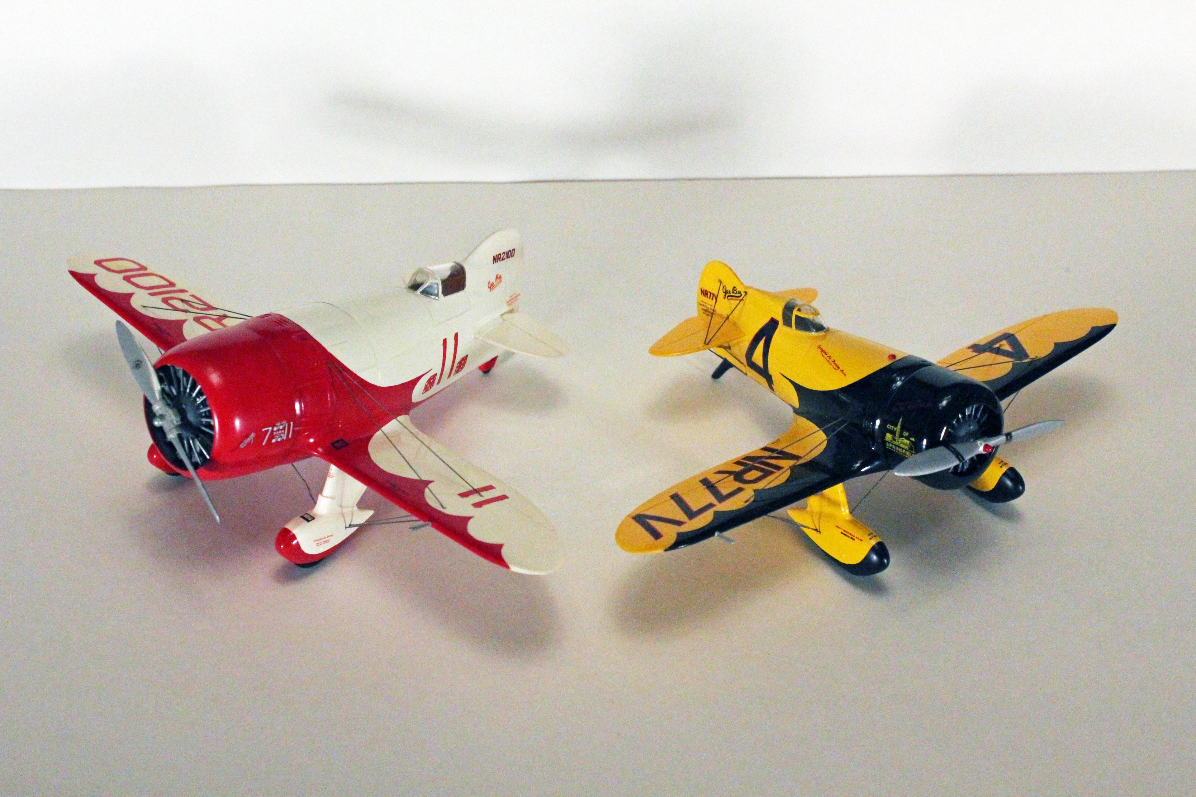

How'd you do the flying and landing wires on the Gee Bees and Gilmore Special?

22 hours ago, Ace-Garageguy said:
Nice collection. Much inspiration.
They look really good.
The “wires” on these are steel colored carpet thread.
I drill all of the holes prior to assembly.
The wires are coiled up and taped to the inside of the wing halves before assembling the wings.
Leave approximately 1/4” sticking out to grab onto later. A large knot in the inboard end keeps the line from pulling out completely when tightened.
I leave the engine/cowling and wheels off until final assembly. This allows me to pull the rigging out from the wings and thread them into the corresponding holes in the fuselage and wheel pants after paint and decals are applied.
Pull the lines taught with tweezers through the open end of the fuselage and wheel pants. Secure the lines with CA and trim the ends when dry.
The tail brace wires are taped inside one side of the fuselage with ends protruding from both sides. After painting, pull these up through the horizontal stab, thread them through the opposite sides of the horizontal stab. The ends of the lines will cross as they pass through the top of the vertical stab. Pull them tight from each side and secure with a drop of CA.
It takes some pre-planning but I find it to be worth it as there is little risk of damage to the finished model.
On biplanes you can do a similar technique by starting at the outboard “N” struts and working towards the fuselage.

9 hours ago, Flynlo said:
The “wires” on these are steel colored carpet thread...
...On biplanes you can do a similar technique by starting at the outboard “N” struts and working towards the fuselage.
THANK YOU SIR !!!
I just bought the Lindberg Coca-Cola Gee Bee racer, because it was cheap and I want to play with it a little. (It looks like a good project for me to learn basic airbrushing, for one thing.) It comes with a loose coil of wire for the rigging, so of course I am already seeing some problems with making it taught when I assemble the model. Unfortunately, that model is made so I don't have access to the inside of the fuselage once I've glued it together, creating another challenge for tightening those wires. Do you have any suggestions on how I might be able to work this out?
I want to paint this model like the City of Springfield Model Z (as it appeared in "The Rocketeer"), even though what I have is an R2. That means I'm also trying to figure out how to do that big number 4.
Share this post
Link to post
I would just coil the brace wires inside the fuselage passing them through the wing from above and below cutting them off after the glue sets. This would be similar to what is described for the tail brace wires above
Share this post
Link to post
Thanks.
