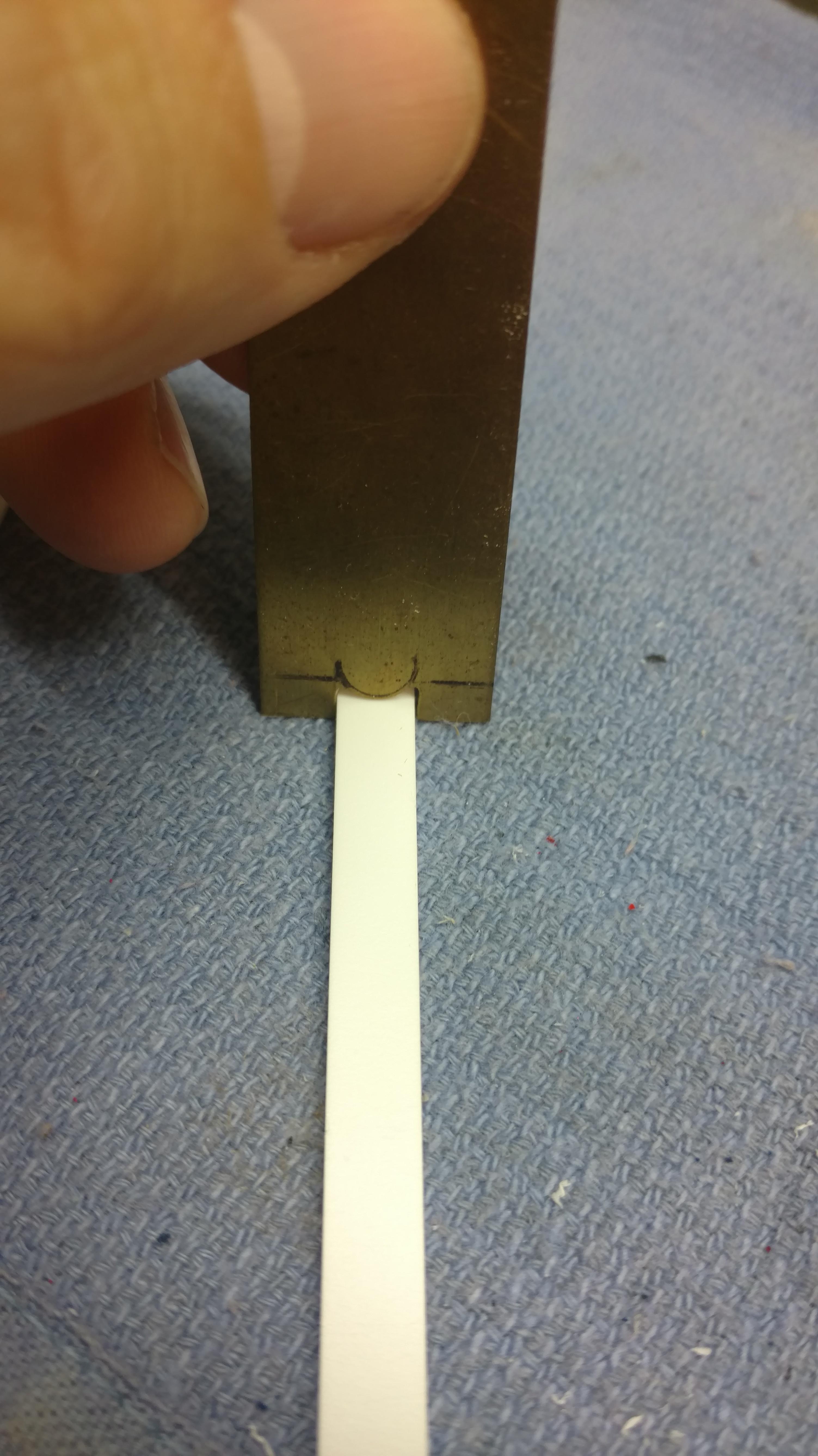

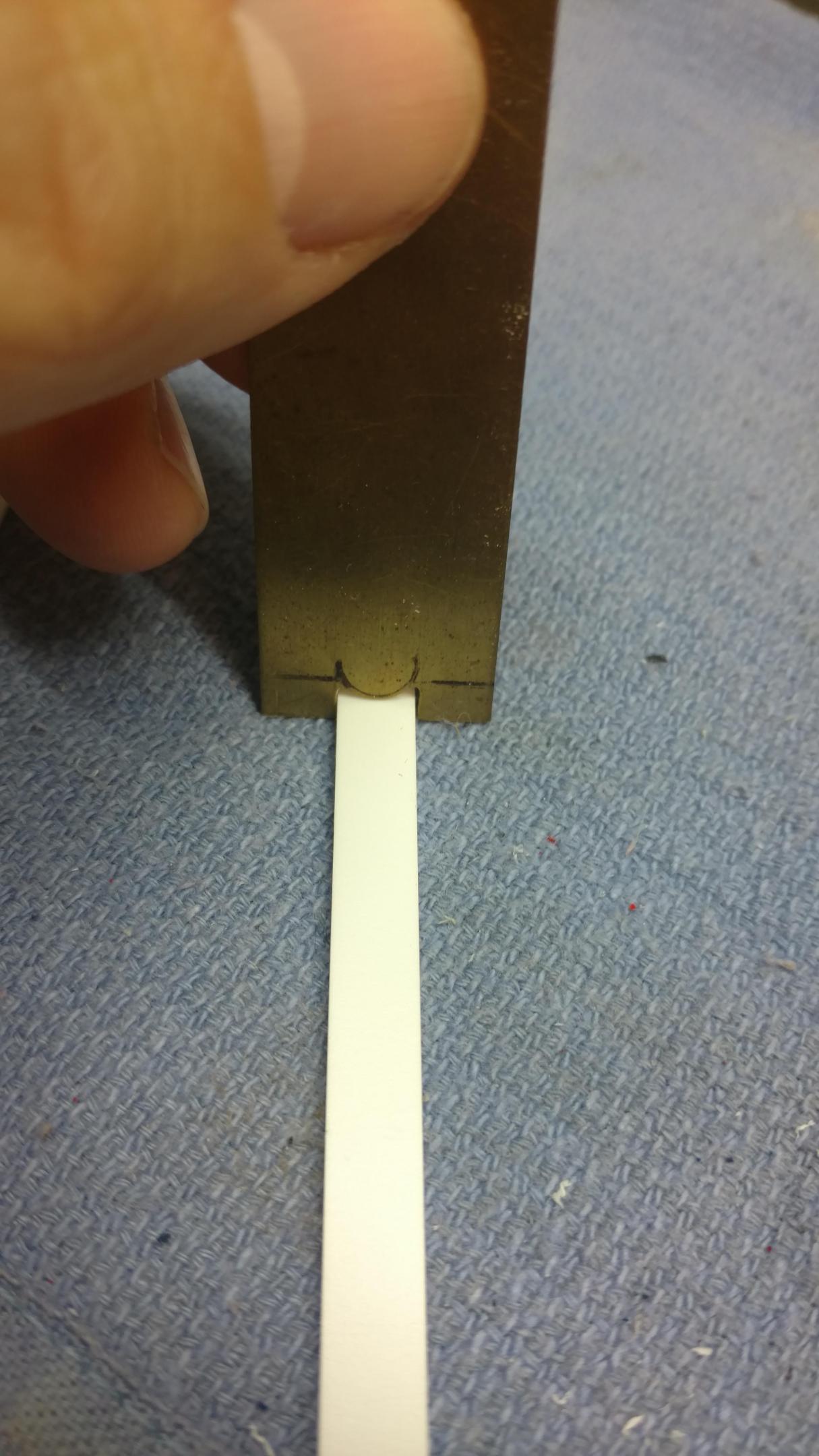

I used a piece of brass flat stock a bit wider than the styrene I wanted to shape. Cut the profile into the brass, as wide as the styrene stock I used which acts as a guide to keep the profile consistent.
It worked well for me, it is a profiled scraper.

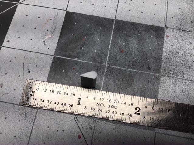

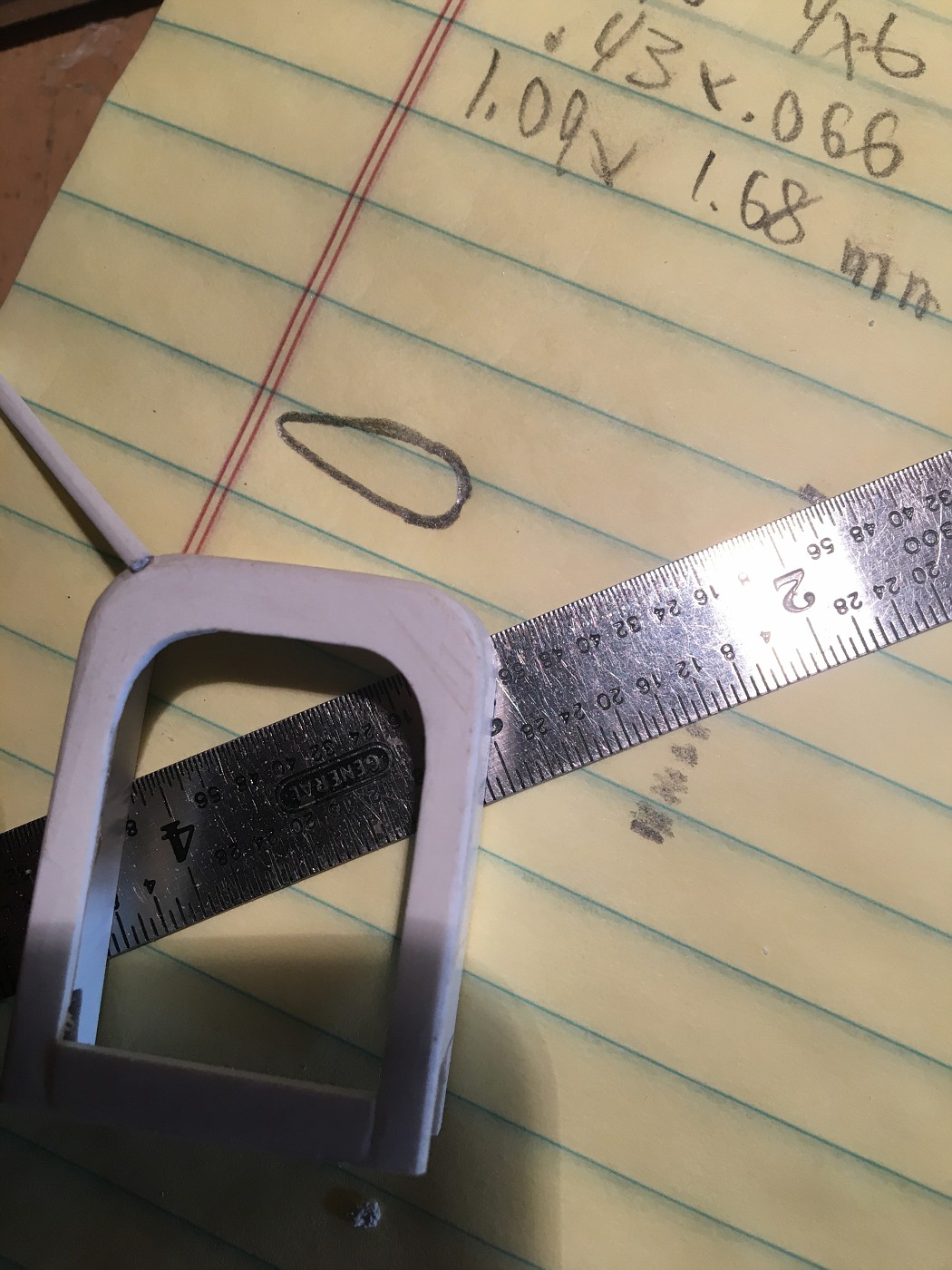

Here is a pic to show what I am looking for. On the left is a drawing of the shape in need. Below that is the radiator shell that is going to get a grill made from 14 "aero shaped" bars. If you look close, you can see a sample rod I shaved down. It is 1/16" high. I want to be able to see through the grill to the PE radiation mesh.
The issue with shaving square rod down as I did is that it distorts the rod and consistency is difficult. So if some place make the rod I need (from any material), I'll get it. Otherwise, my next option is figuring a way to consistently shave the rod by hand.
Thanks for the scraper idea, Karl.

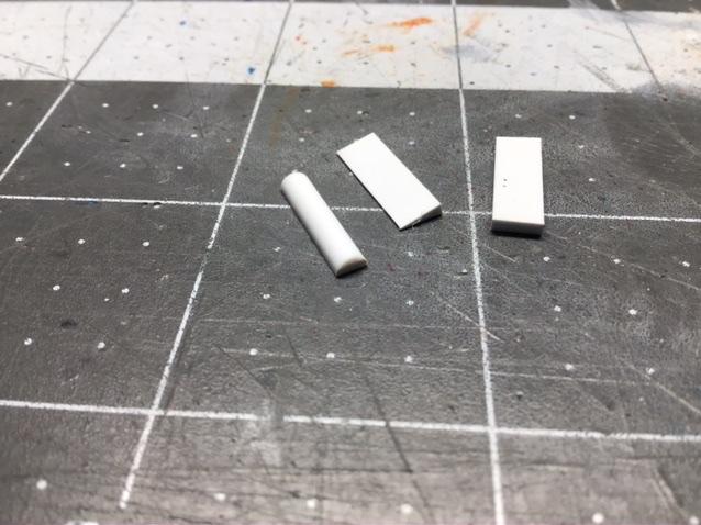

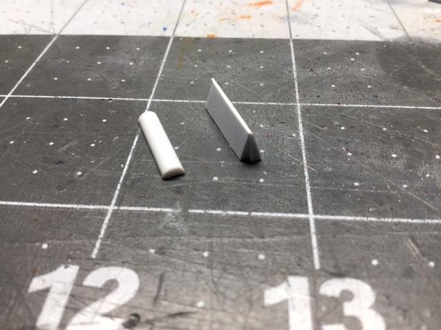

I just tried a little sample. I think this is bigger than you require but the technique might work. I made this from two pieces of 1/16”x 3/16” filed to a wedge (this could be 1 piece but I didn’t have the right thickness) and a piece of 1/8” half round.
Edited by NOBLNG

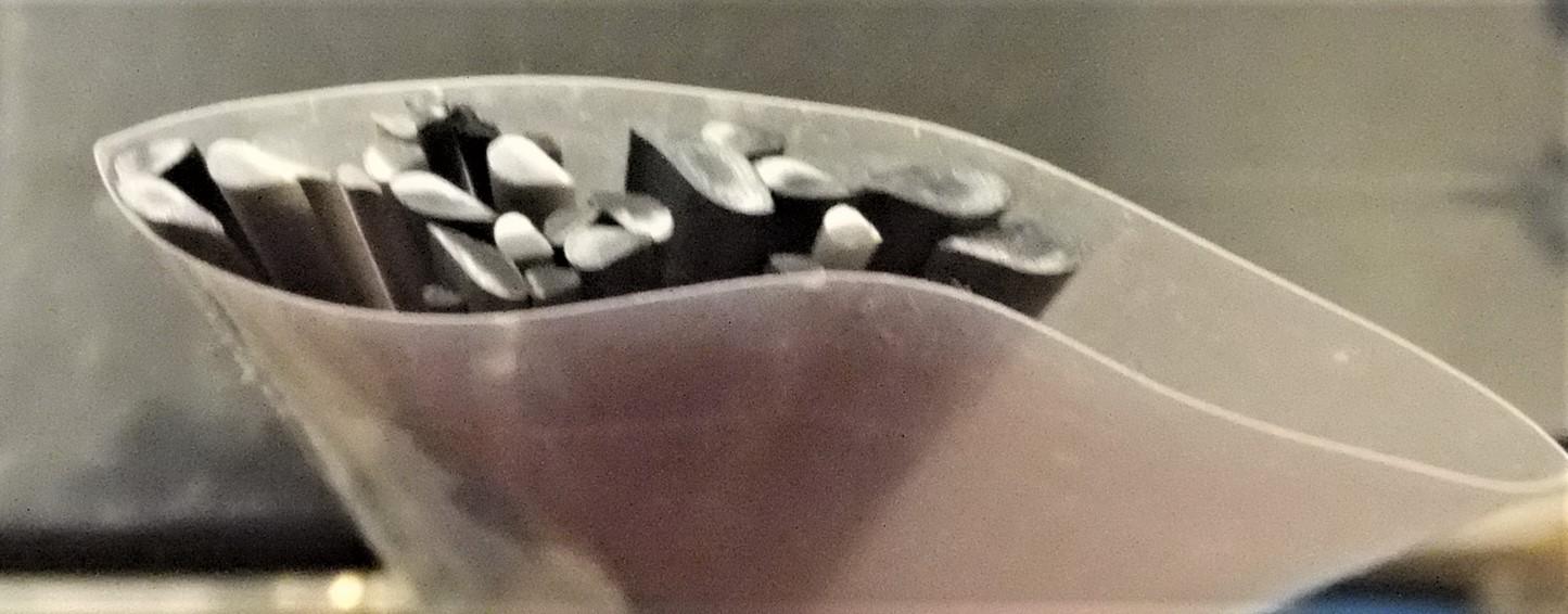

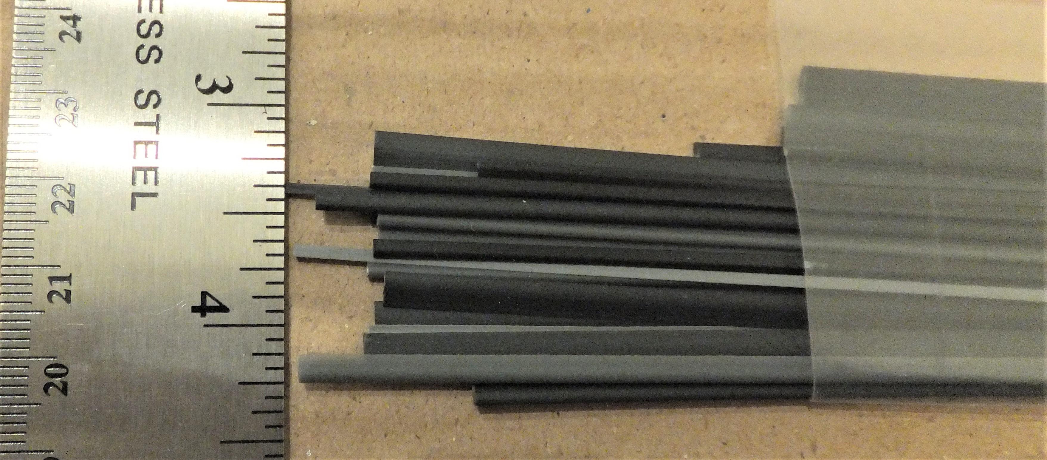

I bought the type of styrene aerofoil section you are talking of over 20 years ago from a company called Contrail.  it was for model aeroplane builders in a light to medium grey.  Maybe an ebay search might find some.  It was quite small - I used it for aerofoil struts on a 1/25th Fiat Topolino.
Come to think of it, what about the rear wing struts from a Revell Top Fuel dragster?  Surely someone on here has some manky old frames that they could cut some struts off of?  That might be your least painful solution.

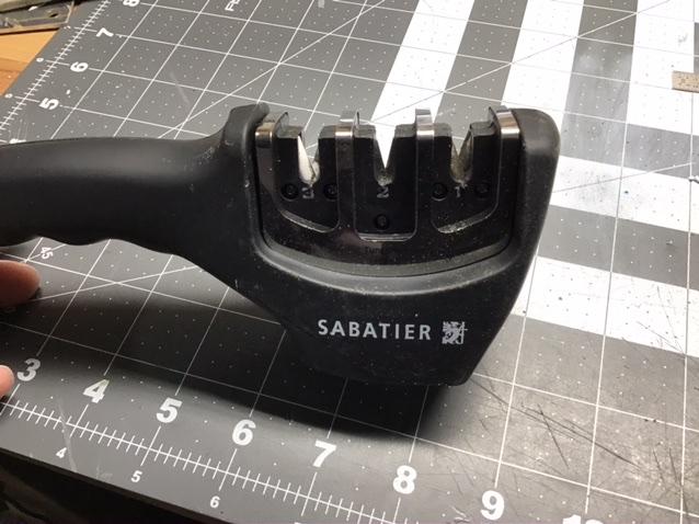

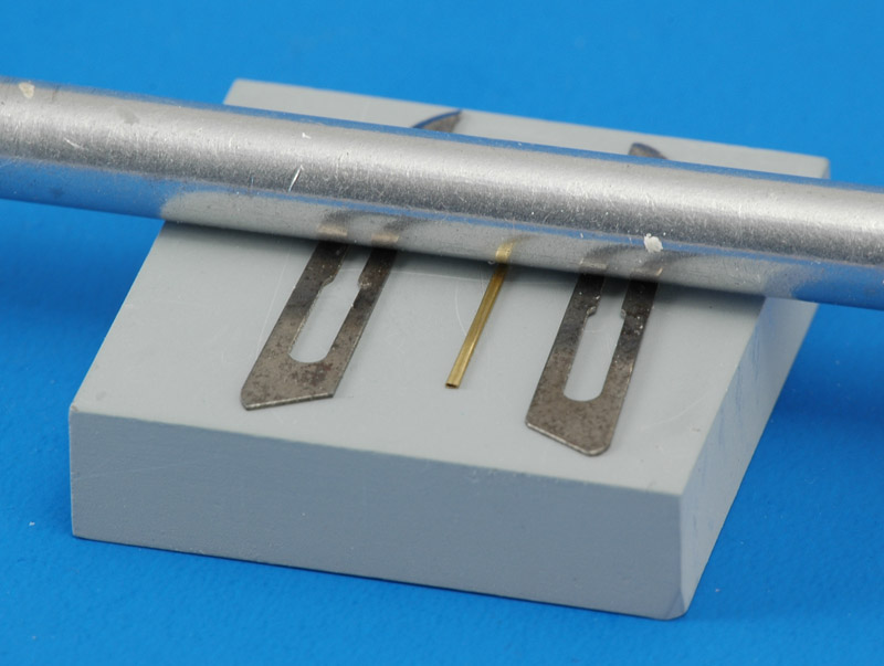

You might try a knife sharpener like this for shaving the styrene?

I thought of the 1/2 round plus triangle idea. Greg, your sample looks pretty good. I wonder if I can get an order shipped.
In the mean time I tried putting two #11 blades in a V in a vice and drawing some stock through. Via knife sharpener. That didn't really work.
Then I tried carving a half wing shape in a piece of brass sheet and drawing it over square rod stuck to the bench with two sided tape. Looked like it was working but it didn't.
Now taking square rod and coloring it with sharpie and shaving it with an exacto using the sharpie coloring as a guide. I'm getting the best result with this.

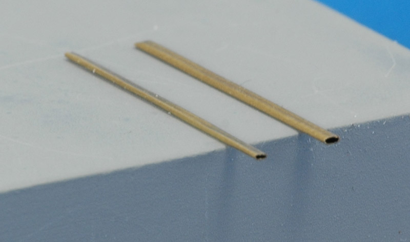

Or a variation on this theme: use Albion brass micro tubing and roll it to a semi-flat shape, using two supports of the right thickness. Roll it on both side to take out a curve. Albion even sells a special tool for this, that you can install in a vice.
Brilliant idea! Such a simple, and practical solution. Thanks for passing that along!

Gary, according to my research, those are gold. They come from Contrail, which is long out of business. What they said in the Airplane chat is that when those are offered up on Ebay, they start a bidding war. With that said, if you want to part with them, or some of them. let me know. I can buy or trade.

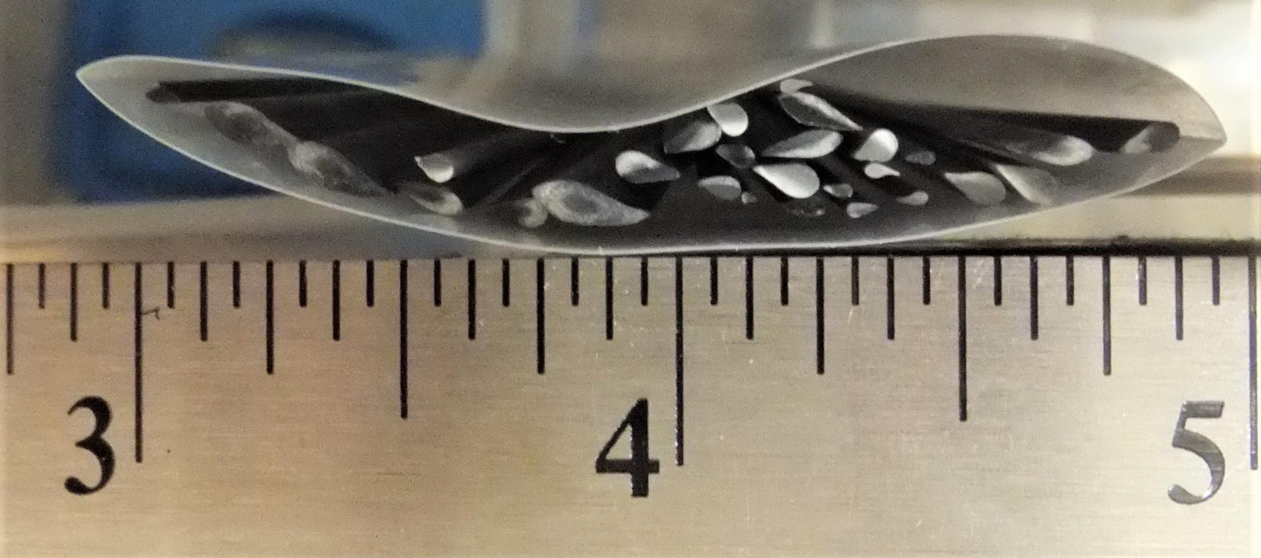

Rob, Flattening some aluminum stock might work. Remember, these are on 1/16" tall at the cross section, but it's worth a try. I might try to get the more of a wing that an oval, but let's see. And if it's aluminum, I can polish it! Quick update -  I just did a rough sample and this one may work. It got pretty close.I need  to play with the "dies" to set the angle of the roller.

There is no finished product to reference. This is for a 1:1 truck that is still being built. The best PIC of where I am headed is in this thread. It shows the grill shell with one hand carved bar laying on it. I want to get this project done and off my bench. My patron has been waiting several years. I finally caught up to his progress, so now he tells me what he is going to do on the 1:1 truck and I do that then show him in scale. You can check out the thread in the big rig section in this forum.
What specific dimensions are you seeking? If it is in the stack we talk further.
