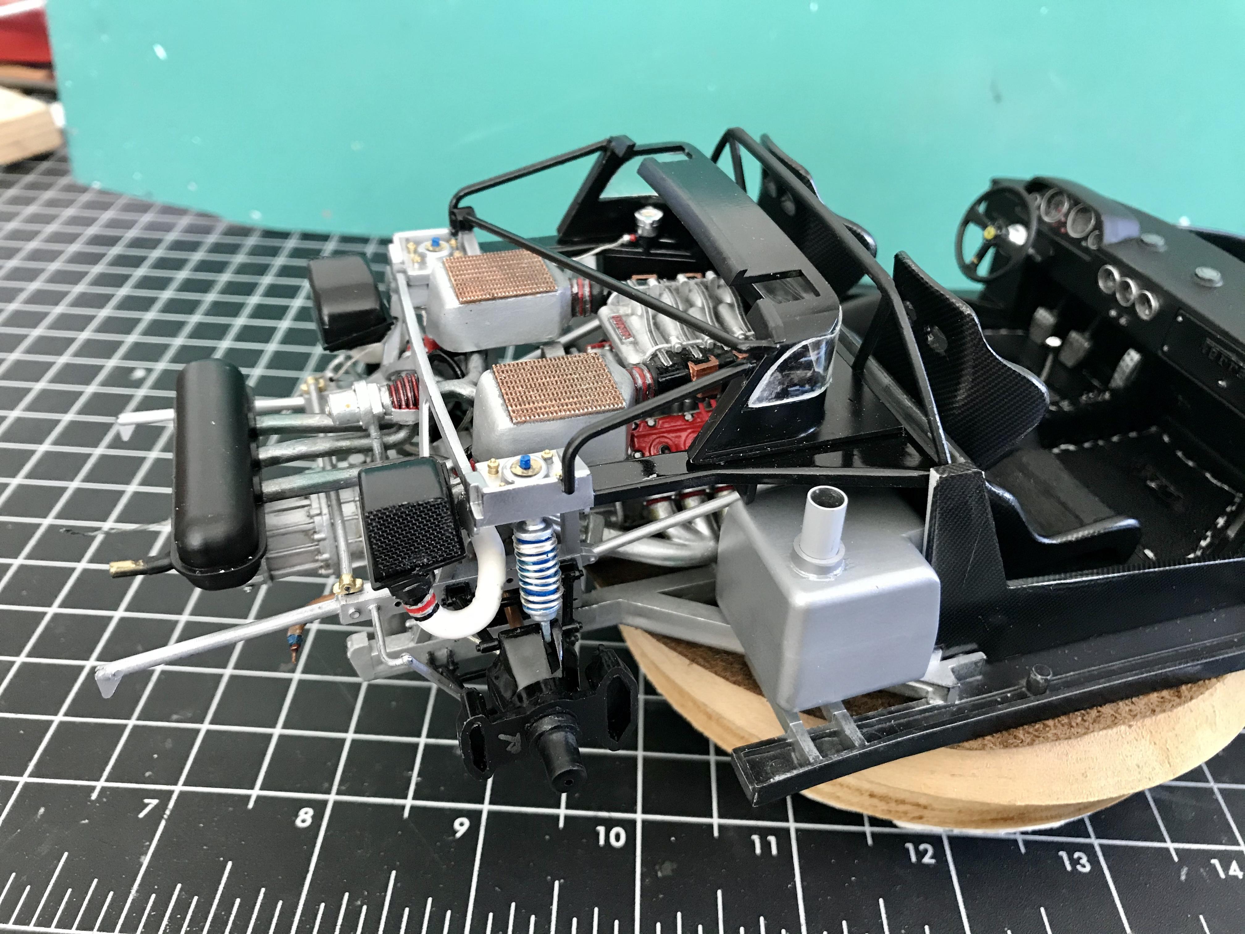

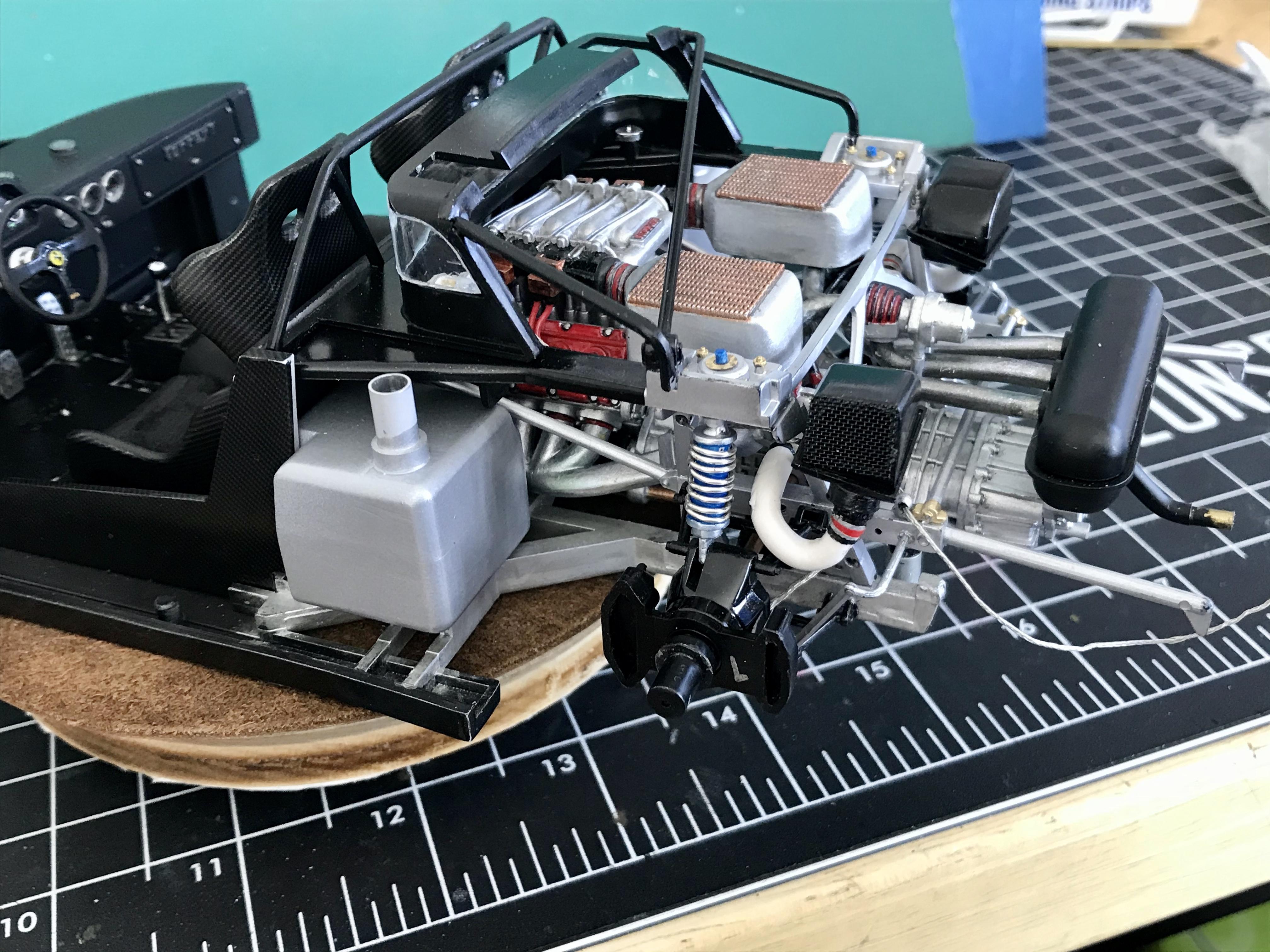

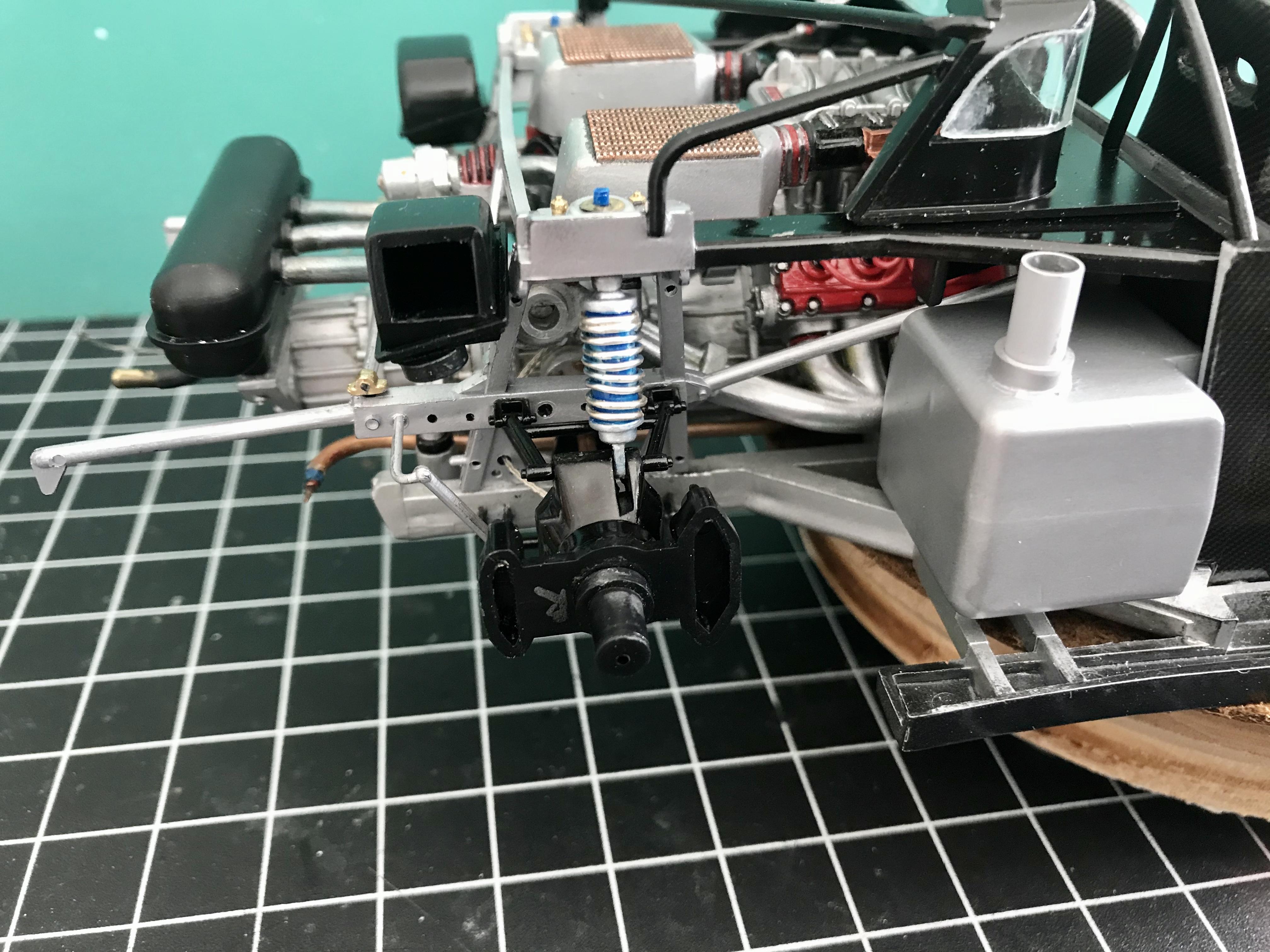

Deviated from paint for a bit and did more engine work.

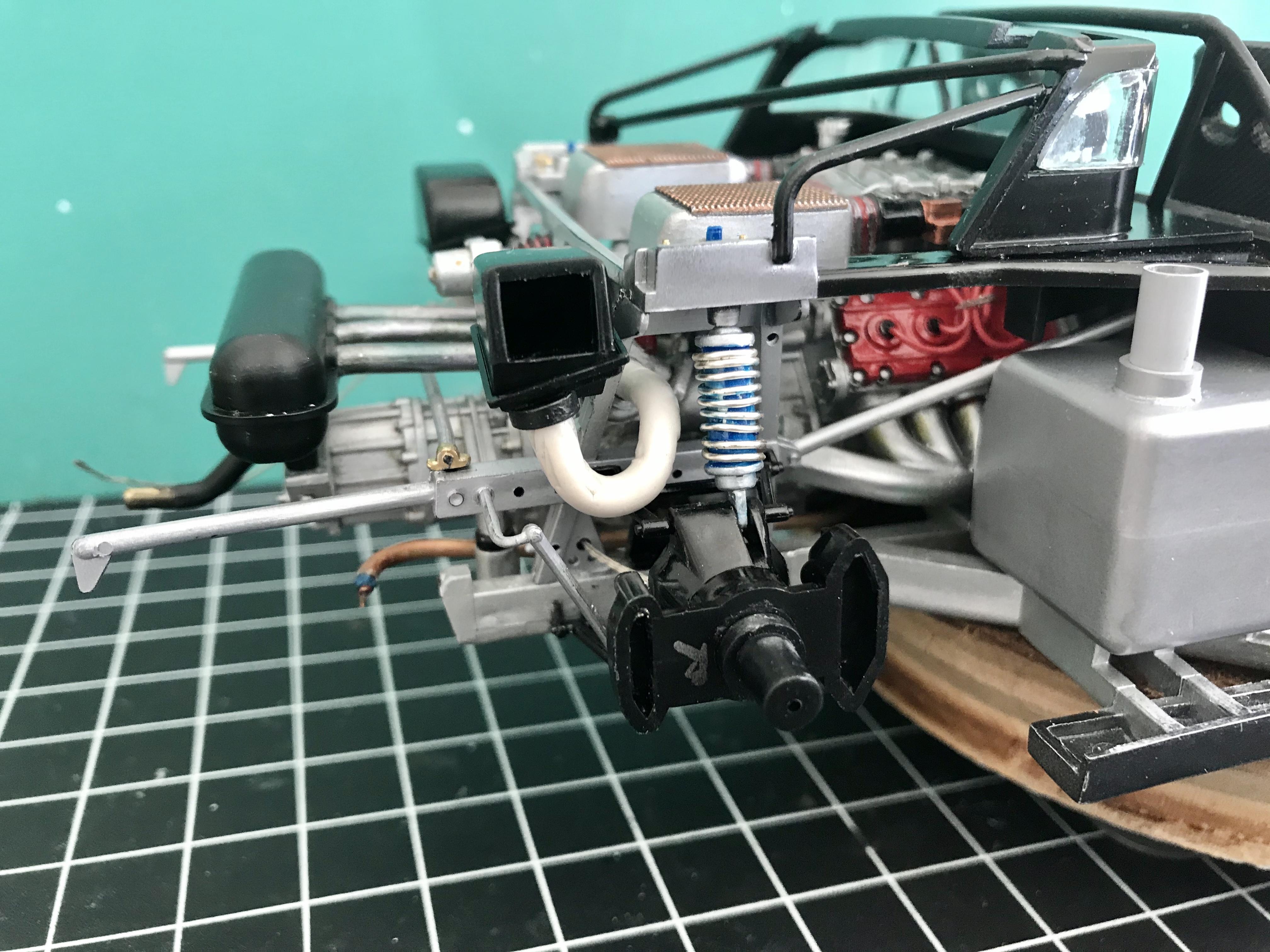

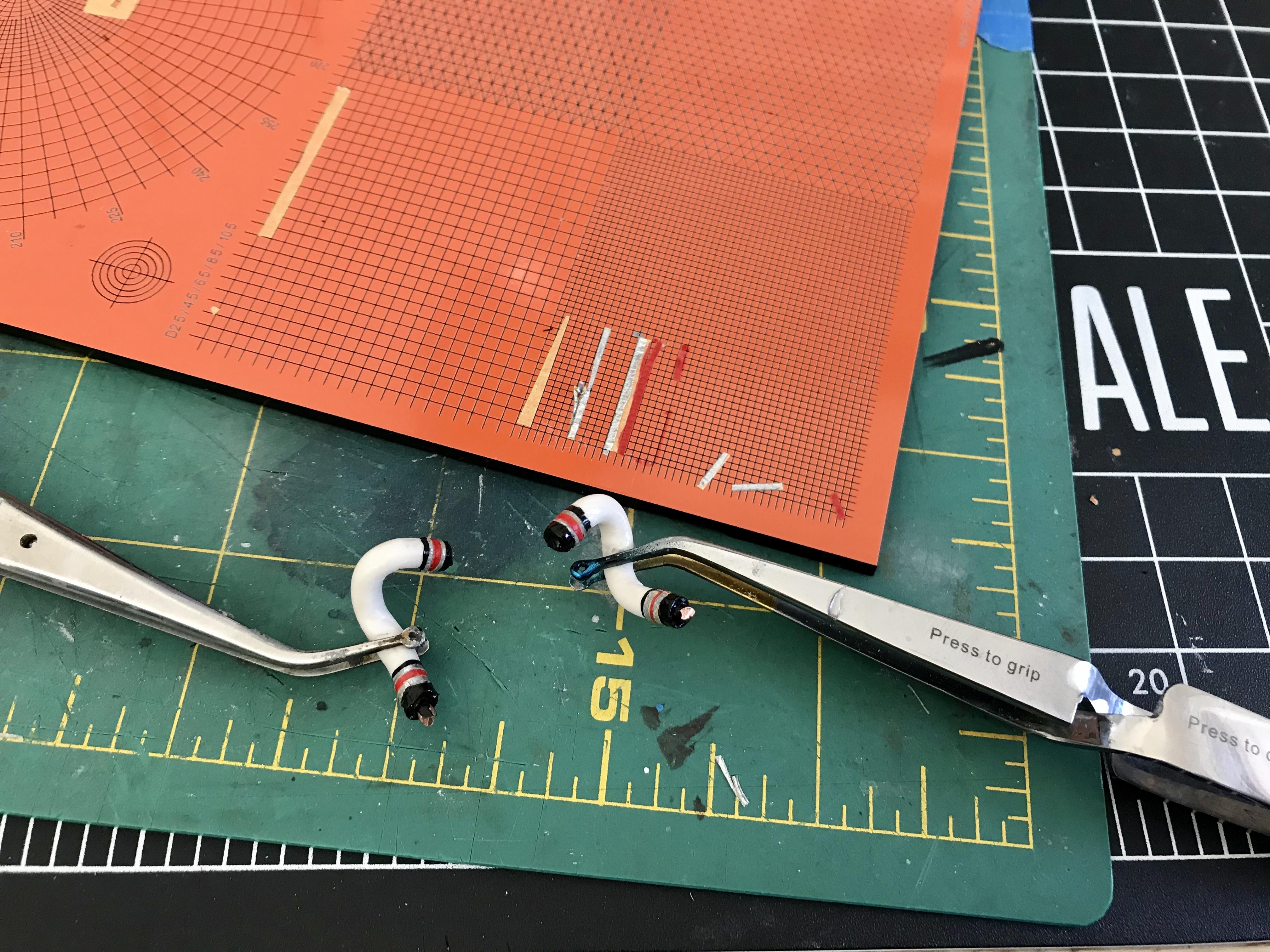

Glossy black air boxes were installed. They have no purpose in the model...no hoses no hook up and look like mailboxes.
Research shows these boxes are the air filter intakes for the turbos.

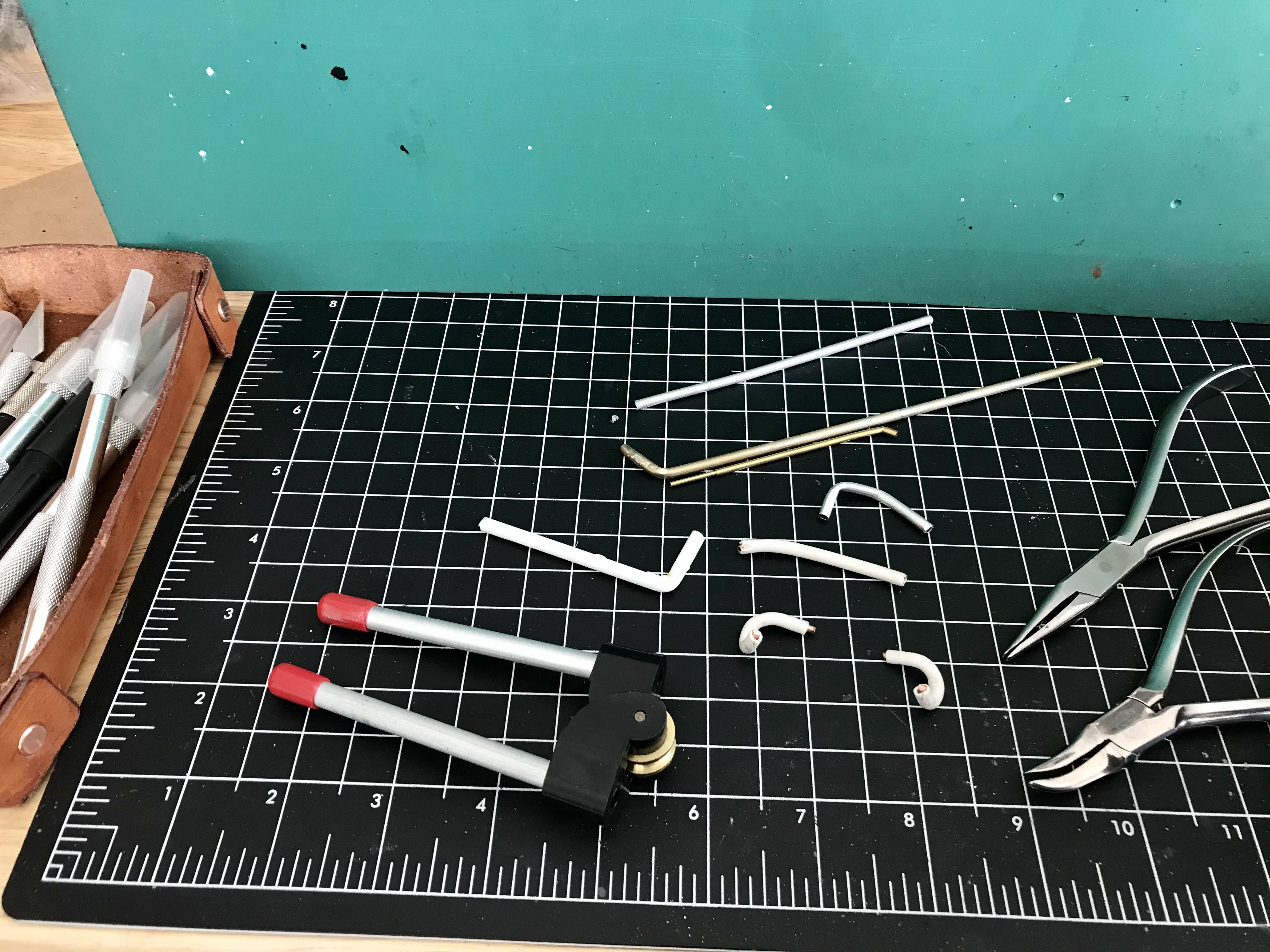

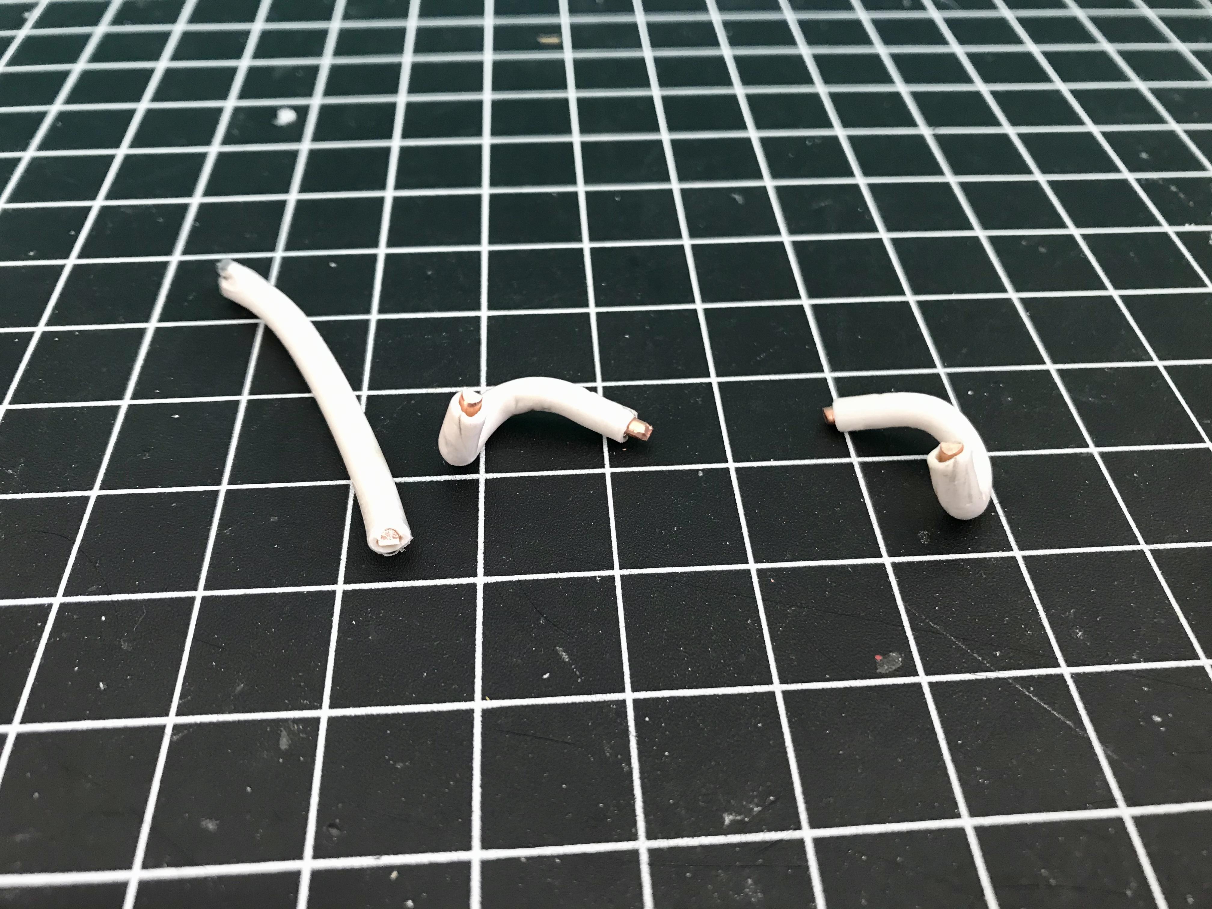

So I made some pipes by bending a thick copper electrical wire coated with plastic.
It was the best material for the job as aluminum broke, styrene would not take the complex curves and brass would not budge for me without huge dents in the tube.
Bent the electrical wire to fit and added some black styrene tube to accept the pipe in the base of the ‘mailboxes’
a bit of detailing for hose clamps
Installed
Finished with some black mesh over the mailbox’s intake opening. Good morning’s worth of modelling

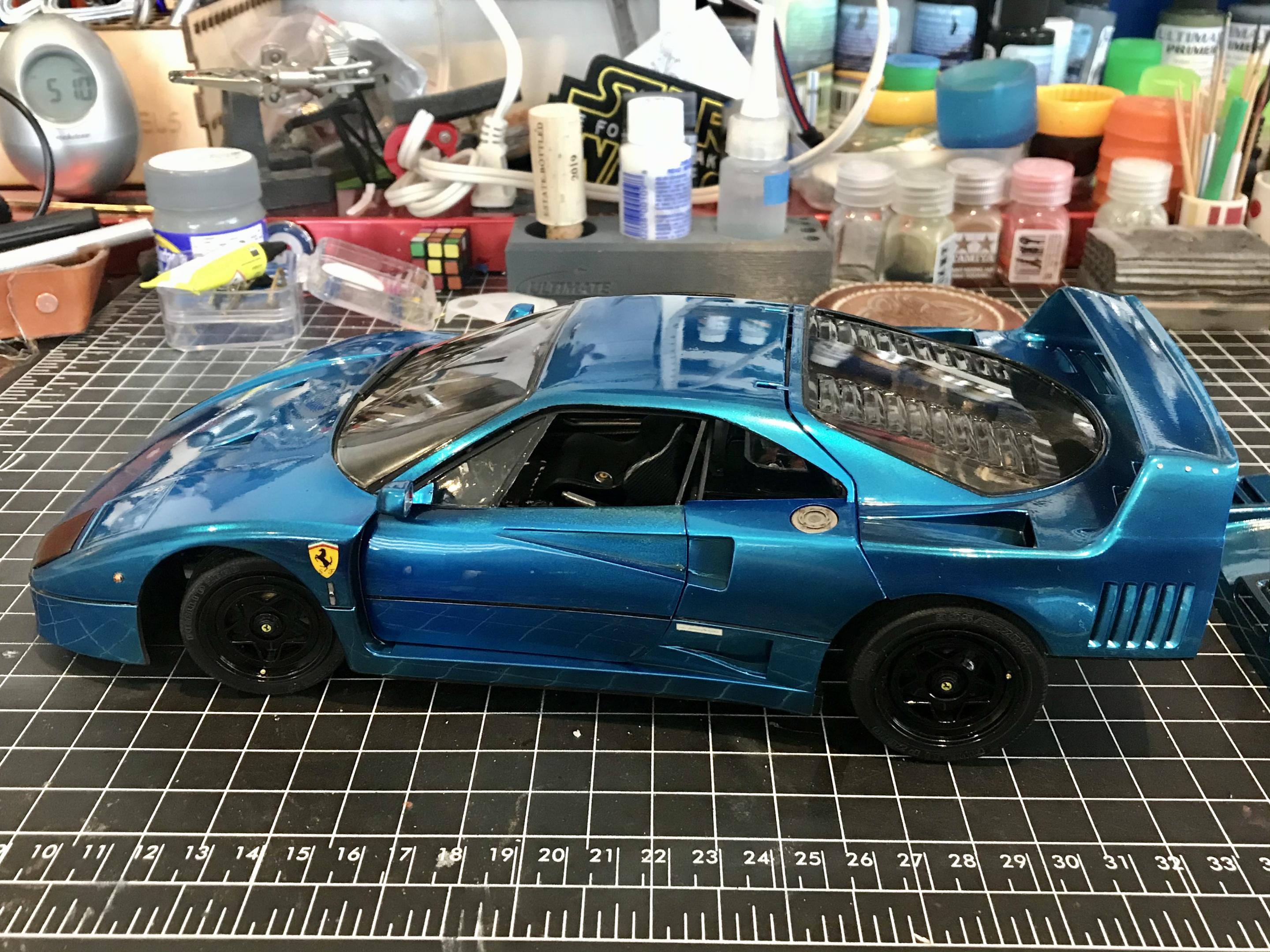

The blue going over will be Tamiya's Clear blue...probably three light coats at least. Then a 2k clear with Splash.

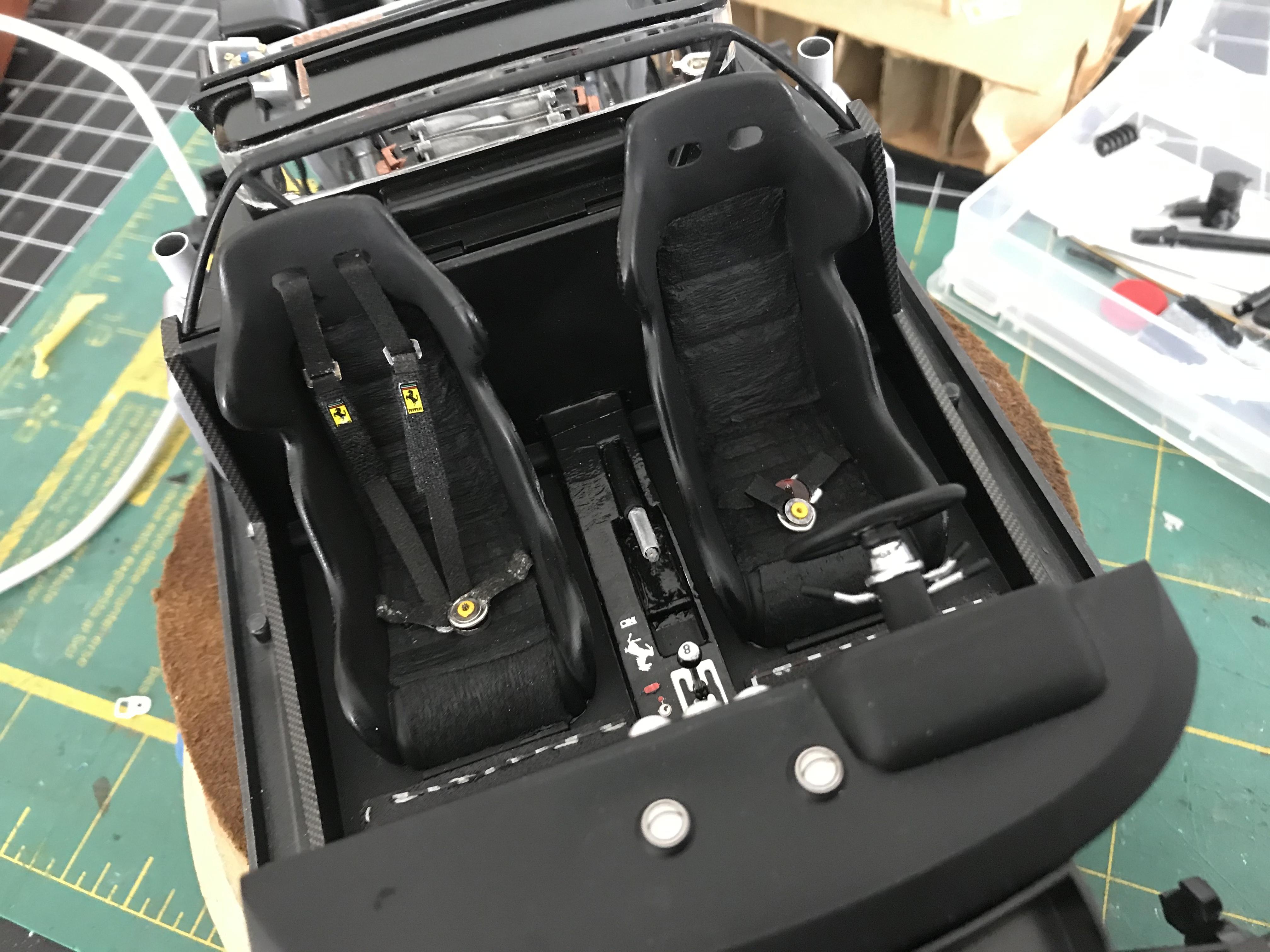

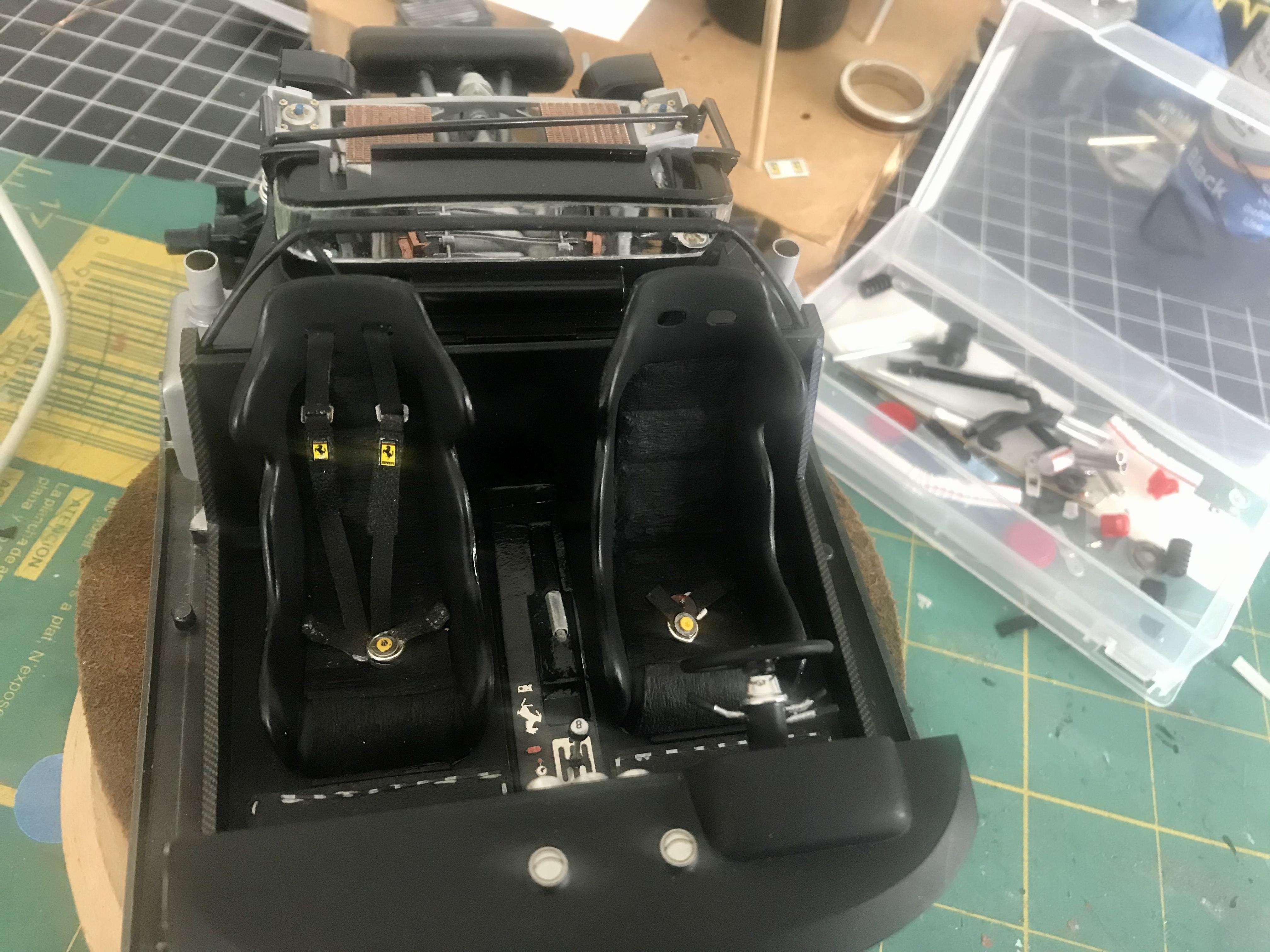

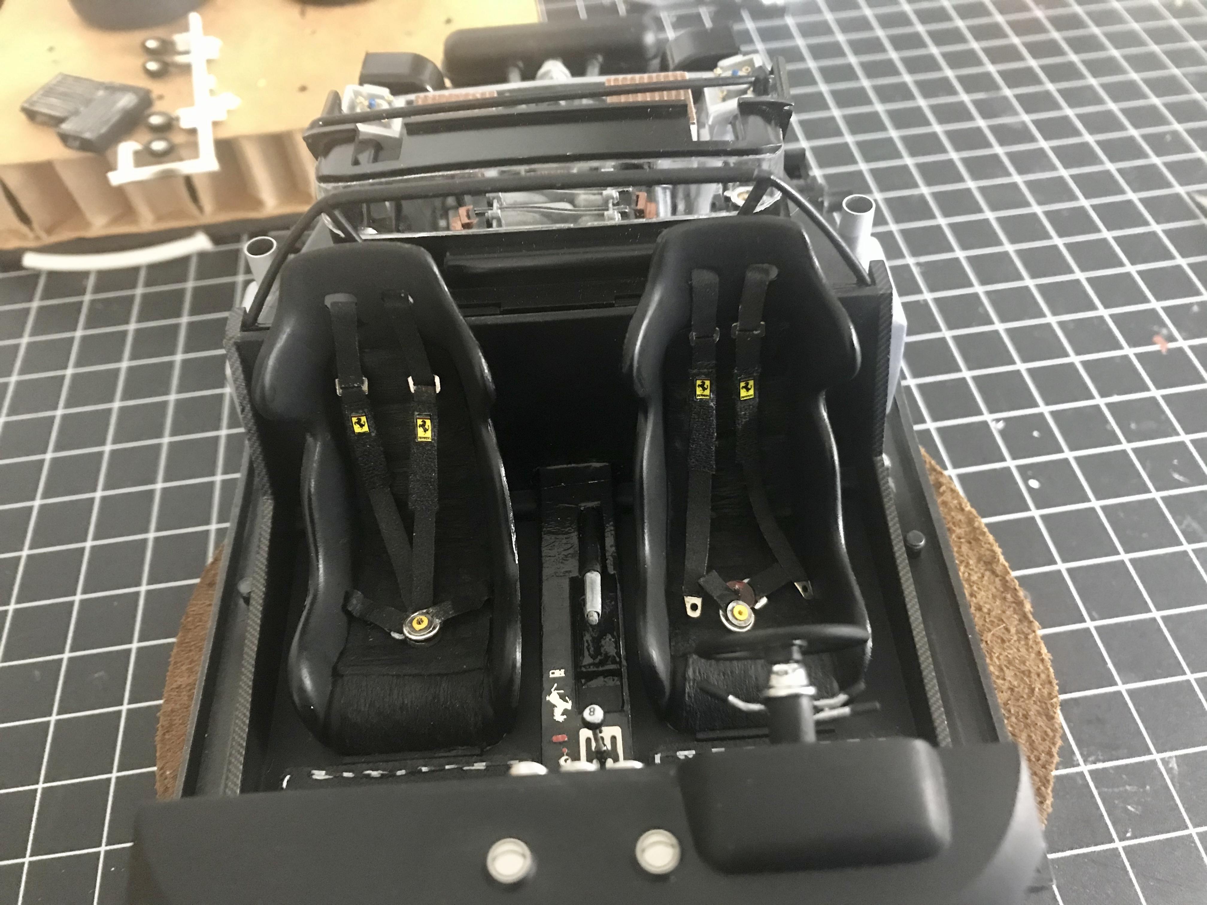

Personally, I hate doing seat belts Scott..........but to make your own like you did.........sheesh.  They're nice too!   Good looking car sir. tim
Cheers Codi

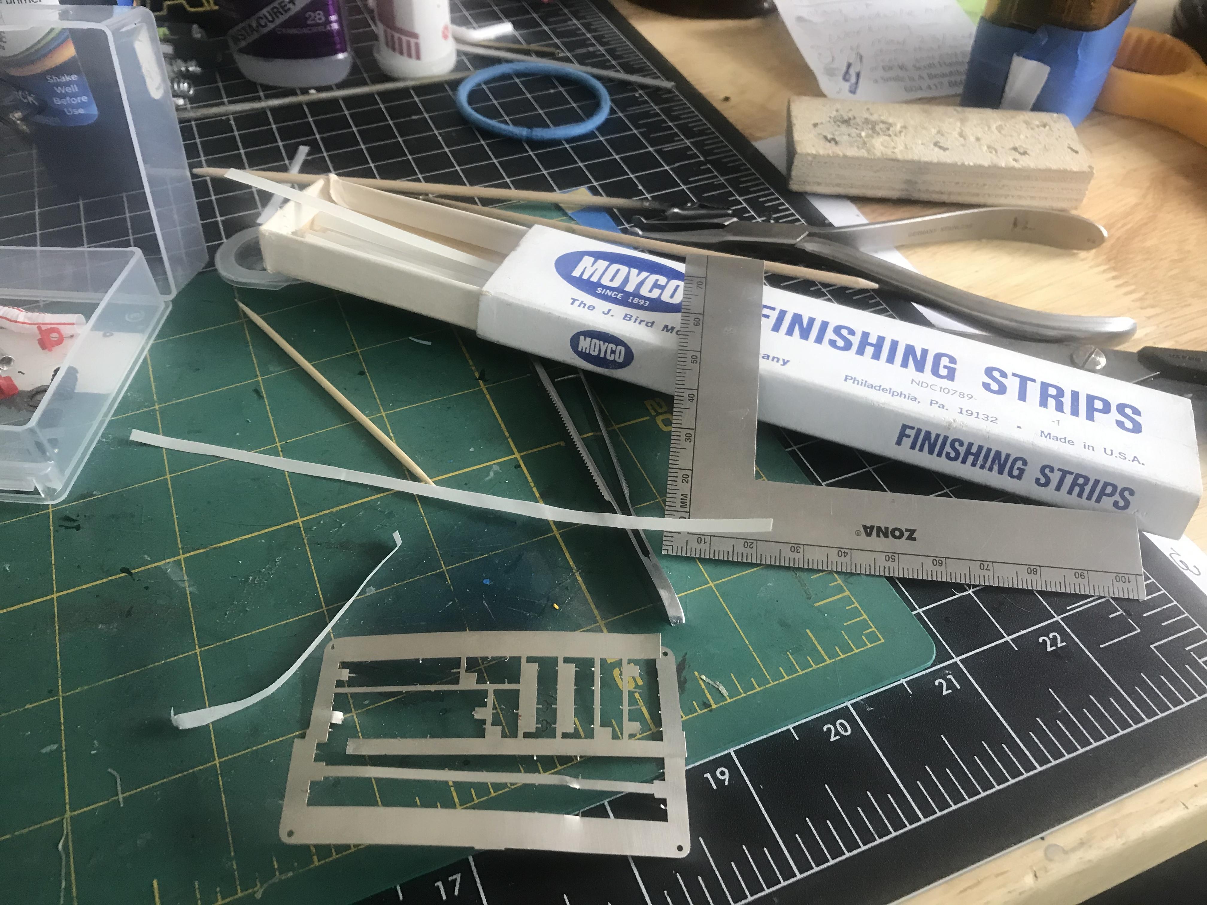

I would use photo etch buckles, but didn't have any 1/16 scale ones....it is  bit weird of a scale apparently. So I had to make do with what I had.
As many a true Canadian can attest,  we are born with hockey tape wrapped around the umbilical chord, so it's multifaceted use comes second nature:P

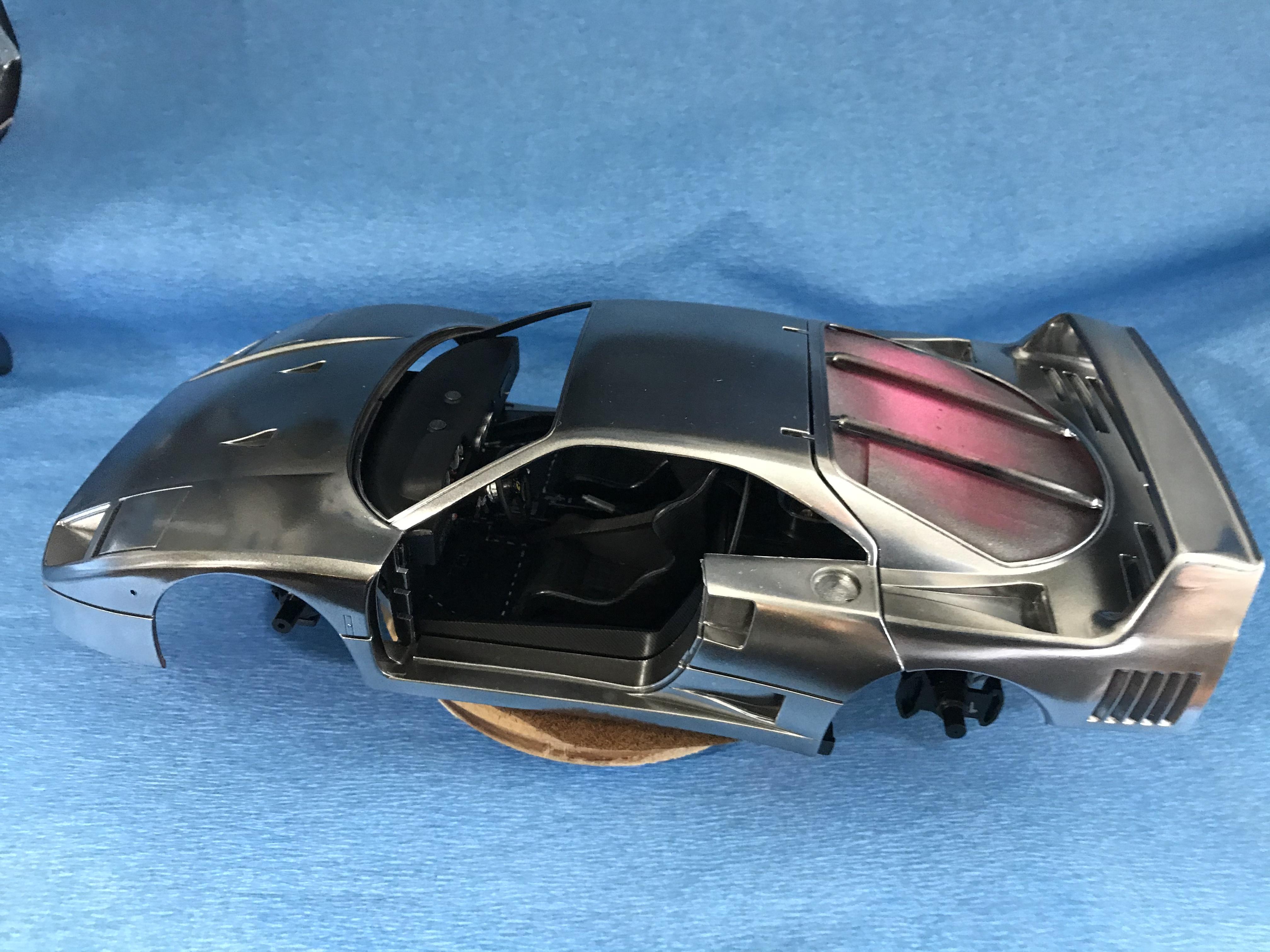

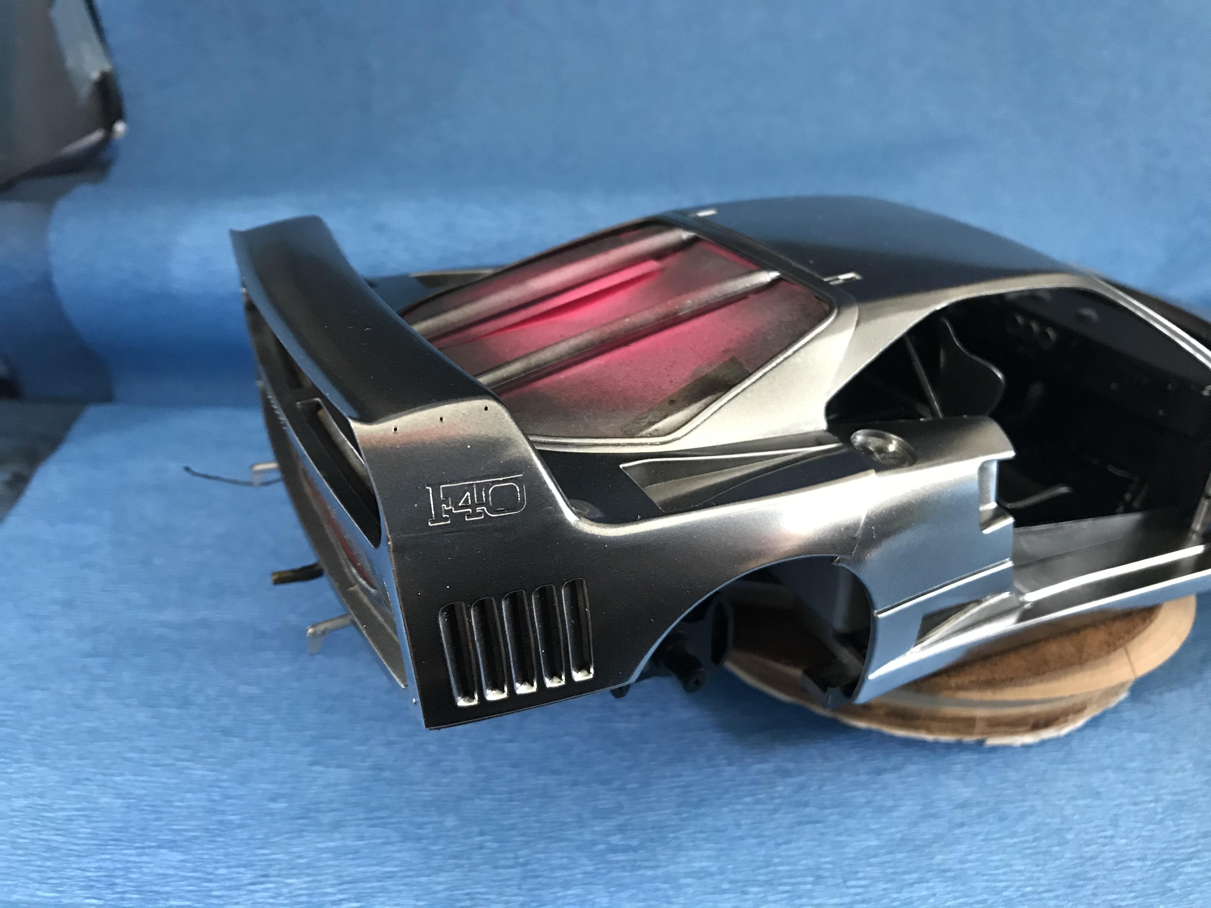

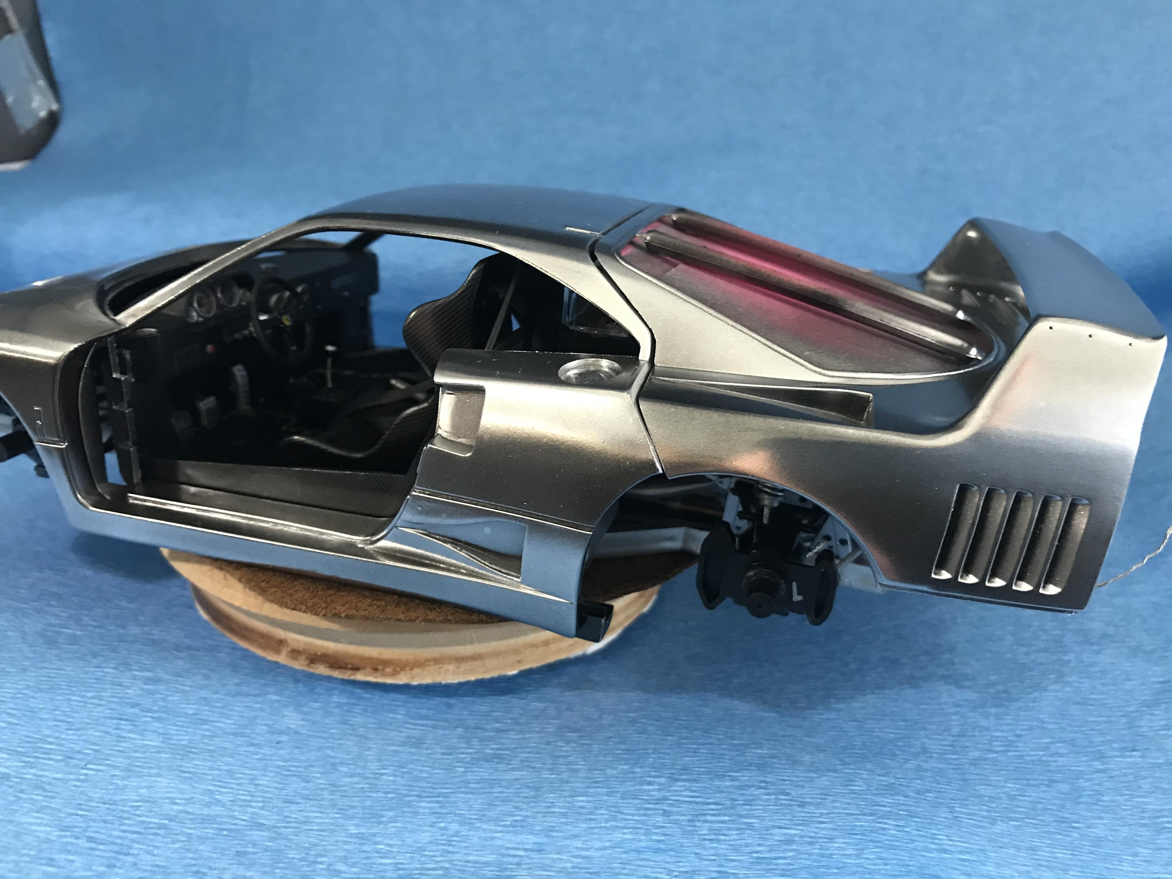

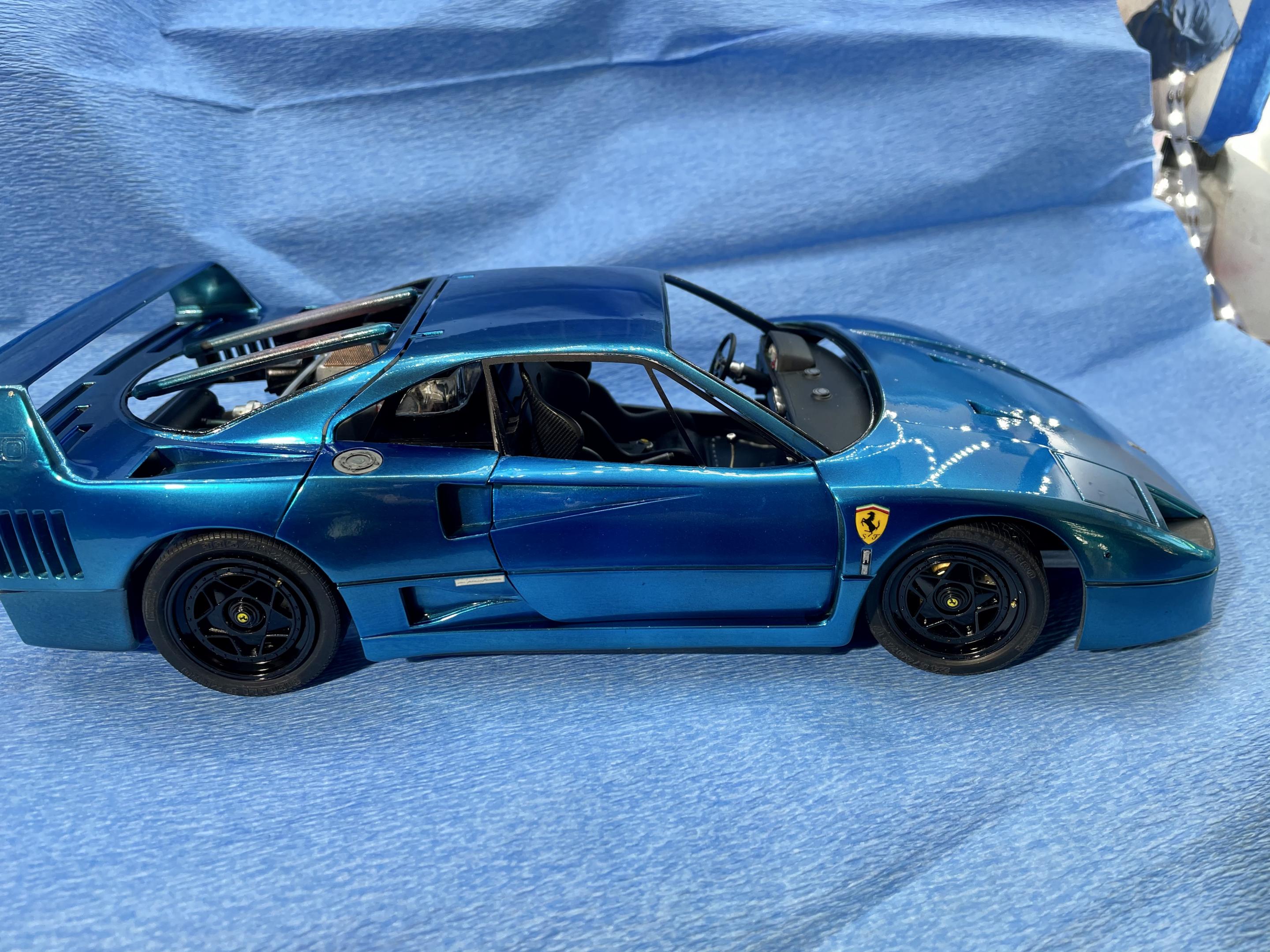

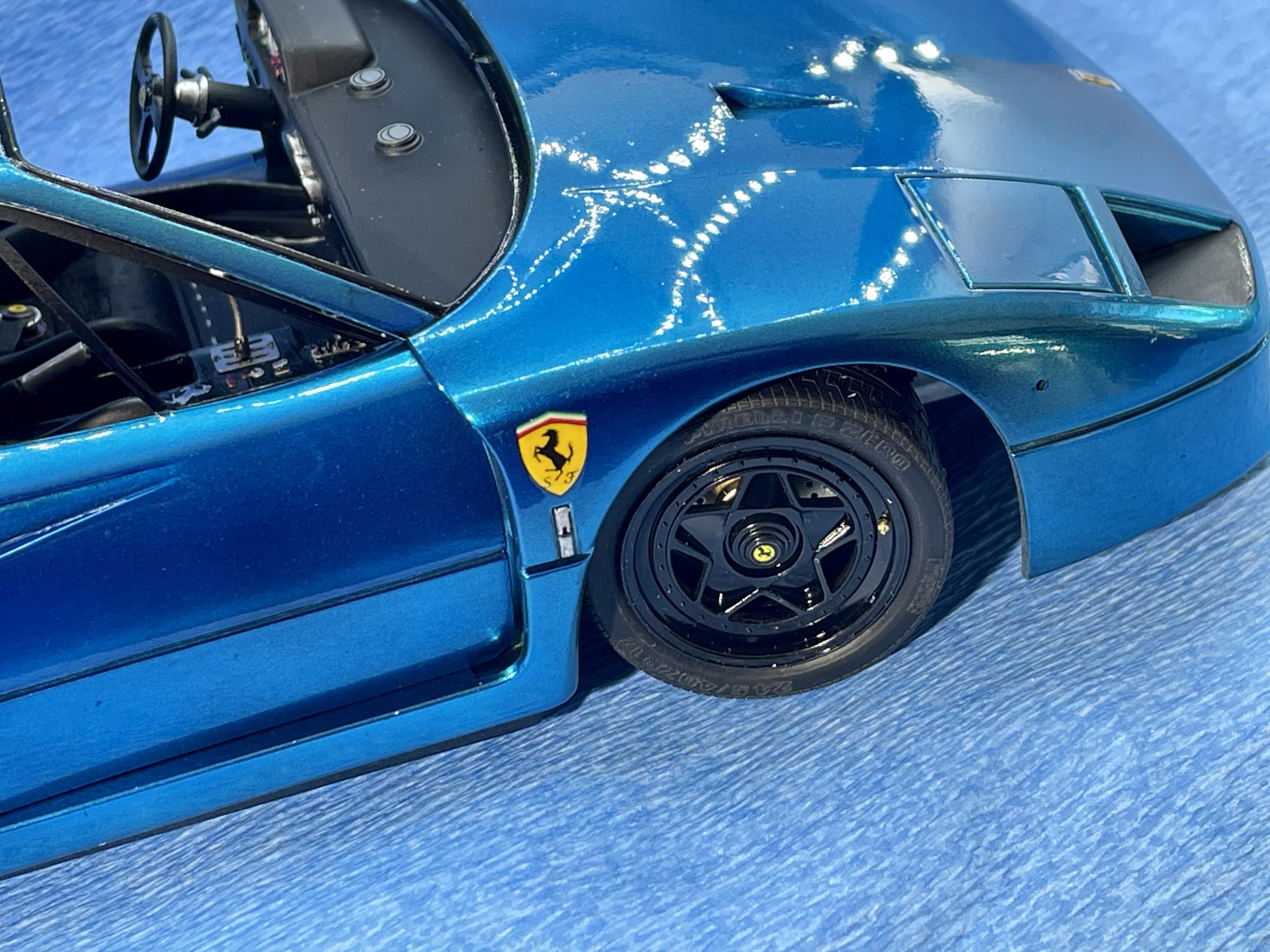

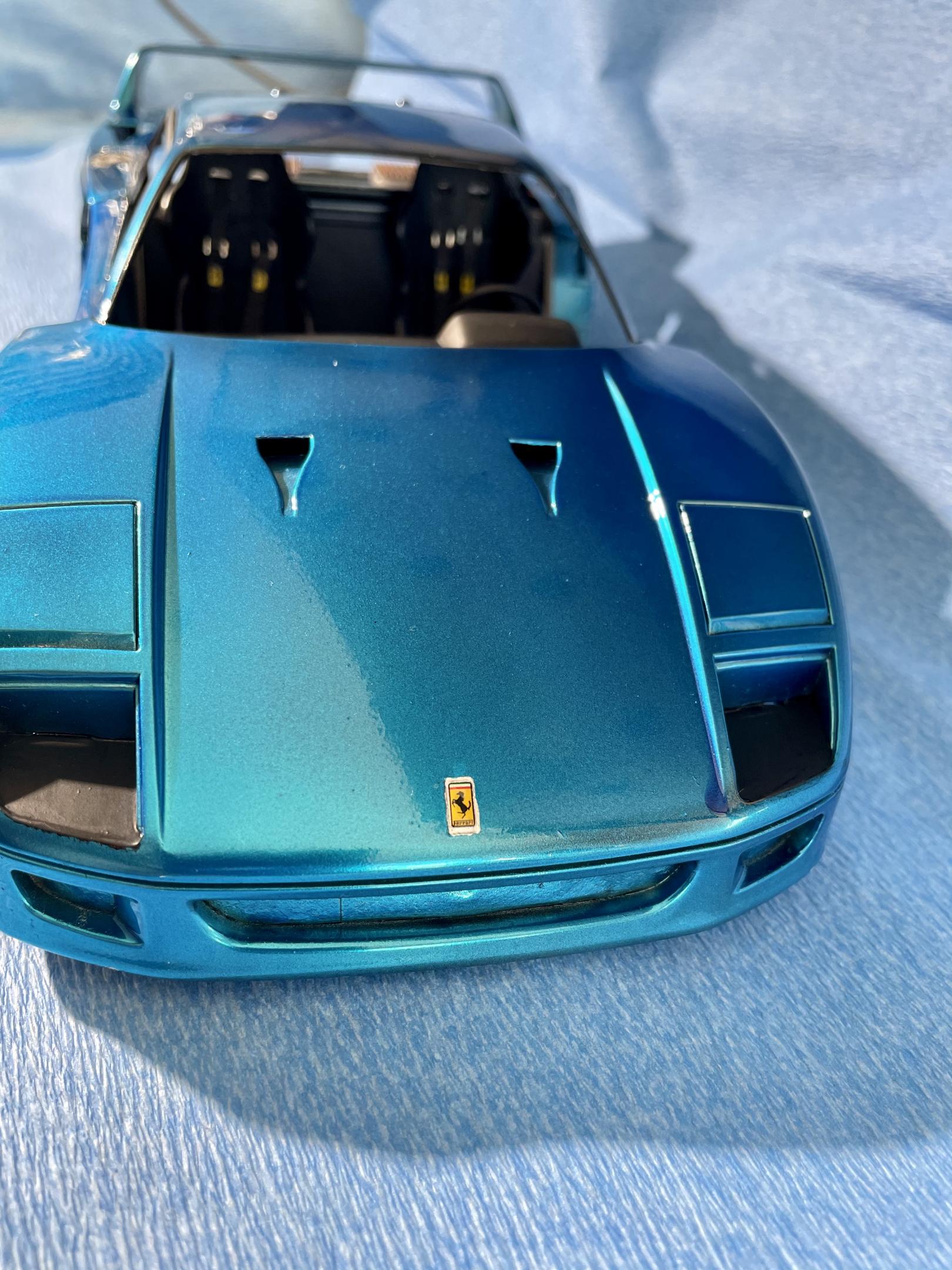

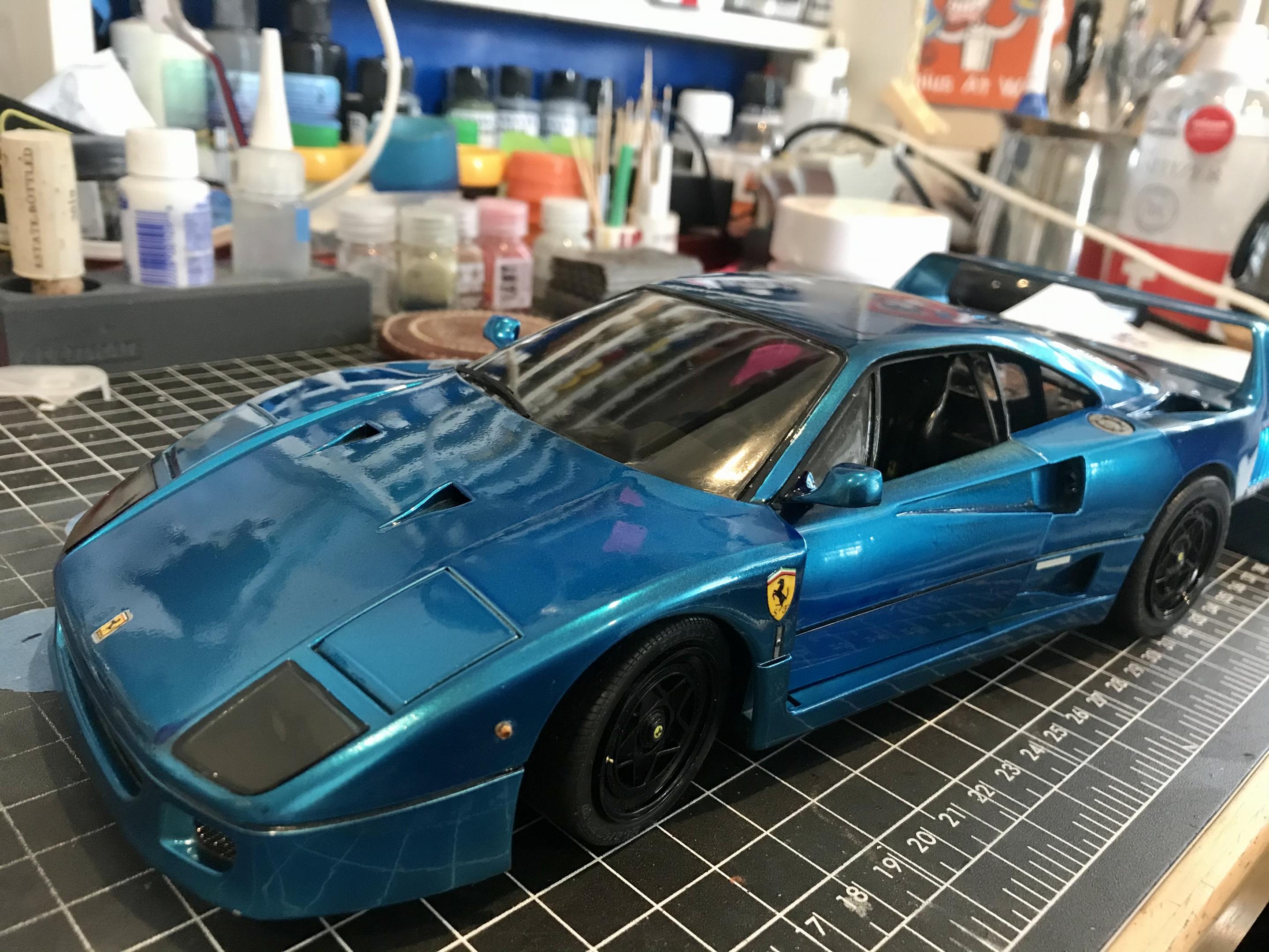

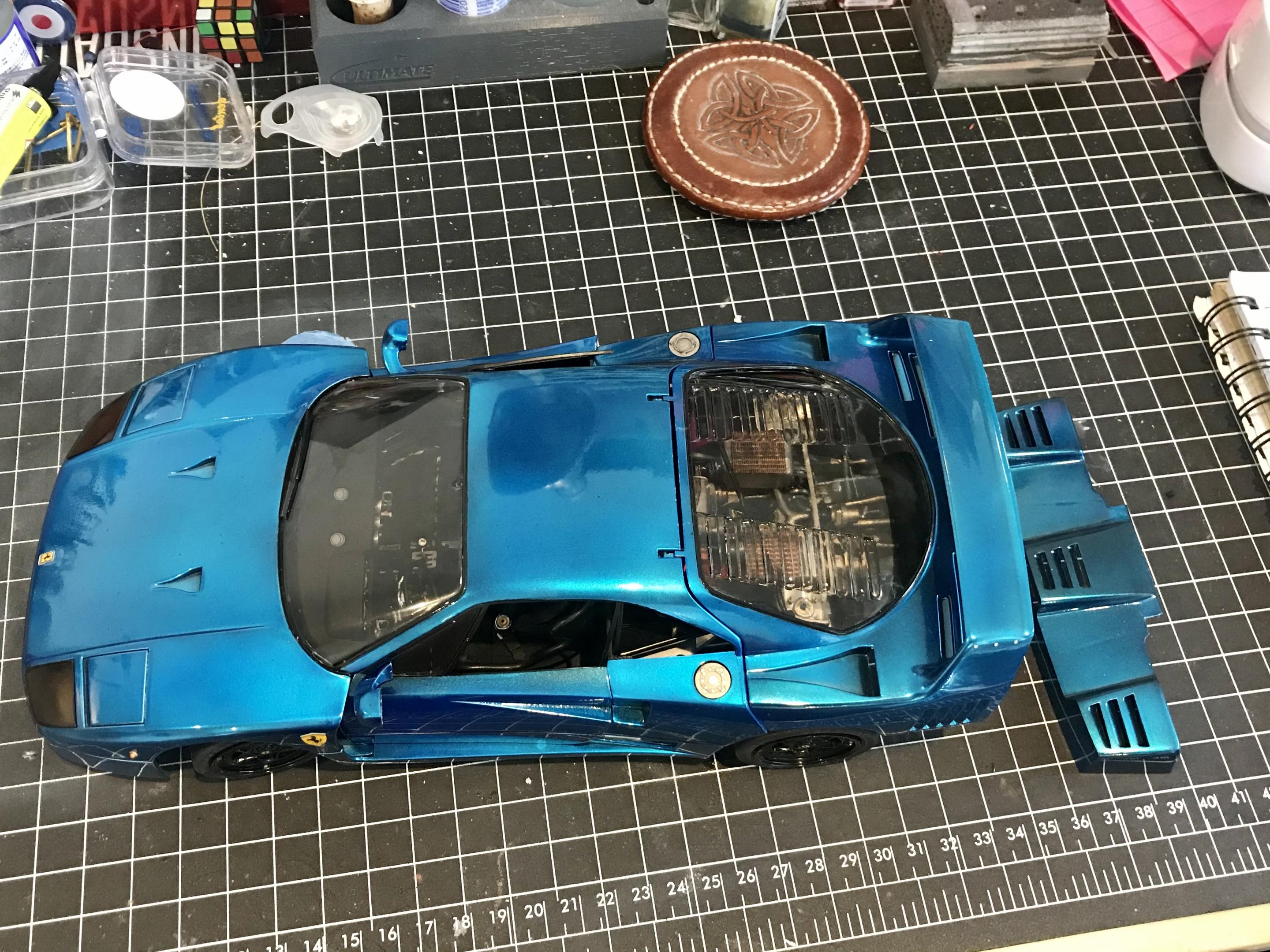

The Tamiya clear blue layers were done and this morning the Splash 2k clear had cured overnight
Not a perfect paint job, but very interesting effects...it looks different from every angle
Final assembly bits over the next week here8D82C7D3-1AD9-4835-BB5A-9C4C161B2F20.thumb.jpeg.8ce4f5f6063afbd2246fa117710b2498.jpeg4C9175CA-721C-41B5-813D-653F697B3DD5.thumb.jpeg.5f7be33e00b3daa9193bf29c0d58d9e2.jpeg29ECB6DE-ECC9-48E4-87BC-DBB11EF82EAA.thumb.jpeg.856e091977376ec2a94de5c5e4b1a6a5.jpeg

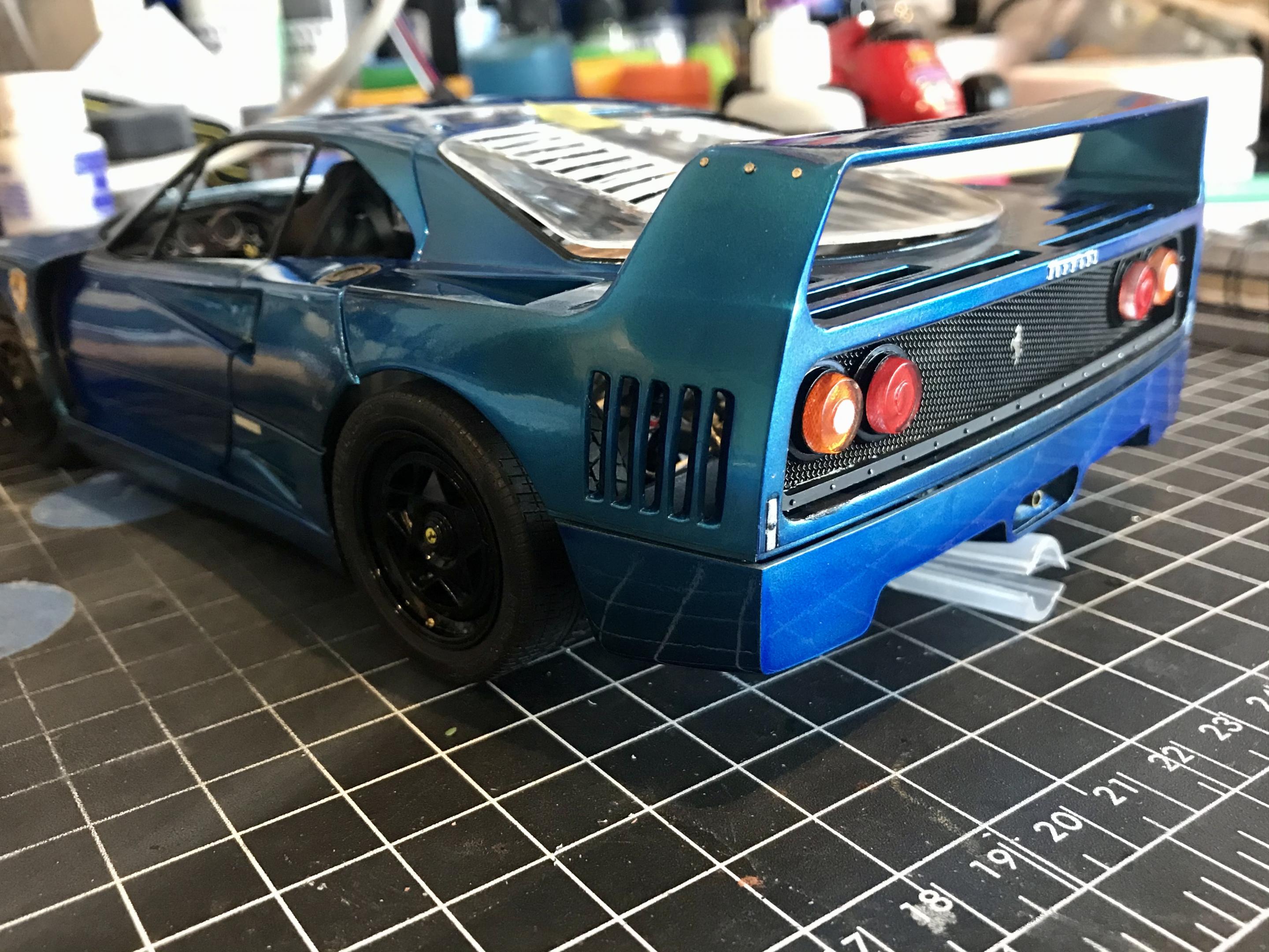

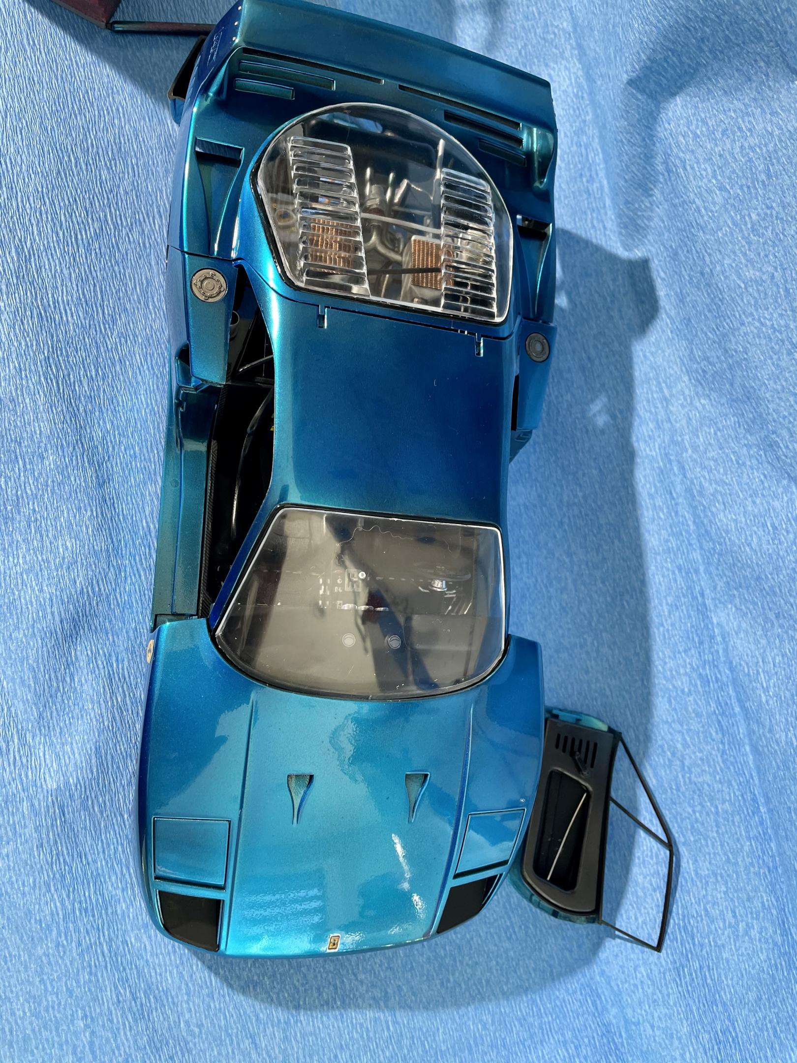

Moving on....
windows tinted and installed, doors mounted, side mirrors on and front lights/covers on. Just the side rear  windows, valence and exhausts to sort out
Almost done🙄🤪
