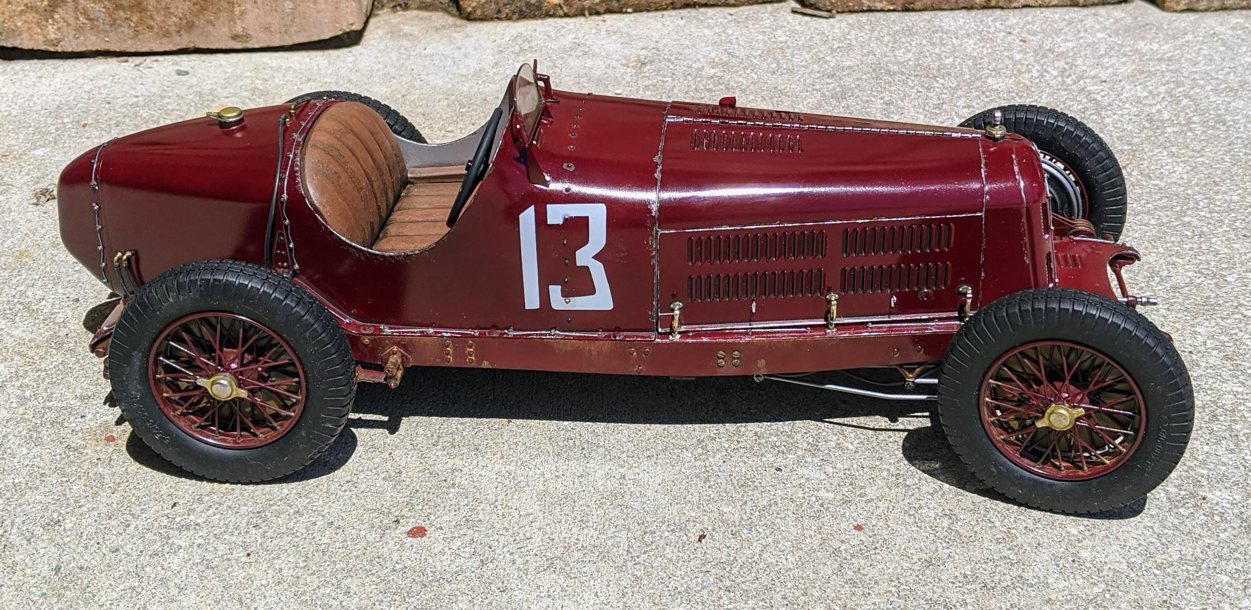

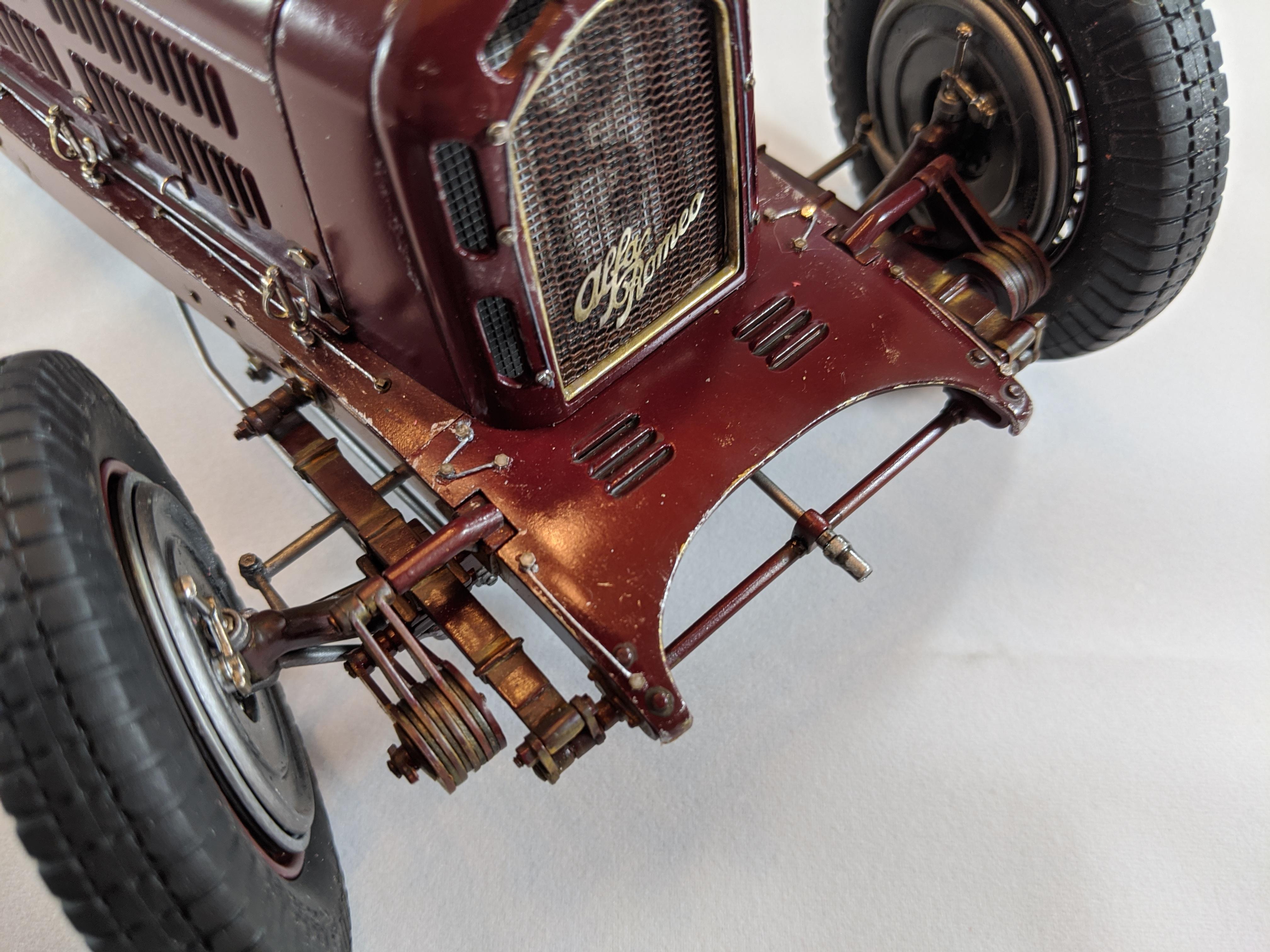

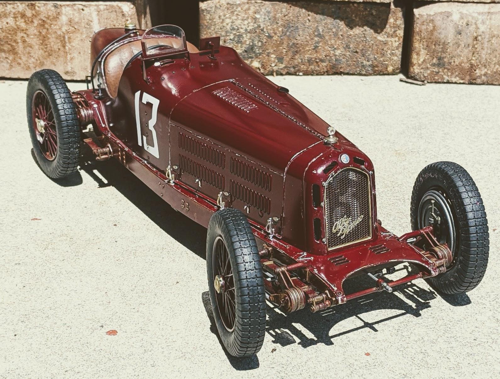

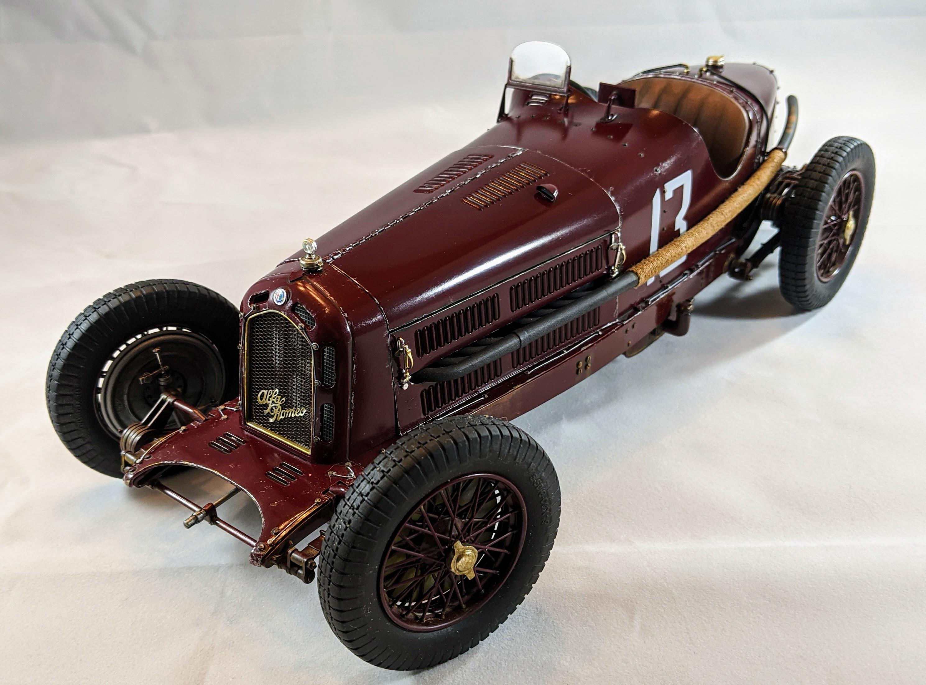

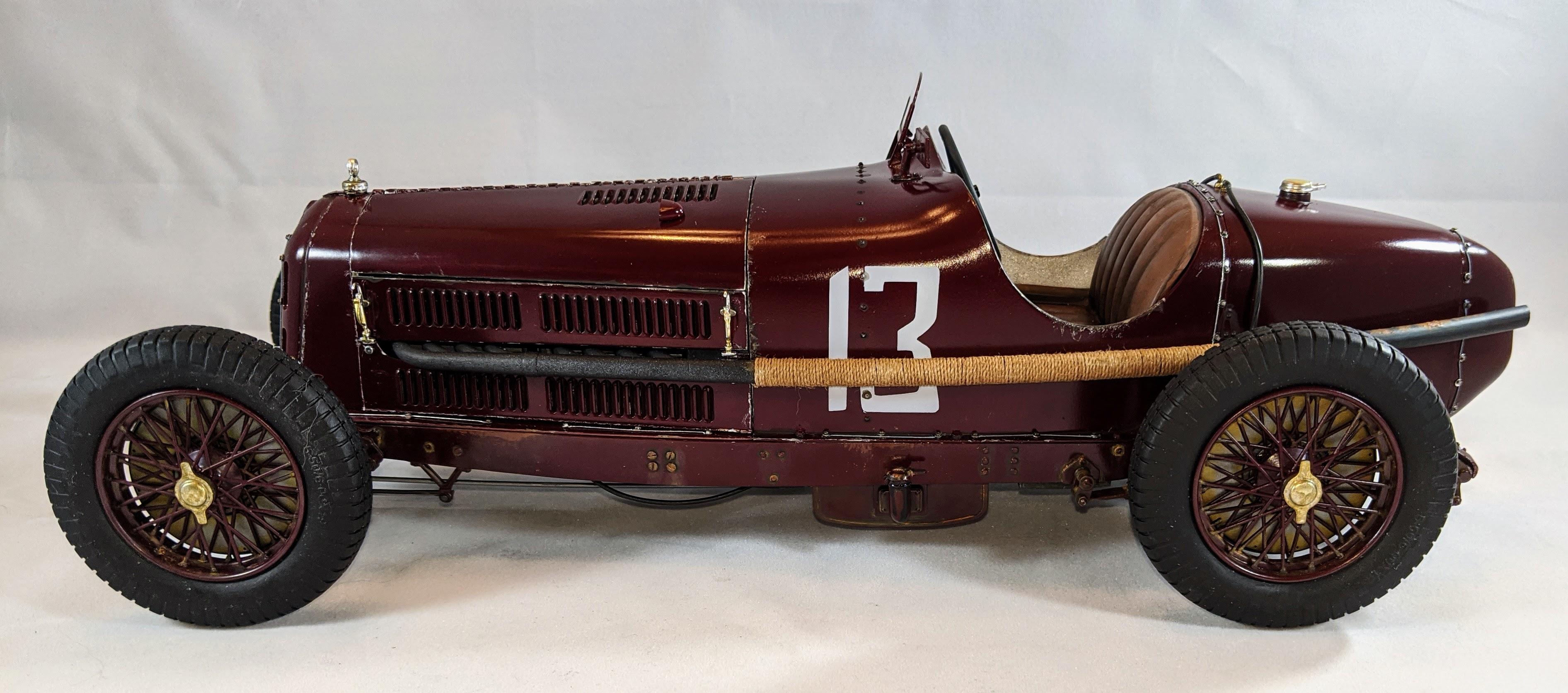

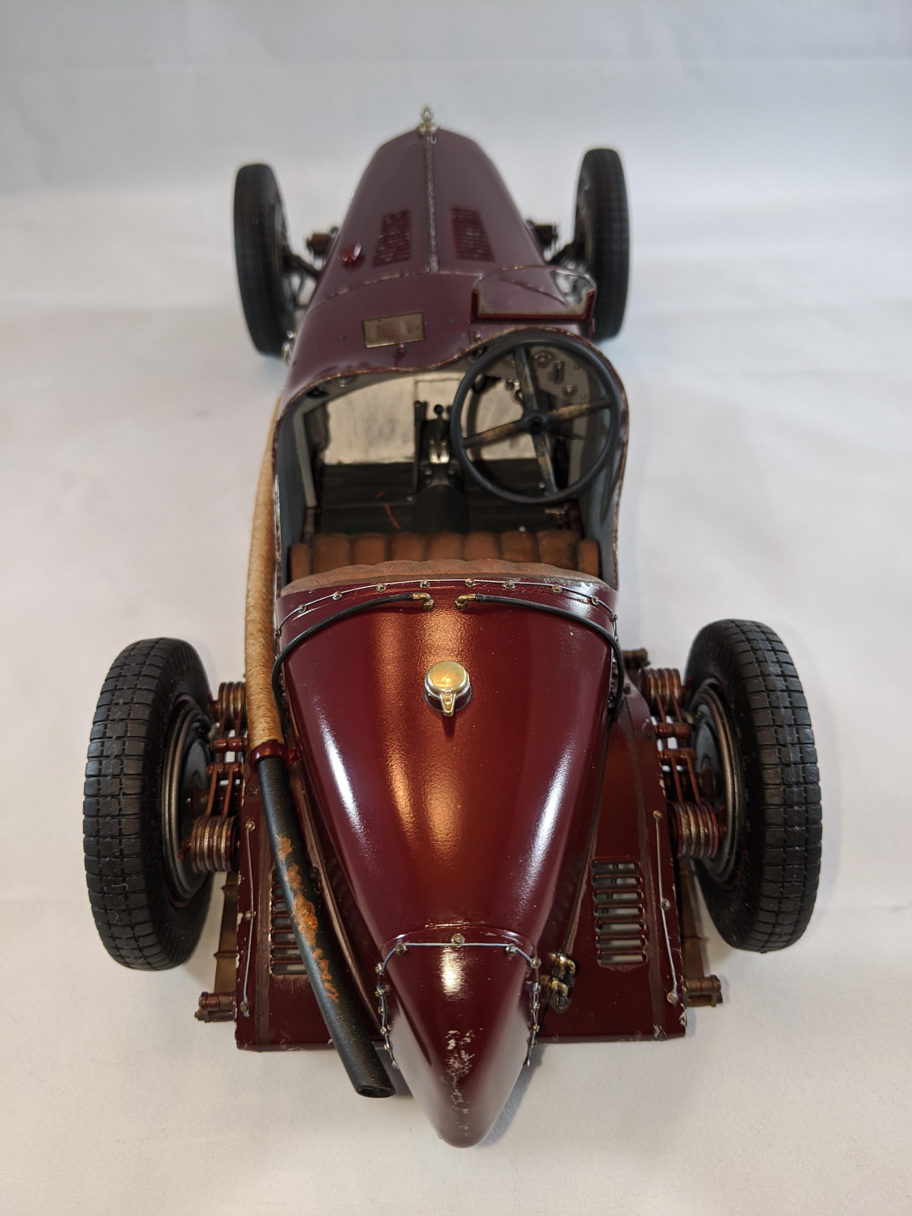

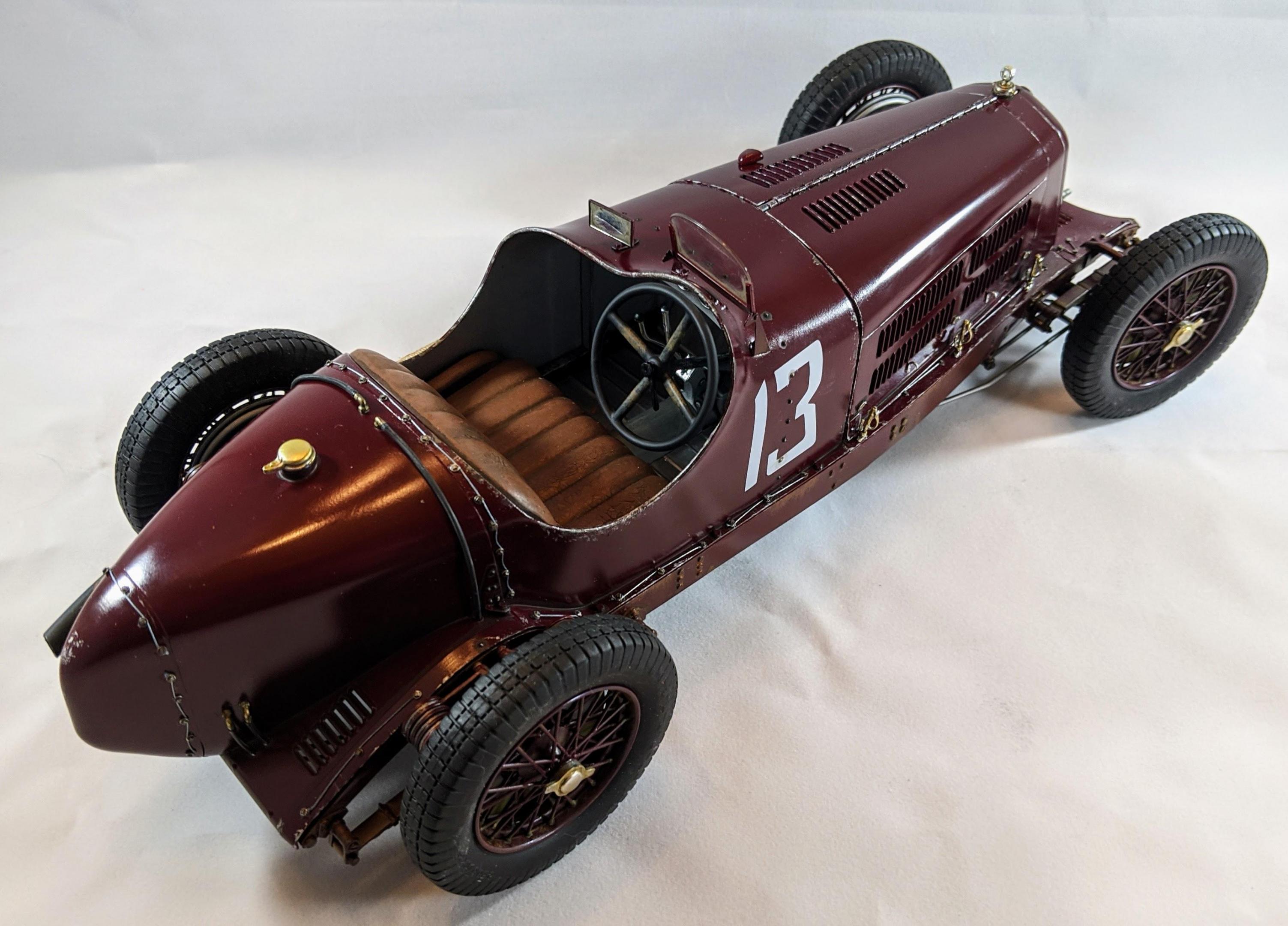

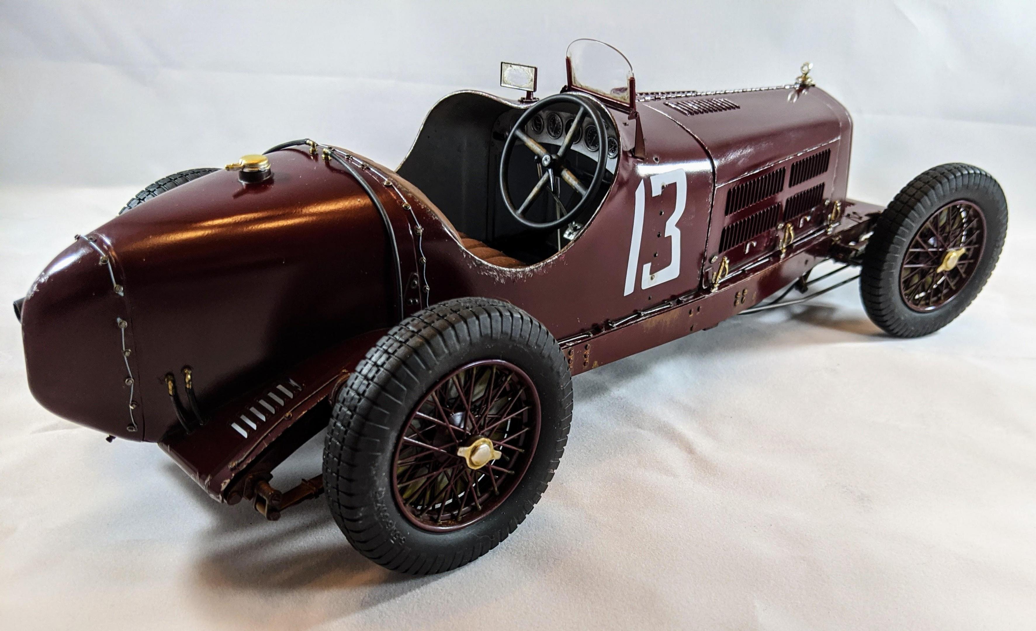

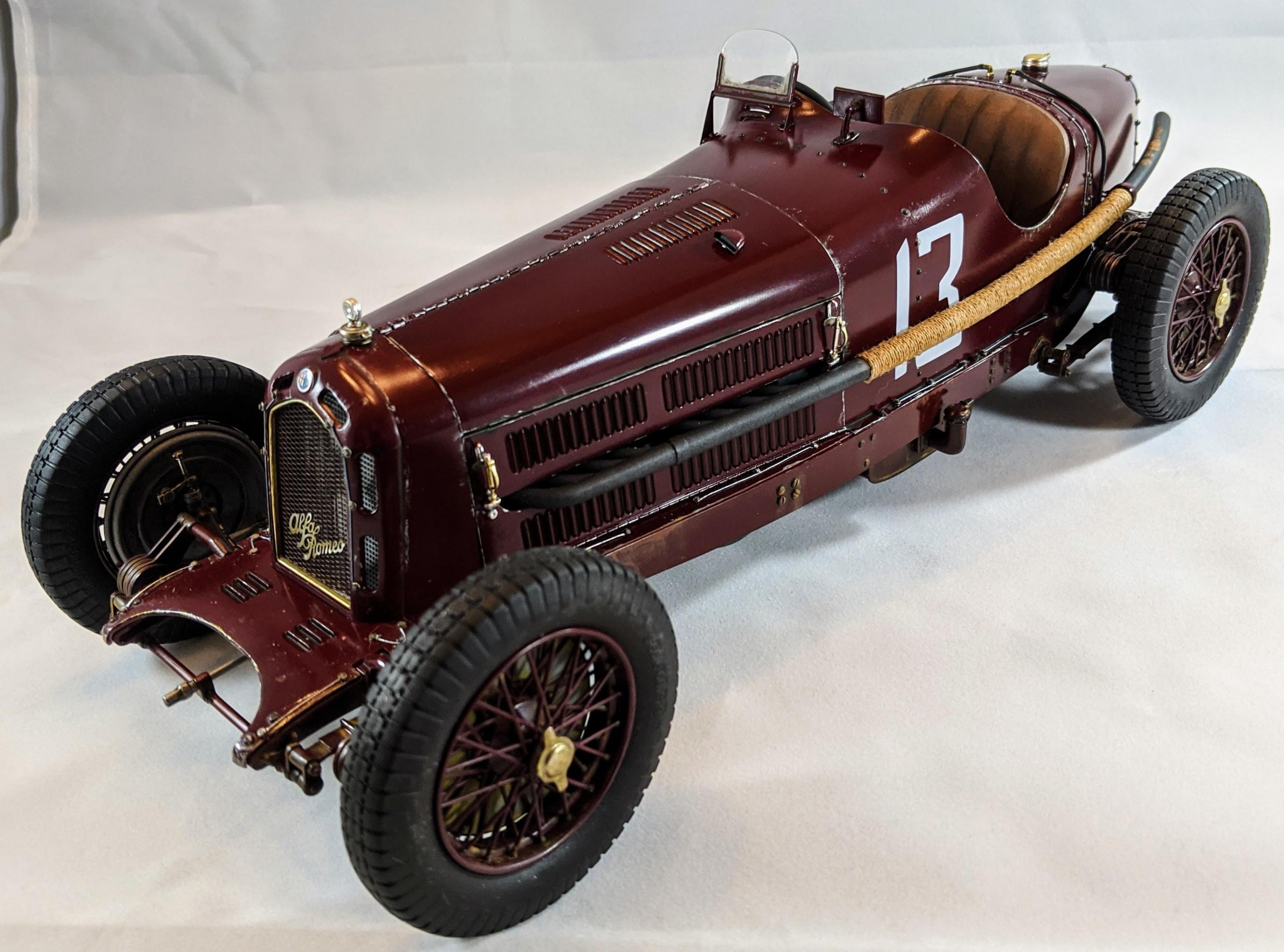

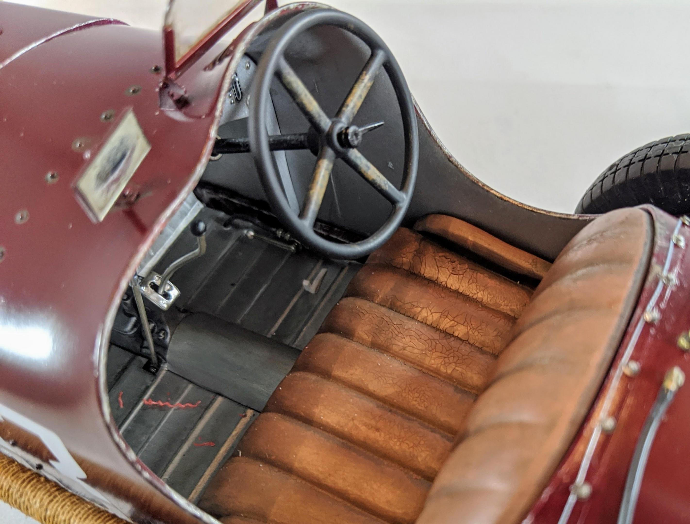

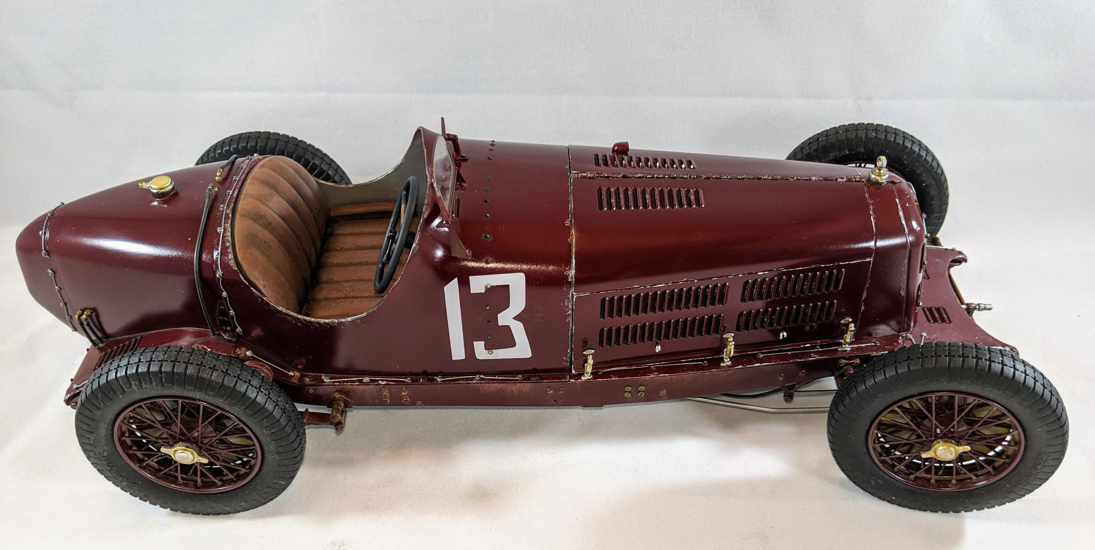

This was my big coronavirus furlough project- Italeri's new release 1/12 Alfa 8C kit. The kit is extremely well-detailed right out of the box., but I added floorboards made from thin aluminum sheet, some underhood details such as braided ignition wires, and lots of styrene rivets and bolts from Tichy Train Group. I also added safety wire using more Tichy bolts and silver-painted thread. The rear-view mirror was scratchbuilt. My concept for this build was to depict a weathered car a few years into its career, so I pulled out every trick in the book to represent a well-maintained but battle-scarred classic racer. Paint is Tamiya maroon over red oxide primer. To keep the shine down and give the finish a faded translucent look I applied mist coats without the final wet coats. Weathering was done with Testors acrylic and enamel washes and drybrushing with Tamiya flat aluminum and metallic grey. Final weathering was done with Tamiya's excellent Weathering Master powders. I used a crackle medium to represent the cracked leather on the seat. There is a WIP thread under the Road Racing WIP forum.
This kit went together extremely well... my only fitment issues were due to some of the modifications that I did and were easily fixed. A lot of this kit goes together with screws and bolts. I did decide to skip the screws that attach the body to the chassis after a near-disaster with the first screw. On to the pics, and any questions or comments are welcome!

Wonderful pics you've posted Jason.  The ones taken outside in b & w look so much like a vintage pic of the car.  If not for the bricks behind it, I would have sworn it was the 1:1.   Fantastic!  cheers, tim
