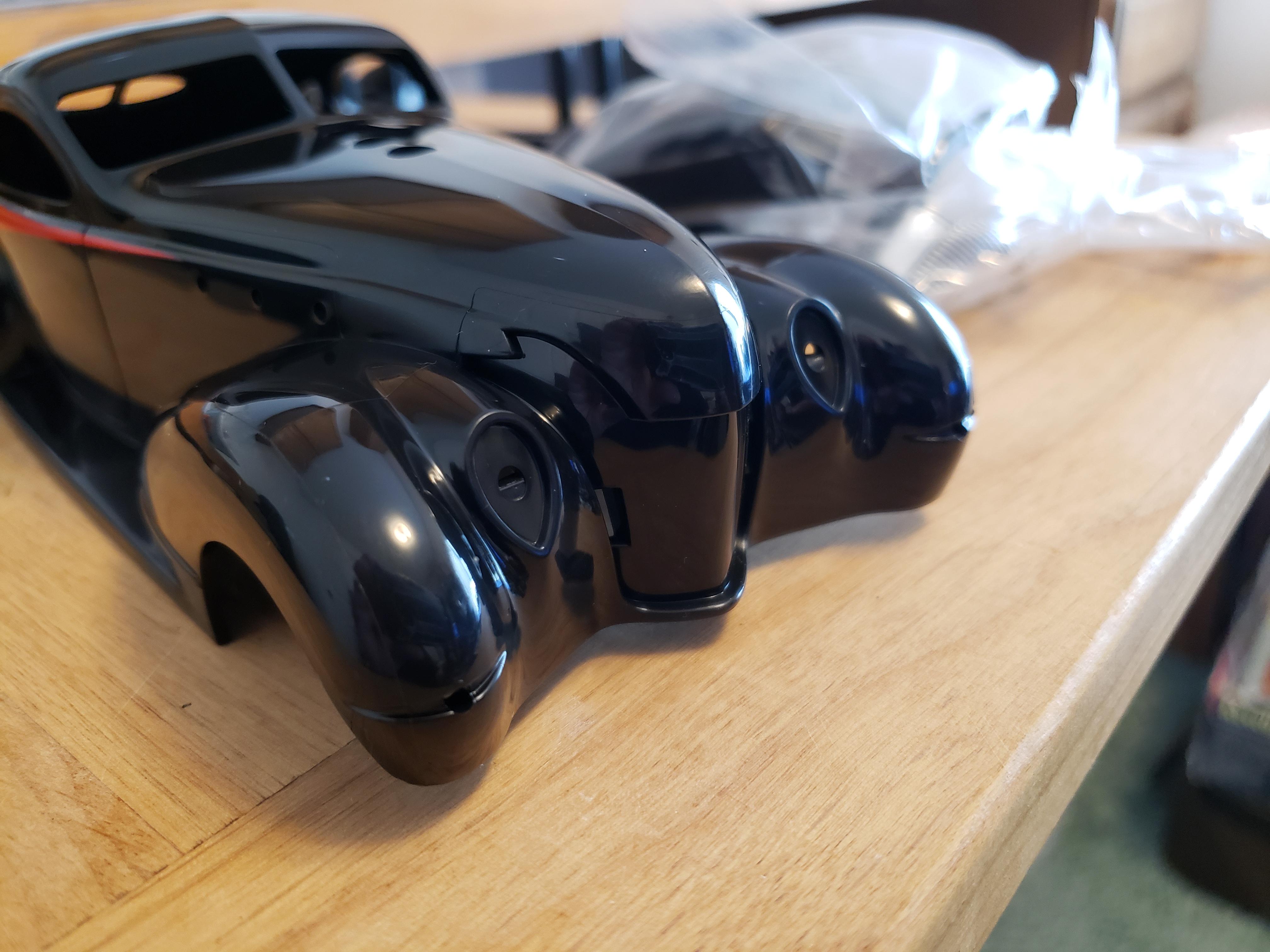

Thought I'd have a bash of converting the AMT 37 Chevy into a Pontiac.
My old man bought this 37 Pontiac 8 conv at the tail end of 2018, but its been off the road since '83 when this pic was taken, paint is peeling, and non running. Condition isn't quite the same as it was back then...............
Starting off with 2 kits as I need to lengthen & modify pretty much everywhere.
Lengthened the doors (4 an a little bit inches) and interior space, along with the chassis.
Until this virus is over I probably won't be able to get to the garage to get any more measurements on the body or chassis.
Made a start with the engine. Cut the block halves up, but didn't notice the blocks are cast slightly different in the kits. Doesn't matter as the file made 'em close enough for me.
Added the ribs on the head, , still have more bits to do (starter, thermostat housing etc). Scratched up the oil filler, downdraught tube, and changed the dizzy out for an 8 cyl one.
Gearbox I dont think is  close to right but will do.
Intake, exhaust & chrome side cover from a 32 Chrysler, SBC water pump (attacked with a file), timing cover from the original kit but cut down a bit. Sump is just there to hold the engine up for now as not sure what to use yet.
Intake and exhaust are too high on the block in the pics but its just mocked up.
Hopefully it'll end up looking summat like these :
It won't be 100% accurate (I know my skill limitations.....), may not even be pretty or get finished before the 1:1 !  but I'll have fun and you get to laugh as I turn 2 kits into a pile of styrene dust and get in way over my head :)

Very impressive engine work. You mentioned that you extended the bodywork. You have the car to make exact measurements from, so the Pontiac is 4 inches longer ? Is the additional length in the body or forward of the Firewall or Cowl ?
Share this post
Link to post
Thanks guys, its longer in the doors, rear quarters (at least behind the doors, not sure on trunk area), front fenders, cowl & A posts are different shape too.
Possibly the only thing that might be close but no cigar in length is the rear fenders but havnt measured them yet to find out.

Your engine pic's are all 8 cylinder. unless someone replaced the engine in in you dad's car, the 37 Pontiac was a 6. The AMT 37 Chevy had tubular front axle and no real frame. The 37 Pontiac had knee action front suspension and the typical GM x frame. Here's a link to the 37 Pontiac brochure. http://www.oldcarbrochures.com/static/NA/Pontiac/1937_Pontiac/1937_Pontiac_Brochure/1937 Pontiac-17.html.
A reference to the 37 6 engine
The water pump should look like this.
If you are happy with what you have, then go for it. If you want some help, let me know. Check out my 35 LaSalle convertible coupe 3d printed in this section.

Thanks all, Peter I did look at the 41 Plymouth as a possible donor for the hood, but havn't decided yet, may use the Monogram 39 Chevy. Agree there's nowhere enough pre 50 non Fords in styrene, which I'd love to see.
Doug, thanks for the info, The chassis & suspension is on my list of things to change but I need to get to the car to get the info I need.
You may want to recheck the link, the first pic shows Pontiac 8 Deluxe, as far as Im aware the only model in the 37s that didn't come with an 8cyl was the woodie. You'd be hard pressed to stuff the 8 in a car that came with the 6 originally. The 8 was available (in varying displacement) from 1933 - 1954, then came the V8. Though there are some differences externally otherwise its pretty much the same block.
