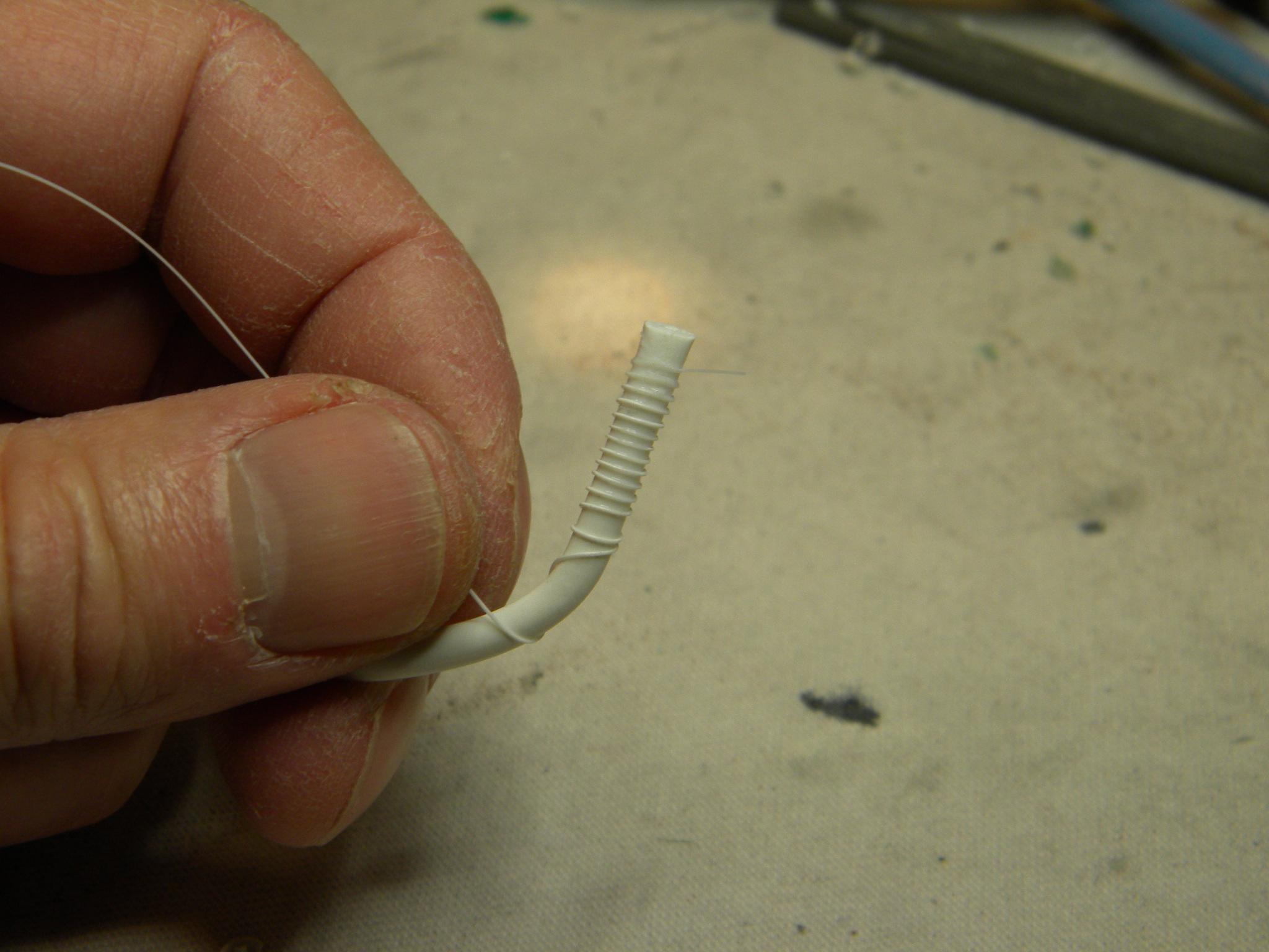

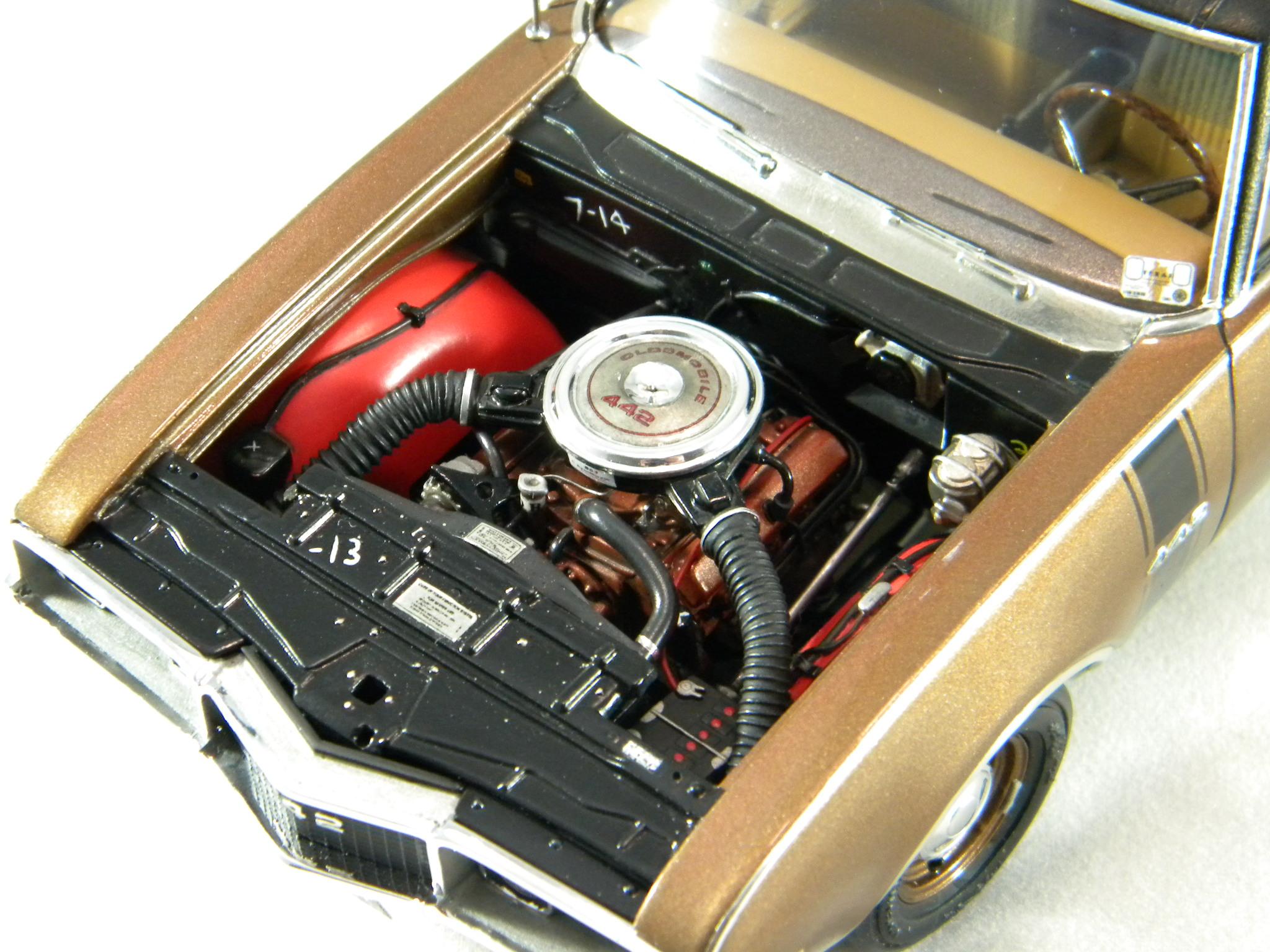

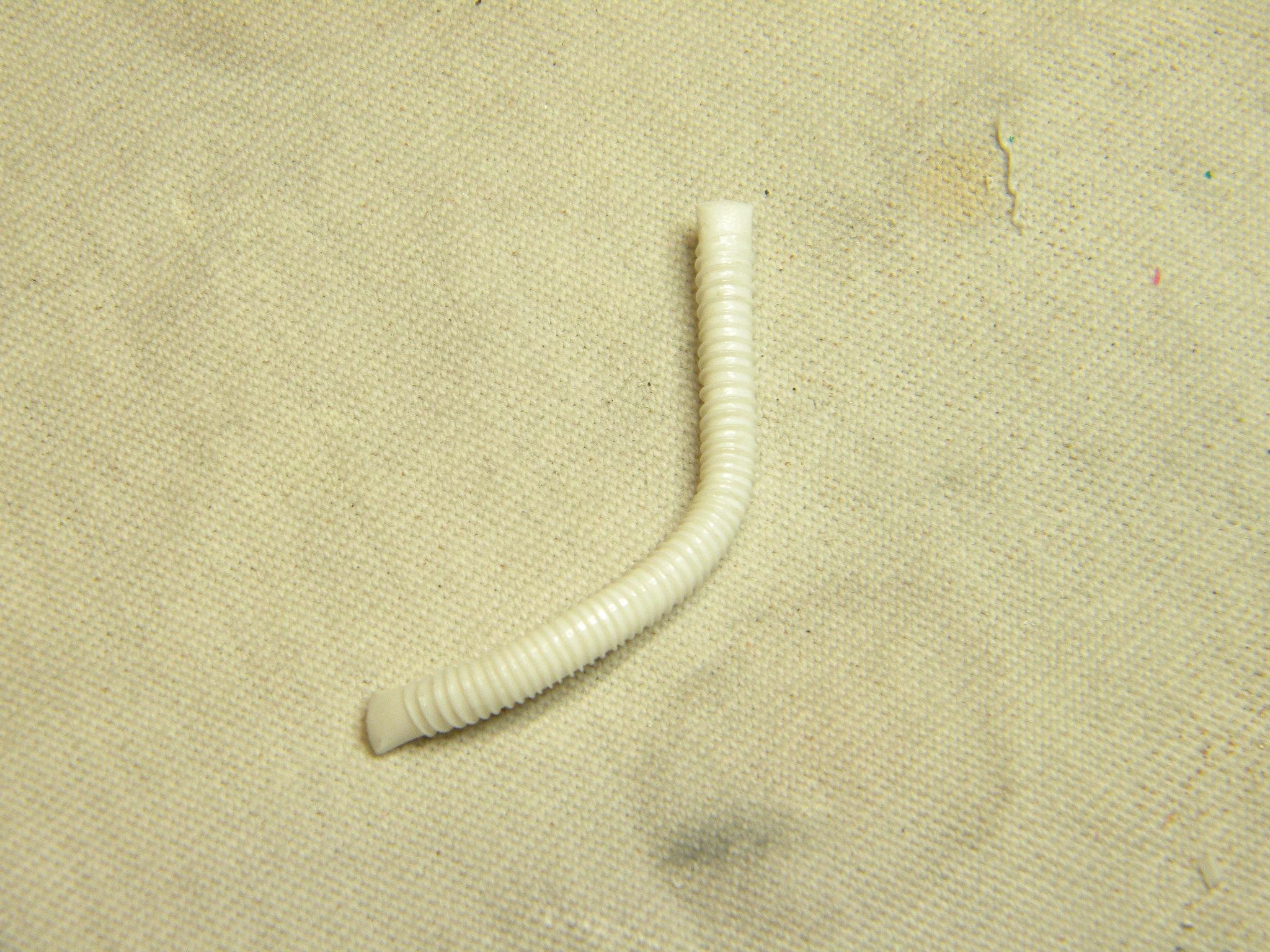

Using a MEK based liquid cement, you can work your way around a little bit at a time.
Not exactly the same, but I used a similar technique for the intake hoses on my '68 442 project.
Of course it's a little more time consuming with thicker plastic, but it's absolutely do-able.
Steve
Steve

I do a fair amount of scratch building using mostly polystyrene sheet and shapes. I typically will pre-bend strips around a similar shaped object to avoid breakage and always gradually attach using CA glue and apply kicker to be sure the parts don't come loose. When working on things like those strips on a vinyl top mentioned above I recommend drawing a nice straight line in pencil to help parts aligned correctly.
As an alternative to always using round styrene like the air intake tubes shown  earlier I would suggest using copper wire applied with CA. It achieves the texture you want and conforms well to curves.
