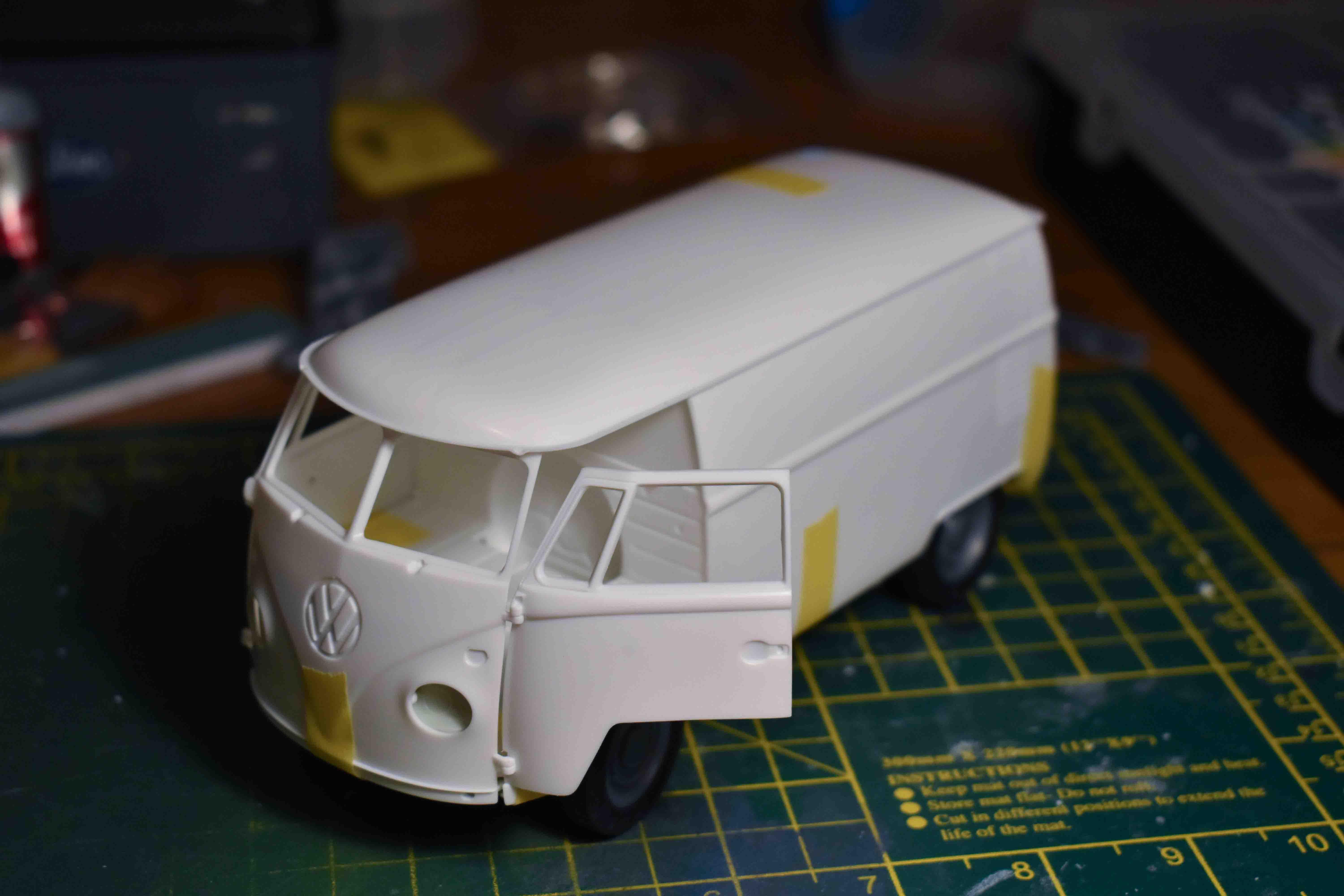

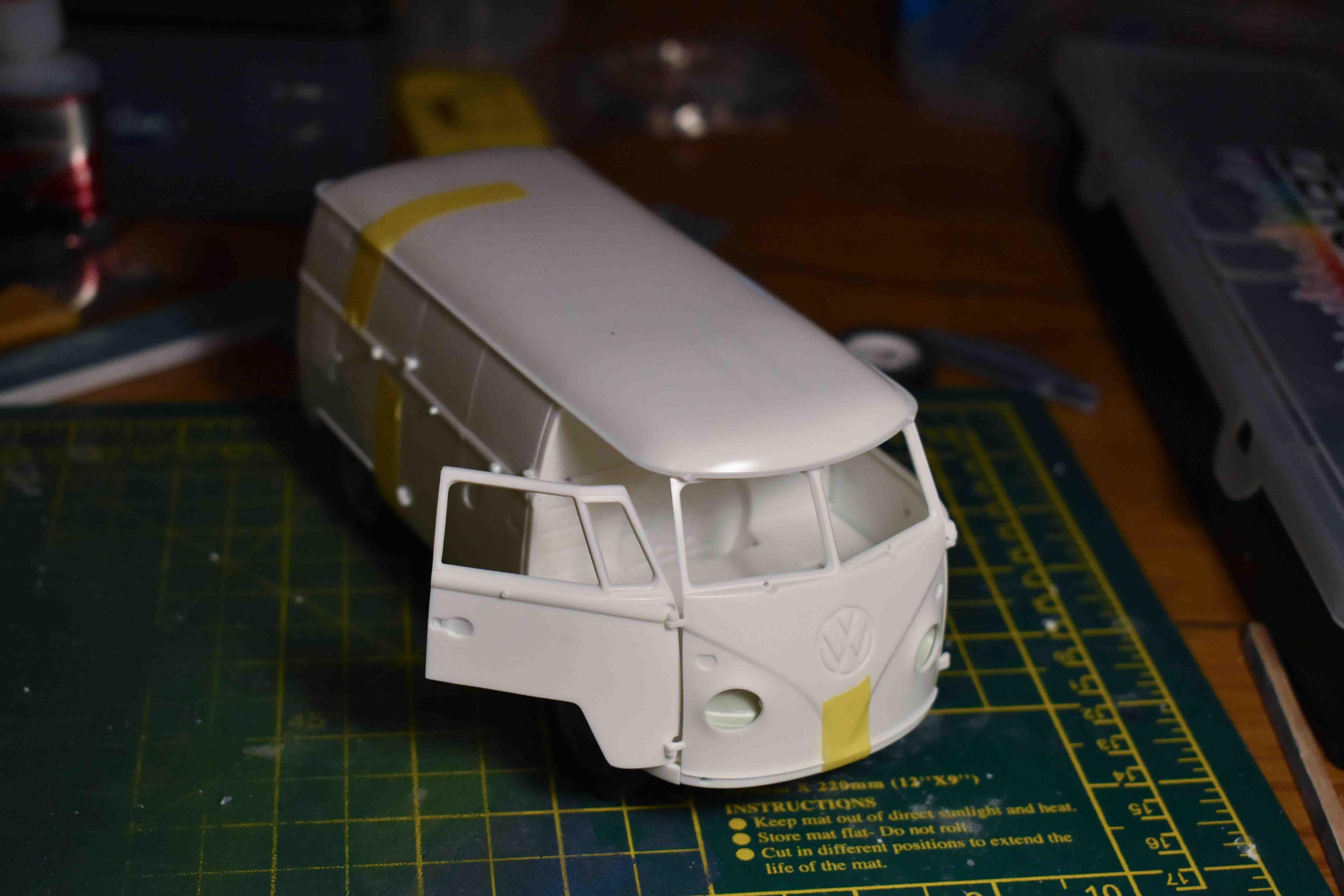

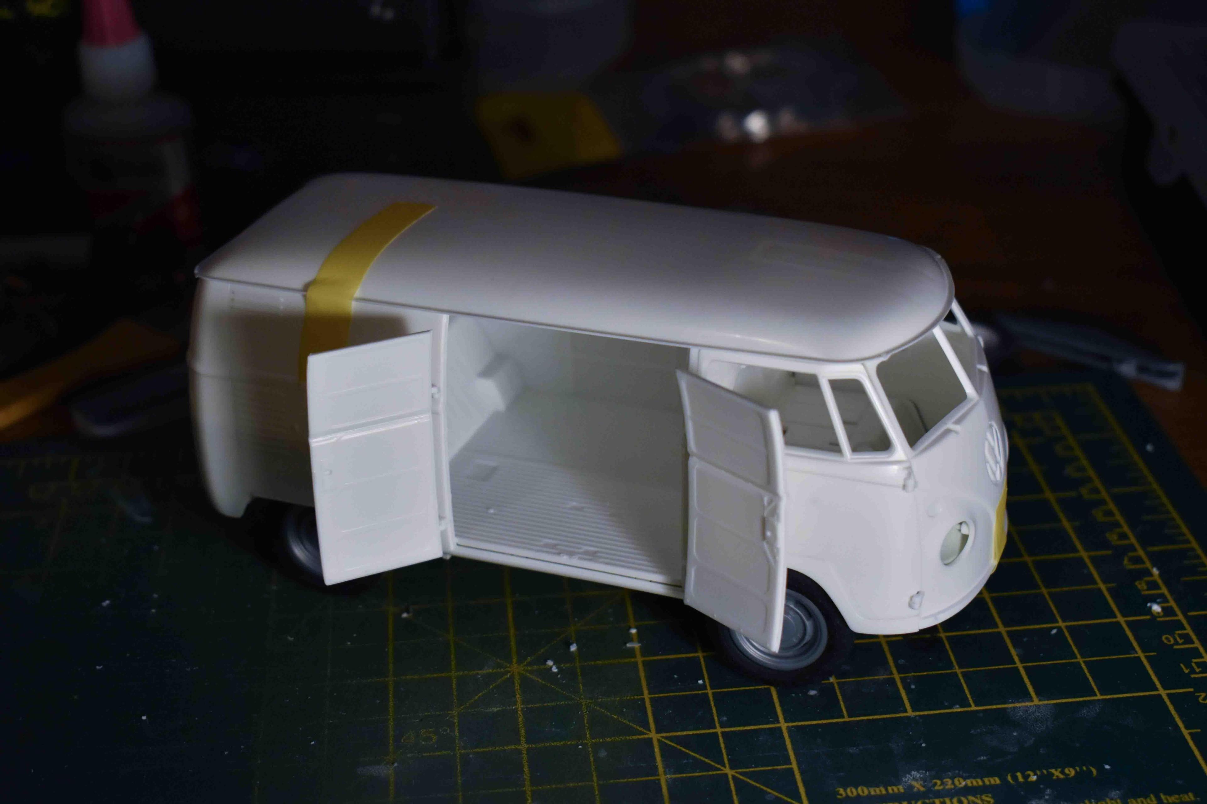

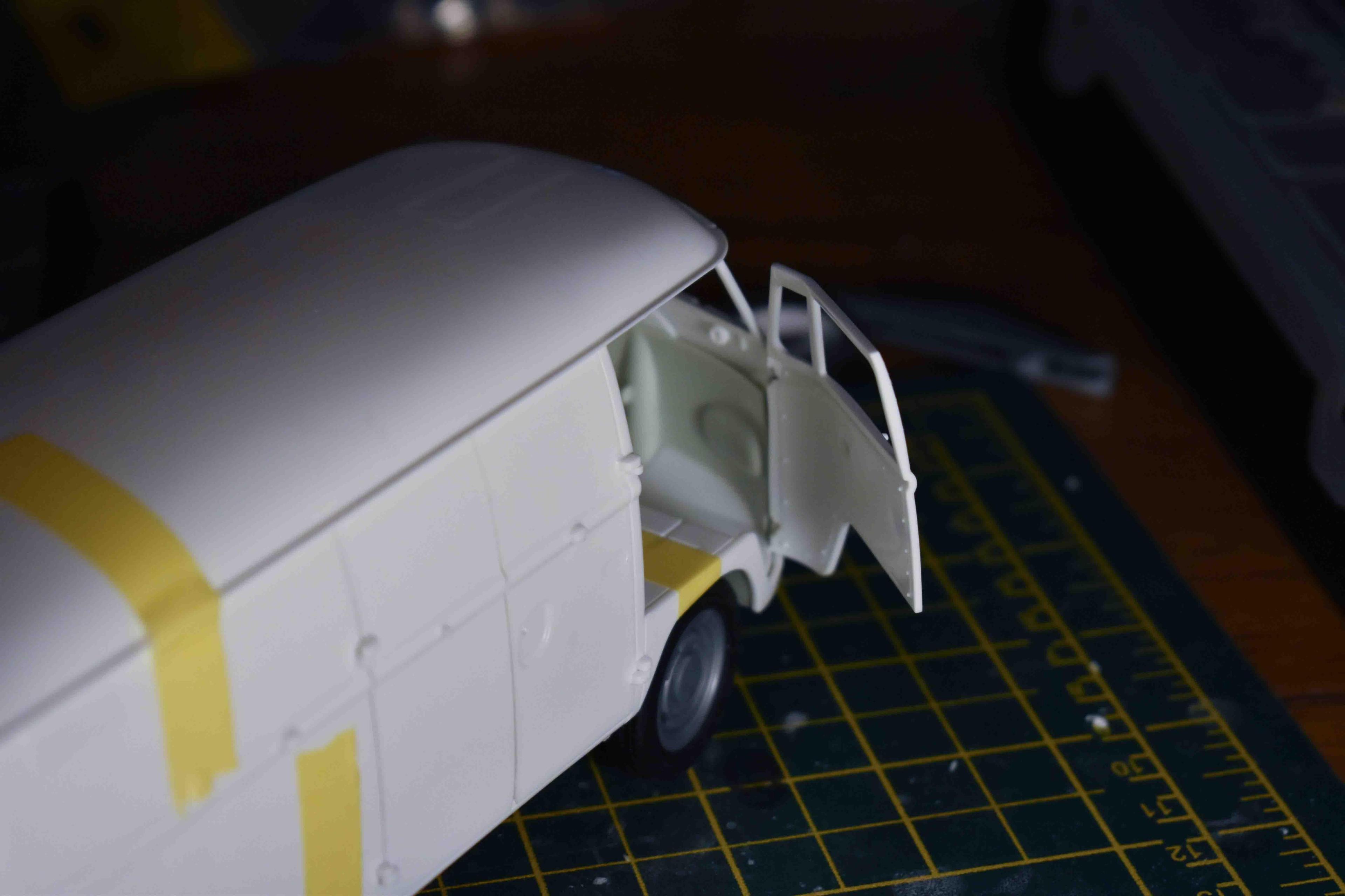

Photo 2-6: since this kit has loads of opening doors I'm just doing a fitting test. I tend do o this with all my build anyways. Everything fits quite nicely on this kit. I just had to sand a bit the front doors.

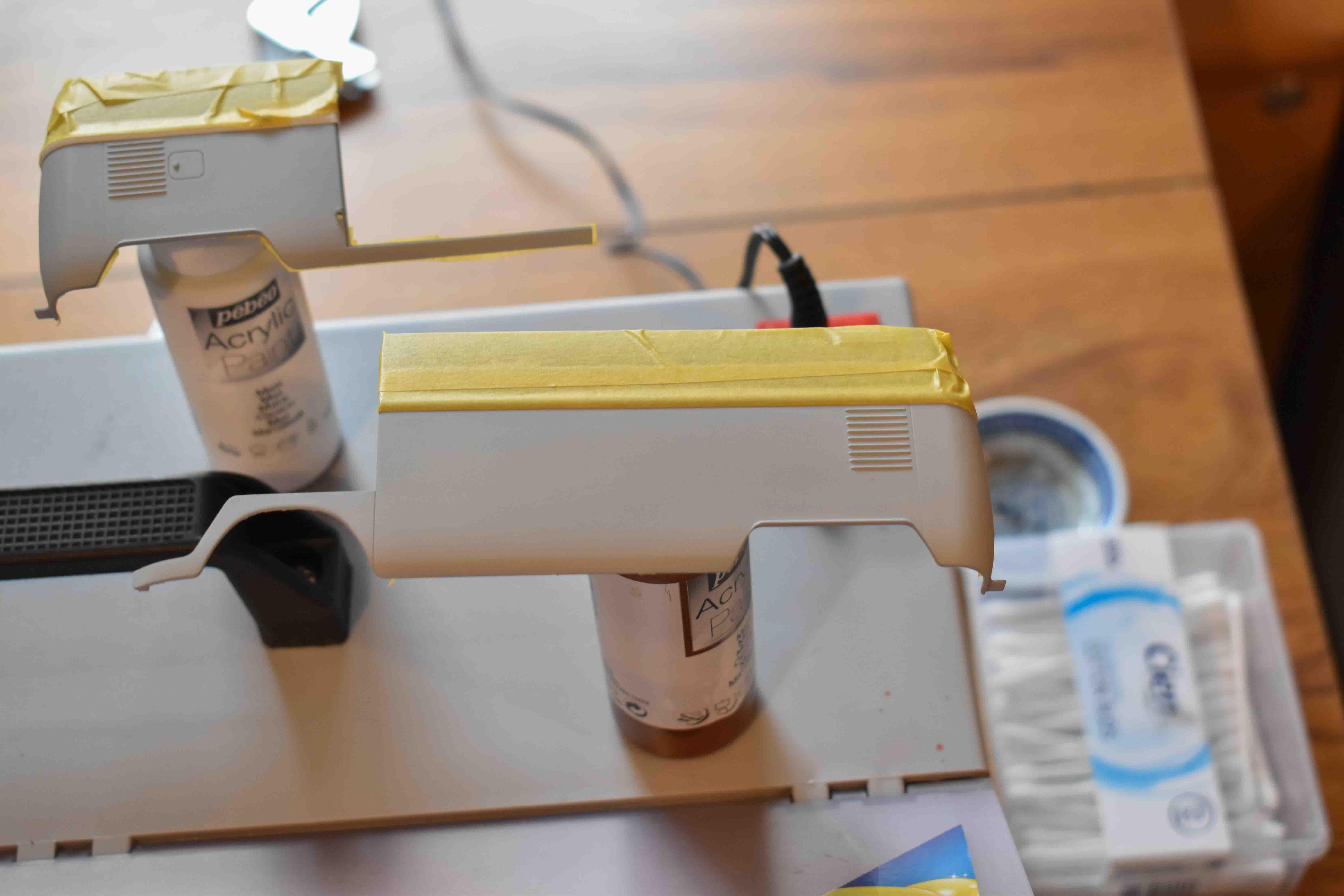

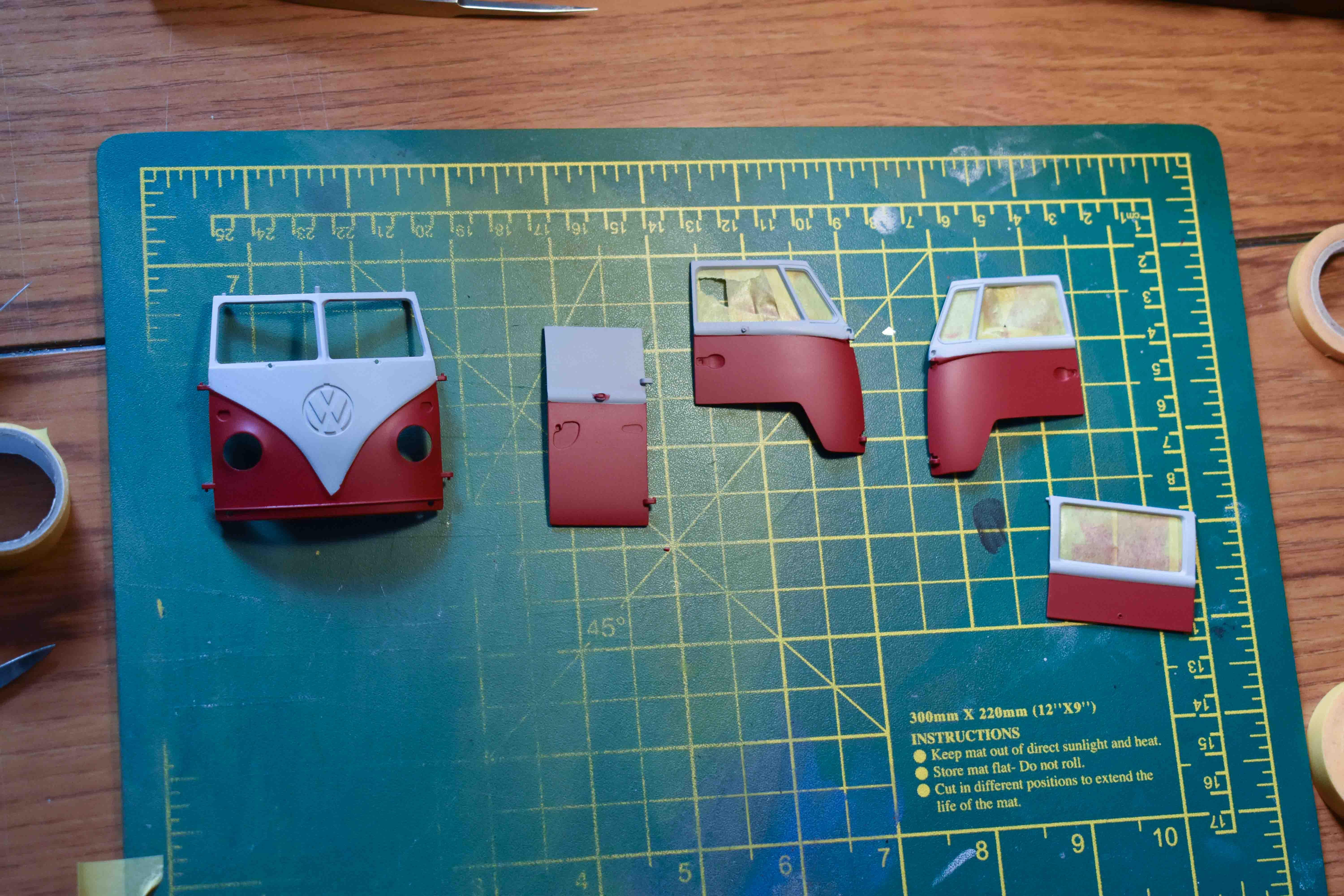

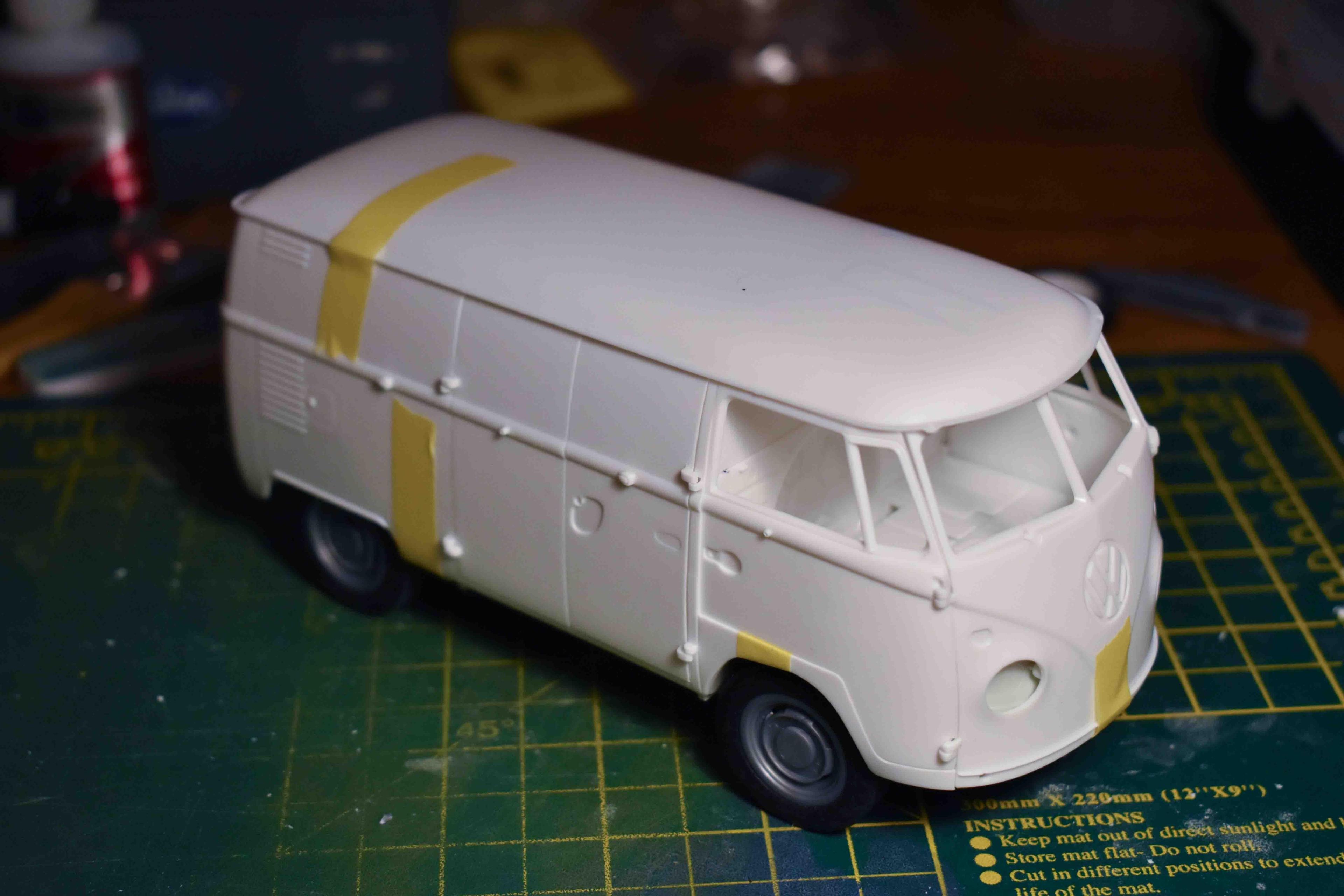

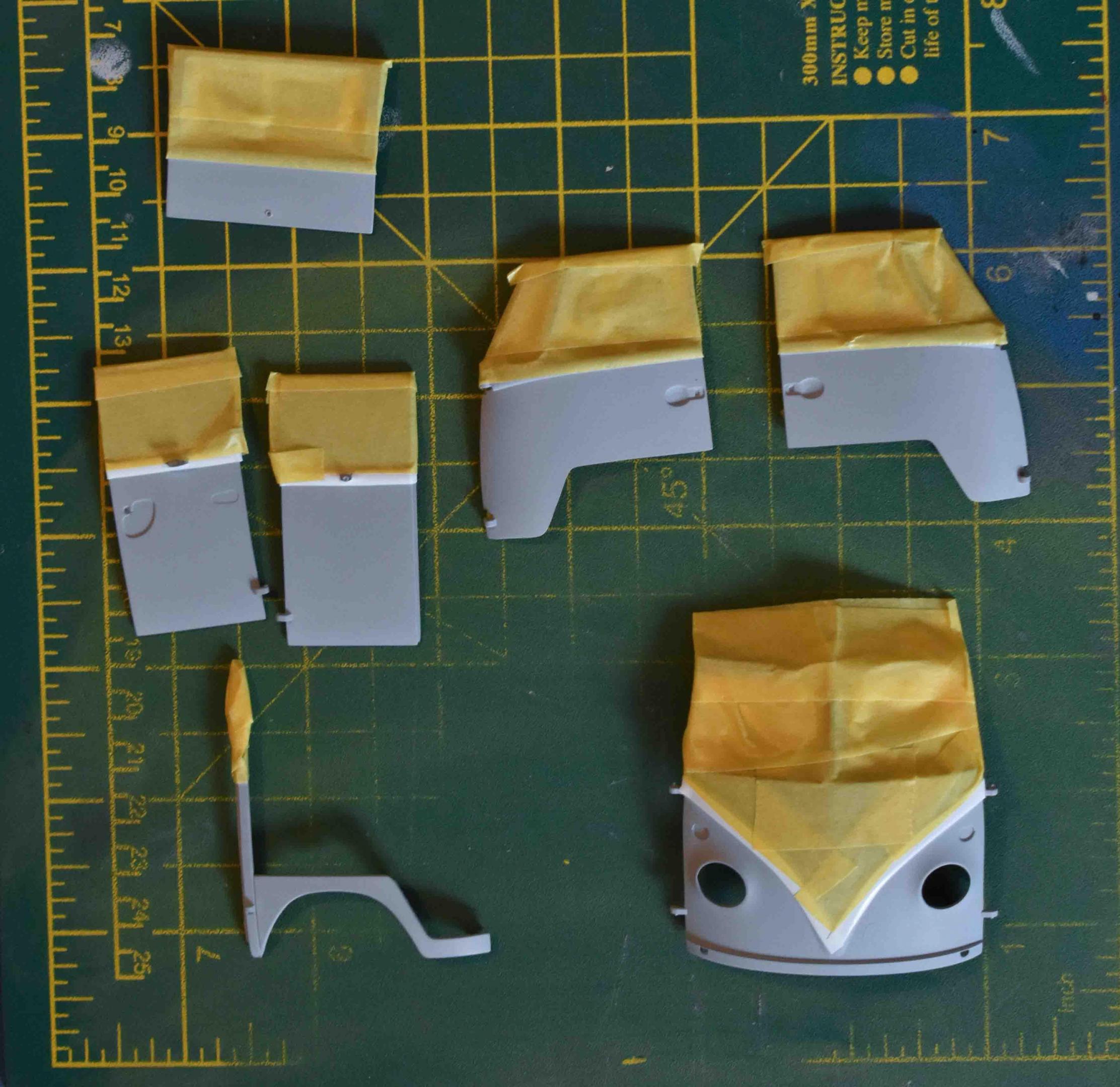

Photo  7 and 8: after applying the primer and some masking to paint the red half

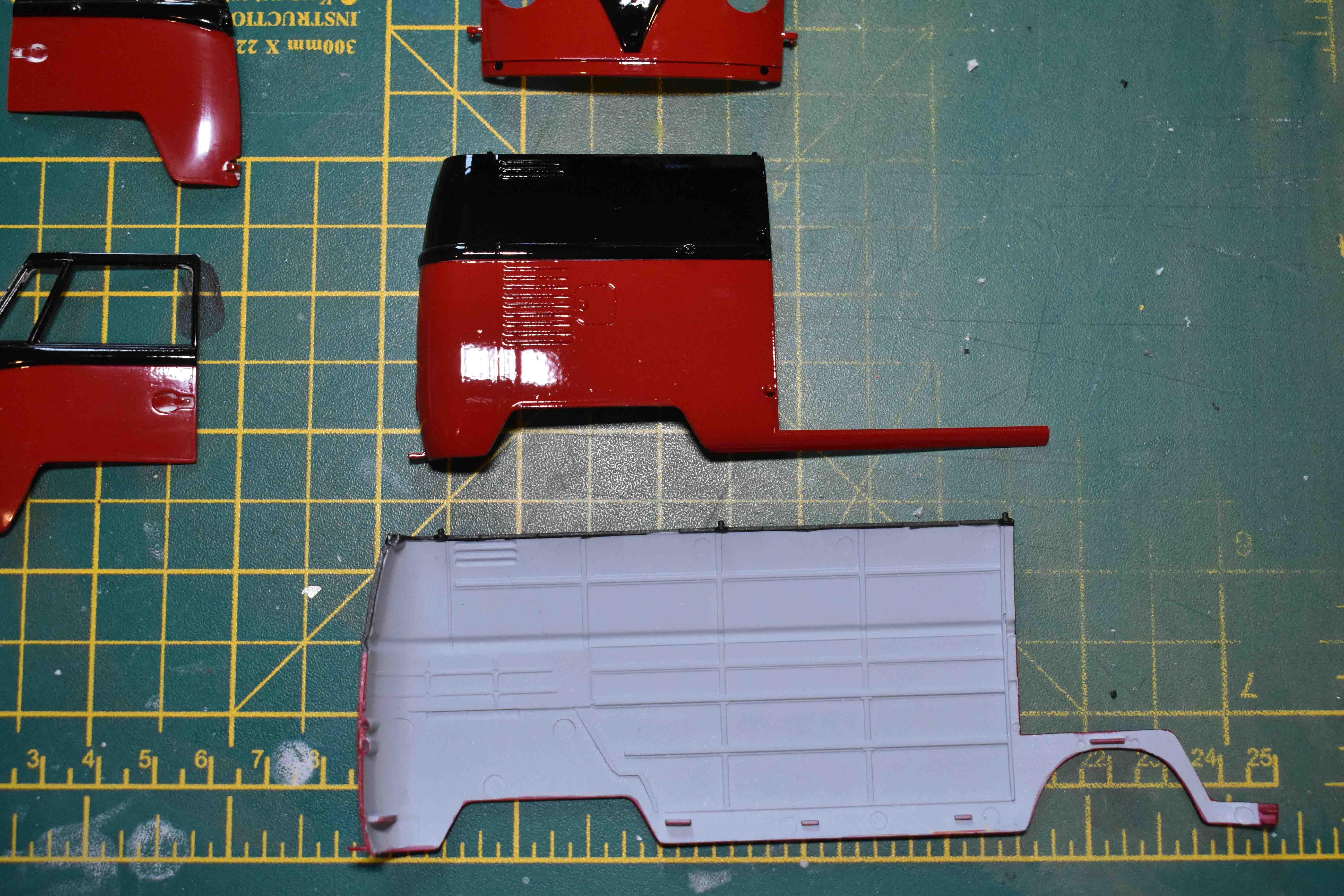

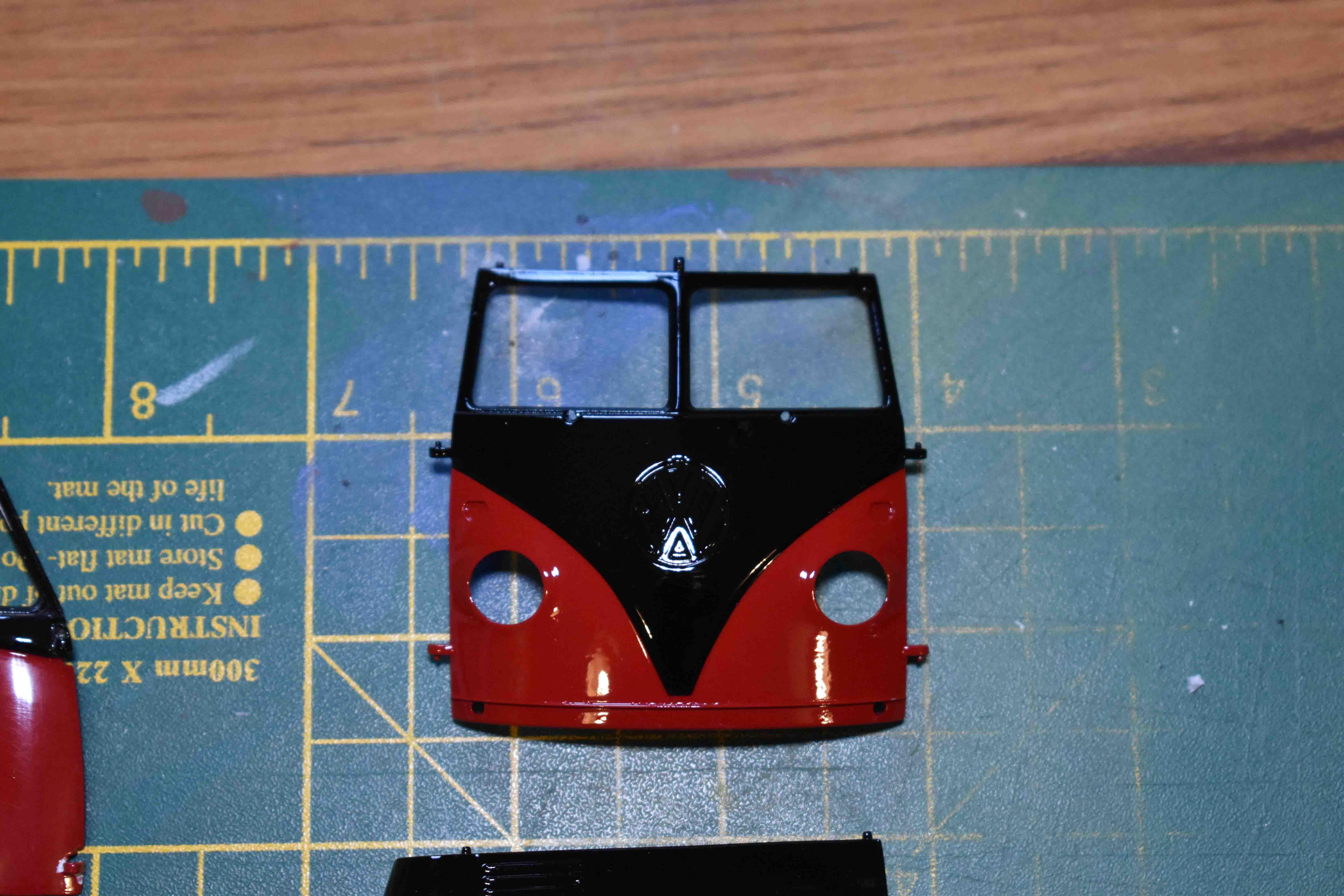

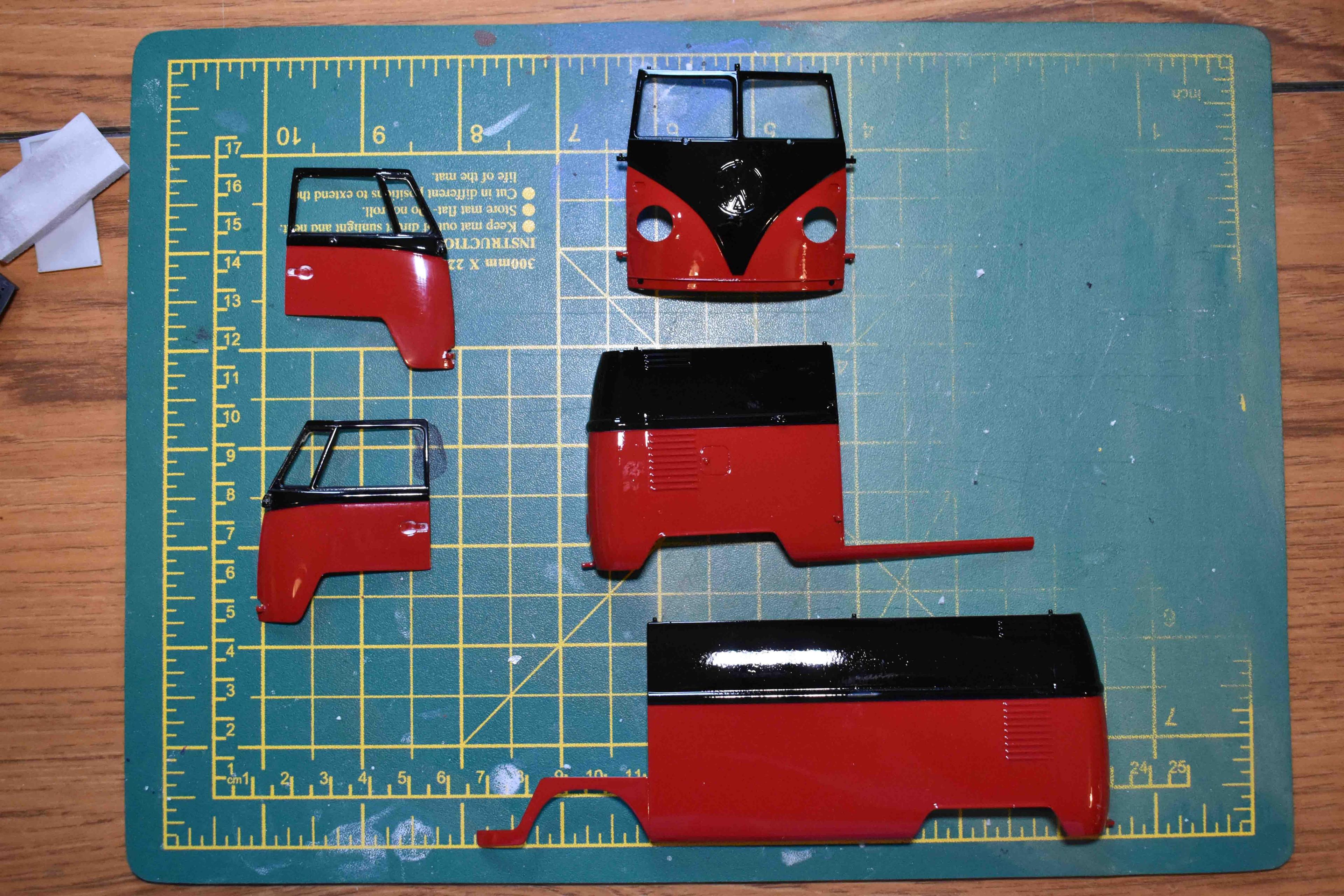

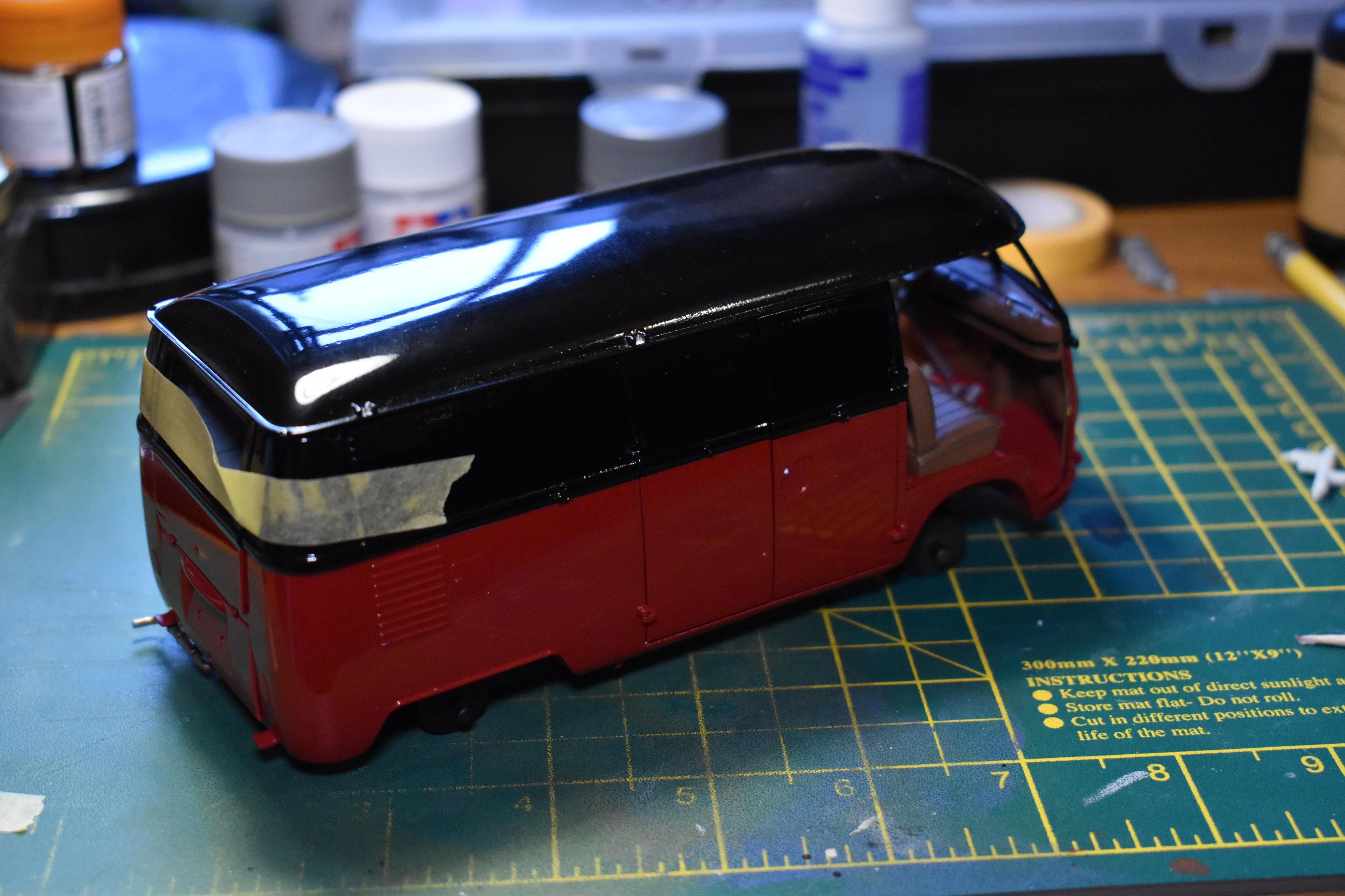

Phto 9-11: after the base coats and clear have been applied. I still feel like I have to improve my 2K clear application. I'm still getting some orange peel. Hopefully I can get rid of it doing some micromesh sanding and polishing.

Paint looks great on this. I've always had an interest in these vans. Looking forward to more.

Looking good so far!  I built one of these last year, watch the hinges for the front doors on the front panel, they're really delicate.  It might be an idea to shorten the attachment points a little bit so it is easier to fit the front doors on as the hinges easily snap off the body (I wonder how I know that!).

Thank you Joe. I still want to grind and polish the paint job to make it more even but still waiting for the compounds and micromesh. Some deliveries are taking forever these days for obvious reasons. Once I get it I will posting some updates.

Hahahaha thanks for the warning and the advice Jim...I will watch out for those ;)

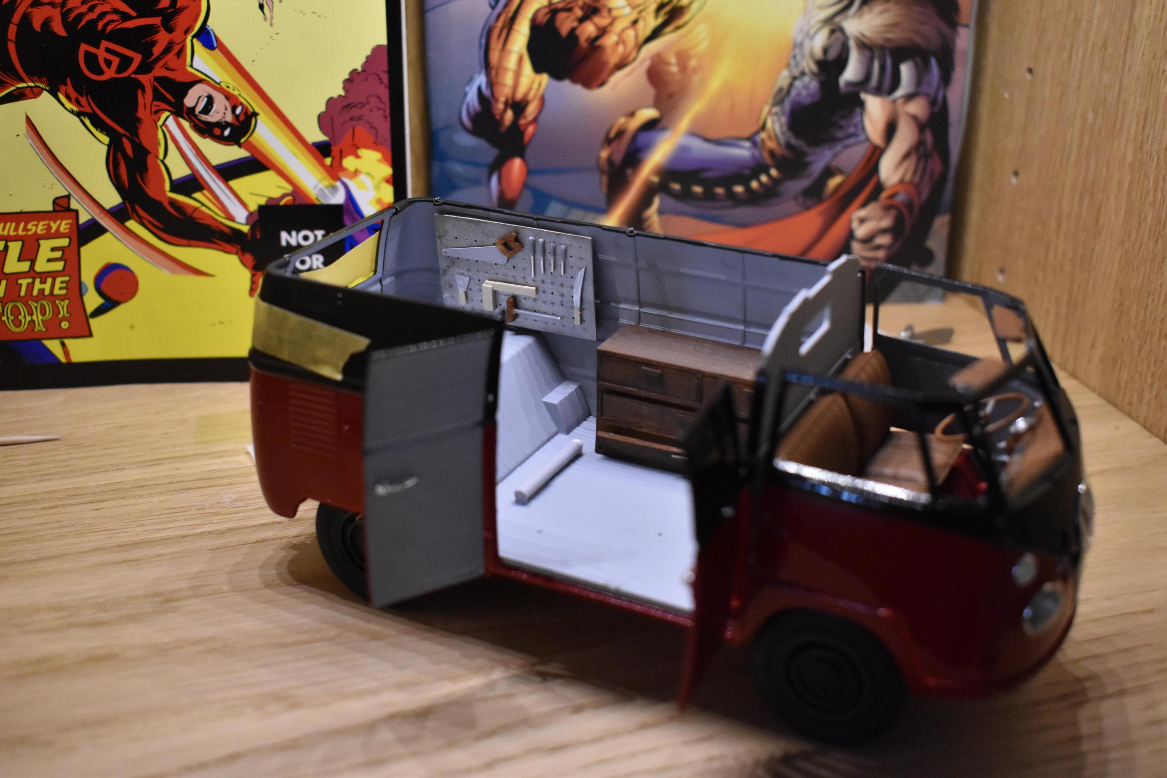

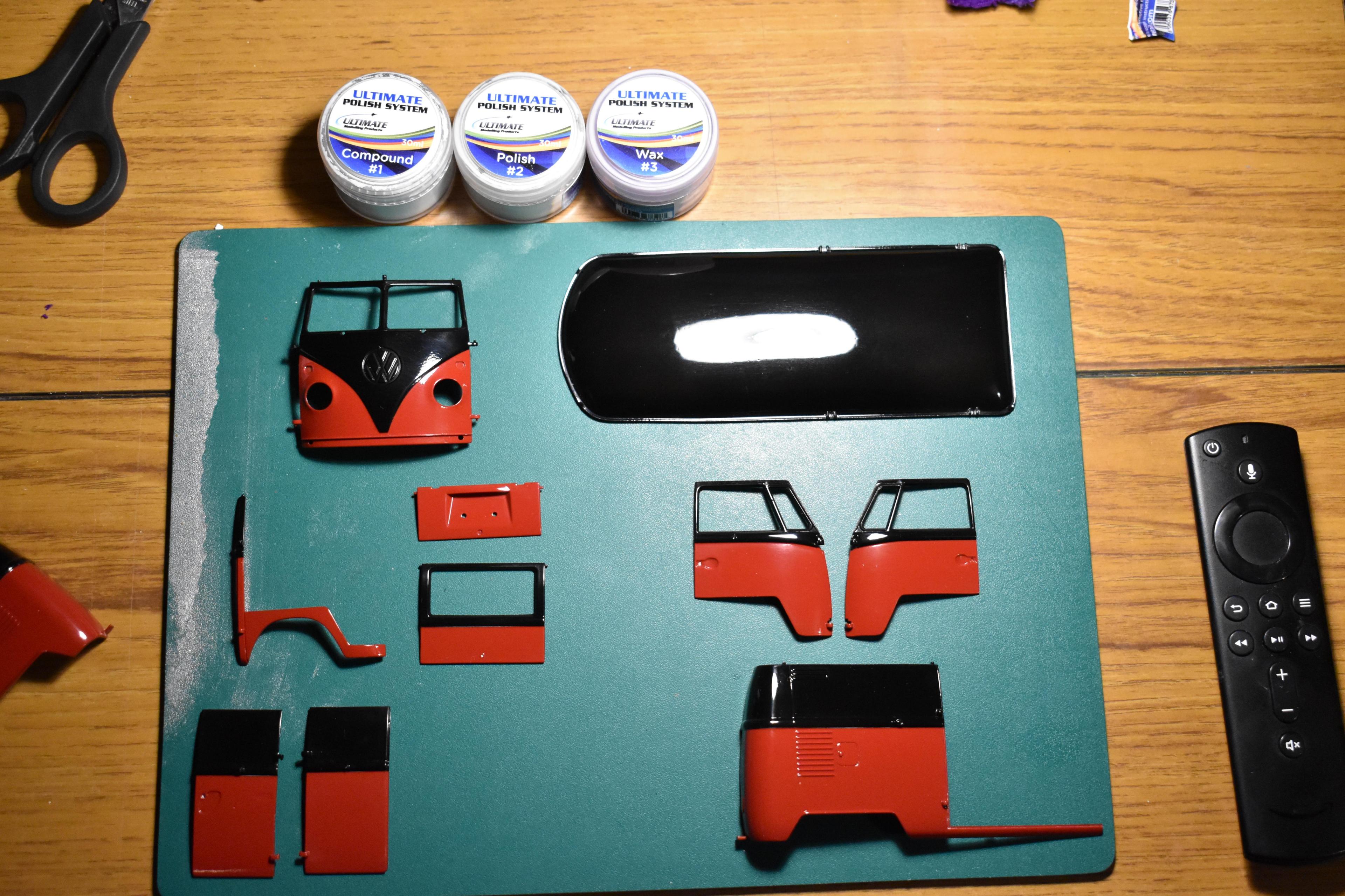

I sanded the 2K clear coat with micromesh (6000-12000) and then polished the body panels with the "ultimate polish system". The assembly of the body is done now. You can also see a tool rack and kind of a tool box that I scratch built for the interior. I only need to add the windows and a few more details and this build will be done.

Excellent build, really like the color combination and the details you have added to the interior.  I had a '72 Westphalia which I traded for a '78 Rabbit, boy was that a dumb move.

I like how you're doing the interior. Peg board and tools look just right here.

Very nice and cool build Armando!  The finish of your paint job along with your choice of colors is superb.  Very good scratch building done on the interior and on the tooling too.  You will soon get a call from Dave Kindig, this guy is crazy of these VW Vans!
