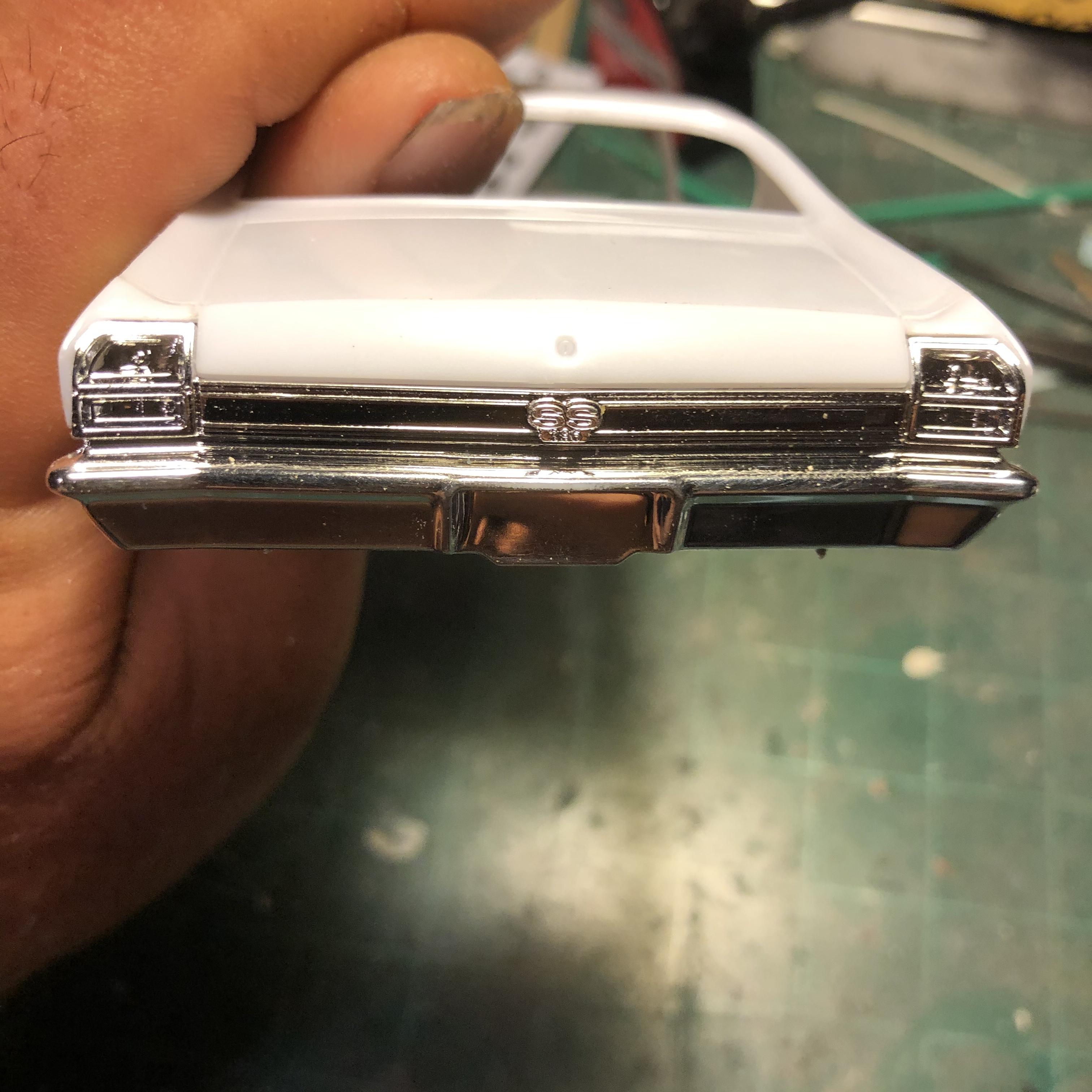

It looks to me based on Steve's photo above that there is a extra piece of trim molded just above the bumper and below the tail lamps that doesn't exist in my reference photos which is placing the bumper noticeably lower then it should be.   I don't have a kit in hand yet but here's a good 1:1 photo for comparison.  Does anyone else see what I'm talking about ?

Thats what i see, i dont have this kit yet  but its in the que to add to the stash.Im thinkin try to cut the bumper off the tail lights and remove the extra space?Lookin forwad to see how folks handel this.
-Steve

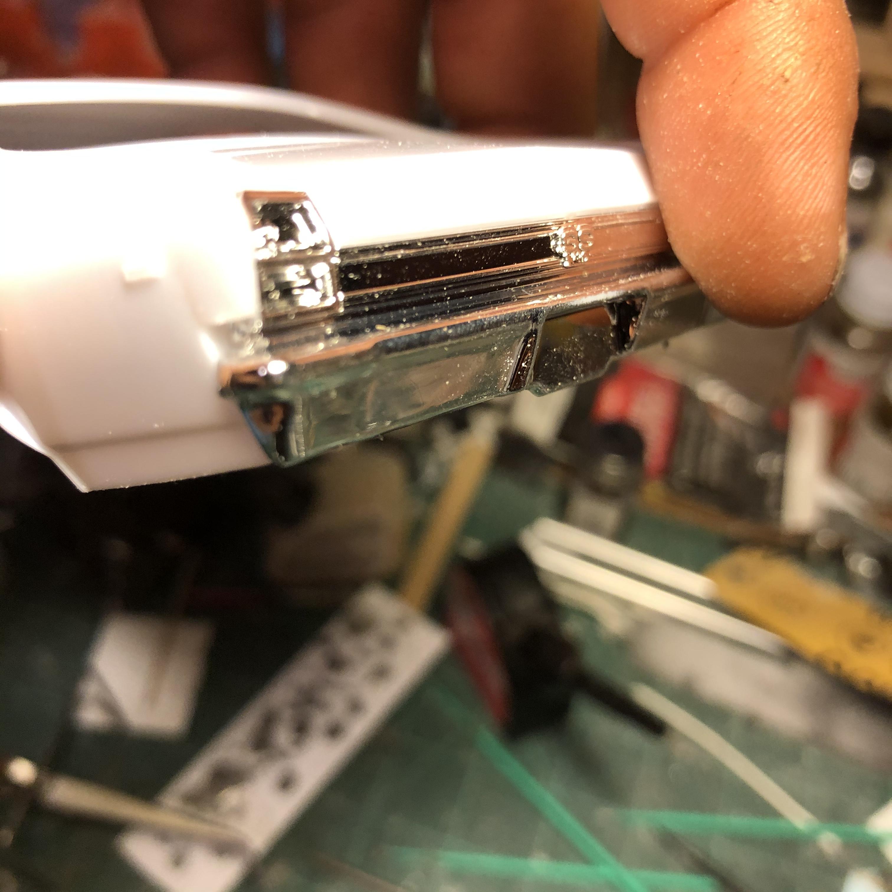

I busted open a kit and took a look. There is a gap between the top of the bumper and the bottom of the tail lamps/trim that looks as though it should not be there. This is causing the gap under the tail lamp caps you see from the side. Thought of cutting the bumper off and moving it upwards , but then that would leave a gap under the bumper where it meets the end of the lower portion of the quarter panel. I suppose you could cut the bumper off, then taper the lower quarters to meet the new bumper height, but that could throw the look off even more. Need to hunt down a good side picture and compare the quarter panel taper in that area.

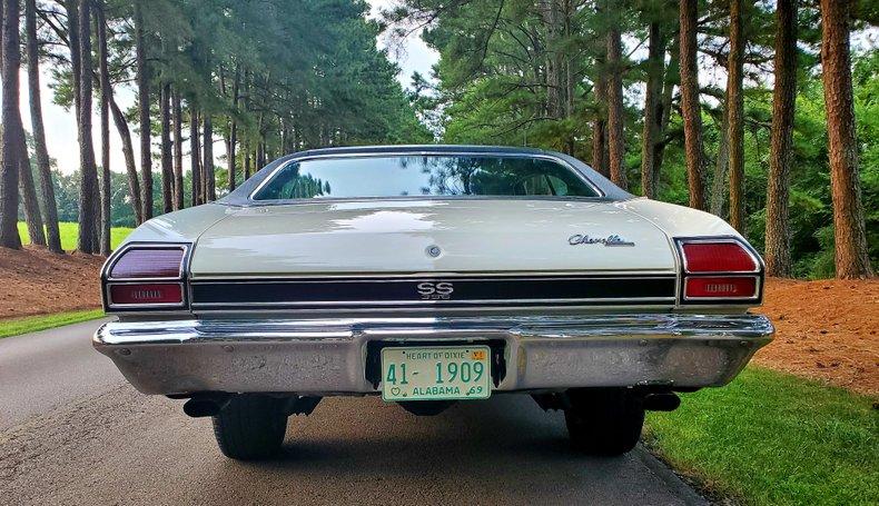

After a quick photo search, there is a noticeable gap in this area on the 1:1, more noticeable on lighter color cars.
(all pics in this post borrowed from the internet )

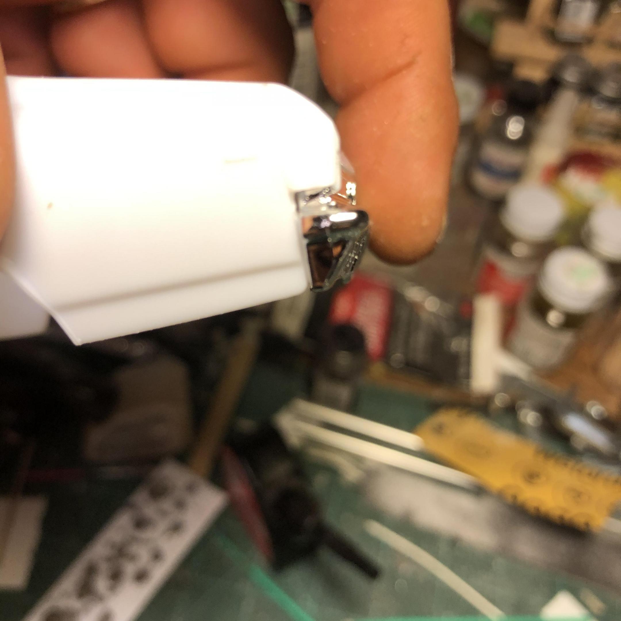

The gap on the model is 1 1/2 to 2 times the height of the side marker lamp for size comparison purposes. None of the 1:1s have anything near that much gap. It's body colored sheetmetal under there, so that is why it is more noticeable with lighter colors on 1:1, especially restored cars that are clean in there.
I have trimmed the taillamp openings a bit on mine, also the bottom lip of the decklid. The taillamps fit the body much better and the gap is lessened. My trimming has made the bottom of the taillamp flush with the quarter endcap, as it should be. Not sure what the next step is though. I may separate the bumper and make a new, smaller filler panel and call it good. The bumper doesn't hang below the quarter on the 1:1, so moving it up a little (not flush with the taillamp bottoms) may make it acceptable.
