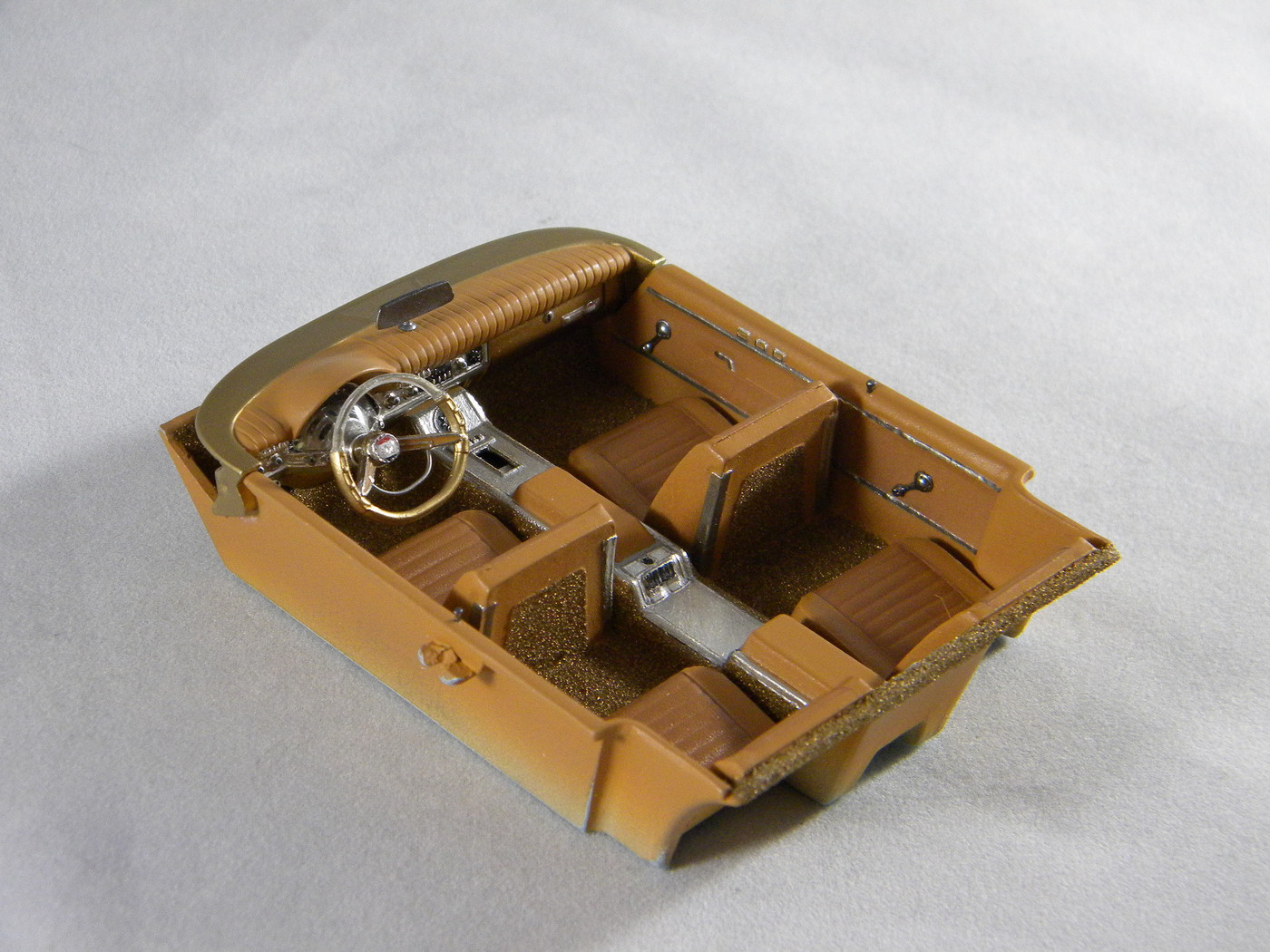

StevenGuthmiller Posted May 13, 2020 Share Posted May 13, 2020 If you're ever planning on building a '60s Pontiac or Mopar with a transparent steering wheel and you are looking for an easy way to achieve that slightly yellowed look that they inevitably had, look no further than a can of Testors clear gloss enamel spray paint! It comes right out of the can a nearly perfect match! I've finally discovered a good use for this subpar product! Before. After. Steve Quote Link to comment Share on other sites More sharing options...

StevenGuthmiller Posted May 15, 2020 Author Share Posted May 15, 2020 Thanks guys! I know that this is something that will rarely be used by most modelers, but strangely enough, I've converted quite a number of old Johan Mopars and AMT and MPC Pontiacs to transparent steering wheels. I wish that I had thought about this a dozen steering wheels ago. Steve Quote Link to comment Share on other sites More sharing options...

StevenGuthmiller Posted May 16, 2020 Author Share Posted May 16, 2020 (edited) 1 hour ago, CabDriver said: I never used that Testors enamel from a spray can before - is it pretty thick and syrupy like the stuff in a jar or does it go on in pretty light coats? Cool tip either way - definitely storing this one away for future reference! It's about the same as other Testors gloss spray paints. In all honesty, it's a pretty good clear coat for certain applications. It levels very well and shines like crazy straight from the can. On the other hand, it's enamel and takes forever to cure completely, and absolutely, DO NOT try to use it on any remotely light colors! It also yellows like crazy........as you can see. Steve Edited May 16, 2020 by StevenGuthmiller Quote Link to comment Share on other sites More sharing options...

StevenGuthmiller Posted May 16, 2020 Author Share Posted May 16, 2020 (edited) 56 minutes ago, Rodent said: I have an original AMT 72 Nova and an original 72 GMC stepside that are Testor's silver with glosscote. After all these years, they have a greenish tinge to the normal yellowing. Kind of look like olive green metallic. Hope your steering wheels don't turn green! My original thought about the aging for the steering wheel harkened me back to a '37 Chevy coupe that was molded in a very light beige that I sprayed with Testors clear enamel probably 30 years ago. It's still this glorious shade of yellow today. Steve Edited May 16, 2020 by StevenGuthmiller Quote Link to comment Share on other sites More sharing options...
Tom Geiger Posted May 16, 2020 Share Posted May 16, 2020 Steve, what kits have clear steering wheels? I know the custom wheel in the old Riviera kit.. that one is in my 1950 Ford pickup ratrod... other sources (and / or aftermarket)? Quote Link to comment Share on other sites More sharing options...
StevenGuthmiller Posted May 17, 2020 Author Share Posted May 17, 2020 (edited) 6 hours ago, Tom Geiger said: Steve, what kits have clear steering wheels? I know the custom wheel in the old Riviera kit.. that one is in my 1950 Ford pickup ratrod... other sources (and / or aftermarket)? The one above is from the AMT 1962 Pontiac Catalina kit. The Moebius '61 Pontiacs also have them. The rest that I have done on old Johan Mopar kits have been converted. Not that hard to do really. Steve Edited May 17, 2020 by StevenGuthmiller Quote Link to comment Share on other sites More sharing options...
