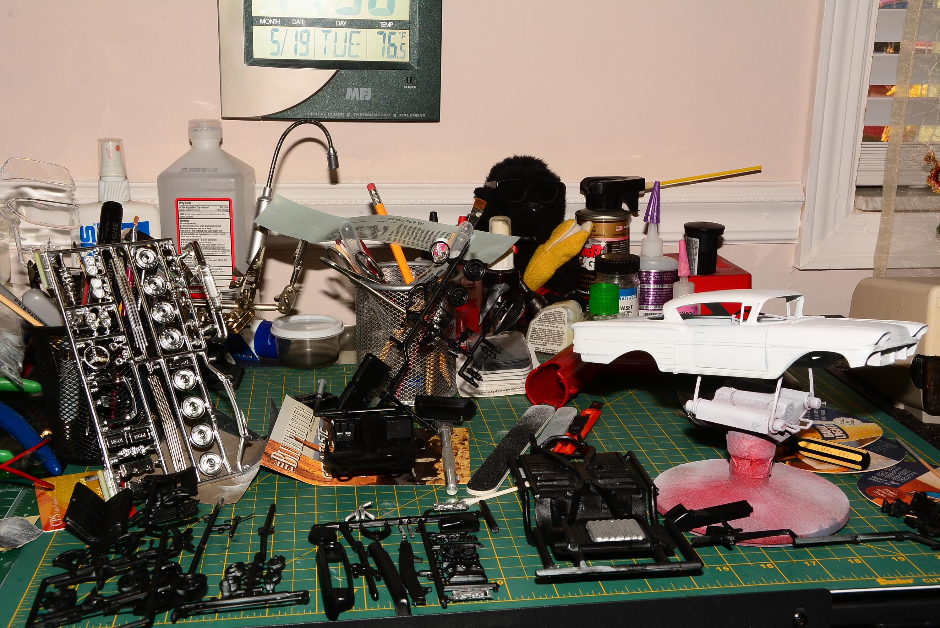

looks like a cluster you know what, but just getting started, I will organize and clean up during the build. I am going to use wheels from a gt500 mustang, and Im going to mix custom with standard parts that came in the kit, because I dont like either one all the way. wish me luck, at 71 years old, I will be challenged to stay steady and not make a mess of things. It is an amt kit won in a Chinese auction at a club xmas party. the club is Table Top Cruisers of central Fl.

Looks kinda like my table, although mines a little more cluttered.

First, I want to welcome on board sir!
Even with a busy workbench you can build model (mine is also cluttered) and it seem that you have most of the necessary tooling.  The age is not a problem either as long you find the pleasure and satisfaction in the process!  The '58 Chevy Impala is a very cool car so I'll be thrilled to come back to check your progress!

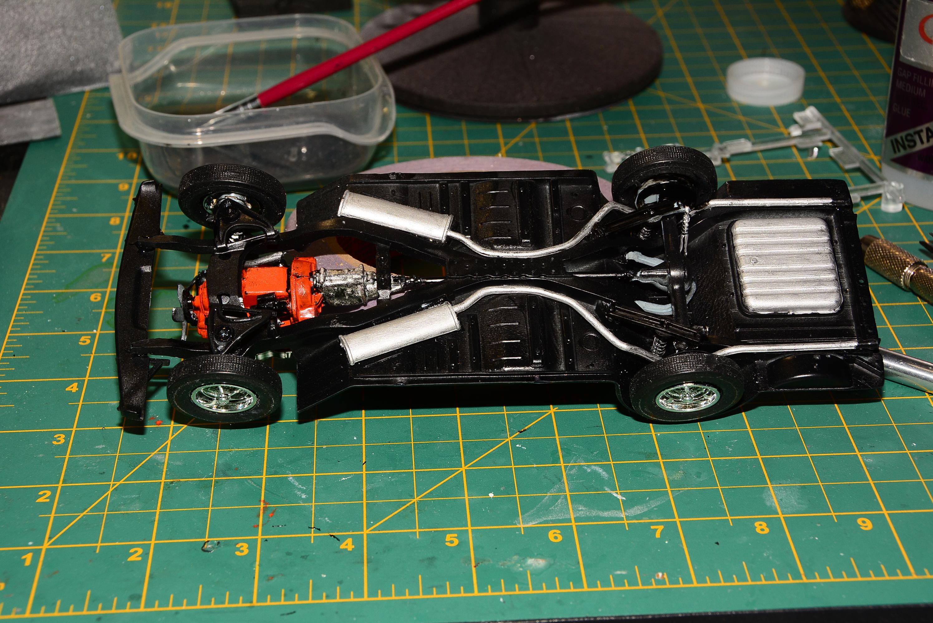

a little progress here.

That is a model builders work bench alright ! Seems no matter how large of a bench I have I end up working in a one foot square space.

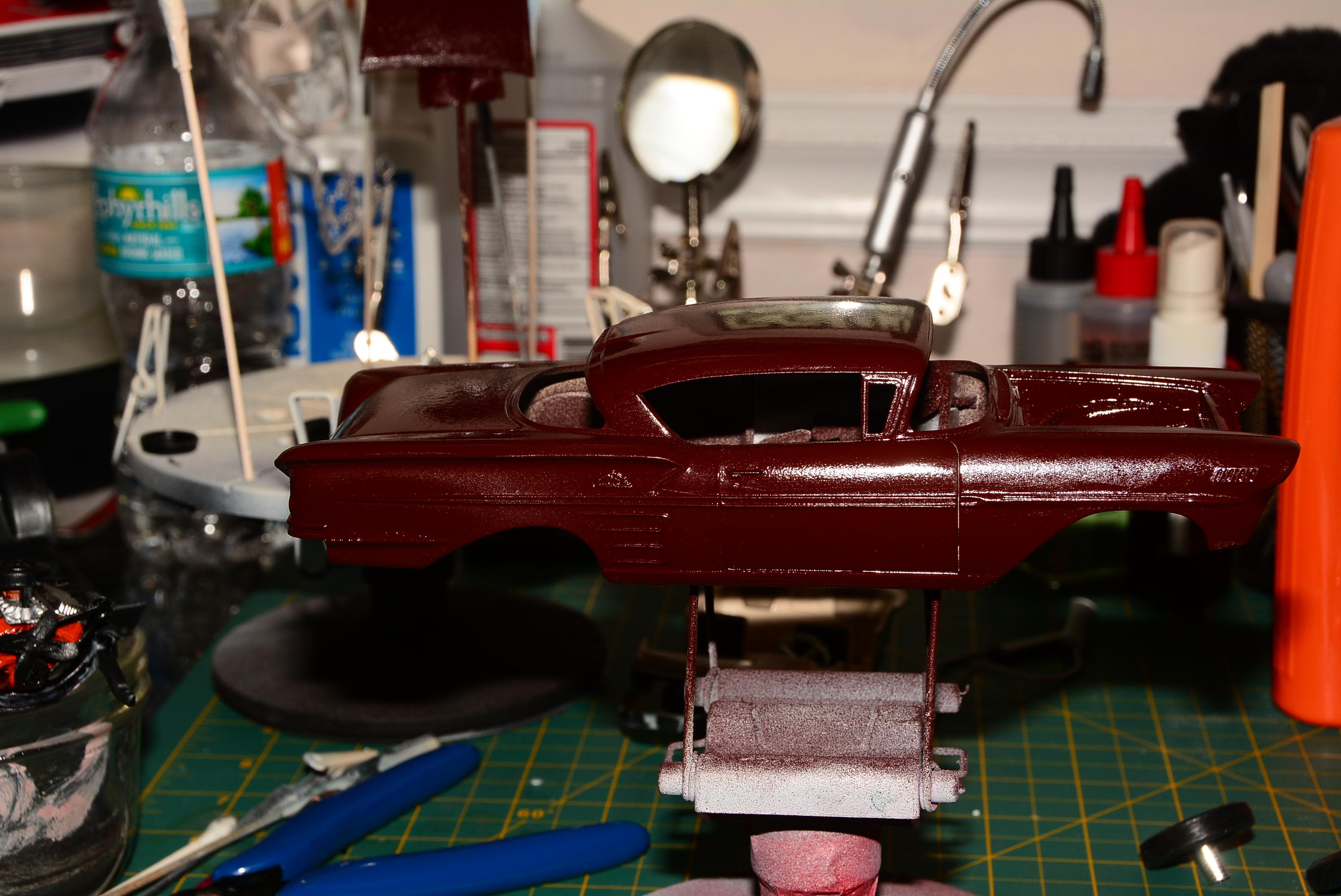

here it is after only 3 hours in super power from ace hrdwr and a light wet sanding. I am starting over with some thing different.  Randy C, I watch HPI Guys workshop and viewed the video on how to use cheap spray cans, after I botched this one, but found no clue as to what went wrong here. I have done this more than a few times without this kind of ugly result. I will say, I never got as good as a result as hpi gets either. anyway, here goes......

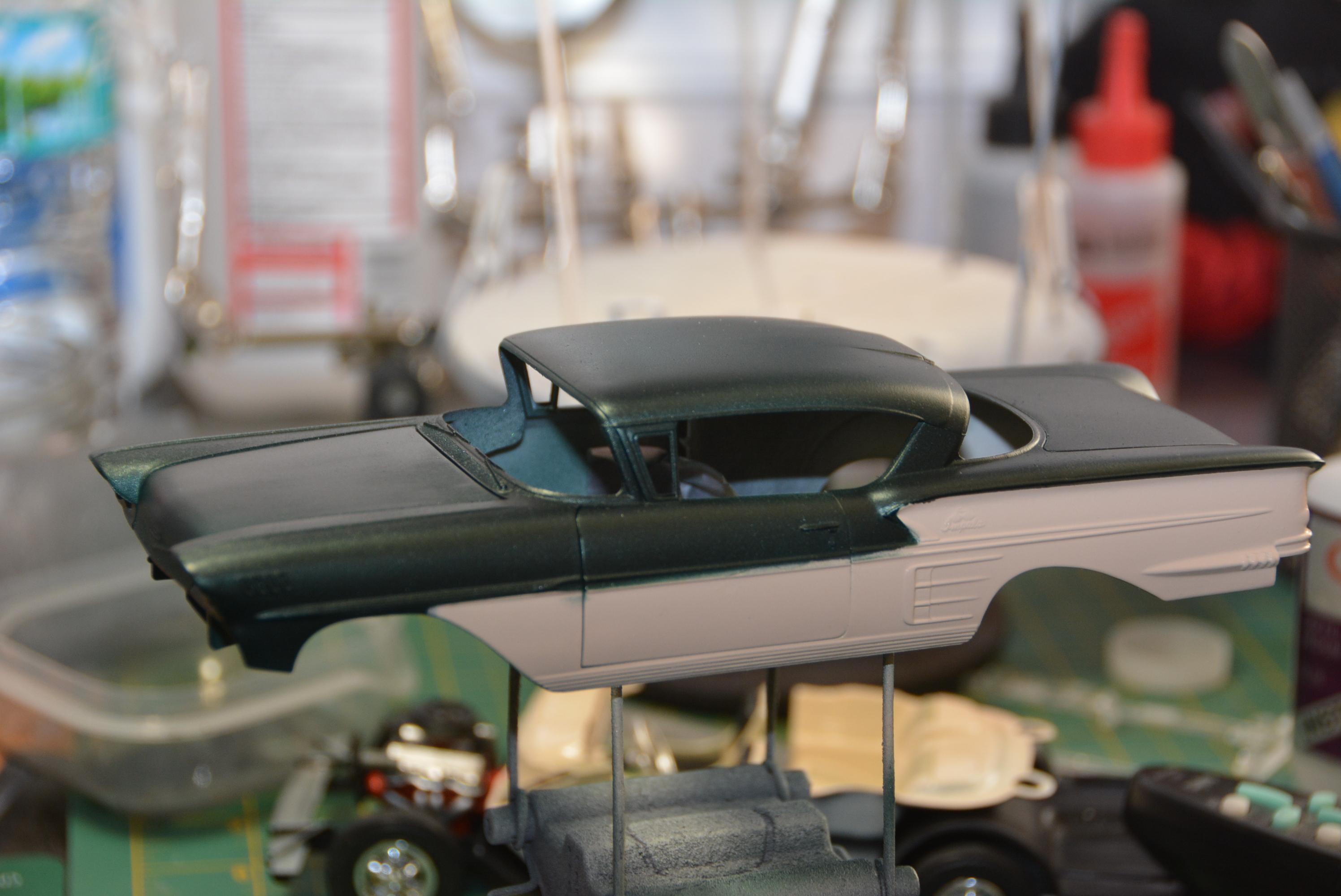

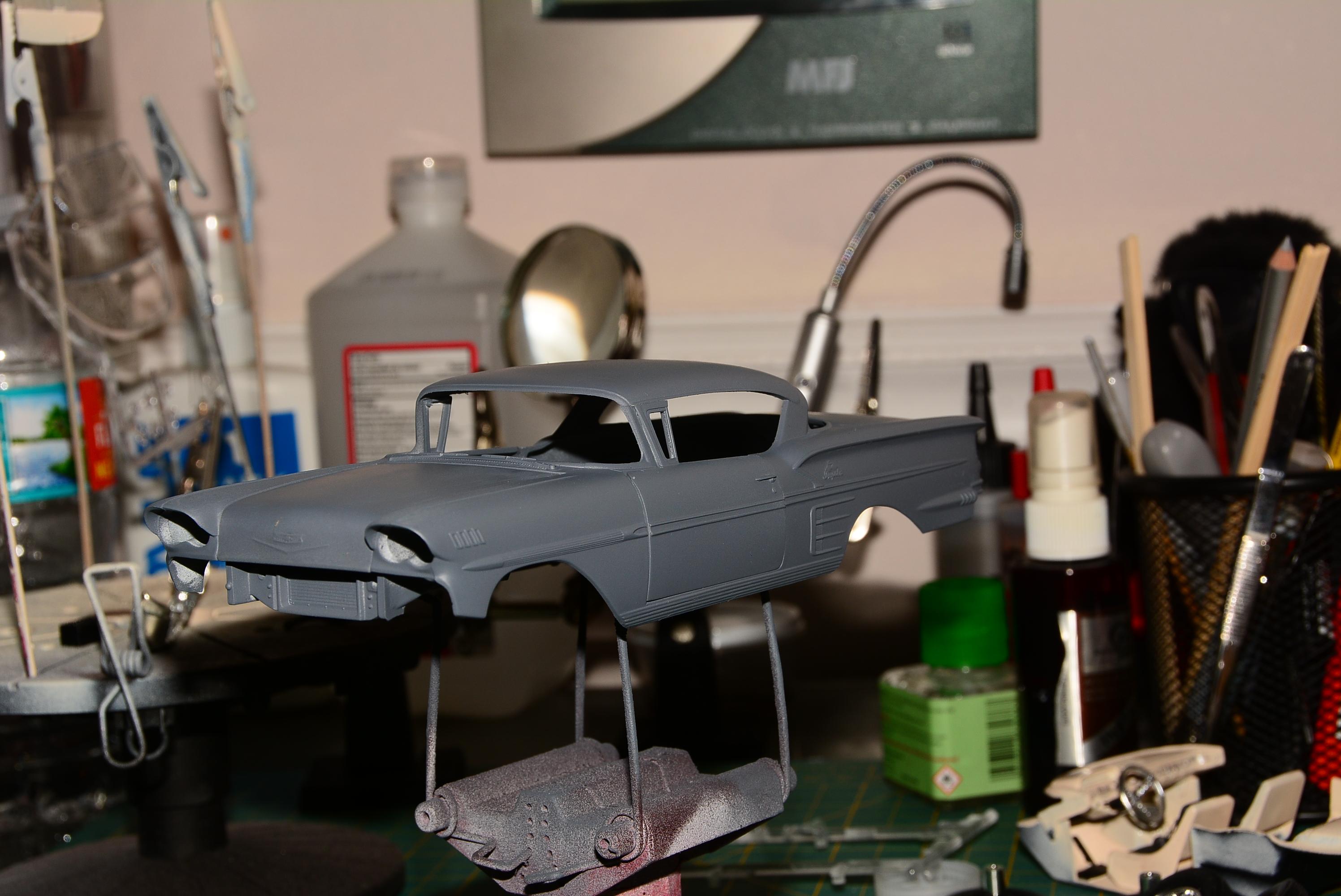

I used my gray primer this time and result was way better than the white. I guess its possible the white primer is the problem because after that was when the trouble started. I am also going to switch final colors just in case.

Nice recovery!
Your primer base looks great.

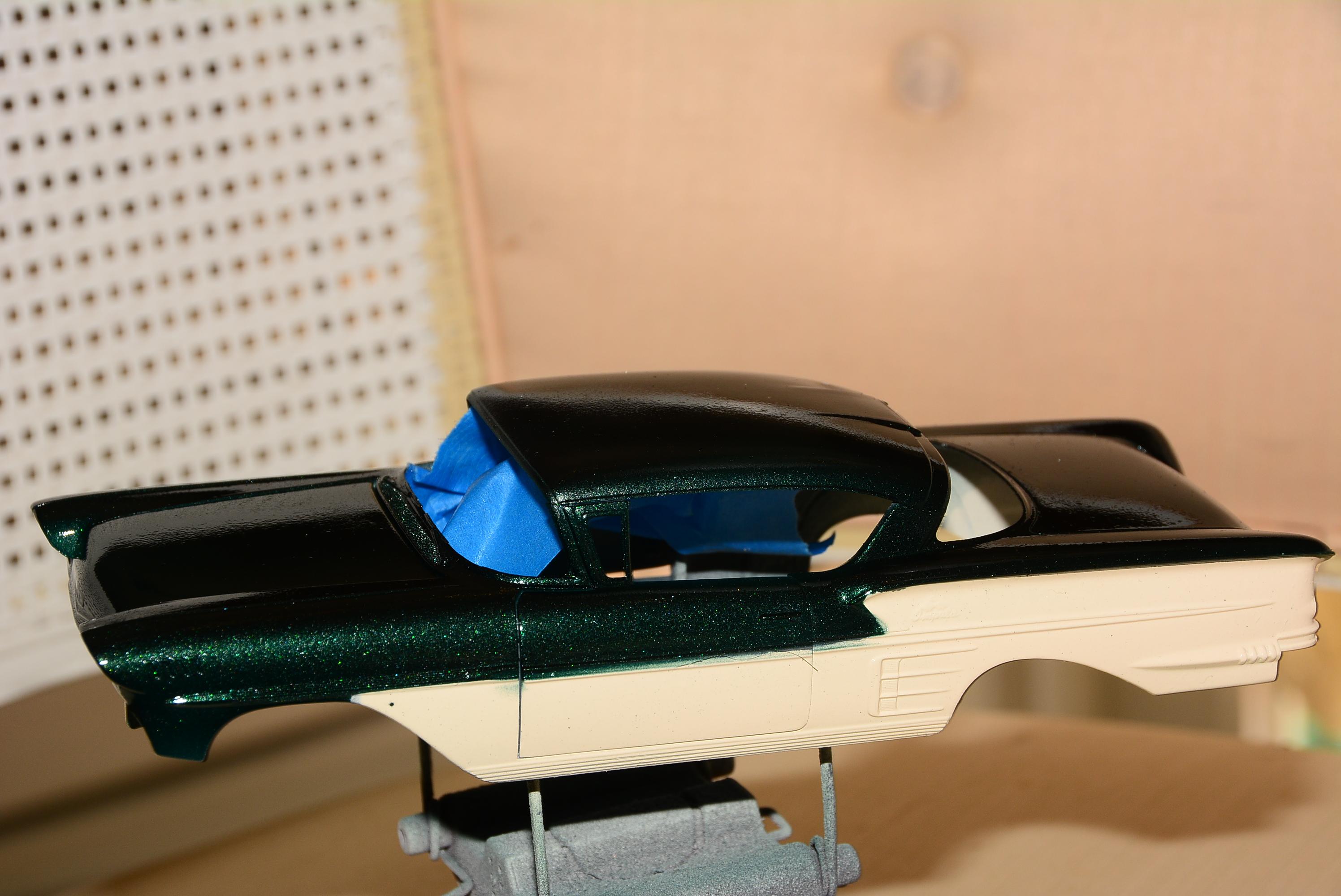

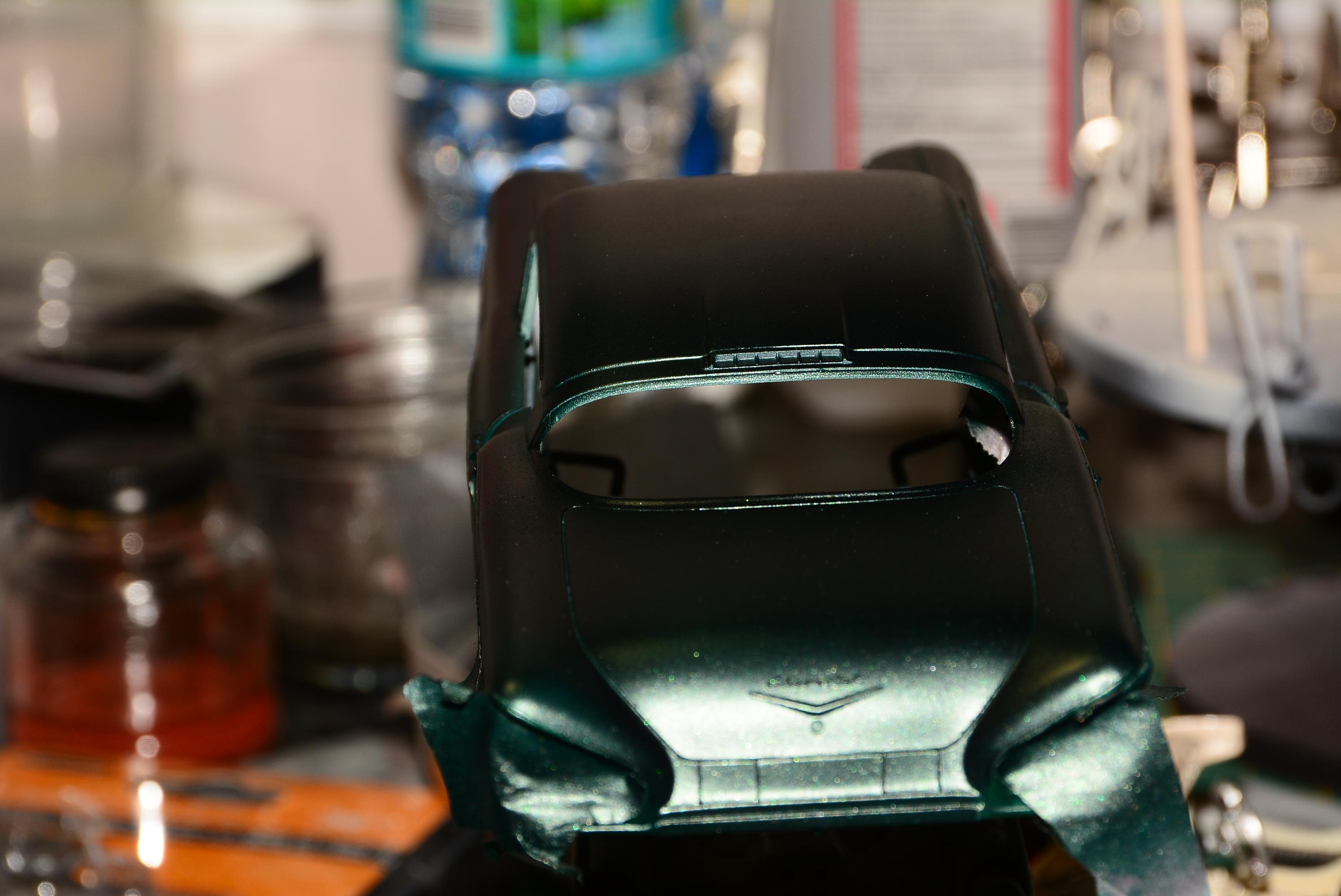

Im not ready to pull the tape to show the cream white color underneath, but I am ready to say Ive been doing this all wrong for awhile now. The new color I chose is a bottle Ive had for a long time now and it was going to go on a 68 mustang. getting it was a chore. It is called Bullitt green from gravity colors usa. I still have 1/2 bottle left and one full bottle from Matte for his poor handling of my order. However what I meant about doing it all wrong, is using rustoleum or duplicolor rattle cans. air brushing is definately the way to go. Im not sure of other brands, but this gravity stuff flowed out and on the car so smoothly and effortlessly I couldnt believe it. Also, it's the first time I used my Paasche H air brush. I had been using an Iwatta double action, and that was pretty much harder to get used to than the one touch Paasche. as soon as it dries, I will pull the tape and apply a glossy clear coat which will put me in to final assy. I appreciate all you fellow modelers for your comments and encourgement.

2 more with hood this time and better lighting that almost shows how good the paint looks in person..

hoo wee that's looking good.

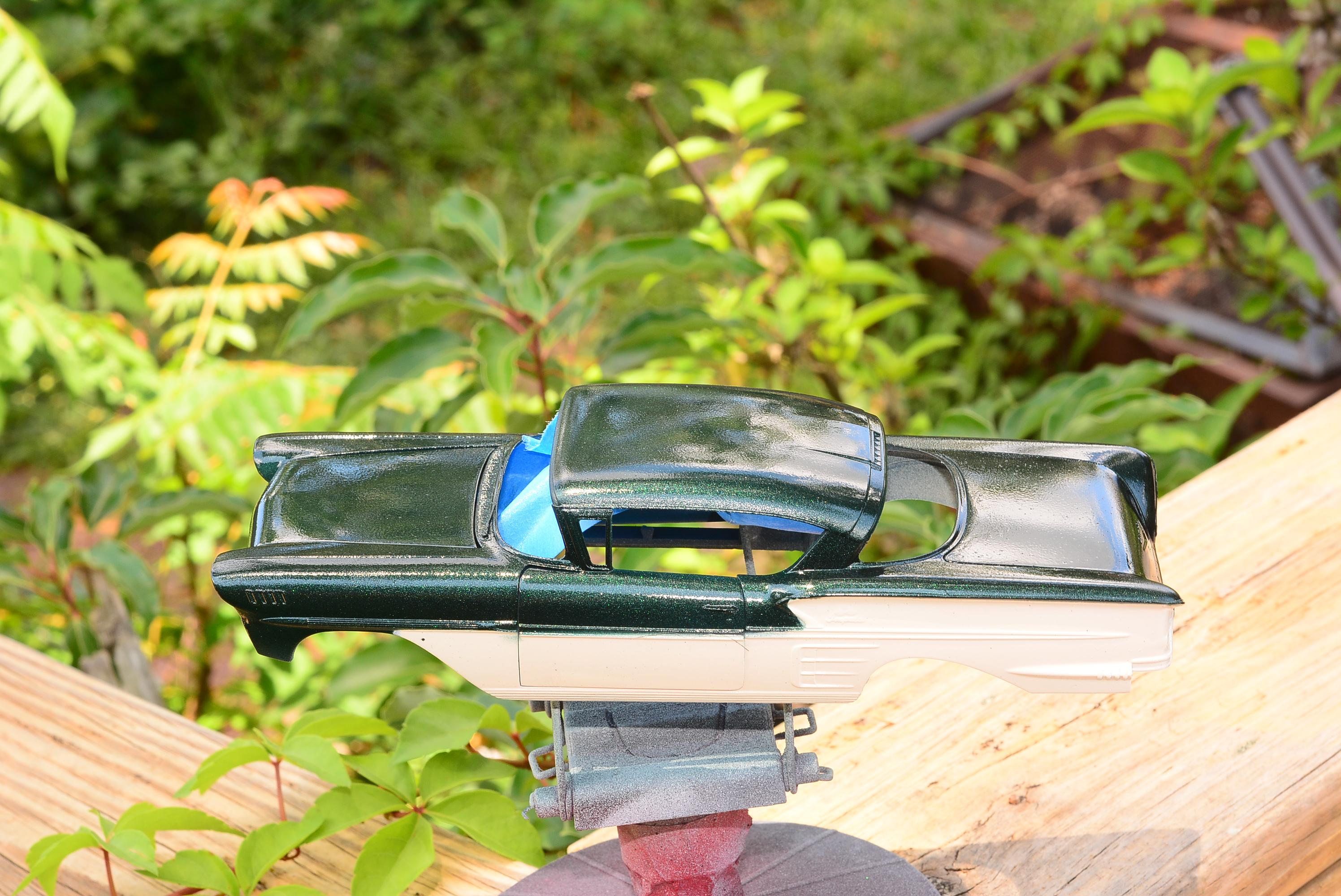

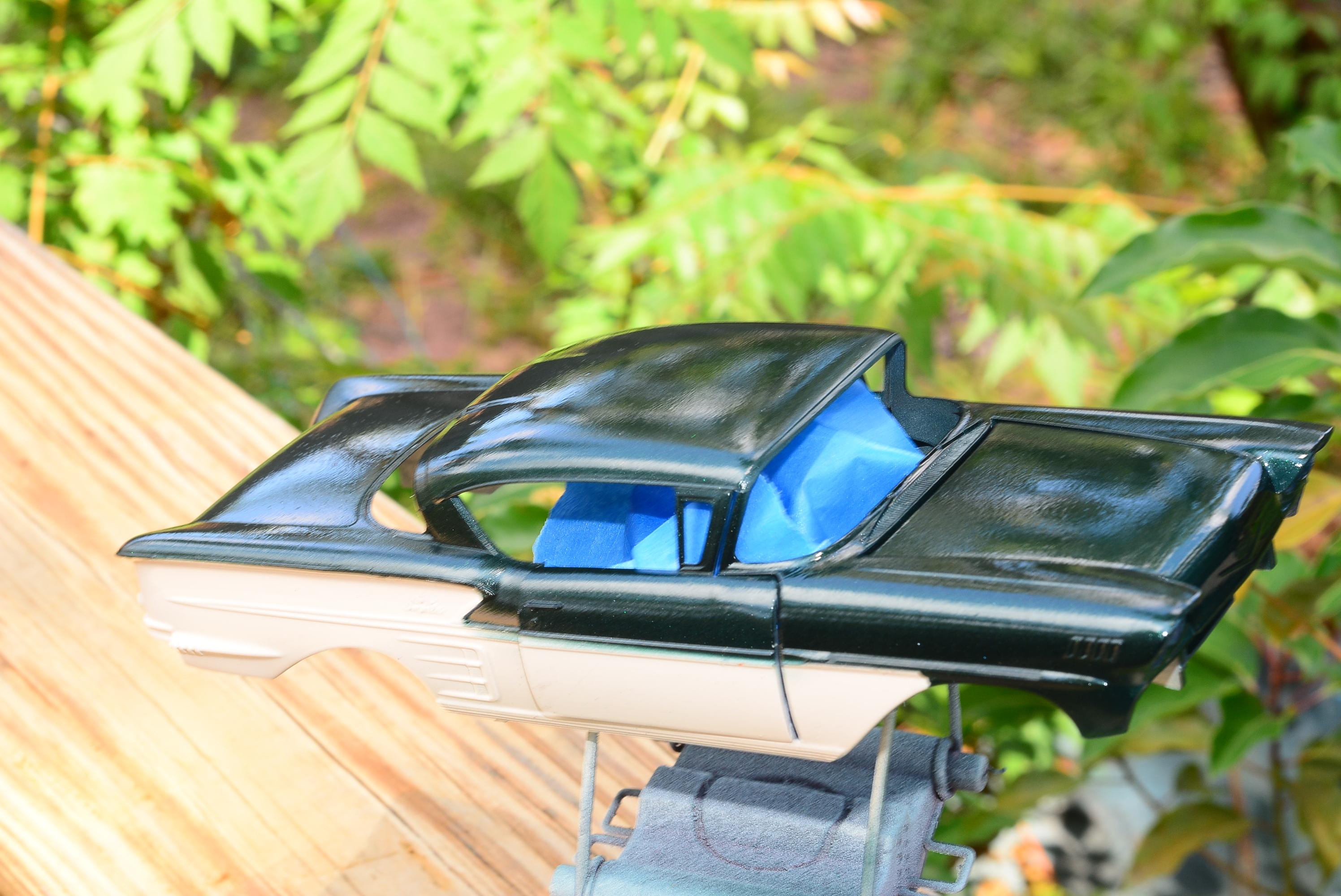

The photos you've all been waiting for !!! lol. just kidding. however, this is the first paint job I've done that is my personal best. even though I had to strip and repaint the hood 4 times before it finally became satisfactory, overall I am very pleased with the result. I used a product called Speedo Kote 2k clear. next up is bmf and then final assy. Again, I thank you all for your comments and encouragement...

Looking great!  BMF shoudl really make that outstanding.
