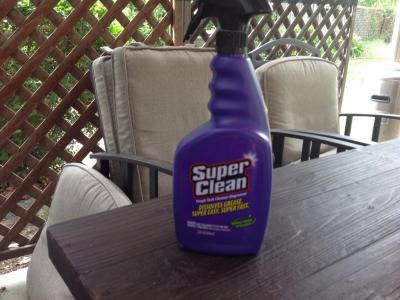

Rolandm925 Posted April 6, 2015 Share Posted April 6, 2015 This stuff removes chrome right in front of your eyes in about 1 to 2 minutes. Removes paint from parts in about 5 minutes. Walmart. $6 bucks Quote Link to comment Share on other sites More sharing options...
Sidney Schwartz Posted April 6, 2015 Share Posted April 6, 2015 I've also used Super Clean for removing chrome and it works great, even on complex parts. Quote Link to comment Share on other sites More sharing options...

StevenGuthmiller Posted April 11, 2015 Share Posted April 11, 2015 I use "Super Clean". I've never had any problems stripping it down to shiny bare plastic. Steve Quote Link to comment Share on other sites More sharing options...
Ace-Garageguy Posted April 11, 2015 Share Posted April 11, 2015 I use "Super Clean". I've never had any problems stripping it down to shiny bare plastic. Steve Which exact product? I see they have several in their line. Quote Link to comment Share on other sites More sharing options...
StevenGuthmiller Posted April 11, 2015 Share Posted April 11, 2015 Which exact product? I see they have several in their line. This is the stuff I use. I'm about out. I need to get some more. This gallon has lasted me about 3 years. Steve Quote Link to comment Share on other sites More sharing options...

Speedfreak Posted May 11, 2015 Share Posted May 11, 2015 (edited) Like Steve, I've been using Super Clean lately, (same thing he shows in the photo) , and it takes the top layer of chrome off in minutes, then I let it sit in the stuff for several hours, sometimes over night , and it's down to bare plastic, best stuff I've used so far. Beats the BLAH_BLAH_BLAH_BLAH out of bleach. Edited May 11, 2015 by Speedfreak Quote Link to comment Share on other sites More sharing options...

Force Posted July 28, 2015 Share Posted July 28, 2015 I can also recomend Super Clean, I have tried it and it works like a charm. Quote Link to comment Share on other sites More sharing options...
